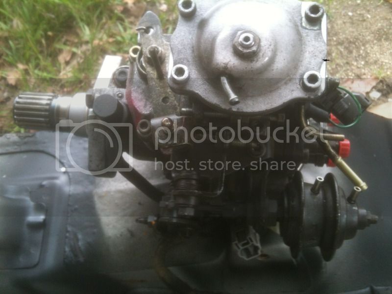

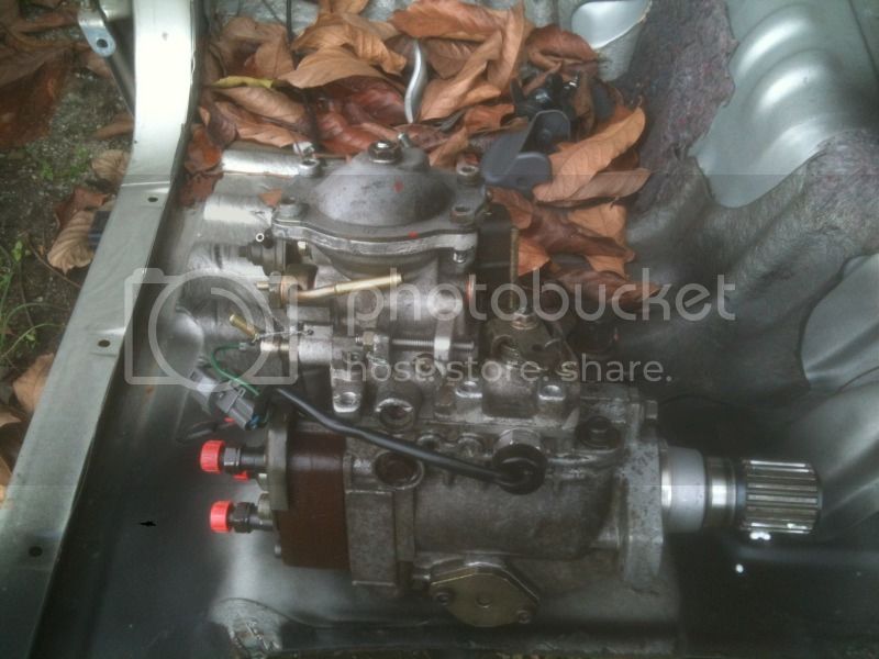

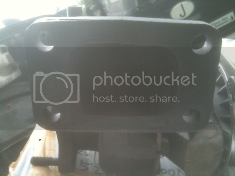

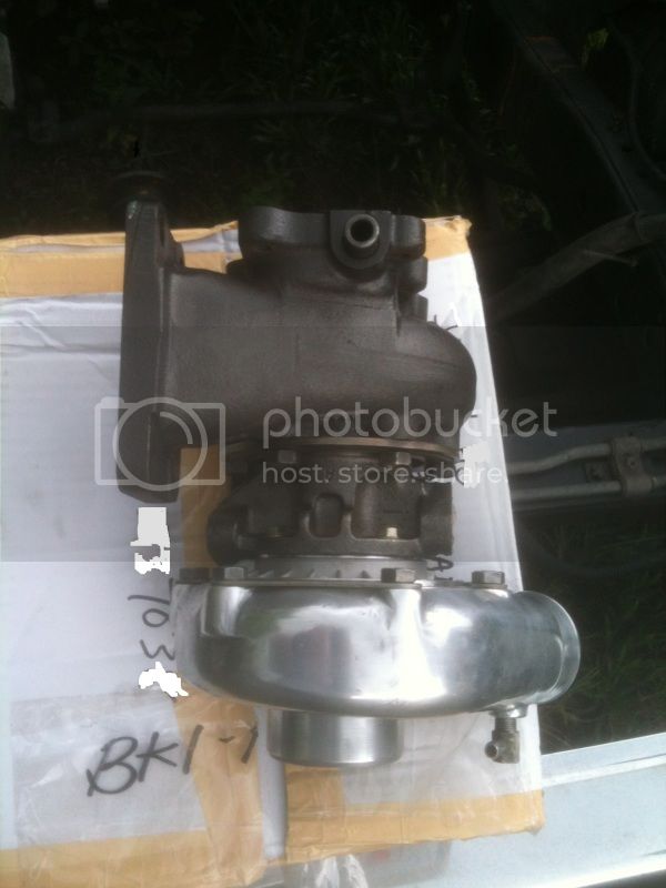

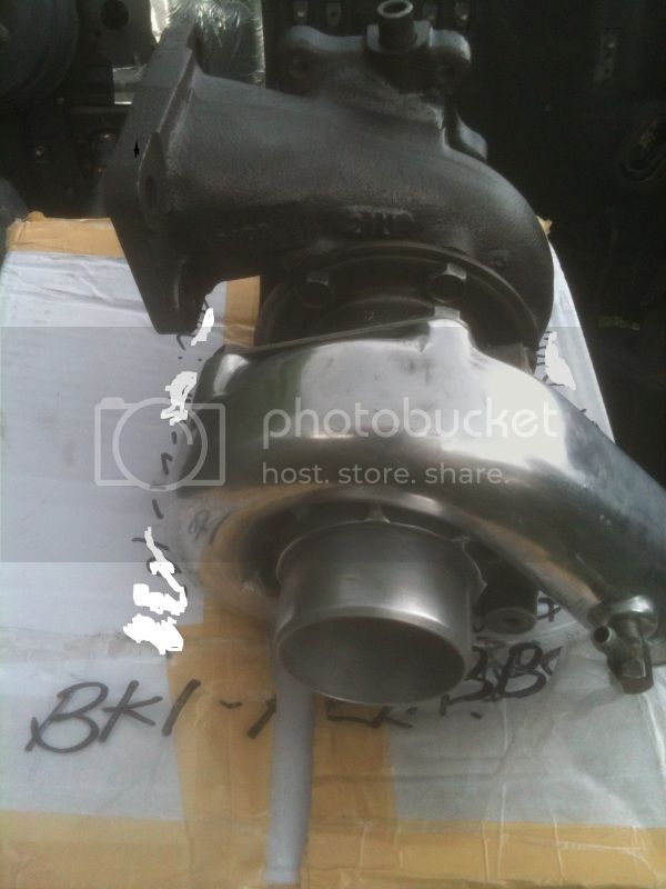

Not much to see on the piccies of fuel pump and turbo but here they are as seen today.
Fuel Pump reconditioned and tuned:
Hybrid Turbo with Garret parts inside. Tuned for fast spool:
