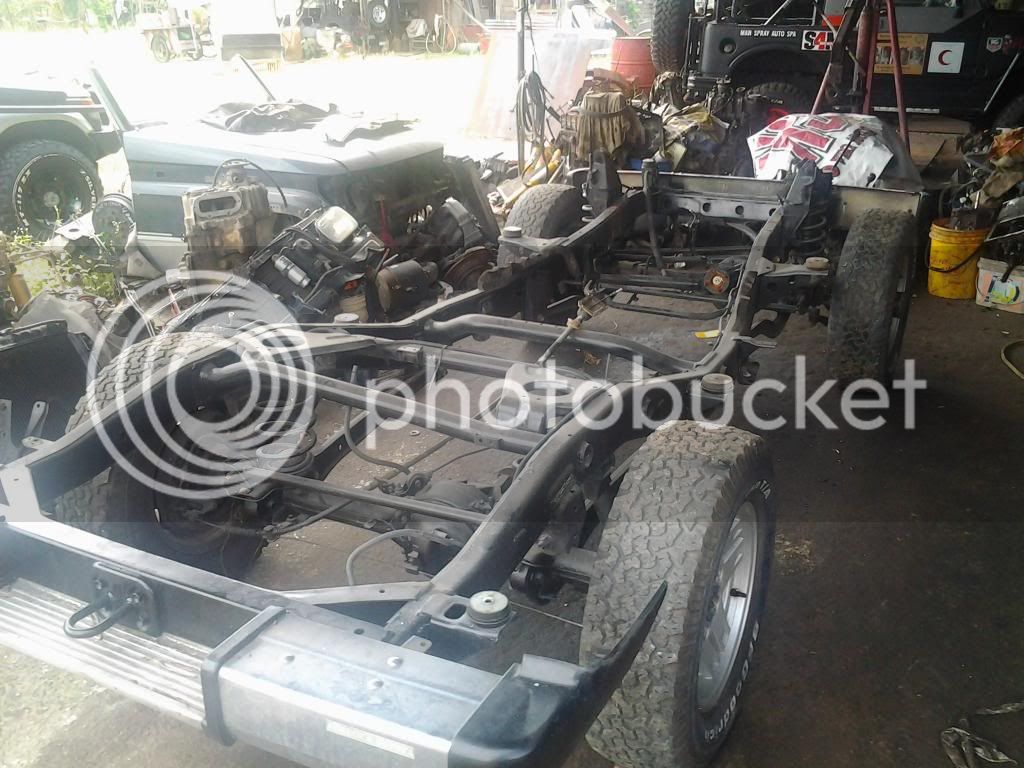

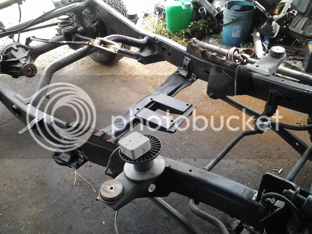

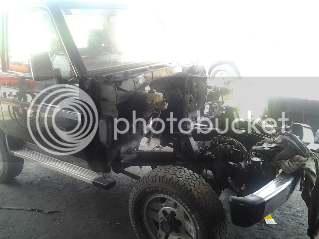

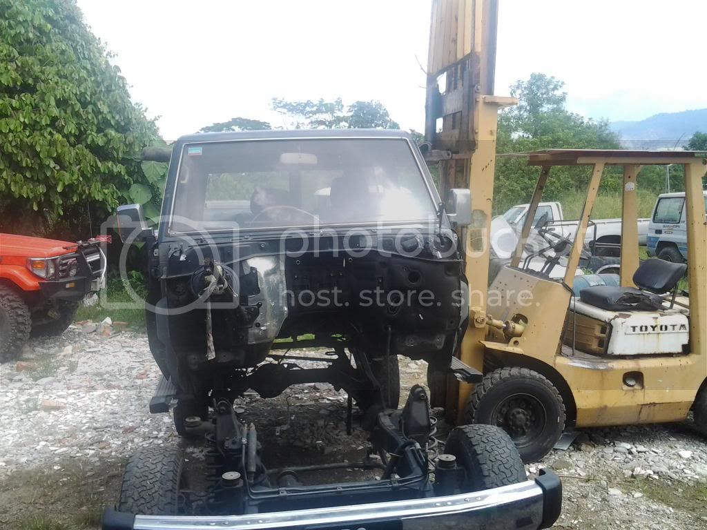

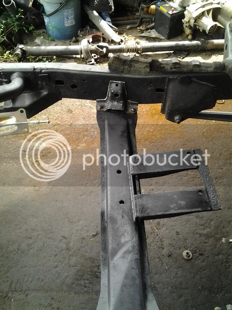

Was decided better to take the body off considering cutting and welding job to do for engine and gearbox mounting.

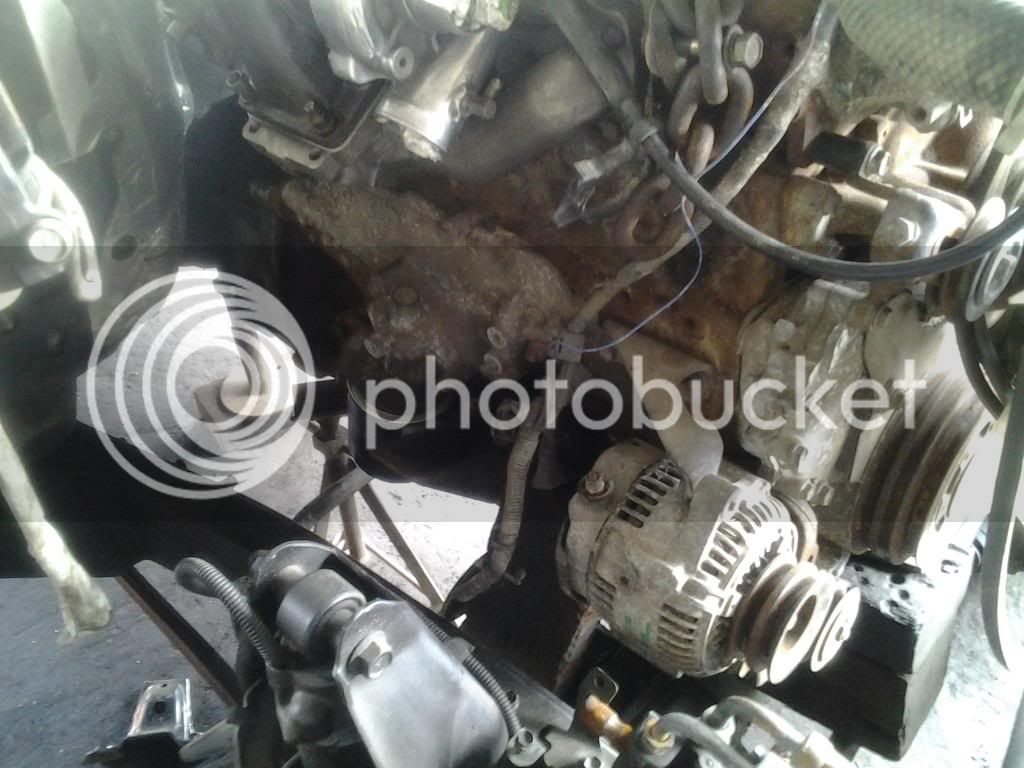

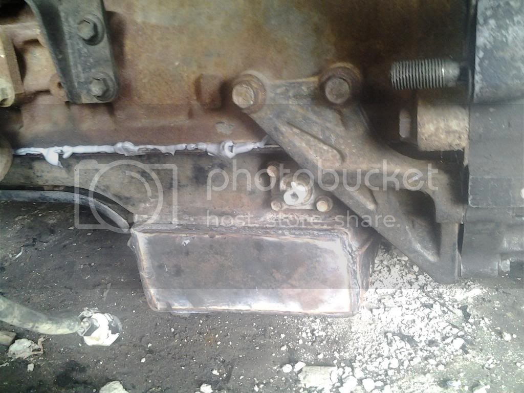

Sump back from with the side trimmed:

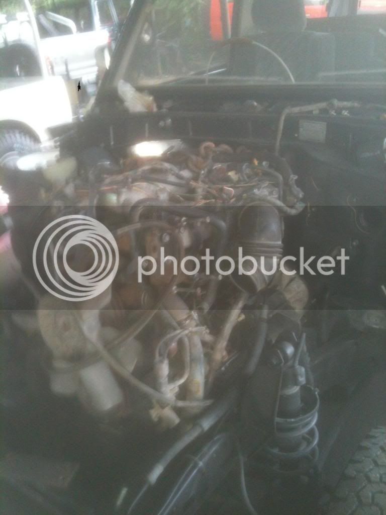

A quick update. Apologies for the low quality piccies, taken with an out of date iphone3GS.

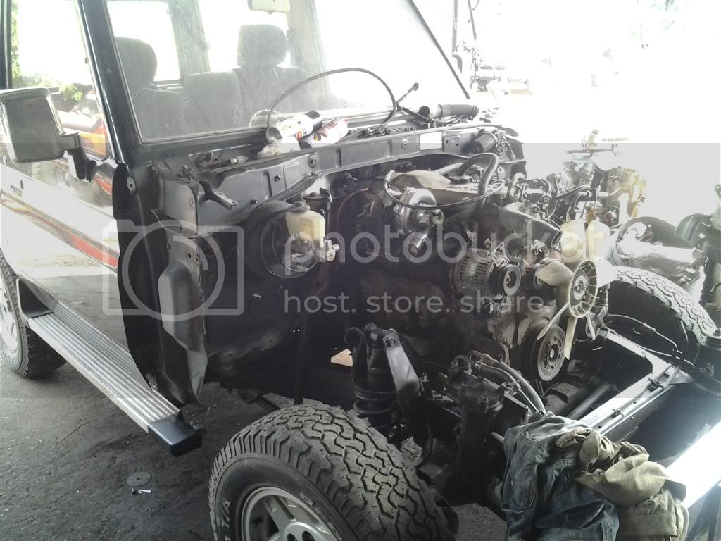

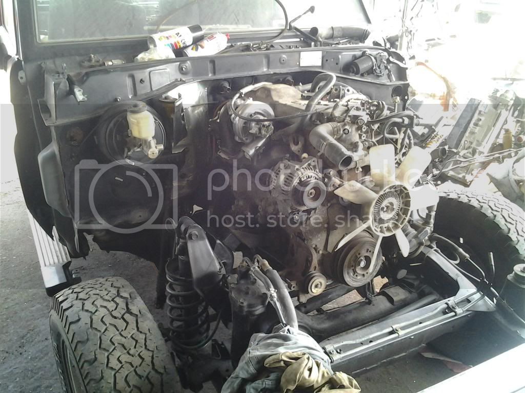

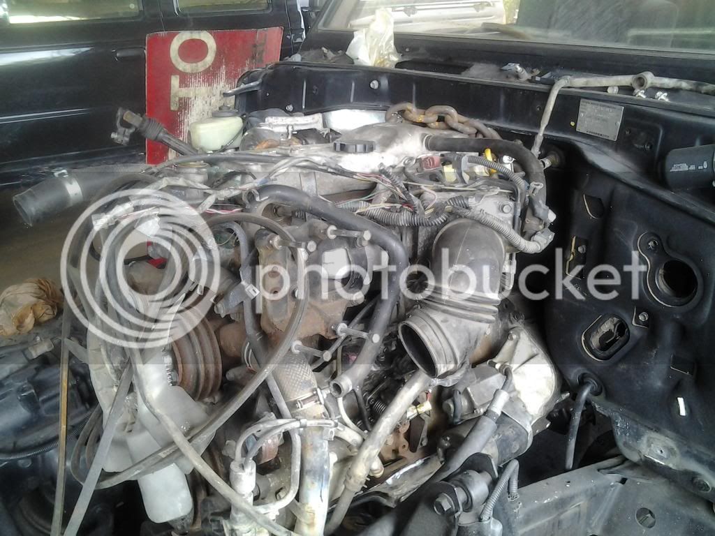

15B and geabox in the engine bay. Not final position:

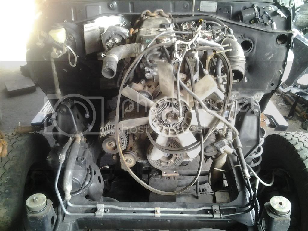

Engine resting on wooden chocks while awaiting final alignment:

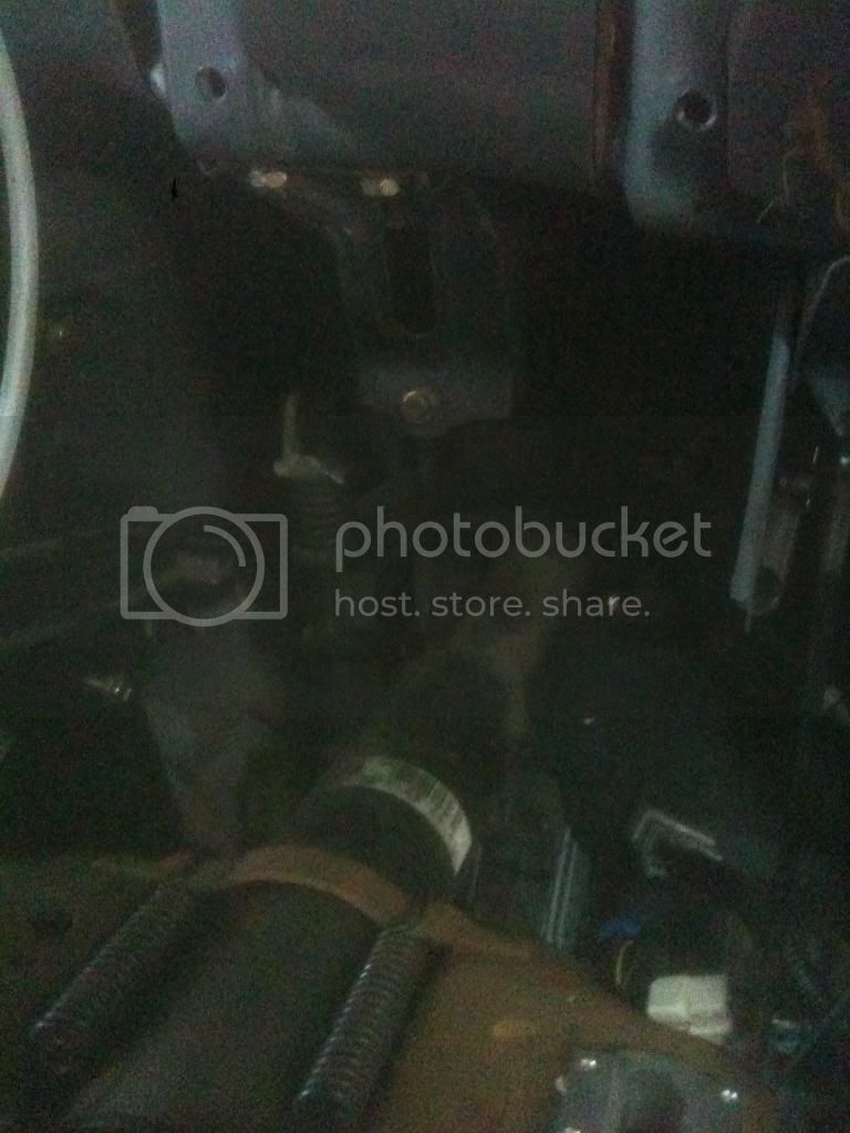

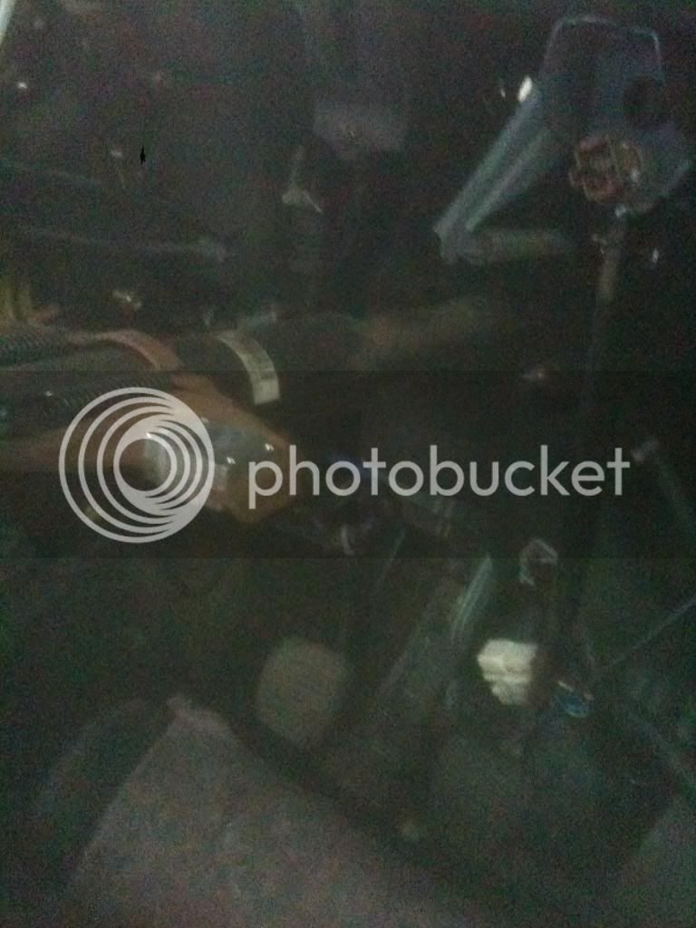

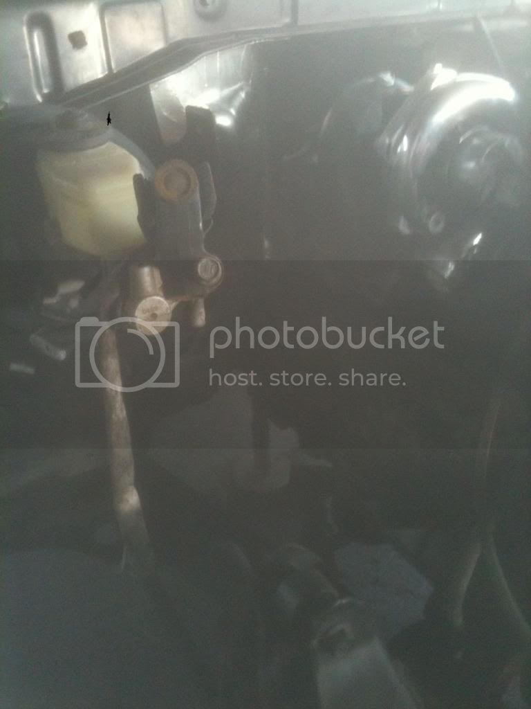

Spring loaded clutch pedal. Vehicle was a former auto. If the spring loaded pedal not too good a servo unit will be used:

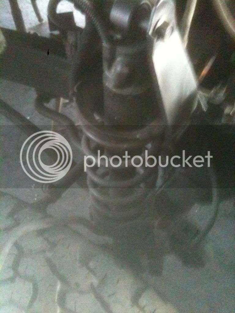

Still on stock suspension:

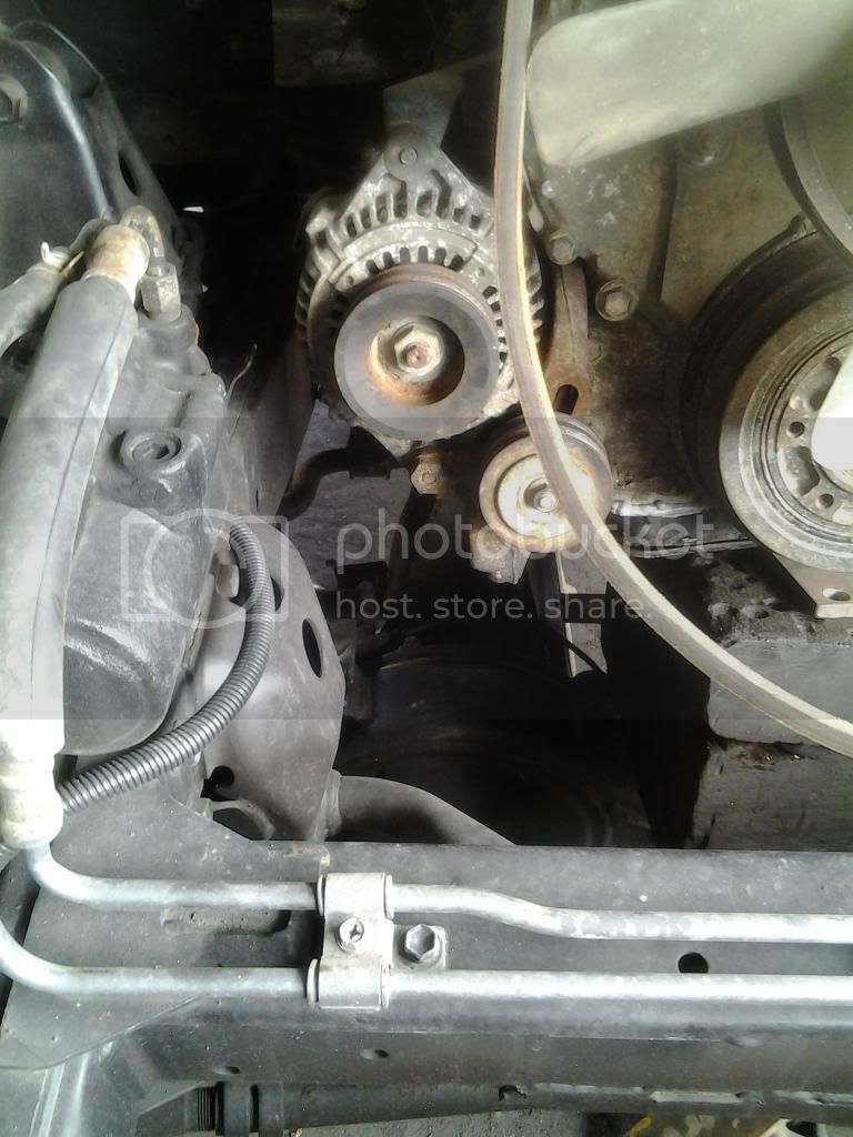

The trimmed sumps sits very nicely so no issues there. Also the old 24V alternator proved to be no issue too; however a 12v alternator will be installed as the vehicle will operate on this voltage.

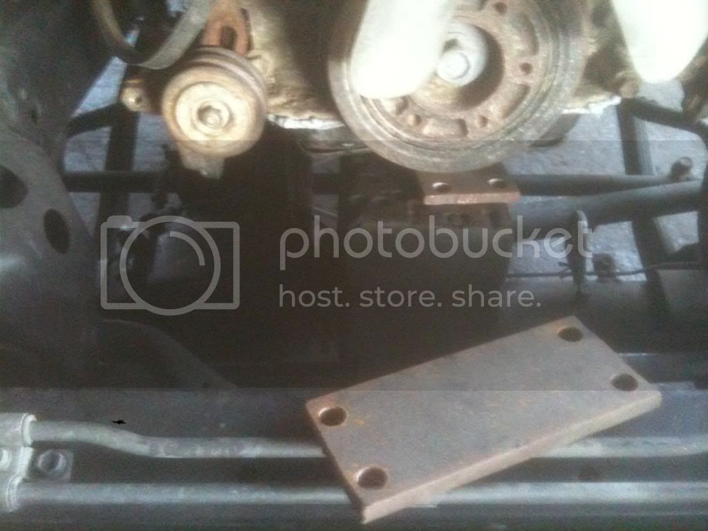

A set of engine mounts were ordered from Sabah. They should already have arrived in Kuala Lumper. After alignment ready for full fitting.
The next step will be to roll out the red carpet for the welder!!

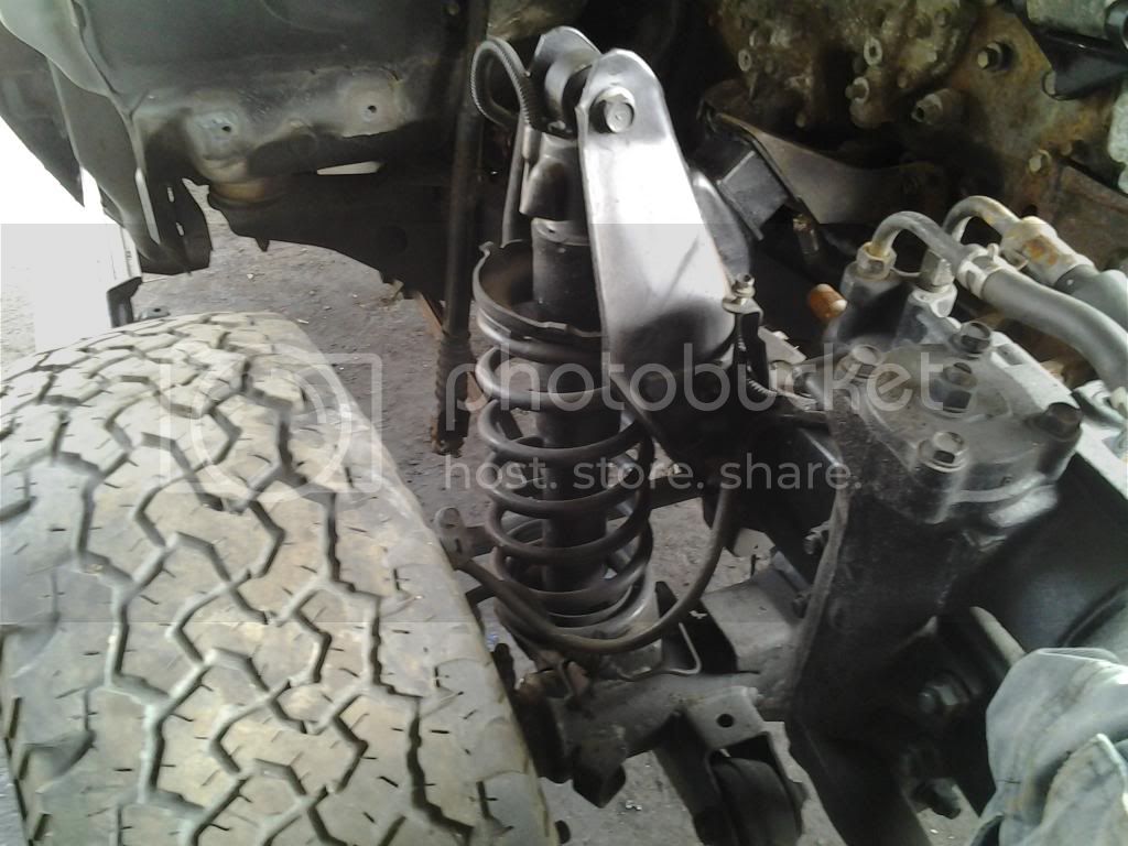

It's cool to see the absorber is inside the coil spring :cool:.

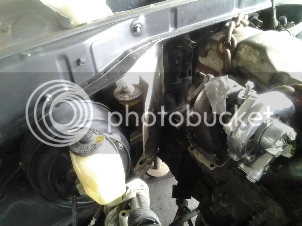

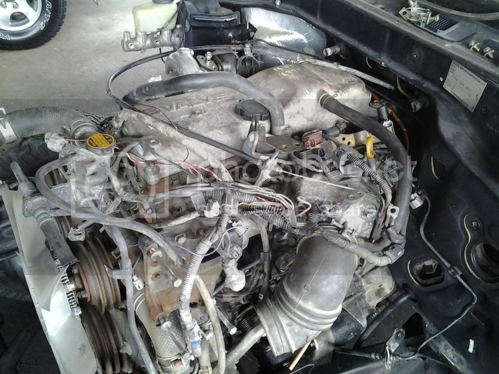

A few better piccies taken today.
Engine bracket mount bracket arrived from Sabah too.
:p:p Does the mean the springs won't fall out when going over a few humps?
I think this setup works best on coil because it stabilise it directly at the same degree. By the way what is that pipe connecting to the absorber? Does the stock suspension has the function to control its firmness? I thought such premium features are only available at 100 series and above. :eek:
Correct. Two settings. I tried ot but could not tell any difference....onroad anyway.

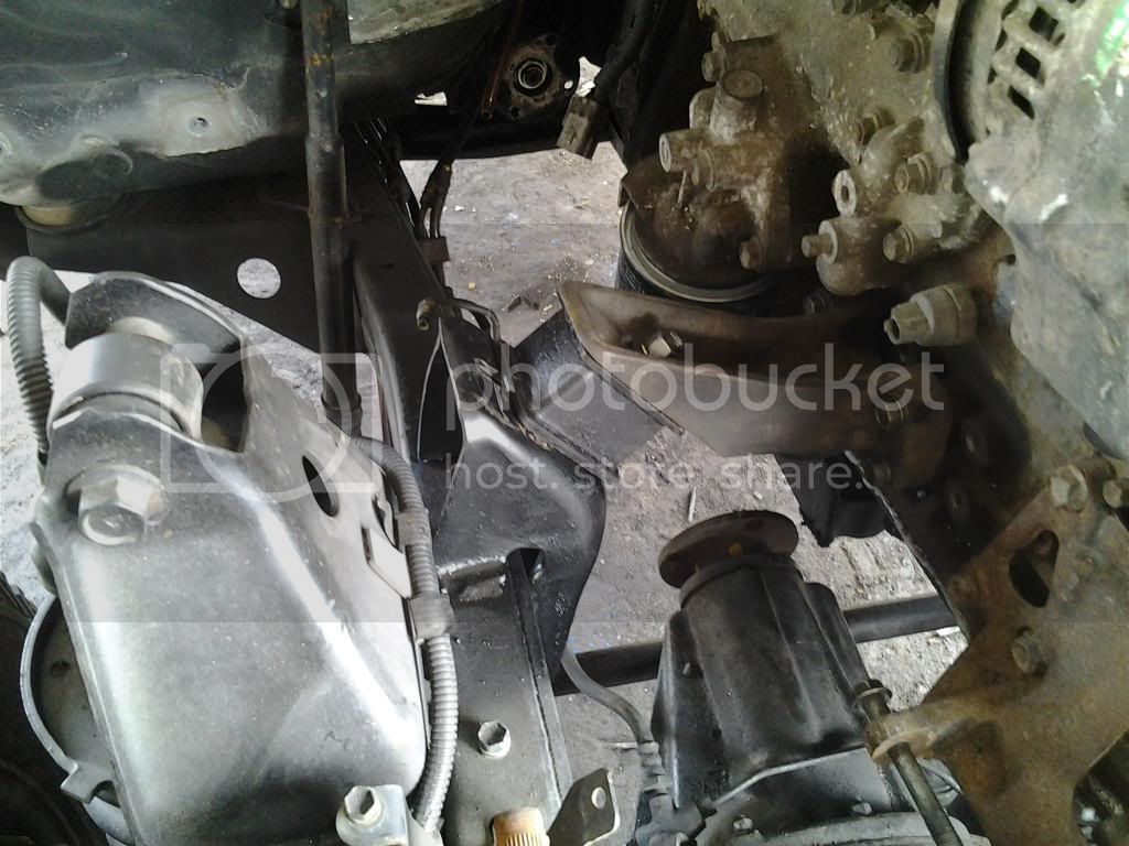

Gearbox and engine mounts fitted and ready for full welding:

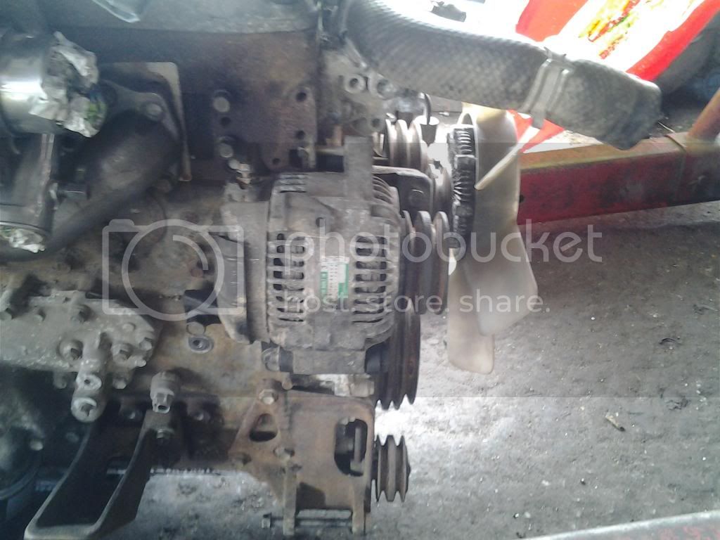

Alternator moved up for clearance:
Not the alternator to be used as its 24v.
Here's the engine all fitted in the engine bay and bolted down permanently:
Left side engine mount:
Right side engine mount:

The clutch pedal is a little stiff. Should a servo unit be used as per the BJ engine?
