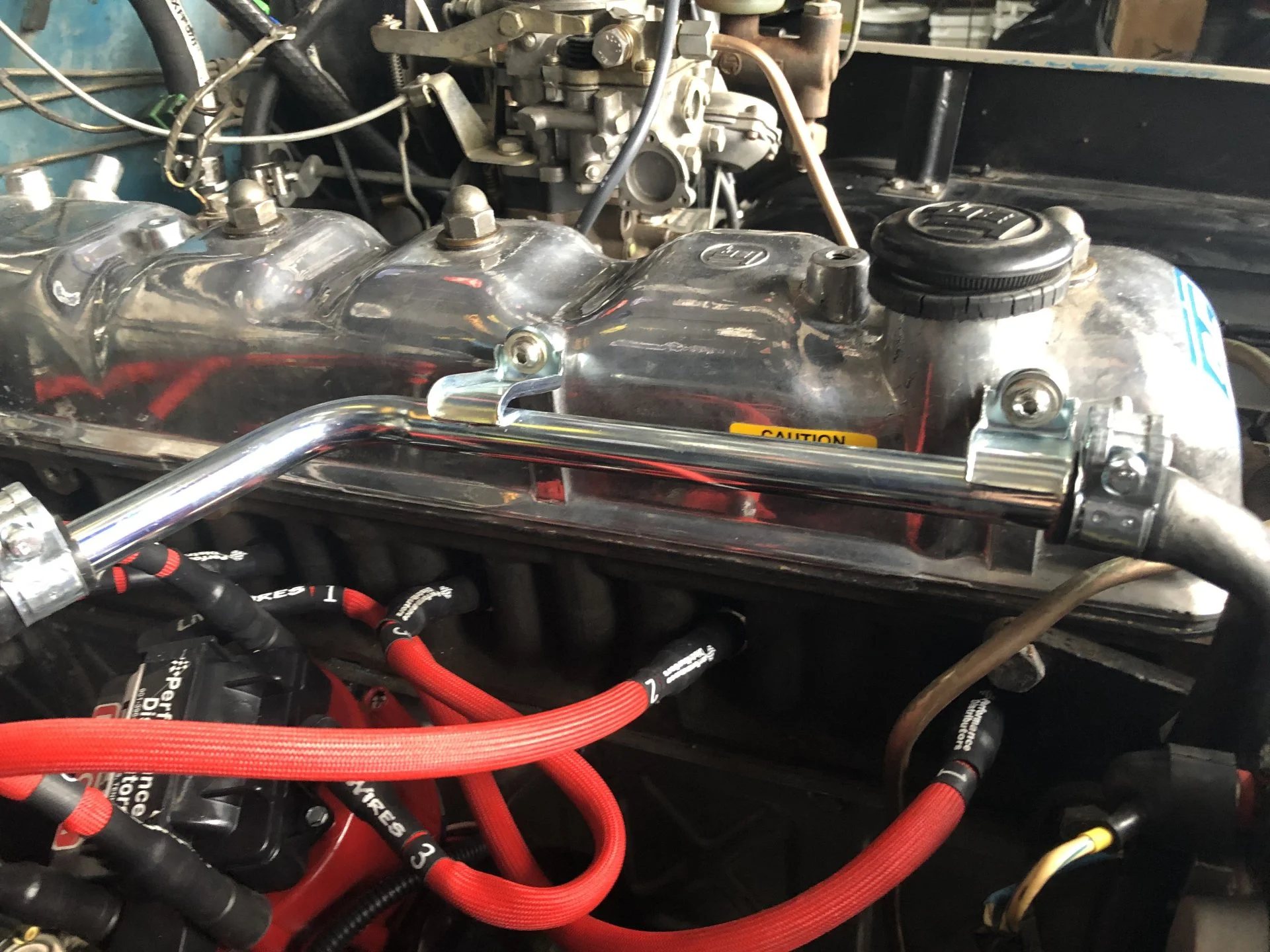

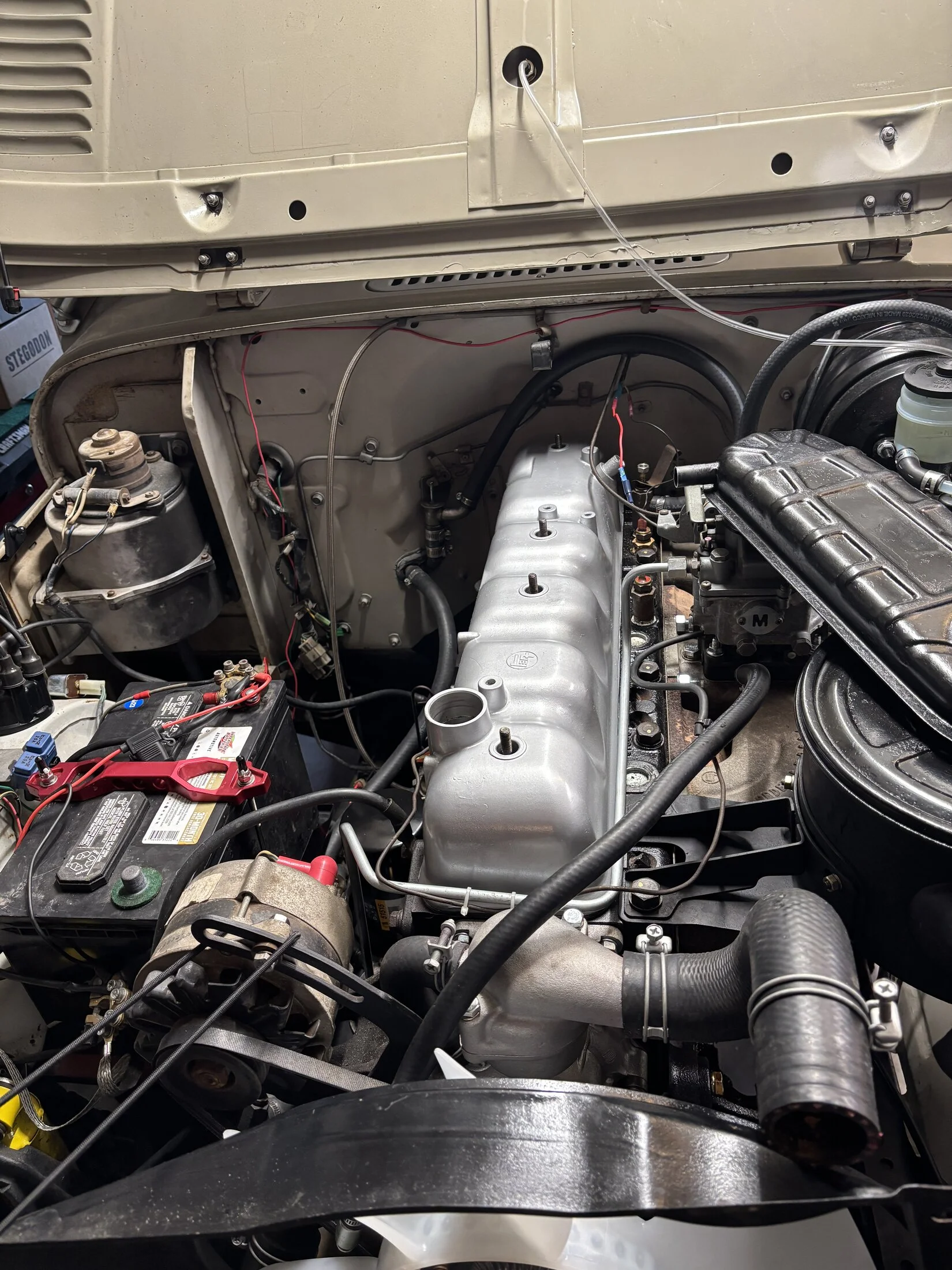

I rerouted the plumbing after installing a DUI. The DUI cap has an UBER Mellon. Clears my 2f air cleaner. In my case, it was necessary to channel my inner Neanderthal IOT bend the new pipe up ever so slightly. 👆🏻
Wow, there's a lot going on in there.
For sure. The DUI dizzy is LARGE. Barely clears. But, by mounting my new plumbing on the valve cover it was easy to reroute.

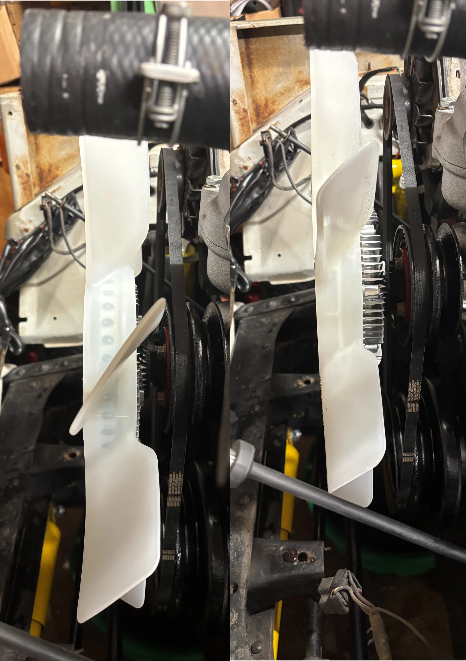

Drained the radiator...again...and removed it. I swapped out the "too close for comfort" fan for a new one from @cruiseroutfit that will give me a bunch more clearance.
I actually sits further back than the clutch thermostat. (Old on the right, new on the left.)

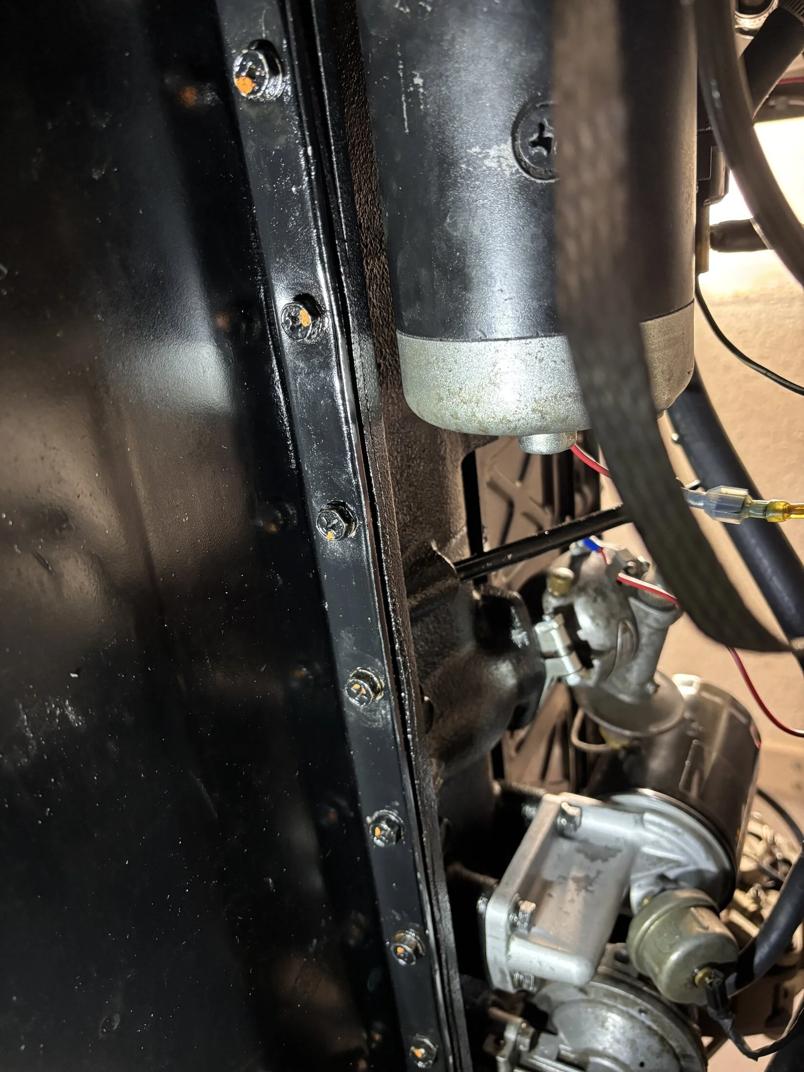

I ordered a new radiator from Mr. T. Tired of worrying about leaks.
I'll reinstall the heater tomorrow and try and get the rest of the hoses shortened, routed and sorted before the new radiator arrives.

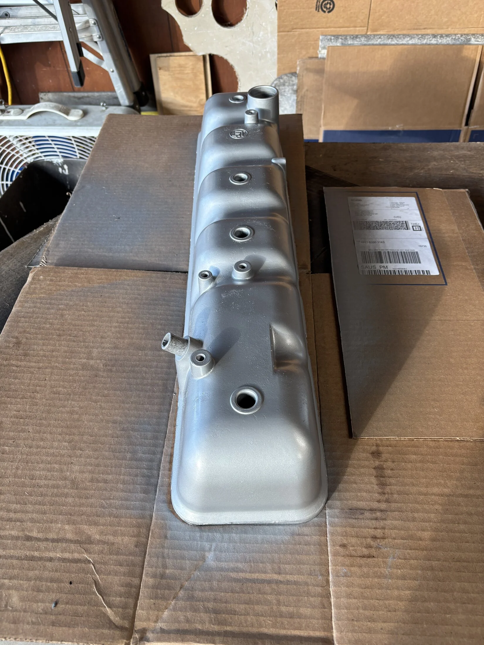

I painted the valve cover since it got a bit scratched by the chain when it was lifted.
Makes the engine compartment look nice.

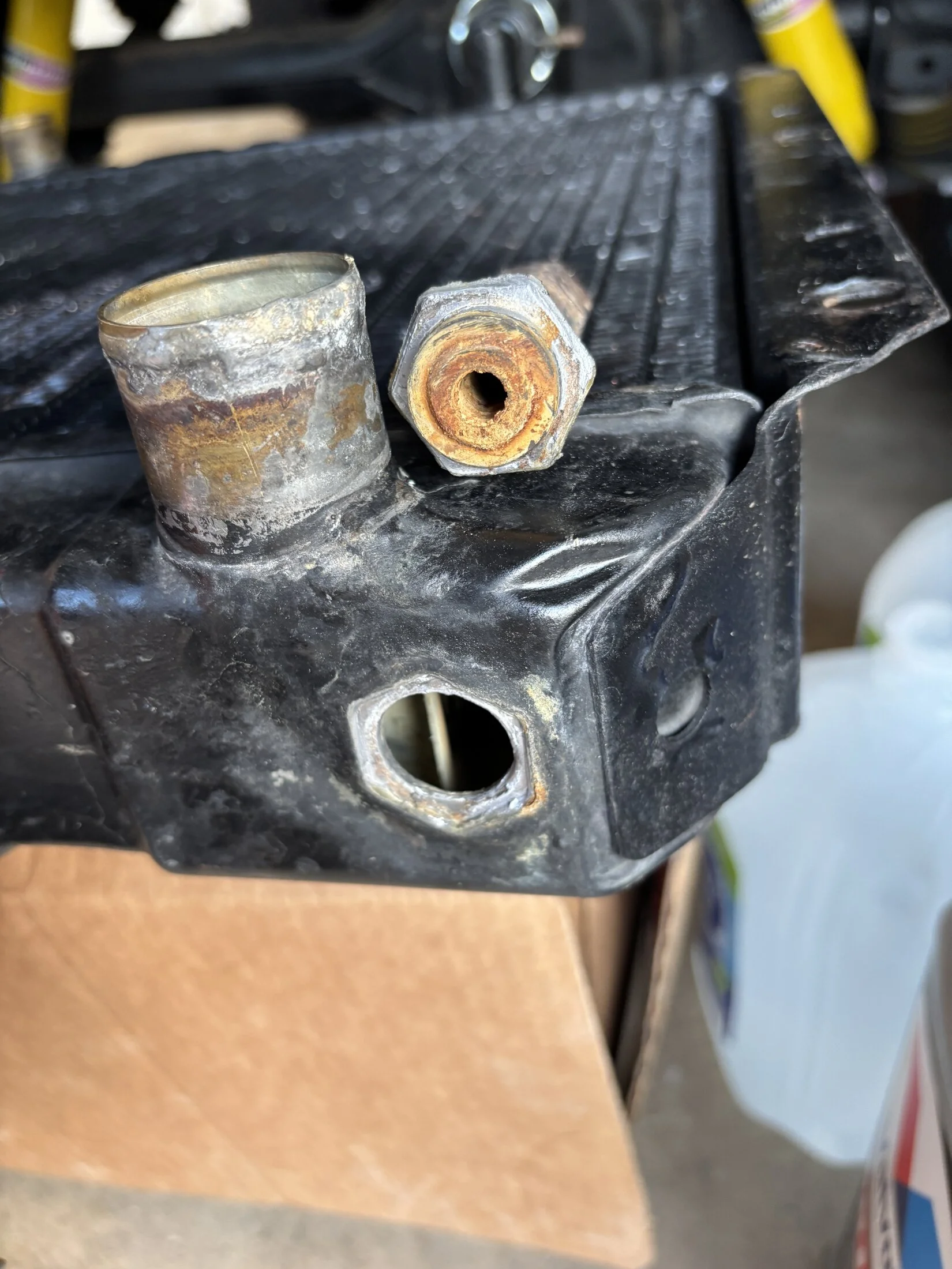

I decided to try and remove the drain from the old radiator and it did not go well. The silver solder was already compromised and the source of a leak. I just finished the job.

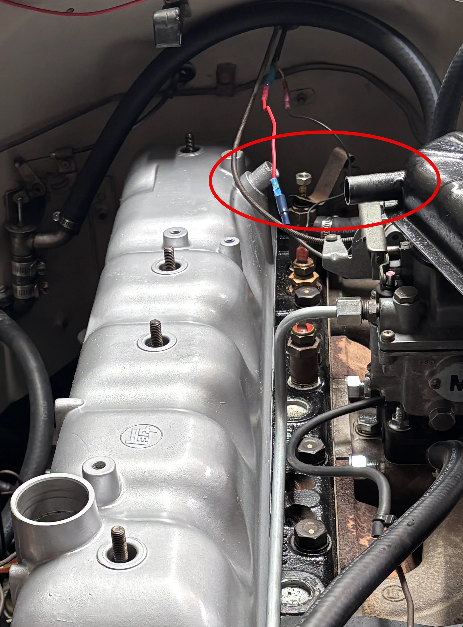

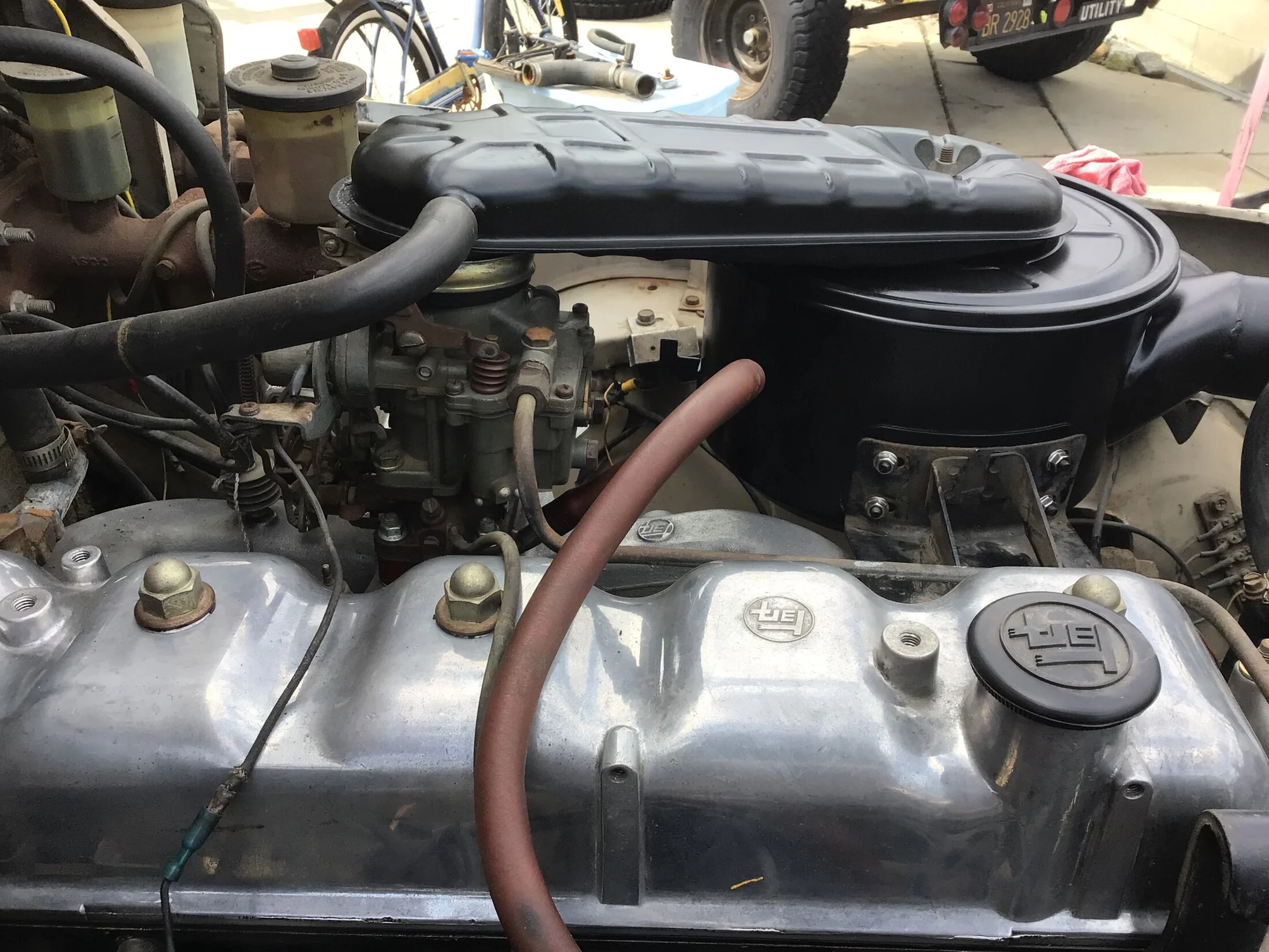

Question of the day. I bought some 18mm silicone vacuum hose from Amazon to go from the air cleaner to the valve cover, but it's flimsy and doesn't look very good. I couldn't find any "real" rubber vacuum hose in auto part stores or online that was big enough. Has anyone else solved this connection?
Try McMaster-Carr on that last one.

Thanks, anything in the neighborhood of 18mm ID? Not sure why but this appears to be a challenging size.
Maybe your local auto parts store has a 5/8” id pre-bent hose that looks like an S with close dimensions? I’ve had ok luck going and telling them I need something not for its intended purpose and they’ll let me just look through hoses, seals, etc.
I put two 2F pcv hoses back to back, with a short piece of metal tubing at the midpoint junction. This is the Karma Cruiser.
Matt I’ve bent straight heater hose with a spring and a heat gun. I’d think some 5/8 Gates with a long 5/8 OD spring from the hardware store would do the trick.
Insert spring into the hose so it doesn’t kink when you bend it, bend and then heat the hose, allow it to cool and then remove the spring. Repeat at the other end and you can make a hose with the two bends you need.

I'll have to try 5/8" again since two of you mentioned it. I thought I tried it before and it would not fit the air cleaner port. I have bent my own hoses using that technique, that's why I was bummed to only find silicone hose. It does not bend as easily and kinks easily. I shortened it
Mark, are those still available?
Matt my 77’s air cleaner port is the same diameter as the valve cover, yours may be different.
