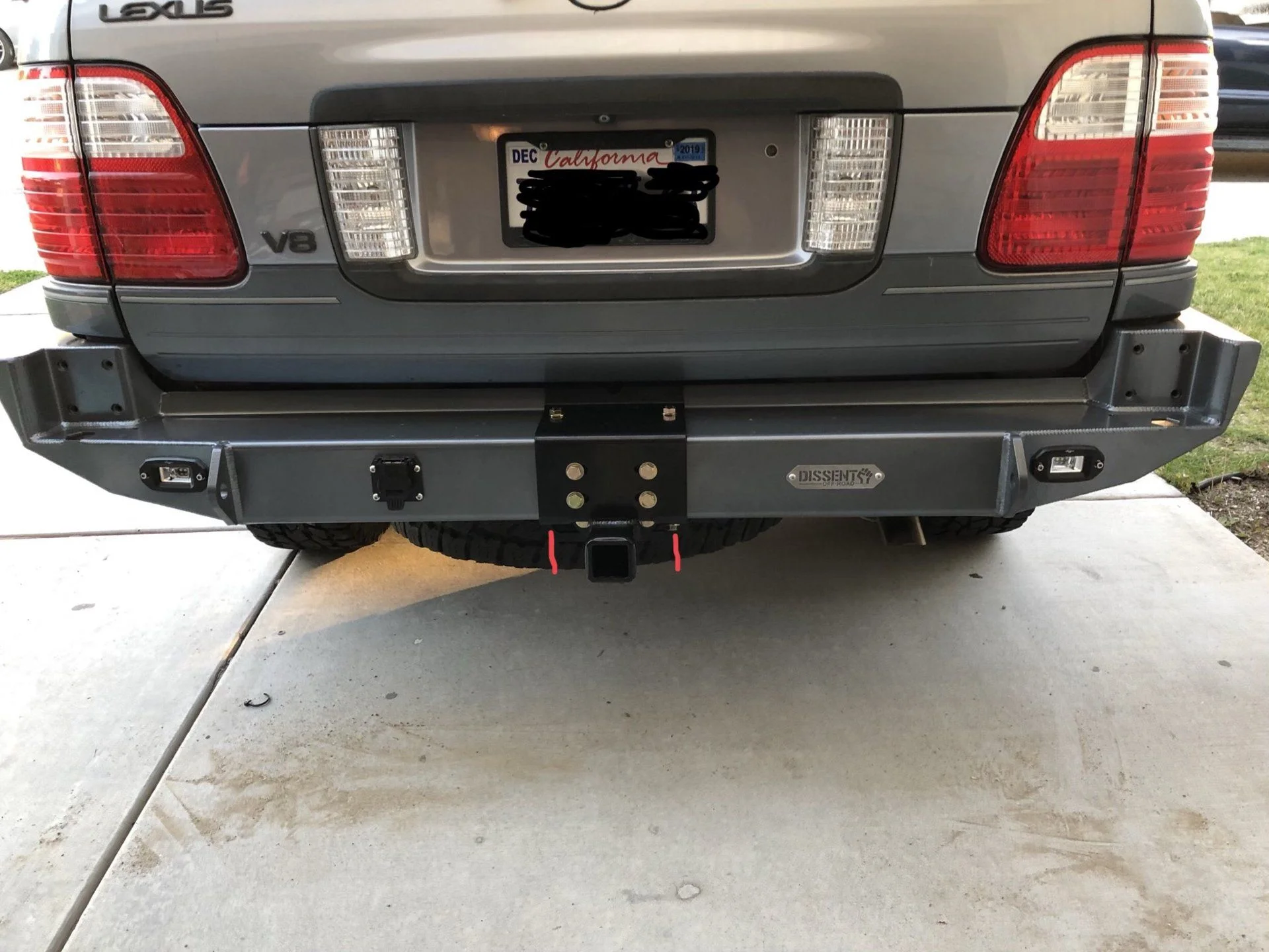

well got it on. Didn’t finish wiring. A little bit difficult to adjust because the wings are fairly heavy. It’s more of a two piece bumper with the blk piece attaching both pieces together and to the cross member. Aligning everything required me to wrestle the pieces to get the bolts threaded to where the factory hitch goes. There are two bolts (marked in red in the photo) that are difficult because of clearance to the cross member. I can’t get one on. Need a tap&die kit handy. Pretty sure I got a bolt kit for swing outs too, otherwise I have a lot of extra bolts.

Is it noticeably more clearance off the ground compared to the stock bumper or no? Pic is deceiving

Definitely MORE ground clearance. Significantly more pronounced at the wings where the stock bumper does not sweep upwards at all.

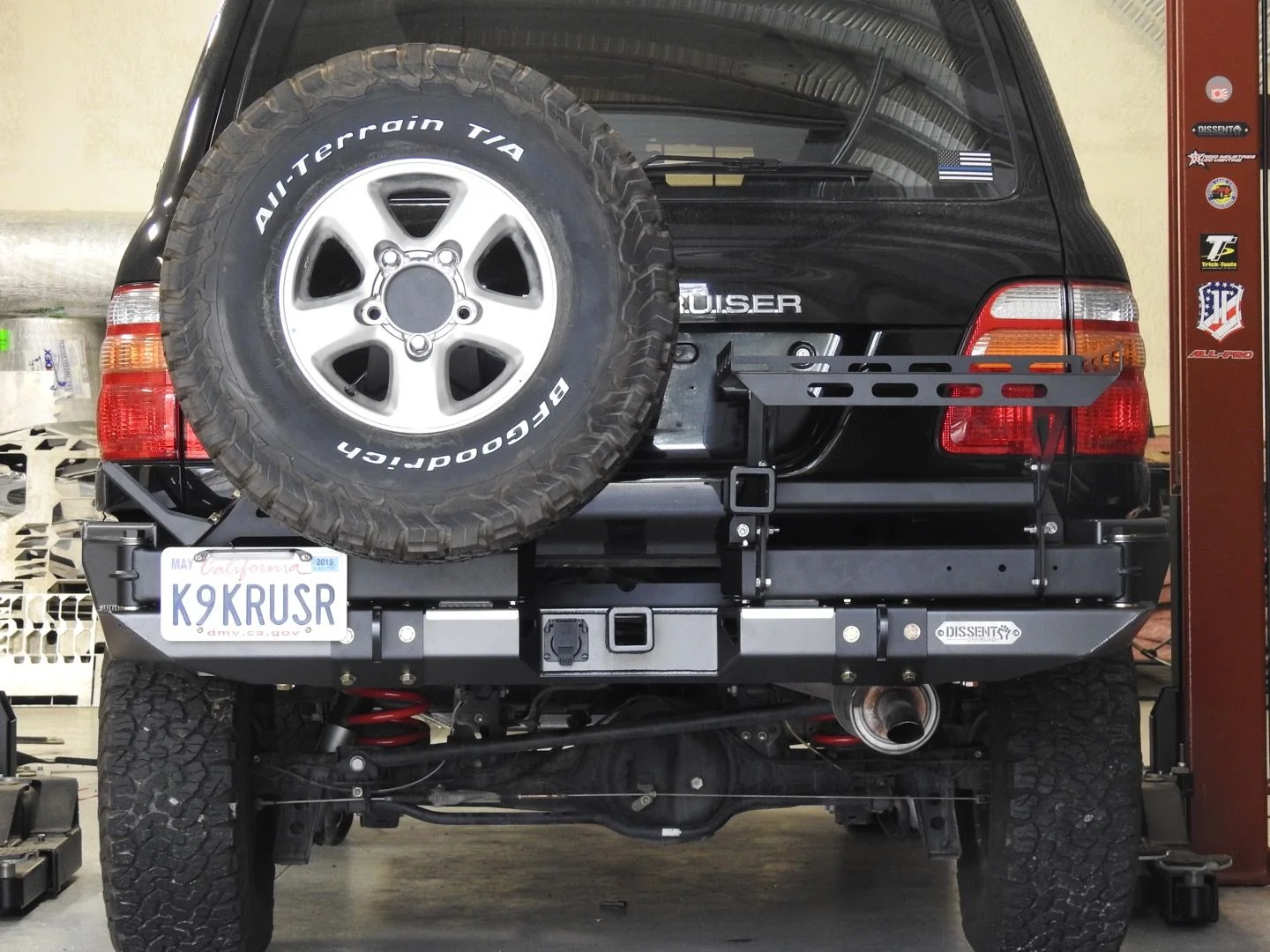

Ben (Dissent) has fabbed up receivers into the swingarms for others. Makes a great way to mount racks. Check out his site gallery and you'll see photos
