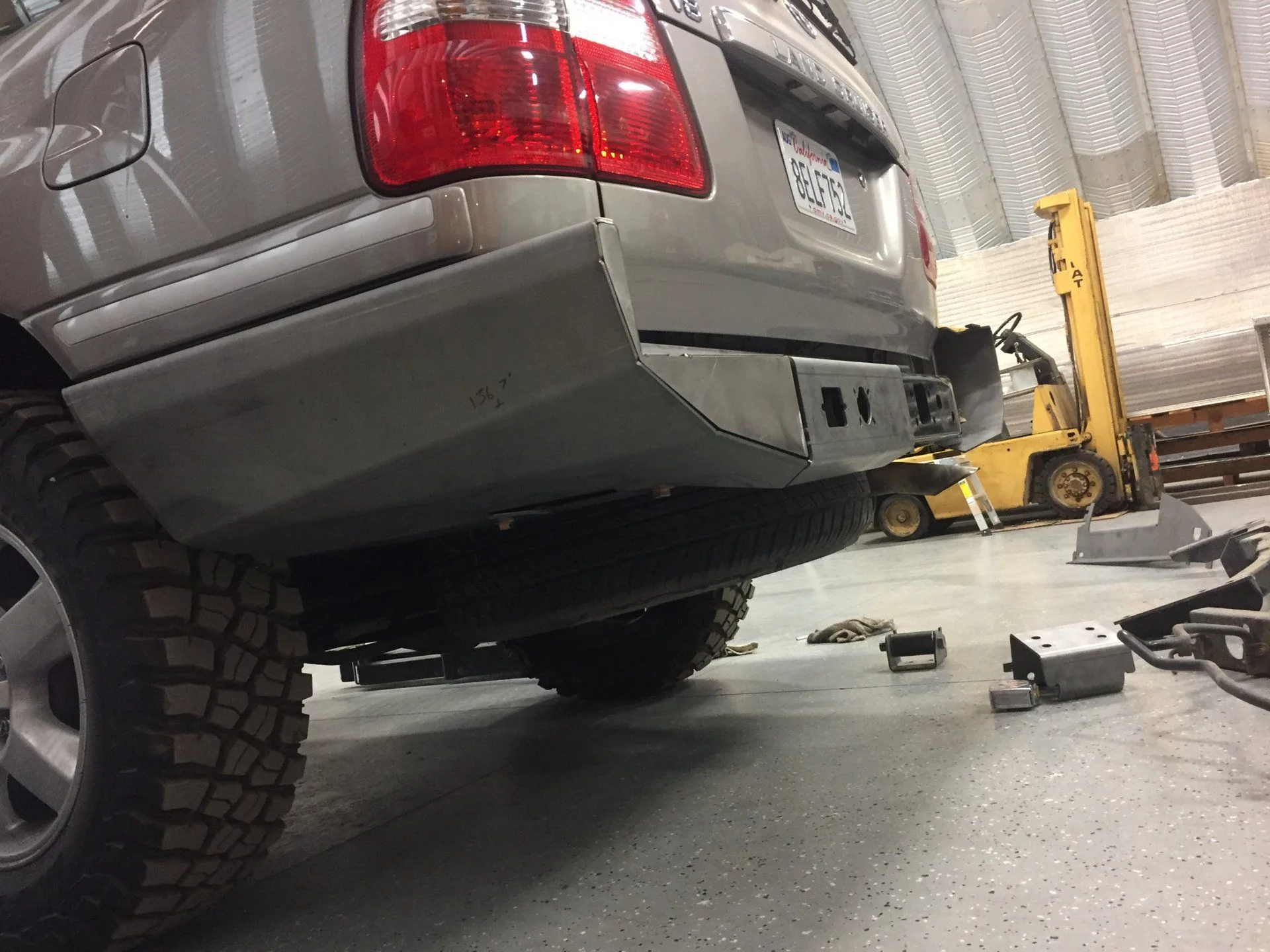

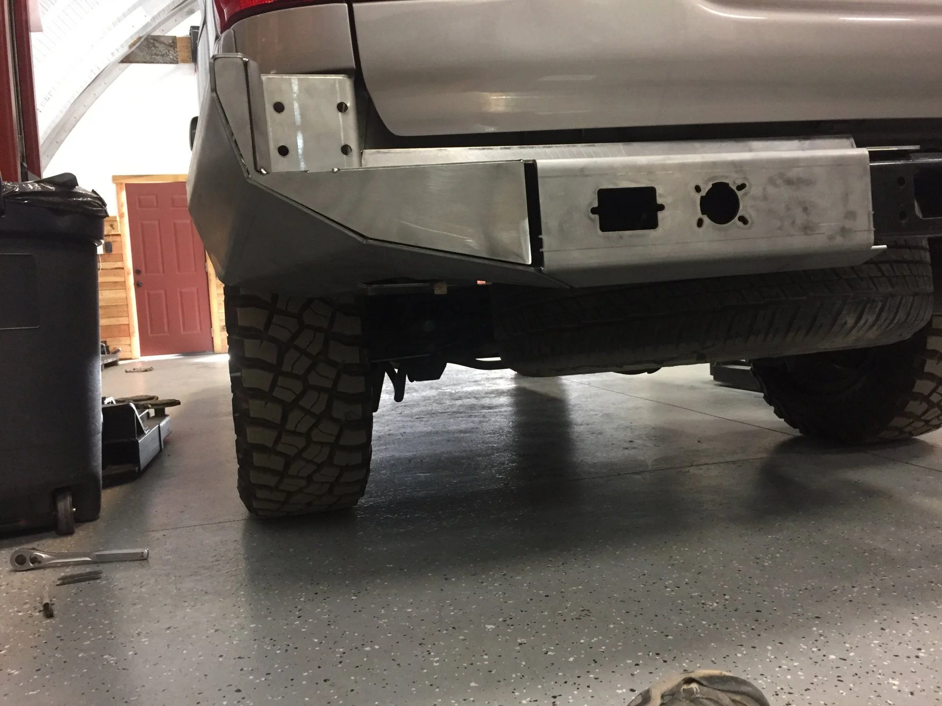

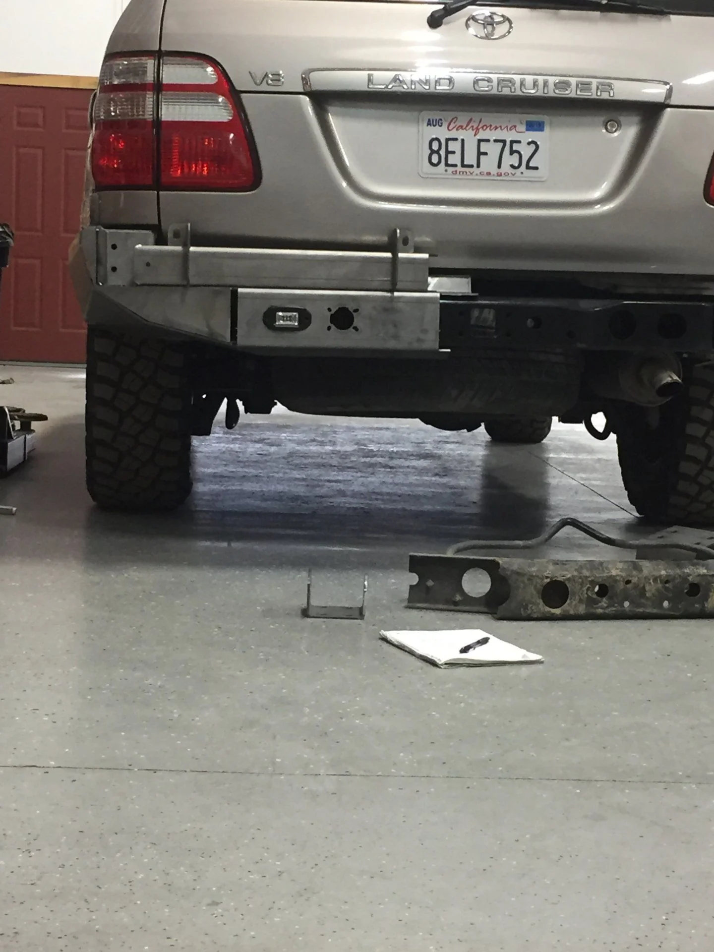

Hey guys. Wanted to see how you guys would feel about a no cut version of my rear bumper?

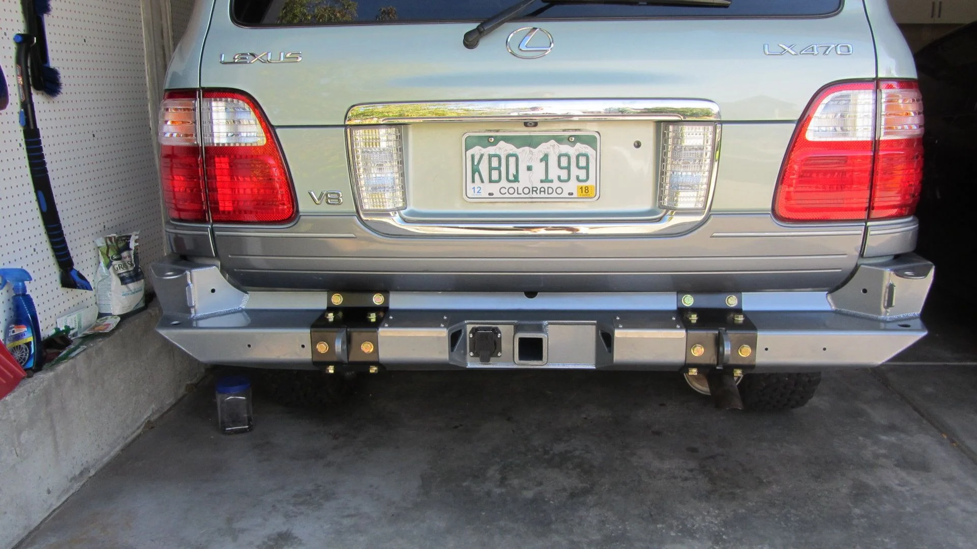

May end up replacing my current version with this one.
What we are looking at is a 100% bolt on bumper, high clearance, (about 1" lower than the current version on the center only) slam style swingouts with a new heavy duty latch design, run with or without swing outs, tire will still fit underneath, included backup lights and trailer plug, still semi modular allowing proper adjustments, high and mid clearance tow hitch, (depending on towing needs) all this for a target price of $2200-2400 for dual swing outs!

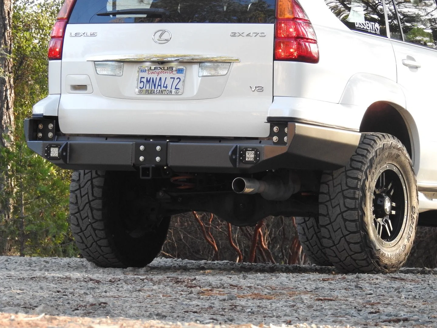

The gx470 bumper got me thinking so decided to give it a go and am extremely happy with the lines we were able to achieve building around the crossmember. Here is a sneak peek, more to come.
Finished product will look a lot like the gx bumper
very interested. How robust would the hitch be compared with the current version?

Looks awesome Ben. You probably already know this, but trucks without the integrated hitch don't have the hitch cutout in the rear crossmember. Might make it challenging to have an hitch without going below the crossmember. I suspect you'll find an elegant solution though
Edit. Just noticed where you put it on the GX. Looks great!

Yes, the hitch is a little tricky. A high clearance hitch would require a notch in the crossmember which will compromise the strength so an additional crossmember may be needed for a high clearance version. I have actually really grown to like having the hitch hanging a little lower as it's the first thing to hit, you know what your hitting and you know it's not going to hurt anything.
That being said, even if the receiver is on the bottom of the bumper it will have a better departure than the most popular competitors. The competitors stick out 4-6" at least from the crossmember allowing a hitch to be raised into the bumper, this gives the appearance of high clearance but the added length takes from the overall departure. This bumper bolts up flush with the crossmember so what is lost in clearance is gained back due to the short length.
