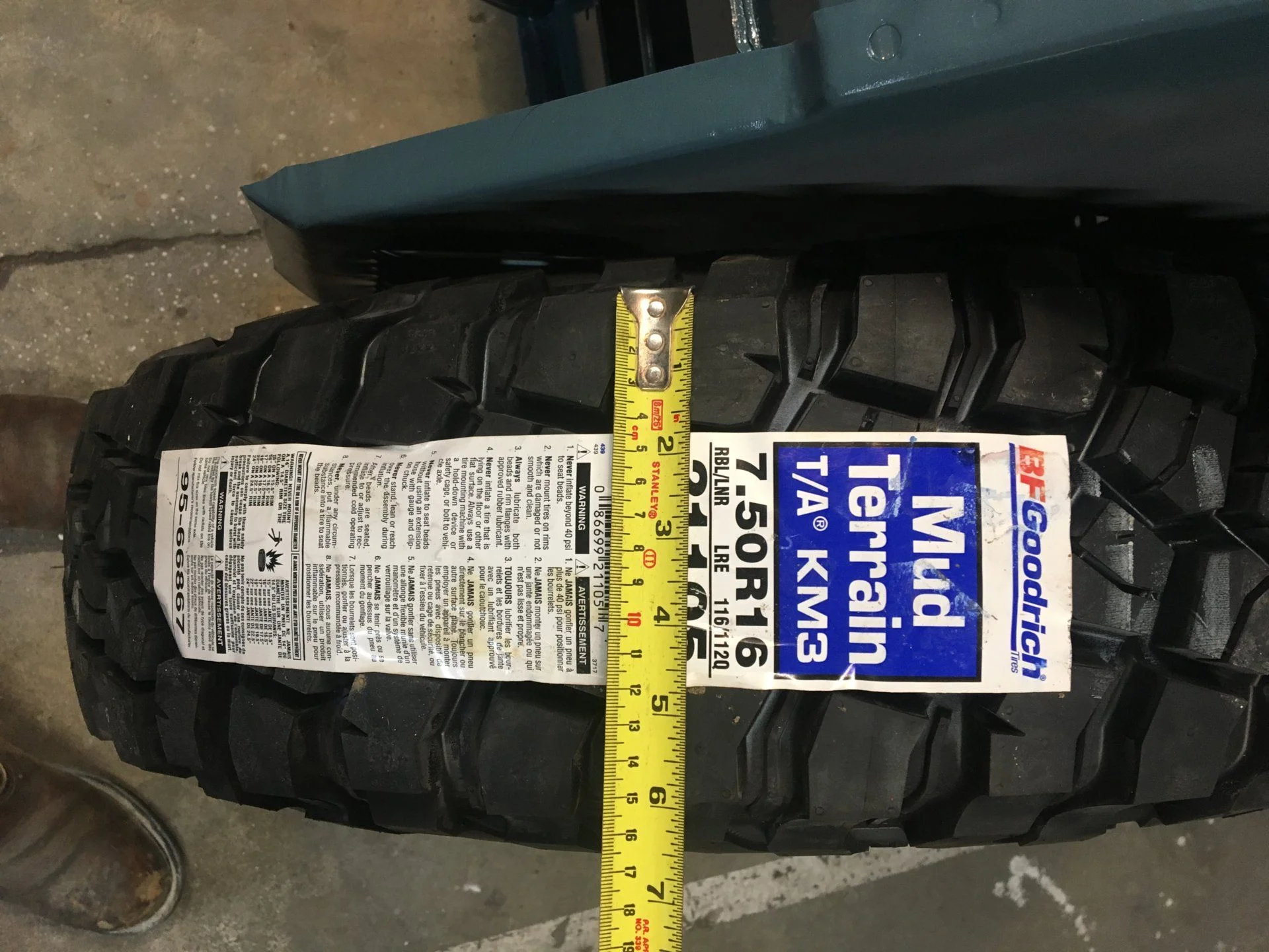

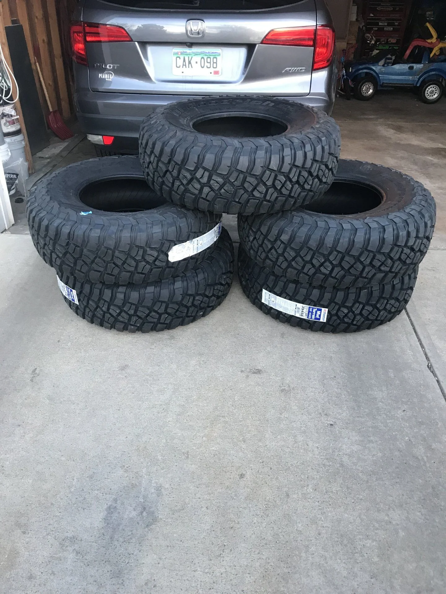

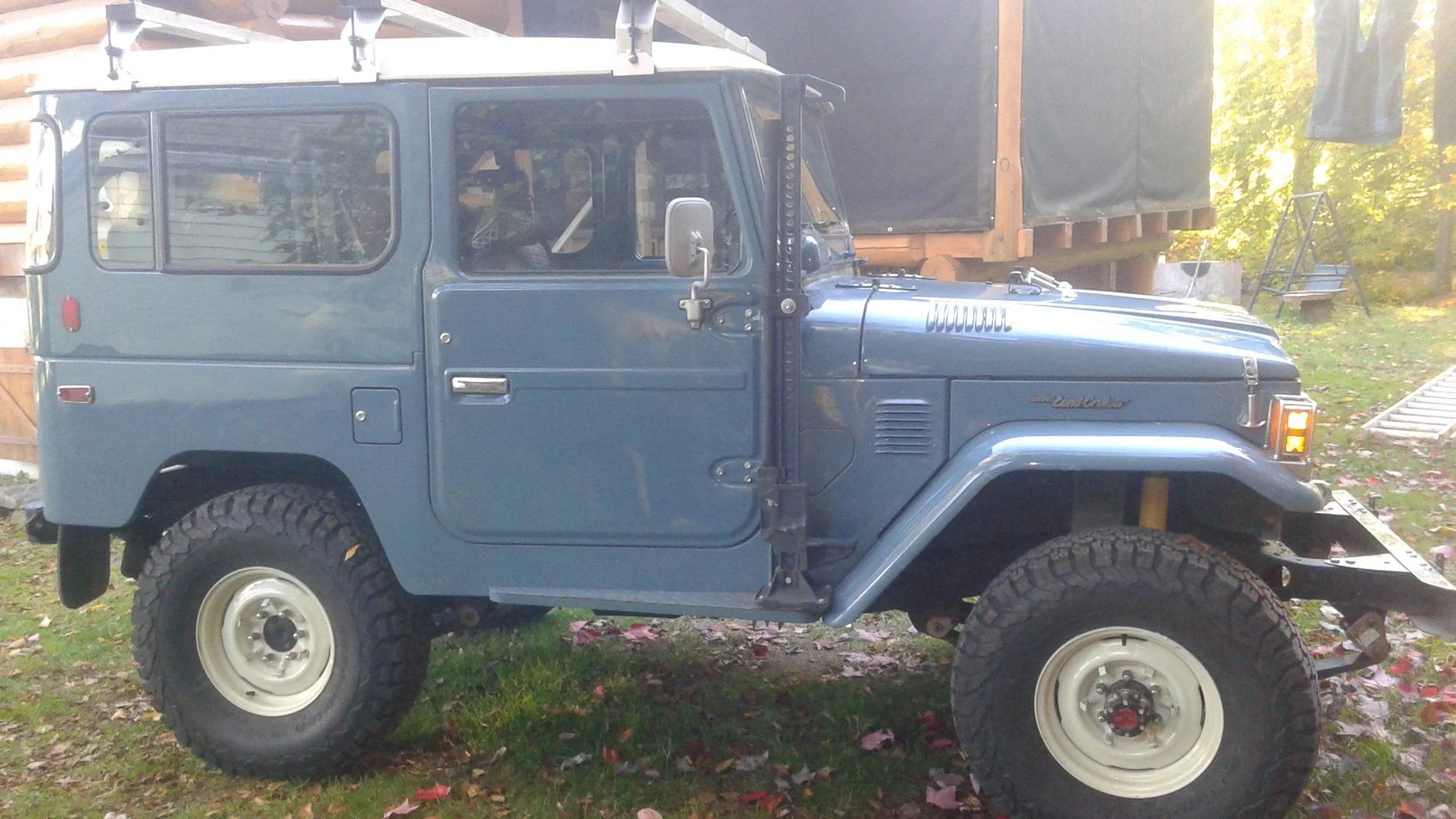

Mine just got delivered yesterday.
1897894
1897895

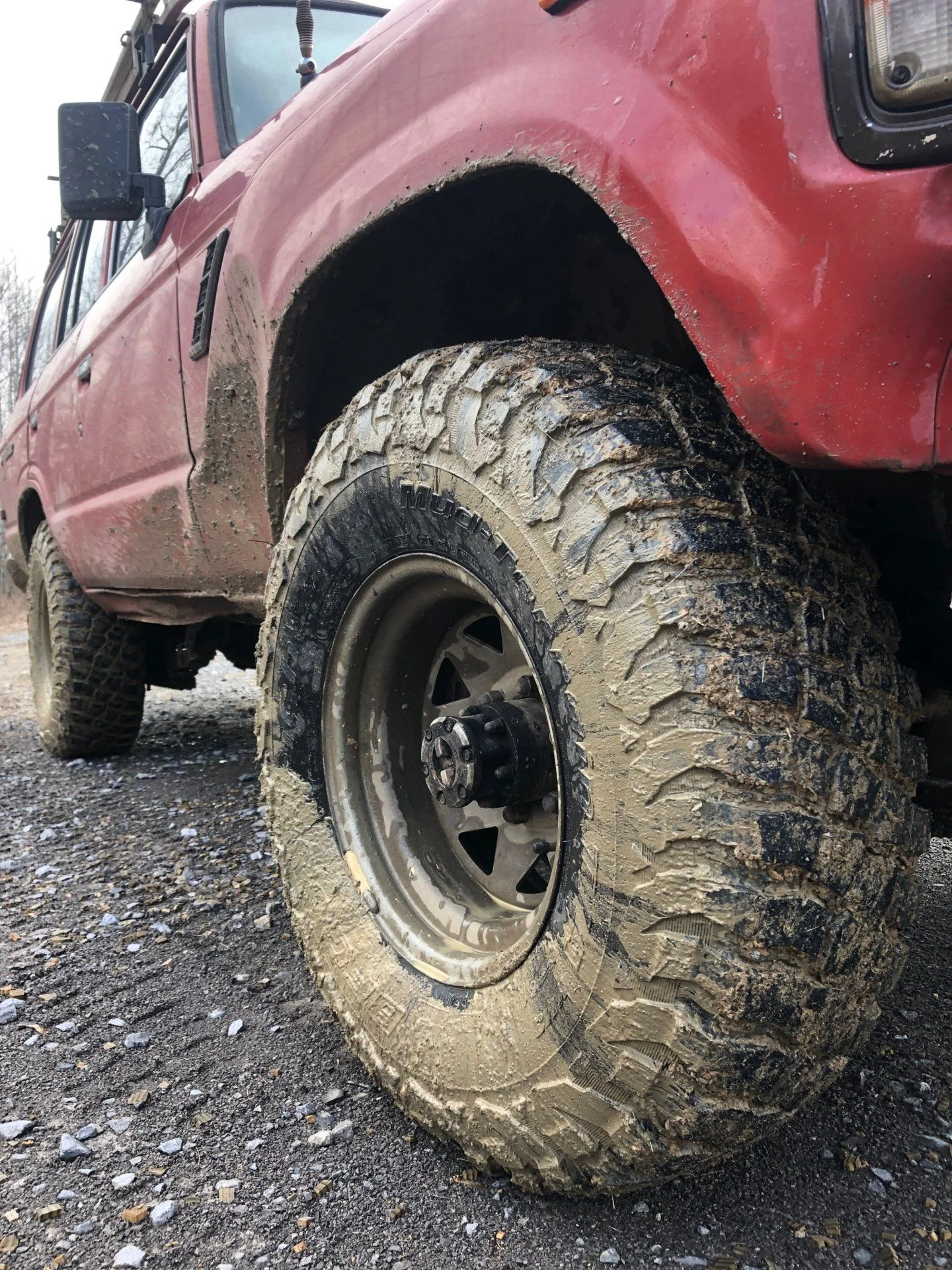

Been running a set of 33x10.5x15s since August, have about 8k miles on them and have been pleased with the mud performance. I've been in stuff that would have stopped KOs. Highway noise is noticeable but not excessive and you can feel the rolling of the lugs at times. Haven't measured tread depth but the tires seem to be wearing well. Thanks to @wct49 for setting me up with the tires.
1901104
Have you had a chance to get them mounted yet? I am looking at the same size and curious what they actually measure out to.
no not yet. life has been busy, and i've been doing other random modifications and upgrades. soon though

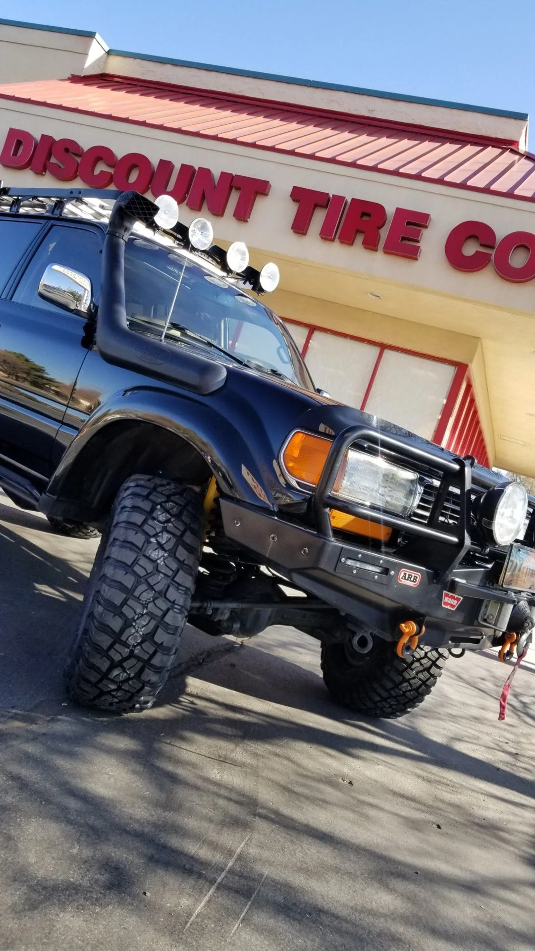

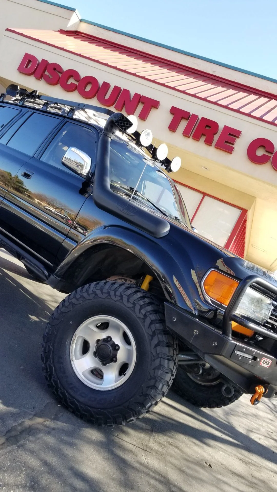

I'm a little on the fence with these new KM3's for me.
Purchased a set of 315/75 16's for the 80 series a week or so ago. They replaced my BFG KM's of many years in the same size. I thought I was imagining things after install, but they didn't seem as tall as the KM's and the tread depth was less than the original KM's (18/32 v 20/32, I still have a brand new KM as a spare so I had a reference). Not sure if it was just tread appearance on the height and width or actual #'s, but according to some specs they are just a touch shorter than the original KM's and the KM2's. (34.6 vs 34.8).
They are a very smooth tire, I will say that. Granted my old KM's were a tad old (15 years), I am sure they were as crusty as I am.
My biggest complaint right now, which is actually pretty substantial for me, is their weight. Anyone with an non-geared 80 Series knows we need all the help we can get. I have always been "okay" with the KM's regarding power and feel. The new KM3's are significantly heavier (as they should be since they are a "E" rated tire versus the KM/KM2 "D" rated tires). I am seeing (depending on the spec sheet I find), they are anywhere from 7 to 9 lbs heavier per corner and boy do I feel it and to be frank, not really digging it. I've only driven about 50 miles on them so far and I am pondering taking Discount Tire up on their "if you're not happy - bring em back" policy and seeing if they can get me the KM2's which I see are still floating around at a few places. It's kind of a shame, as I am sure the compound is a bit improved with the 3's over the 2's (at least so I think), they seemed to perform really well in a snow storm some days ago, but I am not sure I can deal with the extra weight/rotational mass hit of these E loads. I haven't needed to re-gear for 15 years, I'd rather not now.
My .02.
Are those tire diameters actual measurements you made or are they listed specs? Also what springs/lift do you have on your 80?
Nice looking truck by the way.

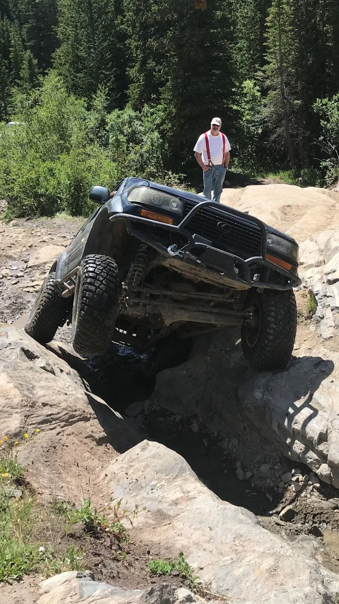

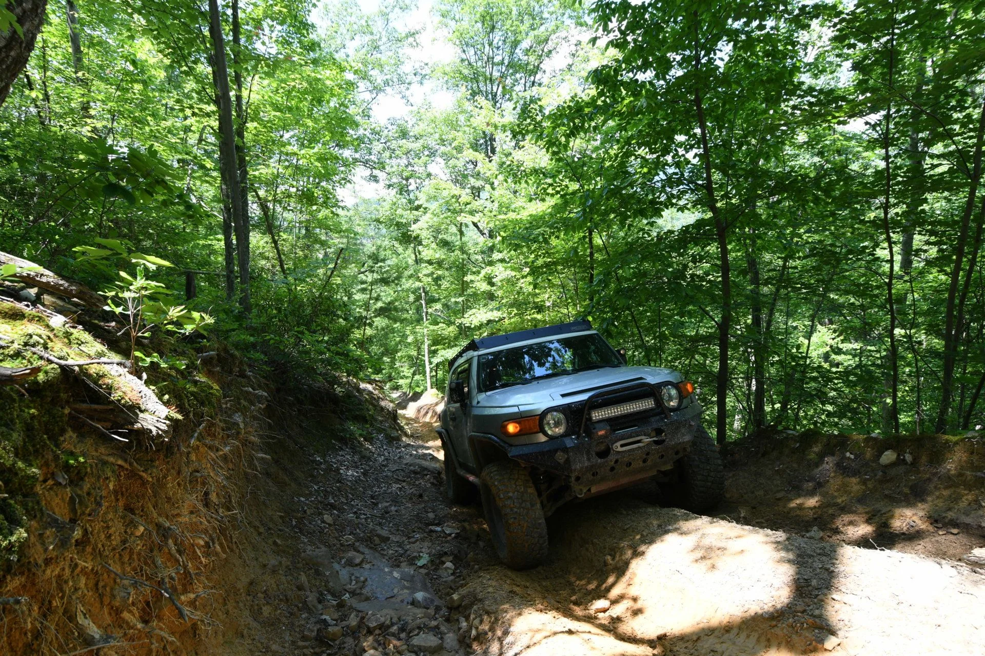

Just got back from GSMTR and it was the first real "east coast wheeling" I've done since the KM3s were installed. They performed beautifully! The first day I didn't air down, running 35 psi. Second day I went down to 22psi just to smooth out the ride. I usually leave A-Trac on when I'm wheeling, but this time I left it off and those tires pulled me up some really fun stuff. Overall this weekend, I used A-Trac in two places and my front/rear locker once when recovering someone who lost 4wd.
This pic was going up the ass end of Walden's Ridge (Trail 75) at Windrock.
Been really happy w/ mine since mounting.

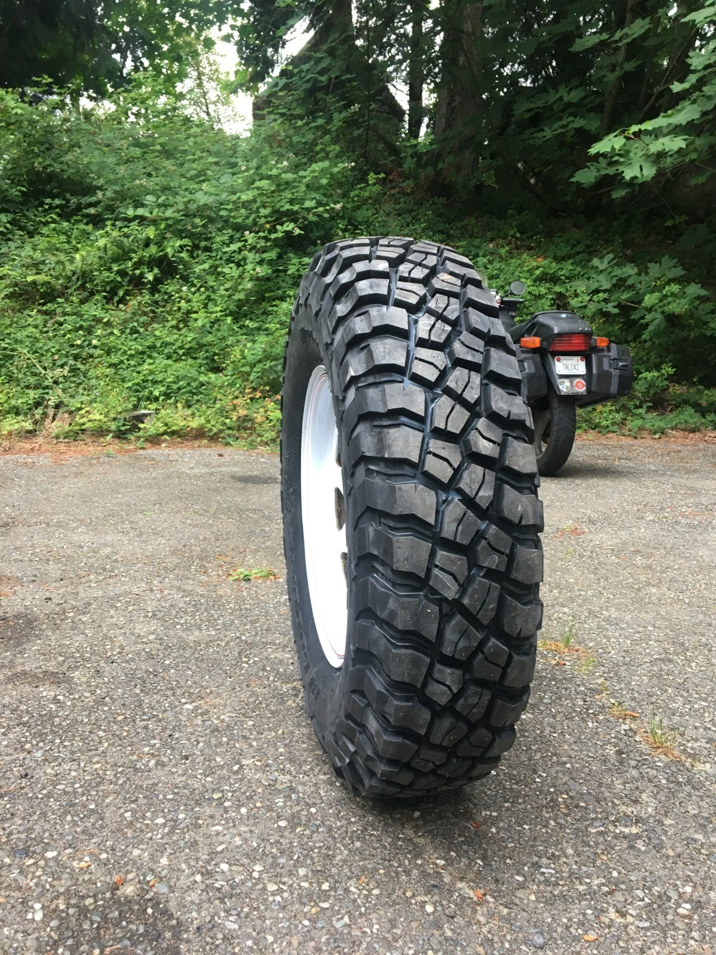

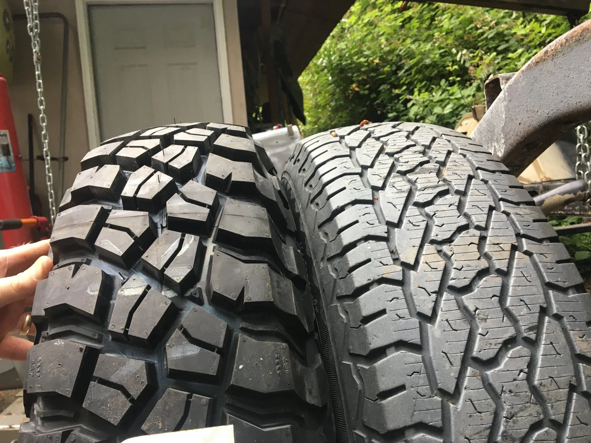

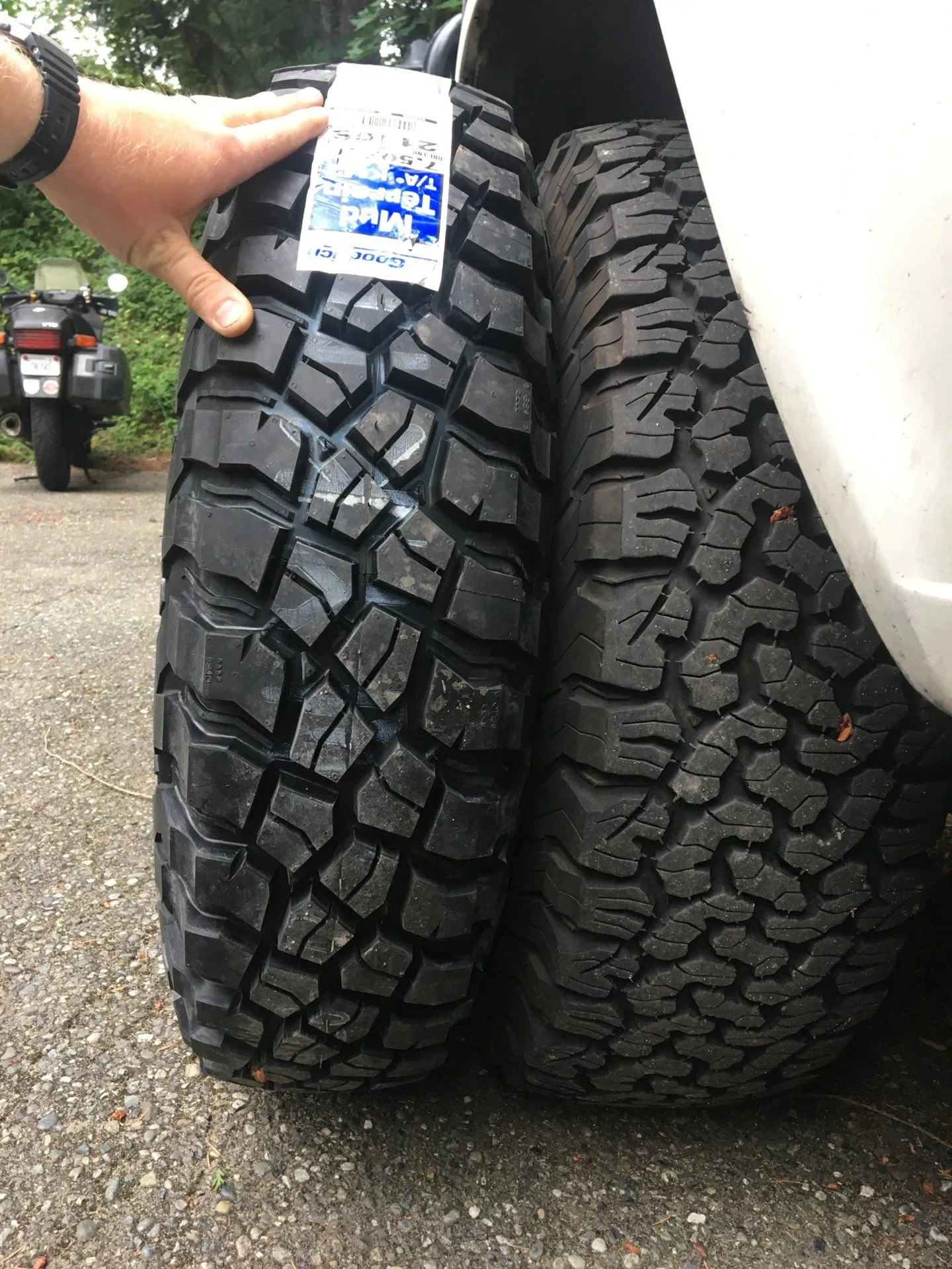

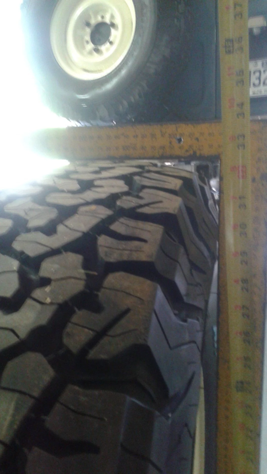

In reference to the 7.50R16...

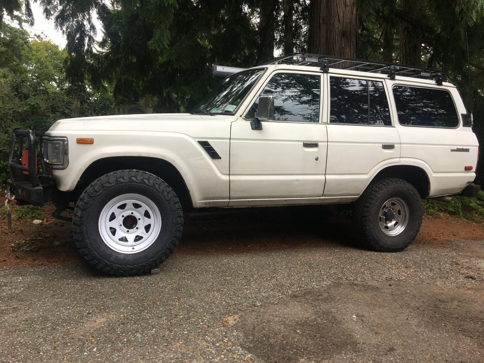

View attachment 1732870 Ok... I couldn’t wait - they arrived quick and I mounted one up on a 6” wheel. The picture makes it look fatter than it is.
View attachment 1732864 View attachment 1732866
Next to a 235/85R16 also on a 16x6 wheel.
Next to 33x10.50 on stock FJ62 wheel. (The AT is obviously loaded - but I think they would be pretty dang close in height both standing free).
I might just have to go back to white wagon wheels on the ‘62! :grinpimp:
The first picture is mounted on a 6" wheel? Manufacturer and part number?
I bought some OEM Toyota clips with the screws and all from Venezuela for $150 shipped for 5 wheels.
So did you buy 16” non-splits from Canada and clips/ screws from Venezuela? How did you source the screws and clip? Sorry, having trouble following. Seems like you’re starting to get in the price range of the 16” Steelies from Japan. Plus they are now coming in gray.
