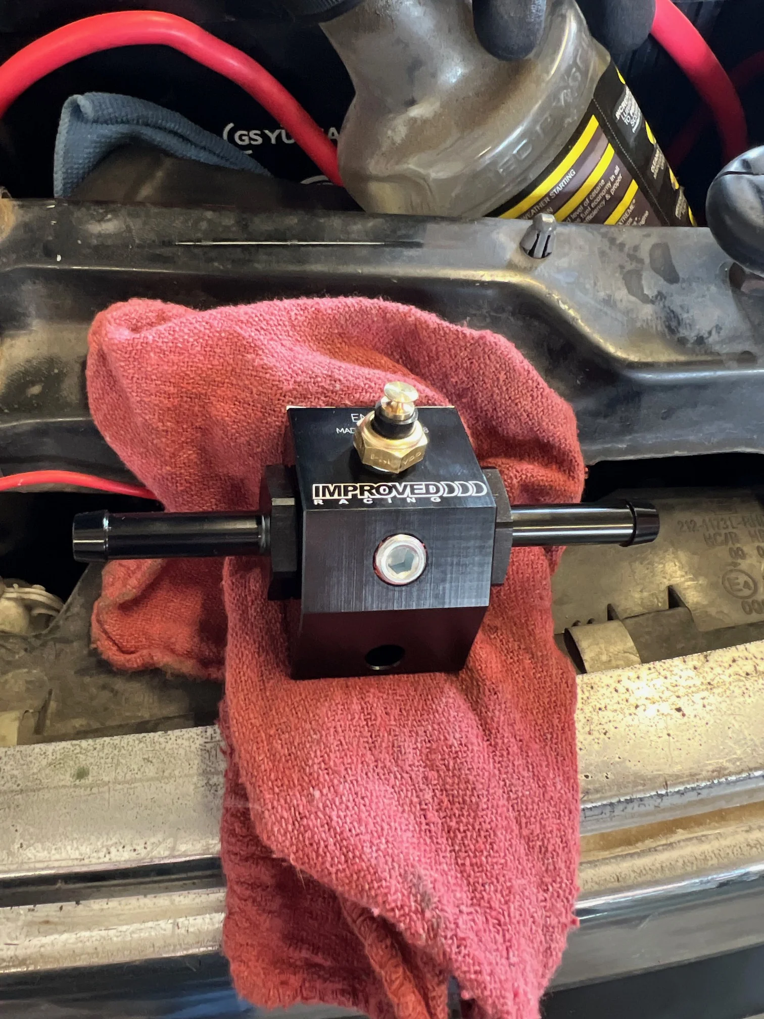

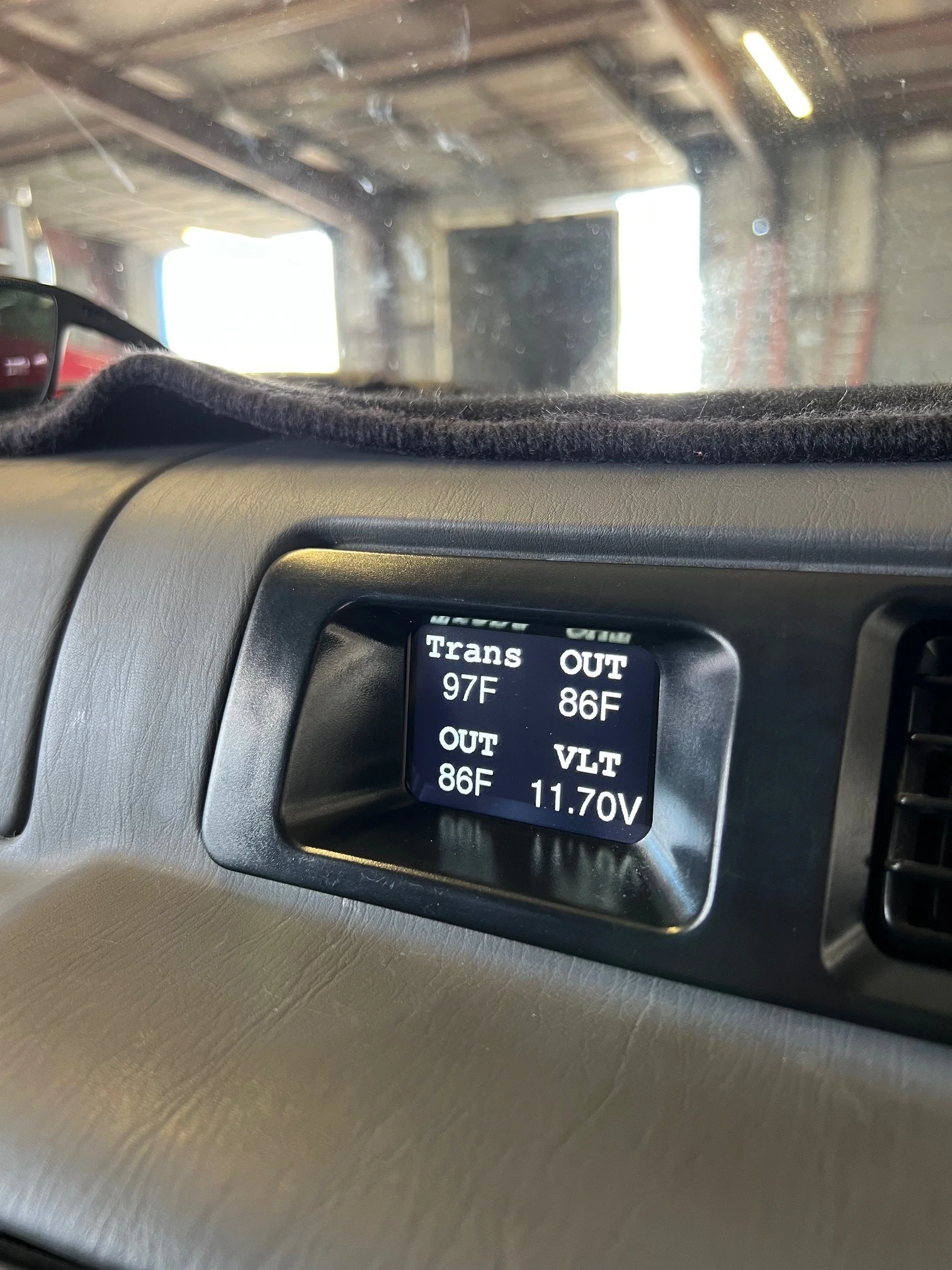

Finally got around to ordering this for my '96 HDJ81.
Been meaning to get some real numbers on my trans temp as well as the other so I ordered a few of the sensor kits too EGT, Boost, Oil PSI (installing later)
Not sure if all JDM cruiser don't come with a trans cooler (other than being routed thru the radiator) but mine did not.
Ordered a Hayden 689 cooler and mounted it up front.

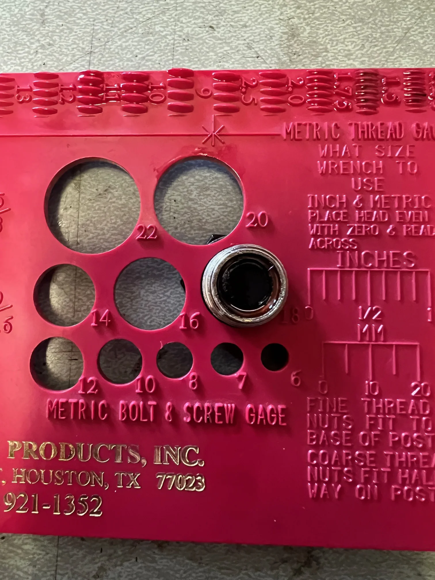

The only issue I ran into was the trans temp sensor was too small as my drain plug is 18mm.
Found a sensor block from Improved Racing and ordered that with 3/8 fittings. #ENV-151
Also ordered another VDO sensor with 1/8 NPT (#323-050)
Deff what I've been looking for as far as gauges go and we'll see how cool my trans is from here.
Thanks LutzAuto!
