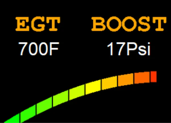

Another request and follow-up question:
1. [Feature Request] One decimal place on Boost Pressure would be nice if it's possible to fit (currently shows whole number only). Shrinking the font size on unit (psi) could provide more space.

1. I will look into this and potentially add it with the request above.

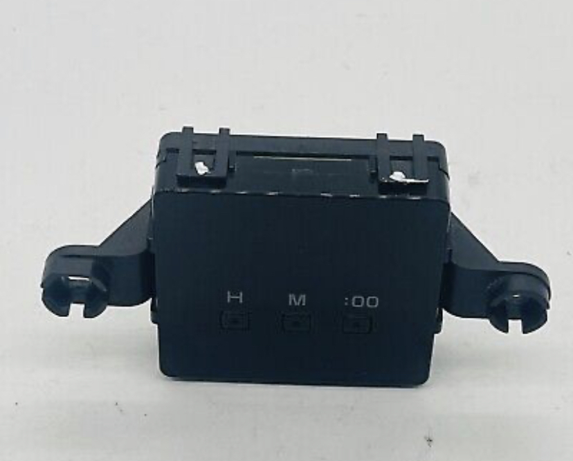

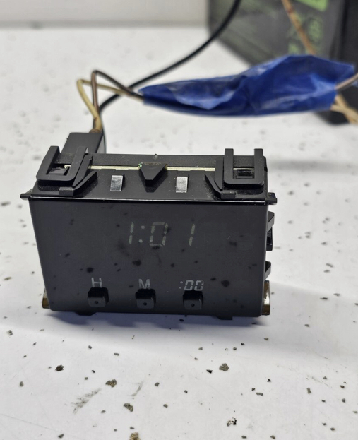

@Lutz Auto any thought on adapting this product for use on 3rd gen 4Runners? I haven’t compared them side to side, but they have a very similar clock to the 95+ 80 series and are prone to failure. Seems like it could be a very popular item. I know I would buy one.
80 series clock:
3rd gen 4runner:

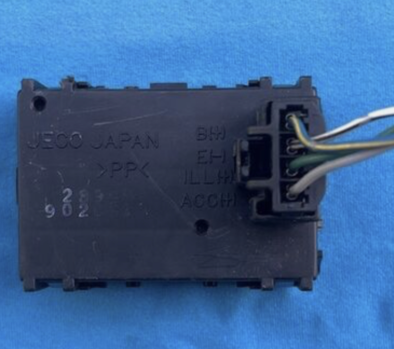

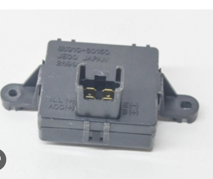

Are you still planning on a product for the earlier model dash clock? My clock just died
This is something that I have wanted to do, but am not sure when I will have time to revisit it. Finding a good touch screen the correct size is the challenge.
