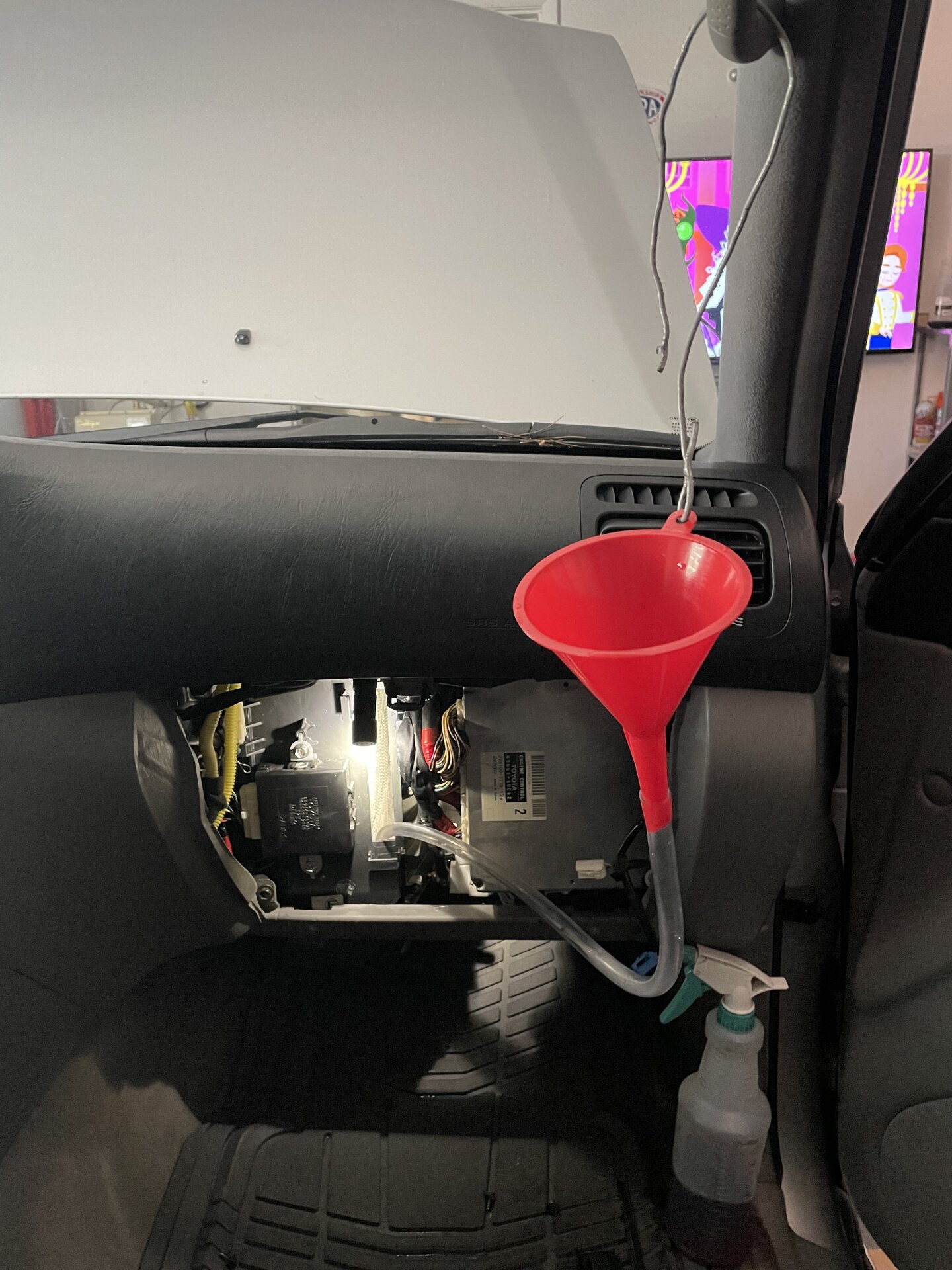

Here are some photos when I did mine:
Remove the glove box door, use a funnel and hose to redirect water flow (best to use hot water to easily loosen up compounded dirt and deposits:
I also used an all purpose cleaner and spray bottle to help wash down the dirt.
I also used a toothbrush to clean the fins of those stubborn dirt sticking, with an aerospace level type of extension- a skewer.
Before / During / After:
Collected dirt and water clarity indicator to let me know if I need to keep on going.
As you can see I also extended the drain plug using a hose (I think this is 3/8 ID hose - not sure) so the dripping liquid doesn’t hit the frame and build corrosion in that area)

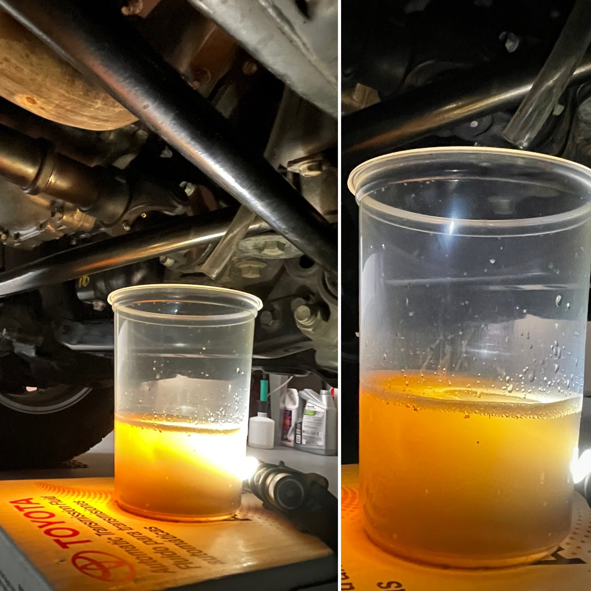

Well. What does this mean? Orange sediment like film inside the heater core and probably my whole cooling system. There was a lot of sediment and murky water that came out when I flushed the heater core.
Haven't tested if it fixed the heat yet though since I dropped a spring clamp in the cavity between the firewall and the engine and can’t pick one up until tomorrow. It literally disappeared somewhere in the engine bay near the firewall. I’m hoping it won’t find its way into a pulley or something and damage anything.

Still need to do a full coolant flush. After the heater core flush though I did get some heat function back. Not even close to OEM functioning heat but I can at least feel the heat now. Became less of a problem now that the weather is warming up
If this were my vehicle that I hoped to keep for some time, then I would do multiple drain/fill cycles until what's coming out is clean. Drain from the radiator and the block (easy with the right size tubing). Fill with distilled water in the beginning, and then switch to coolant when what's coming out looks clear. You might also want to use a coolant flush product at the beginning; although I have no personal experience with these, I have heard that they can help remove contaminants from coolant passages.

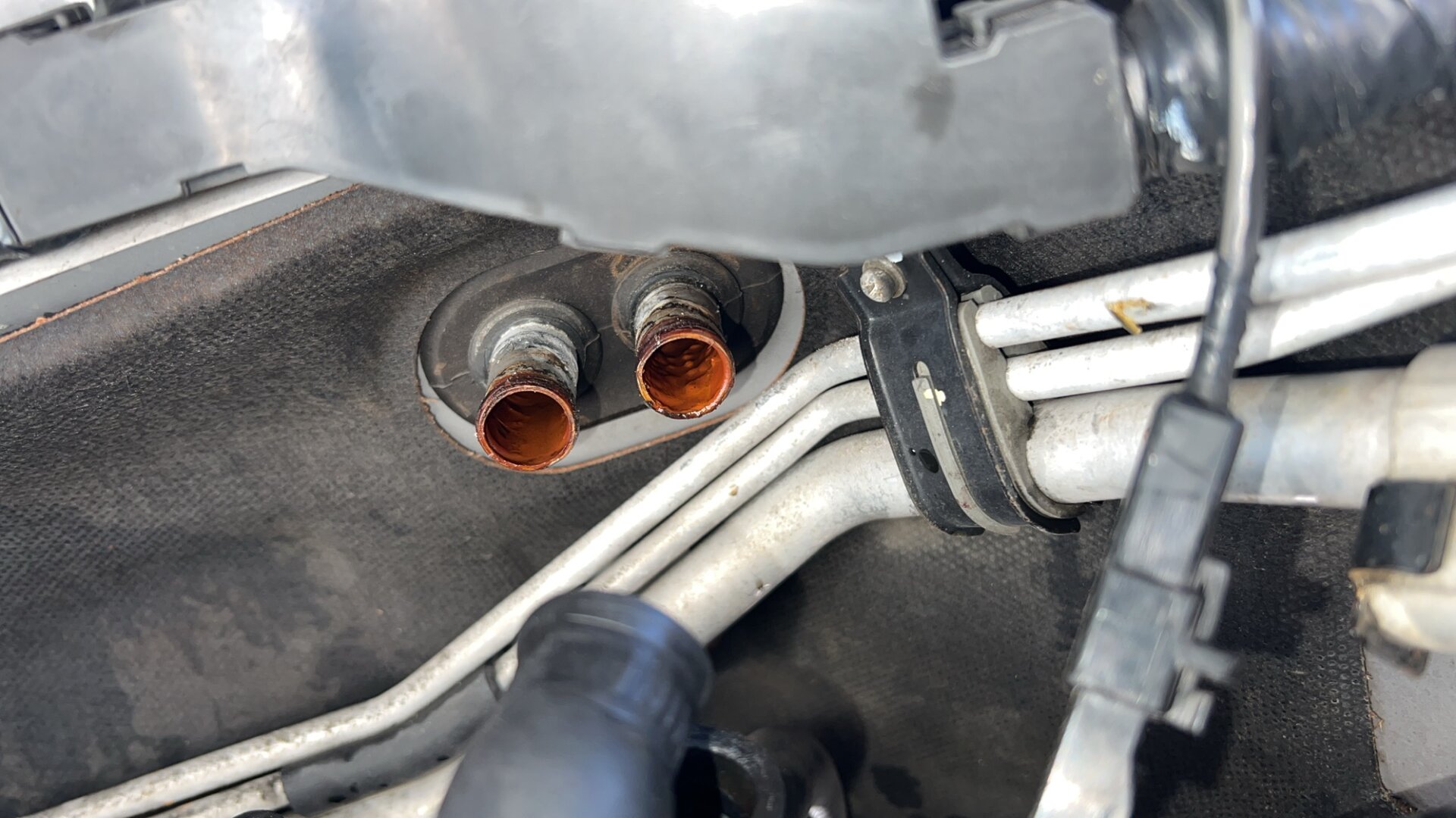

When you've drained everything and it's time for the final fill, I would change as many hoses as I could, and use OEM hoses/clamps. The one in the pic of the rusty heater core intake/outlet looks crushed from the use of a worm-gear clamp, and swollen as well. FWIW, these pics look like the "after" photos from a Reasons Not To Use Tap Water In Cooling Systems white paper.
