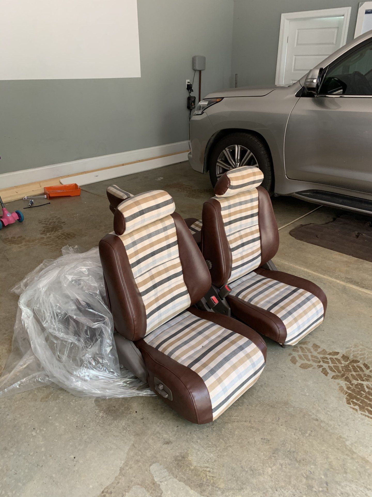

I got the seats home. Love how they turned out.
Mileage 289,543
I put the seats back in the 80. Couldn’t be happier. Almost have the interior back together. Waiting on the LHD shifter from Japan. Realized the one they had sent me was for a RHD when I went to install it. I may have to make @Roxx a deal on it.

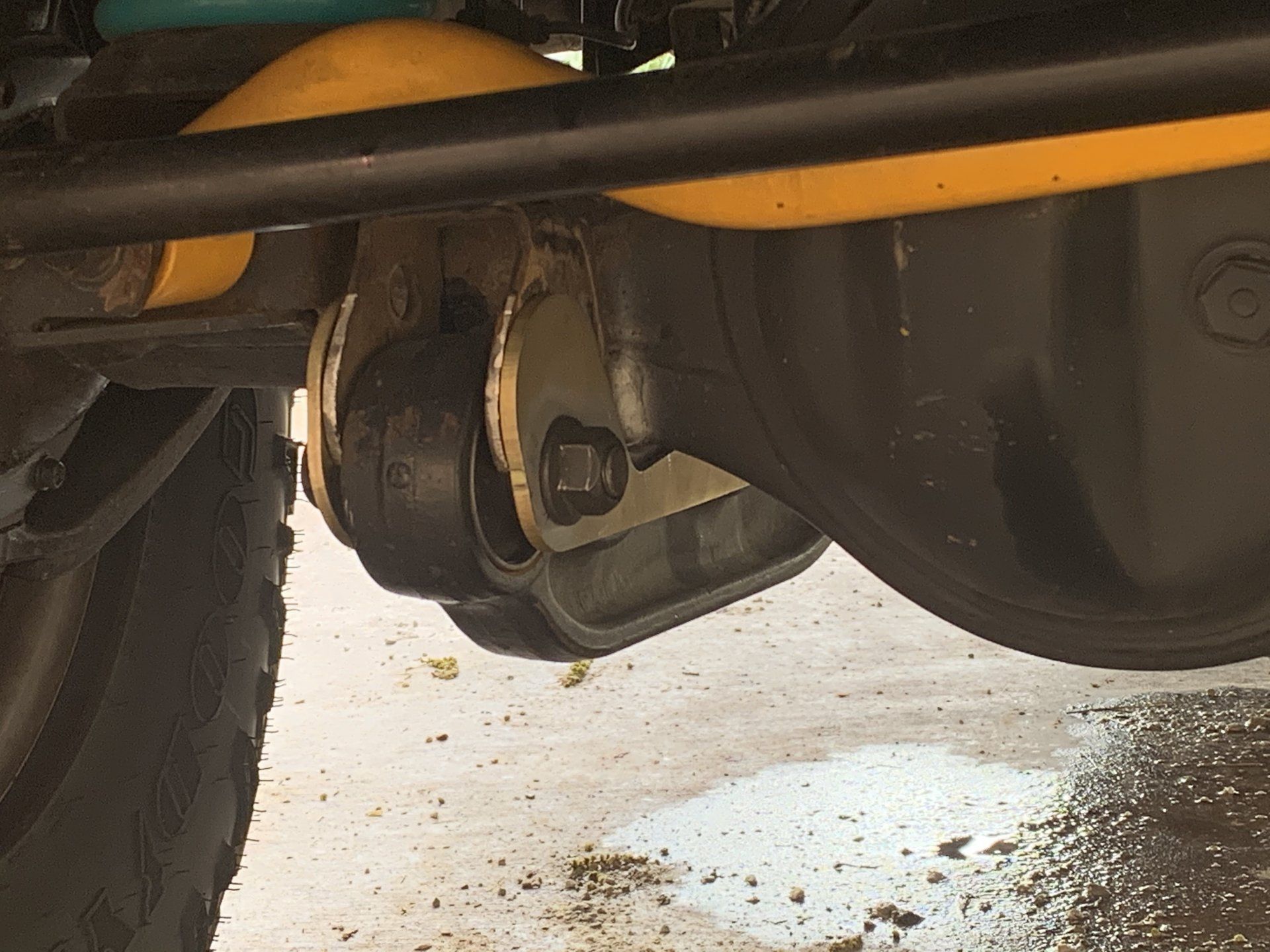

Finished up this afternoon installing the Landtank castor brackets. @roadstr6 called it. The brackets make a huge difference on the hwy. I took it on a short Test drive and could tell right away. Hope to weld them in tonight and drop off for an alignment in the morning

Finished up this afternoon installing the Landtank castor brackets. @roadstr6 called it. The brackets make a huge difference on the hwy. I took it on a short Test drive and could tell right away. Hope to weld them in tonight and drop off for an alignment in the morning View attachment 2296647View attachment 2296648
Fantastic! Glad it worked out.

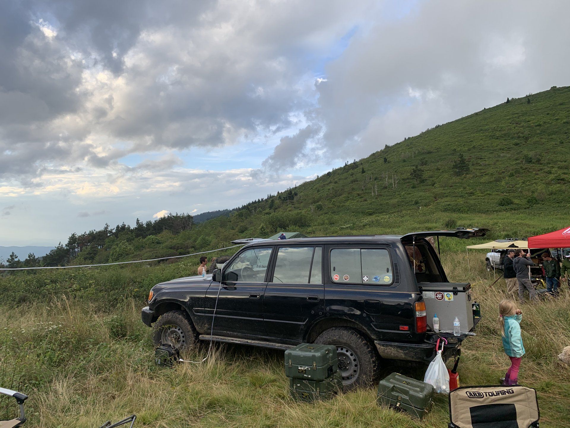

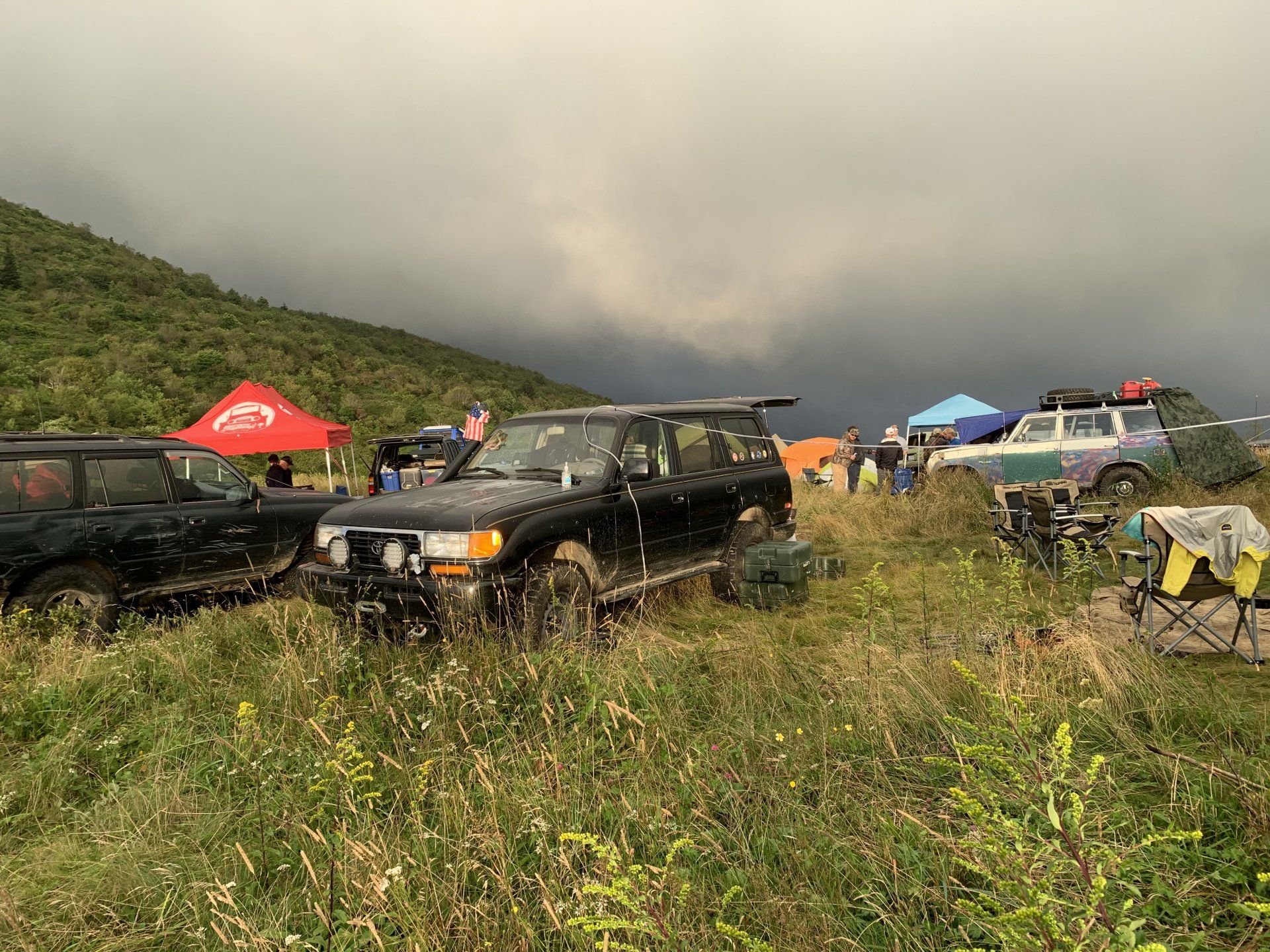

1200+ miles over the weekend for Hurricane creek with the Upstate Crew. The 80 tracked really nice down the highway and the only suprise was a loose Thule bar riser From the RTT bouncing on the trail

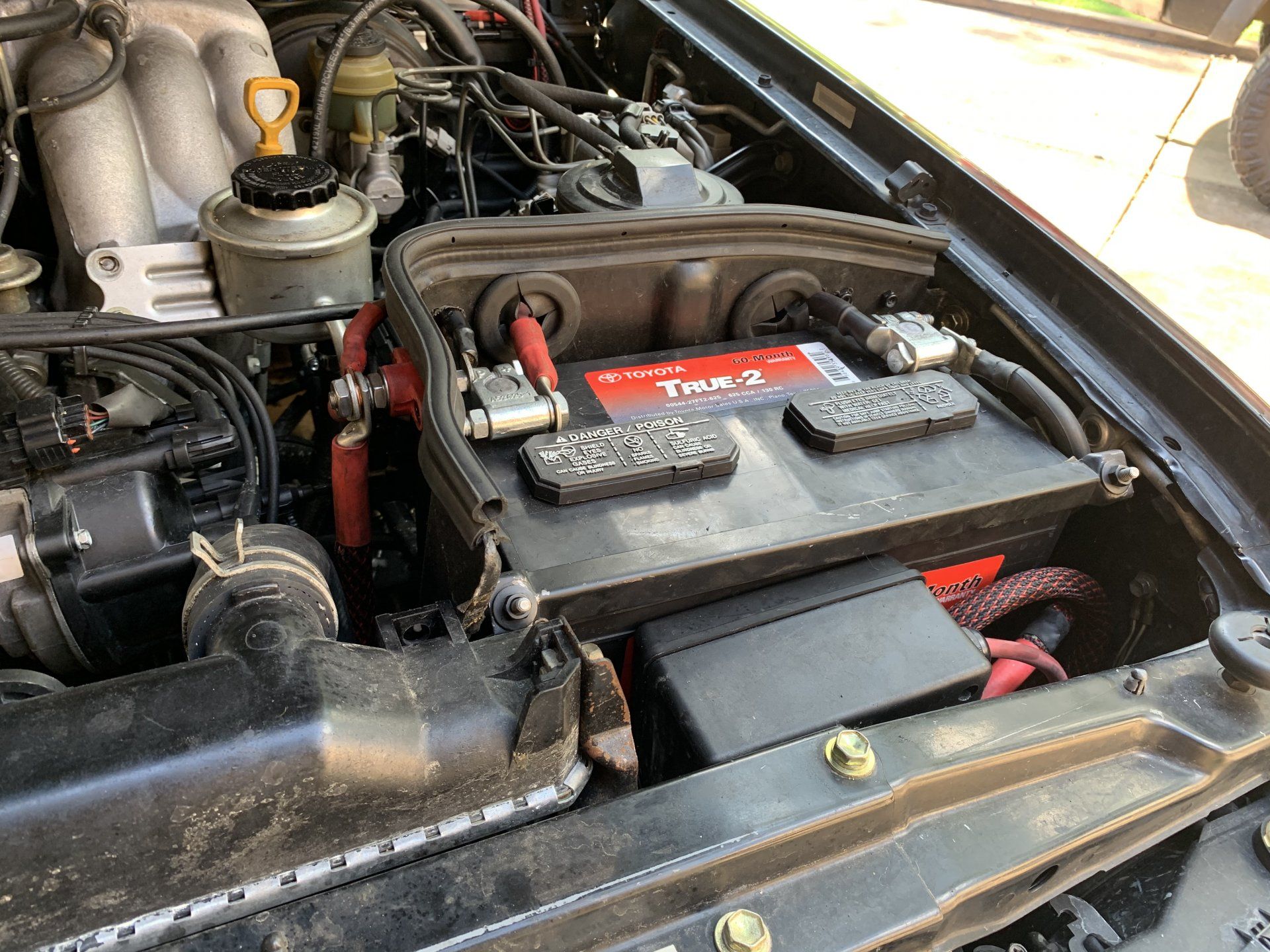

  • After running the fridge over night cranking seem sluggish. I’m going to change the battery. Not sure of its history so it’s time to go.

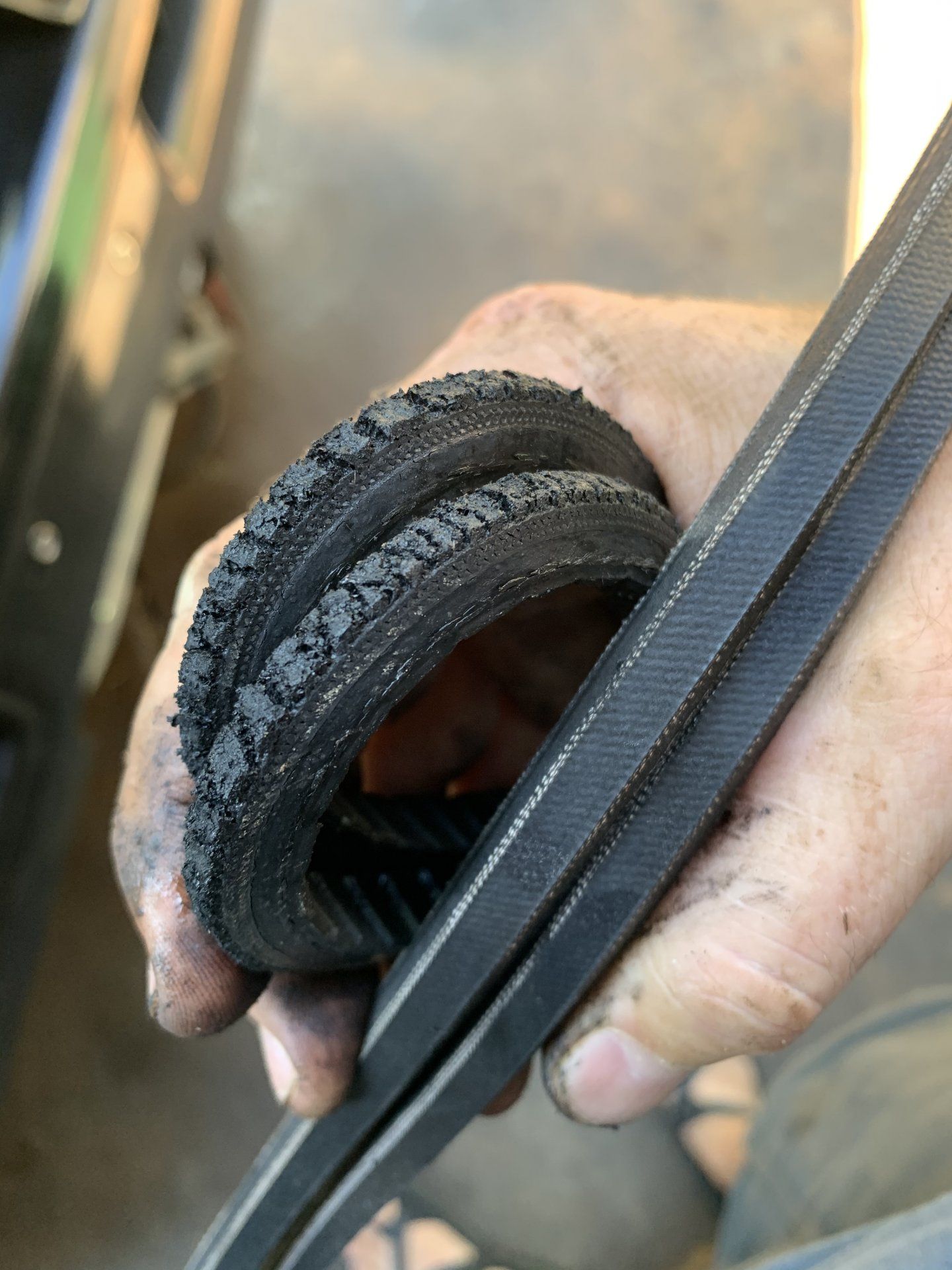

  • noticed oil on the steering stabilizer. Inspection confirmed it’s the distributor Oring.
    I replace it previously with a generic o ring. The oil has made the belts and upper radiator hose soft in spots. Will be Ordering belts, oring, and an upper hose fromToyota

Did some Maintenance last week before Over the Mountain with Upstate. After the last trip the Distributor O-ring was leaking. Oil leaked on the belts, slung it on the upper radiator hose and on the battery box. The oil ruined the belts, upper hose and the battery box.

Belts-
90916-02353-83
99332-10910-83
Compressor belt
90916-02353-83

while at Toyota I picked up a new battery And installed. Battery box has been ordered.

Drivers battery box to be replaced upon arrival.
