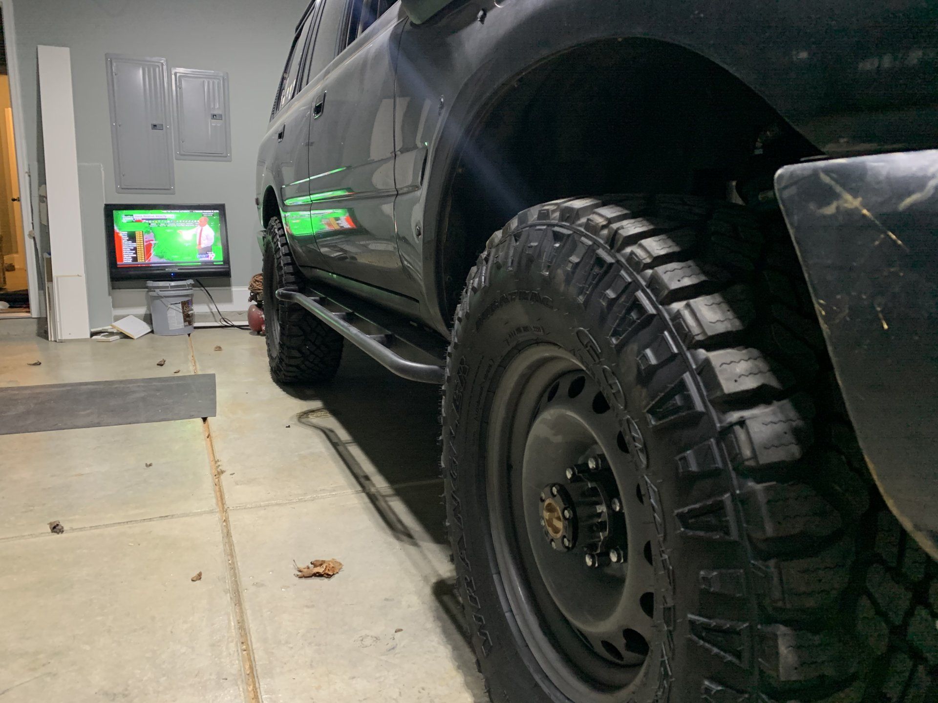

NC LX becomes NC LC
An ARB Front bumper would look perfect with that wheel and tire combo
I agree. I kept debating on which bumper to run.
When I bought tires I kept rembering what you said about swapping back to the 285’s vs 315s

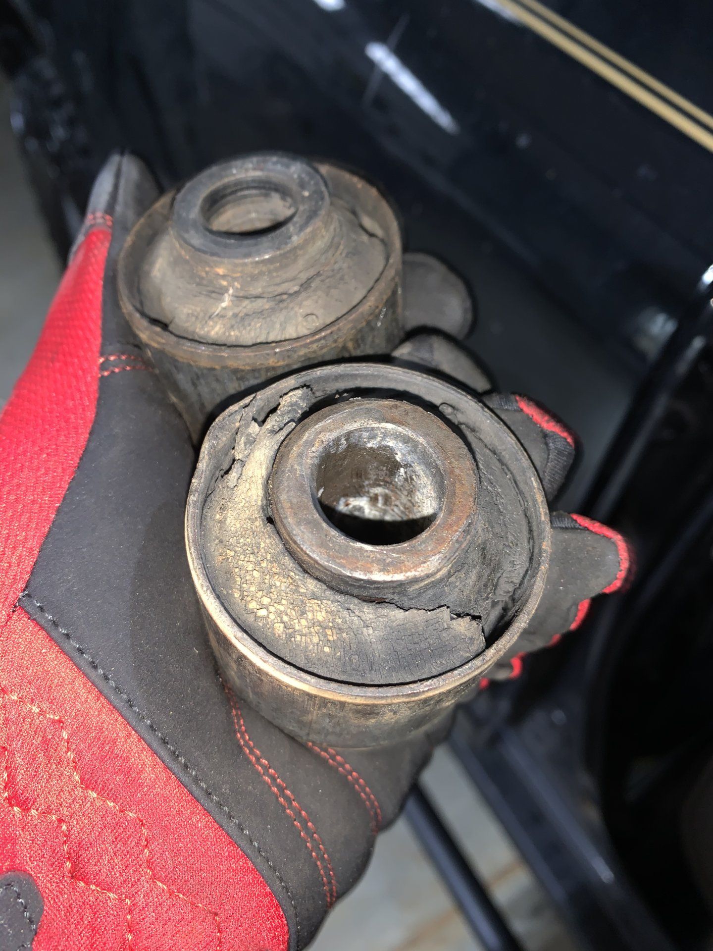

Cruiser maintenance...
New Toyota bolts and bushings in the radius arms.

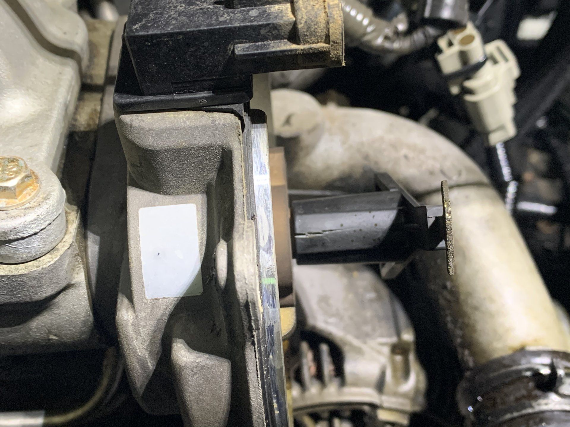

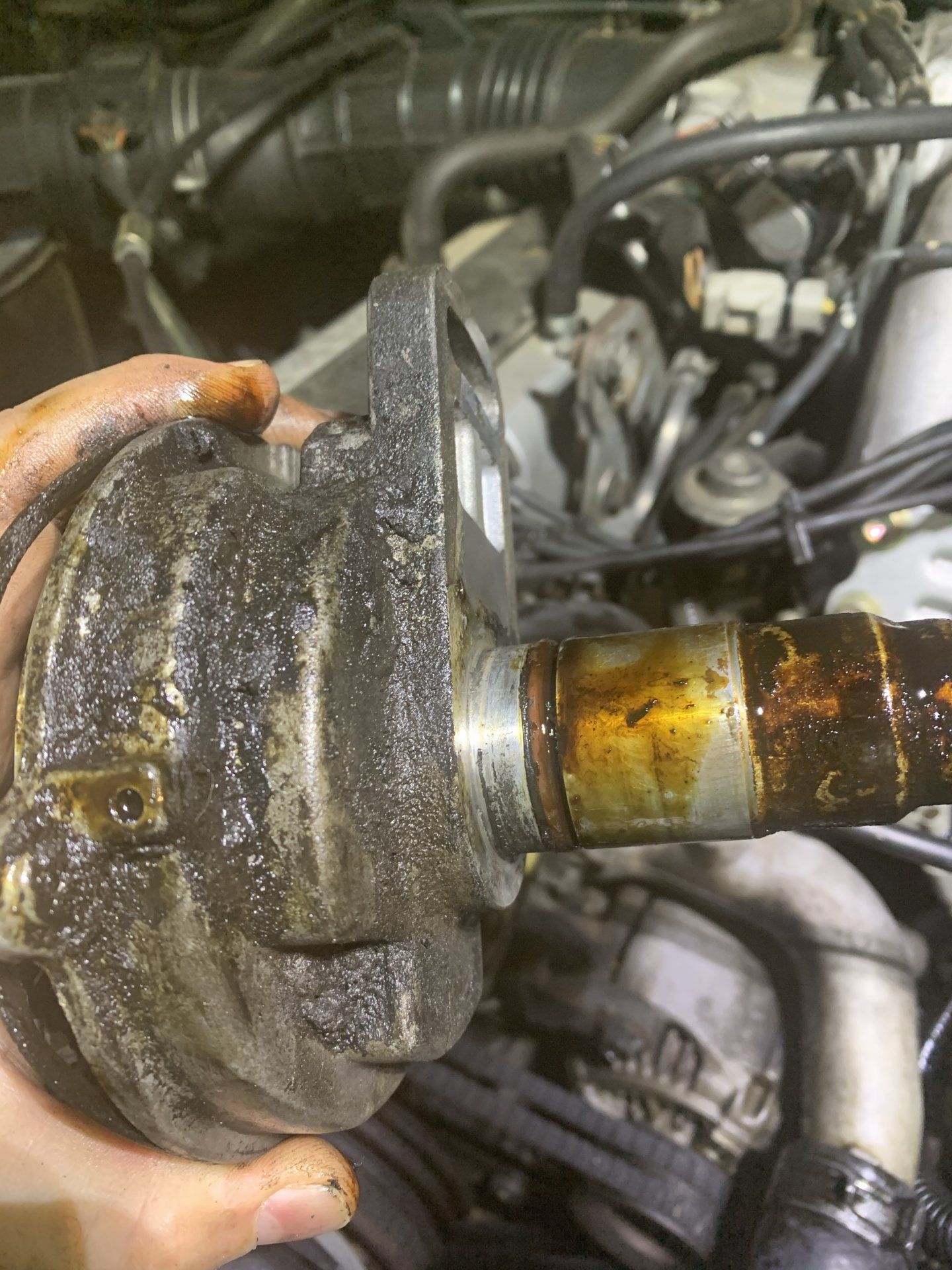

Chased a oil leak that I thought was power steering fluid. It ended up being the Distributor o ring. Also found a crack in the rotor button.
  • NewToyota Power steering cap.
  • New Toyota upper radiator hose.
  • New distributor oring
  • Rotor cap and button

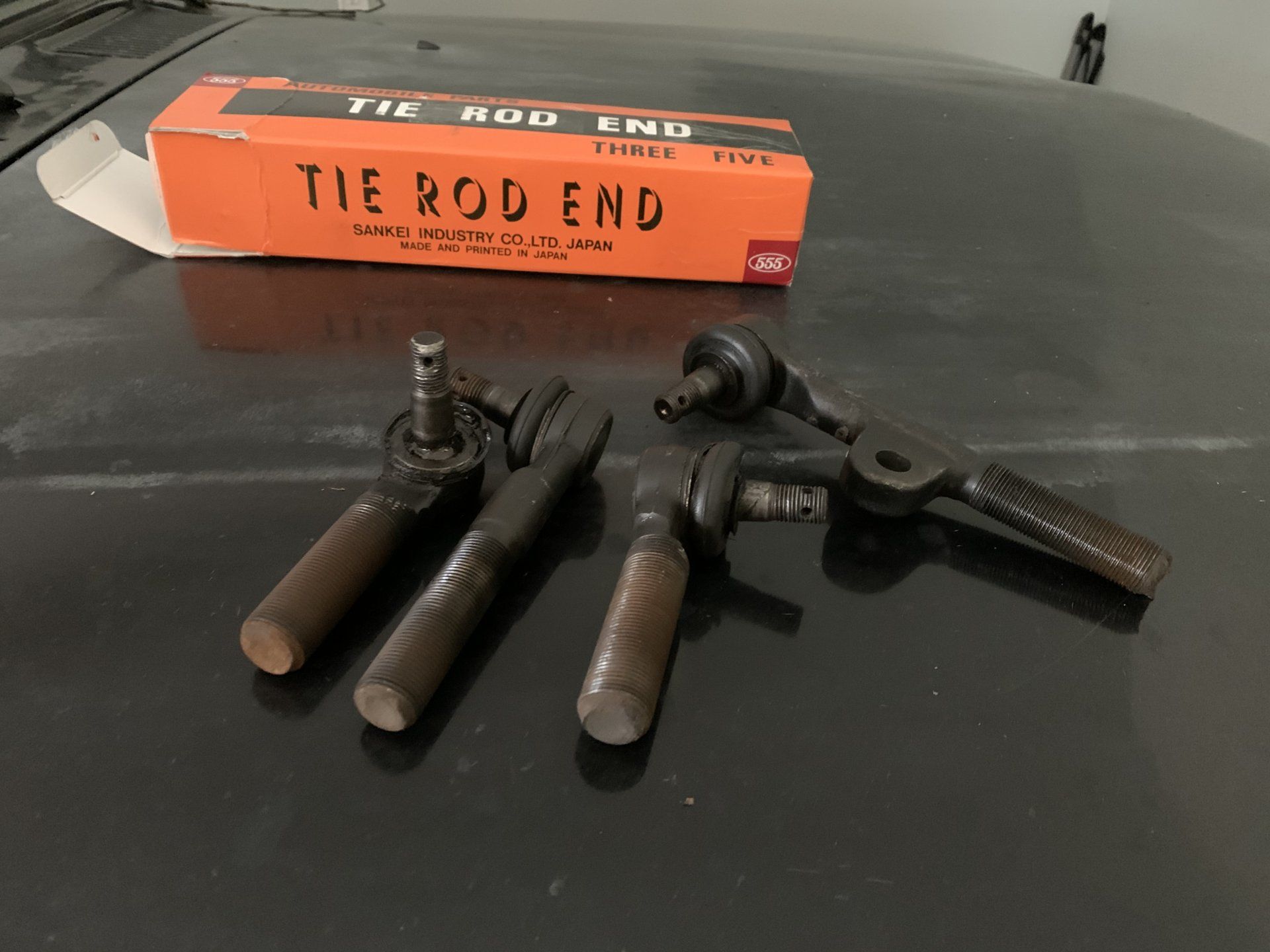

TRE’s are installed.

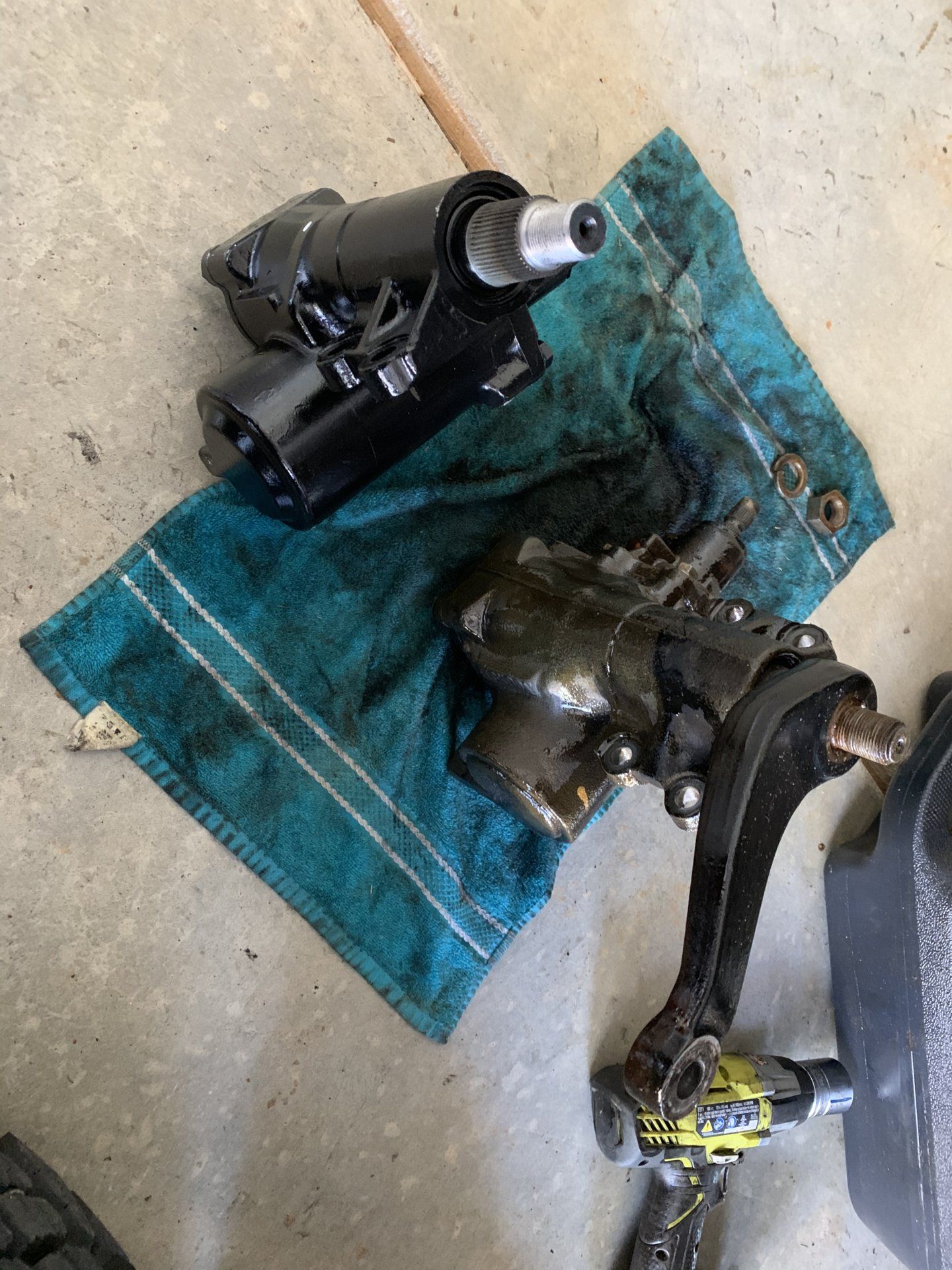

Steering box will be here Wednesday.

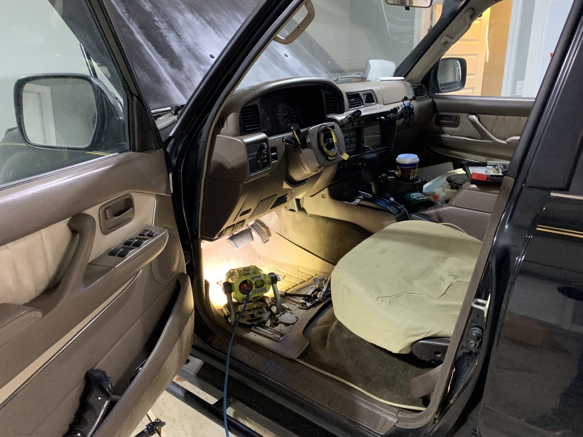

Need to do an update before I forget.... I’ve finally got the steering and handling dialed in. The Ol 80 drives better than it ever has and I can run 80 with my pinky now. Before the Christmas party trip I did get the reman steering box installed. It helped but the play in the steering still made me nervous. I had new bushings pressed in after the trip. The frame side bushings were destroyed.
After some adjustments with the sector screw the play is gone.

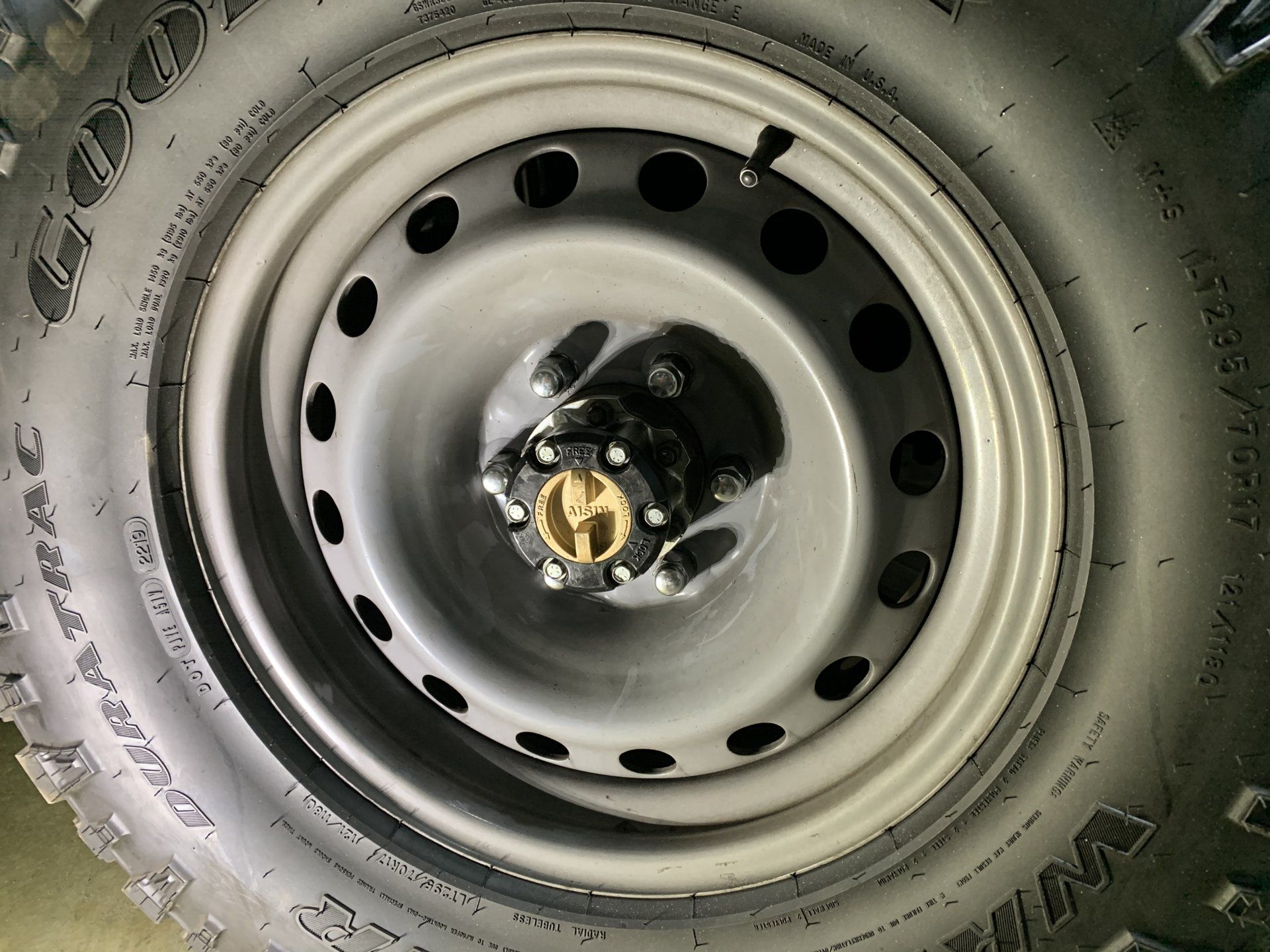

I spent the day under a tornado warning. Seemed like a perfect time to get my Aisin hubs installed while I kept an eye on the weather.

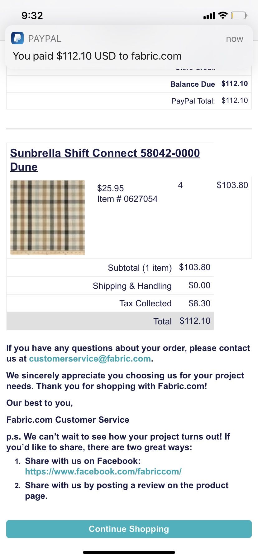

A lot going on the the 80 right now. The interior is at the Amish having the 1st and 2nd row being recovered. Im doing a two tone with a plaid insert. I’m using a material made for patio furniture. uV resistant, breathable and water resistant.

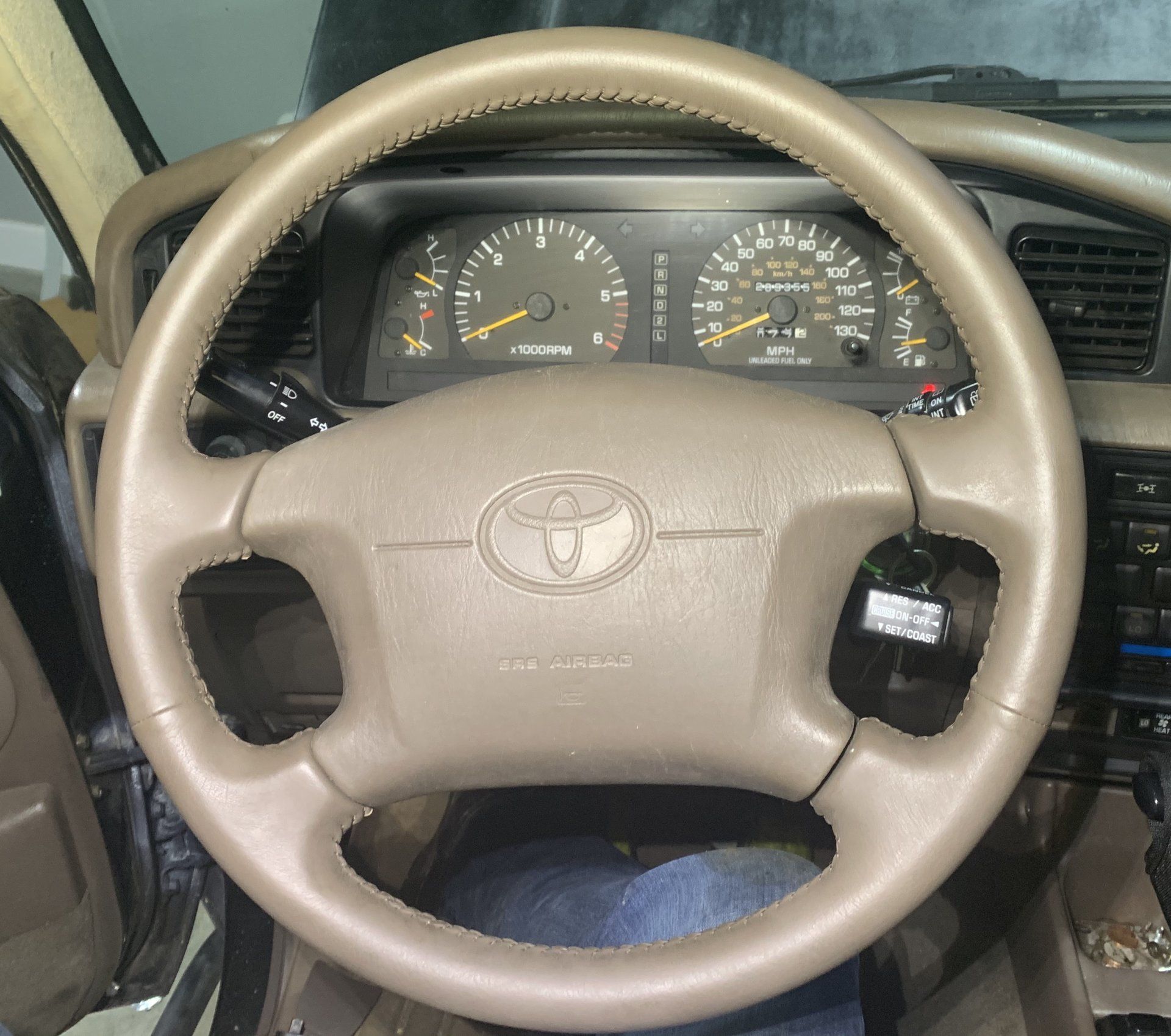

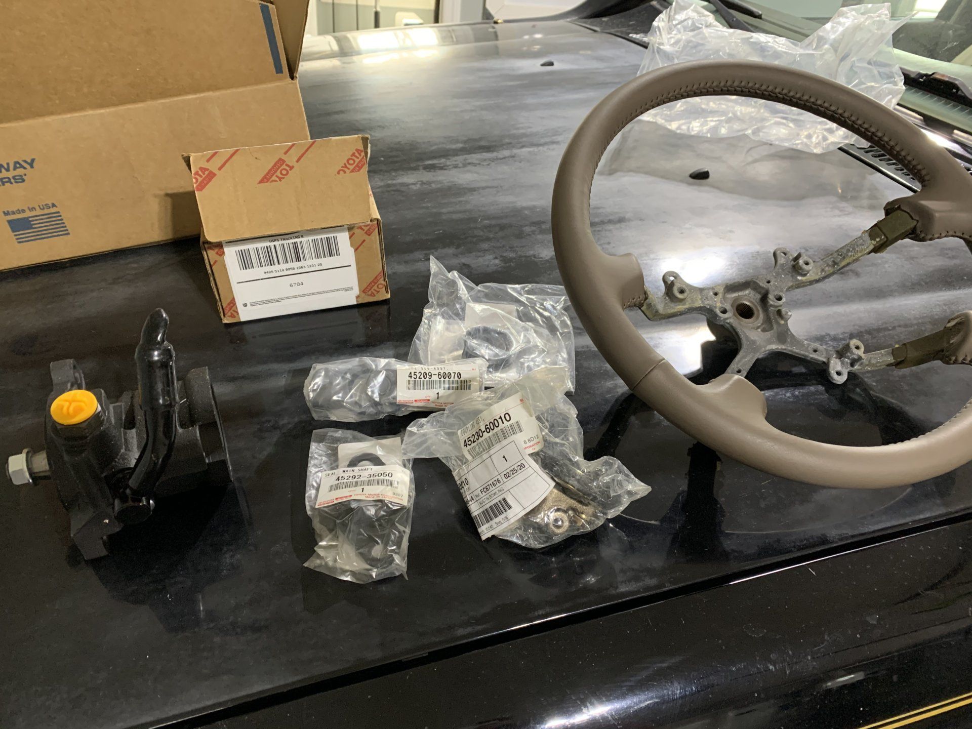

Decided since the Steering hasn’t quite felt right it would be a good time to make some changes and improve on the feel of the interior. NOS leather wrapped steering wheel along with some other goodies.
NOS Camry steering wheel. 45102-06061
45209-60070
45292-35050
45230-60010

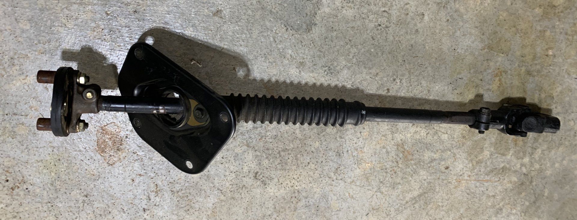

also picked up a universal. firewall bearing for a steering shaft.
New pump and steering box.
The reman steering box I installed before Christmas has a slow leak. I had a replacement sent. This should overhaul the steering.
45209-60070
45292-35050
45230-60010

@NC LX it looks like you got a new rag joint? I guess Toyota calls it something else, or just considers it all to be a universal joint. Does the steering feel any better by replacing that? How was the play before you replaced it?
