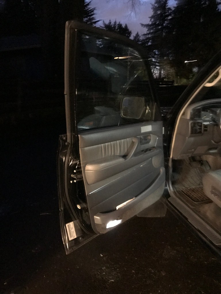

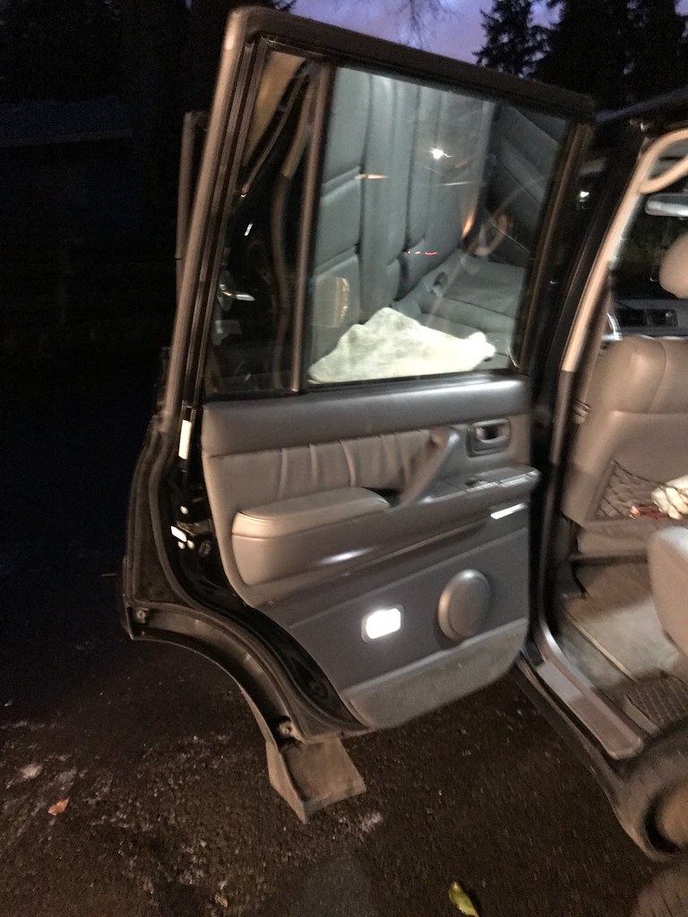

Hi Everyone -

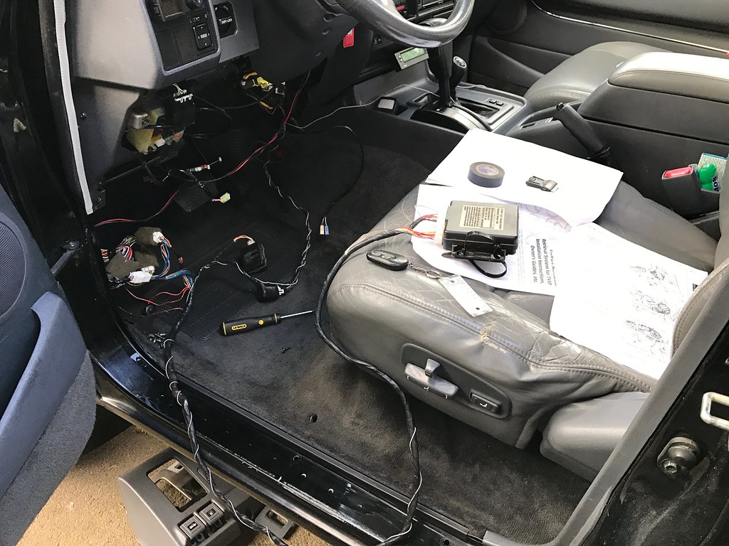

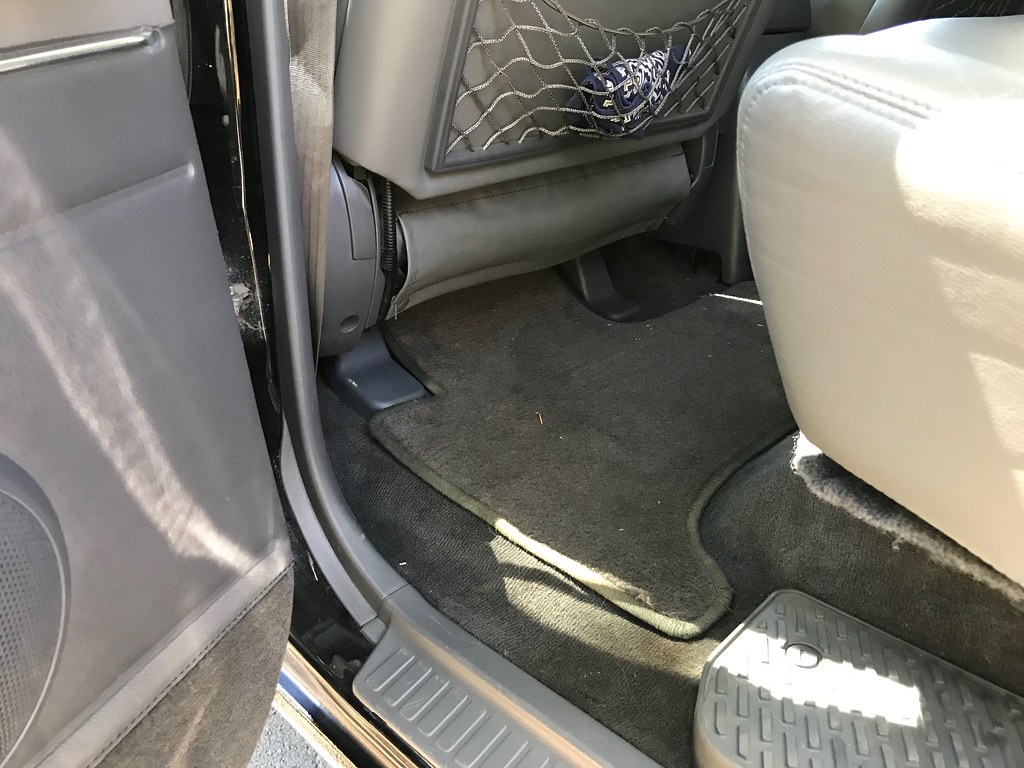

I need some advice on wet passenger & driver floor boards. I have done plenty of searching so far but have not found any feed back that has helped me. I feel that I have followed all of the standard advice. Here is the low down:
The passenger side is the worst but wetness is present on both sides. I peeled back the carpet and had a small amount of standing water in both sides where the wire loom rests. The fire wall is dry. I cleaned and dried everything the best I could - two days of rain, without driving the truck at all, and the dampness is back.
PLEASE HELP!
- Factory Toyota windshield
- Very healthy seal. I went around the entire windshield gasket with a screw driver and it was really well sealed.
- Sunroof drains have been scoped with weed hacker cord.
- The holes in the frame have been poked free with a zip tie and test water has flown through from sunroof to frame rail with no problem.
PLEASE HELP!
