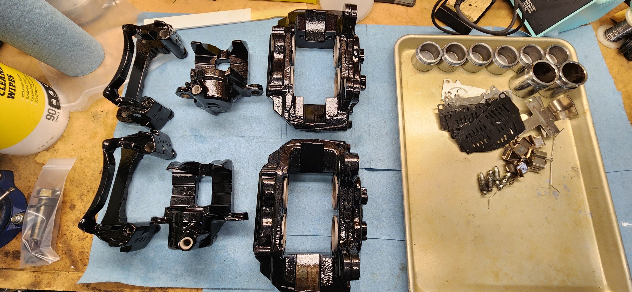

Full set fresh from the powder coater. New bits waiting.
Fully rebuilt with all OEM parts. Needed 2 new pistons on one front side.

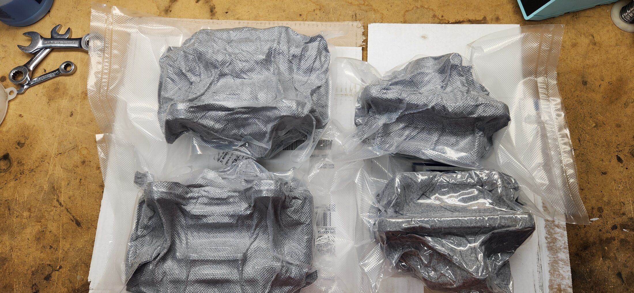

Wrapped and vacuum sealed for freshness. On a shelf in my garage till springtime.
How much work did you have to do to prep the parts for powder coating? Did you consider Cerakote?
LOL. I had to drive to the powder coater and drop them off. They were filthy and covered in peeling paint from my last attempt. Prior to that, I removed the pistons, fittings, and all rubber bits.
The shop understands what I want. They soak them, blast where needed, mask off the important bits.

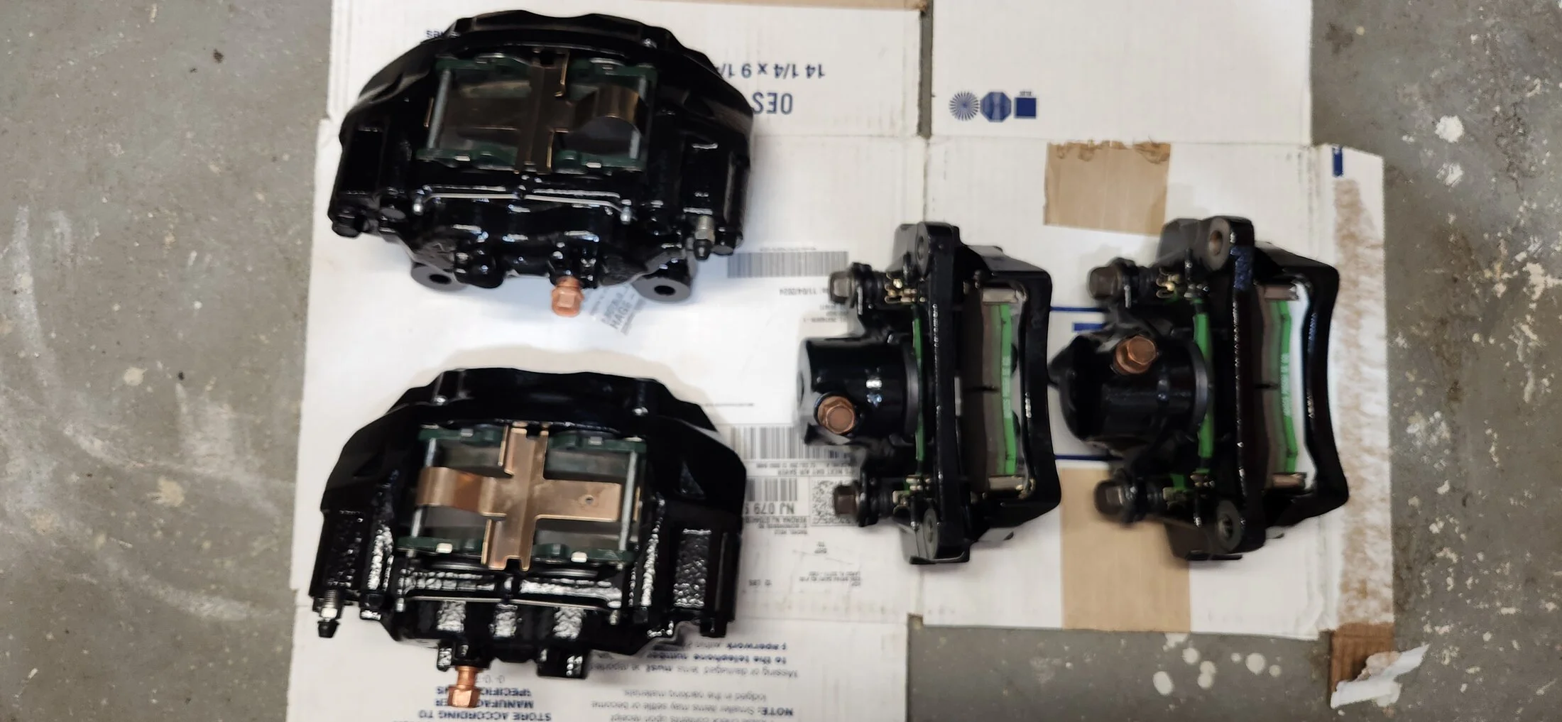

After the issues of finding good calipers, I have been rebuilding the last few also. I have not been powder coating them but that is a great idea! Nice work!
I have 3 sets of fronts and 2 sets of rears. All the fronts are coated. I have to bring in the rears that are on the truck now.
I swap calipers before my spring/summer road trips and wheeling trips. Fluid gets changed yearly.
