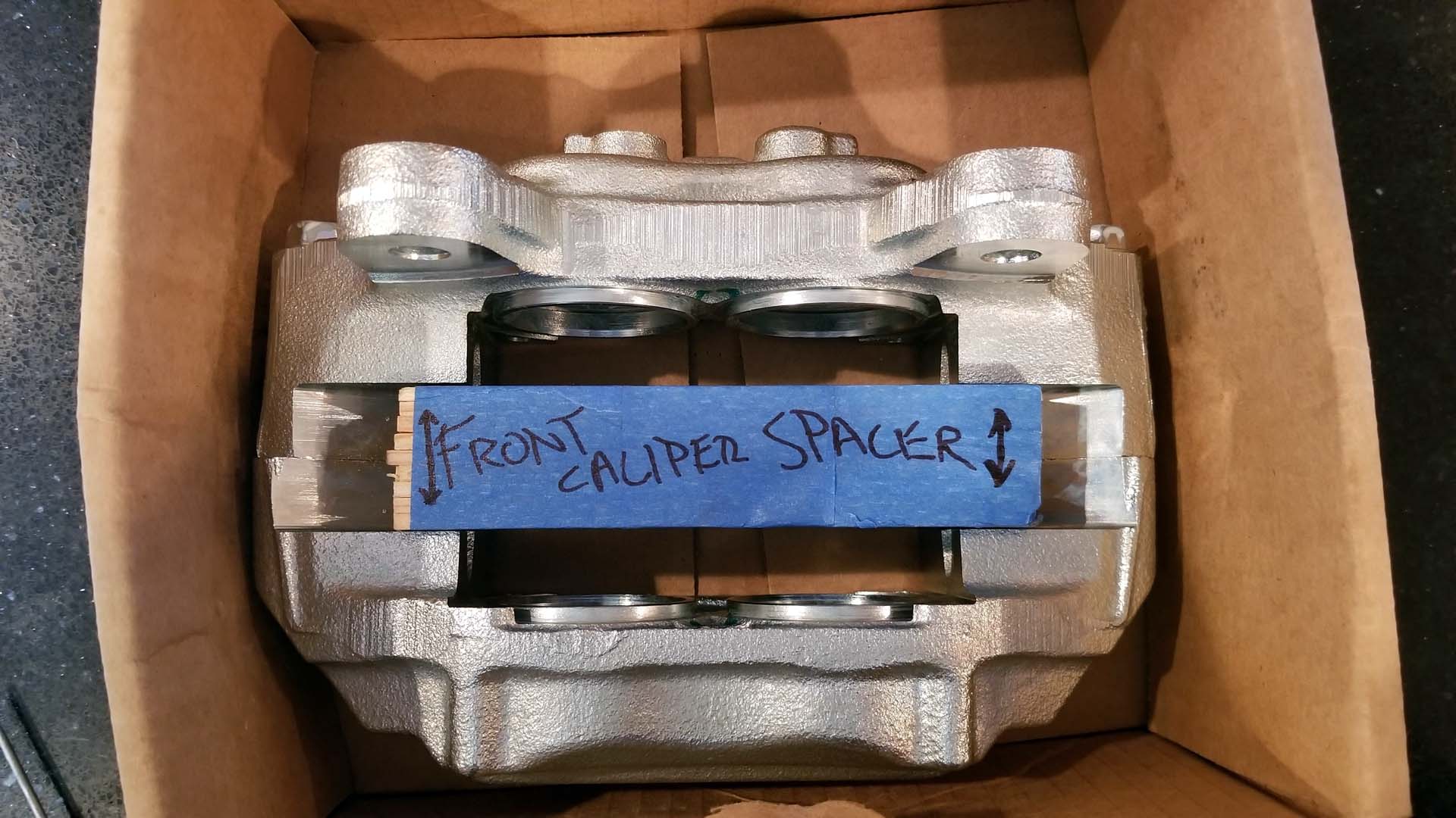

I have always rebuilt my calipers using the OEM rebuild kit, but it was always a PITA to get the sometimes stuck pistons out.
As I am prepping the new calipers for painting, I needed to remove the pistons (brand new ones BTW) along with all the bits and pieces associated with the rebuild kit. I didn't want to use the 2 screwdriver method to pry them out as they are brand new and I didn't want to mar the finish.
I took 9 Home Depot paint stirrers cut down to 6" and taped together as a spacer for the calipers.
This worked flawlessly as the pistons have just enough seal left to get all 4 out using compressed air.
Knock the spacer out and give the pistons a little wiggle and they come right out.
I'm certain someone thought of this before me because I remember reading something similar years ago, but I think it's great.
Work smarter, not harder.
Why not just tape off the pistons and that area?
Because I needed to hit the whole shebang with brake cleaner before painting. There was lots of residual grease/oil/crap and the brake cleaner would have damaged the rubber seals.
OK. Makes sense!
But you'll wash off all that pretty silver paint! :rofl:

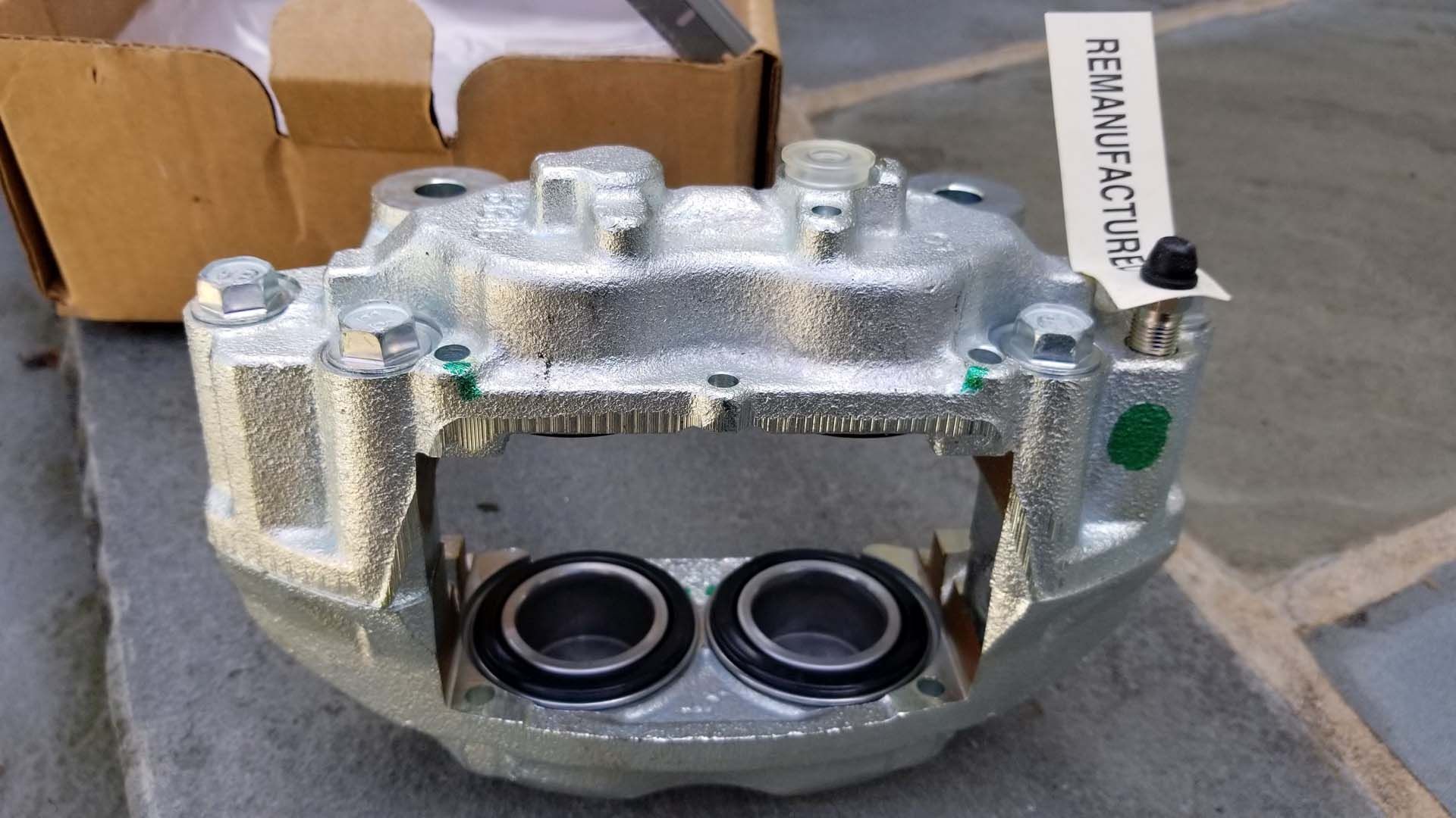

New genuine might be available. I managed to source a set of new genuines probably about 2 yrs ago. check Amayama, partsouq and megazip as well as what any local dealerships might say as I don't know if those parts places cross-link straight into Toyota central parts brains trust or have their own inventories.
So back in 2018, I replaced all 4 calipers with Napa Eclipse and after reading what other people dealt with, figured I was one of the lucky ones. Yesterday I had to replace one of them in the rear as it was dragging. I initially planned to do a quick rebuild as it can be done pretty quickly but once i got the piston out i noticed the rust was very extensive. Anyway Looking closely they should not have passed QC for remaning. Talked to Napa they had to order 3 calipers before one came in that had new sliding bolts, Not the pitted sandblasted variety, and with pistons that were not rusted. One caliper they ordered for me, arrived with a nice paint job over what used to be a machined surface, couldn't even tell anymore. anyway the third caliper they ordered was in good condition and I installed it yesterday. I did a quick rebuild with a new piston on the other rear caliper just to be sure rust wasn't an issue there too. So in short if you still go this direction and not OEM, you need to inspect them very well before accepting them. I know they provide that warranty and it is very nice, but its better to not have to use the warranty in the first place. Figured I would let people know that you have to check the quality very much. Personally I wish i would have just rebuilt the originals and not gone down this path, but hopefully mine were remaned and someone got a good set.
I still have a "new" OEM remanufactured caliper to return that had a seized piston. I didn't pull it apart to diagnose, as it's just going to get returned.
Just got these delivered today. I can't decide on the gloss black VHT caliper paint I already have, or pick up some red.
Jon, would you say it's necessary to paint these reman OEM units? Or is the finish adequate to bolt up out of the box?
Thanks
Thanks
I live in the northeast. Anything that's uncoated turns to rust.
