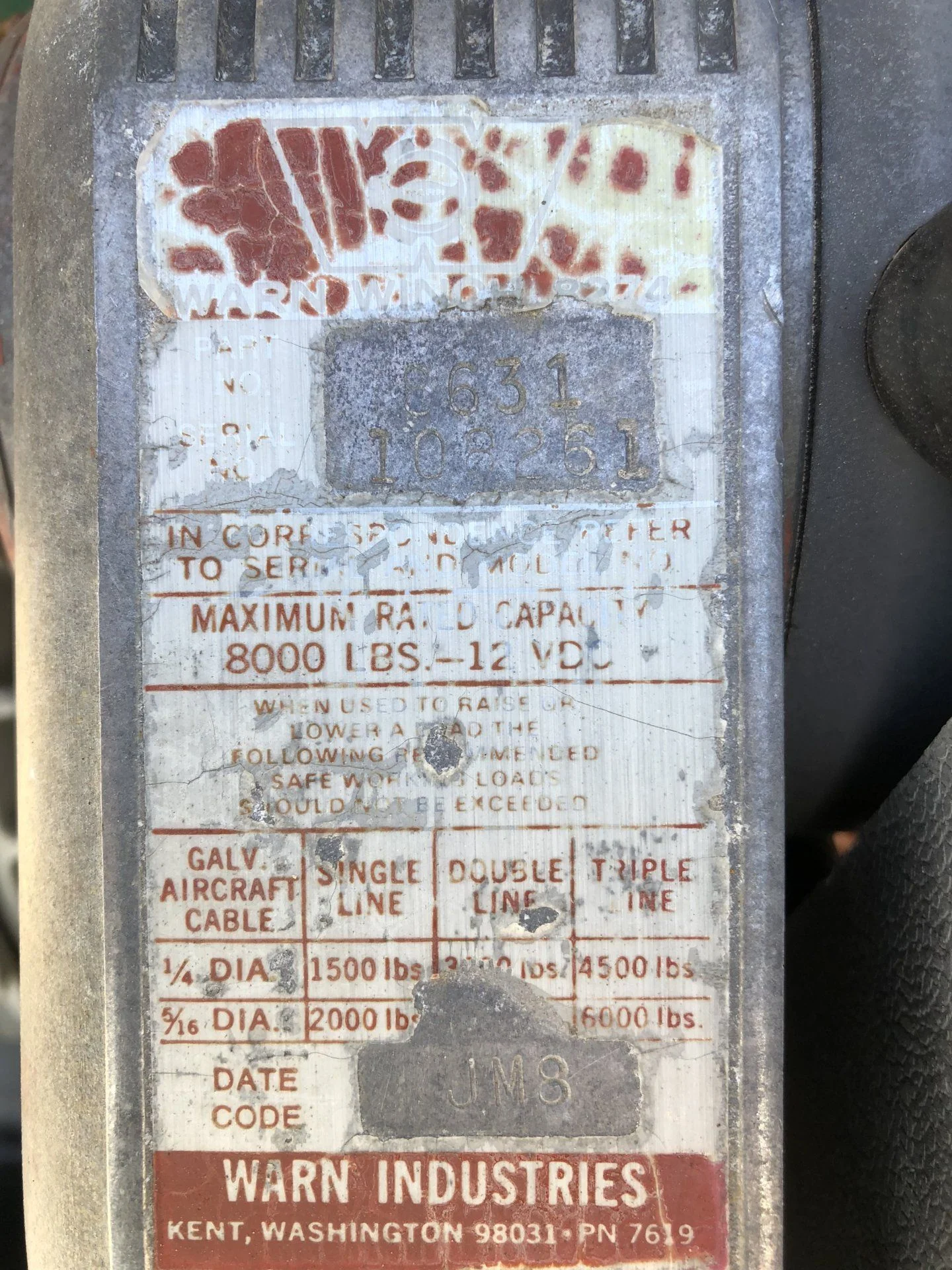

Look on the metal badge where you found the serial number, on the bottom there should be a date code. The last digit is a number, and is the last digit of the year it was manufactured. The letters before it are codes for the day and month, IIRC. As an example, here is mine:
My Date Code is "JM8", so it was manufactured in 1978. J=10th letter of the alphabet, and M=13th letter, so mine was made on October 13th, 1978. Pretty sure that's how it works, but the year part is correct in any event.
