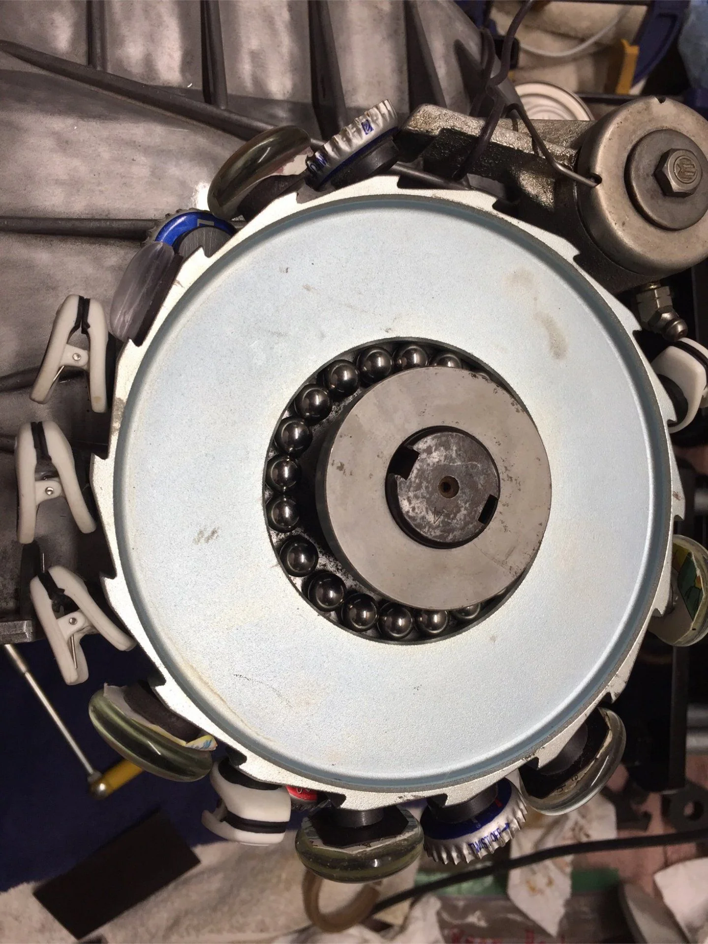

Used a bunch of fridge magnets to hold the ball bearings. Thanks to @Awl_TEQ and @flintknapper
Yes
