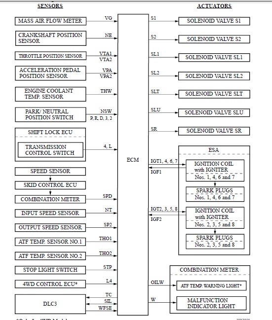

The 5 speed is electronically controlled, meaning more wires, connections, and sensors. This also means the transmission ECU (built into the engine ECU) has to be happy with all of the inputs and sensors it needs, or it will not shift correctly, and it will go into limp mode.
It's not only the transmission that is the issue, but the other things that come with having that 'era' of ECU. Earlier models, around 98-02, you don't need the key transponder and key transponder ECU. The EVAP system also becomes more complicated. I believe the newer systems will run in limp mode if you do not have the complete EVAP system installed and running correctly. All valves, including charcoal canister!
All in all, the pre-03 2UZ is better for swaps, especially if using a manual transmission and 'manual' throttle with cable.
Here are a few pages from the a750 repair manual explaining different functions and inputs. Check them out and you'll realize how advanced the a750 actually is. When everything all works, its amazing. When it doesn't, its a nightmare.

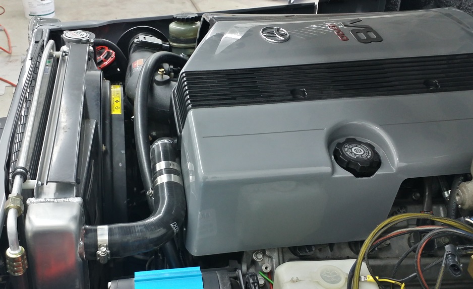

One issue I did have though, is it was running warm. I was concerned about that, but I had faith in my radiator, being that it was the Champion that was in there while the old high performance Chevy was in there and it never got hot. The 2UZ in our 4Runner loves to be around 190 to 195, and with the OEM size Champion, I was seeing up to about 210-215 on the freeway (with AC off). The fact it was on the freeway led me to believe the rad wasn't big enough, so, time to upgrade. I went from the small OEM size radiator to a 19x26. It is about 100 sq inches larger, and holds close to 1 gallon more coolant. This also means I can run a larger fan and shroud.
Old vs new-
I had to cut out the saddle and make my own mounts. Funny enough, the Champion radiator was about the very last thing on my list of 'stuff I can use on the build that I already had'. Nope.
With temps down close to 200 now (mind you, this is in August, Las Vegas, uphill, freeway, 108 degrees outside), I was happy with the upgrade. It was a compromise of space though, just like everything. I am using a Volvo 2 speed electric can. The largest SPAL fan I could fit was a 16" 2200cfm fan. The Volvo is more than 2200cfm on LOW. Close to 3500cfm on high.
Tight fit!

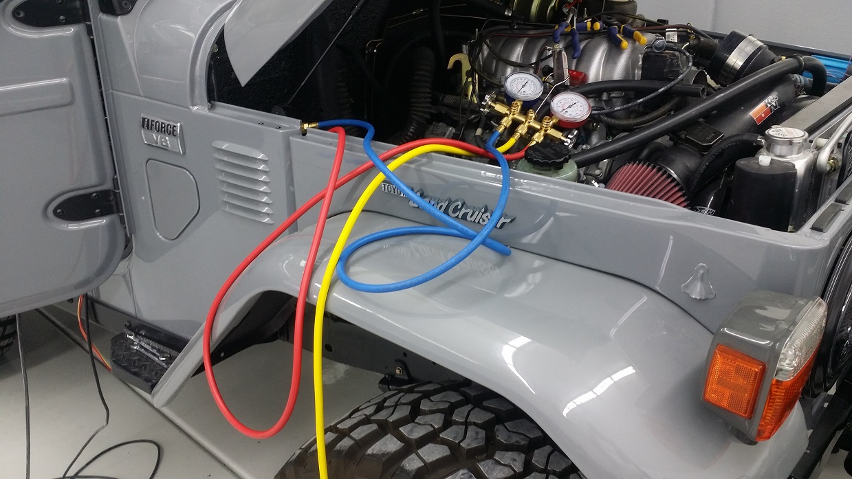

As stated earlier, I went with the Old Air Products Hurricane system. I am extremely impressed with it so far, and the kit is very high quality. I had to crimp my own lines after I cut them to length. Luckily, our hangar has some amazing tools that are available 24 hrs a day. Here is an AC line crimping tool I used for about an hour and 8 crimps.
Action shot-

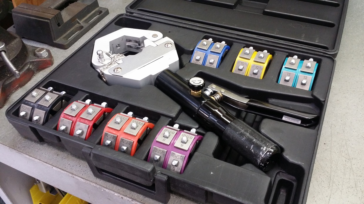

After getting the lines home, I test fit them and all were perfect! Don't forget to clock the fittings with bends in them! I added 7 oz of PAG 46 oil to my compressor and vacuumed out my system for 1 hour. Then I let it sit for 24 hours with no leaks! Time to charge it!

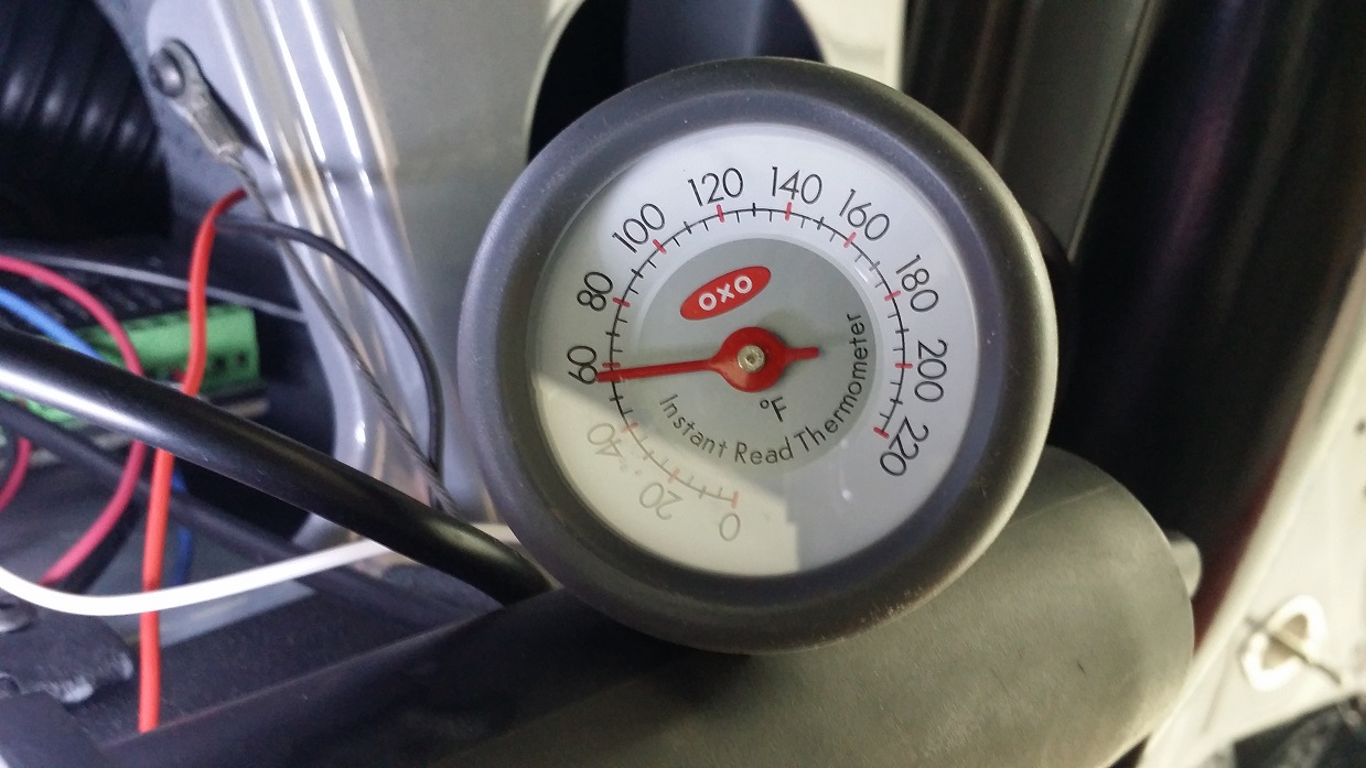

After adding about 28oz of DuPont Freon, it was blowing ice cold!
Temp in garage that day-
Temp of air coming out of the vents-

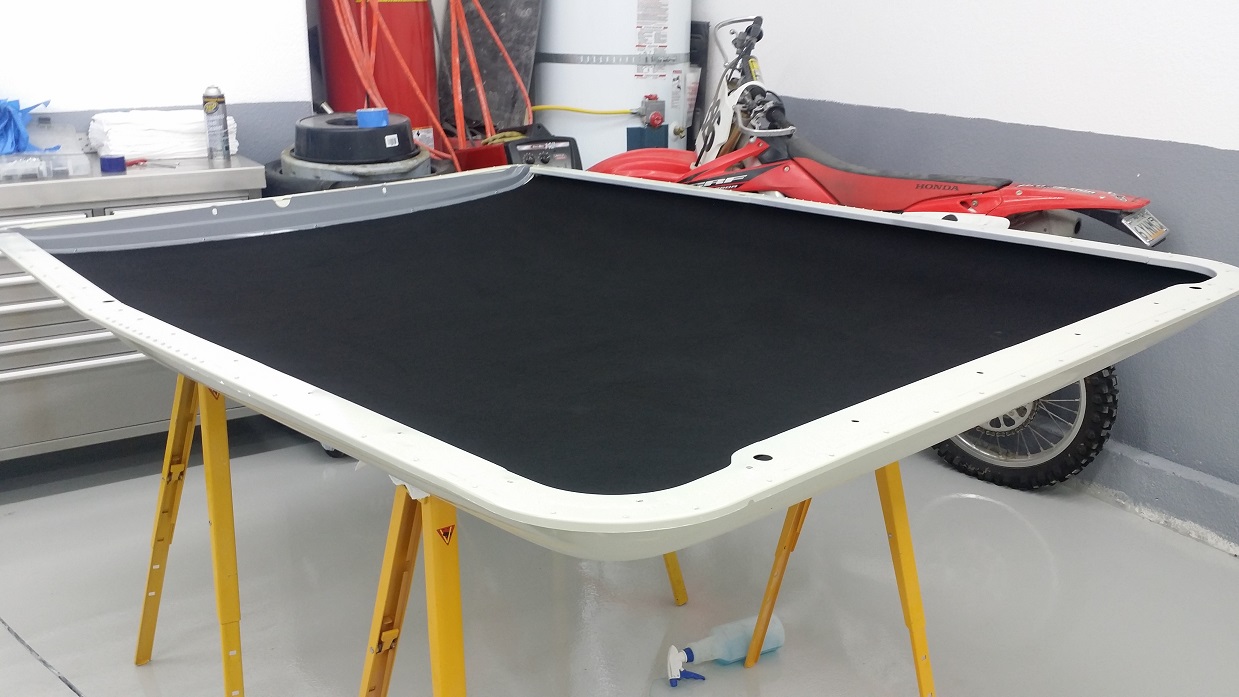

And lastly, I pulled the top off again to do the headliner. It took my a while to make up my mind on what I wanted. I thought about doing white Raptorliner, but I really like the look of dark headliners. I also wanted some sort of fabric to absorb sound. Although, I did coat the underside with ceramic Lizard Skin for insulation.
I decided to go with Ozite carpet. It's extremely light, easy to work with (stretchable), and cheap. I used Permatex headliner glue. I think it will hold up great! I am really happy with how it came out. It's all one piece with no wrinkles.
The top is back on now, and tightened up for good!

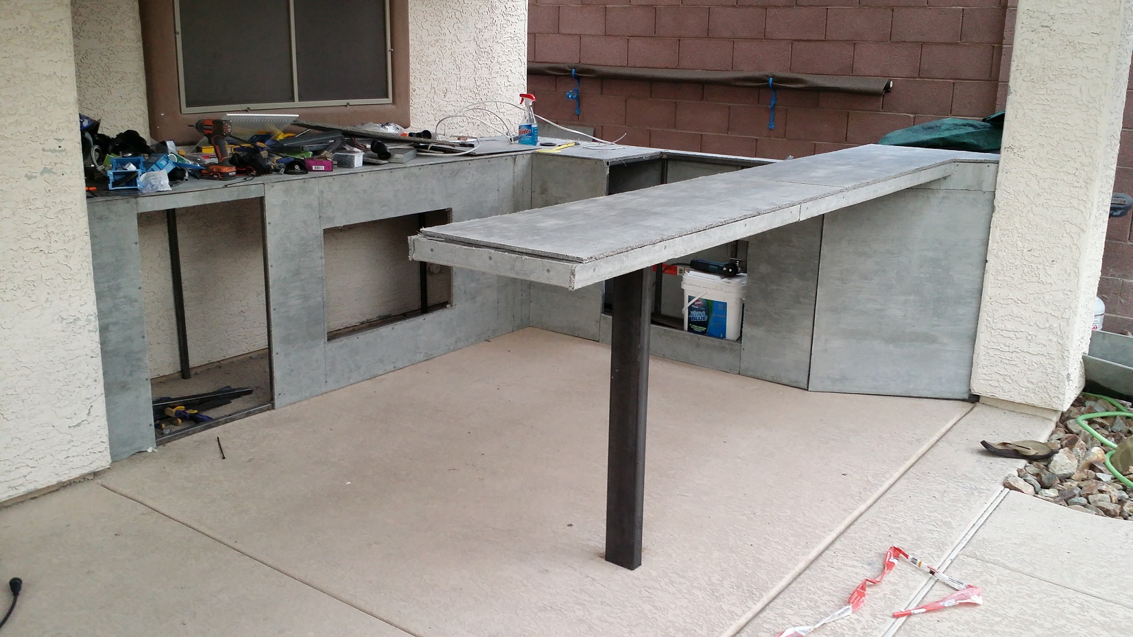

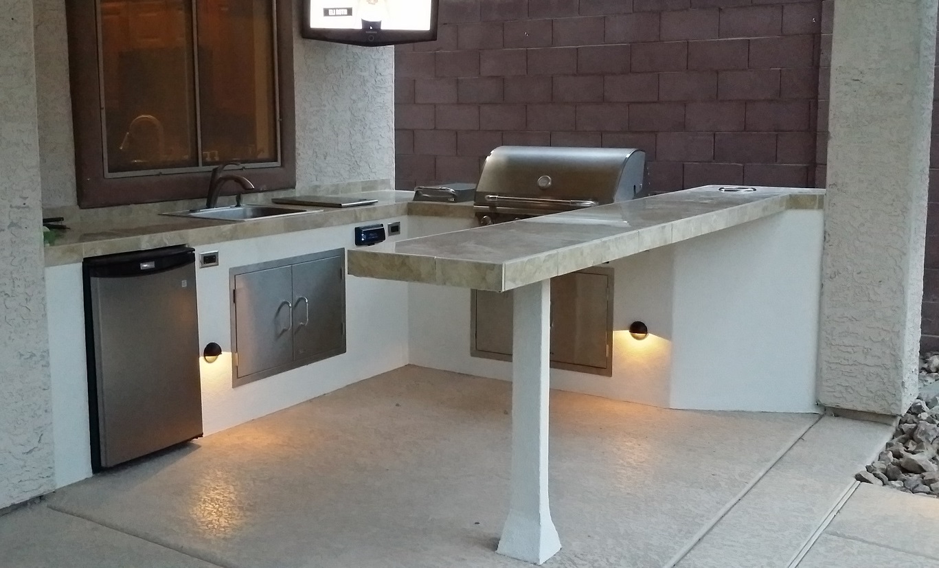

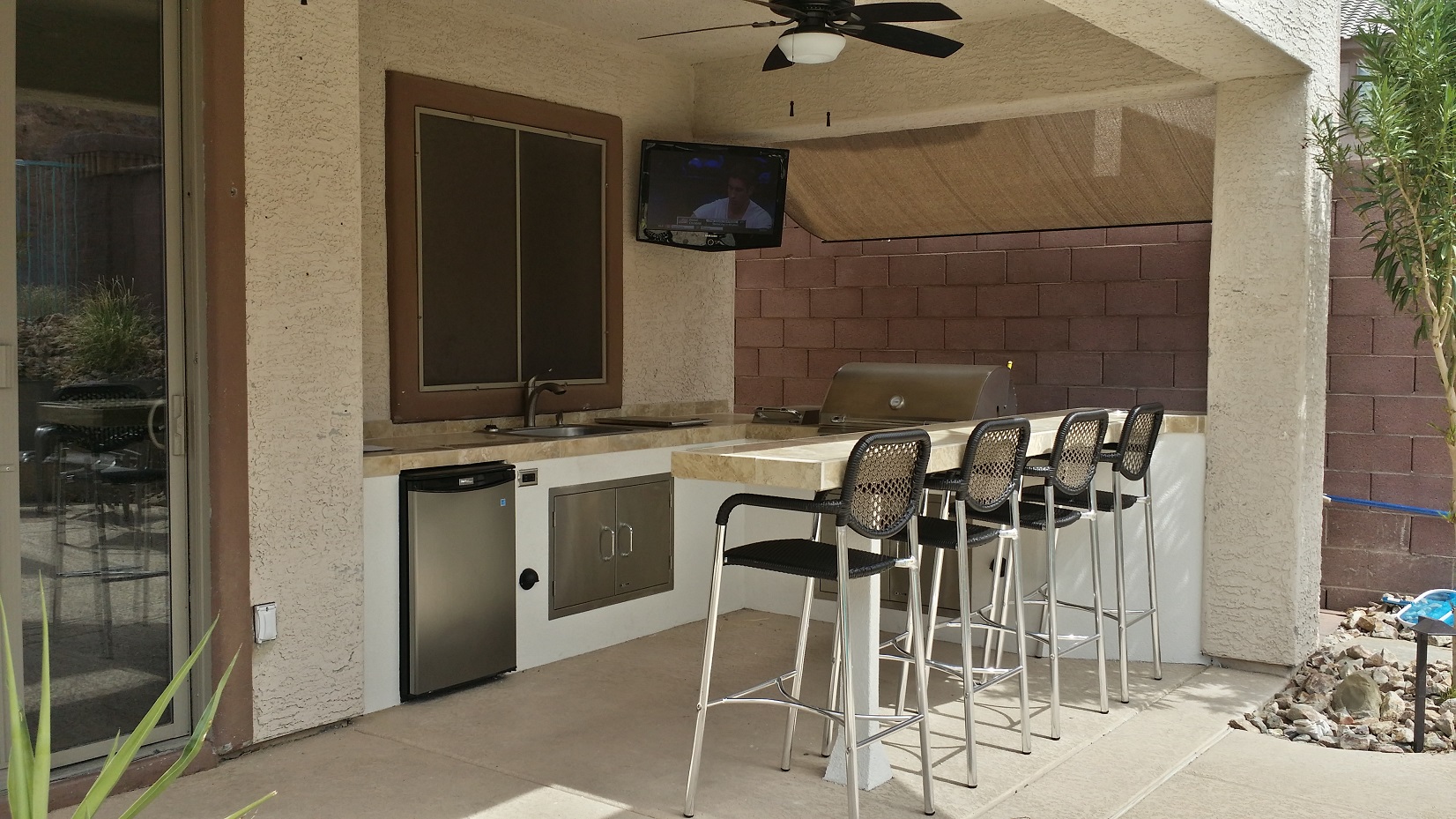

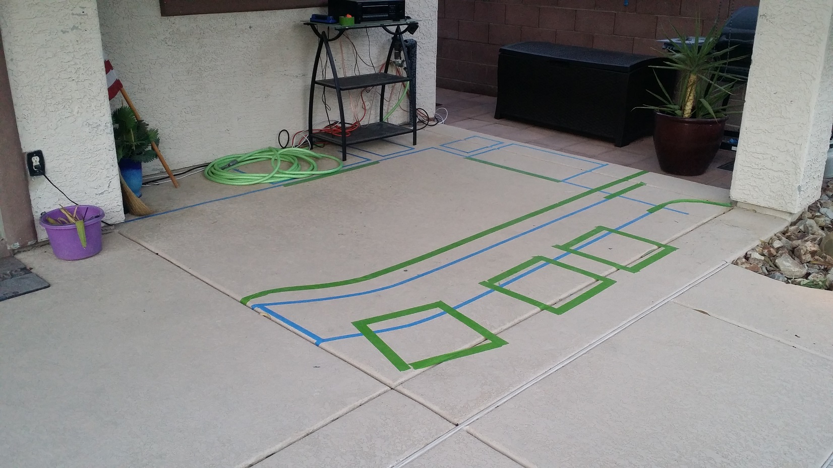

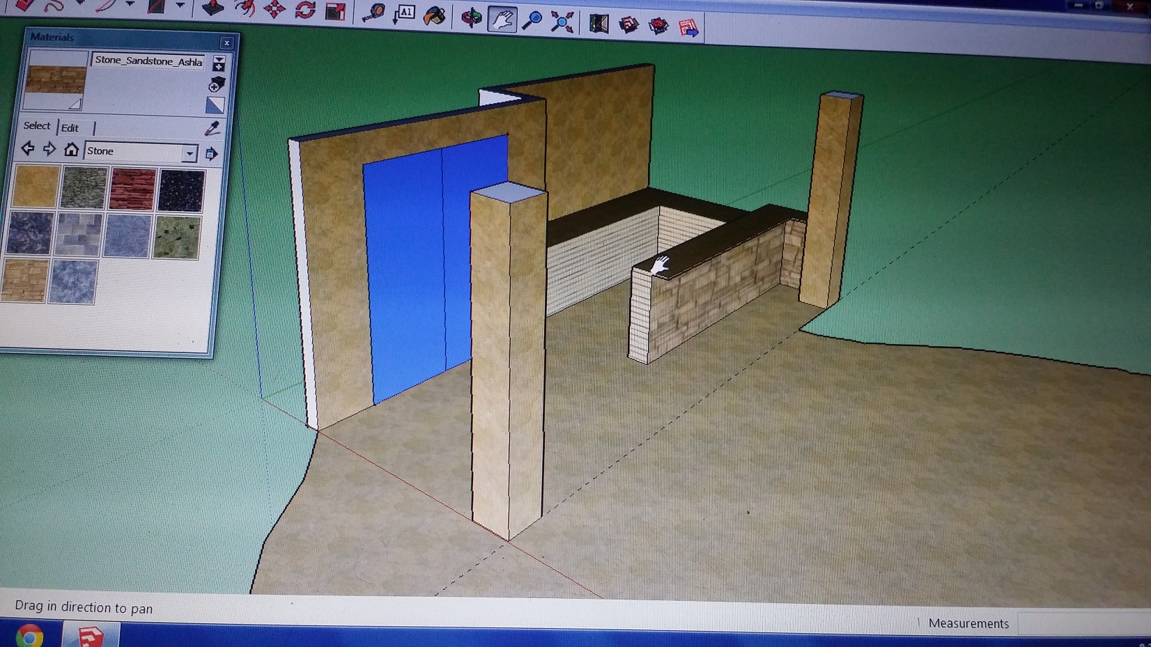

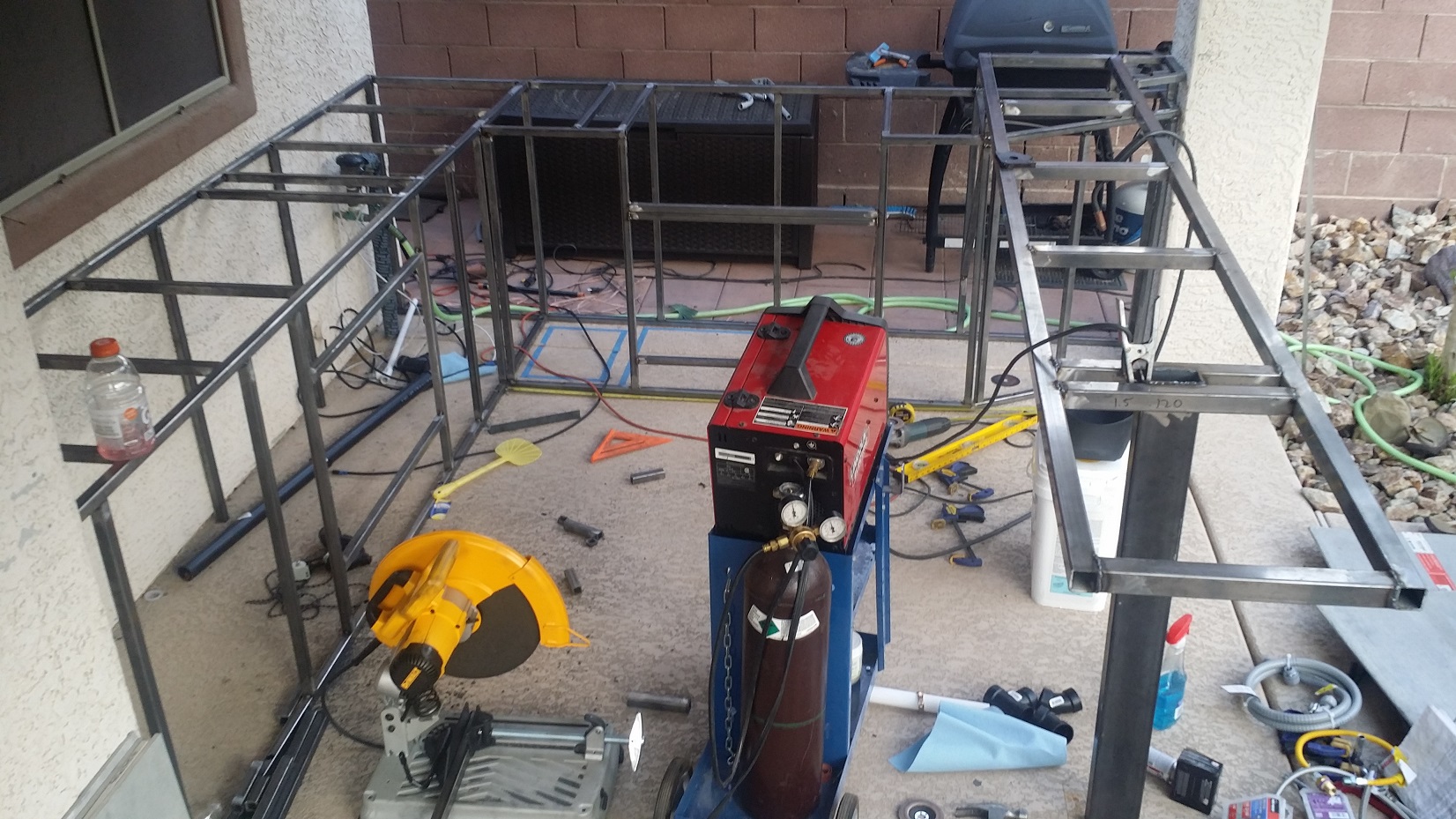

Sorry Danny! I promised Shandelle I'd build her an outdoor kitchen! I made it up in Google Sketchup and built it (I did everything but the Stucco)! This took about a month out of Land Cruiser build time!!
Believe it or not, that is 220 feet of 1x1 .095 square tubing!!
And complete!! Time to work on the 40 again.....
