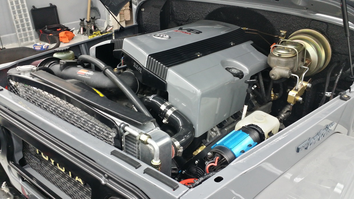

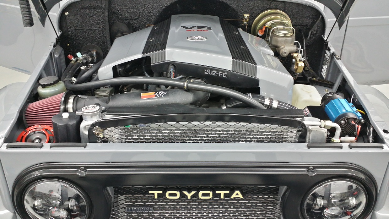

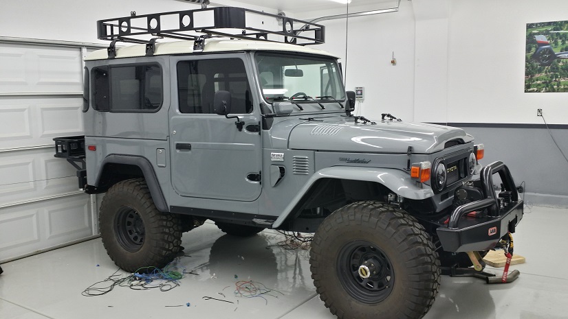

Finalizing a lot of the wiring... just about wrapped up under the hood (hopefully you can't see it, I tried to make it clean). Man, it feels nice putting the engine cover on!! Not much room to spare in this engine bay!
Unbelievable. Just unbelievable.
I can't wait to see what comes next.
I spent the week at SEMA, so it motivated me to finish this thing up once and for all! Really just down to some wiring, putting the seats back in, and door panels on.
I threw the rack on last night just to see what it would look like, but I've ultimately made the decision to get rid of it. It makes it too tall, especially with the roof tent on top of that.

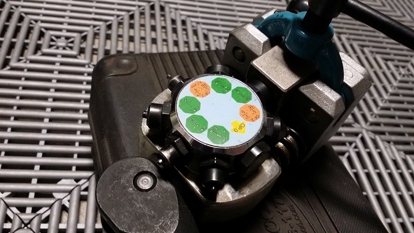

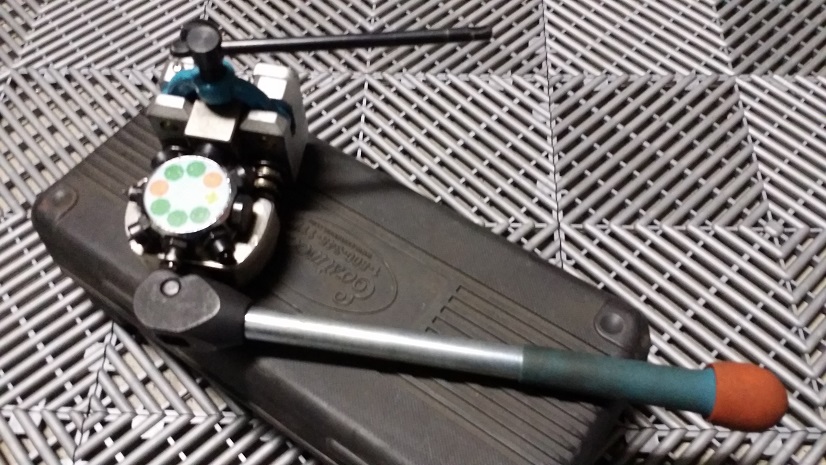

First, brake lines. I used a nickel/copper blend. It was extremely easy to work with. Easy to bend, and easy to flare. This was the first line I made, which was for the rear axle-
I made all my own lines using this tool, which I highly recommend-

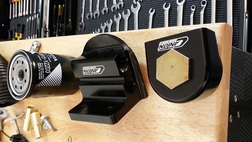

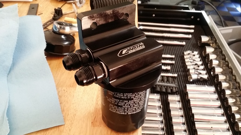

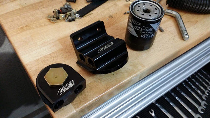

Also, my oil filter. I had to do a remote mount, due to location of the stock oil filter on the 2UZ. With how narrow the 40 frame is at the front, there is no room for a filter, and BARELY enough room for the remote mount! I looked for many different mounts, and this was the highest quality and best fitment. It also allowed me to use an OEM Toyota oil filter, rather than a generic thread. It is made by Canton Racing.
I take it that adapter uses the huge bolt to hold it to the block ? How are the seals built on that part ? I've looked into this to ditch the stock "nose-down" filter arrangement on the 2F and you're pretty limited to mounting locations . That looks to be a well made setup , I've used the Earl's from Summit in the past , not bad but it's hard to index the spin-on adapter correctly .
Sarge
Sarge
You're exactly right... the huge bolt threads into where the normal filter would thread. There is a huge o-ring that goes on the outside, just like a filter. This is a very high quality kit, it's all machined aluminum. I bought the $50 Summit special and it was a joke. Not only that, the fittings came out from the adapter straight, not at a 90, which almost defeats the purpose of having an adapter to make room.
It is very easy to clock the adapter, just point it and tighten the bolt. Here's the kit-
http://www.summitracing.com/parts/ctr-22-824/overview/
I did not buy the kit, I just bought the adapter and filter mount separately so I could use black hose and fittings, rather than the Earls.
