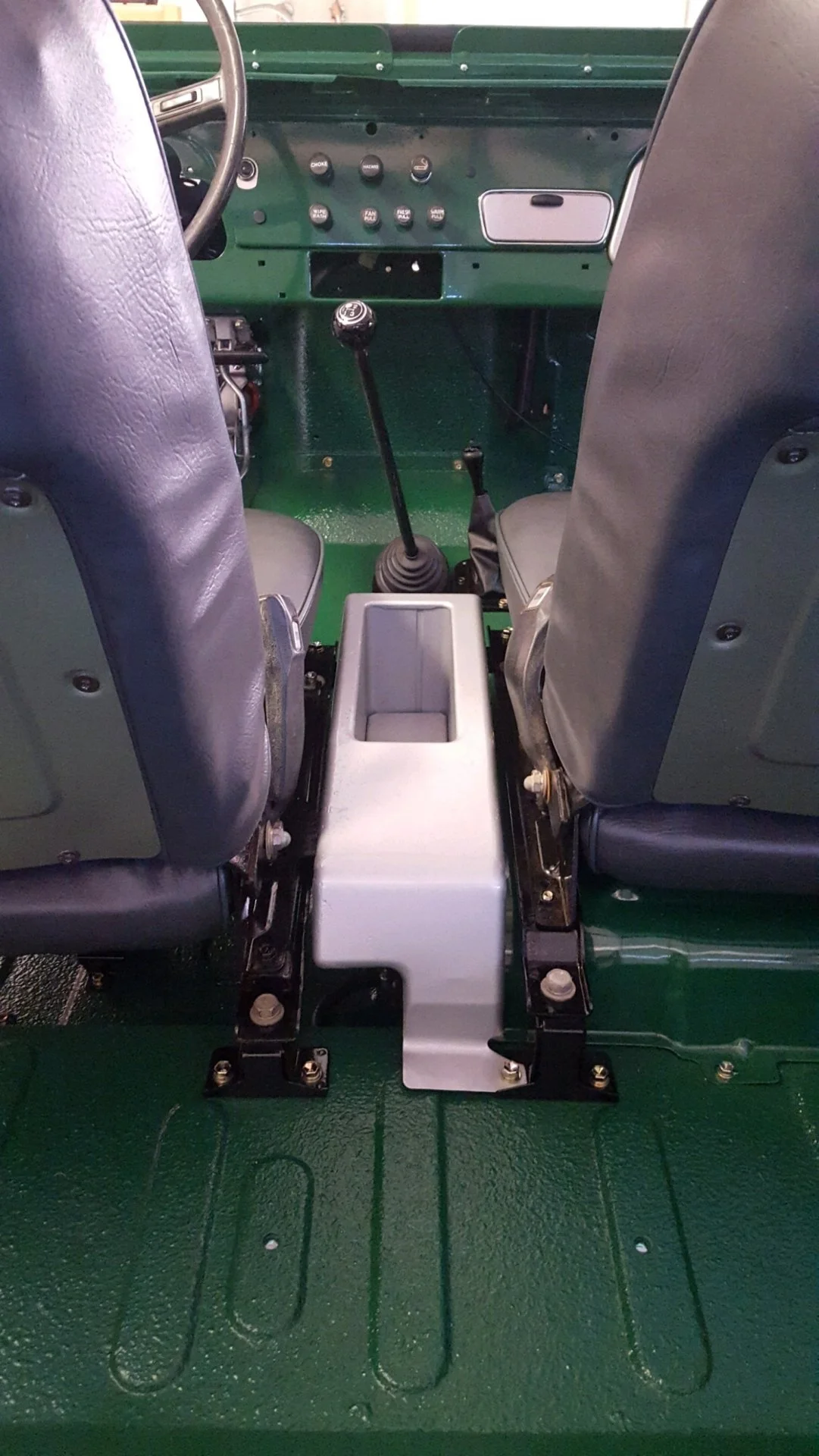

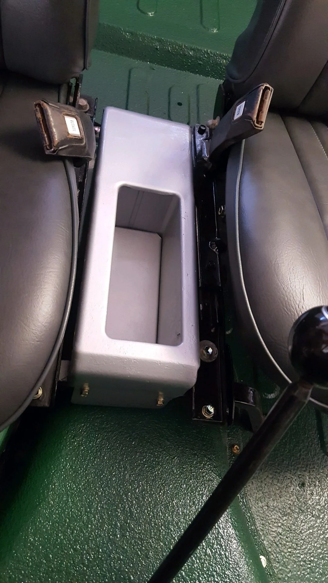

Installed the 3 point seat belts. Not sure if the were stock in 74, but these are much better than just a lap belt.
Three point seat belts started 1/76 in the US market. Wasn't until 2/78 that seat belts moved from the hard top to the roll bar. Haven't seen any FST in the US made after 1975. Did the three point seat belt requirement starting 1/76 have anything to do with it who knows.

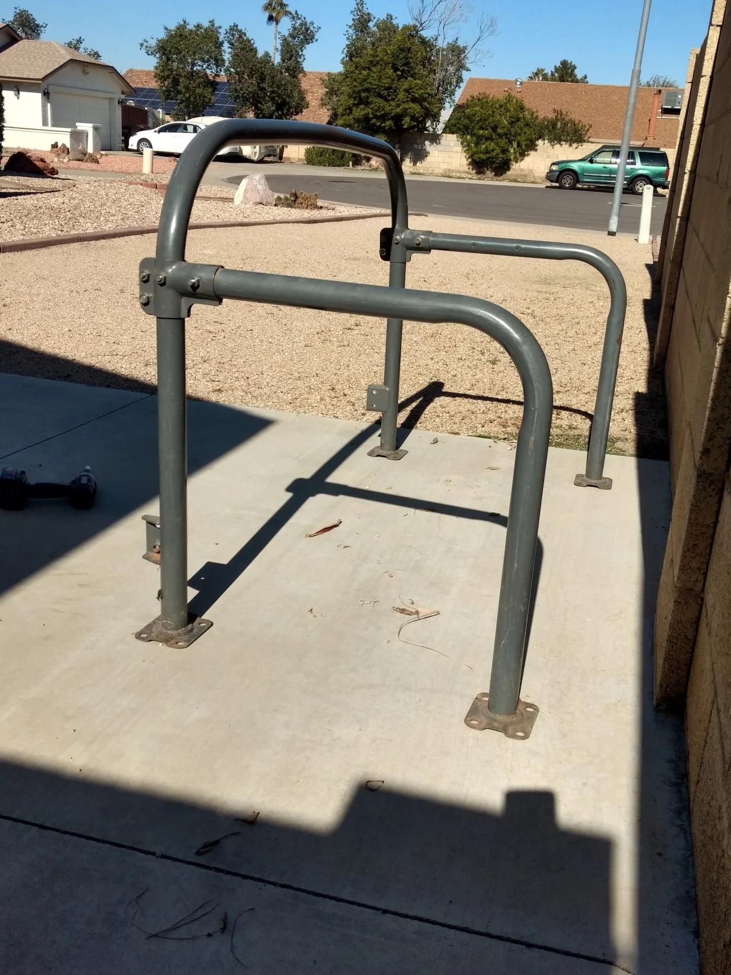

My 76 is 10/75. Hard top is need of a little TLC and picked up a set of hard top sides in matching beige. Those also fall in the 1/75-12/75 range. Have a mustard top for ambulance doors and no vent window. Again those were made during 1975 without the seat belt brackets. Do have 77 top with seat belt brackets but vent windows. Just can't catch a break. Could add three point seat belts using one of these options.

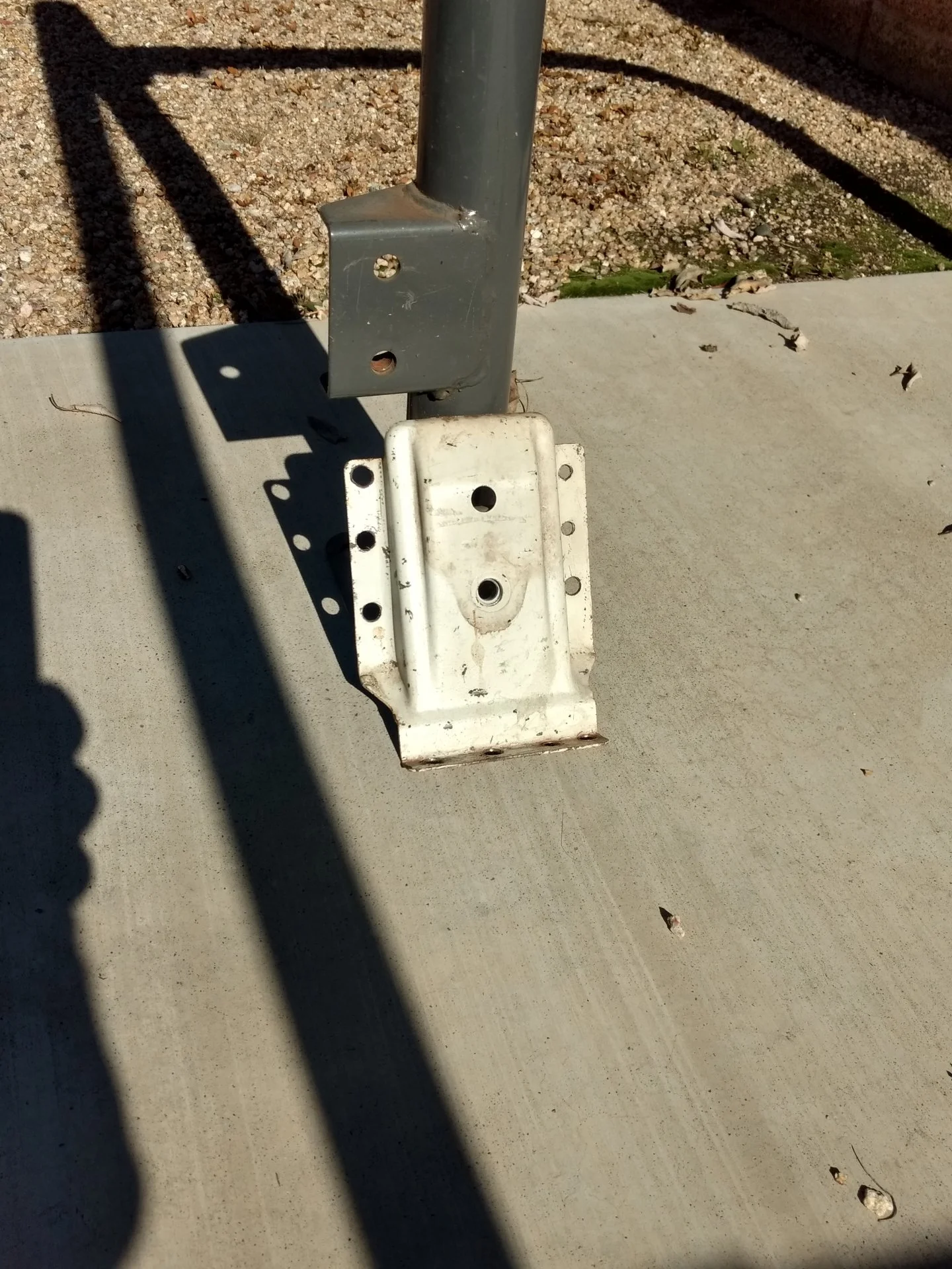

Roll bar would be the easiest to undo later.
Shoot what does that look like?
You can see it here. Most people think this is oem, because it’s so common. At one point someone stepped on it… that’s it.

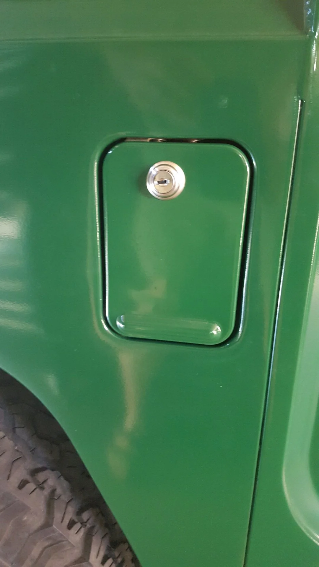

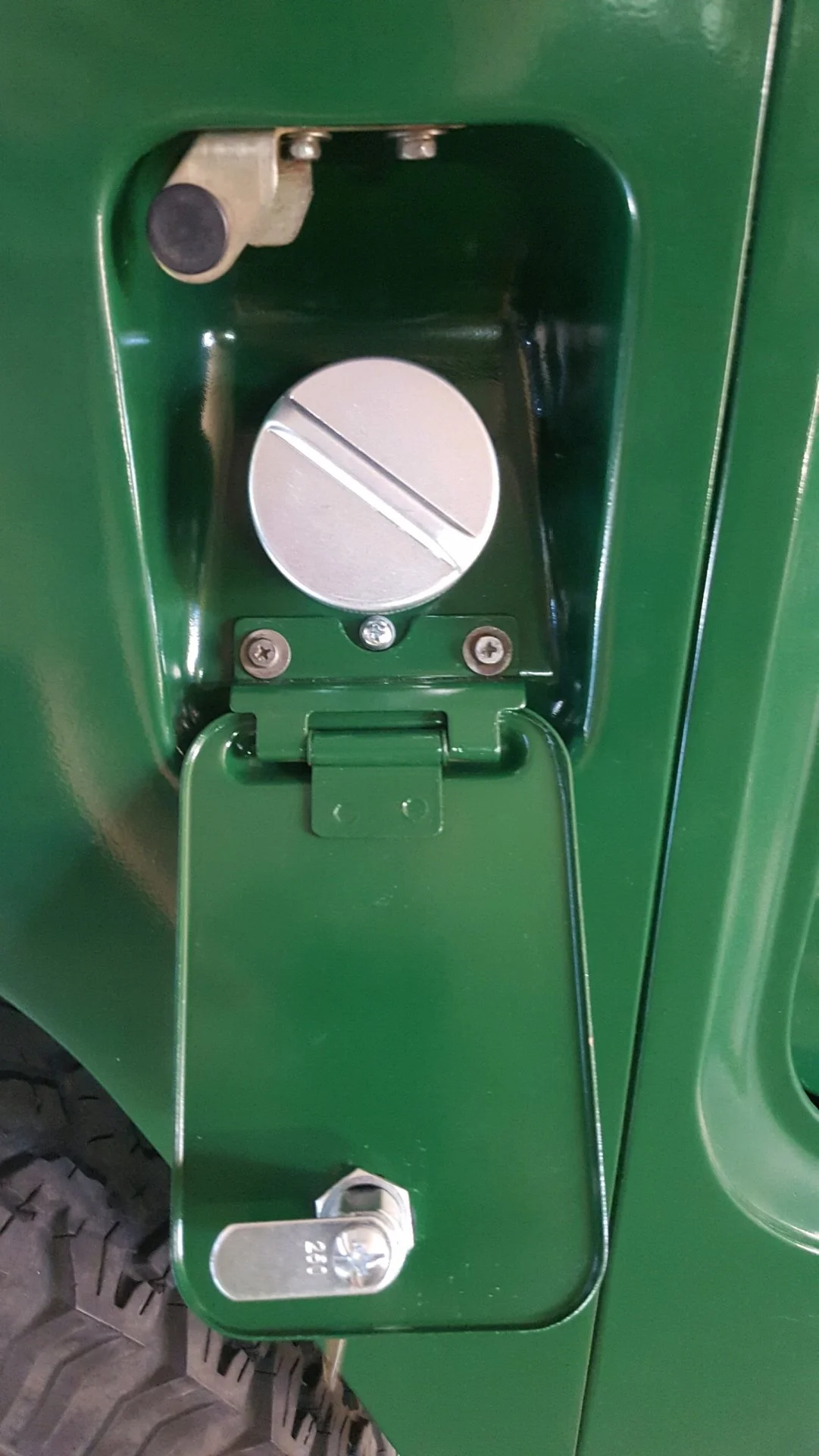

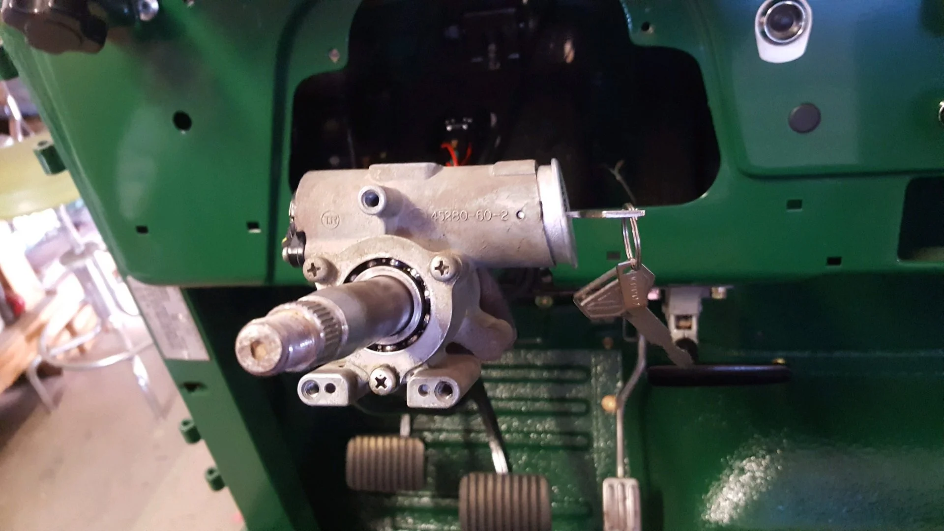

Fuel door situation is all locked up now. Learned a lesson about the column lock housing and key cylinder. I drilled mine out to much and broke it. Bought a replacement off Ebay. The new oem lock cylinder and keys are now functioning as they should. Got the rest of the parts to finish off the column. Leaving them off till it's wired though.
Need to remove a similar cylinder as you did. Any pics of what you mean by “drilled” it out? I would like to prevent a purchase of a new one of possible. Thanks!
Exquisite build!!!
To remove the lock cylinder, you need the key and it needs to be in the accessory spot. Then push in the release.
Other wise, carnage may happen. I think if you drill out the release deal, it would be best. Then buy a new lock cylinder.
Or take it to a lock smith......lol

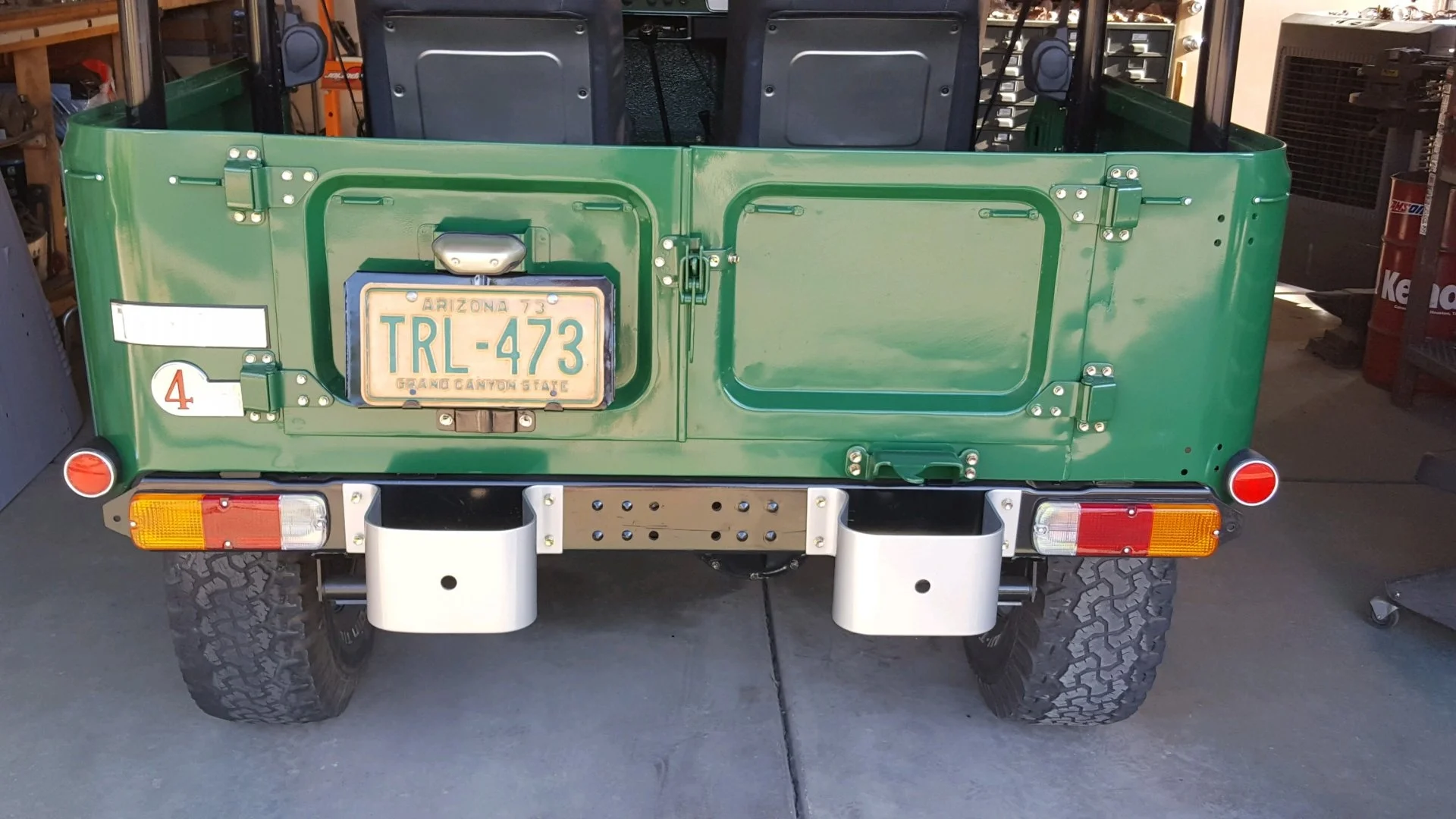

Did you check the clearance on the tire carrier before you put the lower side markers on?
Are you doubting Mr T? Those are the factory holes. Yes, it fits. I checked just for you.
