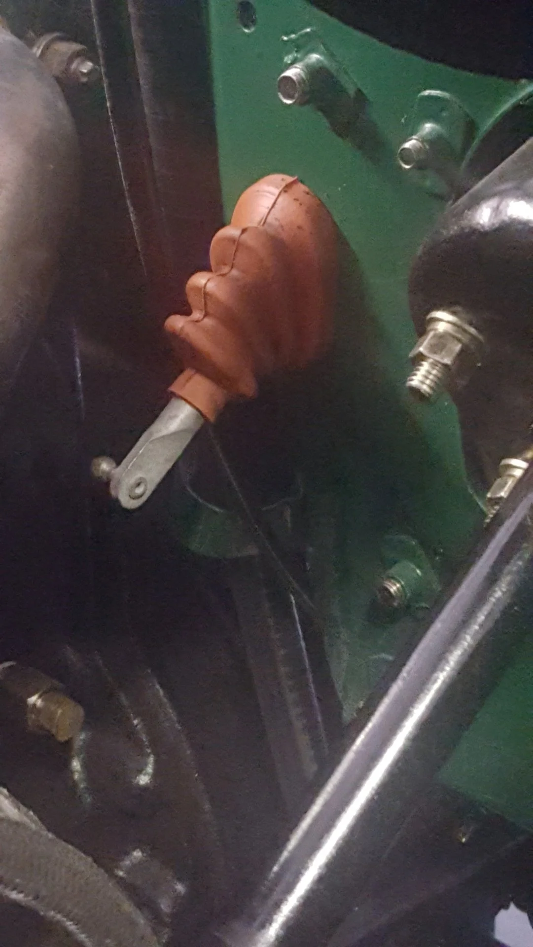

I got the clutch line and the front brake line finished. I also made and installed these silly charcoal canister lines and fuel separator doo dad. All hidden under these covers.

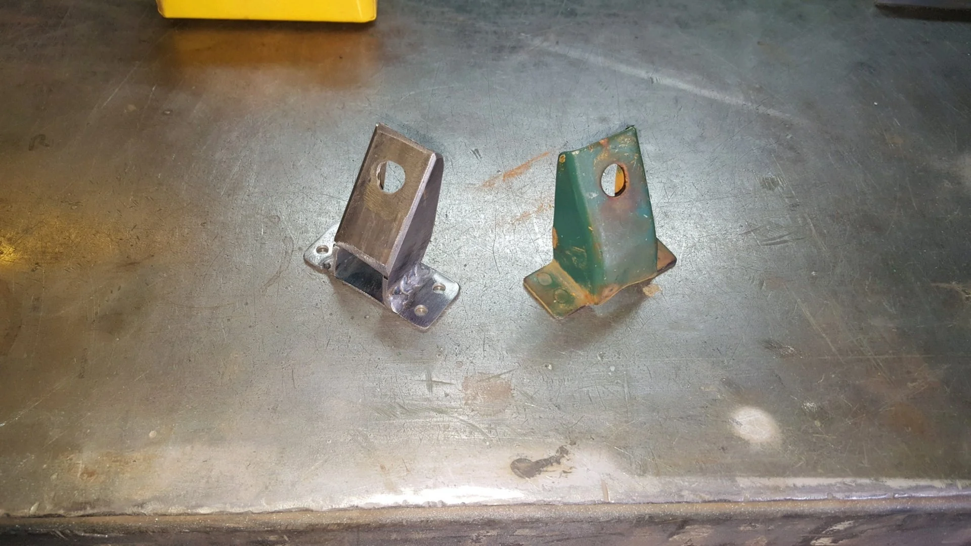

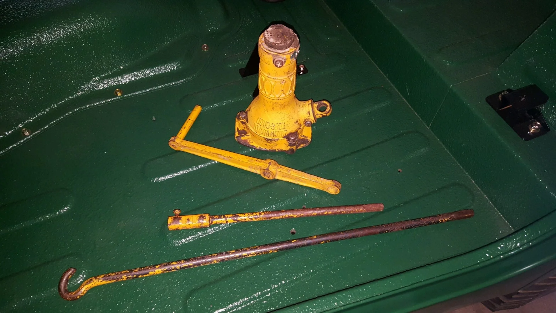

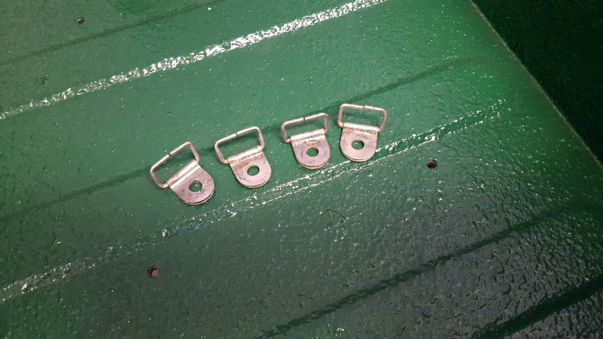

Gas pedal......need to figure out all the linkage. Here are oem hold down points for the tool bag mounted under the driver seat. It's amazing they stayed with the truck despite just being thrown in a coffee can. They look real nice in the picture, but are pretty much raw metal. I will paint them. Sorry no gold cad plating like factory.

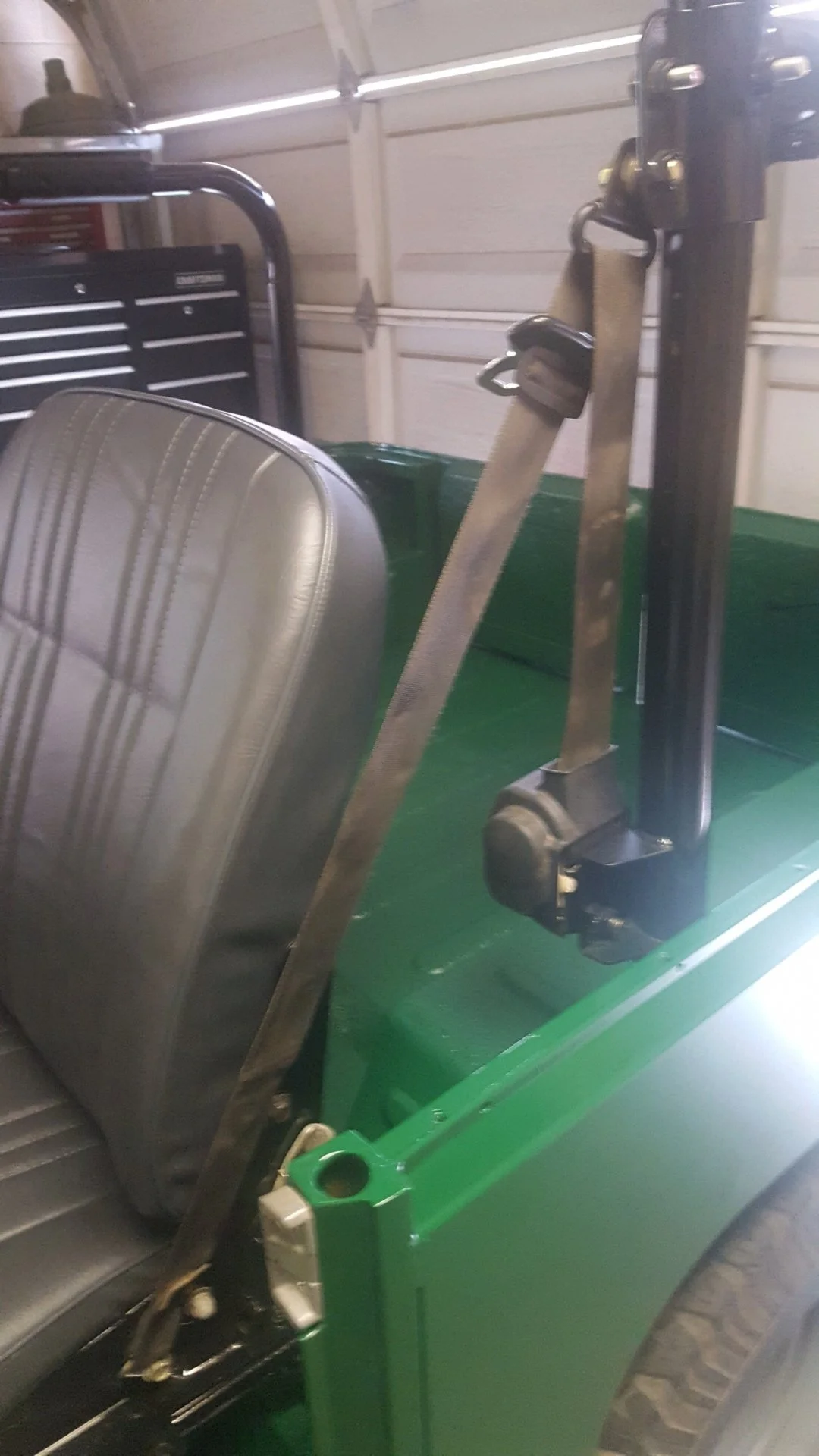

Figured out the oem dash layout and took inventory of my switches and pulls. I swapped out the originals for others I had in better condition. Cleaned them up and installed in the dash. I also made a short harness for the fuel gauge and installed that. Now the passenger seat and seat belt is bolted in for the last time (i hope...). 🍻

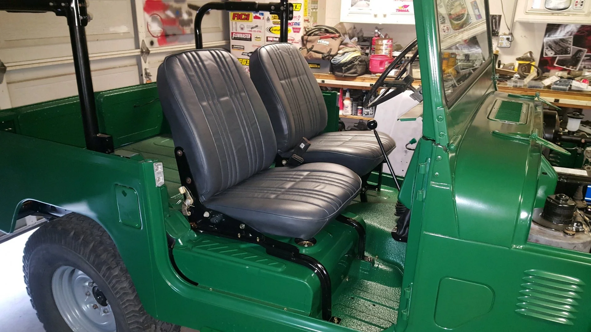

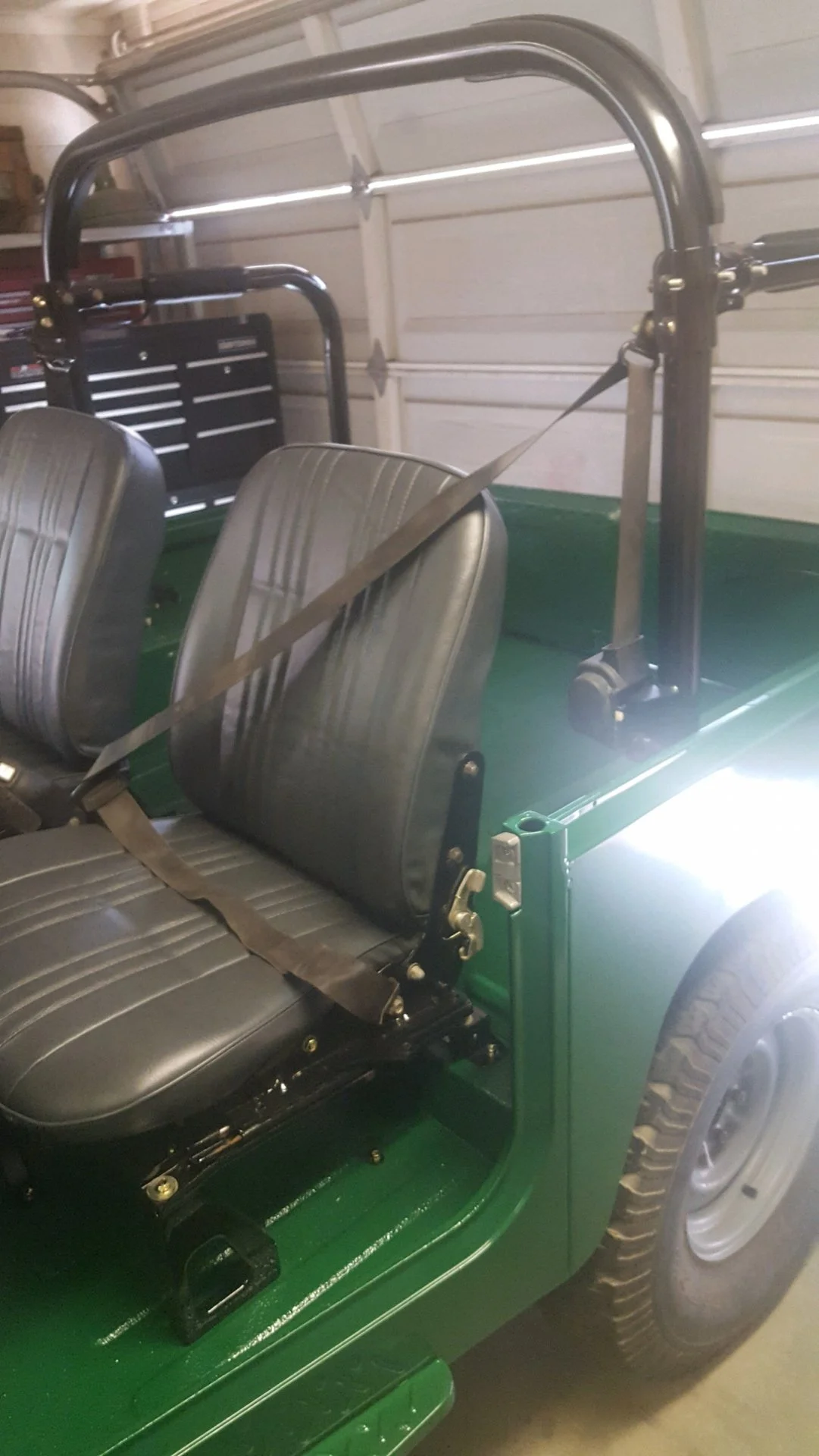

Bolted in the driver seat and placed the passenger seat in to get the visual. They might come back out for wiring access. Either way, I wanted to see how it looked and fit. Nice.......but alittle tight for me at 6'4''. :hillbilly:
Forgive me if you already know this, but the two rear and the front left seat bracket can be rotated 180 degrees. Then a short piece of flat bar with a couple holes can be added to the front seat brackets. It gives you a couple extras inches while keeping mostly stock brackets. It's easily reversible should the next owner want.
