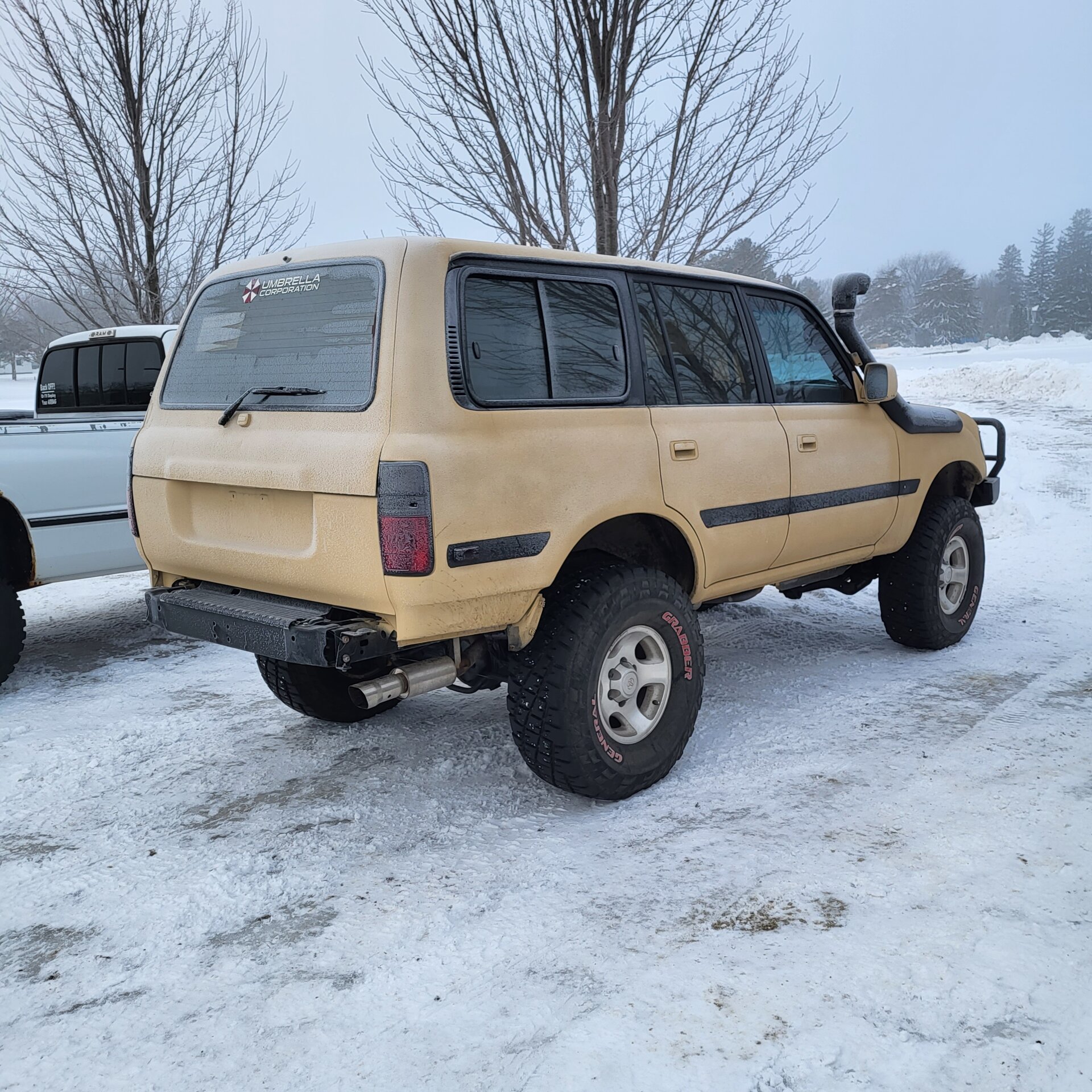

Popped up for sale locally. Very little rust. Some really sketchy shtuff going on with the wiring.
Almost made it home before the check engine light came on. 😆
It's got a nice winch in it, and a ARB bumper on it. Whole thing is covered in bedliner. 😆

Looks like I'm not the only one who recently picked up an 80 distraction to thier current 40 build haha
If that's the 80 I think it is, it used to be green in a past life
My buddy just picked up one that is green and covered in bed liner. Might be the same rig as his?
Mine came from Colorado. A shady dealer bought it on auction to be a personal rig, found out they drive mediocre, and it sat for almost a year until I picked it up
May be his, know it was for sale at one point not too long ago. Just noticed fenders are trimmed so not yours. It was also from Colorado.
