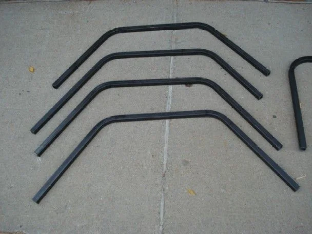

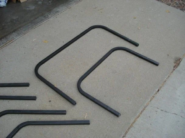

Here is what I got done yesterday. I spent the afternoon and evening at ullr's house, thanks again Ian! :D
Seems simple, and it is, but getting 4 pieces of tubing to bend at the EXACT same angle and make them mirror images by hand was quite the task. I only wasted one section, and I can use that one in making my "shelves" on the sides of the frame to hold a gas can or whatever. So I took the messed up one and pulled two 90* bends instead. I will chop that one down the middle to make two shelves... clear as mud?
I also pulled the top bar for the rack for the front cargo box. Simple stuff but time consuming for noob at bending.
I've got to know how you bent that square tube!!!! That looks awesome!!
Looks great there Drew,
What did you use for the making the bends, Or should i say what brand of bender?
It is a JD2 bender. What a COOL tool! The tubing bends like butter, I have had 2" .125 wall tube on it and it pulls really smoooooth. The only thing cooler than having one of these things at your house is having a friend who is generous with his... and lives like a 1/2 mile away! :D
All you need is a square tubing die... simple as that. Some dies are made for round tube, and other for square tube.

Are you planning on doing the lower part of the rack as a square, or will you have to bend it at another time?

Looks awesome! Want to see it outside, so we can get an overview of the project.... :)

Thanks bud. The rack top bar (the one pictured will be bent and welded/bolted to the lid of the front cargo box. The top of the box will be square to make everything water and dust tight.
Once the snow lifts, I will snap a few pics, but we have family coming in today... YIPPEE! :D so time in the garage will be happily limited.
