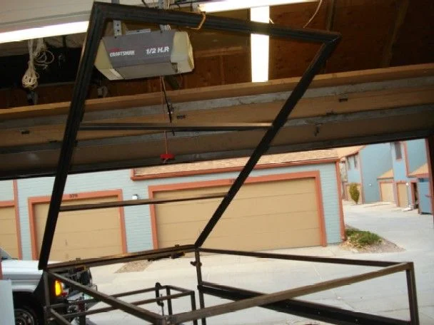

Got to work on the lid for a while today.

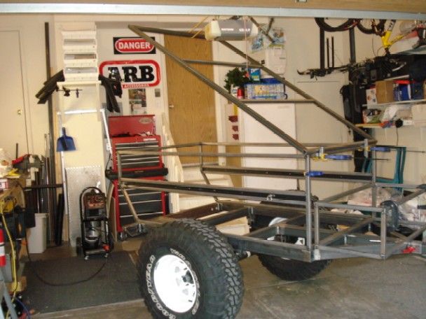

Here is where I ended up today, The frame is only tacked up and fitted. I spent most of the day welding all the seams of the big box and grinding... and grinding... and grinding all day long. Got everything pretty flush and smooth. Welding the light 16ga. tubing proved to be quite a delicate operation, especially when I was welding the ends of the tubing as it likes to burn up faster than the other sections. All in all it was a good afternoon.
Got a little camera crazy today. Here are a few more... :D
Tomorrow I am off to get more steel... again! :eek: For the tailgate and drawers and a few floor "spreaders," I have decided on a metal floor and I am going to make a few spreaders over the frame crossmembers since it will not have any strength otherwise.

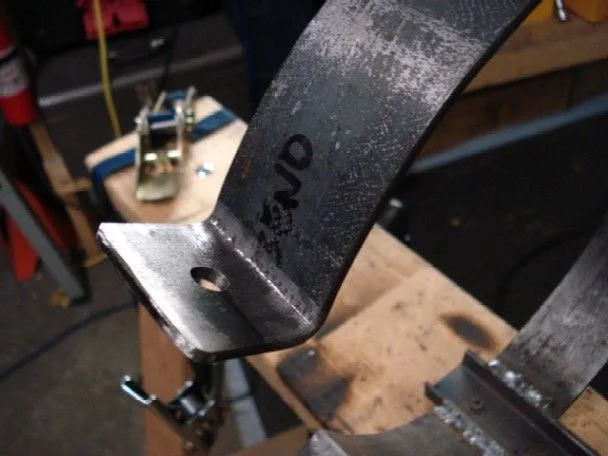

I worked on my propane tank mounts today and got them up and running. I had purchased a set from my local welding shop that open with a hinge then tighten with a wing nut. Once I had them in hand they didn't fit the tanks :( and they made the tank stick out nearly 2" from the sides of the trailer... not good... not only that but they were 60 bucks and not close enough to what I wanted to justify the cost, SO...
... I made my own! :D
I started with about 5 bucks in scrap material from my local steel yard. I cut two channels 8" in length. I drilled three holes to make my mounts foundation.
Next, I welded 2x.125" strap to the sides of the channel and hoisted the tank into place. I used the tank as a mold and started to bend the strap around the tank... I used a few ratchet strap to hold the tank in place and I screwed the foundation to the saw horse, this all worked really well.
Then, I tacked in the short side. I bent the tab over and then got the rough shape by bending the steel in my vice with a 3lb sledge. If you try this, just bend it a little at a time and after a few minutes a nice smooth curve starts to form.
Once the short side was in place I could trim the long side to the right length. Then it was time to burn in the welds, the first one I made the spot welds failed once I really started getting after the bending.
After that, I just had to bend the last tab over on the long side and drill a hole for the bolt to go through. Then I used an adjustable cresent wrench to man handle the bolt holes into place and I can bring the two parts together tightly by tightening the bolt.
You can see how the tank mount will "bolt" up to the frame of the trailer.
Woa-lah!
I have two custom propane mounts now. I will secure the bottom of the tank with a bolt to the deck of the trailer, but other than that I may create a way to lock them up when the trailer is parked in town.
I ordered 2" wide rubber strips to insulate the tank from vibration and keep it from getting banged up by the mount itself. It is good stuff and has a nice adhesive back on it. After paint I will put them on.
Whatta' ya think?
