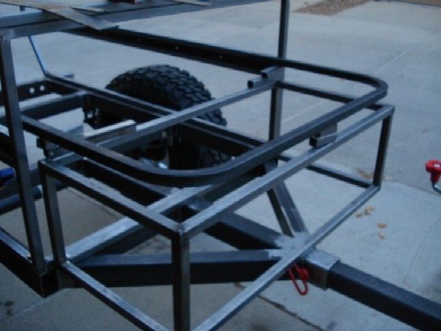

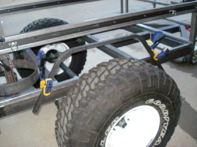

Here are a few new pics.
Pic one: A little overall veiw of where I am at.
Pic two: How the front rack will sit once the lid is created.
Pic three: Rough placement of fenders and how they will eventually look. They will be cut down to sid on top of the cargo box bottom rail and will be bolted to the sheet metal.
Two more

what are you using for bending your tubing?
My buddy's bender, it is a JD2 with a square die.
