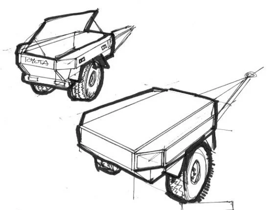

I let this idea die until I realized that I can now bend square tubing. I might re-think my side box idea. It is a great idea that I got from AT's Horizon trailer... which is 'da BOMB! :D
My main hesitation was the idea of attaching sheet to round steel, but now the square tubing gives me easy mounting of the sheet. Whatcha' think?
Here is a rough sketch...
Looks good, but I think angling the "panier" boxes is more work than it's worth. I'd go for rectangular, like on the Horizon.
More work, yes, but it fits with the overall design scheme he has working:)
Ed
Ed
Agreed, if I didn't care how the overall thing looked, i would be a blessed man... with a HUGE box on a bomb proof frame and would have been done about 2 months ago.
...8 bends a few stringers and the boxes are done... yeah right! :D
