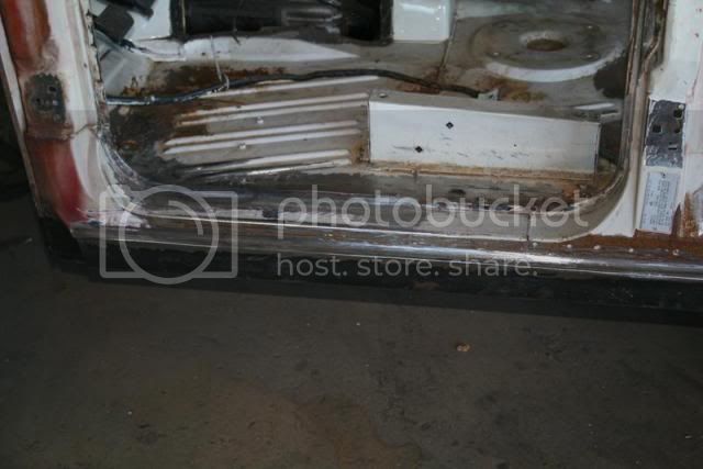

I also drove over to Knuckle Busters 4X4 to see how they are doing on the welding. I have to say, those guys are artists. The work that they have done is amazing. I took some pics, but Graham over there wouldn't let me take a lot because he wasn't done with some places. Too funny. Good to have a perfectionist working on your truck. I'll try to do some before and after to show the changes...
Driver's side floorboard before (note hole in floor)
