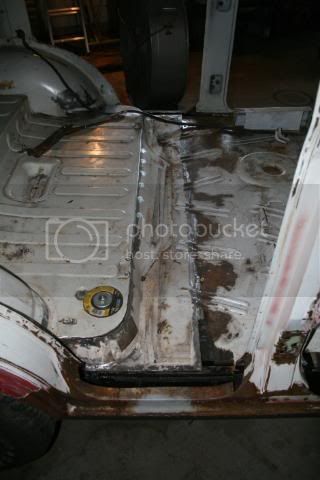

Well, I haven't posted up pics in a while...so here are some of the progress over the last few months. It's not been a lot...but it's enough right now!
Here are some pics of the floorboards where we cut out the roT;

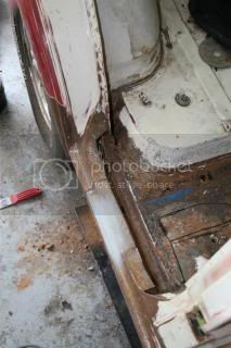

Rocker repair....

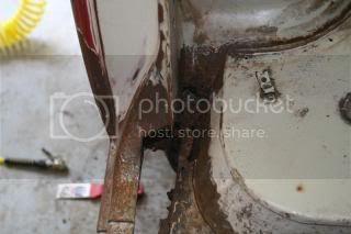

Door repair with POR putty. Filling in holes and what not

question, how did you like working with the por putty? I thought about getting some of that stuff. seems like it would work nice for the smaller holes. I have some por putty but have heard it is a little too soft for holes larger than pinholes?

Thanks Noah. The thing is that I kind of like the tedious work. I am a bit of a perfectionist and I just know that I'll find stuff that won't be done the way I was going to do it. I am sure you know what I mean!
As for the putty...that stuff ROCKS. I have seen mixed reviews before, but I gotta tell you, I like it. It's MUCH better at filling holes than the POR patch. It's the consistency of modeling clay and sticks like gum to whatever you push it onto or into. That door was rotten at the bottom to the point that it was wobbly because there was no structure. I put the putty on the outside and the inside and let it dry overnight. Once it was dry, it was on there. The only thing I'll tell you is that it's a pain in the ass to sand. Since it is so hard, it doesn't sand quickly like filler. I ended up using a flapwheel on the grinder since I overdid the thickness a bit.

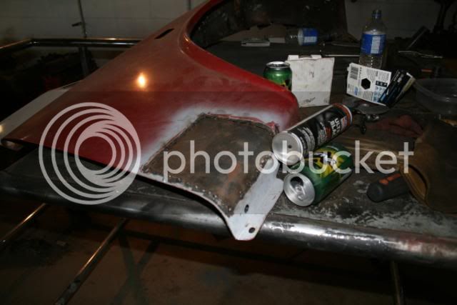

Here are the fenderpatches. The first one is done, and the second is only tack welded.

Looks like good work!
Dang - those sliders are nasty... :grinpimp:
Nah, they aren't too bad. They just look bad since they are rusty from being outside. You didn't do too bad at all.
