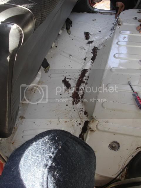

So, I started the bit by bit body work on the new pig yesterday. I can't strip it down completely because I am going to have to drive it for a couple of weeks while I get my FJ Cruiser repaired (I had a little tree accident).

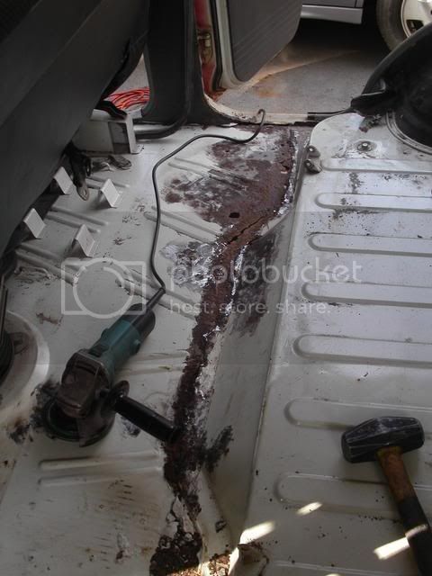

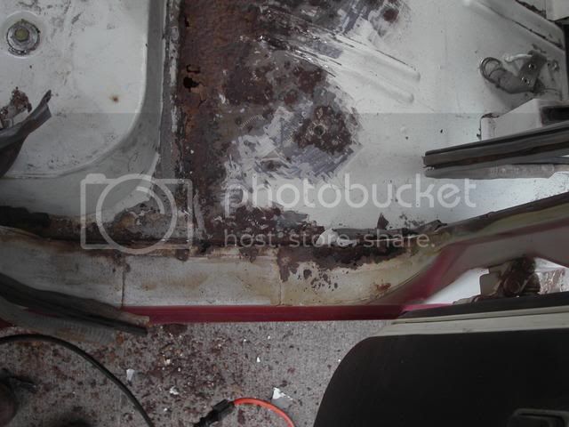

After replacing the electric fuel pump on Thursday I started unveiling the rust issues centering around the rear floorboard and rockers. Here's what I have so far...

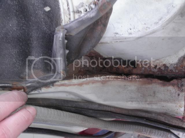

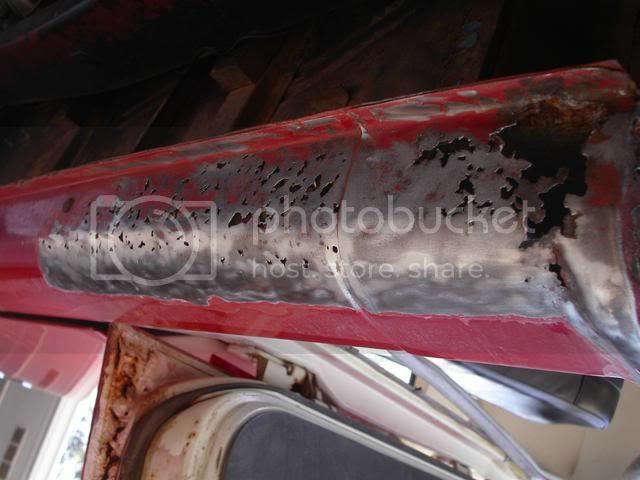

The floorboard is ready for a patch and I am still trying to figure out how to fix the rockers and rear QP corners at the rocker.
Ummm, did we forget the fingernail polish today? I got the factory optional rusted flooboard just like you did! Wow, I can't believe that paint hid those swiss cheese rockers like that! You gonna trim them up or try & patch? I'd be afraid to weld anything to those as you'd be burning through & chasing holes, BTDT!
I don't know about knocking it out in no time, but I am sure I'll figure something out!
Fingernail polish? I'm lucky I have fingers after learning to use the grinder today!
I am thinking about taking aluminum flashing and forming it to the shape the corners are supposed to be, then coating them POR-15, sticking them on with POR Patch, putting fiberglass over it, and then some filler to finish it off. There's nothing to attach to in those areas, so I thought the added aluminum would help give some structure. I don't want to put aluminum right on steel because of the potential reaction issues, so I think isolating it with POR-15 should do the trick. I dunno...but welding right now isn't an option since I don't know how to do that and there aren't any replacement panels available yet.
maybe Ehsan or Paul will come through sometime in the future with panels..............amazing what pretty paint, fiberglass and bondo can cover till you take a grinder to it............ mine looked pretty till I took a grinder to the "bubbles :( looks like most all of us need replacement panels !

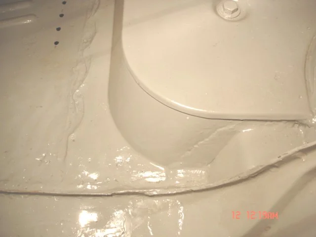

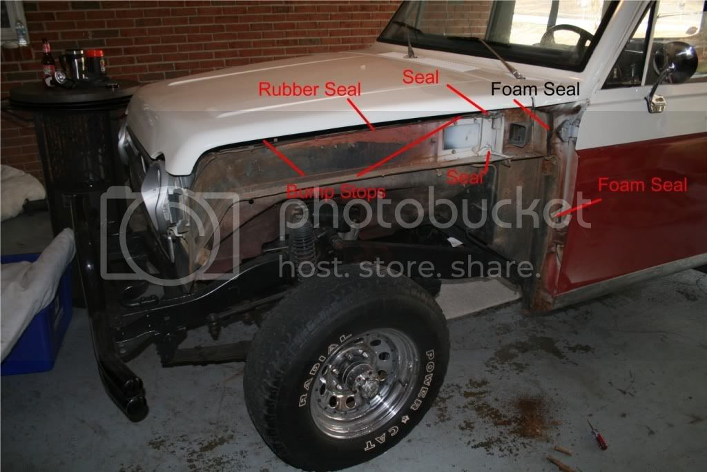

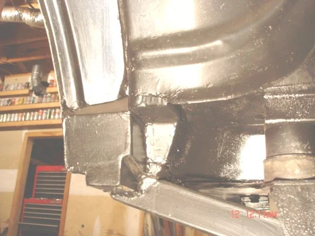

There was so much rust through, I had to cut & refab the rockers & the ends & the rail where the weather strip mounts & part of the floor. I also drilled some drainage holes in the lowest part of the rear floor. Don't forget to check the front body mounts as I had to refab those too. I still need to clean up the front a little - used a little too much POR patch. Hopefully this *may help:
That does help Chuck, thanks. One thing that I am not sure how to do is to rebuild the rusty door stops. The ridge that the weather stripping attaches to is gone on both sides. Any suggestions on that?
One option you may consider to take care of those rockers and rusted lower front fenders are Lance's (IPOR) sliders. For $184 that would save time, money, heart ache, and provide protection if your ever thinking of wheeling that pig. As far as the ridge for the weather stripping...maybe you can persuade Gumby to put a little sheet metal in a brake for you (outta be able to get most of it back). In the long run a little mig would serve you well. Take a class at a votech school and think of the fun you could have. Also, some compressed air and a nibbler to round out the field.
Well, my brother and I cut out a piece of sheet metal that fits really well. We'll tack it into place when we are ready, but I think it will fit the bill nicely.
