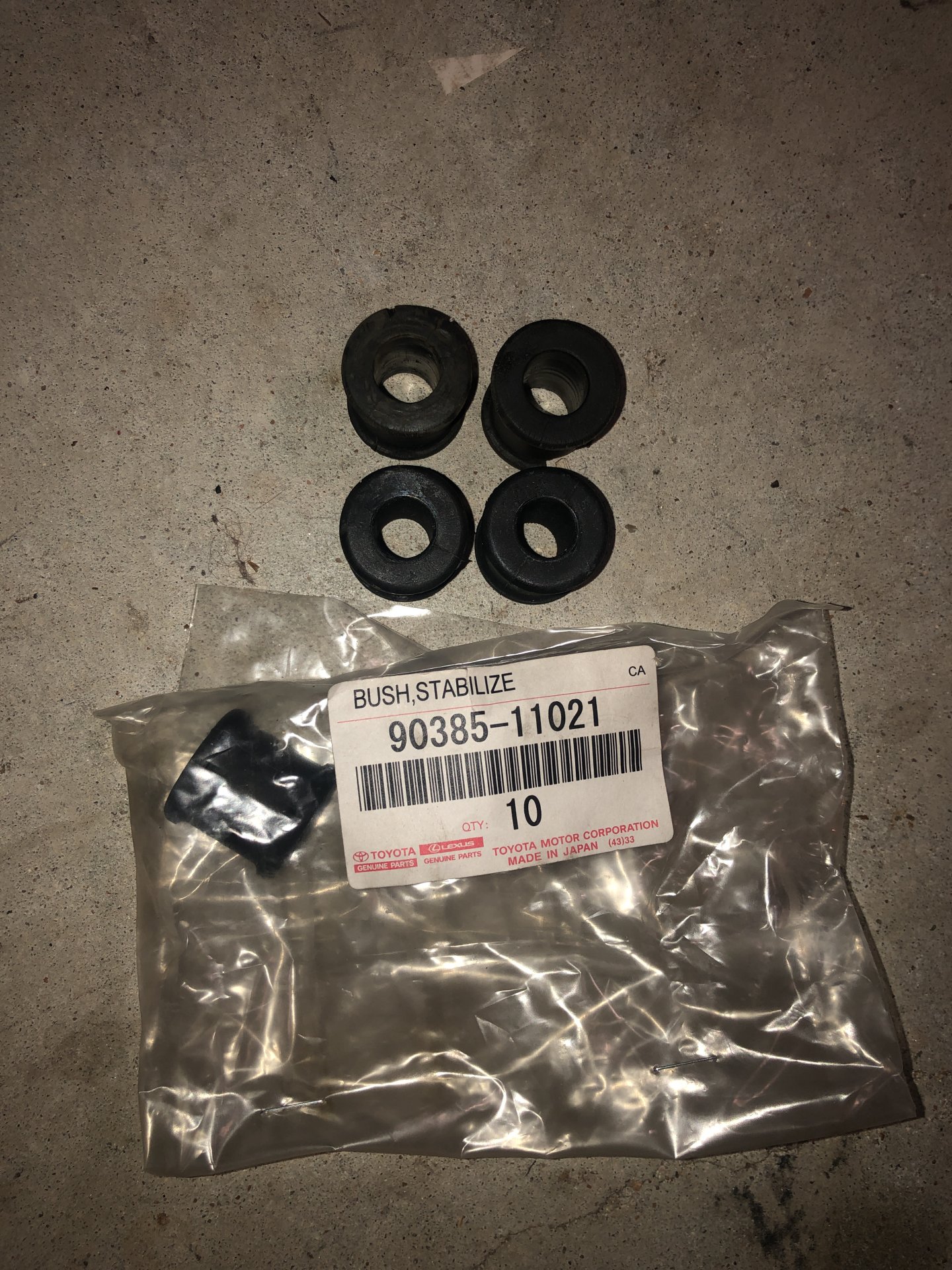

A couple weeks ago, I got the sway bar mounting cushions and put them in and also drilled out the center skid plate bolt that was broken by a PO.
This cushion really helped firm the corners.

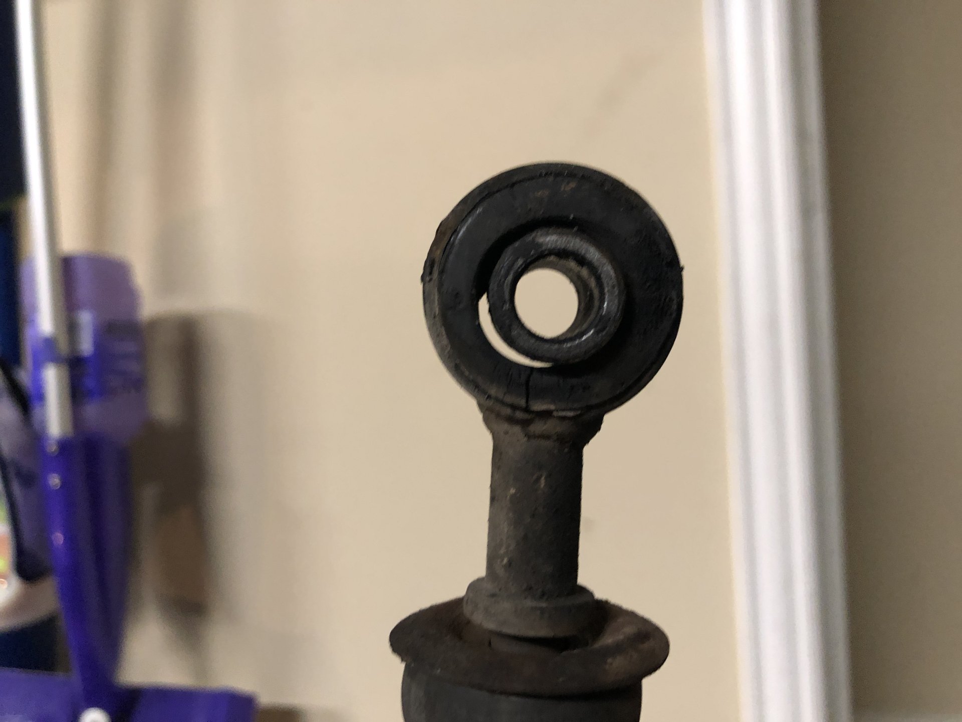

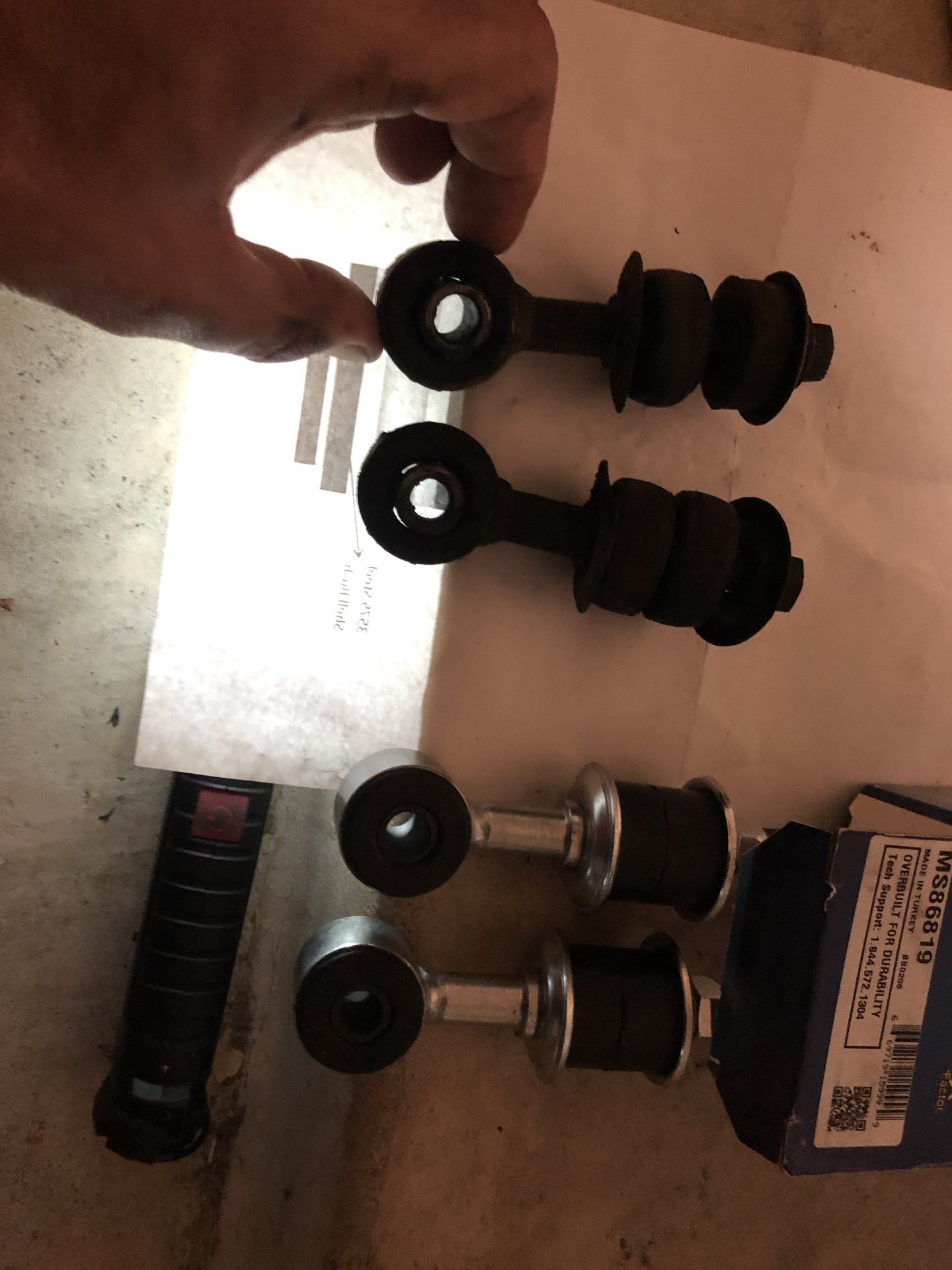

About a week ago, I replaced all the front sway bar bushings and end links. They were well worn. Much firmer around the corners and I don’t feel the push as much around big rigs. The Metal "Eyes" have completely broken loose.
There were pieces of Fabric Tape on the inside of the old sway bar bushings. You can see how wallowed out they are.
The metal "eyes" just fell out. Notice the bend in the bushing washer.

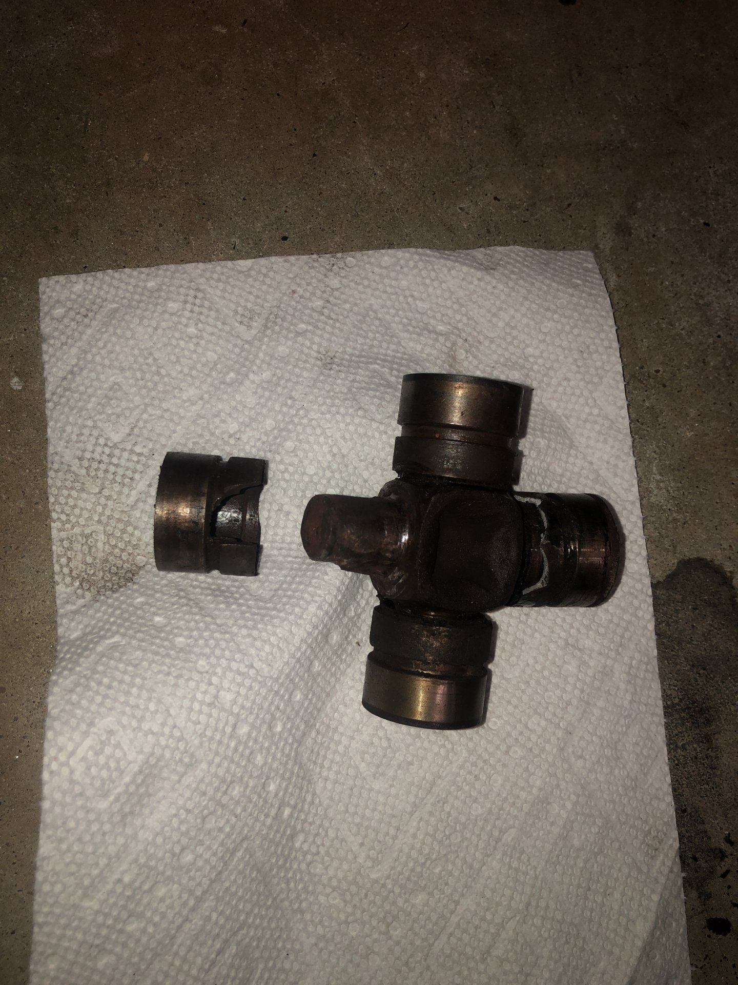

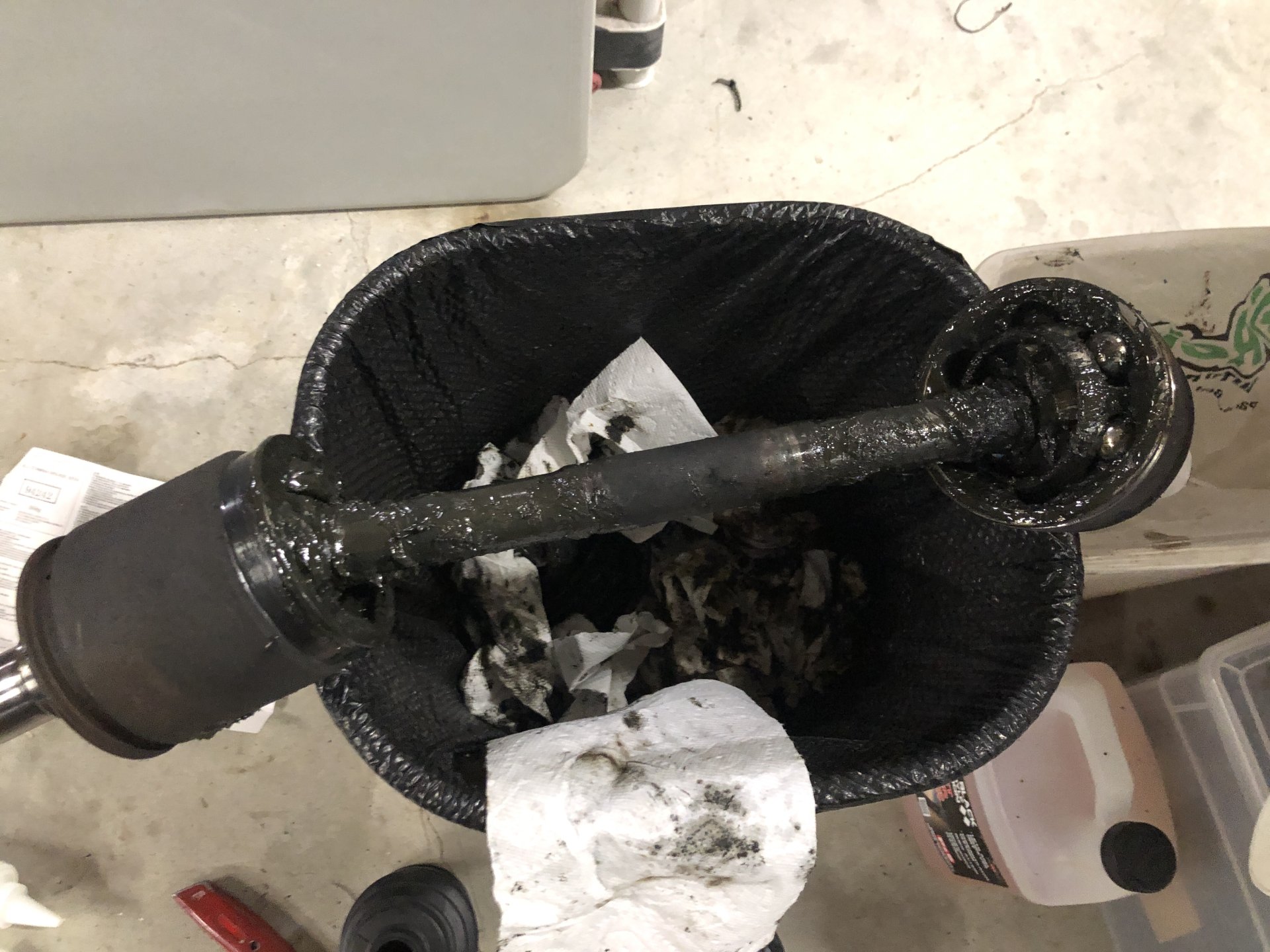

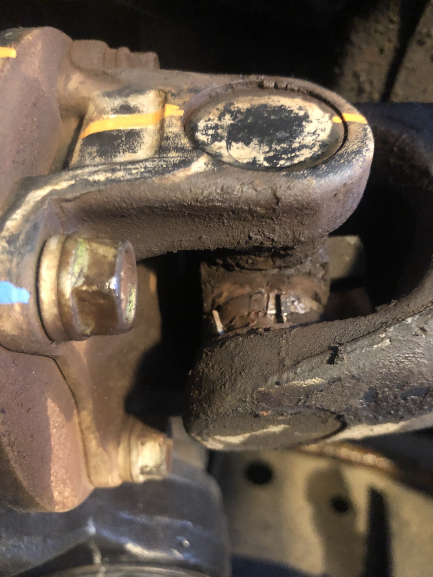

Yesterday, I felt a change in my normal vibrations that I have been suspecting was U-Joints. I crawled underneath and finally found the culprit and this one is bad. Probably the worse I have ever seen.
Caps were broken
The awful wasn’t revealed until I got the front driveshaft out.
After driving the caps out, I found one cap had no (zero) needle bearings and dry.
The opposite cap was mostly dry and had bearings starting to seize.
These have been done before as I could see the marks. I cannot make out a brand but it is not Spicer / Dana or Factory.
I had no extra debris after driving these out so everything broke on the road. You can see how bad it is. I am surprised it stayed together. I don’t need a driveshaft coming through the floorboard.
Grease was in the perpendicular caps and they were surprisingly tight. This photo is not cleaned up. This is how dry they were.
After pulling the driveshaft, I locked the center diff and went for a drive and had the smoothest ride I have ever had in it. It is comparable to our LC now. All vibrations are gone.
The rear U joint is surprisingly tight (Actually feels new) and grease comes out all caps.

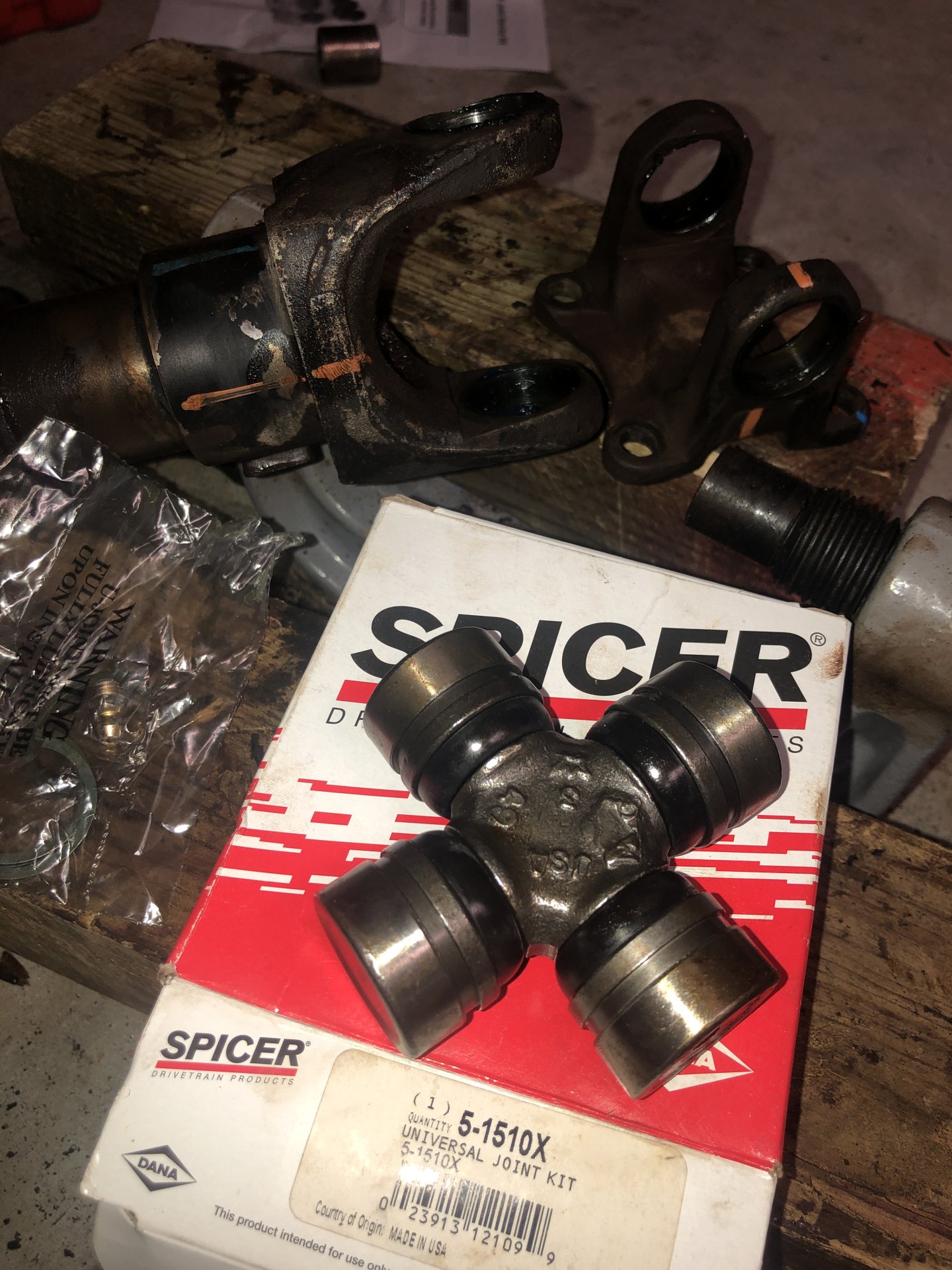

I cleaned up the Cap rests and pulled the slip yoke out, cleaned the zerks and splines and polished the slip yoke shaft and regreased the splines and put it back together. I had to wait to finish the install because the impact was too loud for that late at night.

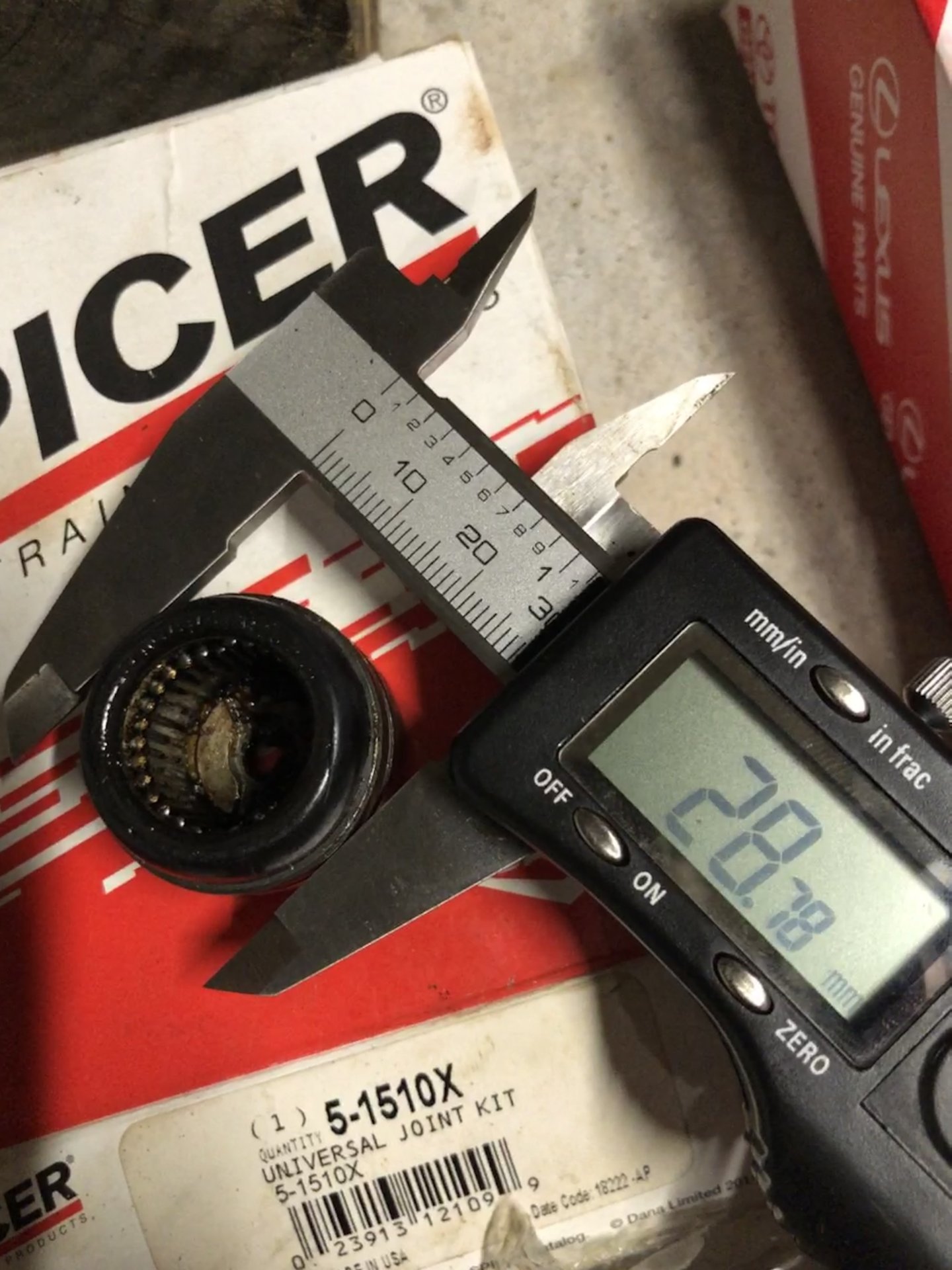

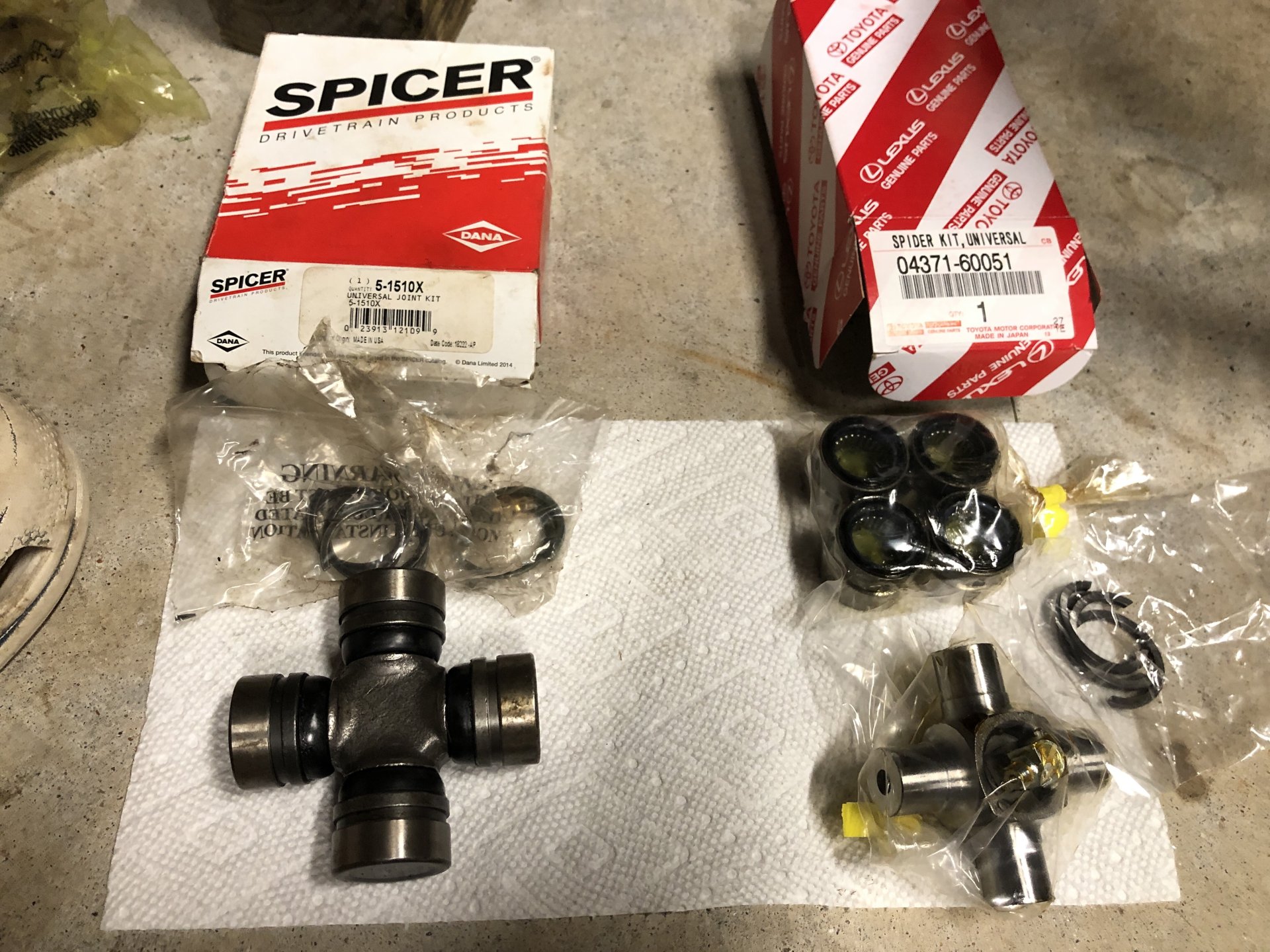

I will be using the Spicer/ Dana 1510X greasable.
Drove it to work today without the front driveshaft and it was great.

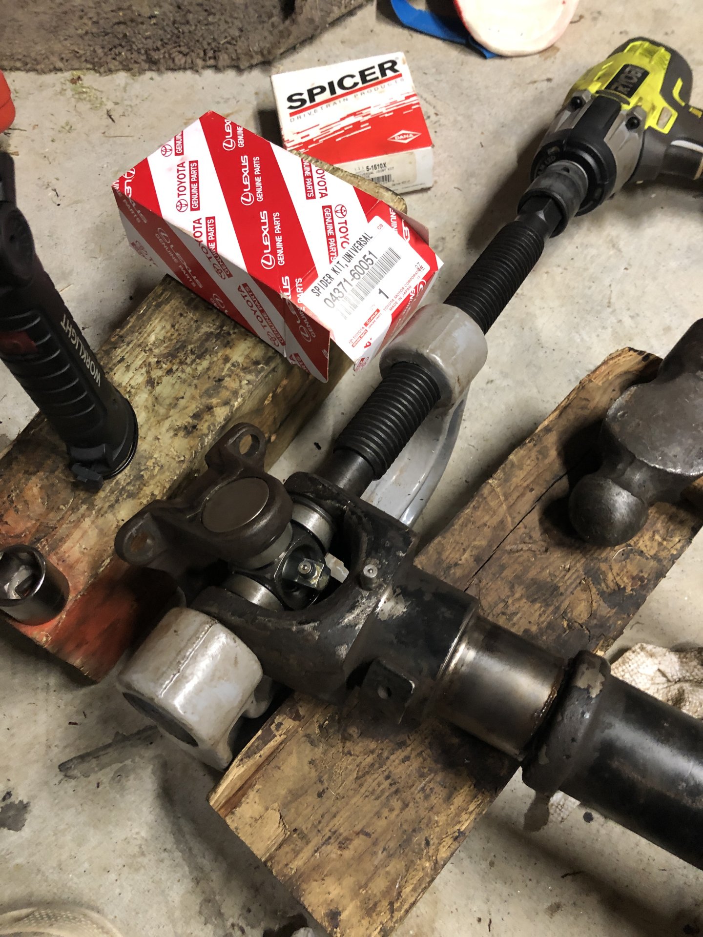

Well, come to find out the Spicer 1510X won’t fit in the front driveshaft so I ordered a couple of Toyota OEM ones. I understand they will fit in the rear driveshaft. The Spicer was a full mm larger than the OEM one. No wonder it wouldn’t fit. The OEM one went right in. The old one I took out looks exactly the same as the OEM one so I will assume no one greased it until me but by that time it was already clogged and dry.
Those ball joint presses make easy work of the U-Joints. I also cleaned out the Slip Yoke and polished the shaft some then regreased it and put it all back together.
I greased it all up and put it all in and she is super smooth (as smooth as it is w/o the shaft in). No more vibrations for me!

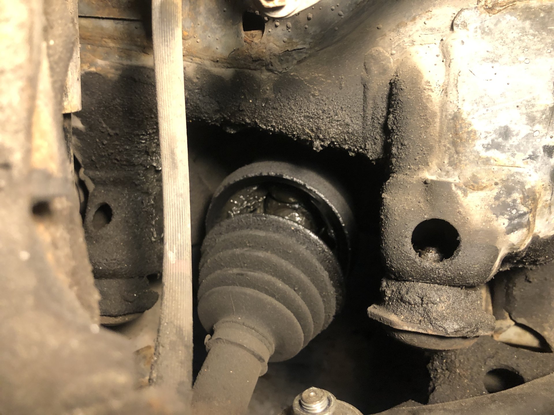

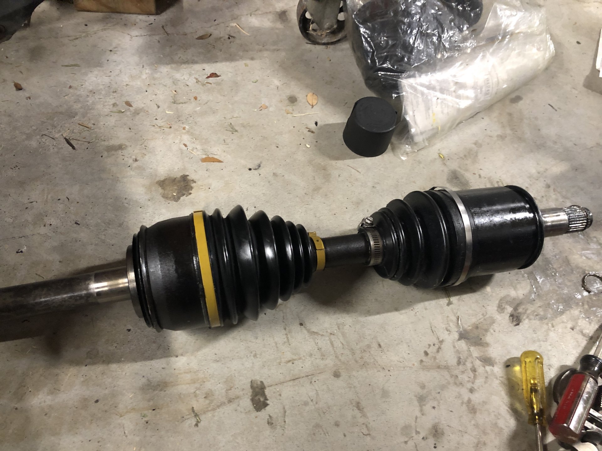

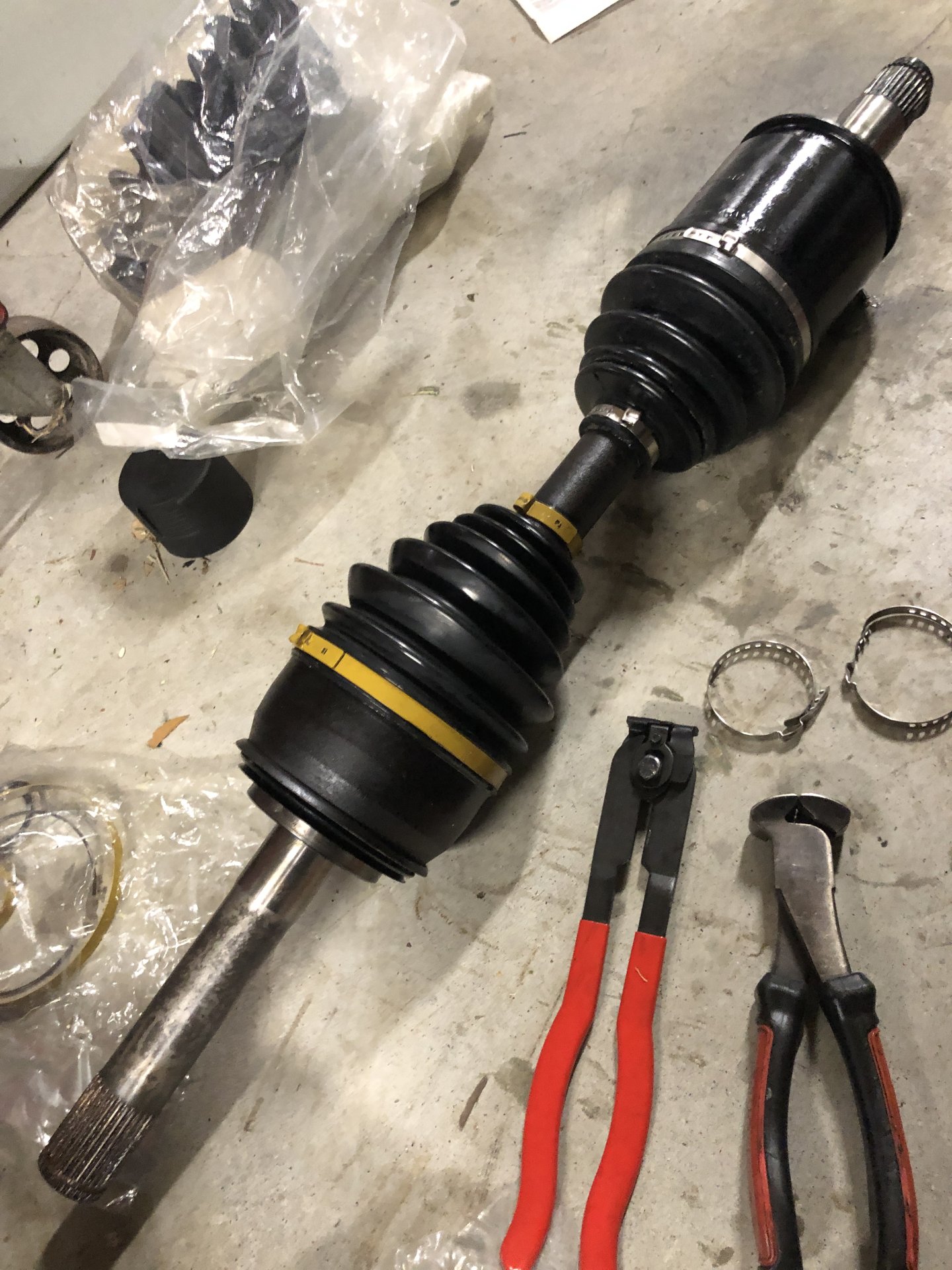

I bought some OEM Toyota reboot kits for the CV axles a while back when I discovered they were all broken.
My least favorite job. Dirty, long, greasy…
Using Purple Power, a roll of paper towels and a can of Brake Cleaner on each side got them cleaned up, painted, regreased, rebooted, and put back together.
Neither of the inner clamps fit. Luckily I had a clamp kit from my 4Runner (that took me half a day to find). I find starting the clamps with the End Cutting Pliers and then finishing off with the cheap clamp crimpers works best. You can see how loose the big silver clamp is in this pic. Worm Clamp was temporary while trying to clamp the big end before finding the old CV Clamp Kit in my garage.
The Yellow Clamps fit perfect.
Everything all pulled out. Look at all the grease sling build up. I also need to replace the rubber Brake Lines as they have gotten soft from the Power Steering reservoir leaking on it.

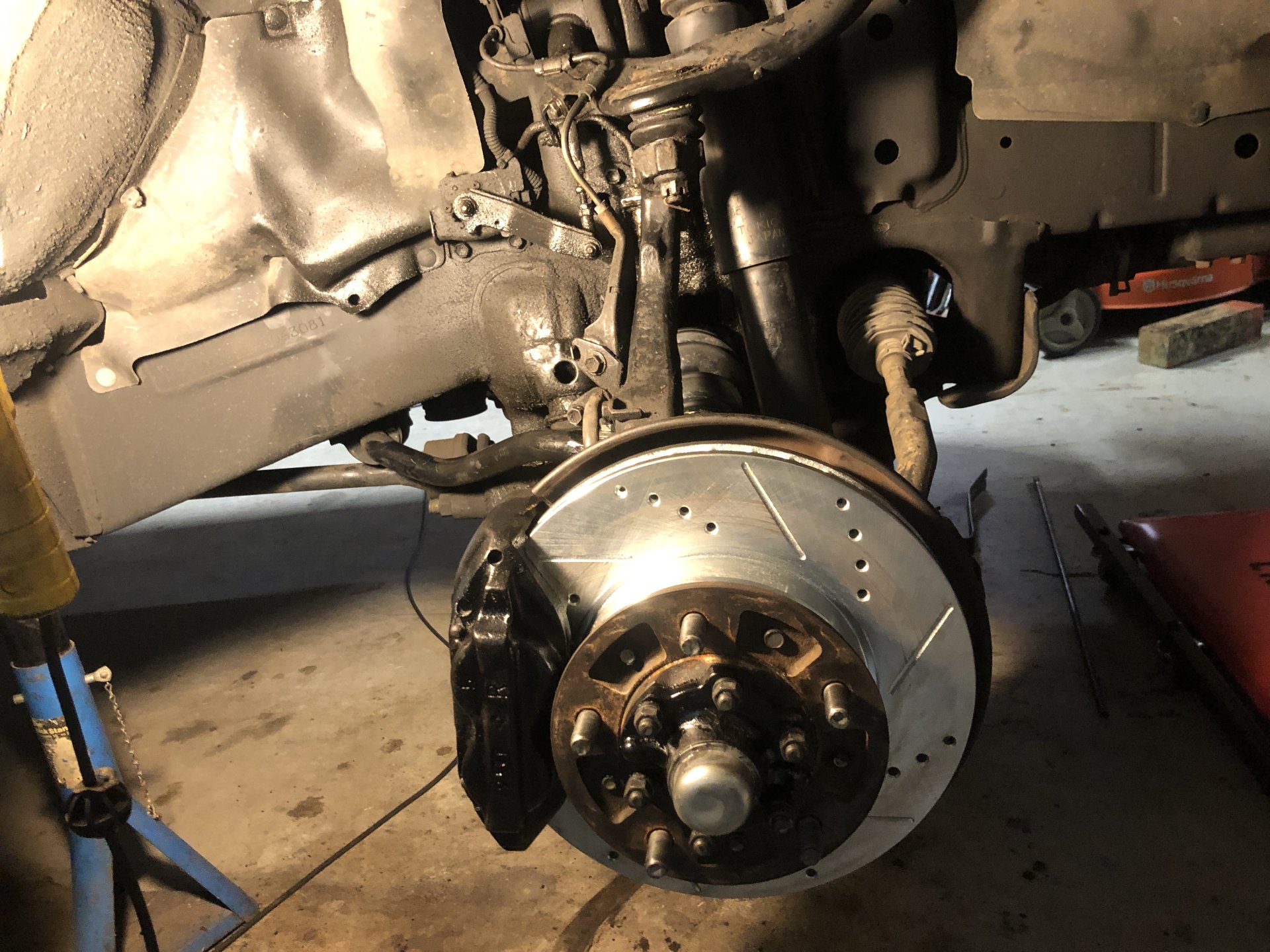

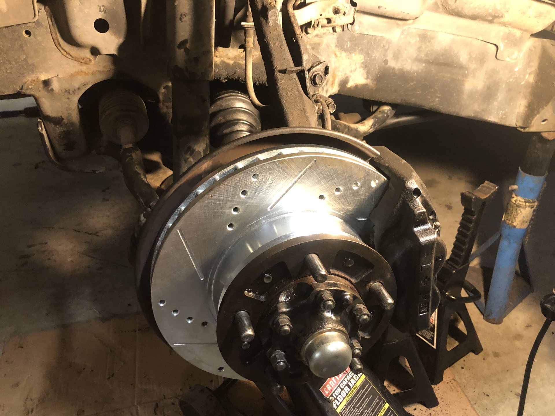

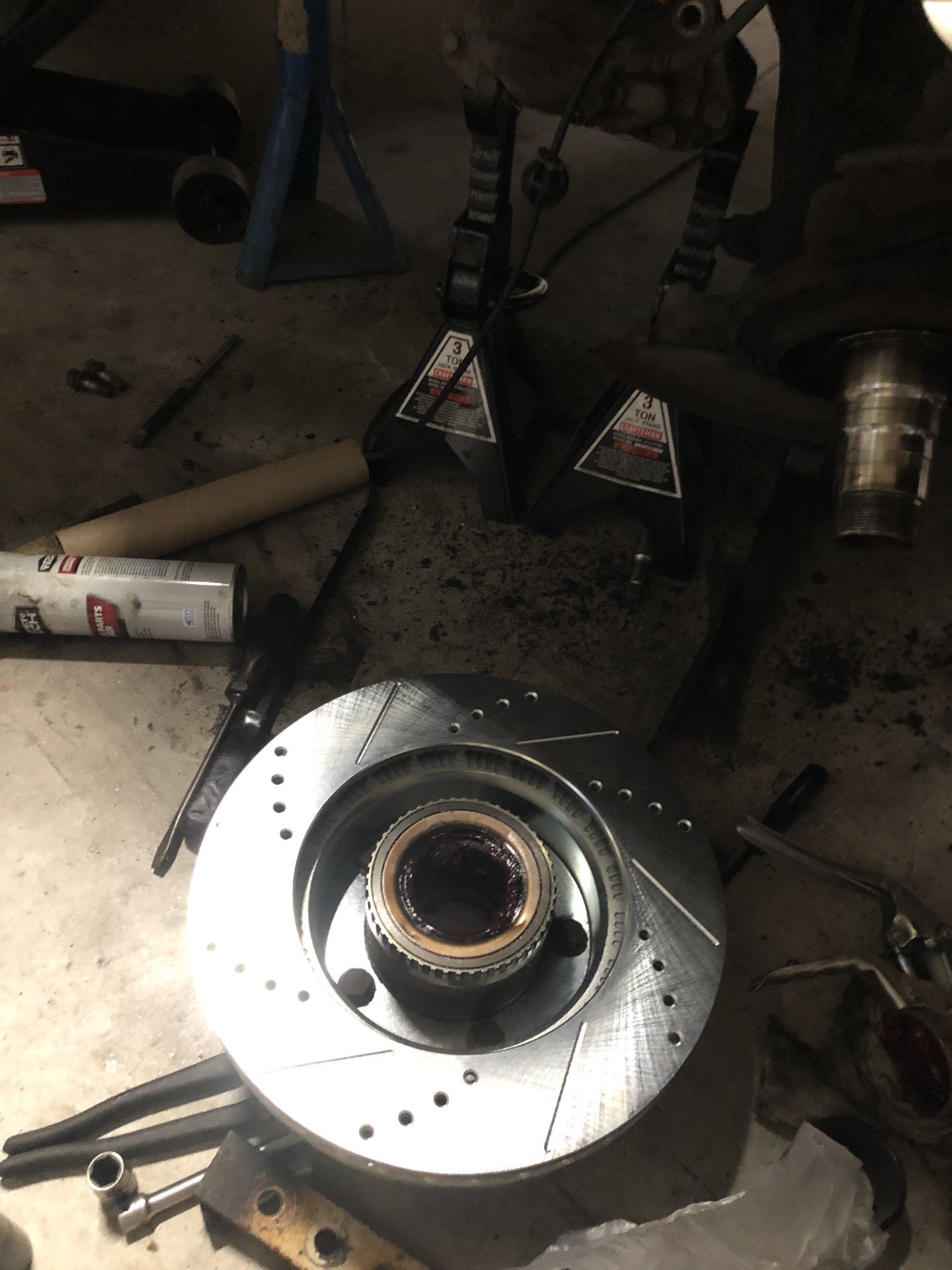

“While I was in there” I decided to swap the front brake rotors and pads as I had the pulsing brakes to a stop. It was very light but noticeable.
I went with the Power Stop Z23 Evolution Sport Brake Kit (K1132) for the fronts. I purchased this a while back from Rockauto.
It has High performance pads and slotted and drilled zinc plated rotors.

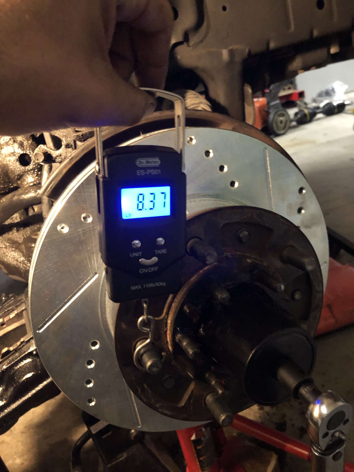

Of course, if you do these front brakes, you might as well repack and check wheel bearings. I cleaned them all out (as much as I could and repacked all the bearings with Lucas Red and Tacky.
Bearings and races looked good.
Those rotors look good.
Bearings preloaded to 43 ft lbs then 43 in lbs then tightened until we got in the mid range with the fish scale.
Taking them off, passenger side was fine, driver side was too loose. I bent the star washer and unscrewed the lock nut and bearing retainer nut by hand. Scary…
I threw a quick coat of black engine enamel on the calipers on and buttoned it up. The pads that where on it did not have the bottom springs that separate the pads from each other at rest.
Driving impressions- WOW!
I wasn’t able to get the double pump the brakes syndrome completely solved and haven’t wanted to send the master off to that guy that rebuilds them yet but after bedding in these brakes I don’t feel the difference between a single pump and double pump.
These brakes grab!
They grab so much so that I have to learn to drive it differently. I am thoroughly impressed.

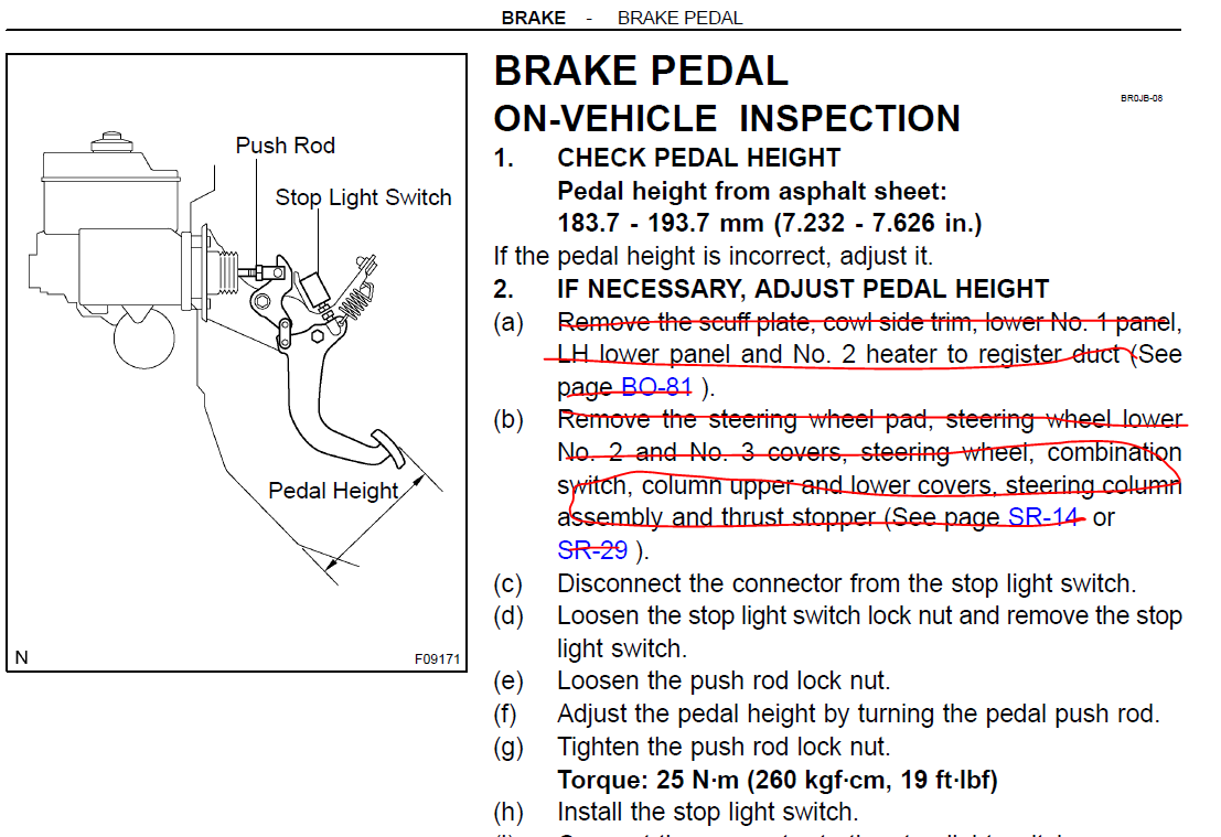

Good work!

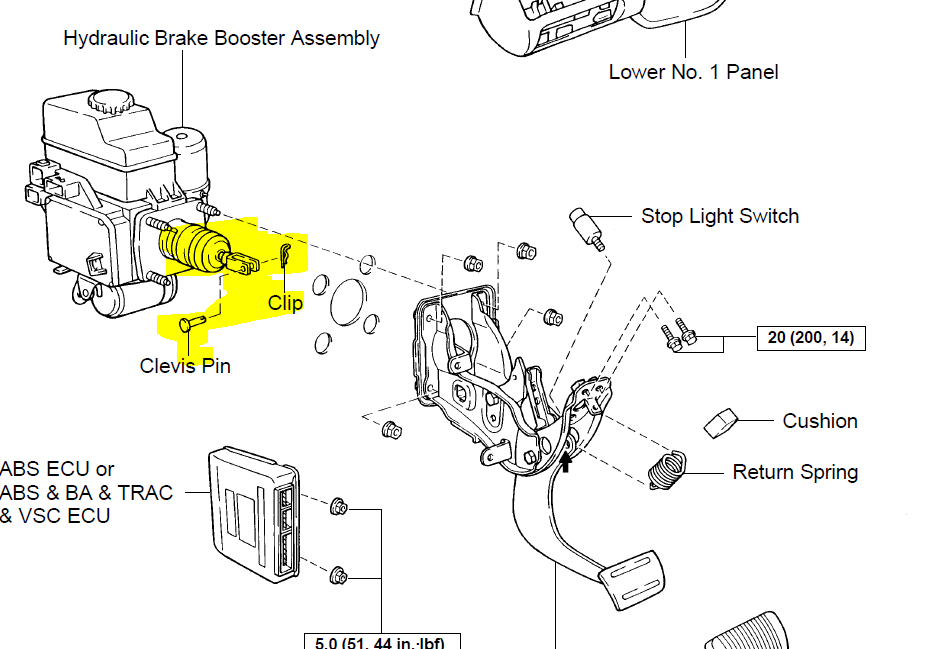

When my 98 had the double pump issue, I got sacred and replaced the booster motor and booster and rebuilt the master cylinder. To my dismay the double pump issue remained :bang:
Many moons later someone suggested adjusting the pushrod length where it connects the MC piston to the brake pedal. You have to take the clevis pin off to be able to turn the pushrod connector to adjust the length.
So I put the truck in neutral, took off the parking brake and starting adjusting the length until the brakes started dragging. Then I backed down just a smidge and tightened the lock nut. That took care of the double pump issue.
See the highlighted part of the diagram below:
Here's the procedure from FSM. I crossed off the steps I didn't have to do:

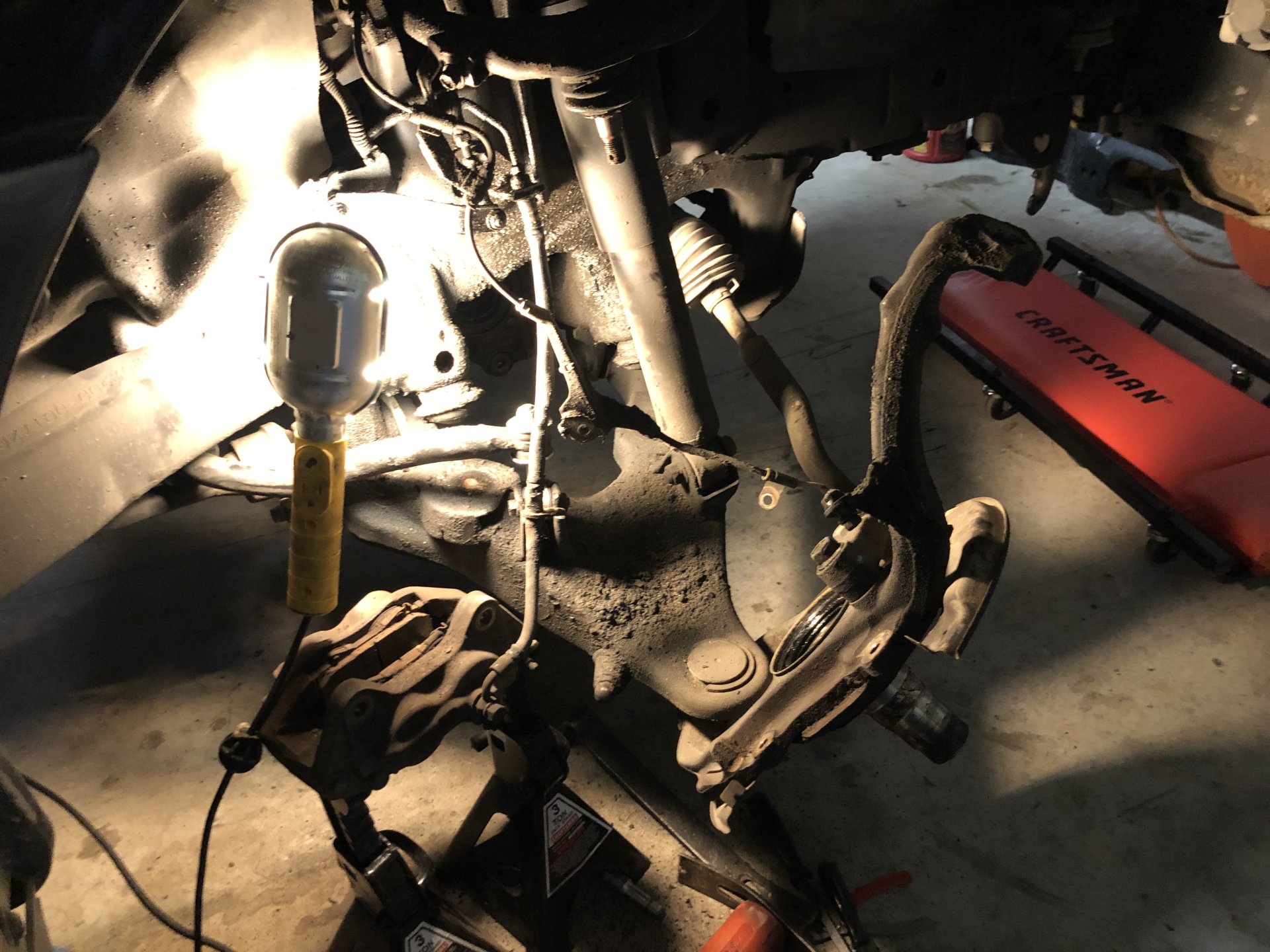

Ball joints have arrived (along with Lower BJs for the Third Gen 4Runner in the big boxes).

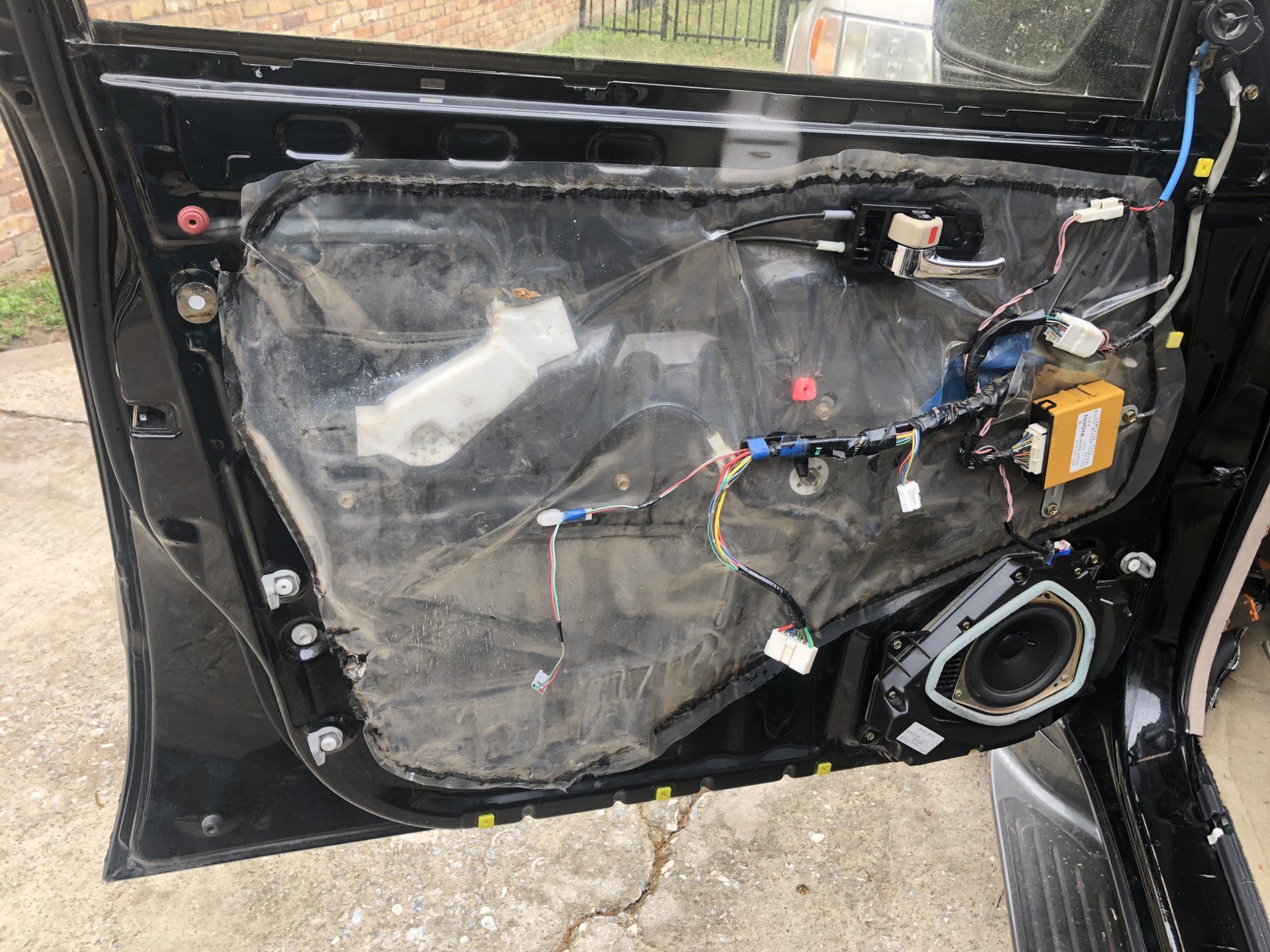

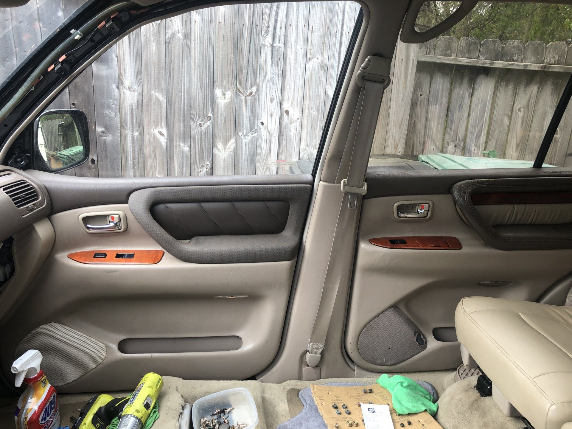

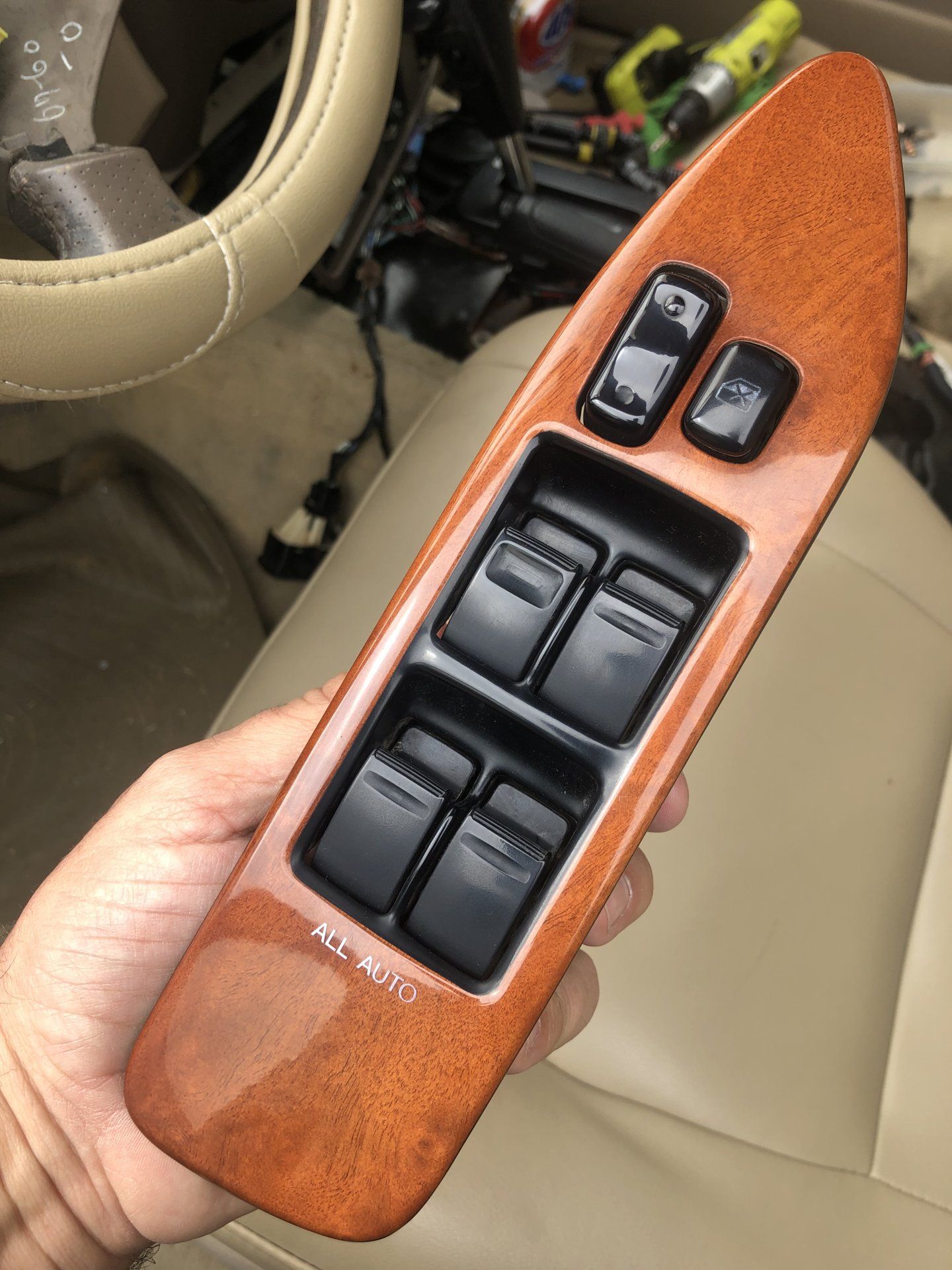

I removed the driver side panel and vacuumed, dusted and 409 cleaned the metal insides of the doors. The Land Cruiser door panel does not have the cut out for the seat memory buttons. I need to figure out what to do there. Any insight would be helpful.
LC panel in the front / LX in the back... for now.
I used Meguires PlastX Polish to clean up the control panel switches. They were filthy and came out real nice. My faux wood is actually imprinted into the plastic switch bezel instead of the stick on laminated woods I see on most of these.

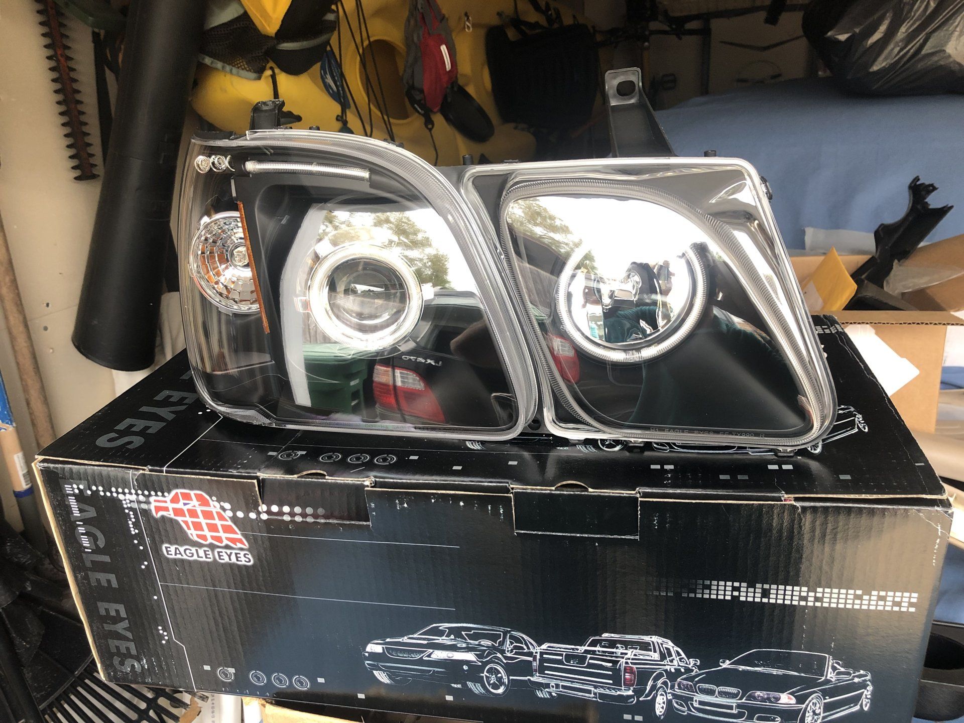

The Eagle Eyes black headlights came in yesterday as well. Should look good against the black paint and add a more aggressive look in the parking lot at at Saks Fifth Avenue for their next sale. Lol.
Are the Eagle Eyes glass? Or plastic?
Unfortunately, they are plastic, but with several broken glass lenses I didn’t want to pay the prices again.
