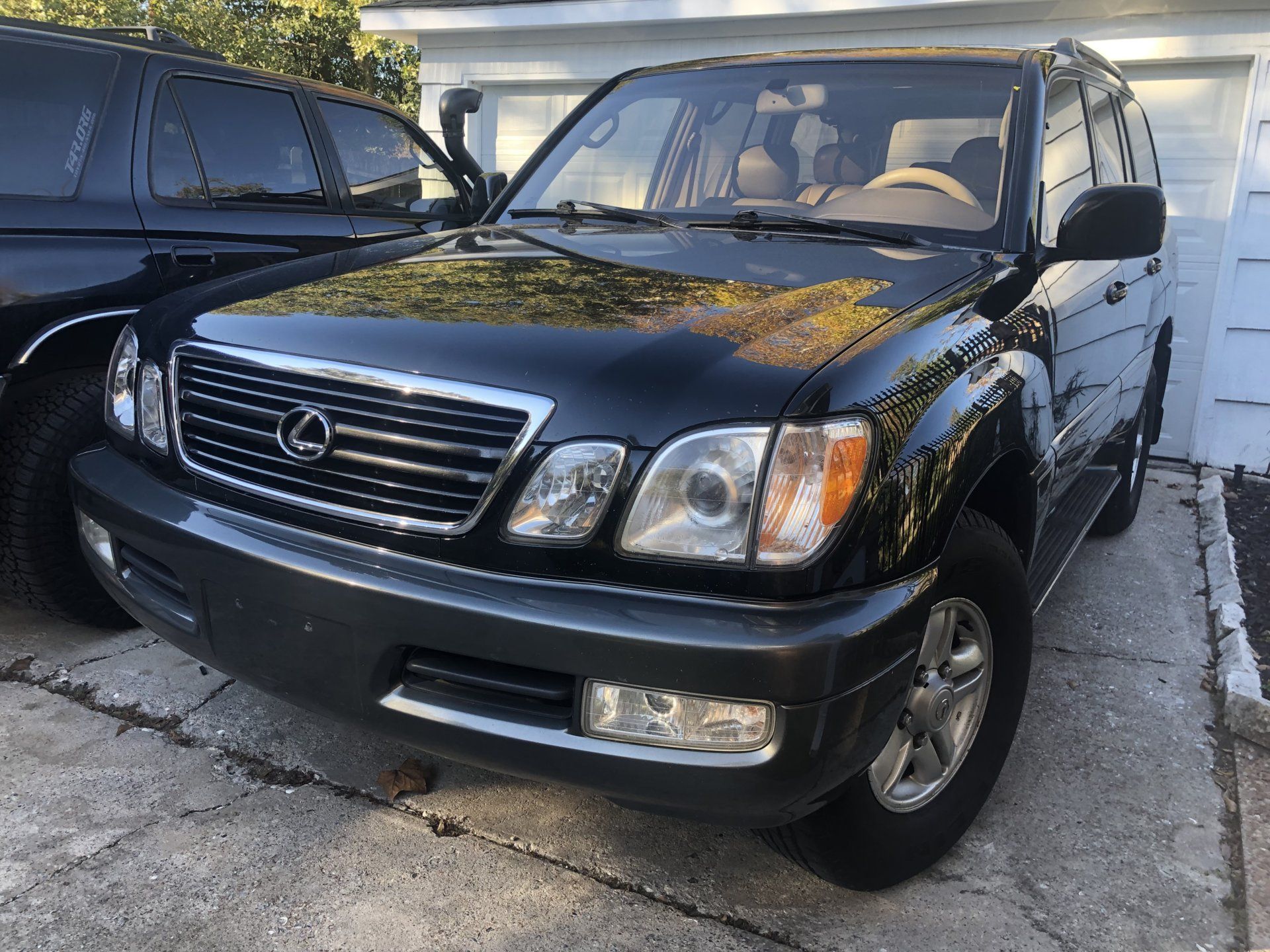

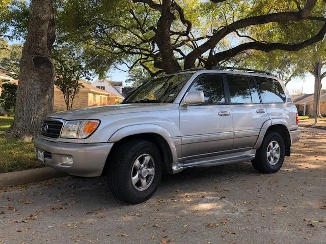

My new find... 1999 LX470
Nov 22, 2017
10
445
Katy, TX
Well, after restoring a 2002 TLC and handing it to my wife a year ago (due to 3 kids and needing a larger vehicle), I decided I need to get something bigger. I actually started this process a few months ago in mid Dec 2018.
I am redirecting from my previous thread just to keep the two trucks separate.
I had been looking online for my brother in law (he wanted a 4Runner) for a while and I thought to myself if something comes along that is too good to pass up I will grab it (a cheap LC or LX 80 or 100)
This one popped up on OfferUp for $5,000 and I was at a janky little car lot within hours. He said it had an odometer discrepancy (it read 97k miles but looked like 250k). I had my buddy pull a Carfax while I explored it. Crawled underneath and it looked bone dry except two torn outer CV boots. Inside, the carpet looked clean, it had new front and middle seat covers (except headrests... kinda odd) and the third row was very worn. Steering wheel was worn through but it had a nice cover. Shifter leather was decent and all the lighter wood was there and not faded or peeling. Door panels looked rough, especially the tops.
So I started it up and it ran just fine with some whining (maybe Power Steering Pump or pulleys) but ran pretty smooth. On the test drive the suspension handled fine (although the AHC did not work) brakes had a slight shimmy from a high speed stop and the pedal feels better when I double pump the brakes. Everything works electronically except the AUTO AC button. Rear air is fine, ice cold AC and Hot Heat.
My buddy gets me the CarFax and it was corporately owned from day one to 40k miles and the rest of the time it was owned by the same person in Colorado. Almost every maintenance record was at a Lexus dealership in CO until 296k miles. I am still going through the Toyota Owners site over all the work done. It had a cluster swap at 347k miles but no documentation.
I felt like it may have been a flood car that was not documented so I aimed low at $3000. They said no. I told them to make me buy it today. They said $4500, I said, “I will drive it home with $4000 in cash in your hand right now.” I drove home with paper plates 20 min later.

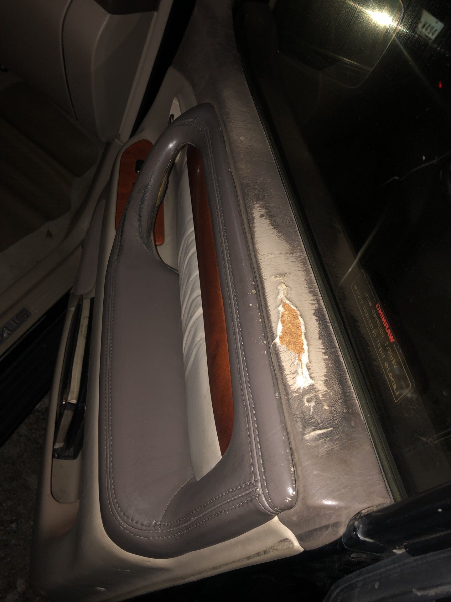

I need to find a LC/ LX in a junk yard for better door panels / Middle Row Headrests

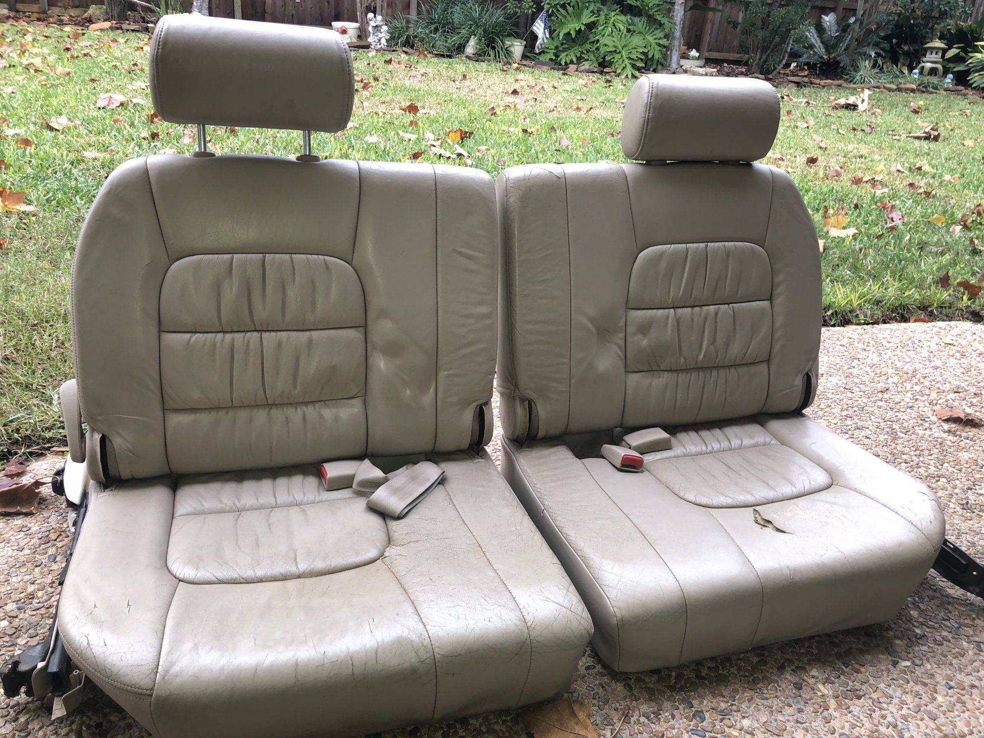

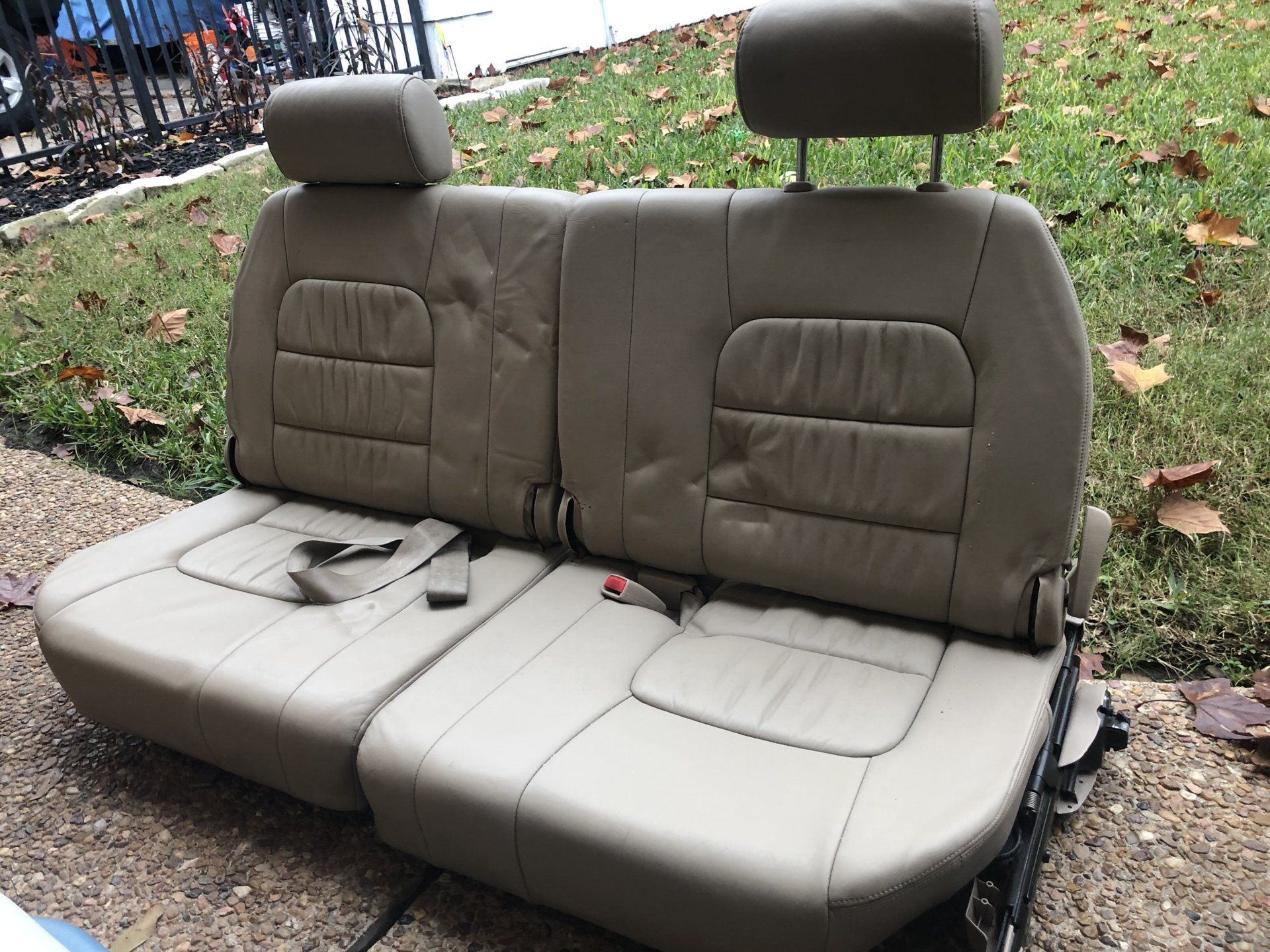

I pulled the third row to see if there was any saving it without recovering and it just looks bad. There are tears, rips and scratches.
db930180-bc91-4eec-ab74-1fe6186c62dc-jpeg.1849647
I found many for $300-400 but I could recover it for that price. OfferUp scores for me again. These were listed for $100. They have been in storage since 2002 and just had some scrapes from being moved around. Sold!
5e79899e-1eb2-4c78-b8c9-10d69a9638e5-jpeg.1849648
You would not believe all the dirt that came out of those seats...

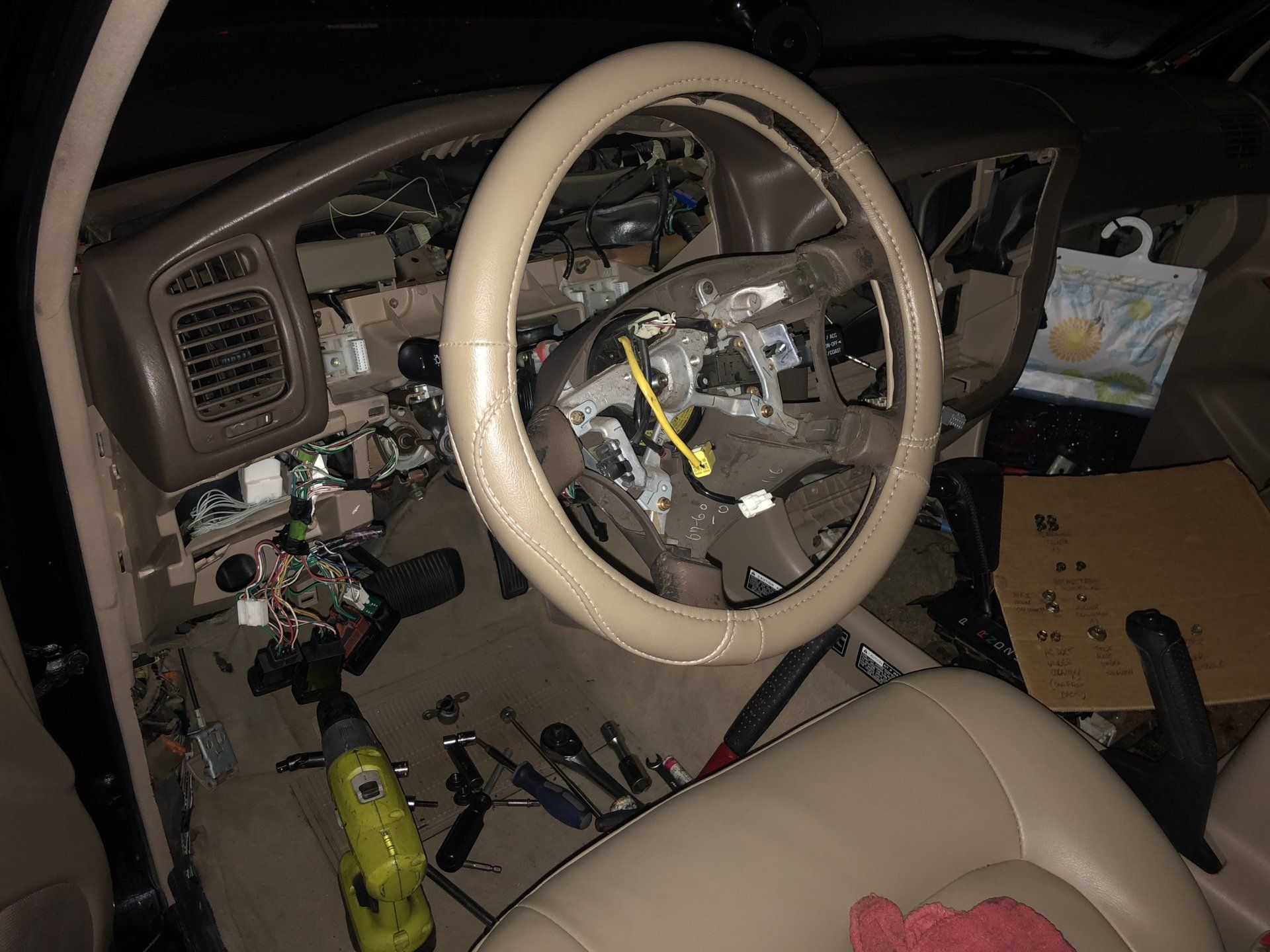

Diagnosing that headlight issue:
I have switched all the relays (DRL3, HEAD relay, DIMMER relay and the MAIN DRL relay) out with working ones from the LC. Nothing has worked. I still have the same symptoms.
The only other item in the headlight system from the EWD is the Instrument ECU and the switch.

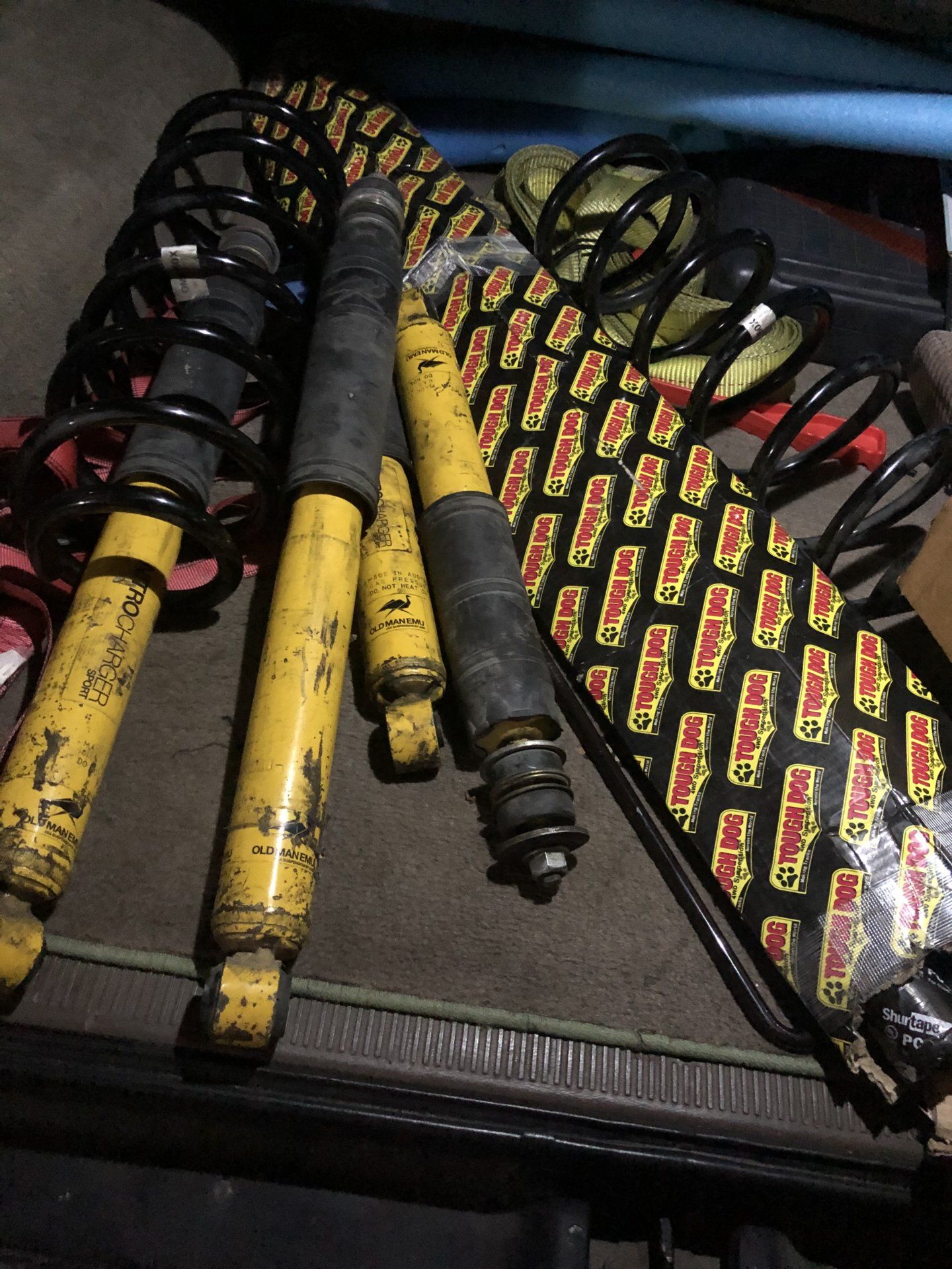

I also picked up a ARB lift kit from @meatloaf feom the classifieds.
ARB 2860 Old Man Emu Coil Springs ~2" lift, Front/Rear Nitrocharger shocks with recent bushings, and OEM Torsion Bars.
Not sure if it will go on the LC or LX right now. It will be a good replacement if I cannot diagnose the AHC on the LX.

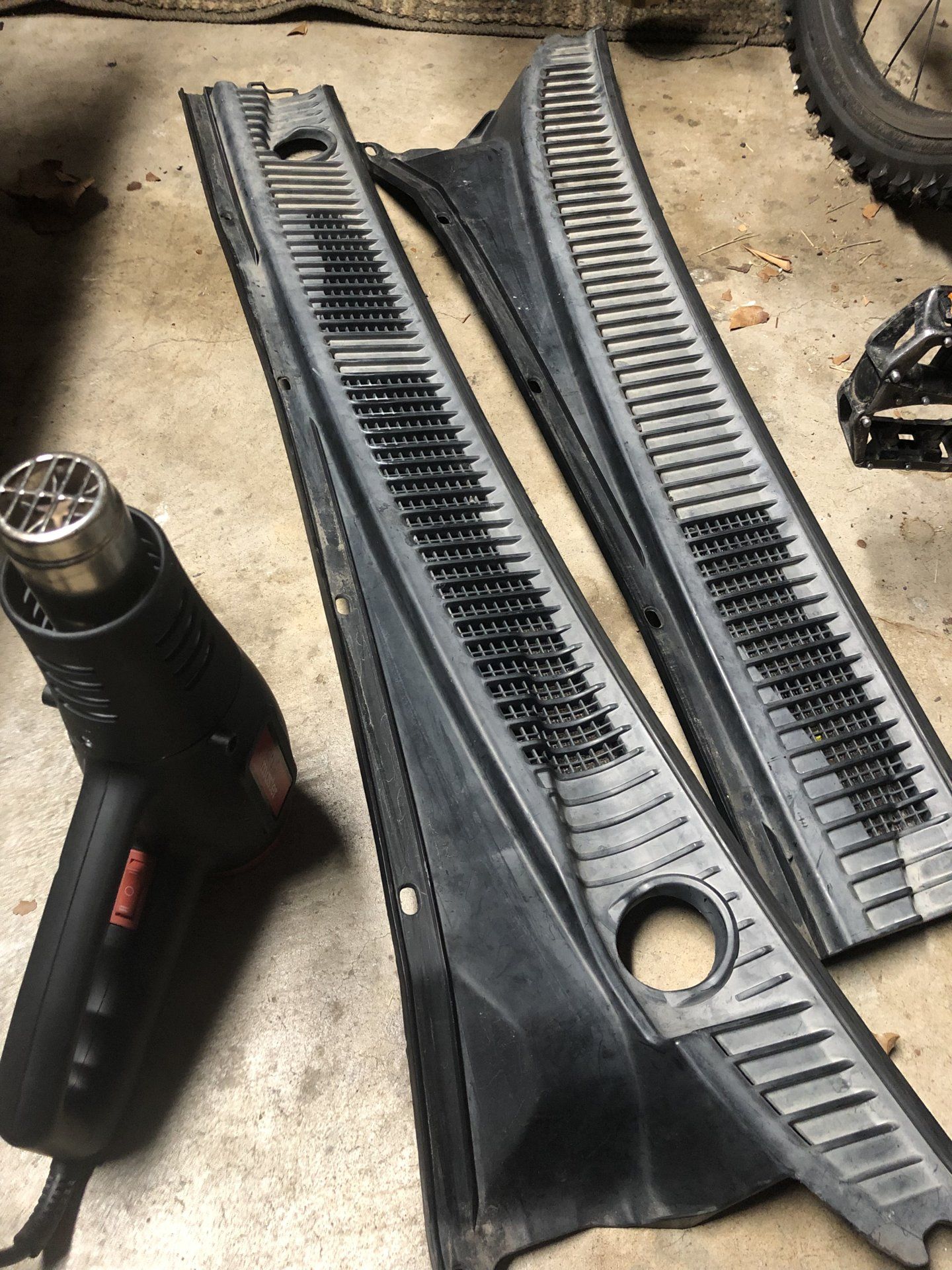

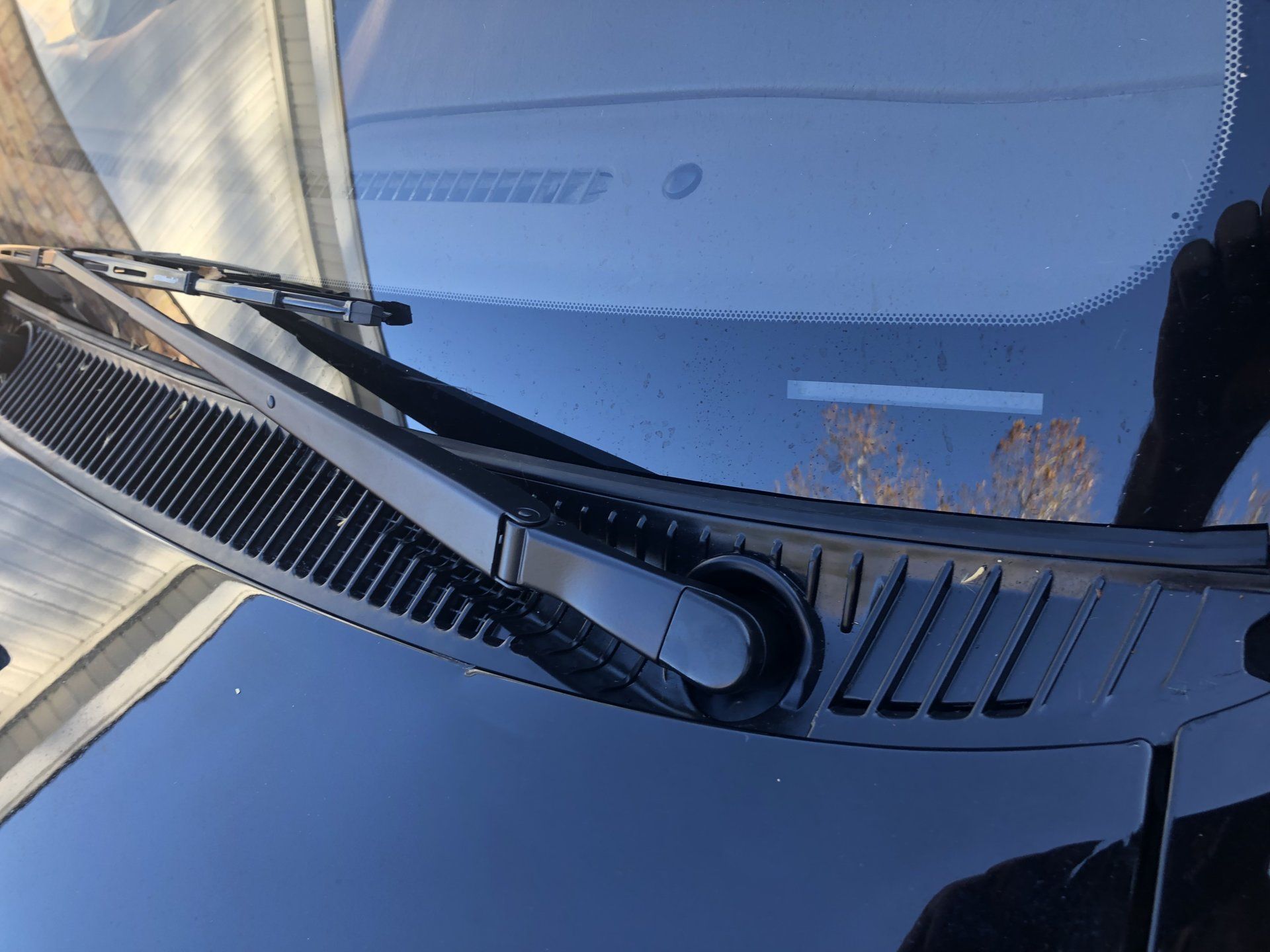

Wipers were torn up. Bought some Silblades. The plastic cowl pieces looked so faded so I whipped out the heat gun and revitalized the black color. (Hindsight - DON'T DO THIS - It works with stuff that is kept indoors but after 4-6 months in the sun they look white-ish again).
fdd3686c-fc82-4b5d-bb87-9eeaa9ecfd9d-jpeg.1861348
Halfway done
e94f5cb9-0a39-4349-9308-1b2d028a320f-jpeg.1861350
All reinstalled and looks great.

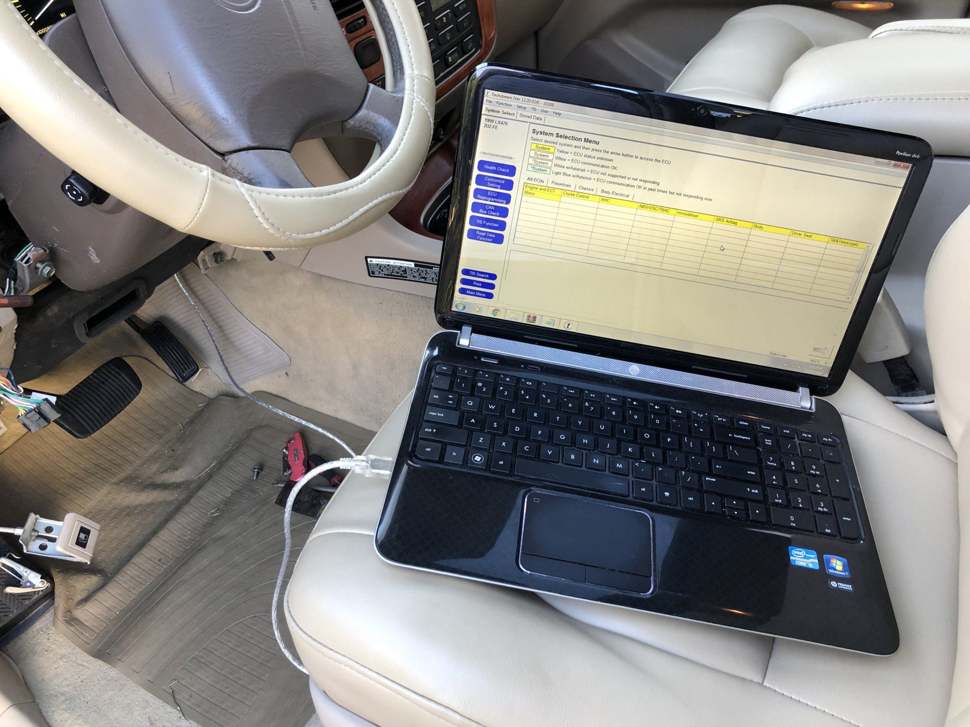

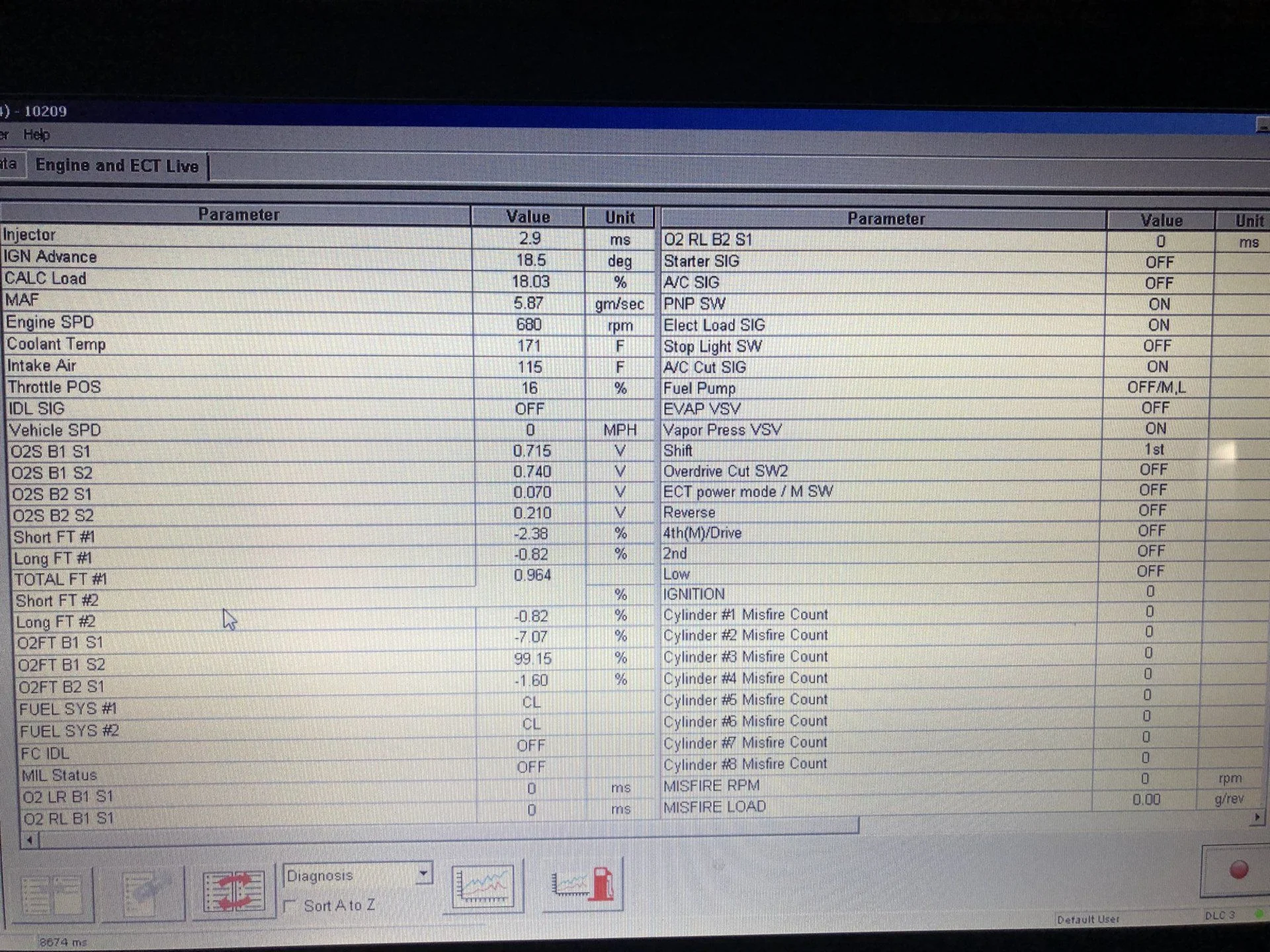

After a few hours over the last couple of days I finally got Techstream running through my 64 bit laptop. I started playing with it but had to leave due to our annual Christmas Eve Eve oyster fest with some extended family.
Hopefully, I can get this headlight electrical issue sorted out.

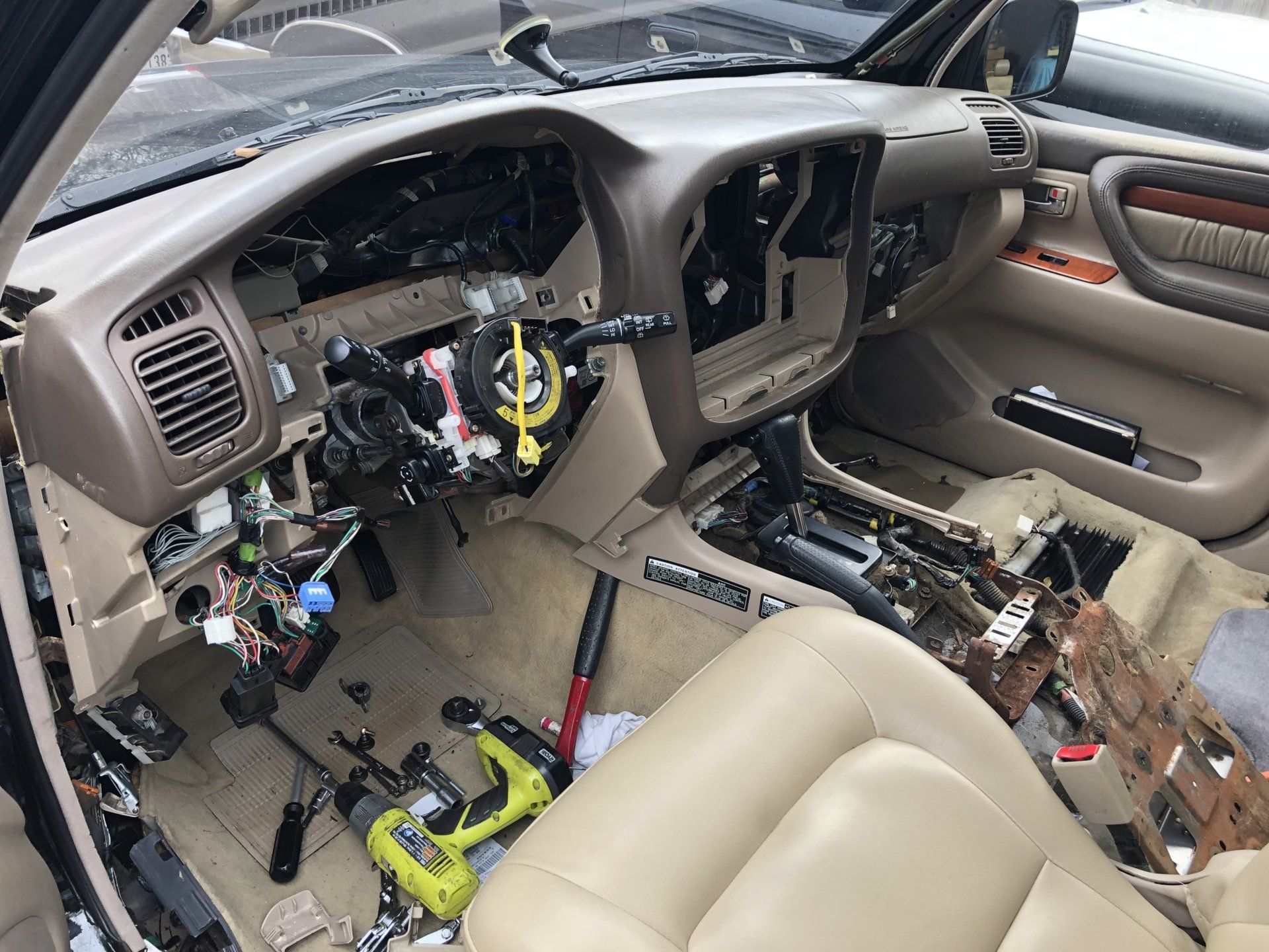

I did not want to put too much work into the truck until I find out this headlight issue so I have been tearing it apart:
1908345
So I will now direct you to here:
1908346
1908349

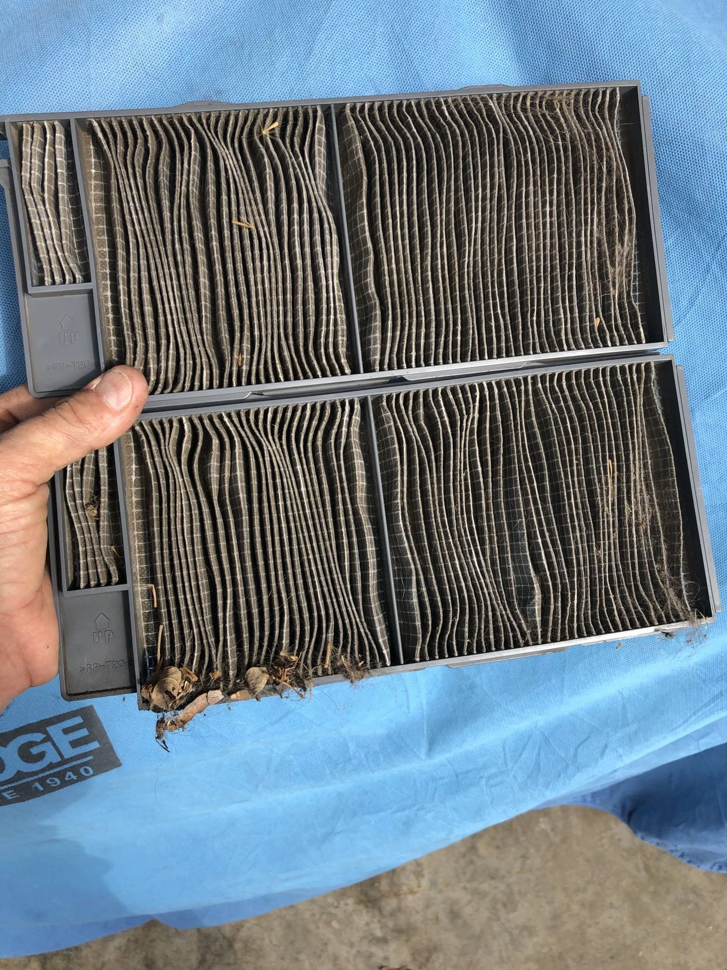

So while I am in there... haha...
I am fairly sure these have not been changed.
1908353

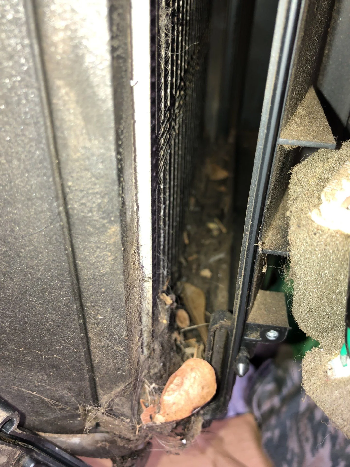

Look at all the debri
1908354
1908355

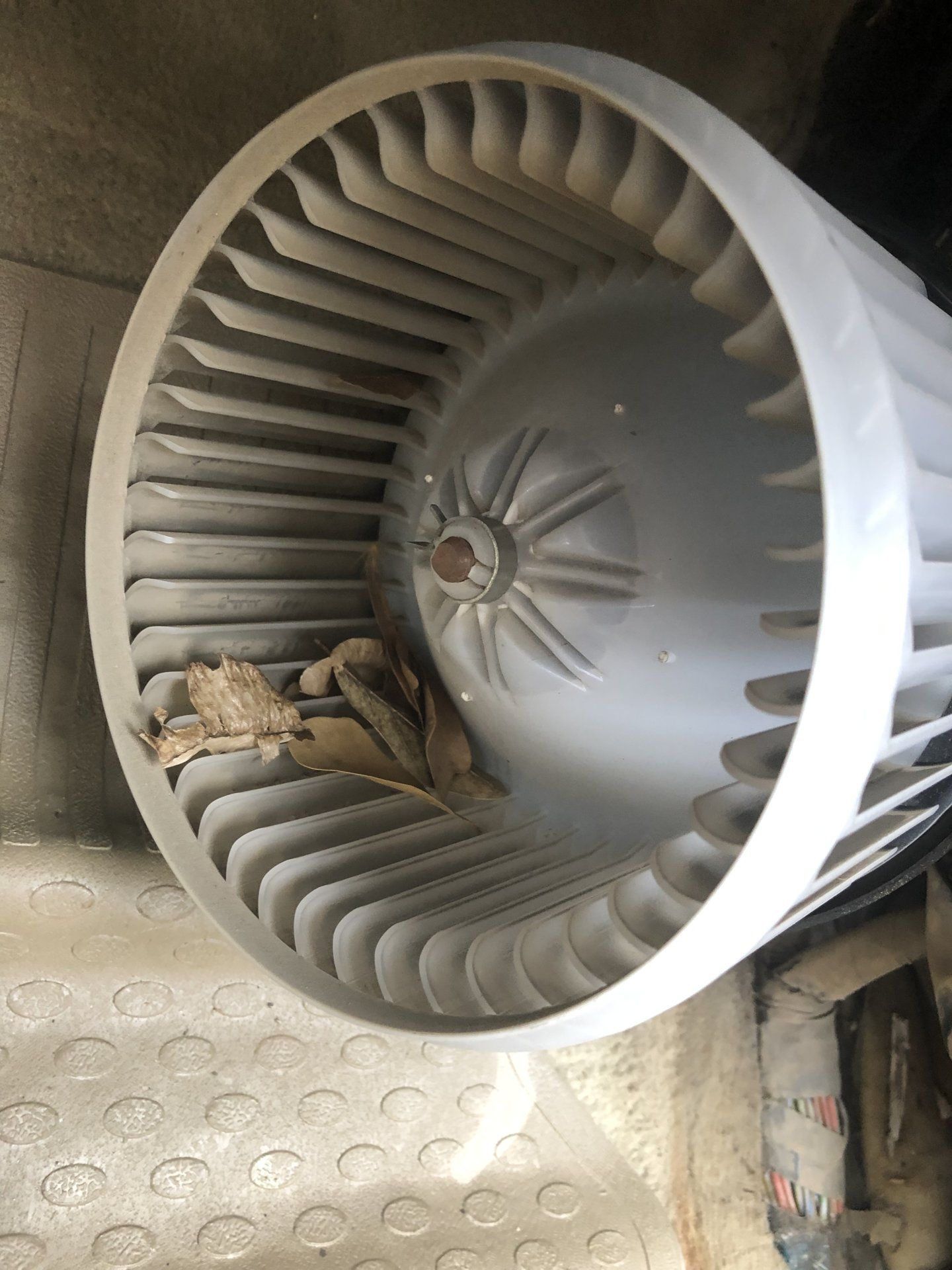

I cleaned this all out and ran some Home Depot AC coil cleaner until it was pretty.

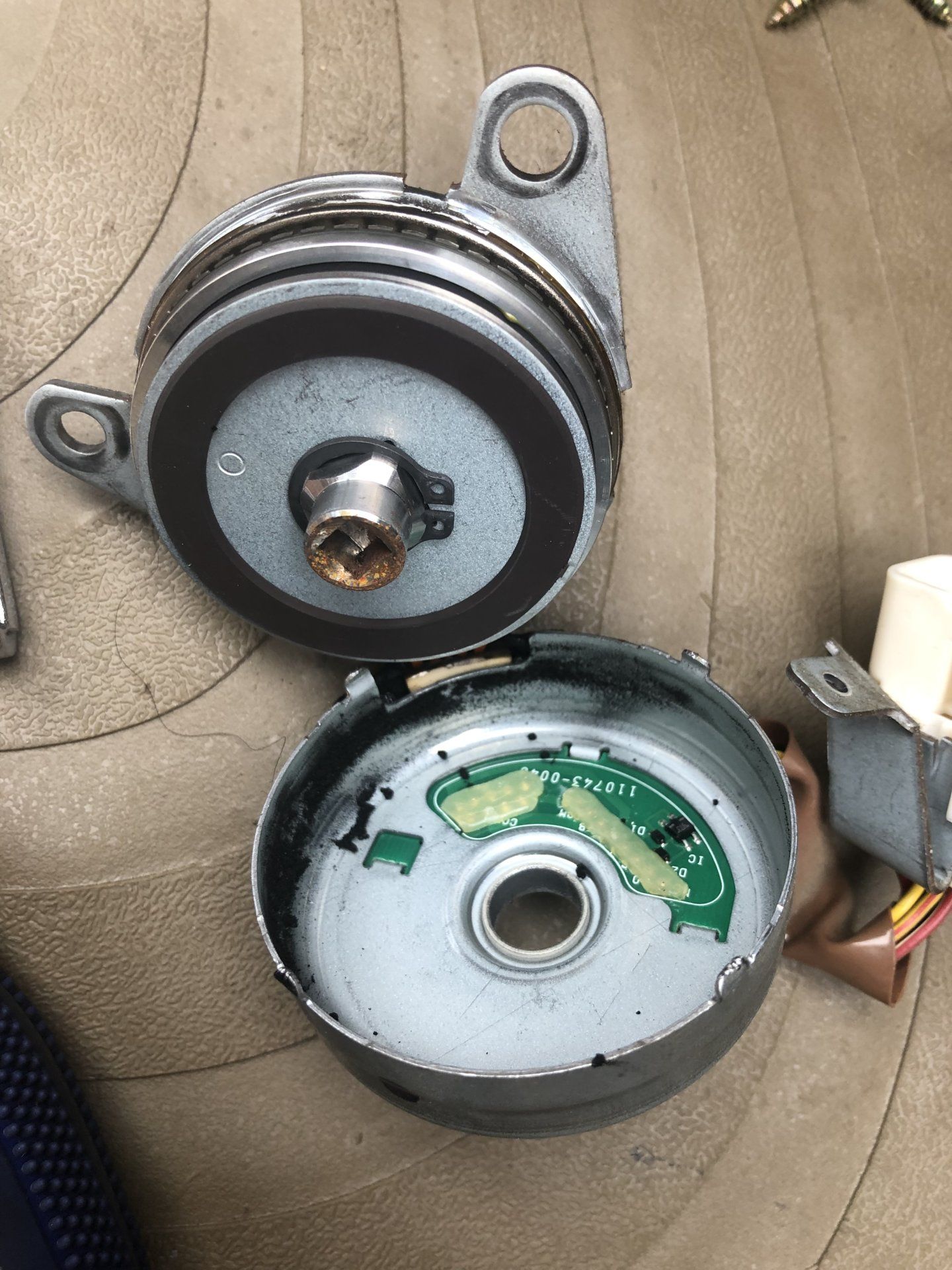

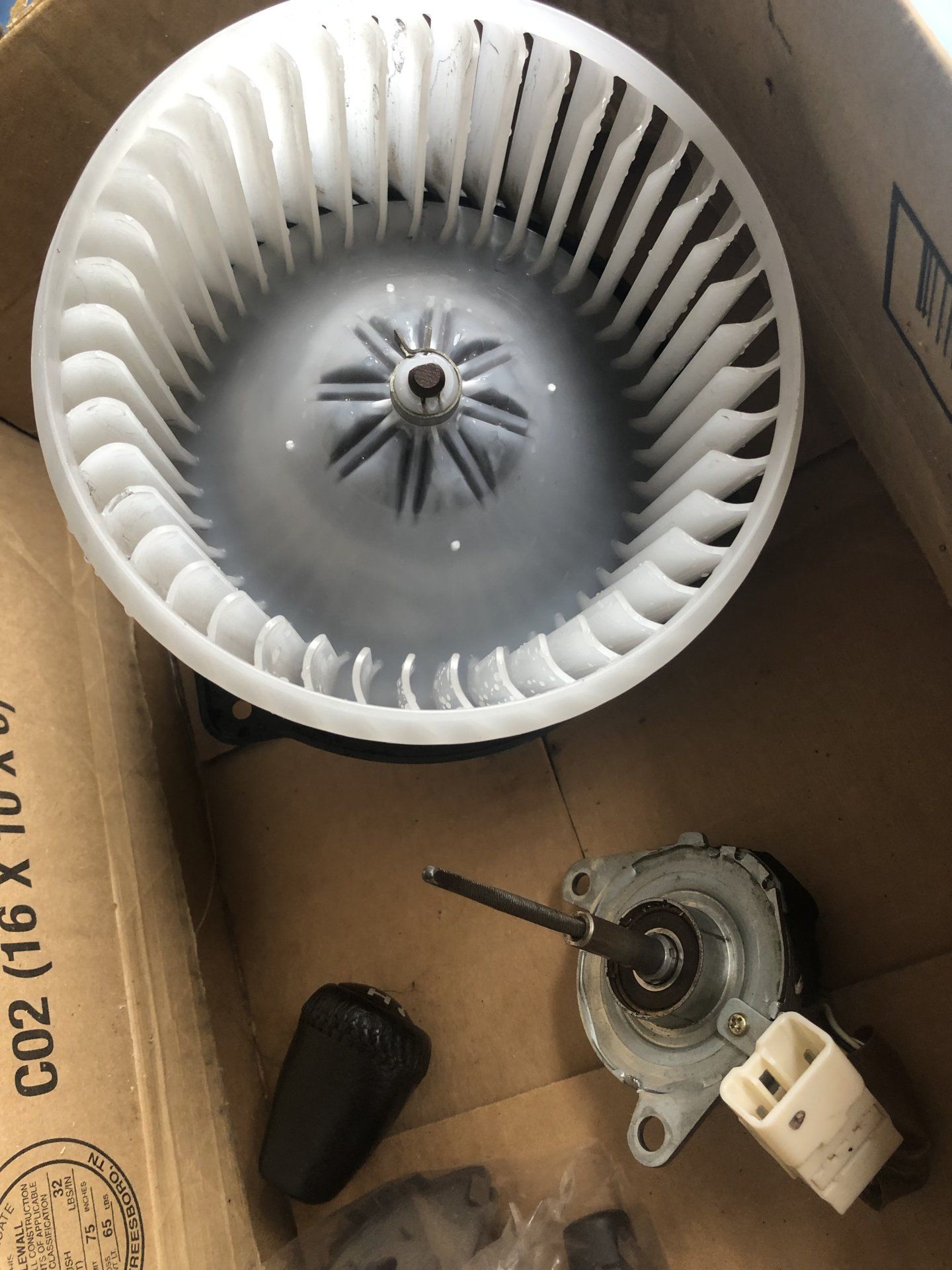

I also pulled apart the telescoping column motor and AC fan.
1908358
The motor worked with 12v so I pulled it apart to see how it looked. It looked like burnt rubber powder. I cleaned that out
1908359
I cleaned them both up and got them ready to reinstall
1908360

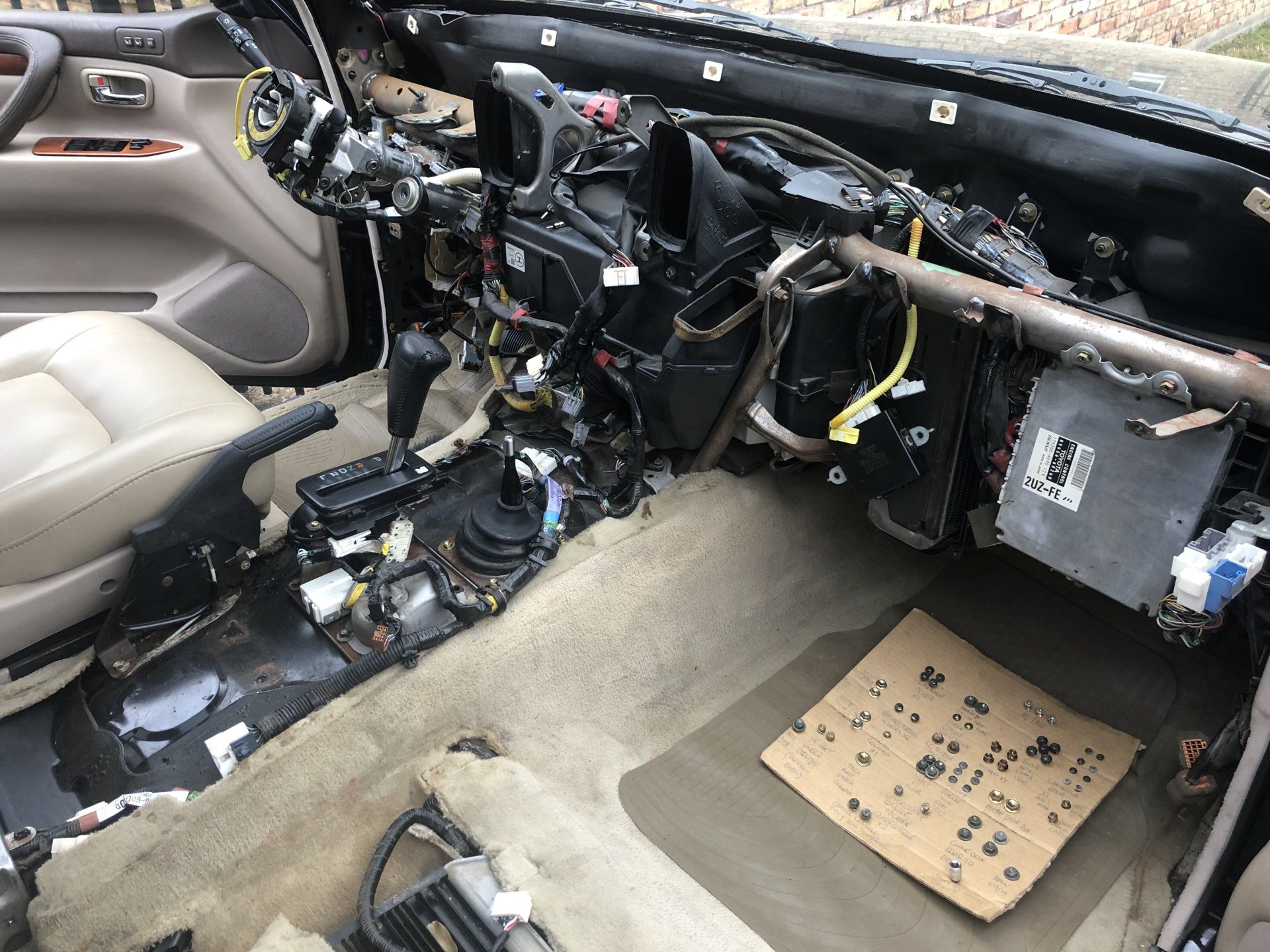

Here is how I kept my hardware straight for the dash. Notes and all...
1908364

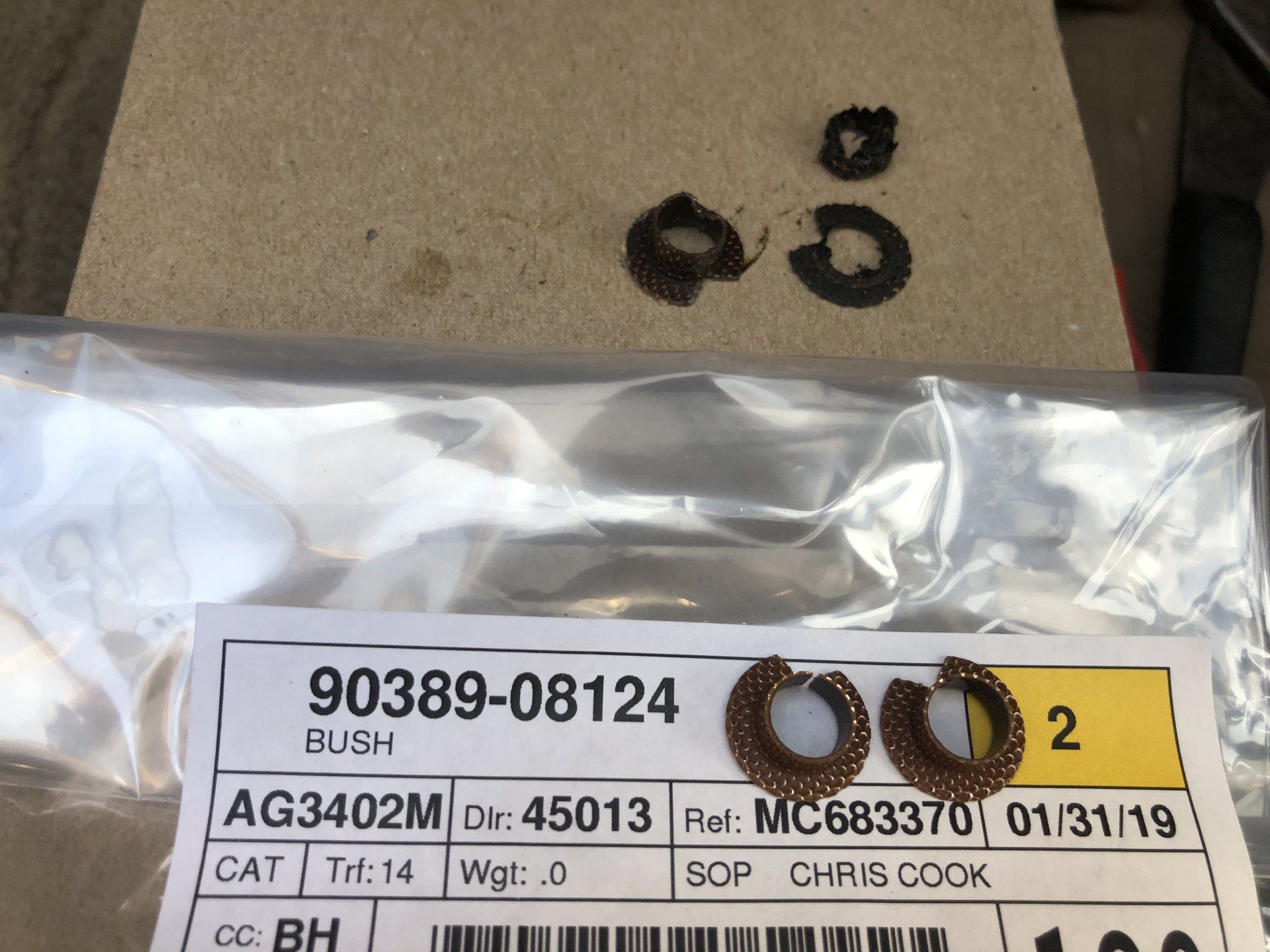

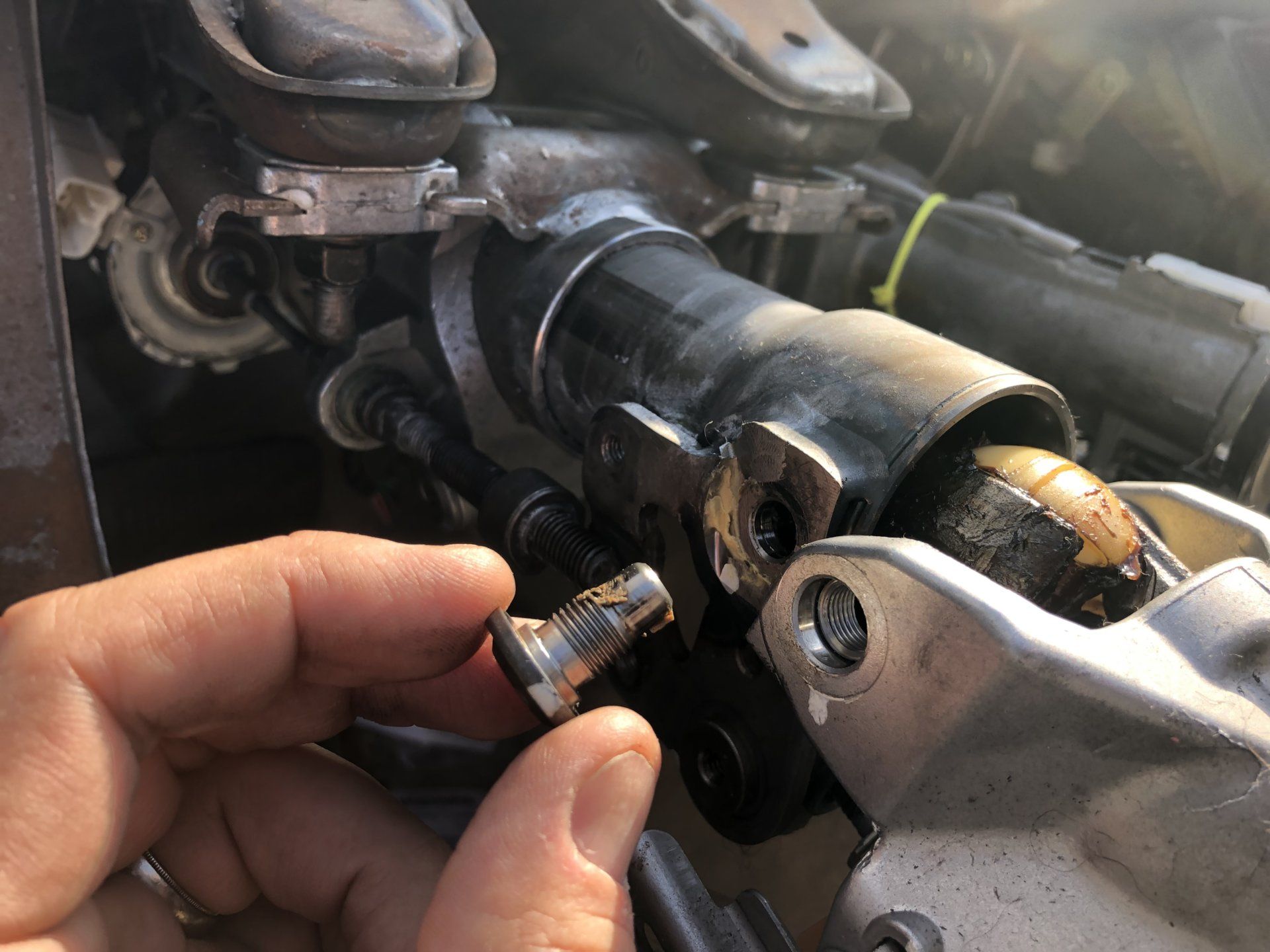

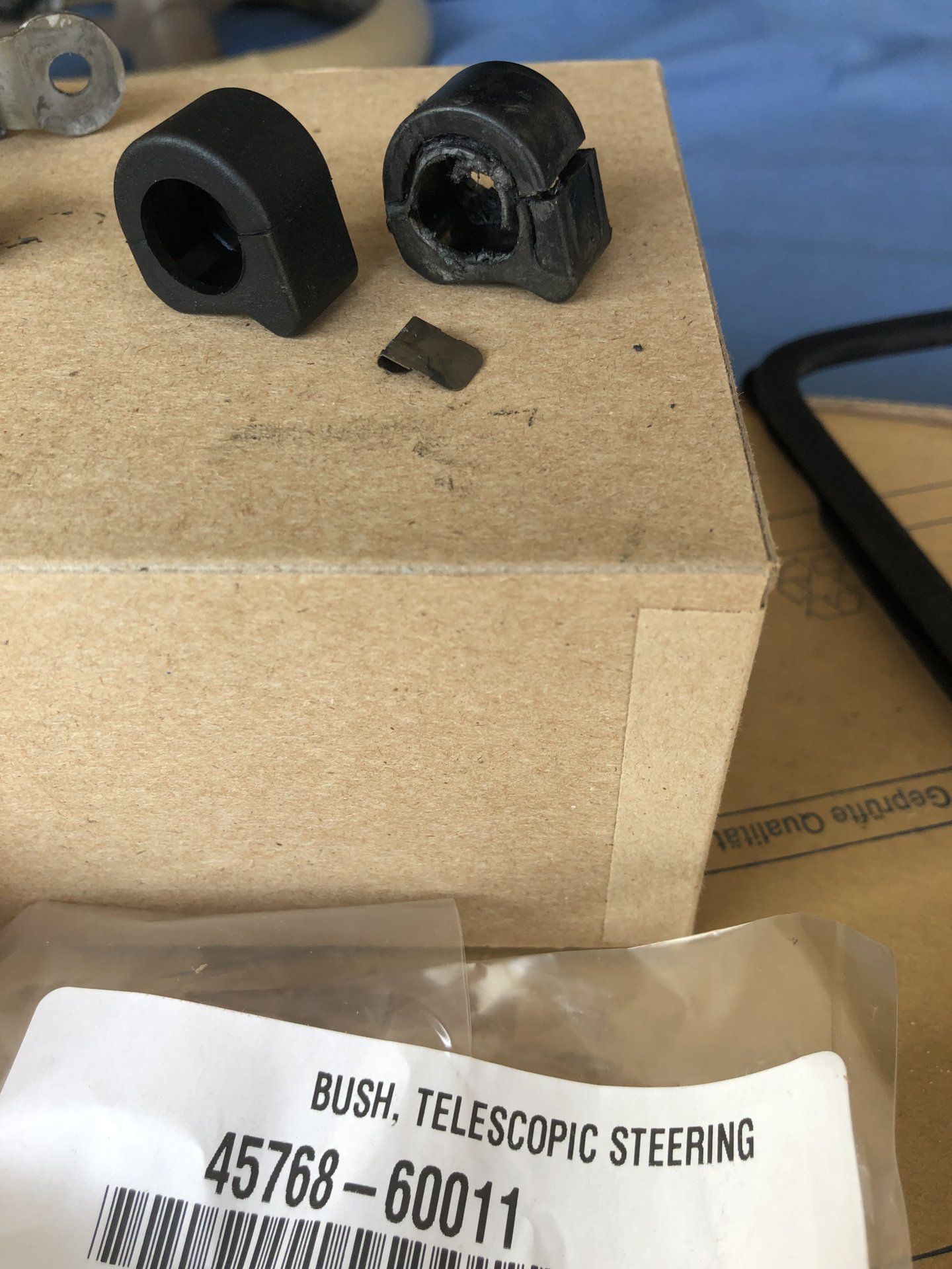

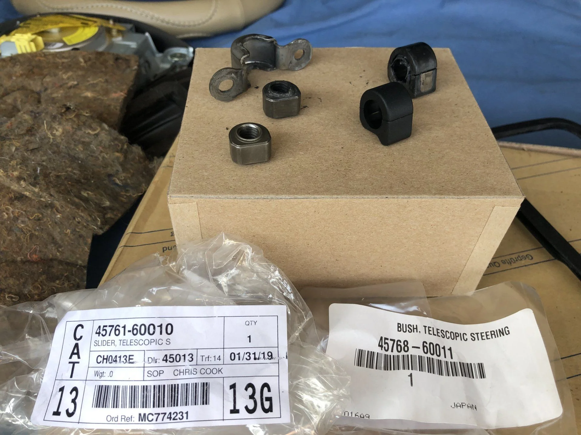

My steering wheel had a looseness to it. It would shift up and to right slightly. It annoyed me so I got the pivot bushings to replace the bad ones. You can see the broken one.
X2
90389-08124Steering column hinge Bushing
1908367
Those bushings go on the the shoulder on these bolts.
1908368
I also replaced the slider and bushing for the telescoping column.
X1 EA
45768-60011Telescope Bushing
45761-60010Telescope Washer
1908370
See the little contact? Make sure you put that on the new bushing.
1908371

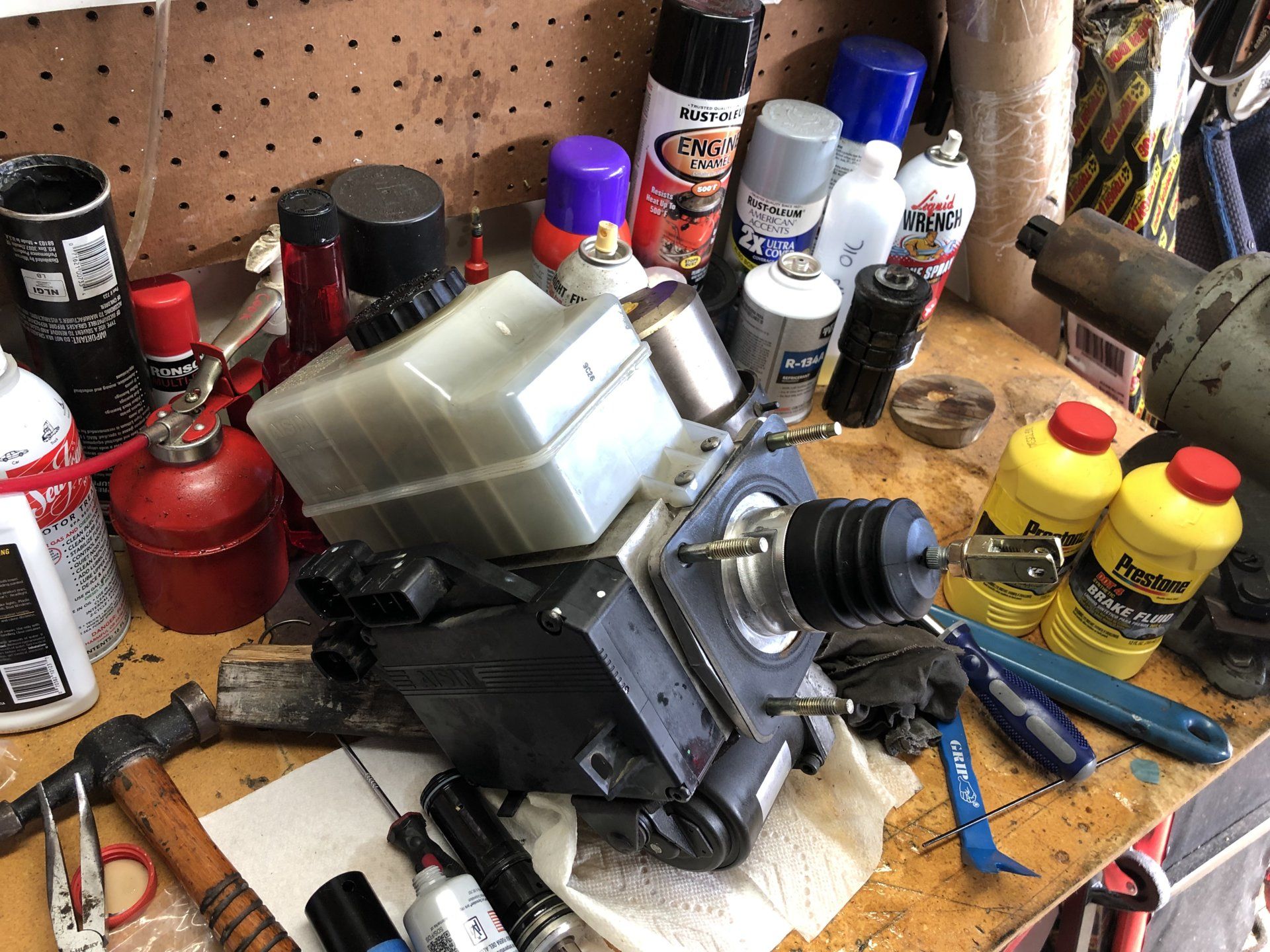

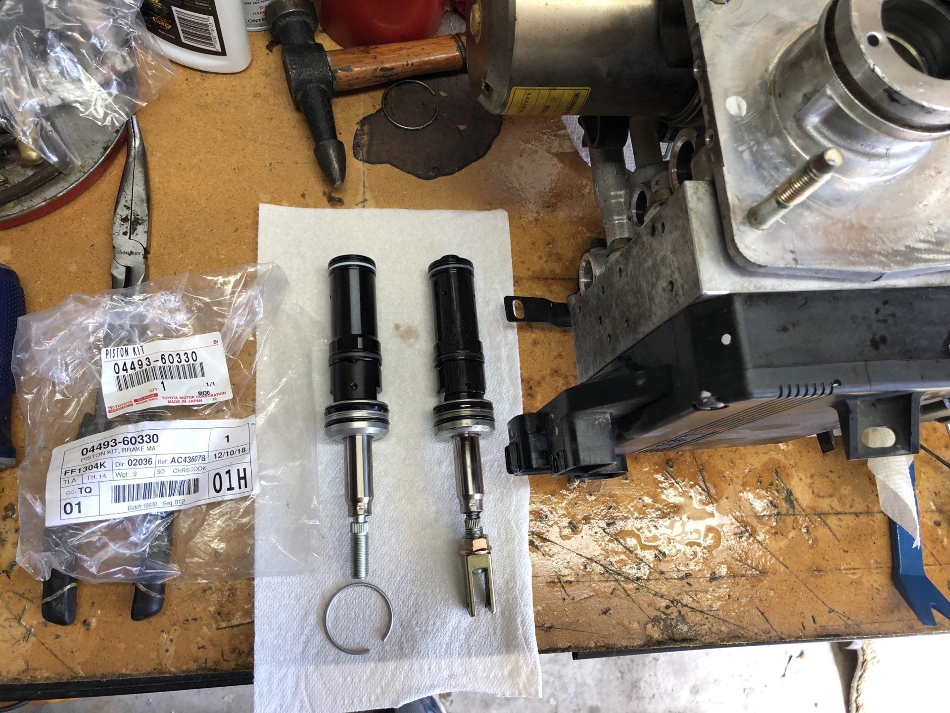

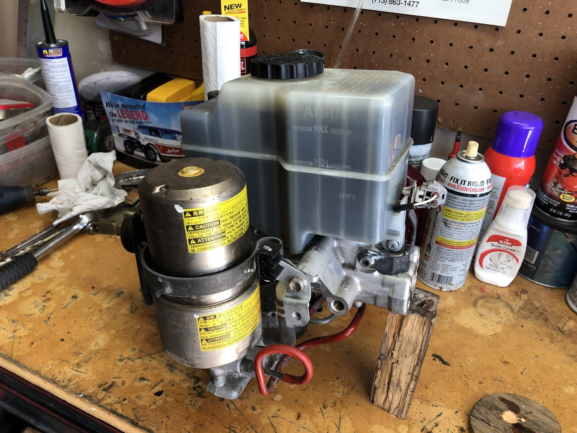

I was having the “double pump the brakes to get a good feel” thing going on so with the dash out I figured it would be easier the pull master cylinder with access from the interior side.
0449360330Master Cylinder Piston (Repair Kit)
1908384
1908385
Old piston on the right, new piston on the left. No visible damage or wear.
1908386
Cleaned out the reservoir with Alcohol and put it all back together. The reservoir didn't look like it got very clean while I was doing it but looking at the pictures now I see a difference.
1908387
Reinstalled then went to the rear brakes to find one bleeder broken and the other had no obvious hole on the seating side. I bled the front brakes so at least I can have some peddle to move the truck around.
Wow! ripping out the entire dash is pretty balsy. Please share any tips and tricks as you put this back together. Best of luck on your project!

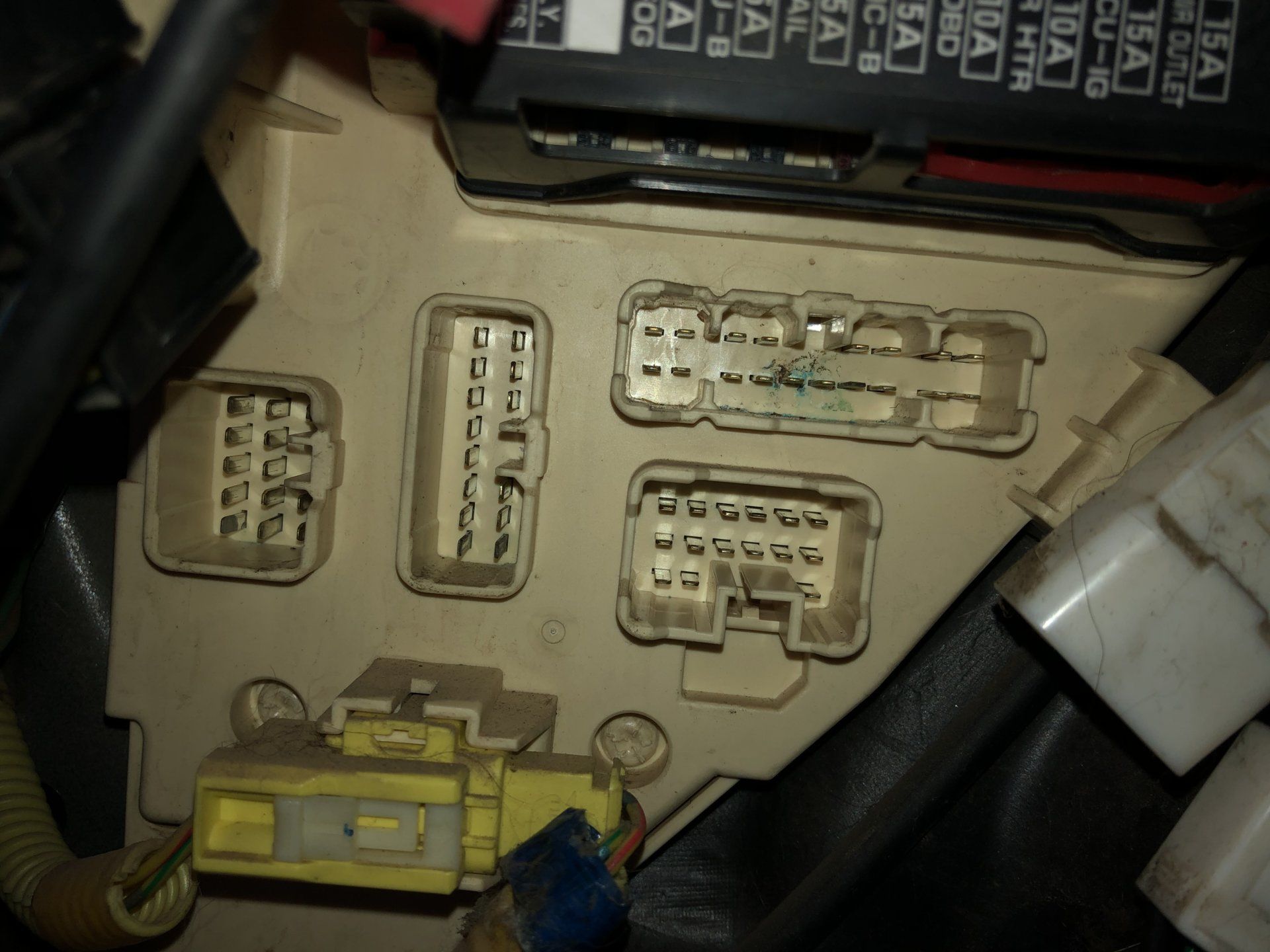

With the dash off, I disconnected and inspected every single connection and removed every single ground (I could get to). I hit each ground with a wire wheel and reattached.

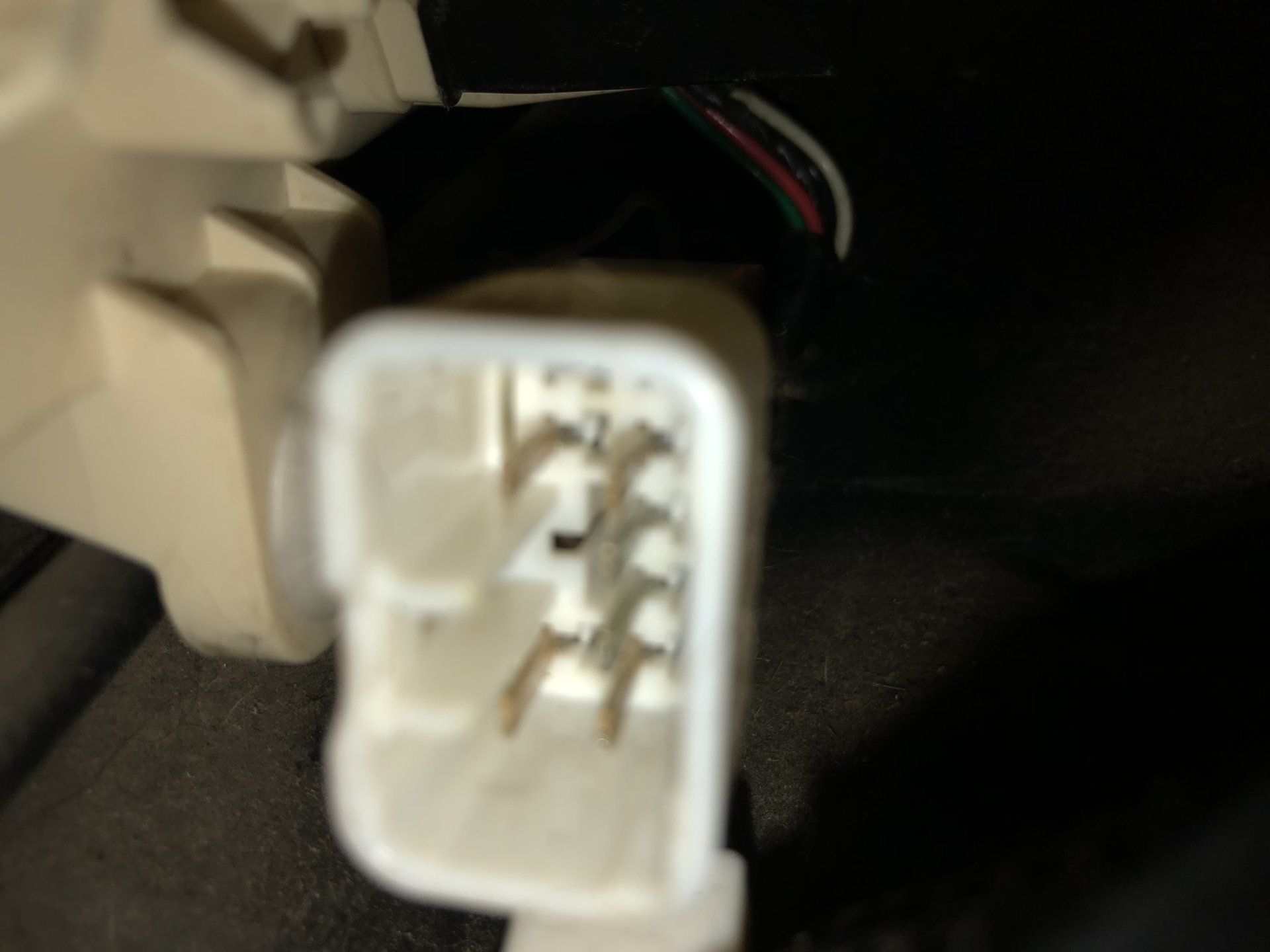

I am thinking that the little contact in the Telescoping Slider Bushing may have fixed the electrical issue.
I CAN TURN MY HEADLIGHTS OFF NOW!!!!!!!! They now work just as they are supposed to...
