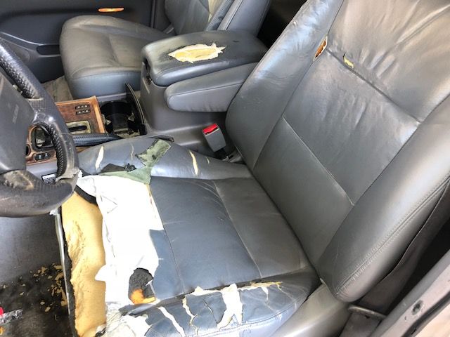

Now, this is a great deal! I got a 2002 Champagne Pearl Toyota Land Cruiser with 161,xxx miles that has been mostly dealer maintained at less than a quarter of my budget, but it is not all rainbows and lollipops. The Uncle was a big fella so he was hard on everything. He also had 2 boxers that had a full run of the middle seat area. Basically, The interior looked like a raccoon family lived in it.

I know she can't see past the tattered interior. I feel when it is done she will want it. If not, I will keep it and get rid of the 4Runner.

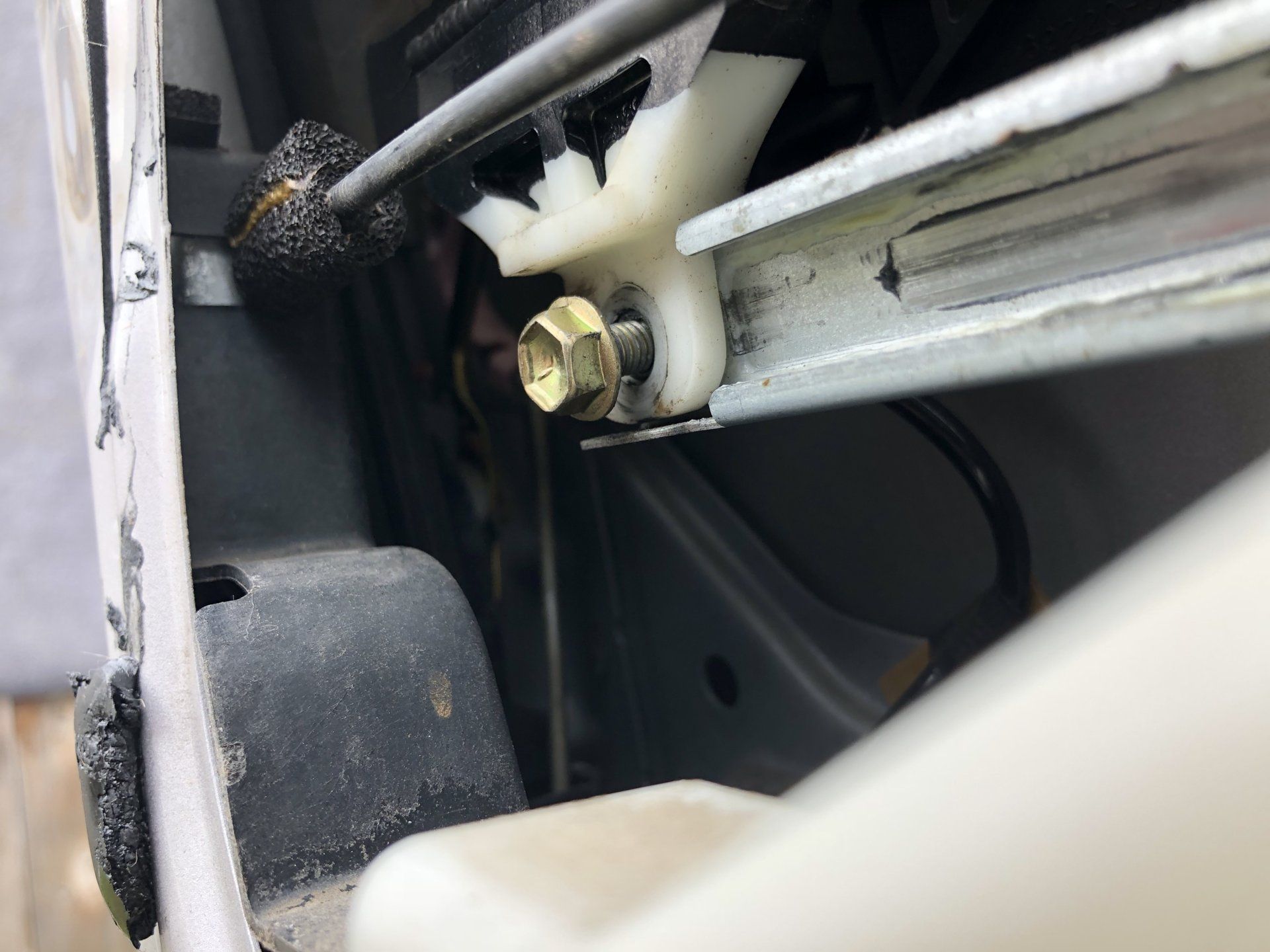

I had a weird pop when rolling up and down the driver side window. Come to find out the bolt that holds the roller rail to the window was almost all the way out. Screwed it in - all fixed.

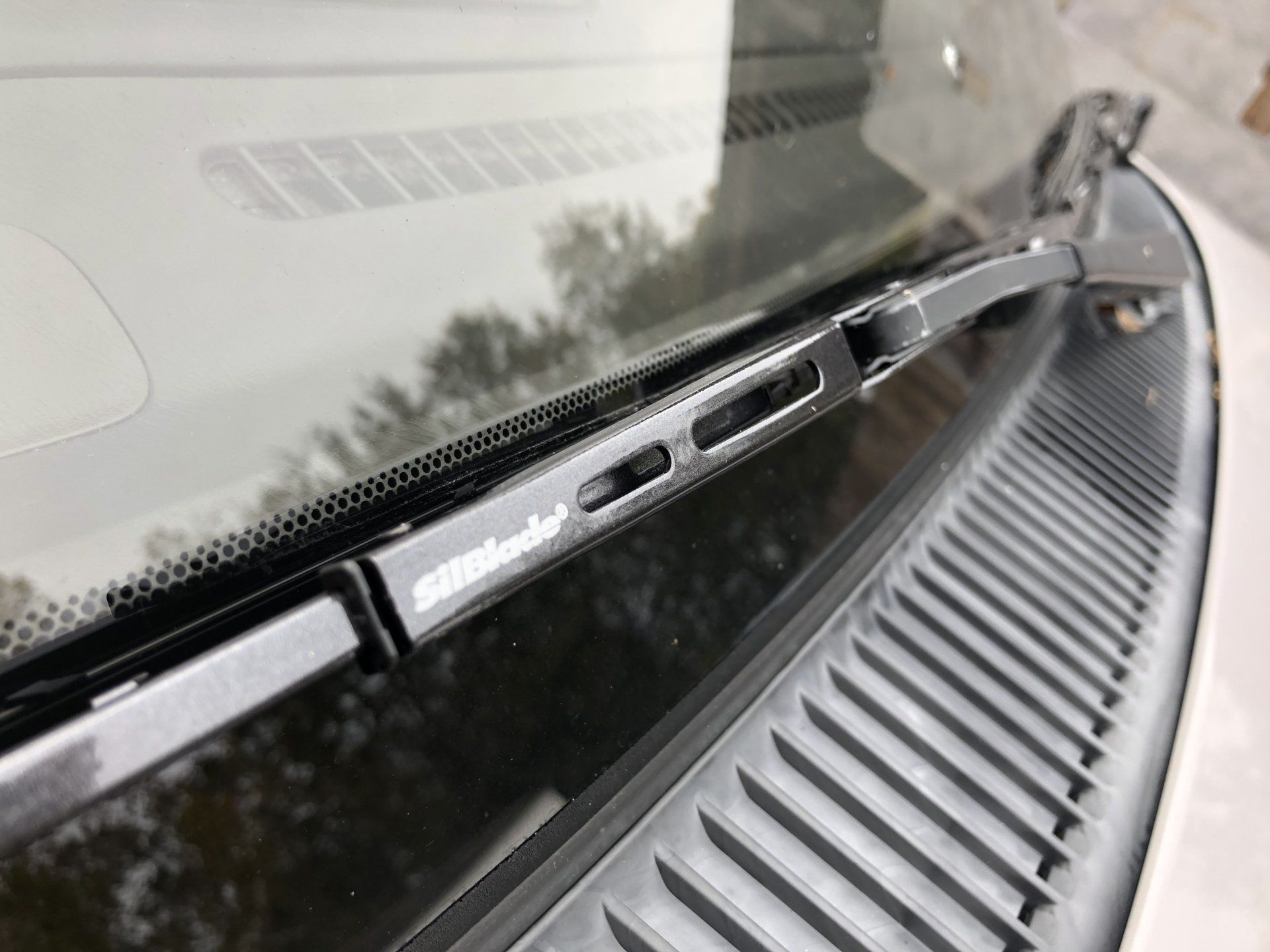

If you do not know about Silblades it is time to learn. I replaced all the old wiper blades with Silblades. Best prices are on Amazon. These blades last years. The ones on my 4Runner and RAV4 are 7 and 8 years old, respectively, and still work great.

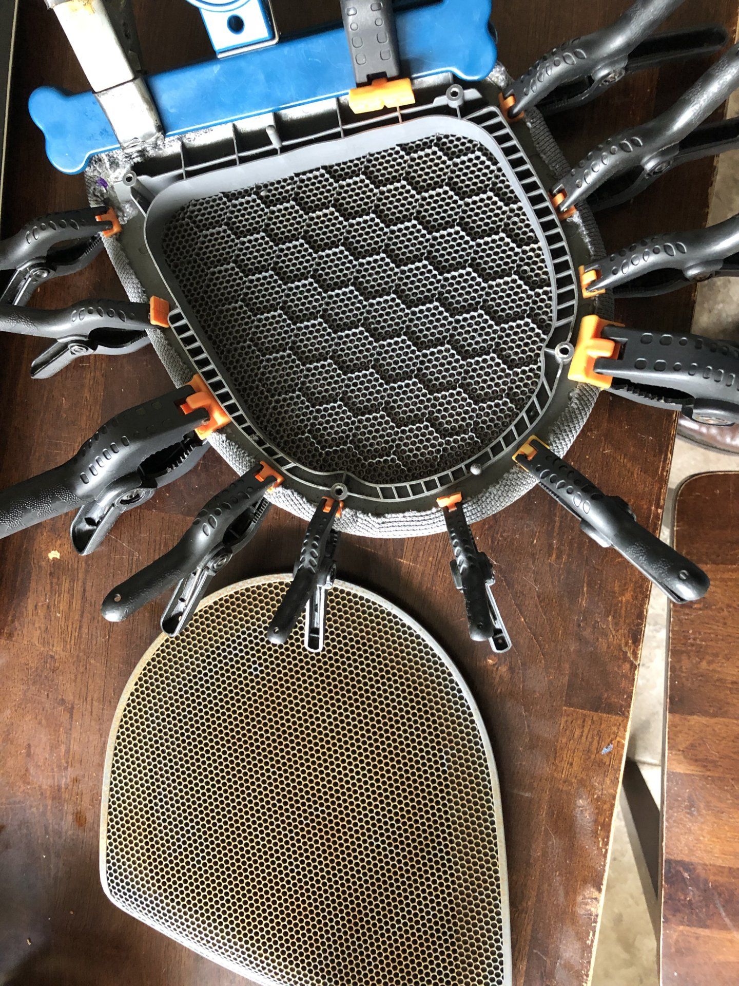

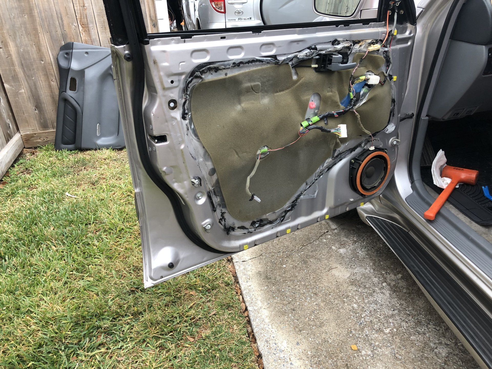

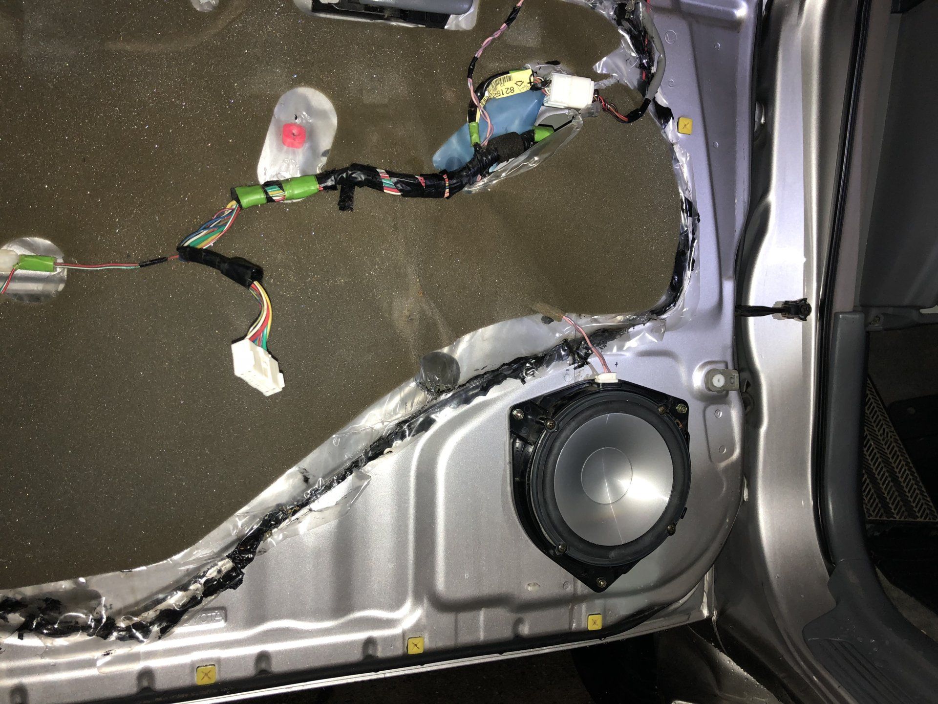

At least the front speakers and subwoofer were blown so I replaced them with Infinity Reference 6030 Component Speakers. I was very impressed with these in my 4Runner. Pretty easy install. Trimmed the door panel holes a little and that worked (the foam ring was hitting the door panel). I left the tabs on the OEM spacers (I read a lot of folks cut them off) and drilled pilot holes and screwed the new speakers into the old spot. I removed the old tweeters and used weatherstrip adhesive to glue the new tweeters the the old mounts. Then cranked it up and taped down anything that rattled with foil tape.

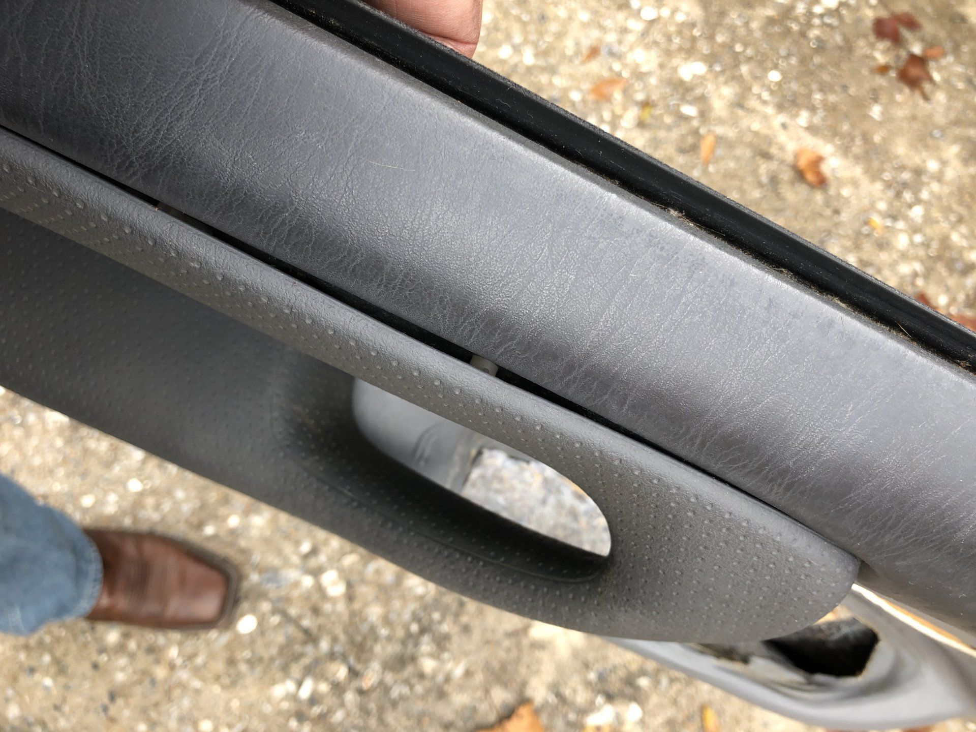

The door pull was pulling away from the door panel so I put some washers behind the existing screws and found there are unused screw mounts on the exact place it needed reinforcement. Easy fix with a screw and washers.

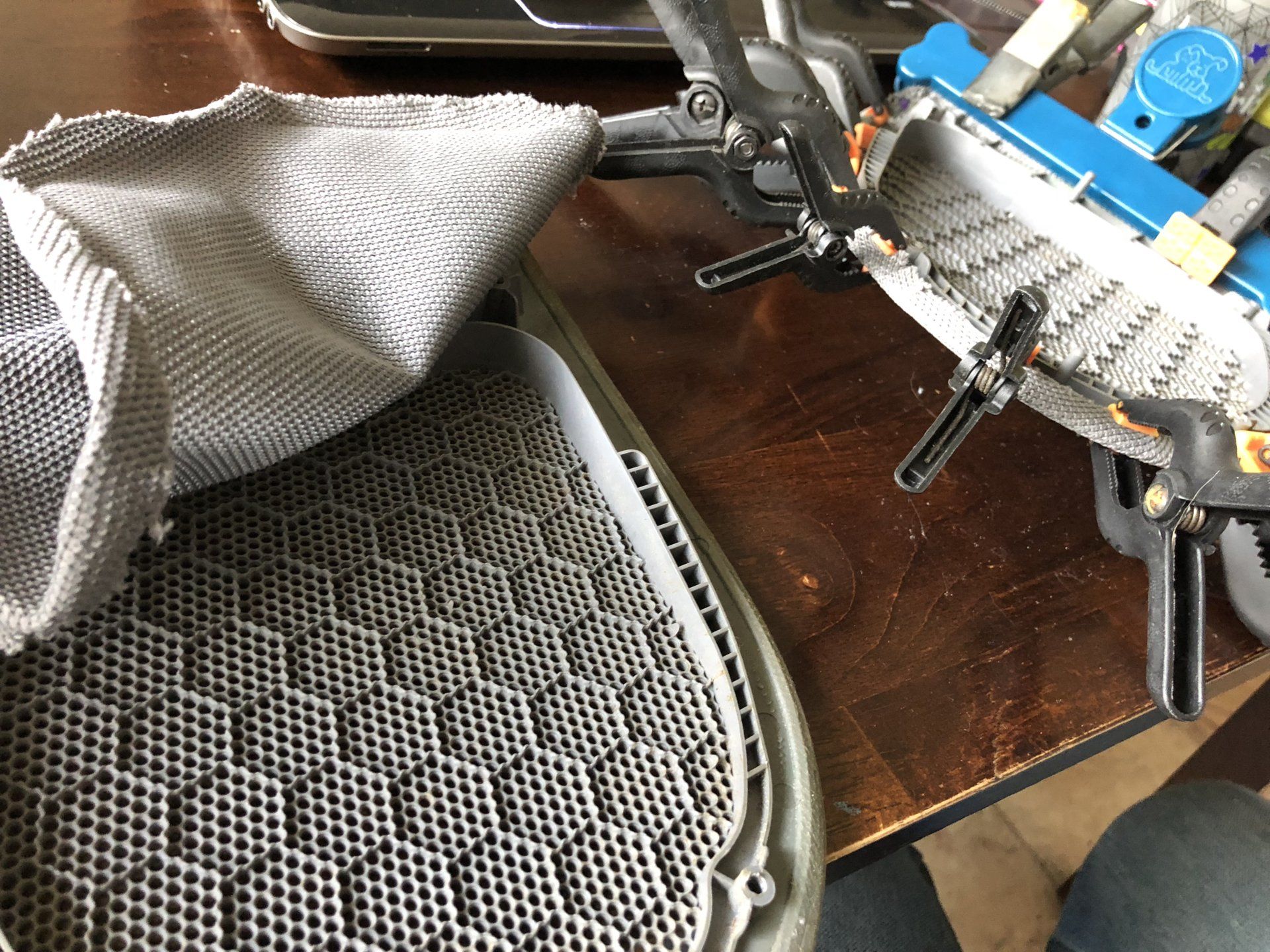

The speaker cover on the driver side was really torn up due to shoes scrapping fabric. While the door panels were off, I switched the fabric from side to side to put the frayed side down. I tried to use a clothes shaver to cut down the fray but it wouldn’t get down close enough to look good. Switched the fabric from side and glued them down. I always wondered if I would ever use all those hand clamps in one sitting.
