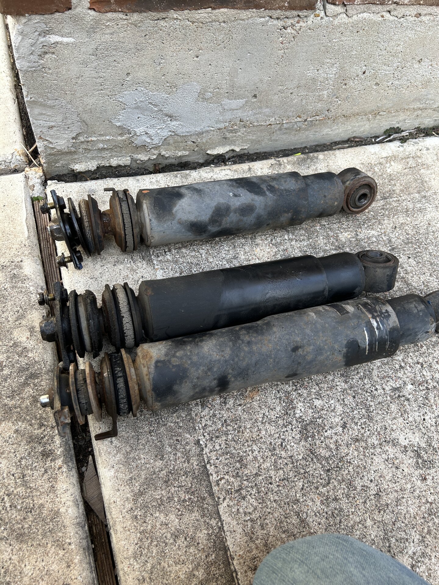

The bushings on the AHC

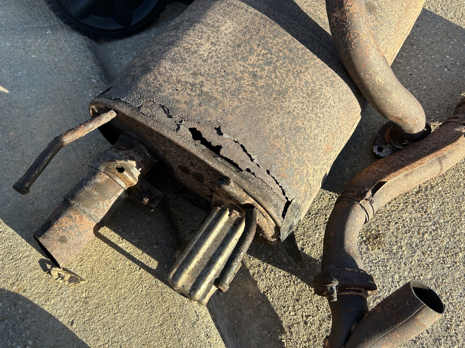

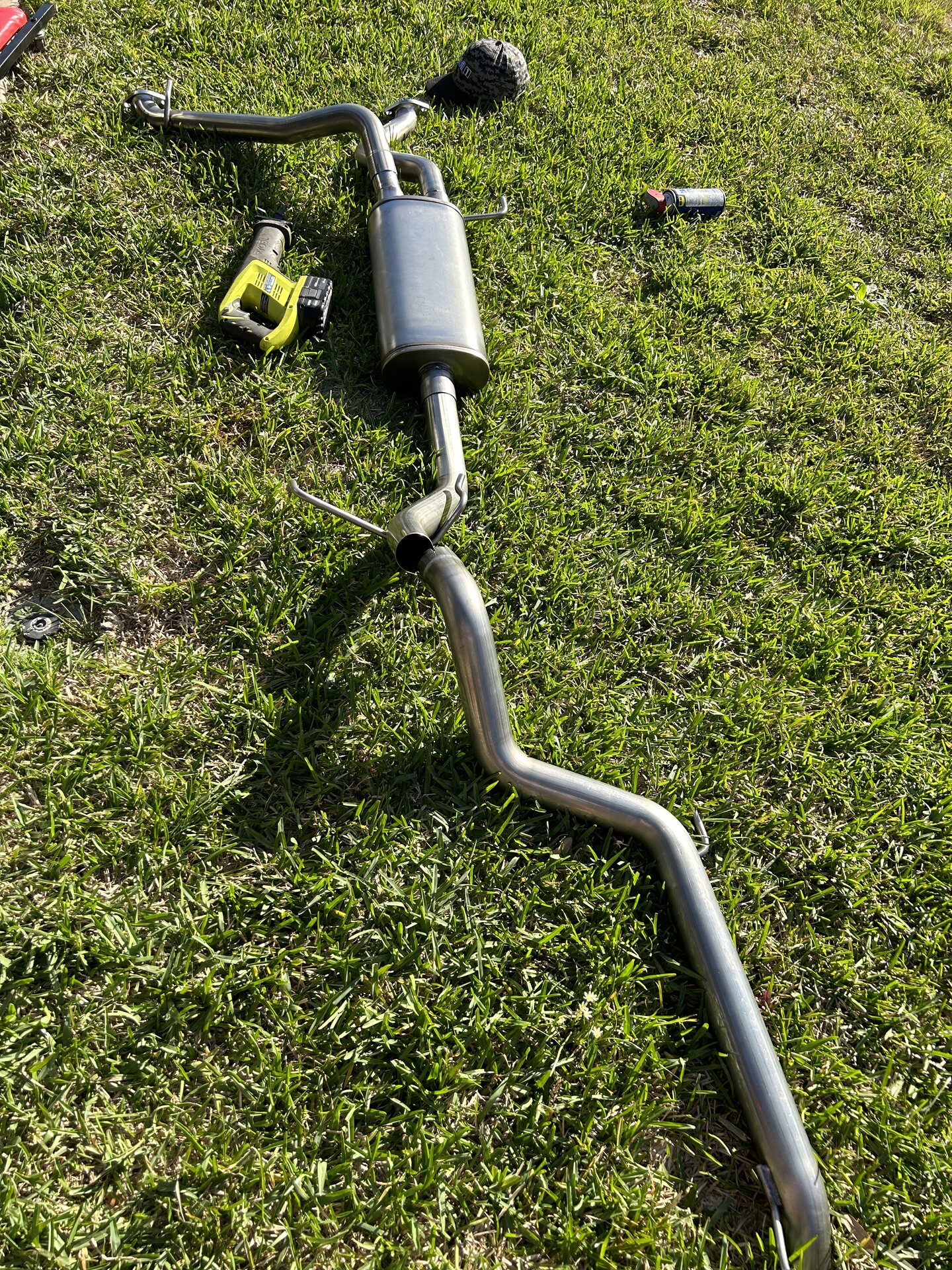

On Sunday, I decided to unwrap the Doug Thorley cat-back exhaust system. Amazing workmanship and the muffler is solid and heavy.

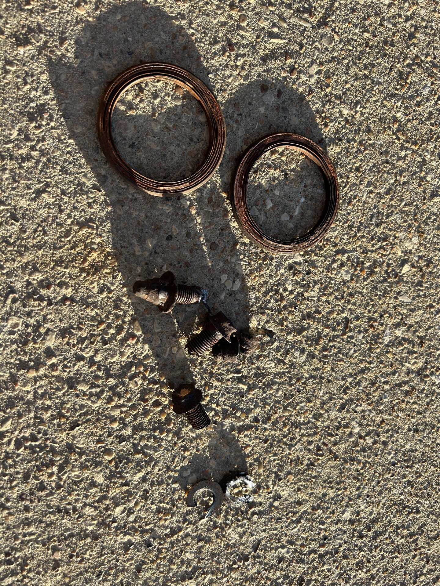

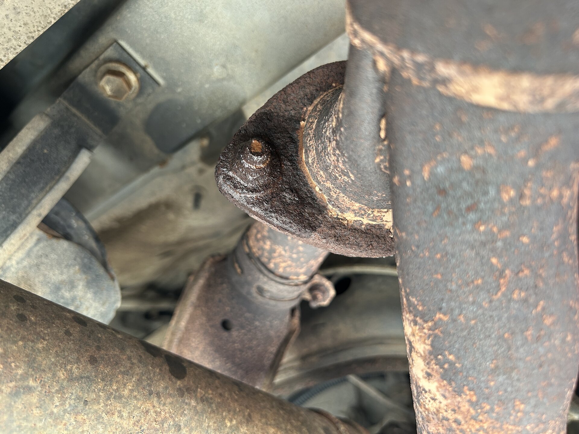

Only one nut and bolt backed out out 4 at the cats so I had to break out the angle grinder and cutting disc, then air chisel to get the others out.
The kit says to reuse the gaskets but I got new ones.
Some carnage
Then the hole that has been heating up the floor board
all cleaned up and ready for the new gaskets

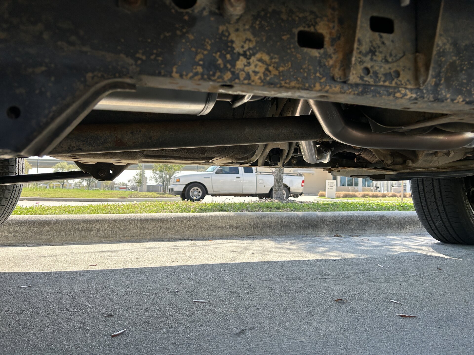

This exhaust tucks up very nicely.
The exit is tucked up real high and tight too.
Quality and fitment are spectacular.
It did take 3 months from Summit to come in.
Sound impressions - Great! Sounds stock at idle, a little rumble when slowly taking off, and sounds full flowing and not loud at WOT.

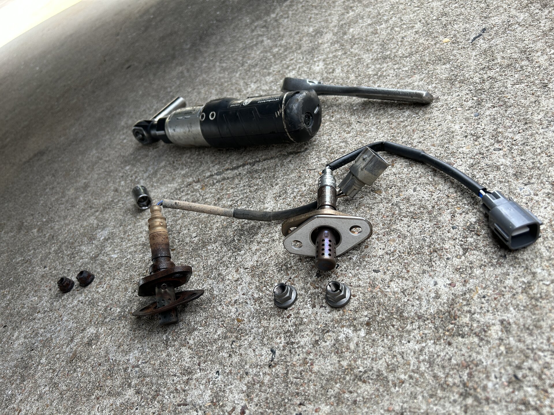

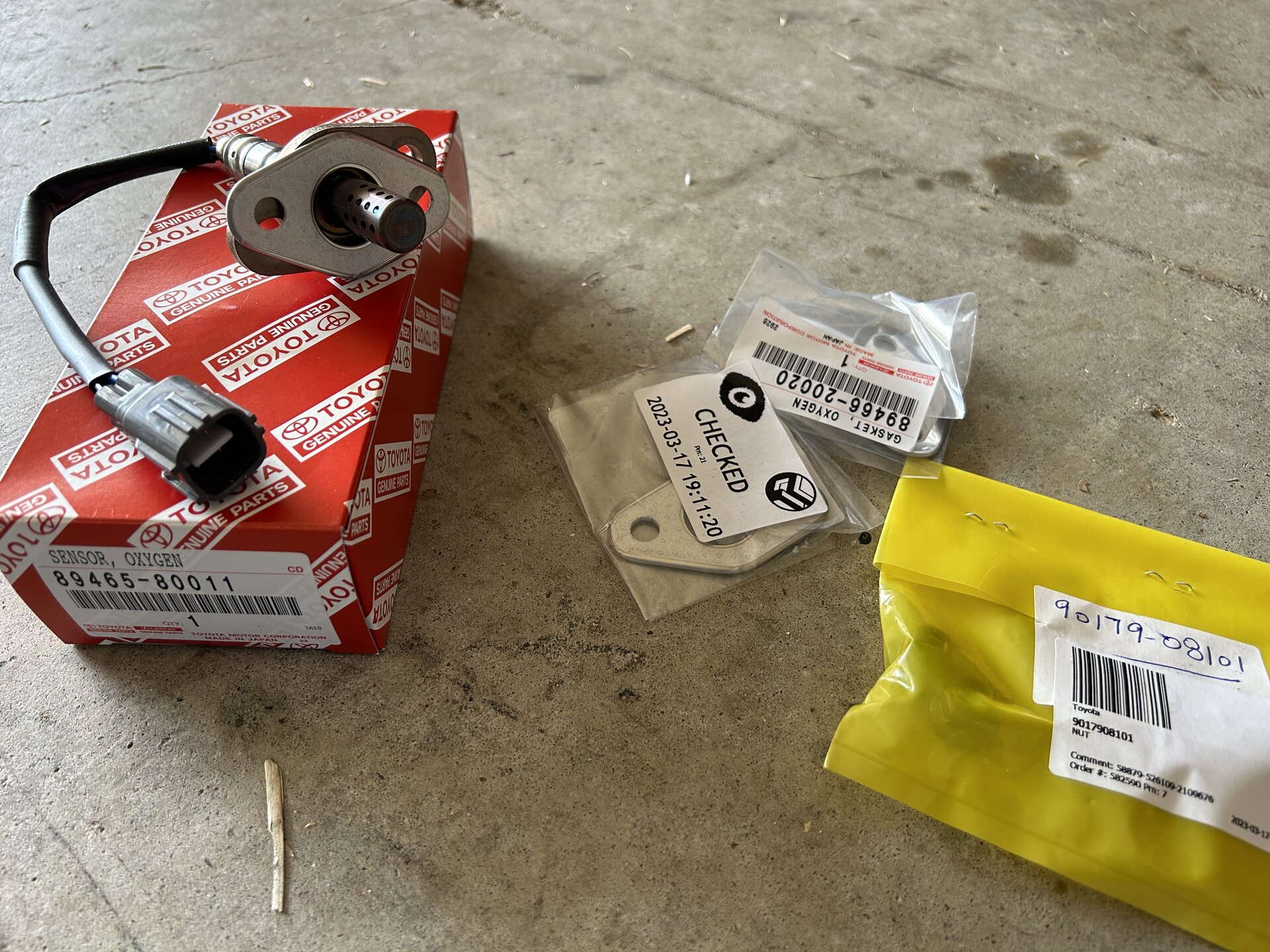

Well, after my cat back exhaust install, I popped a P0161 DTC. I figured that during the rough removal of the exhaust bolts I had damaged the O2 (Bank 2, #2) sensor. I went ahead and ordered one from PartSouq along with a OE Fuel Pump. My Napa fuel pump has some hot start issues. It always starts but sometimes takes too long. I went ahead and got all of the factory replacement parts for the fuel pump as well.
After soaking the nuts in PB Blaster through a couple heat cycles I went to remove the old O2 sensor. Surprisingly, the first nut unscrewed easily and I noticed the Sensor was loose. Checking the other nut, it was merely hand tight. A loose O2 sensor would cause air leakage and cause the truck to run rich (and pop a code) which it did. Did I shake the nut loose during the exhaust install?
Oh well, already there, I put the new one on. No codes yet!
The nuts were almost 1/2 gone. I am surprised how easy the nuts came off.

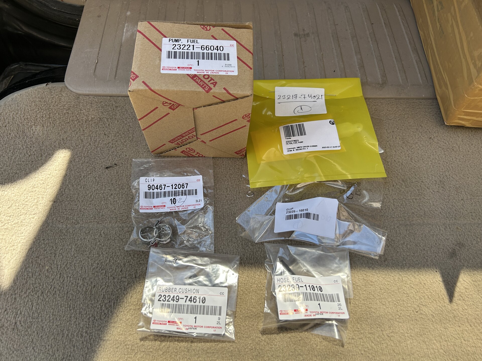

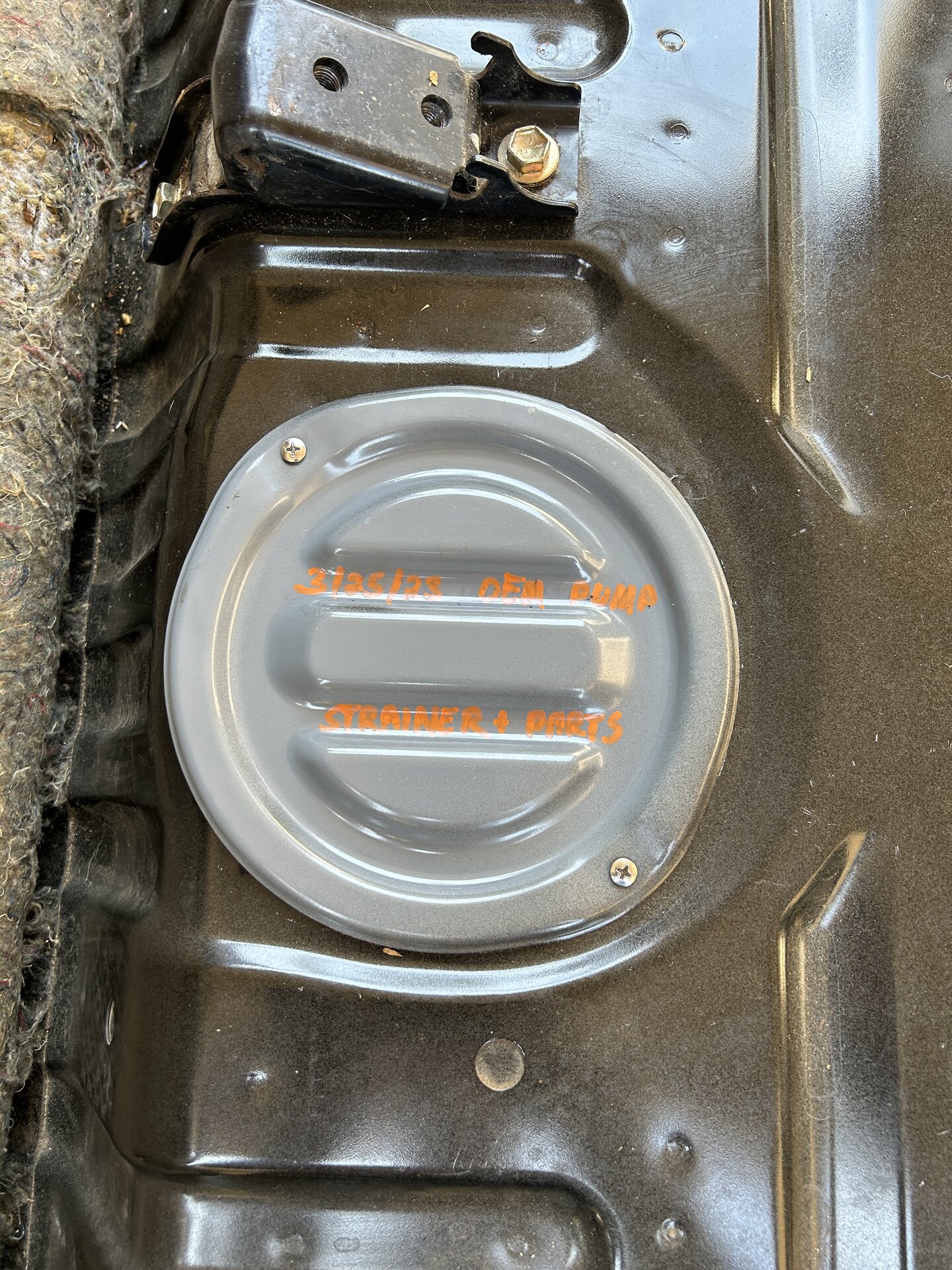

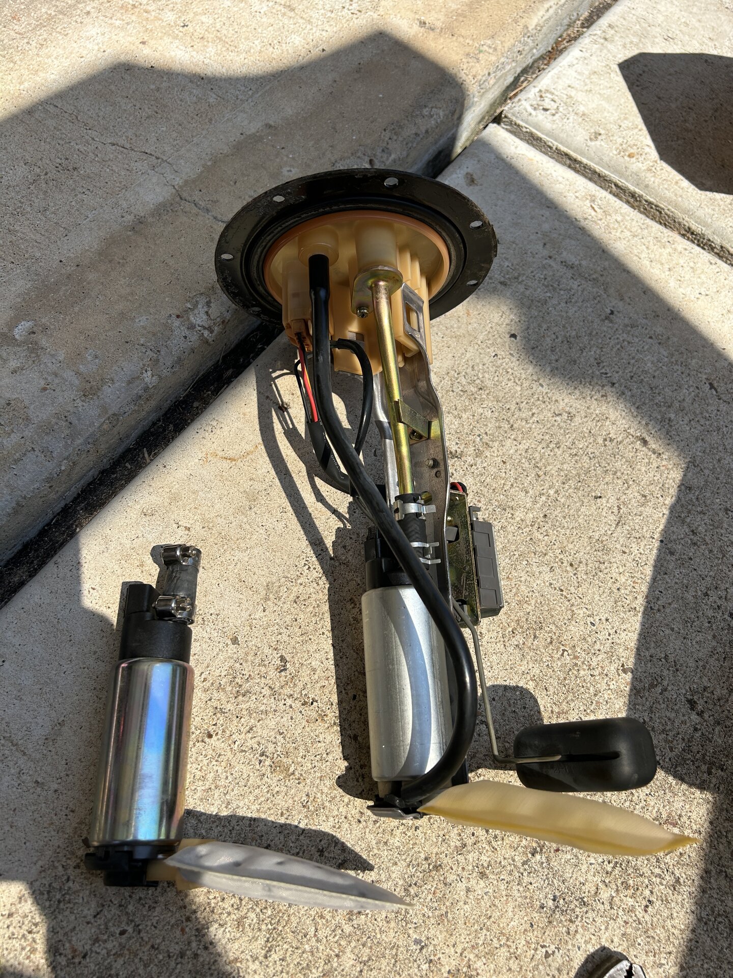

Had a couple free hours this morning with not much to do so I installed the OE Fuel Pump and related parts this morning. Pump, clamps, hose, rubber cushion, clip and screen/ filter.
Toyota part on the right. Napa part on the left
Had to scratch my date off from about a year ago and put the new one on.

I will also mention that while I was replacing the AHC rams, I pulled the Mount Bushings off and they were in really good shape and had a lot of rubber elasticity left. The outside diameter it looked like the bushings were cracked and blown out but inside that area, they were not hard biscuits and were not cracked through.

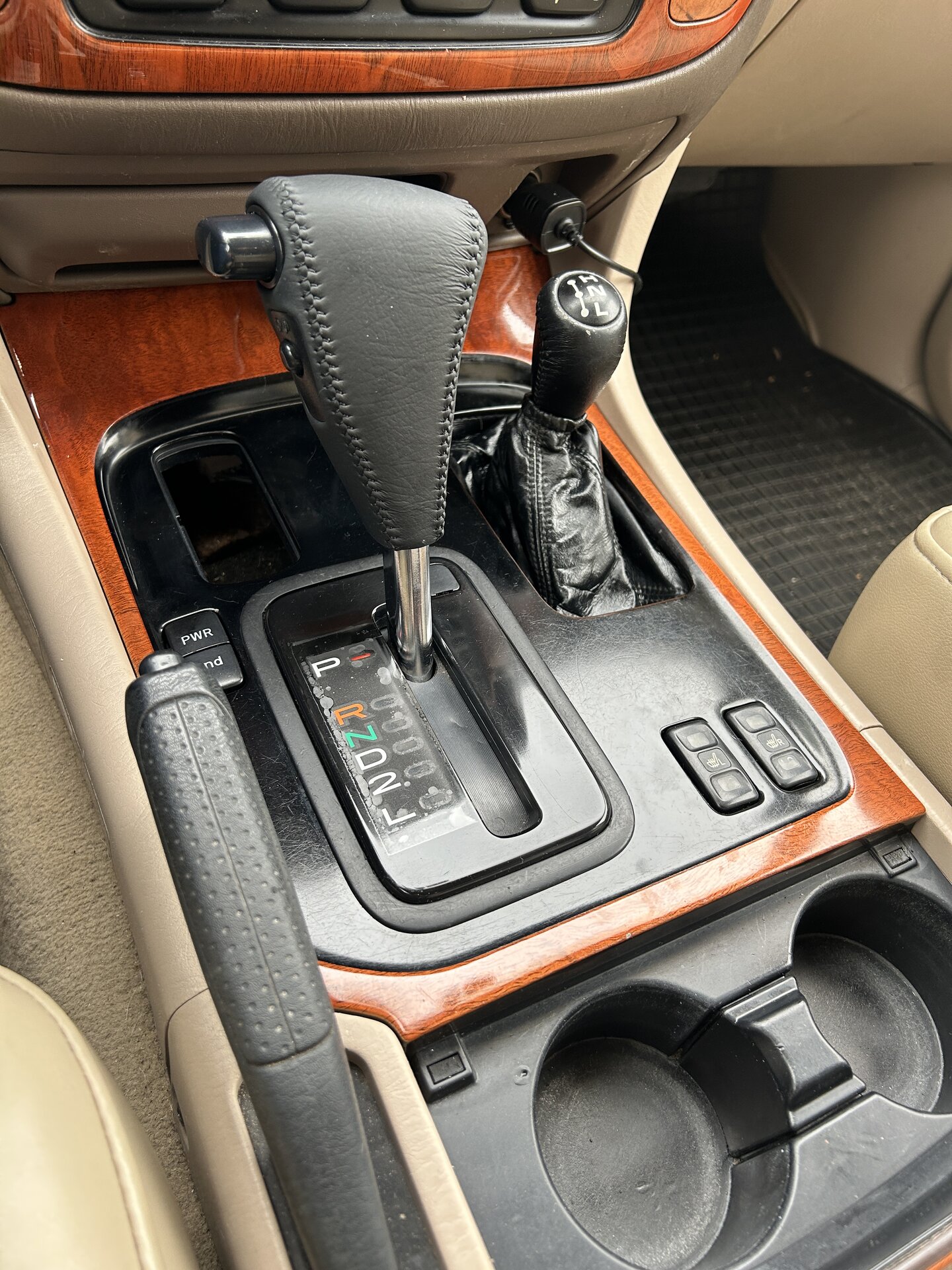

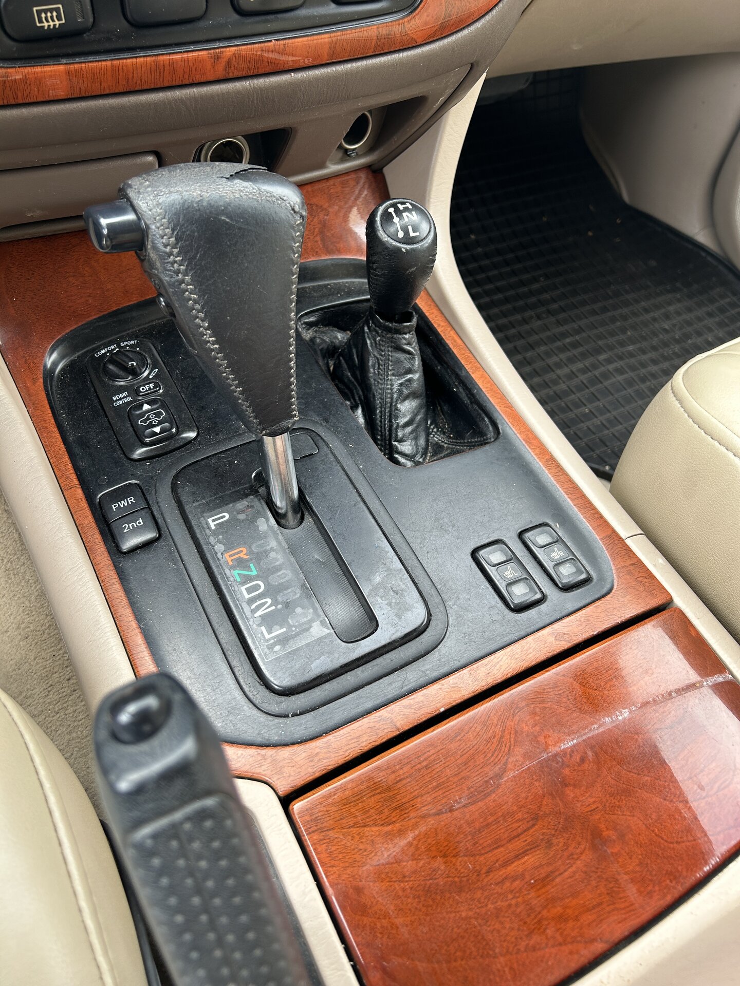

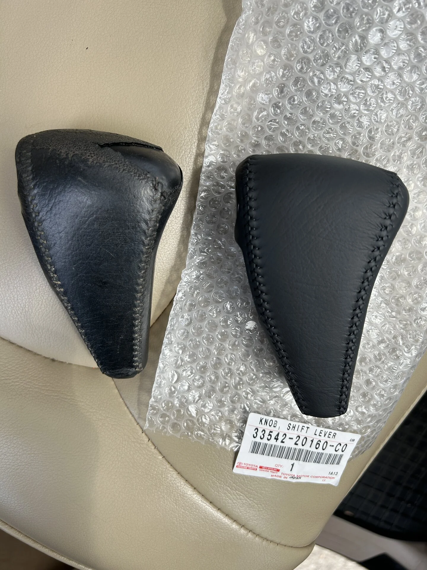

Since putting the new shift knob in my wife’s LC, I decided to do mine. Mine had the typical wear.
New vs old
After a good cleaning and polishing of the center console it’s all back together and looking great. I need to redo my shift numbers like the LC.

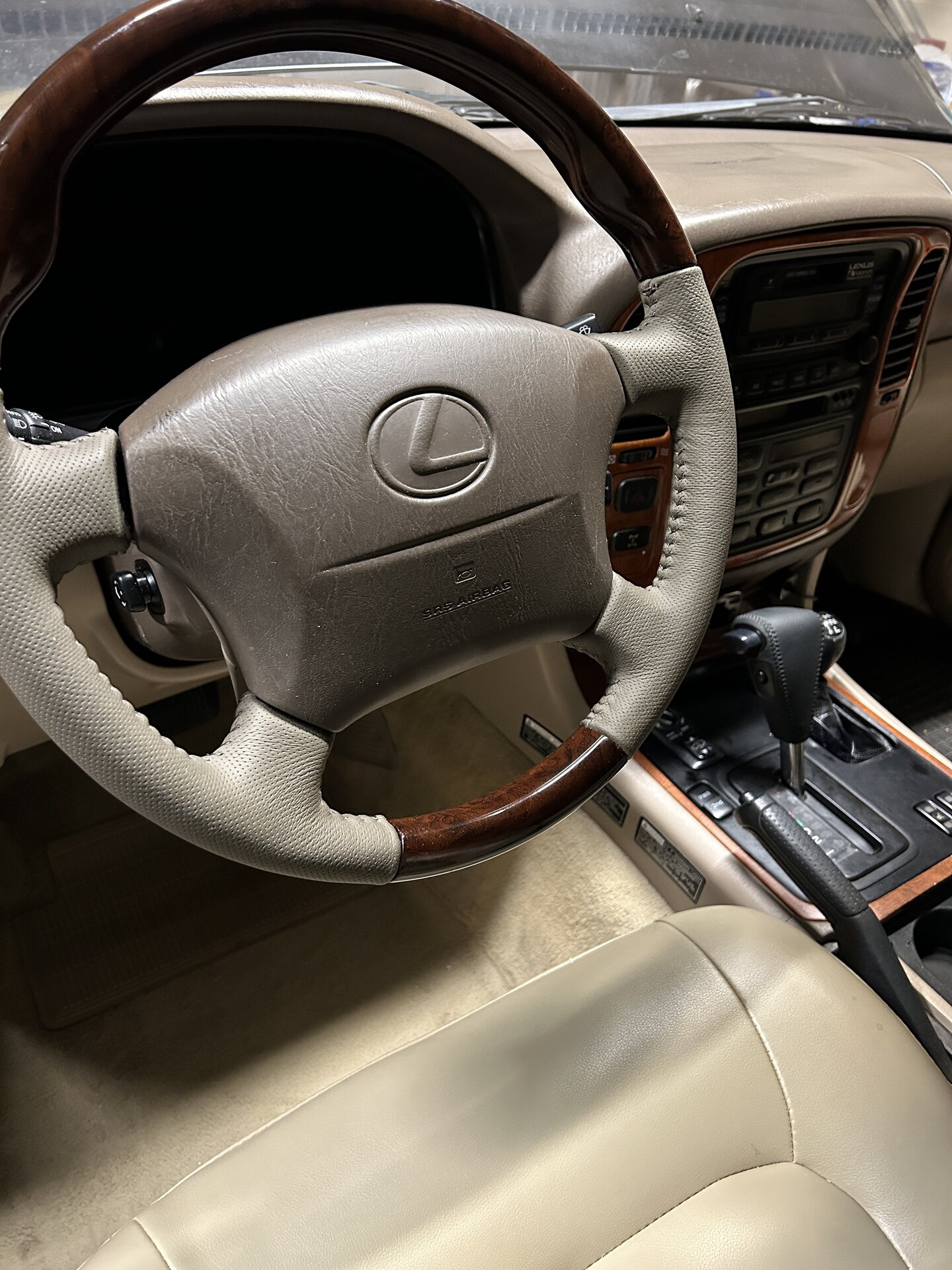

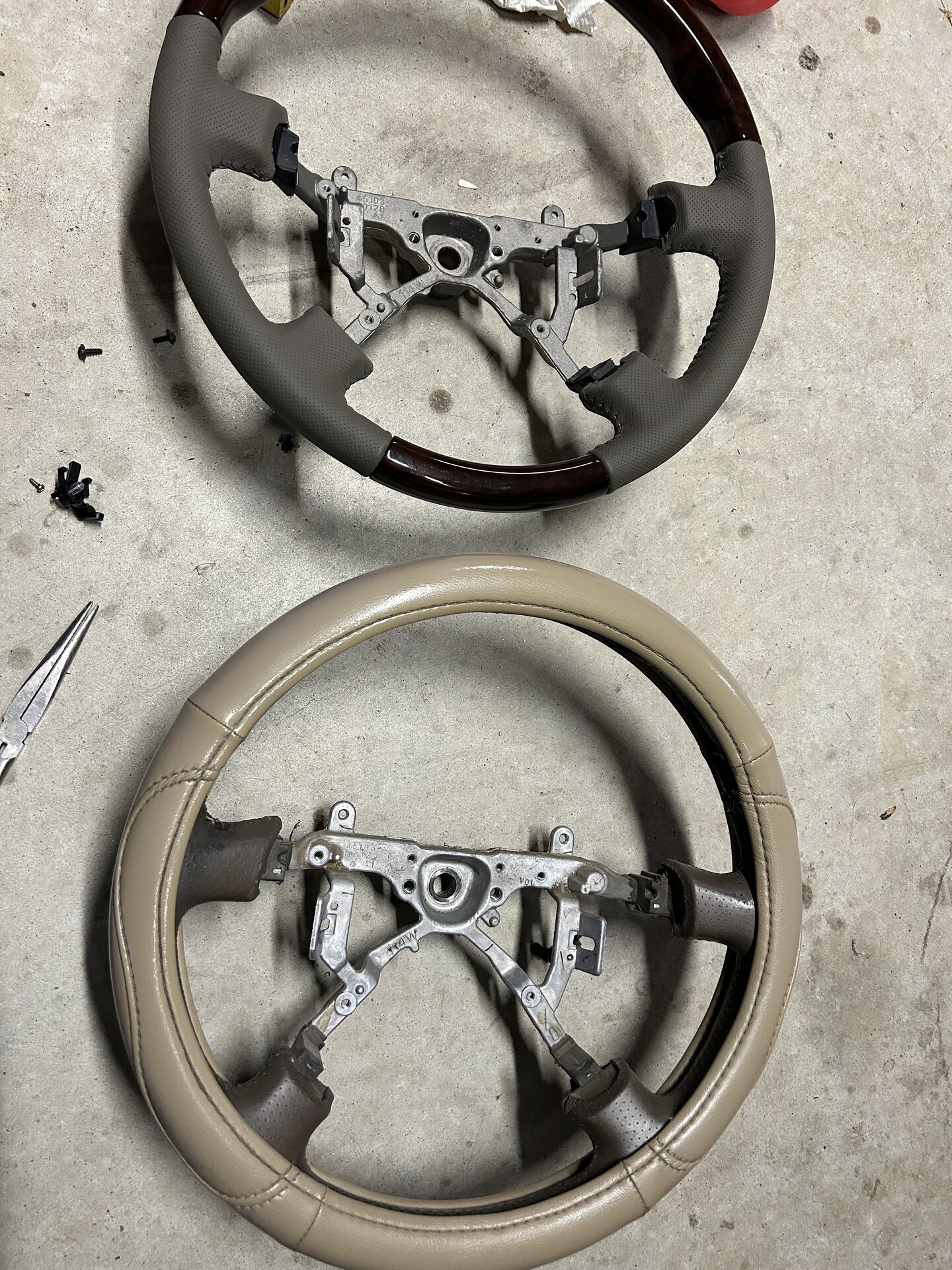

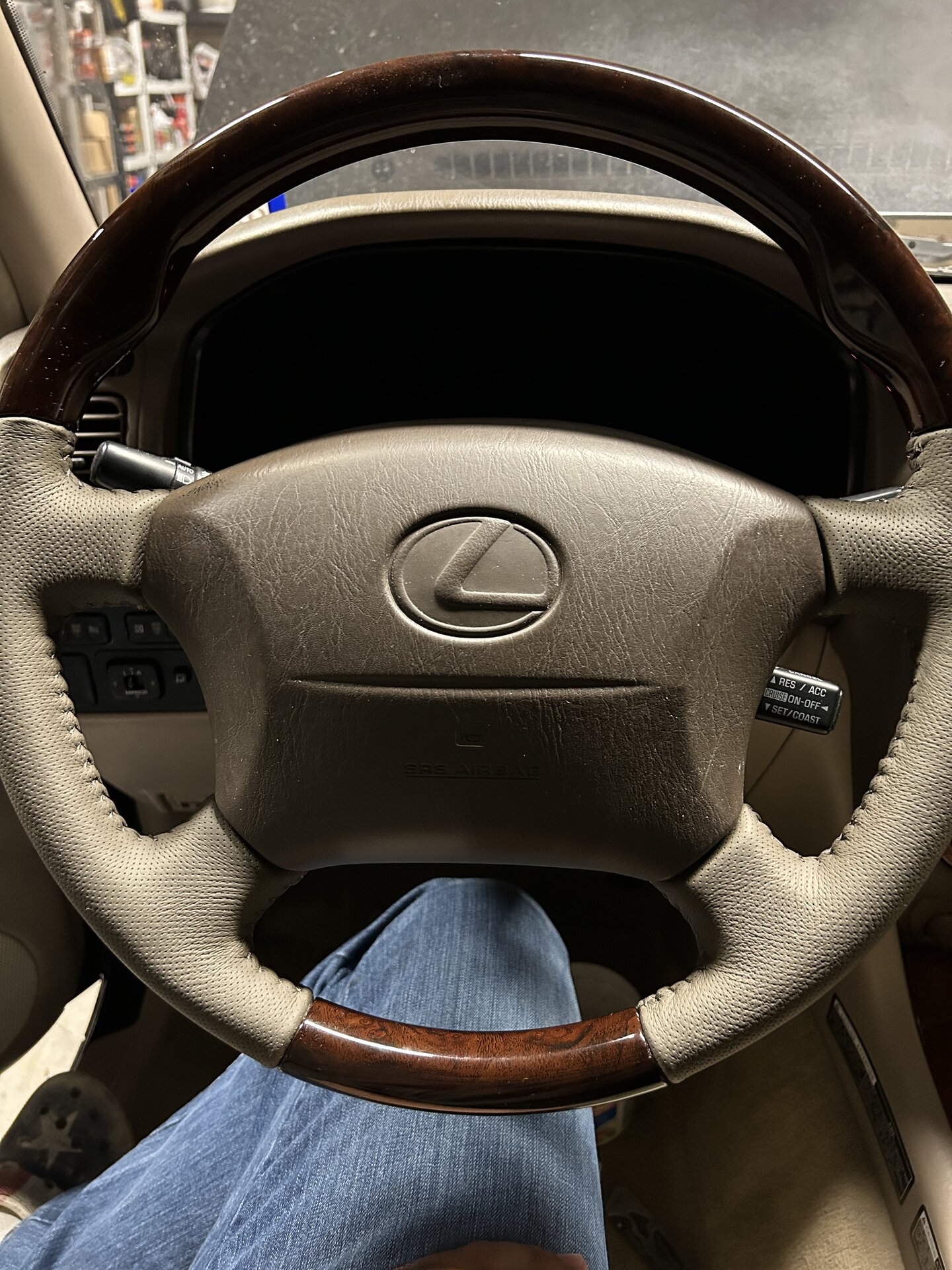

Also, I ordered one of those EBay steering wheels and threw that on.
Old tattered wheel with a custom cover.
Side by side
New wheel. The color match is much better than the pics show.
New wheel and shift knob. This thing is getting too fancy.

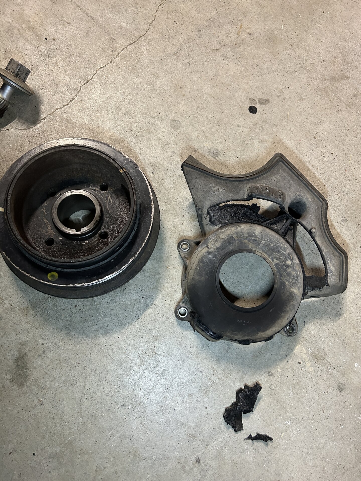

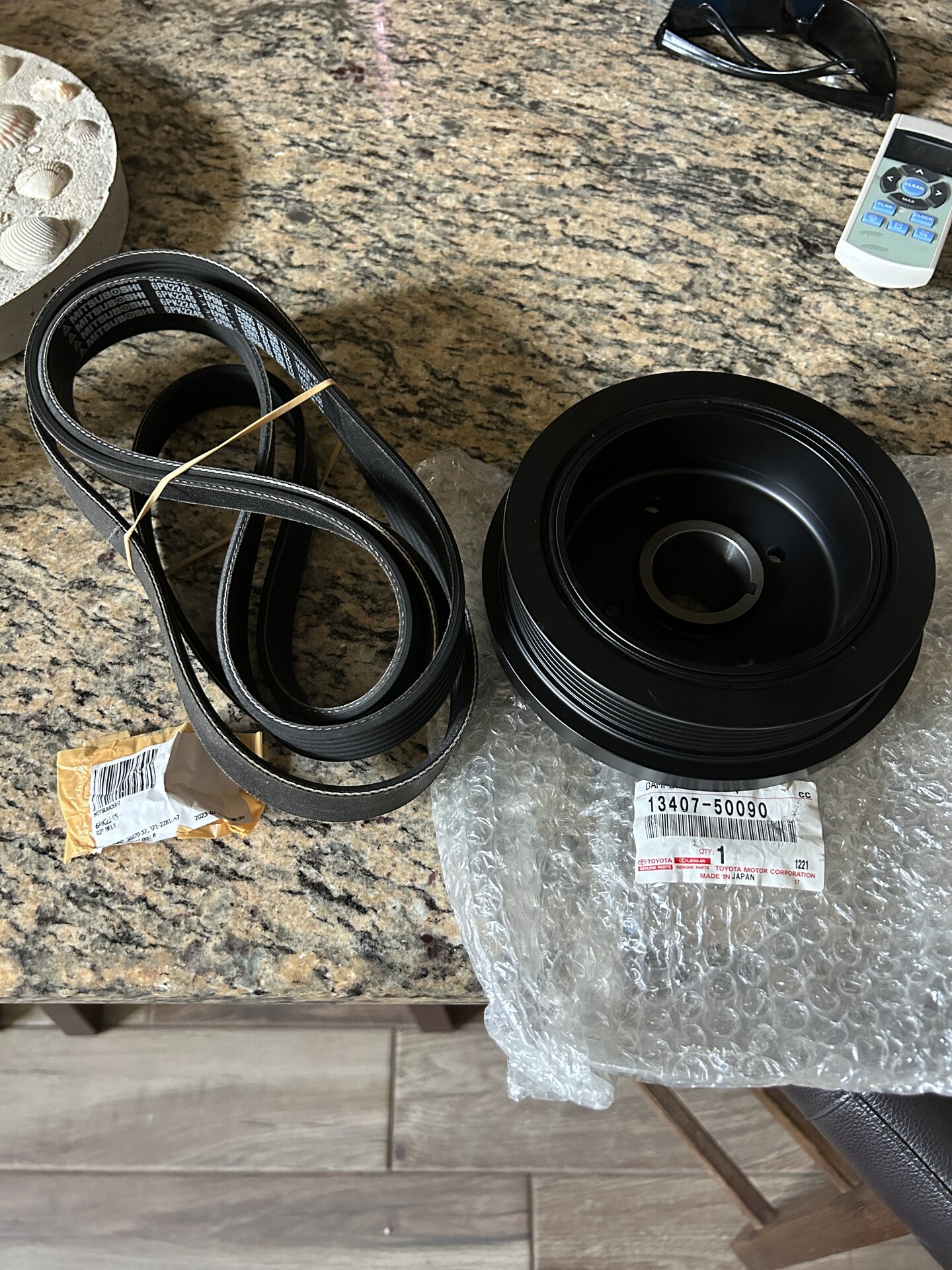

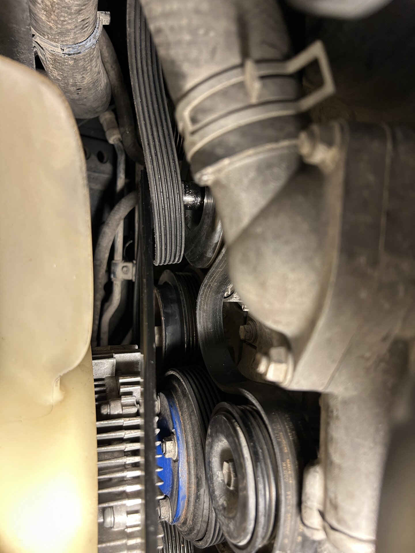

The day after we got back, my wife started the car up and it was squealing like a fan belt.

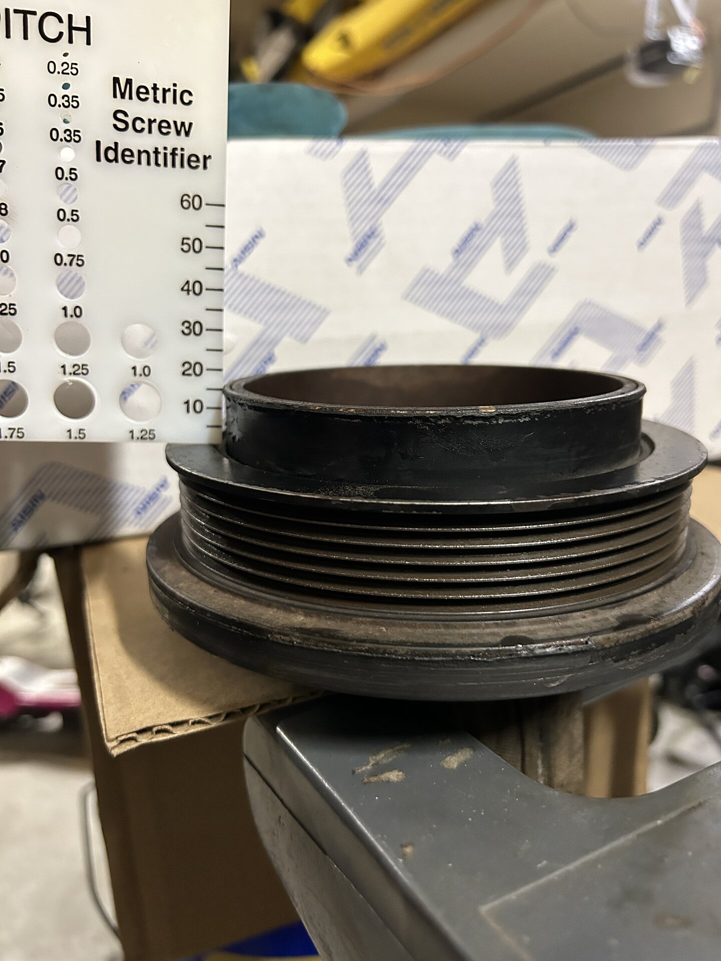

Quick diagnostics, all pulleys turning freely, she ran off to the store and back and said it got worse. I popped the hood to find the belt shredding. I replaced with an old hood belt and it instantly shredded it, then I saw why…
The crank pulley / balancer was not aligned. The pulley had walked off the damper rubber.
It also ate into the lower timing cover.
Parts are ordered.
Parts are ordered.

We are reaching the age where the rubber dampers should be starting to disintegrate. I will look to order one and then work it in with some other preventative maintenance.
Yep. I was debating doing the timing belt job (already have all the parts) while doing this but decided to just get her back on the road.
Gotta get it done before Fall Baseball starts though!
Replaced the Harmonic Balancer / Damper / Crank Pulley yesterday and put the old timing cover back on. New timing cover will be here early next week and I did not want to wait. Everything runs great again.
