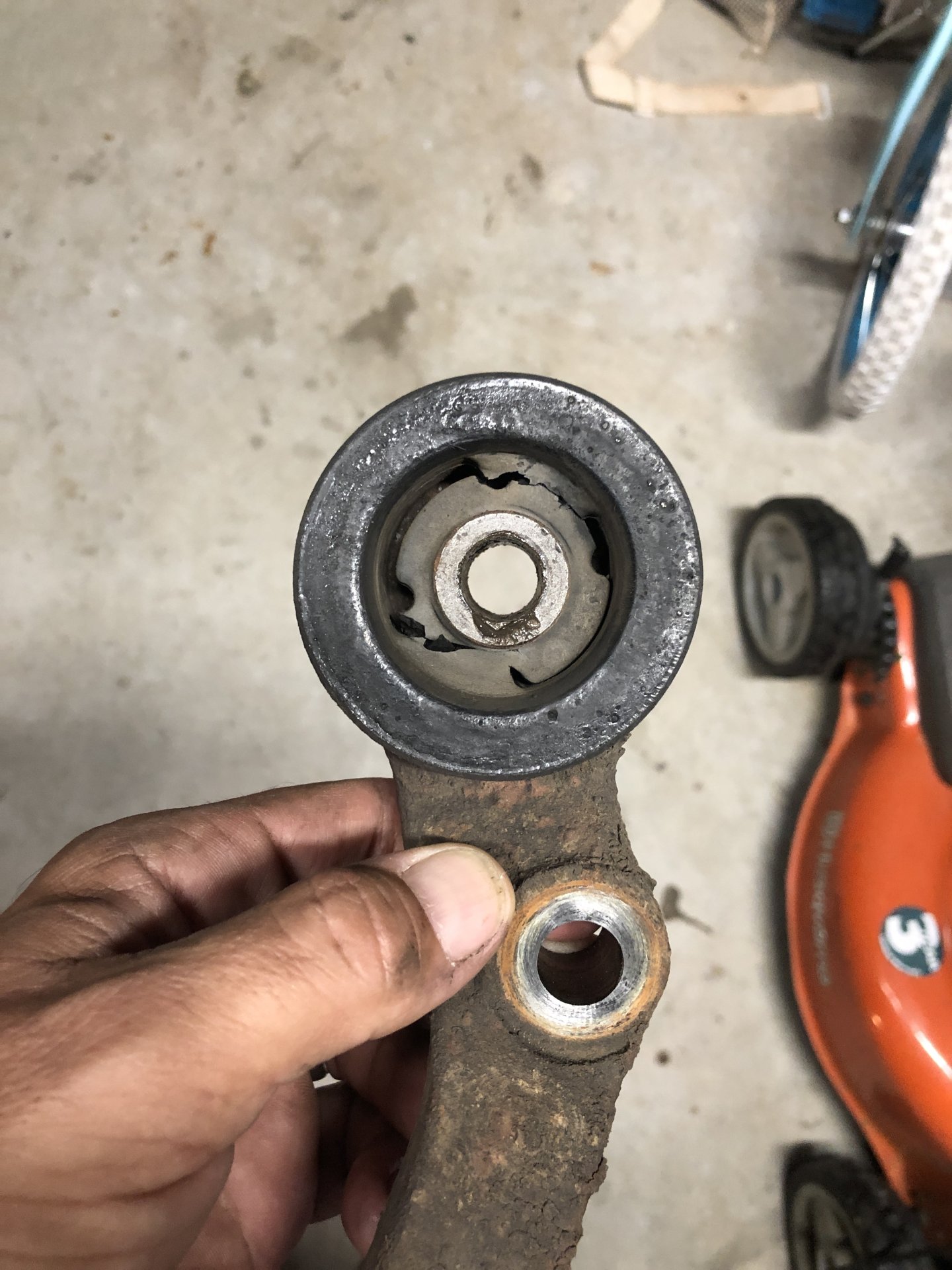

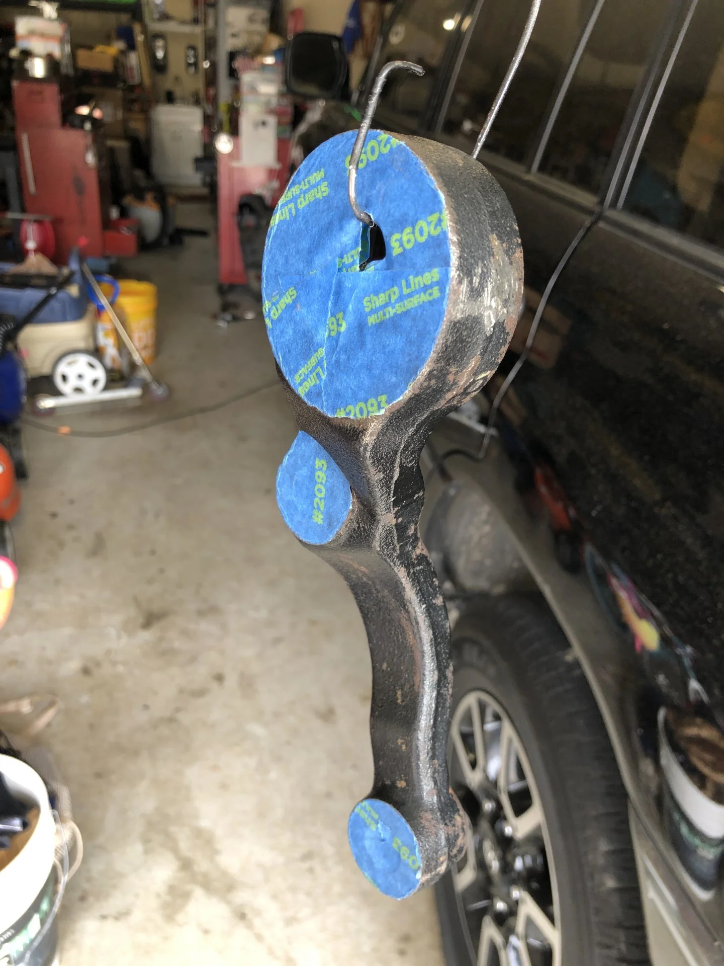

After not getting much change out of the torque arm bushing I decided to knock the rear arm bushing out.
Guess what? Looked good but once out, you can see it is broken completely.
Hit it once with a hammer and the internals fell out.
I removed the cup bushing the same way as the front diff bushing - hammer, chisel, air chisel, Vice grip clamp and bang on it.

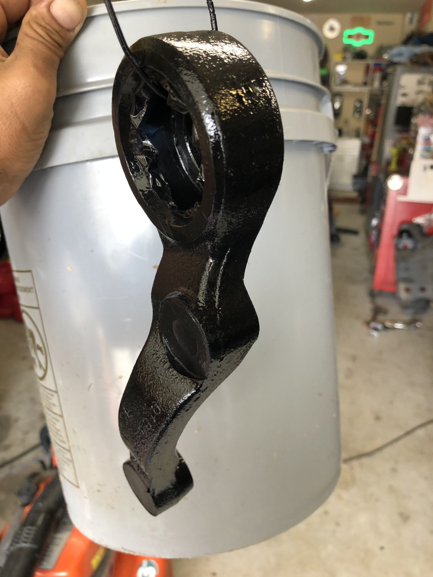

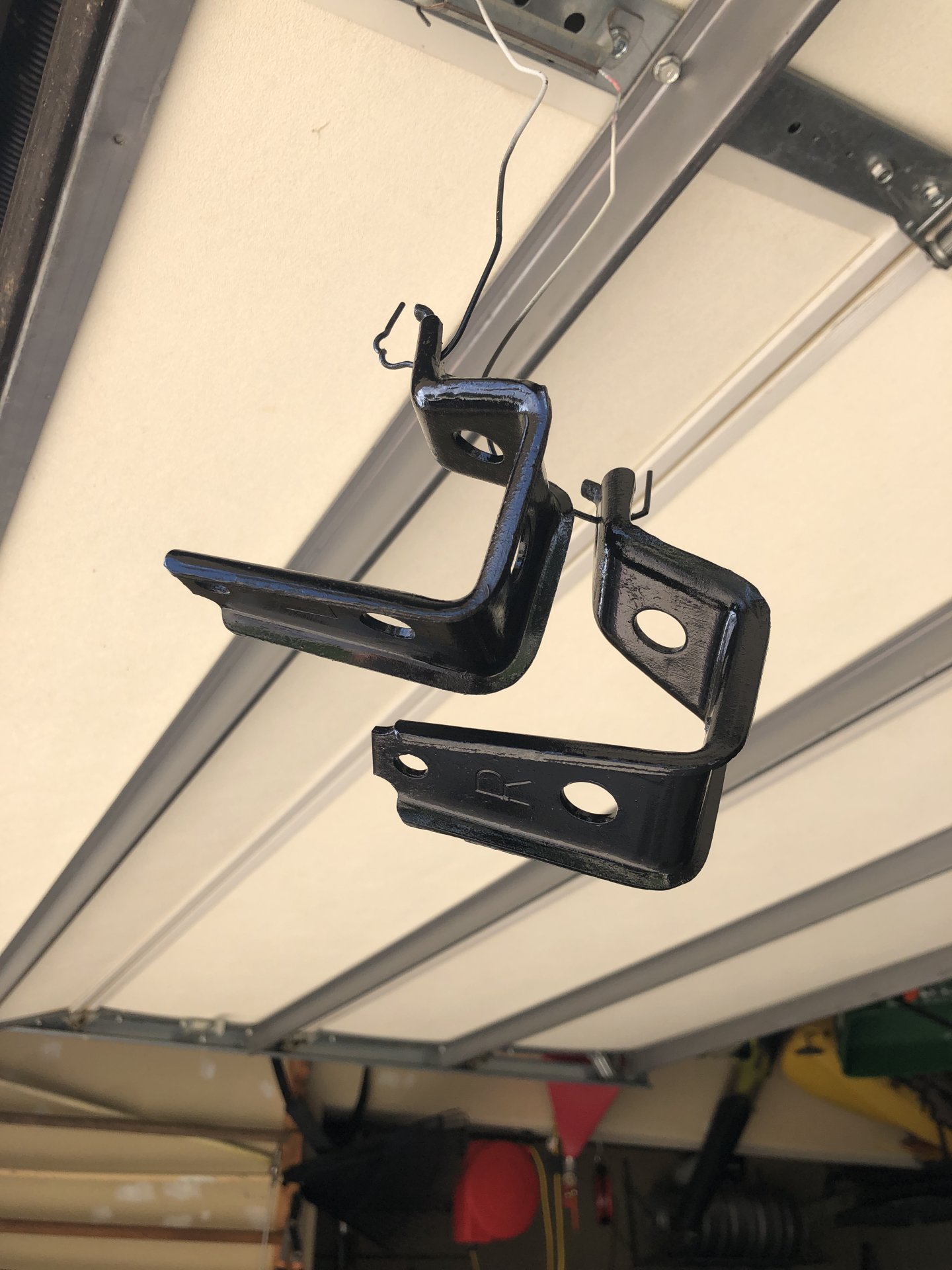

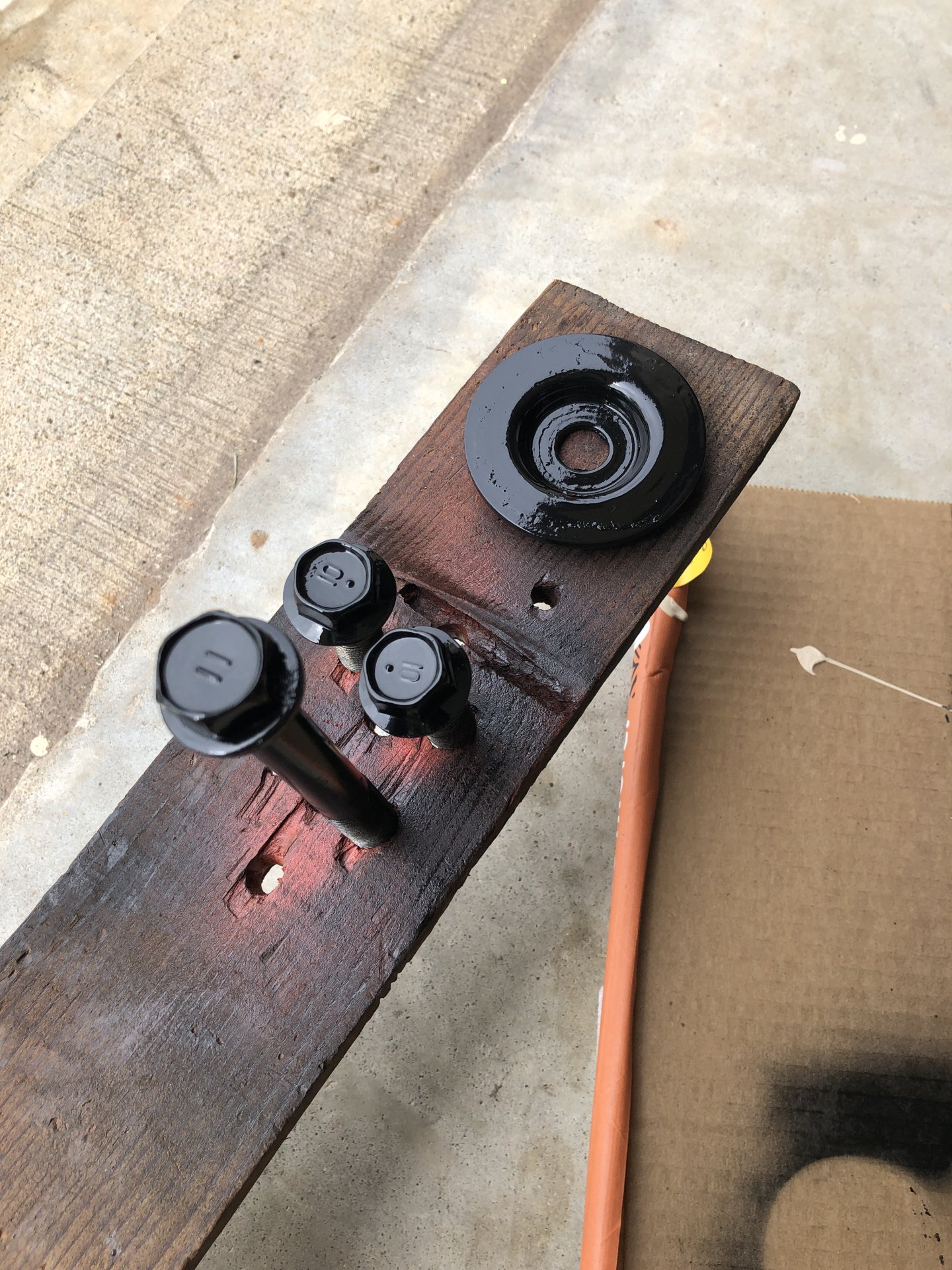

Cleaned everything and masked for paint.
Post paint

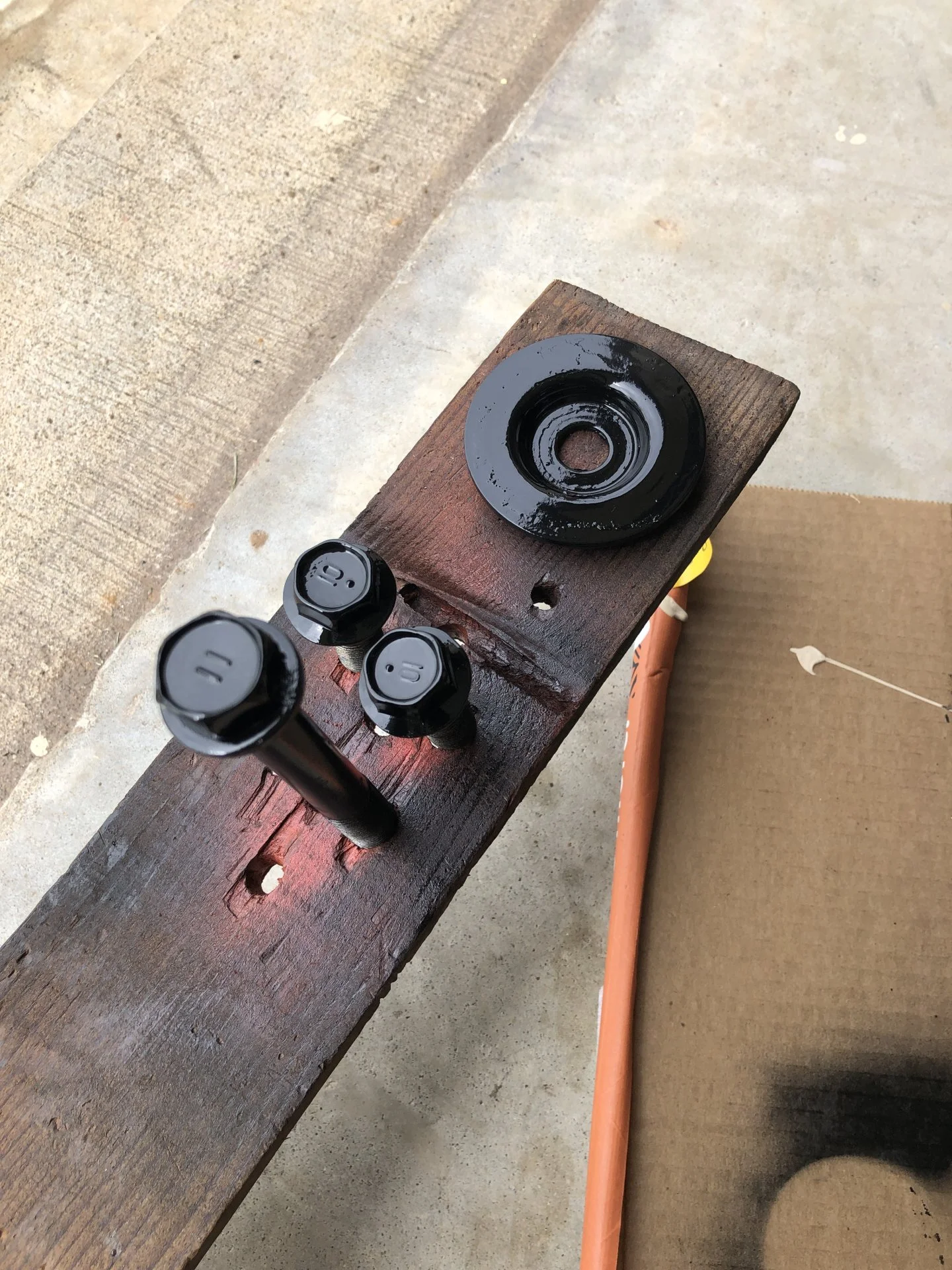

Gotta clean and paint the hardware too because I am me.

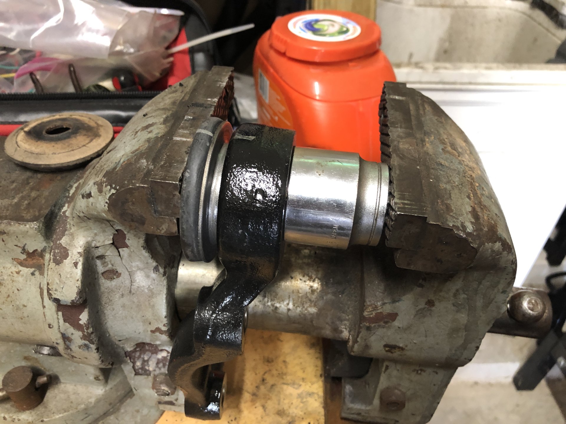

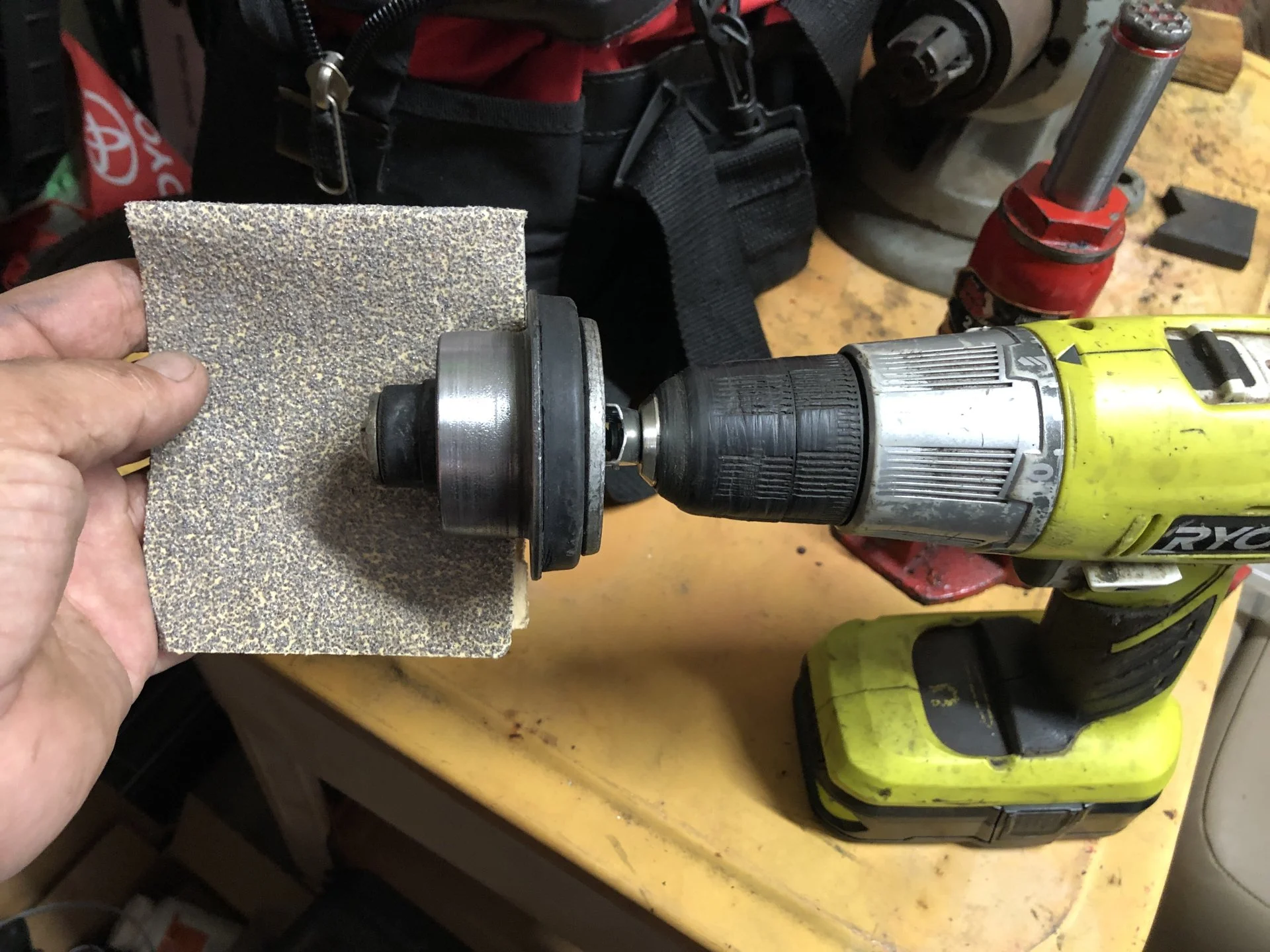

After the struggle with the first two, I took a caliper and measured the bushing and hole and the bushing was bigger than the hole by .17 mm so I took it to the lathe (LOL) and turned it down a bit.
I greased them up and put it in the big vise and pressed it in most of the way. Hit it with the dead blow hammer to finish setting it.

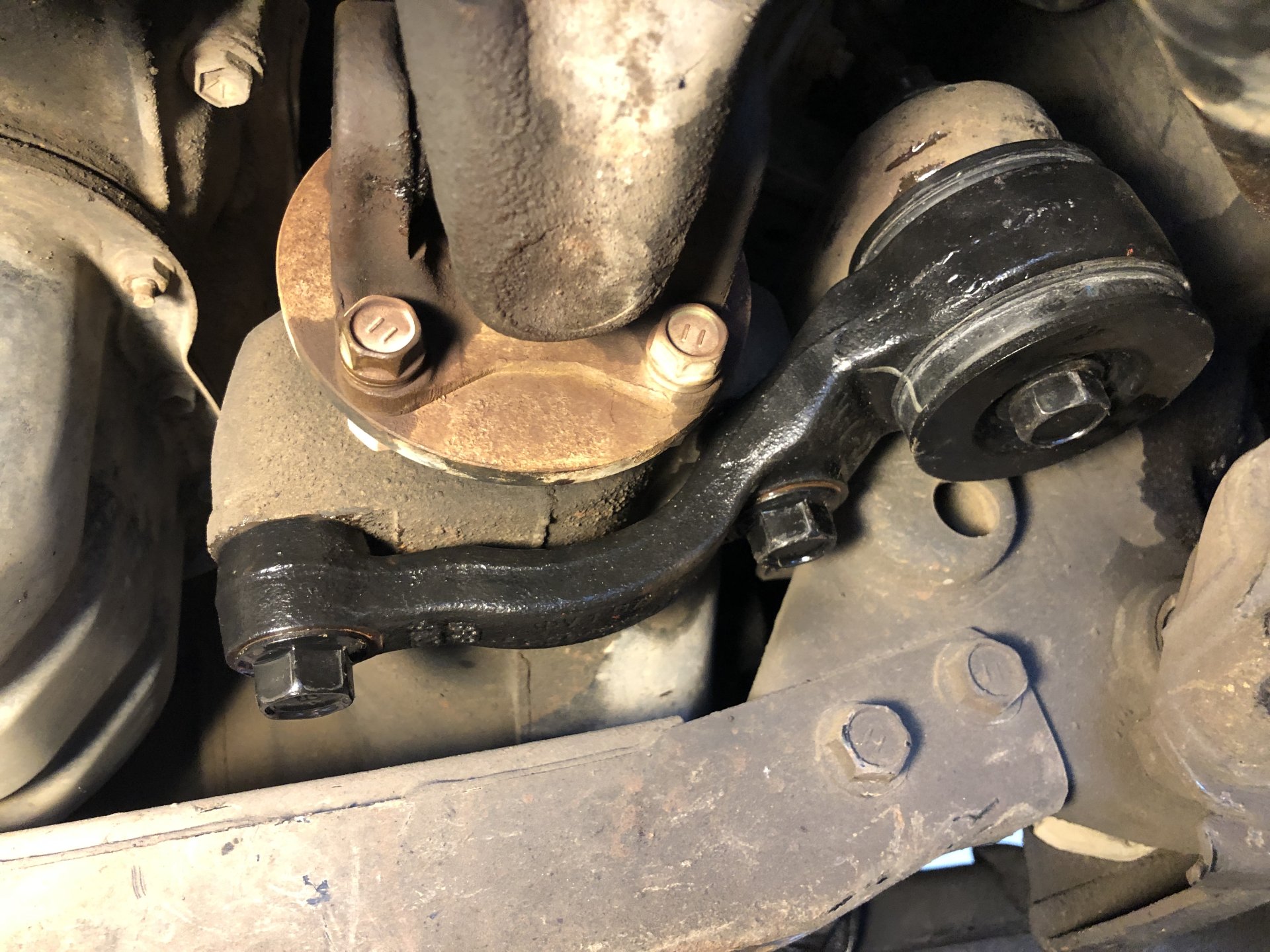

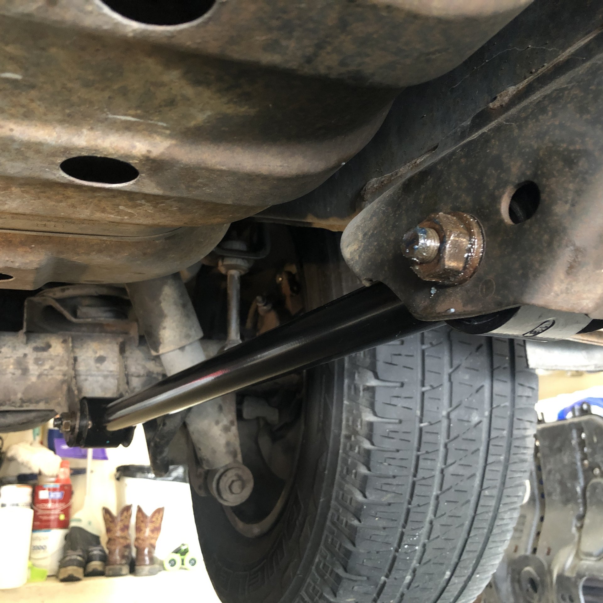

Marked, aligned, pressed, painted, and dated. Ready to go in.
All in.
Driving impressions after all 3 bushings (especially the last one) - Smoother acceleration, about 60% of accelerating vibrations are gone. No, none, zero, zilch, nada P-R-D clunk! No more brake to accelerator clunk.

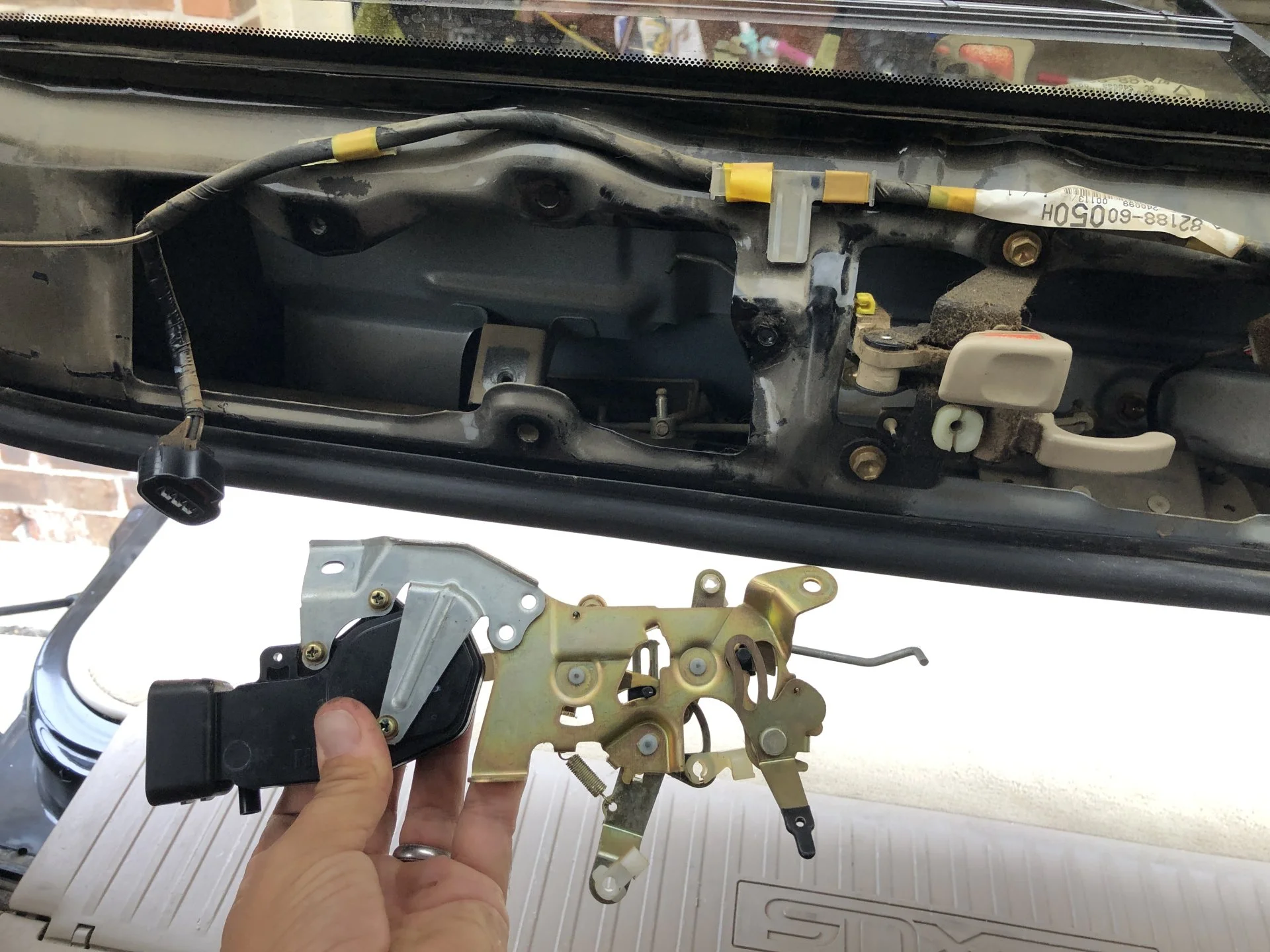

First 90* day in Houston and my rear hatch (which has never given me issues) quit unlocking. I bought 6 of the little actuated motors (1 for the LX, 5 for the LC) in case the others go out a while back.
Of course it went out when I got to baseball practice (I coach an 8 y.o. Little League team and a T Ball team) so I had the wagon full of baseballs, bats, gloves, Tees, and other training equipment in the back. I sent the little ones back to open from the inside and it didn’t work so we ended up funneling it at out through the door. Luckily, I have a folding wagon.
Come to find out that night that the child lock was switched on the back hatch.
Pulled apart - look how dusty!

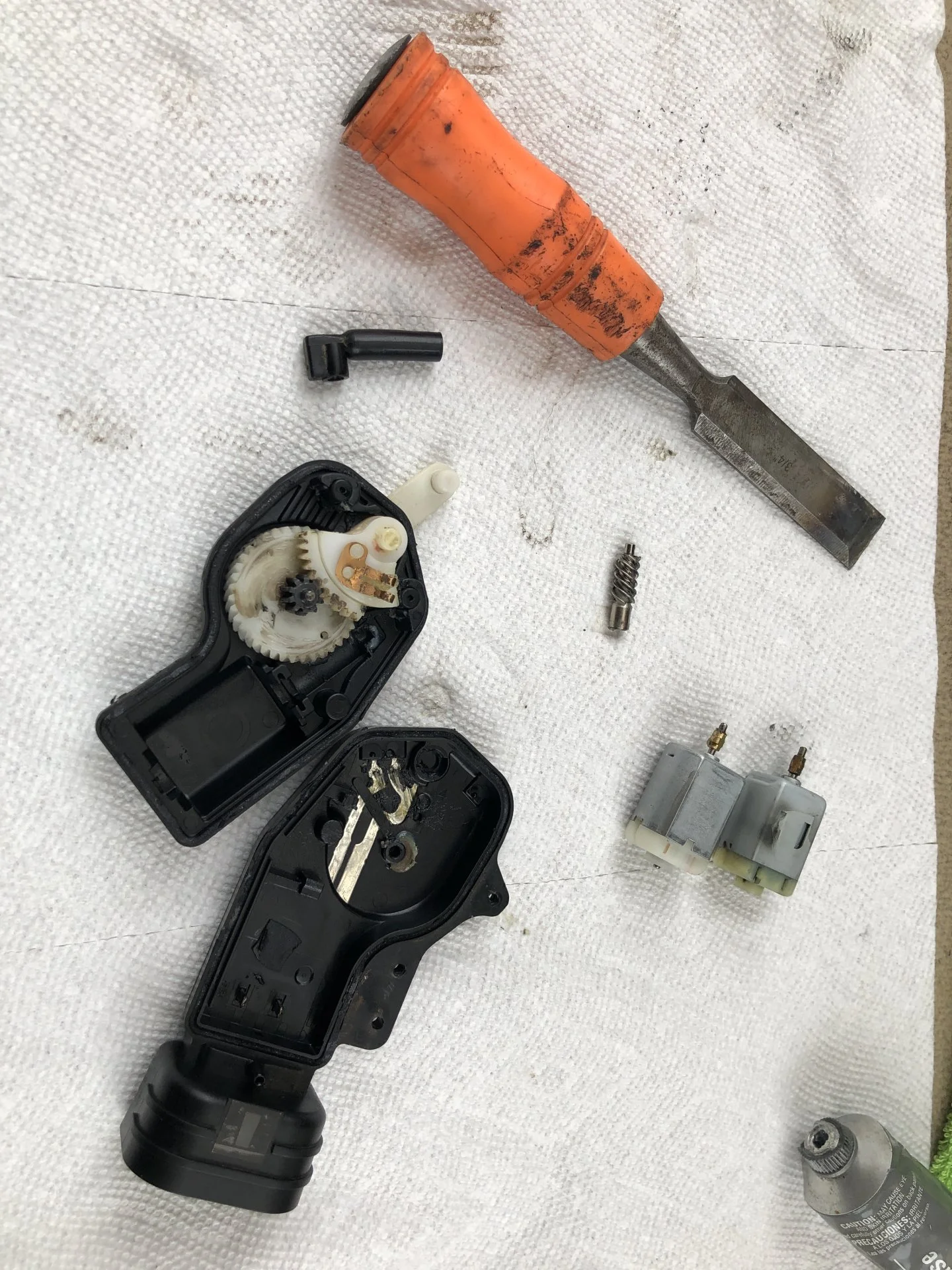

Using the typical tools to break the case open.
Cleaned, regreased, JB Welded, all other parts cleaned thoroughly and ready to be put back together.
Once back together, everything worked like it should.

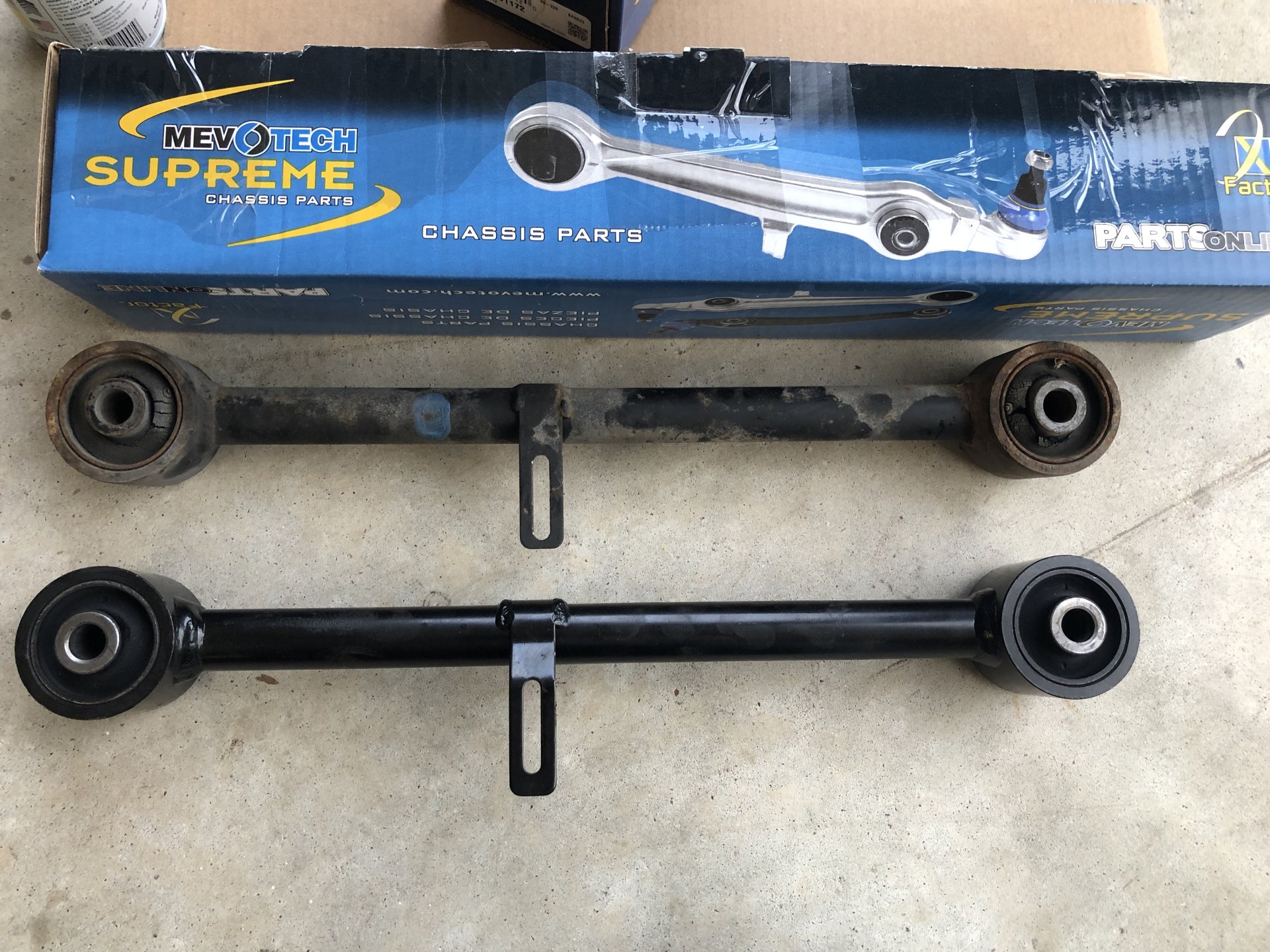

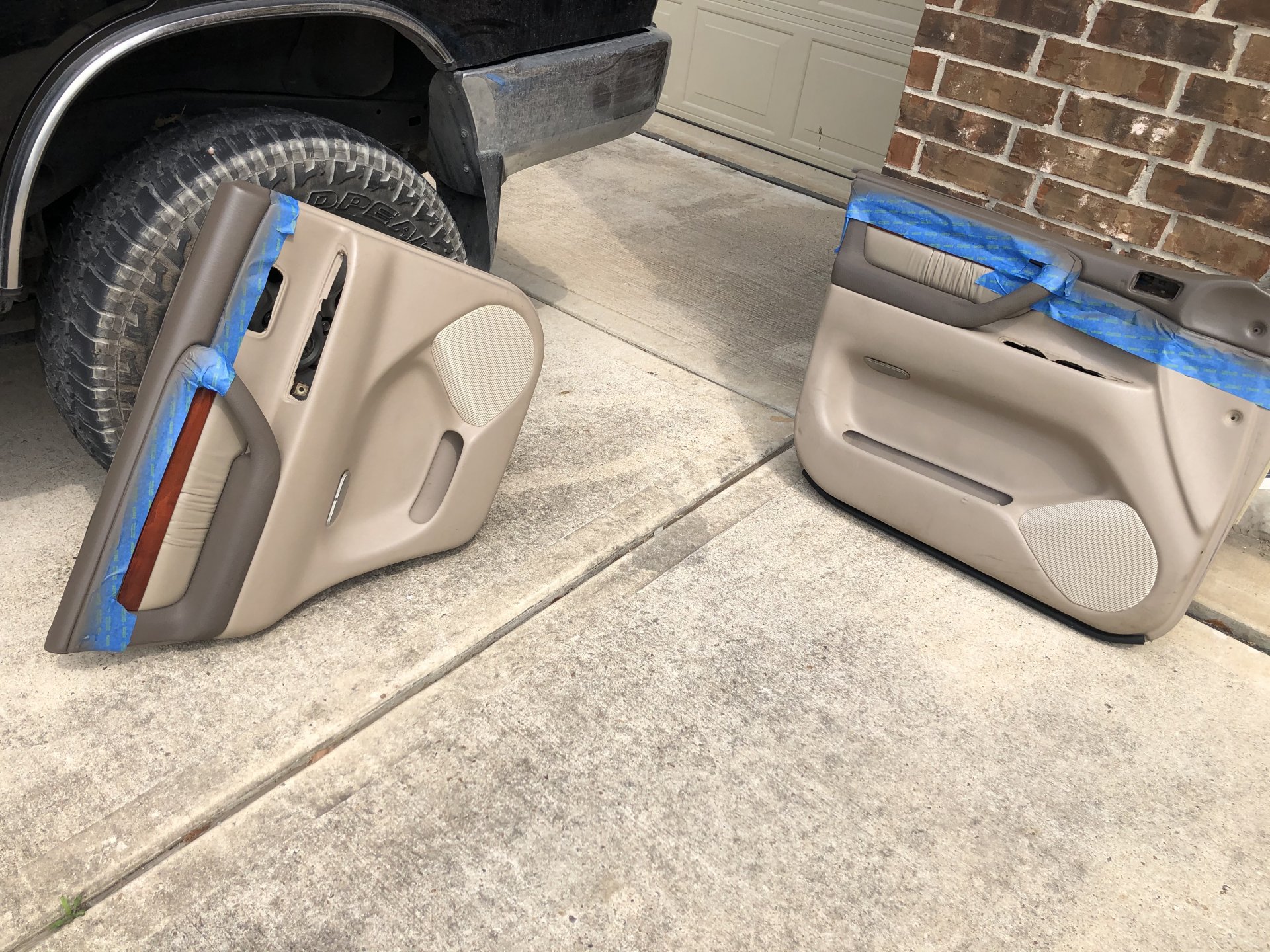

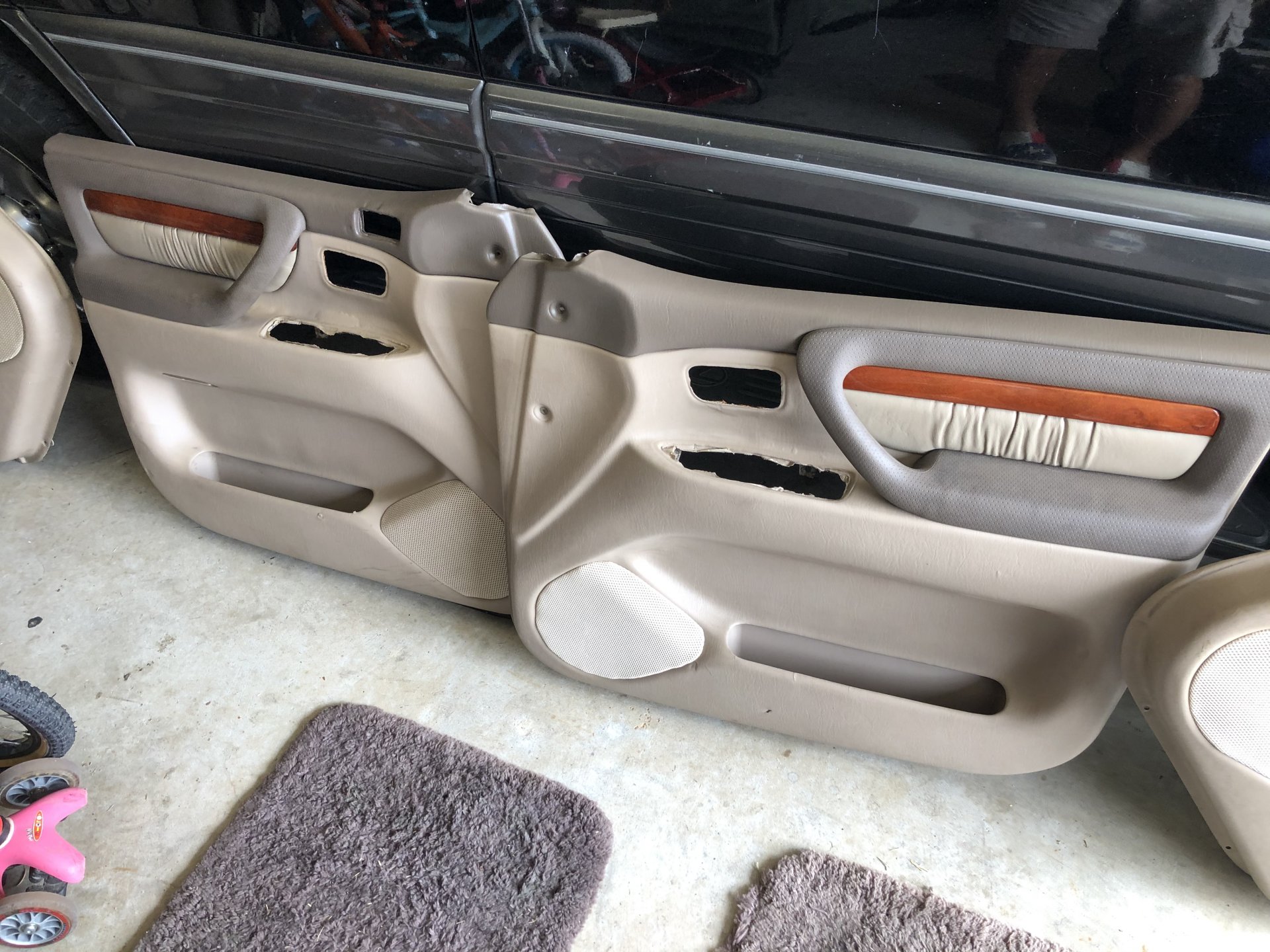

Also got Mevotech rear control arms in the mail. Bushings are bad on mine. I didn’t want to spend all day pressing rubber bushings in and out. Will install those soon.

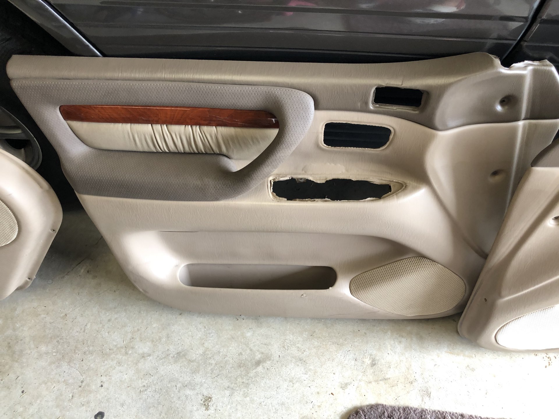

Someone suggested the vinyl spray die color and I bought it and after sitting on the shelf for a year I decided to use it. It is a perfect match. It looked so good I pulled the rest of the panels and did those too.View attachment 2788330
Did you use an adhesion promotor on these? Previous owner sprayed both my armrest and handle a different color so i am looking to do both.
No, I did not. I did scrub them with Dawn dish soap and a green scouring pad and then spray them with Sprayway glass cleaner before hand. I rest my elbow on top of the door on every drive and no issues yet. She also sits in the sun all day.

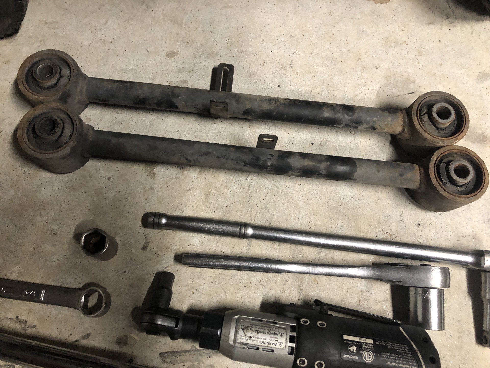

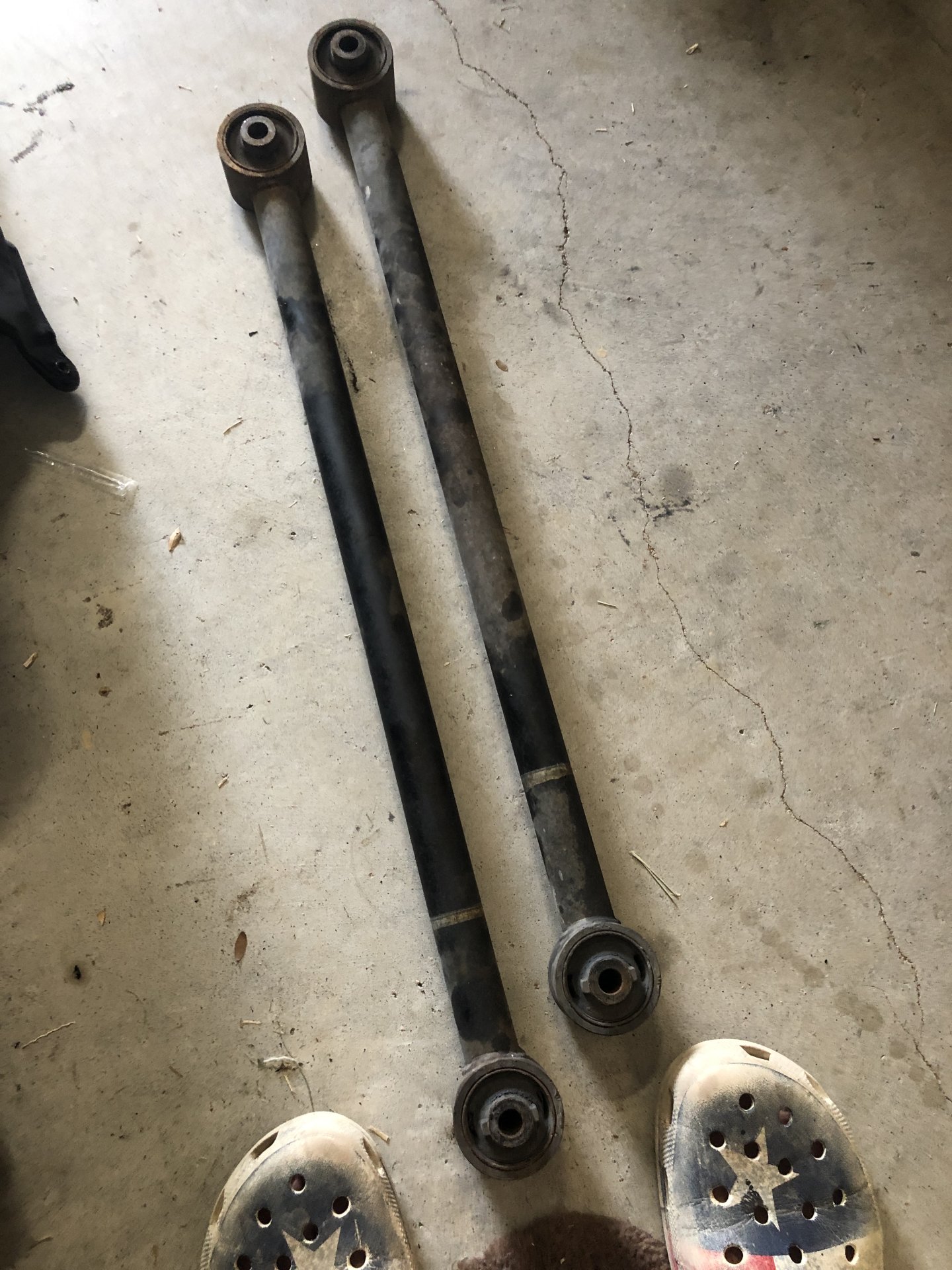

Last night, I replaced the upper rear trailing / control arms with the Mevotech brand from Rockauto. I have the lowers too but only have a couple hours to work per day so those will have to wait for later.
They were bad. They don't look as good in the pics as the do on the truck as there is no tension on them. One of the "eyes" that the mounting bolt goes through was completely detached. I could move all the old "eyes" with my hand on the old ones, not at all with the new ones.
Driving impressions after this - all low speed (below 45 mph) vibrations gone. I also realize now, that I had a slight torque steer from a stop; that is gone now. I had a slight, soft "shifting bump" from brake to accelerate; that is gone now. My high speed vibrations have also decreased a lot but are not completely gone. Very high speed vibrations (75 - 85 mph) have been greatly reduced.
Edit: I also found that this eliminated the "rocking" of the vehicle when coming to a complete stop.

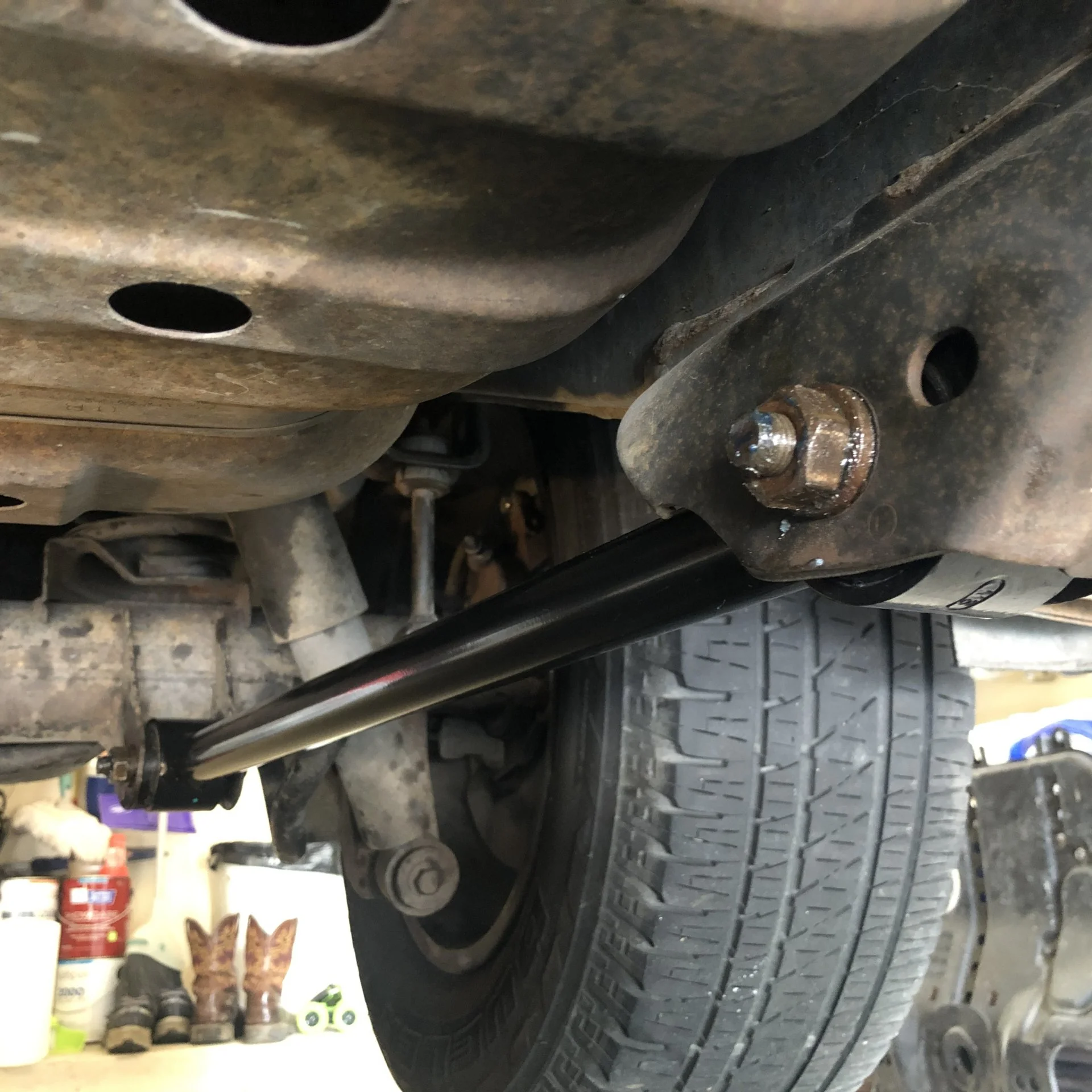

Last night, I replaced the lower stabilizer / control arms. They didn’t look that bad but needed to be done.
I had to take the sway bar mounts off to access the rear bolts. I also had to use a “come along” to pull the axle forward enough to loosen the bolts and to center the new “eyes” of the trailing arms. A ratchet strap was not strong enough but the tires were on the ground, not floating.
You can see some separation at the "eyes". The "eyes" were also out of center in the bushing.

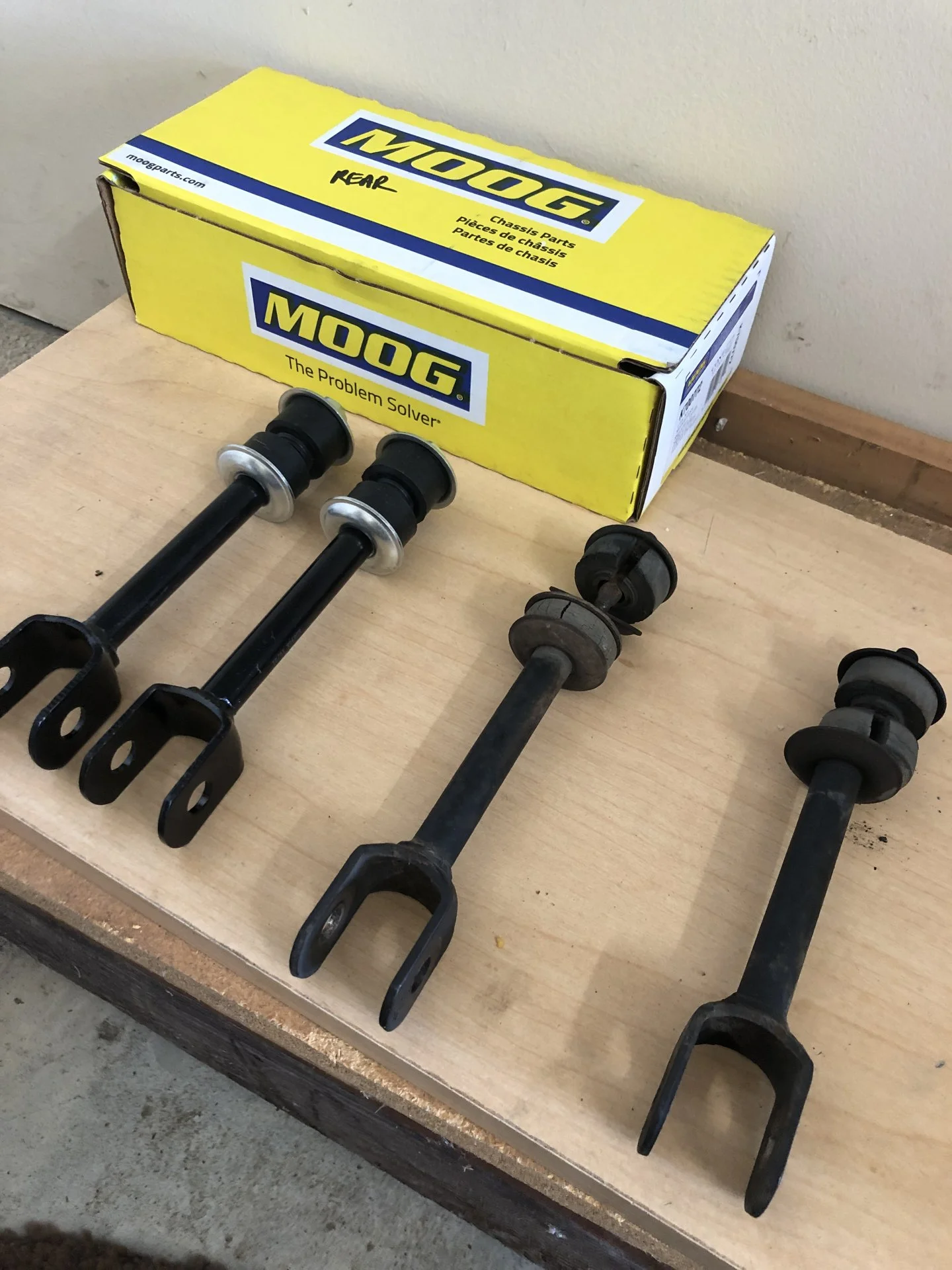

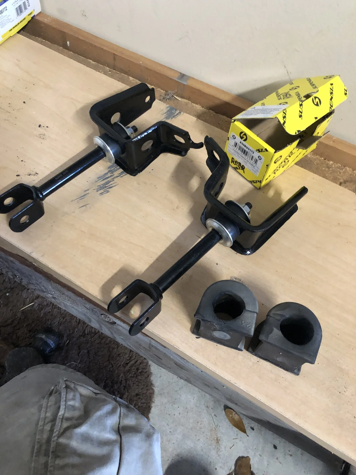

Update: Wow! I am going to start with driving impressions. Almost all of my rear end deceleration vibrations from the Rear End area are gone.
(Don’t yell at me for going non OEM- these are end links, not tie rods or BJs)
Old end link rubbers were rock hard and broken. Oddly, one side had bushing cup washers on both sides (inner and outer) of the upper mount which not correct. It should only be on the bottom side.
The other side had none on the inners.

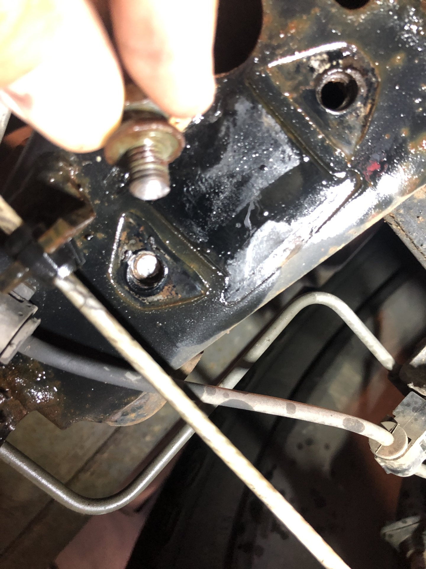

While removing the top bolts to the end links, both end links snapped off.

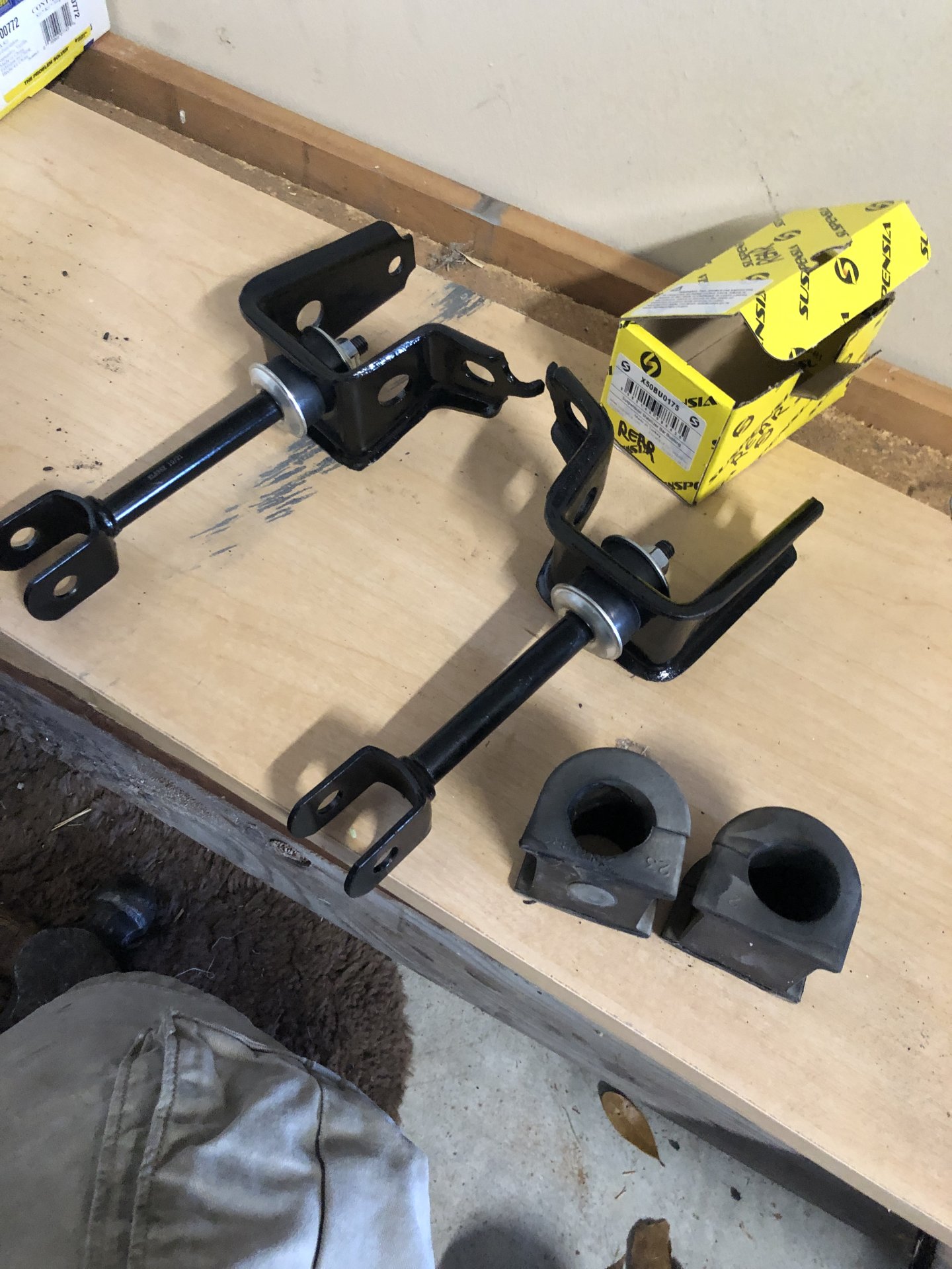

Disappointing, the Moog kits did not come with the sway bar mounting “cushion” (90385-11021 x2). I installed using the old ones and ordered some for install later.
Cleaned up the sway bar mounting brackets and rebuilt them (black spray paint).
I realized I didn’t take a pic with the encapsulating bushing washers on the bottom but they were put on before installing.
You can see the oblong holes in the sway bar mounting bushings to frame.
Dang it! Very rust free truck minus exhaust and this bolt. Second bolt to break off on the truck. Drilled hole in the middle, made it bigger, used a reverse “easy out”, broke that in the middle of the hole, chiseled out the broken easy out bit, drilled it out the rest of the way, then chased the thread. Whew!
Again, lots of vibration improvement with this. I think the sway bar was vibrating on the frame (with a mild hard rubber cushion).
