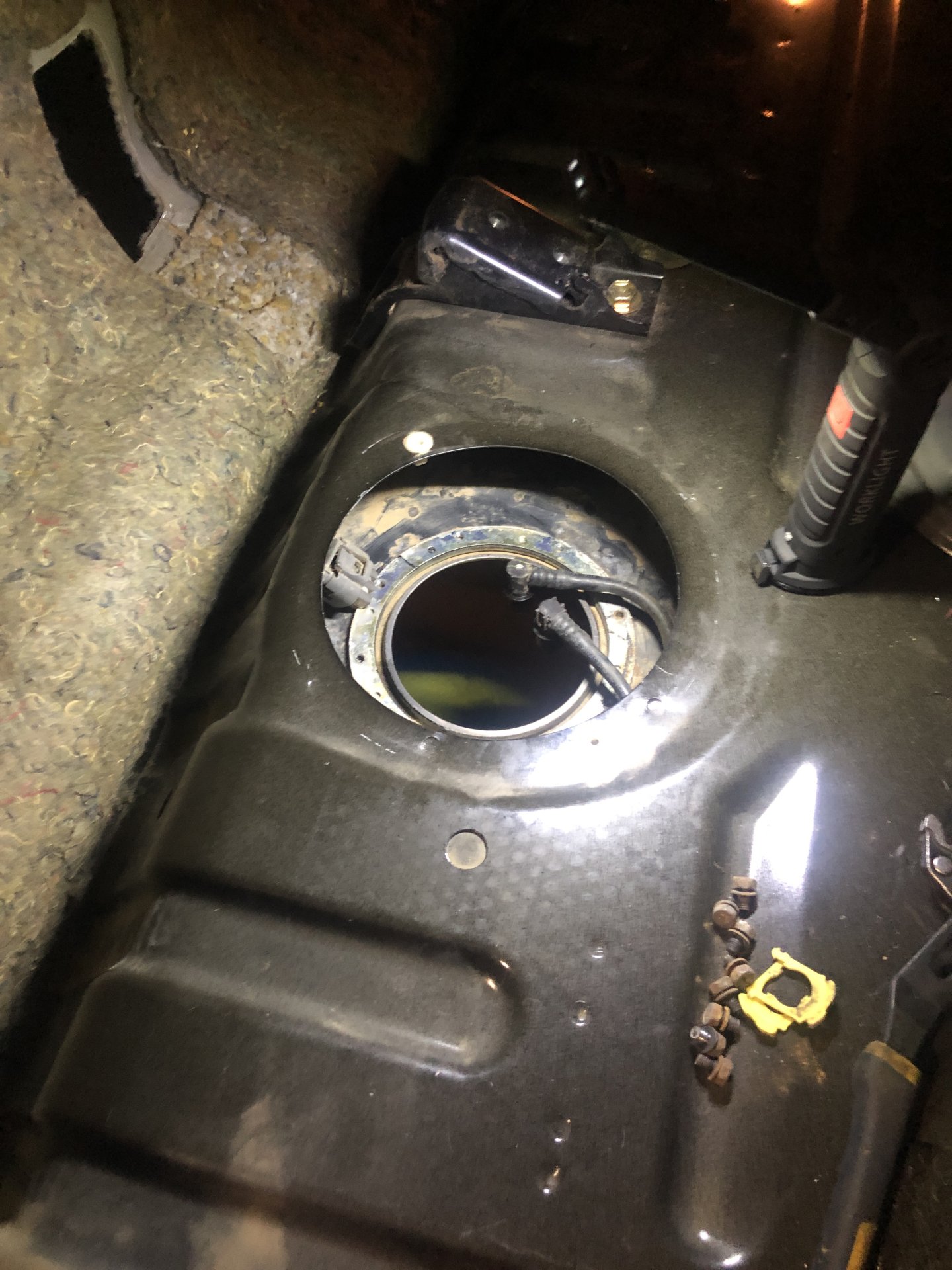

After trying to purchase a Denso fuel pump kit (from 4 different suppliers) and having the order cancelled due to no stock, I decided to go with a Napa brand unit.

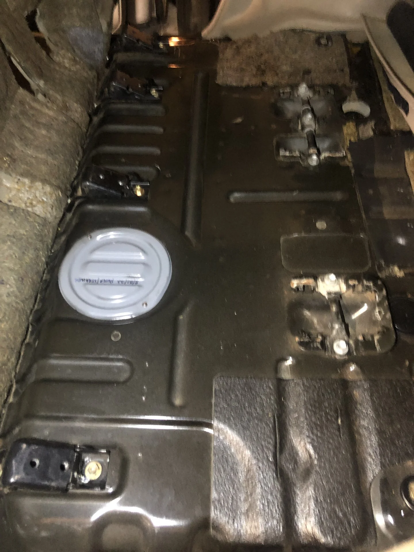

Under the driver side back seat is the access cover. Both rear seats removed and carpet pulled forward. I had to really clean this area before pulling the pump unit out so I could reduce the possibility of dirt entering the system.
Old unit. Fuel sock was dirty but not bad. I also replacer the fuel filter. I let the filter drain out and it was very dirty. Fired right up and ran great.

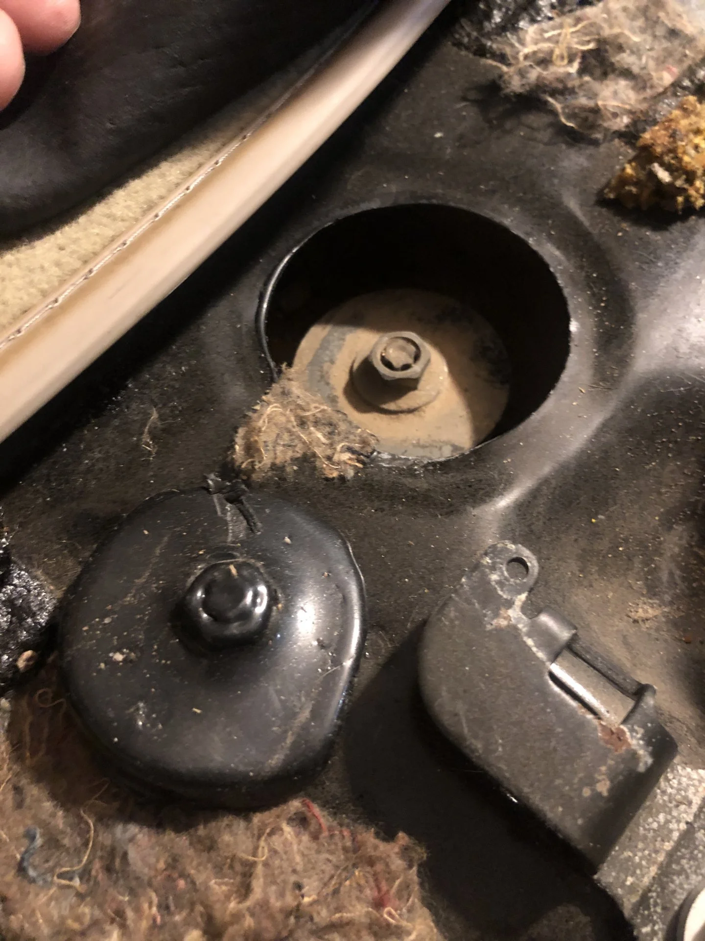

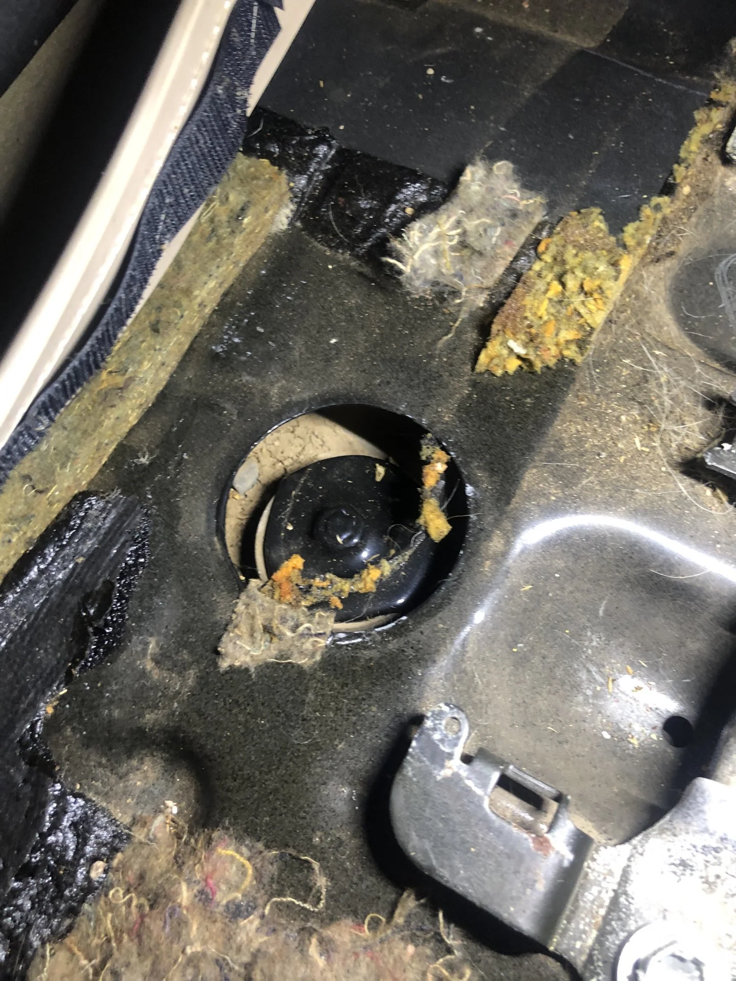

Under the Passenger side, I found this body plug that was melted and the insulation seamed stuck to the floor. At first, I though a chemical had spilled at one time and melted it but on my fuel pump R&R test drive, I heard an exhaust leak. There is a hole in the top of the exhaust system blowing up on the floor. After the test drive the floor was very hot. I am going to have to do something about that before it causes more damage.
Melted body access plug:
Removed the melted plug.

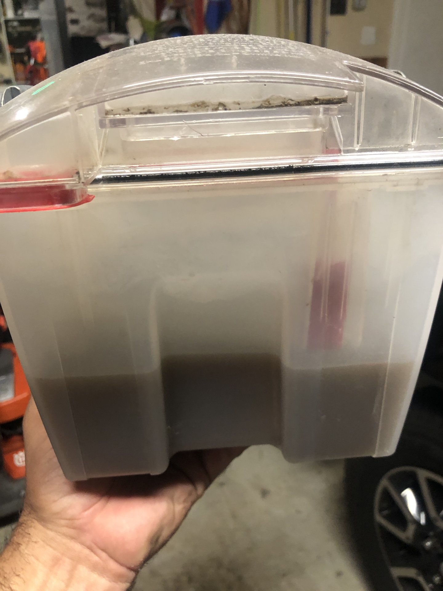

Had to shampoo the carpets.
It was dirty.

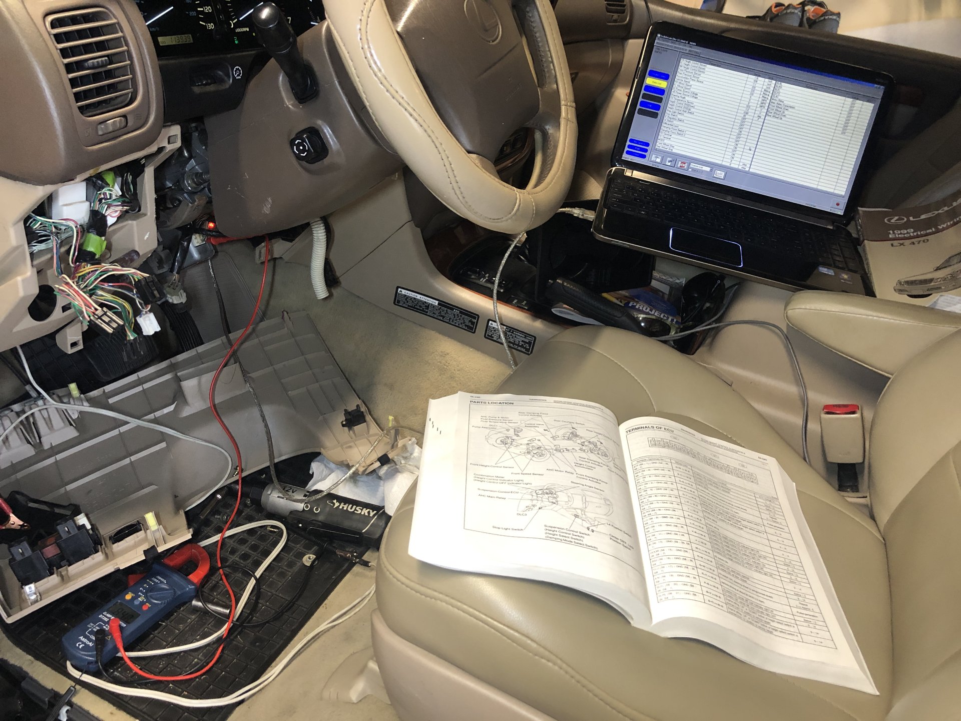

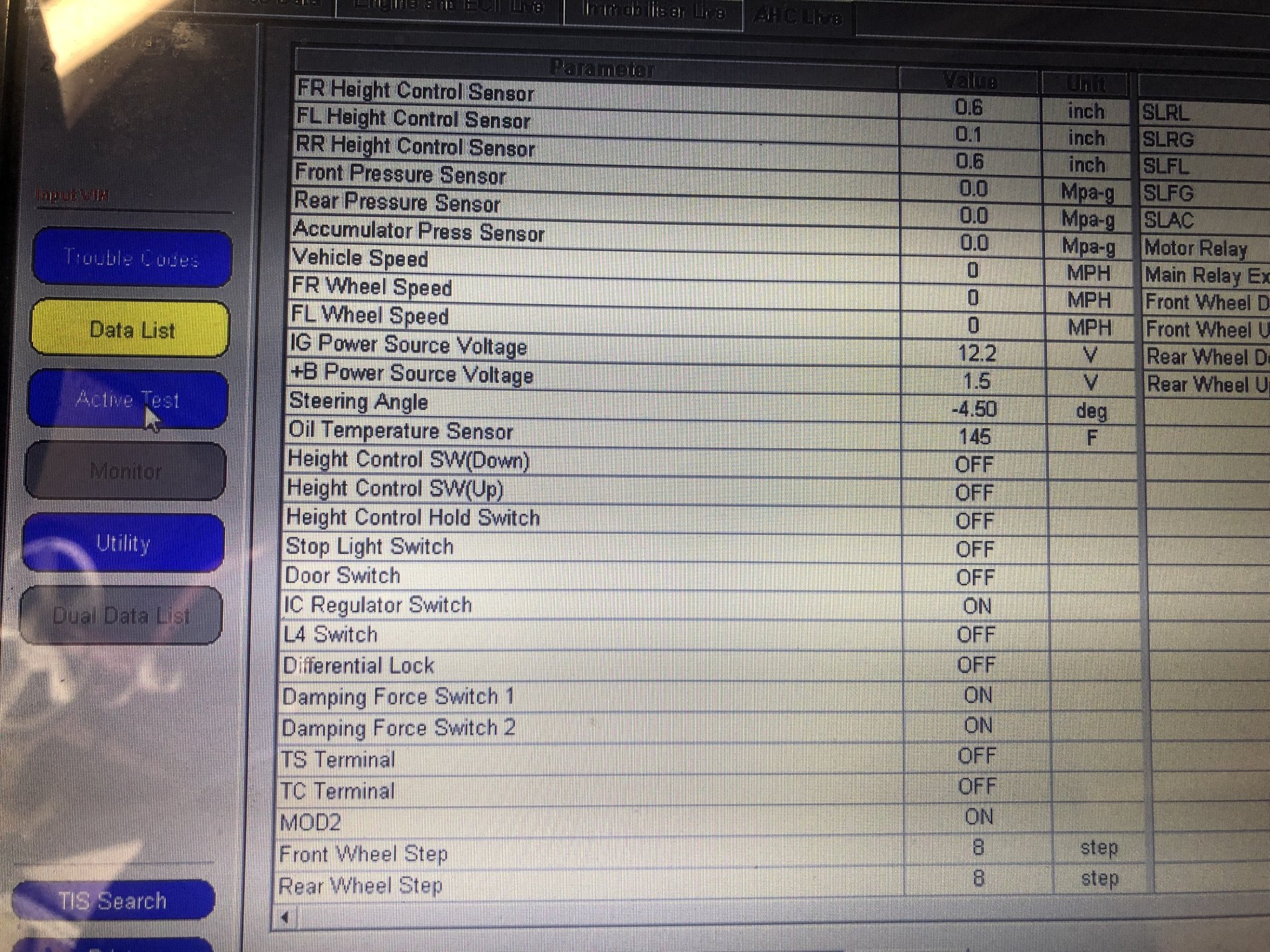

Back to diagnosing the AHC issue...
+B voltage is too low.
No pressure readings.
I have 5 DTCs (Diagnostic Trouble Codes) but could not read them.
I can here the Relay clicking.
To recap: Storm, Water poured in under dash. Next day - AHC "OFF" light flashing and stuck in "Sport" mode.
Every time I tried to read the codes or would try to operate manually through Techstream, I would get the Error below. I need to read up on it.

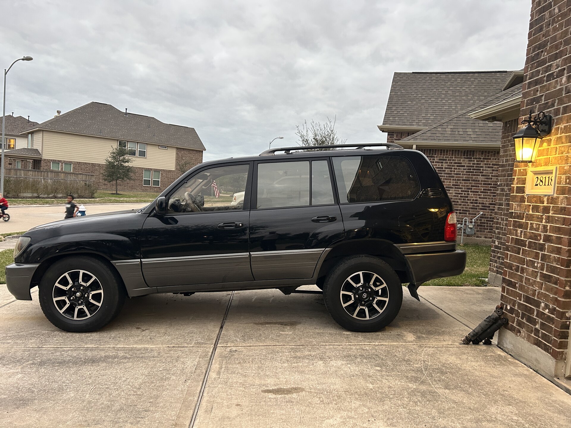

Been a while but haven't really done much. I have been just driving her around with the AHC "OFF" light flashing and stuck in Default Sport Mode. It is firmer but not as firm as my lifted 3rd gen 4Runner.
I did take it on another 990 mile round trip to go fishing in Venice, Louisiana like this with no issues.
I really want to keep the AHC as I love the ride although I do have a lift and replacement parts on the wall in my garage if needed.

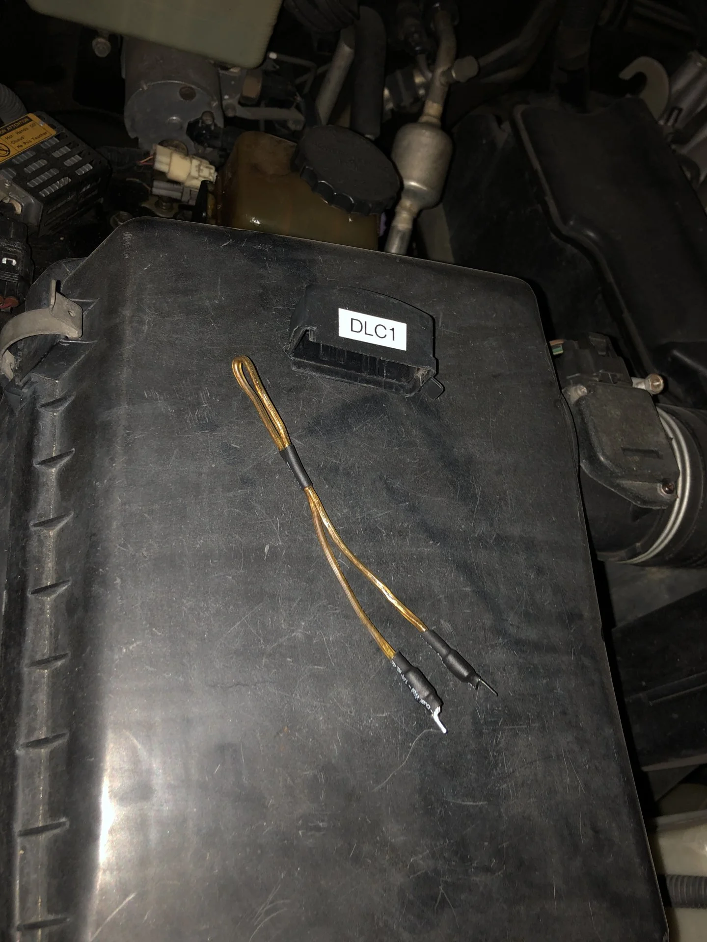

I cannot read the DTCs from Techstream so I broke out the repair manual, made a "SST 09843" (wire loop) and read the flashes and got C1731, C1732, C1733, C1734, and C1736).
I have unplugged, inspected, cleaned with contact cleaner, dielectric greased, and plugged back in all the Accumulator and Control Valve connections under the car and guess what! IT WORKED!!!!!

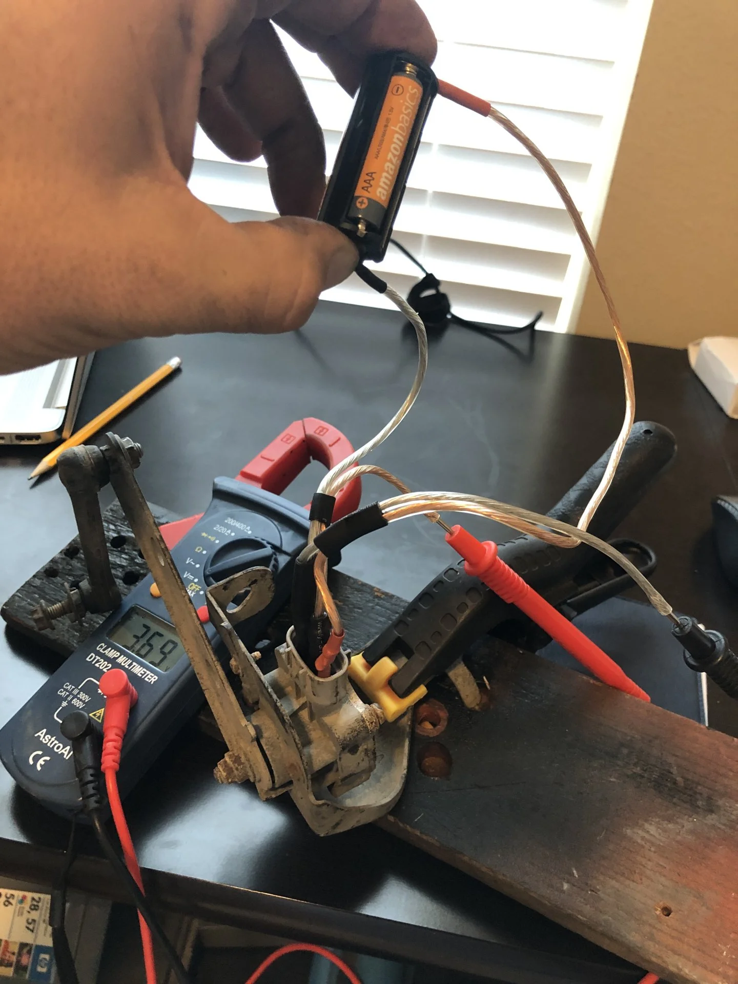

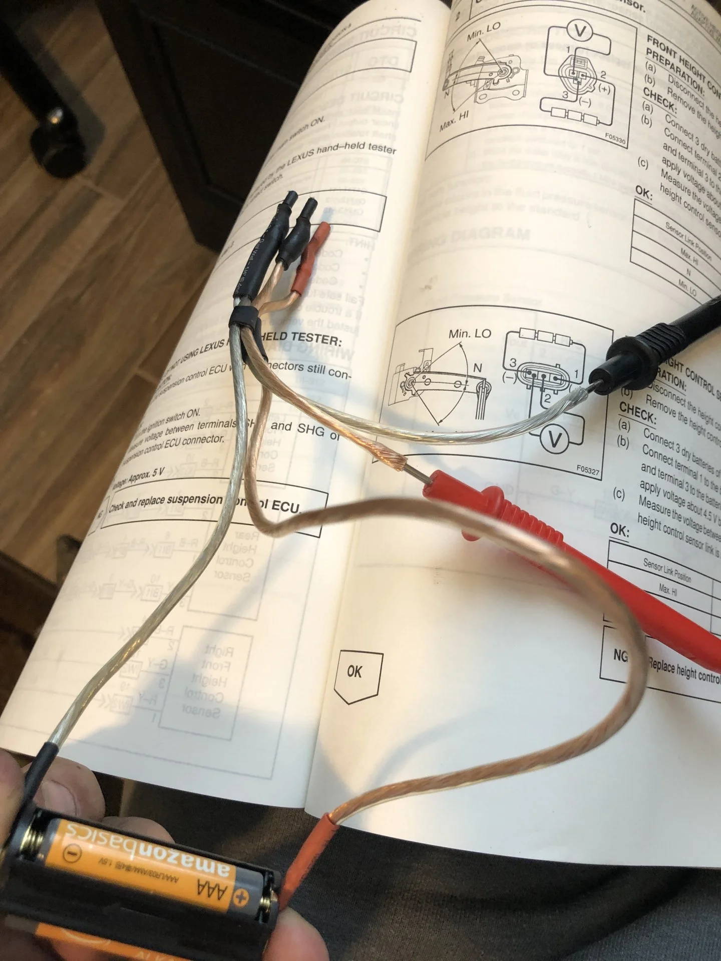

Made a tool to diagnose the height sensors to check them like the book says.
Took readings from the AHC ECU. Found a bunch of bad readings. Wondering if I should try replacing the AHC ECU?

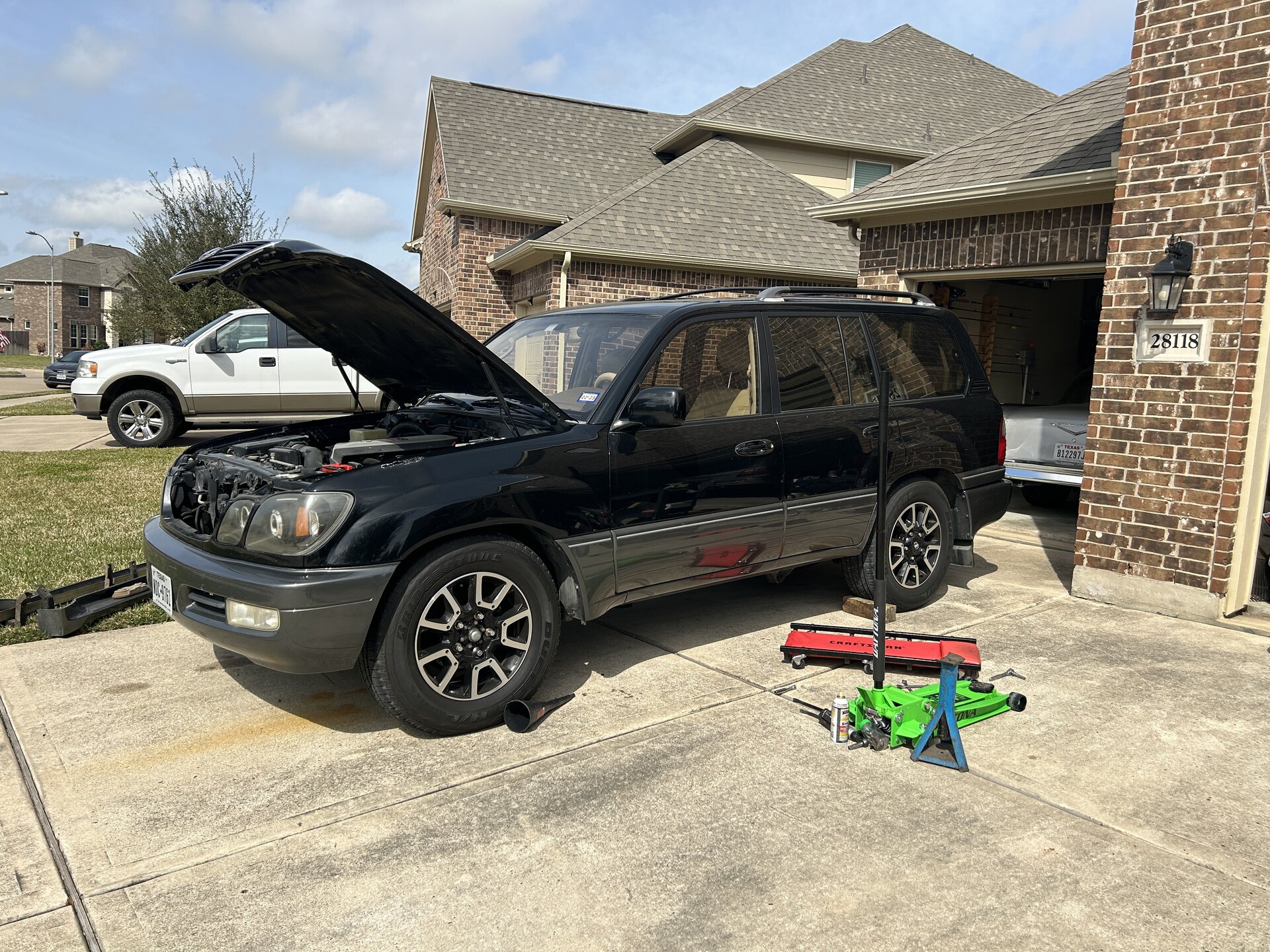

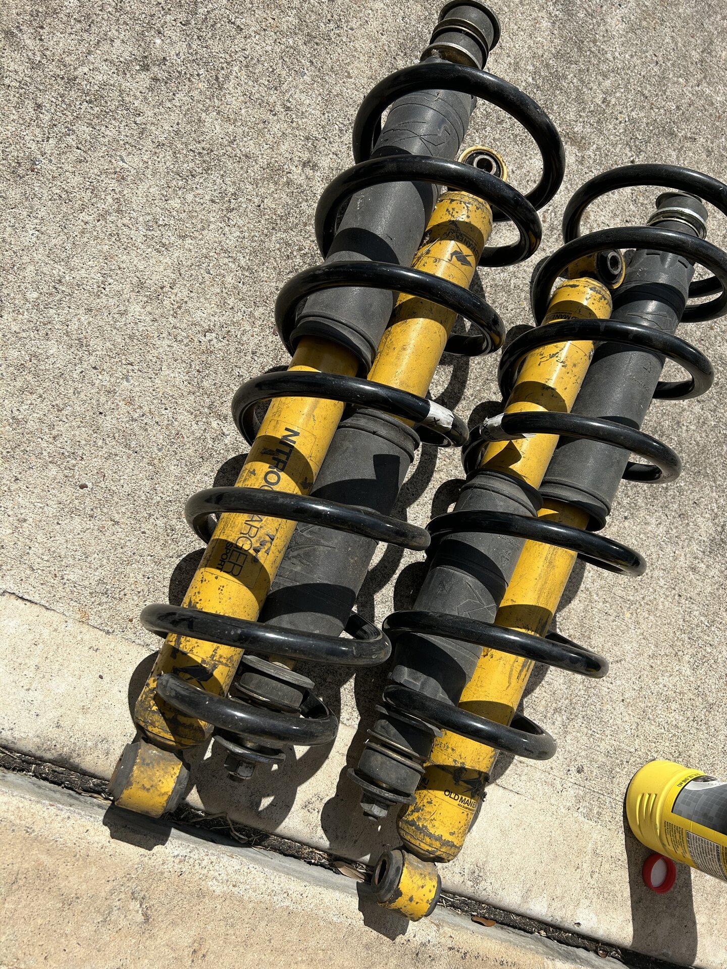

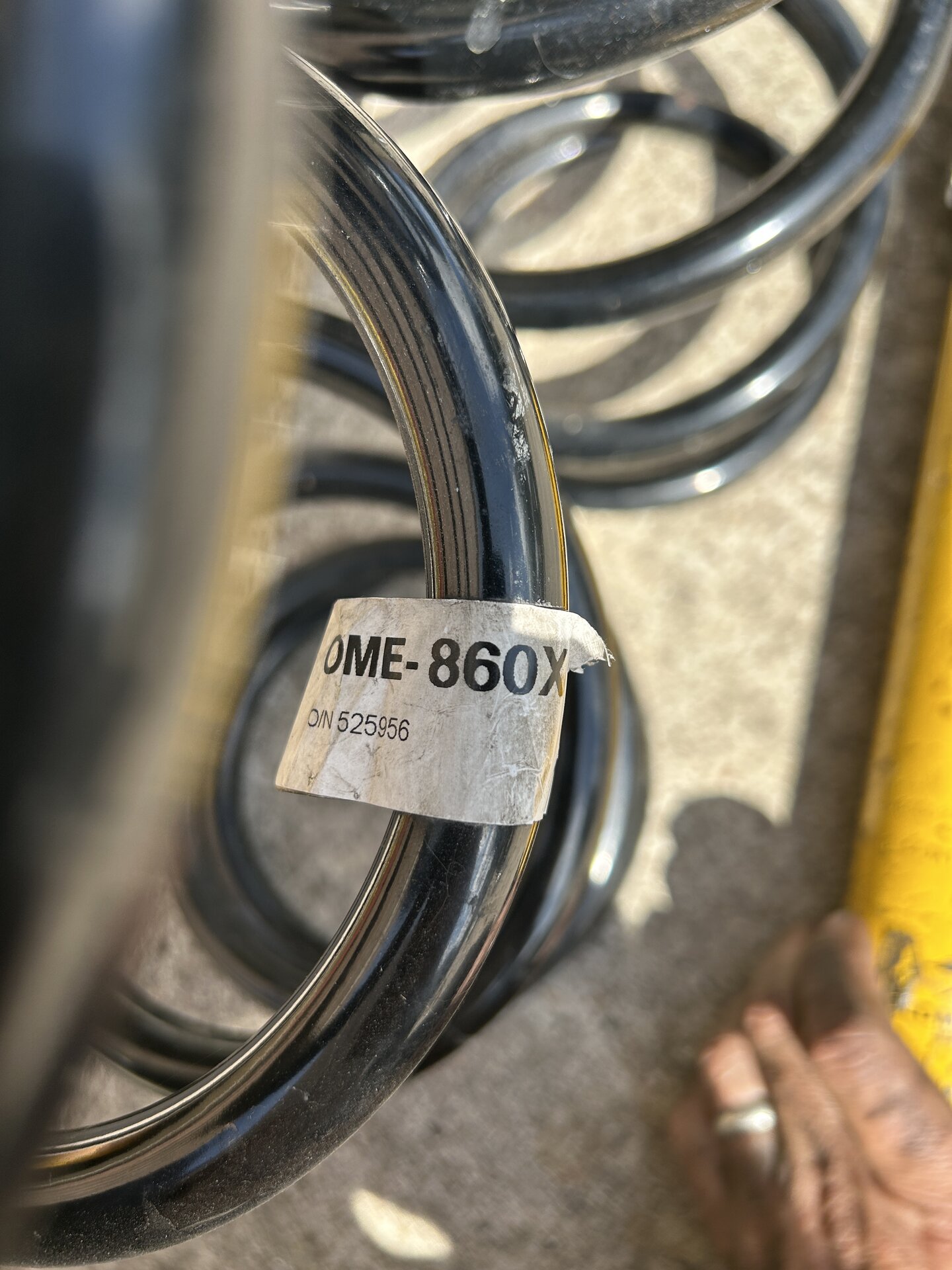

I have had a slightly used 3” Tough Dog / OME kit in the corner of the garage for a while now and after the vehicle basically sitting for 3 months I decided to rip out the AHC and install the lift.
Day 1 (last weekend) was running board removal, draining the system, removing the front and rear AHC “shocks” and rear springs and installing all the shocks and rear springs. I didn’t have time to get the front torsion bars in so it sat there for a week with a nice rake making my HOA cringe.
