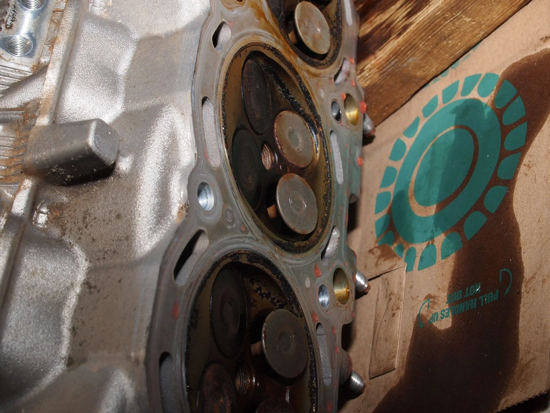

Good Macguyvering using shop vac. I use compressed air when I need too. I found block holds about a qts, and heater cores about 3 qts. I can blow out about 3 qts at best after draining 3 gallons.

I got just shy of 4 gallons out the first drain of coolant. I did not keep track of the drain / refills but blew it out on the last one and figure it is good.

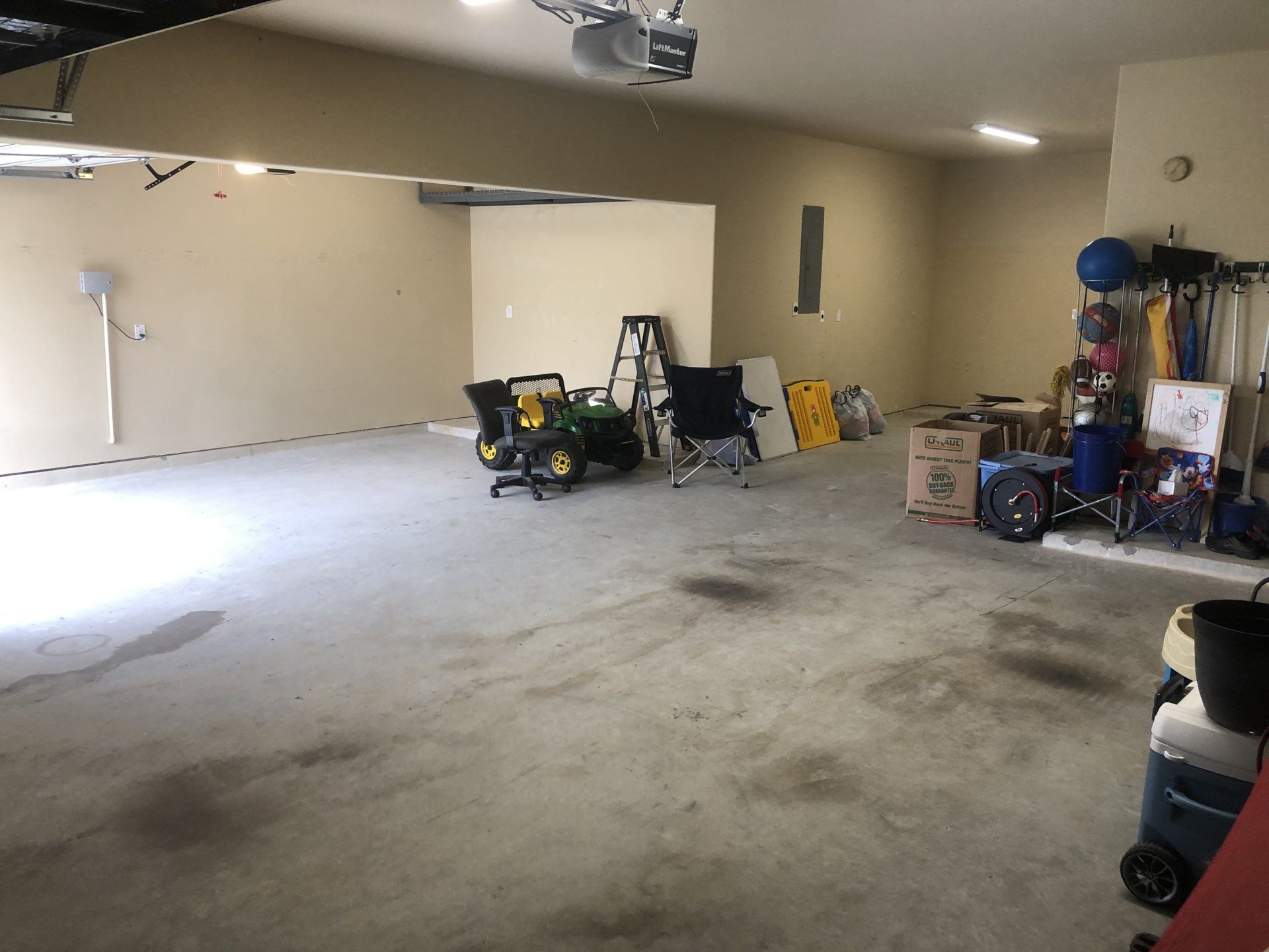

Well, been busy house hunting and luckily we got one and guess what? I got a 4 car garage!
This is the sellers stuff. We close in mid May.
The garage has a separate 220v 50 amp outlet for a welder and a 30 amp 220v for an air compressor. It also has plumbing for a sink. Pretty cool.

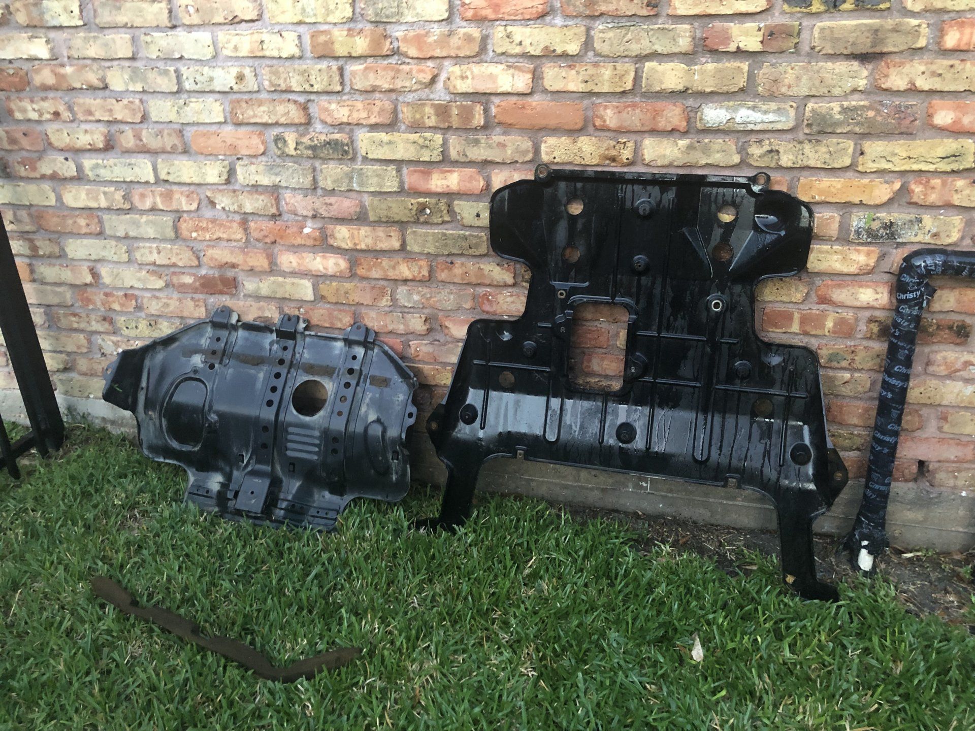

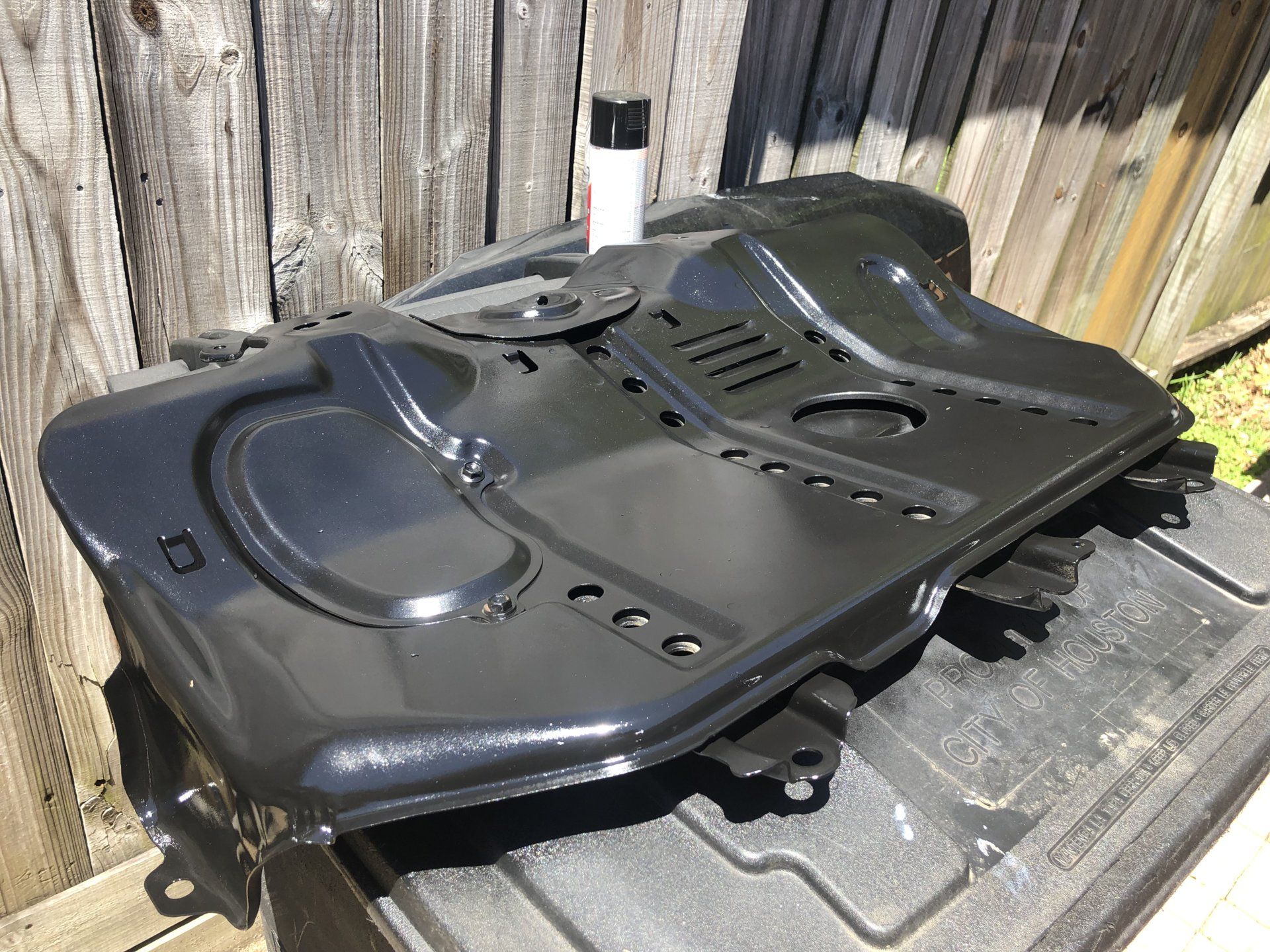

I wanted to clean the skid plates before I put them back on so I could detect any leaks later.
All clean after much elbow grease.

Alright, I ran a green scouring pad over the skid plate and shot it with gloss black rattle can lacquer. Looks tons better!

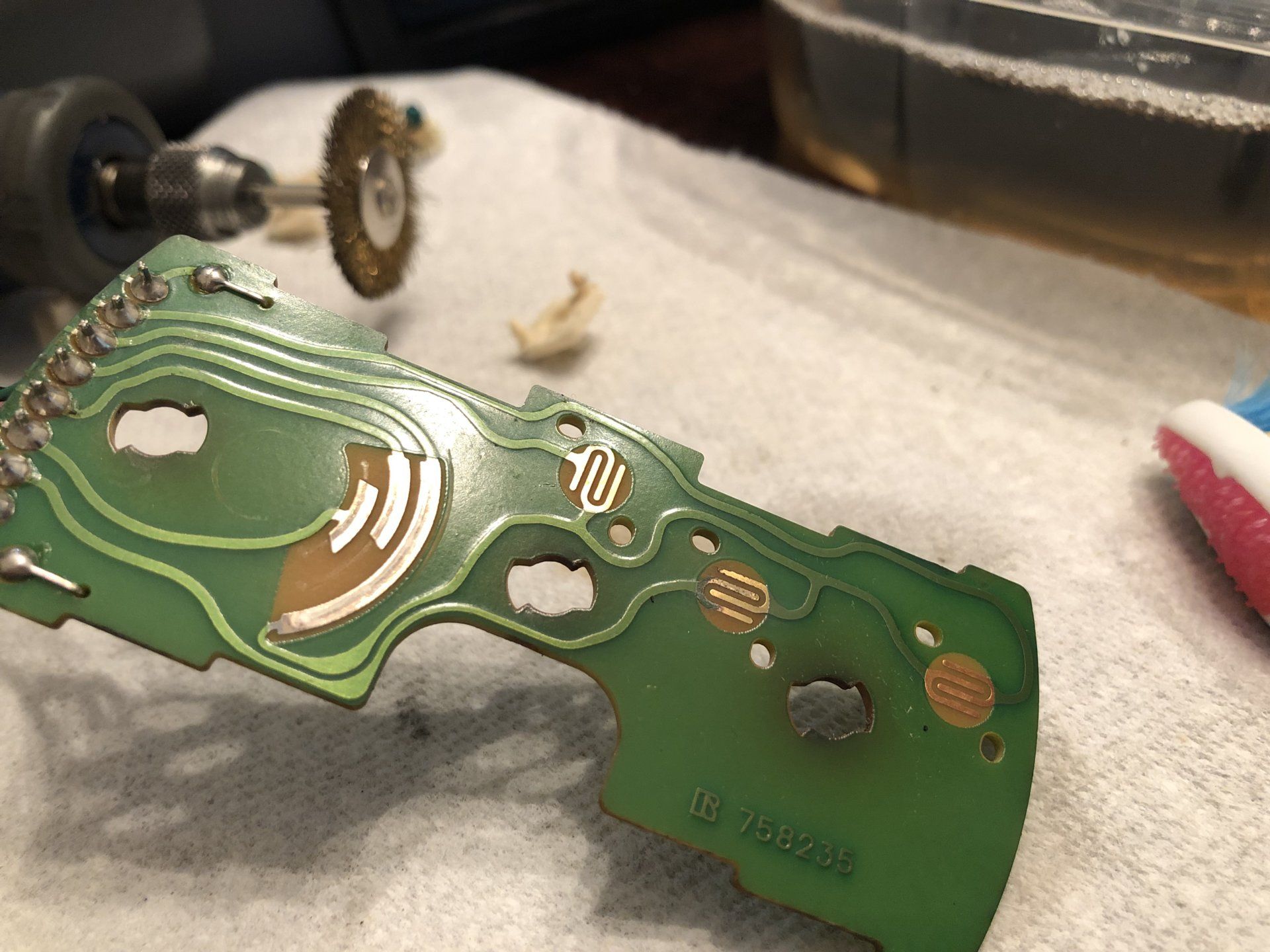

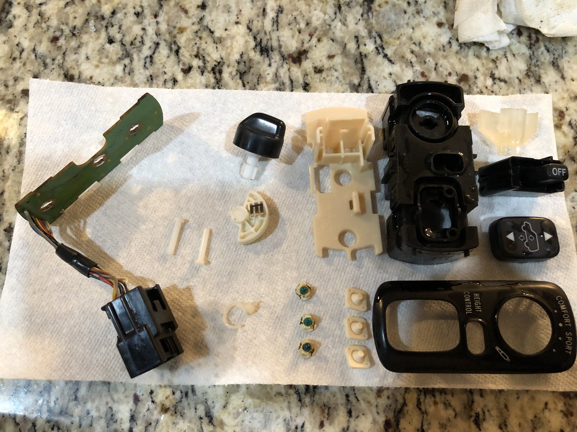

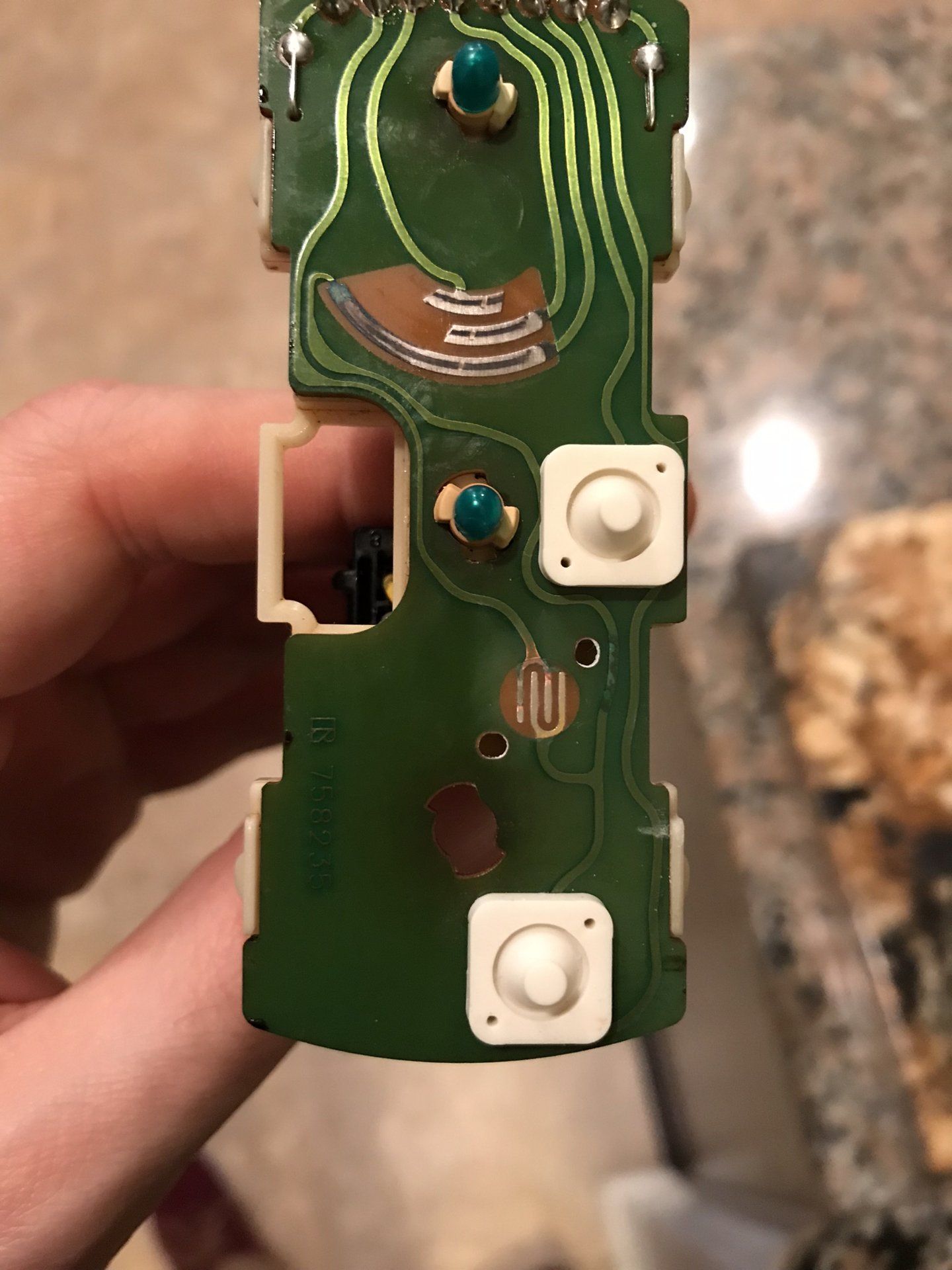

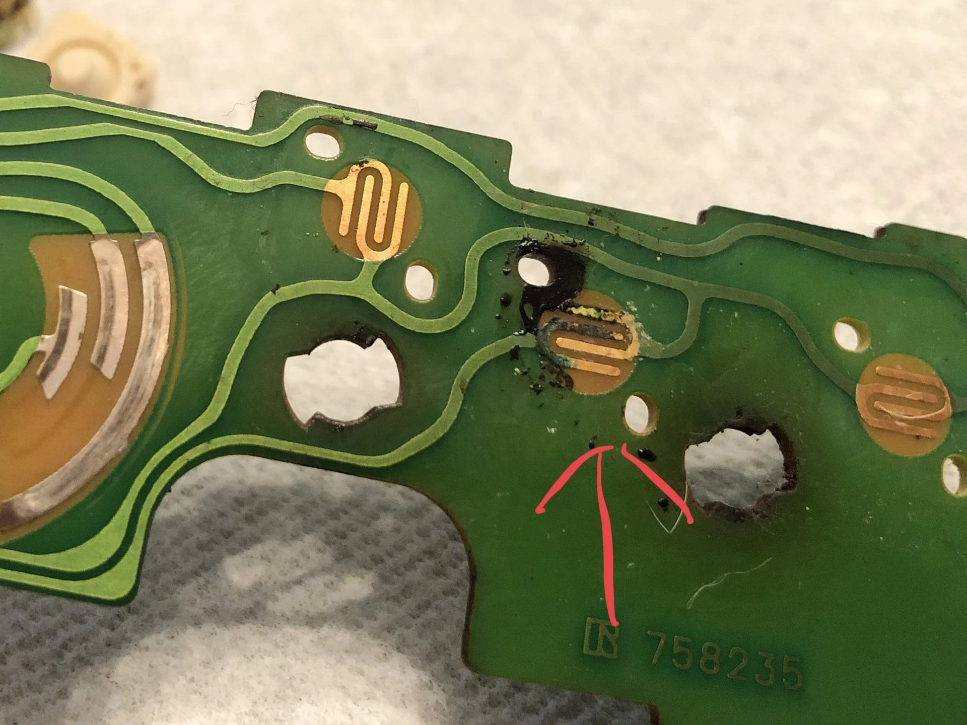

I took y’all’s advice and decided to look at the switch for the AHC. I am sure it has had plenty of cokes and coffees spilled over it and it showed. I took it all apart and soaked the non electrical parts and cleaned them with a toothbrush. To my surprise, there are light bulbs in this switch (mine never worked).
This is really a very simple switch. See the red arrow? Contacts not connecting due to corrosion. That is the high button.
With a Dremel with a brass wire wheel, I cleaned every electrical contact including the light bulbs.
All cleaned up. I put it back together with dielectric grease and guess what? It worked.
Up...
...and down...
Glad to see that worked for you! I wasn’t so lucky with my switch, the corrosion was too bad. Glad it wasn’t anything more serious though!
Thanks for the suggestion. About 20 minutes and $0.00...
My light bulbs still don't work. I think the contacts on the bulbs themselves are too corroded.

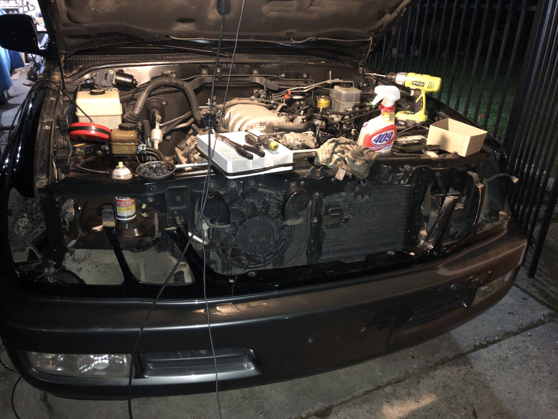

I had the day off today because my Aunts, Uncles and Cousins were in town so I took advantage of last night and got some work done.

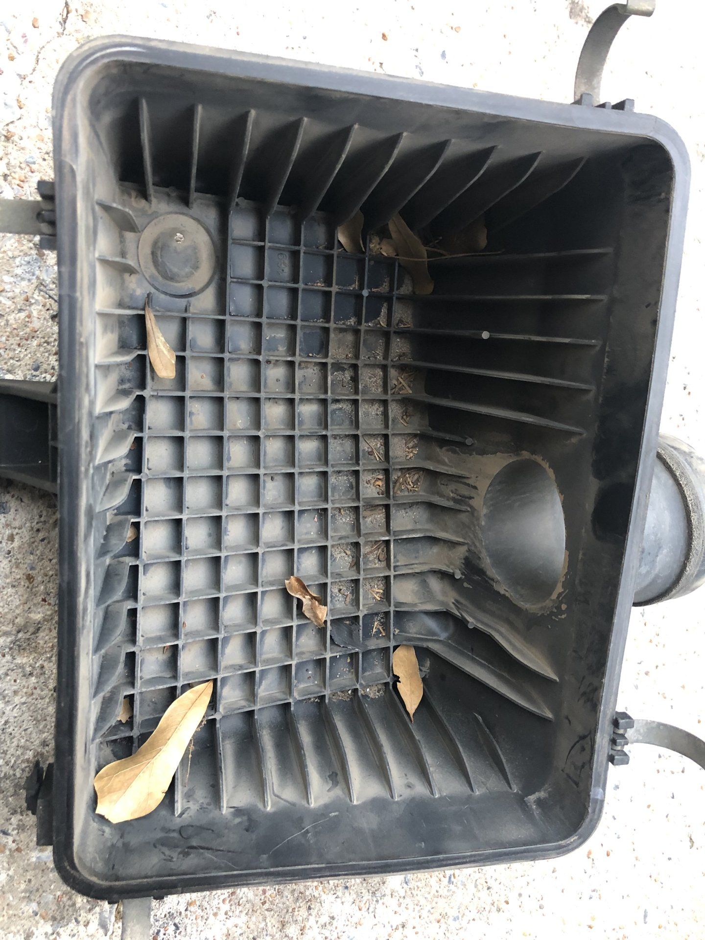

I pulled the air box, MAF, intake lines (my first venture under the hood in this one). Filthy. The throttle body needs a deep clean, air filter looks decent and the bottom of the air box was awfully dirty.

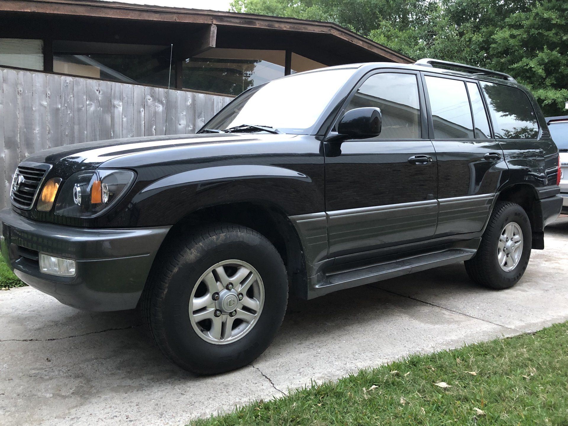

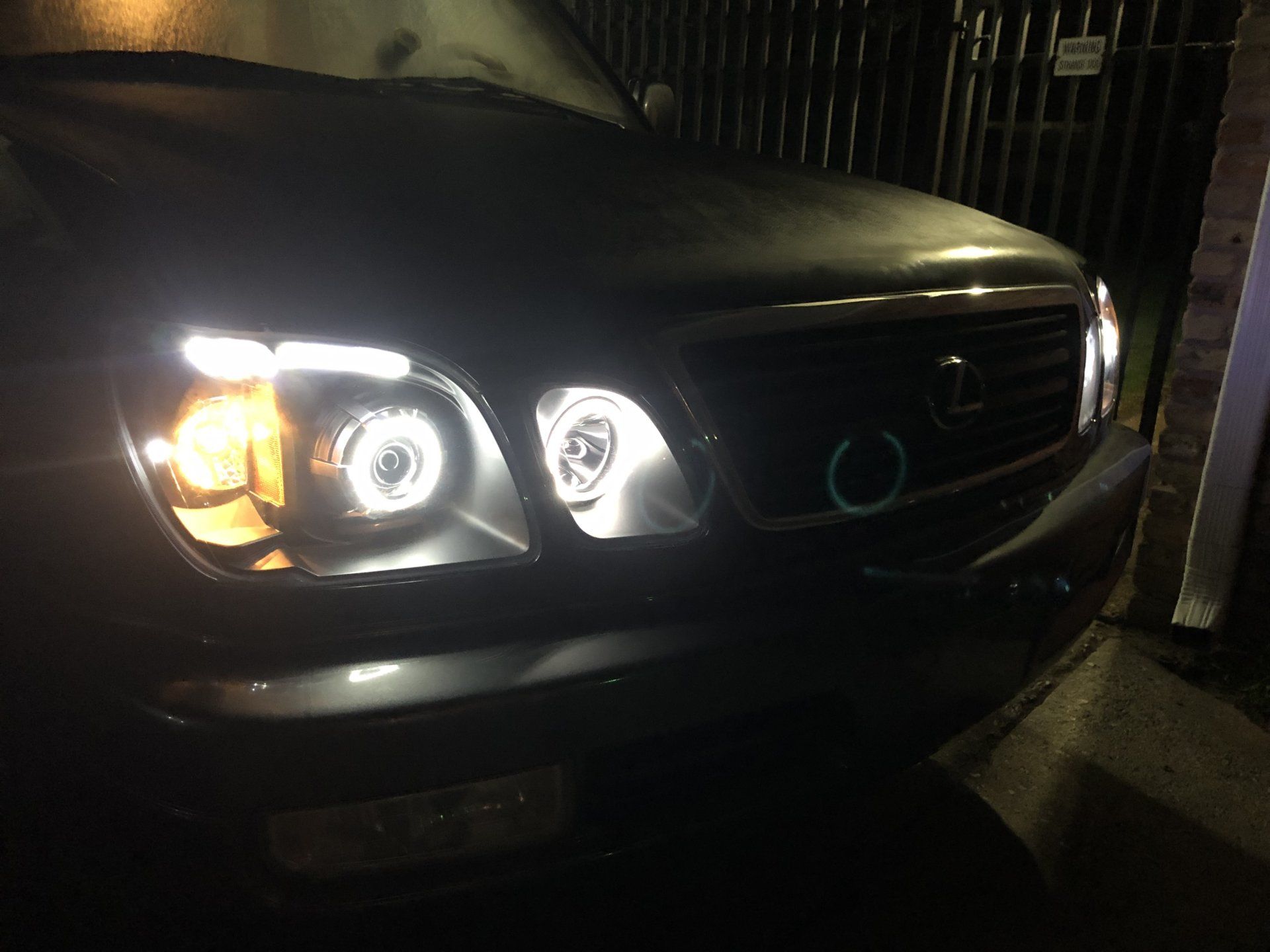

The intake, not being my objective, I yanked the broken OEM headlights and park lights.

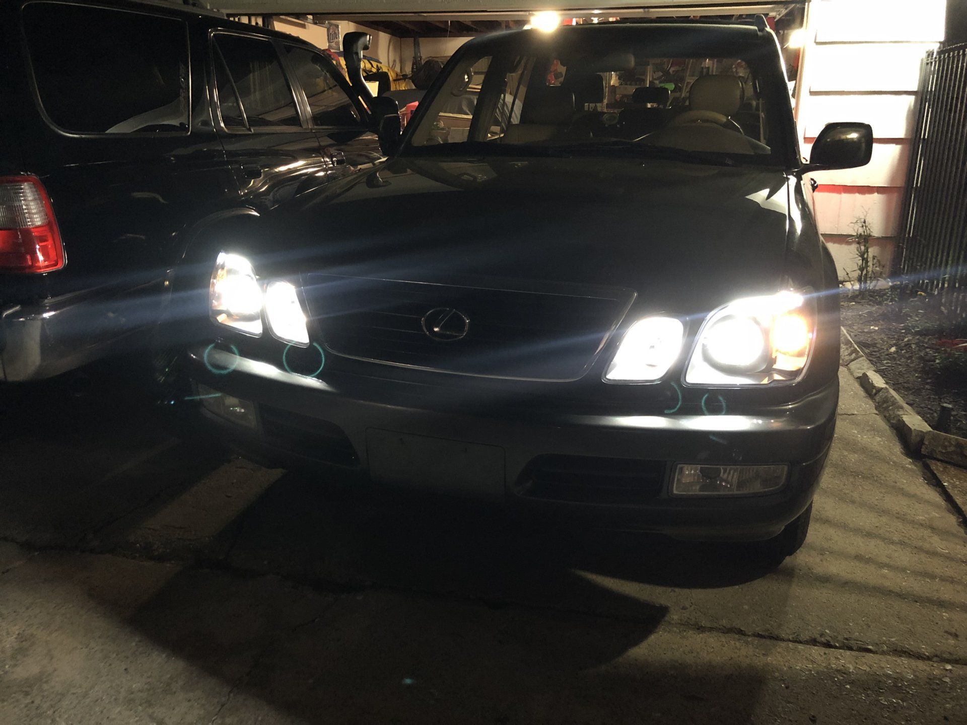

I then tested and installed the eBay Eagle Eyes headlights. Everything worked so I installed them. I wired the Halos and LEDs to the parking light circuit.
Parking lamps on.
We took the kids to the dentist this morning so I drove behind my wife so she could tell me if they were blinding. They had a closely equal cut on a nearby fence and she had no complaints so they will do for now until I have time to properly align them.

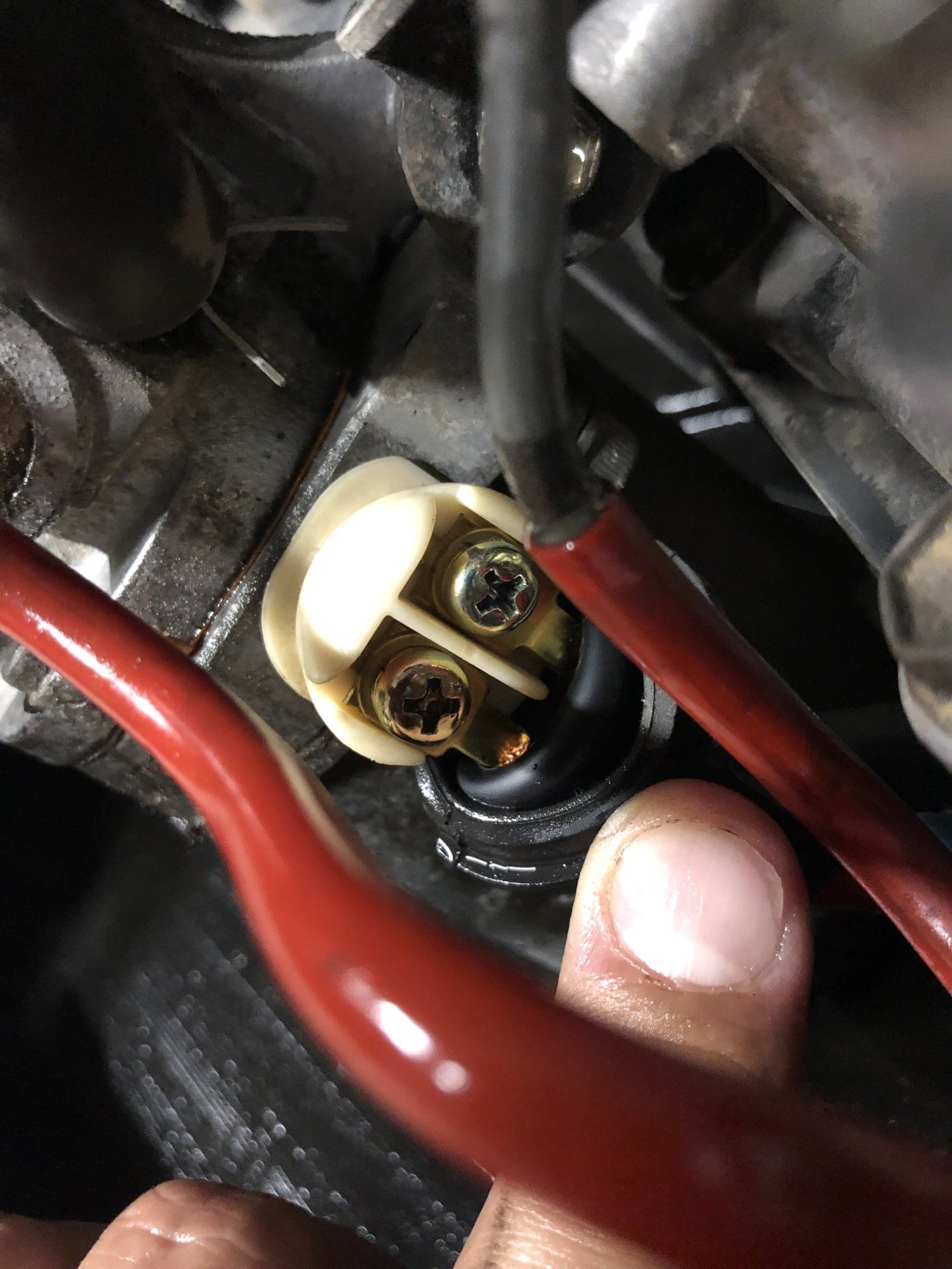

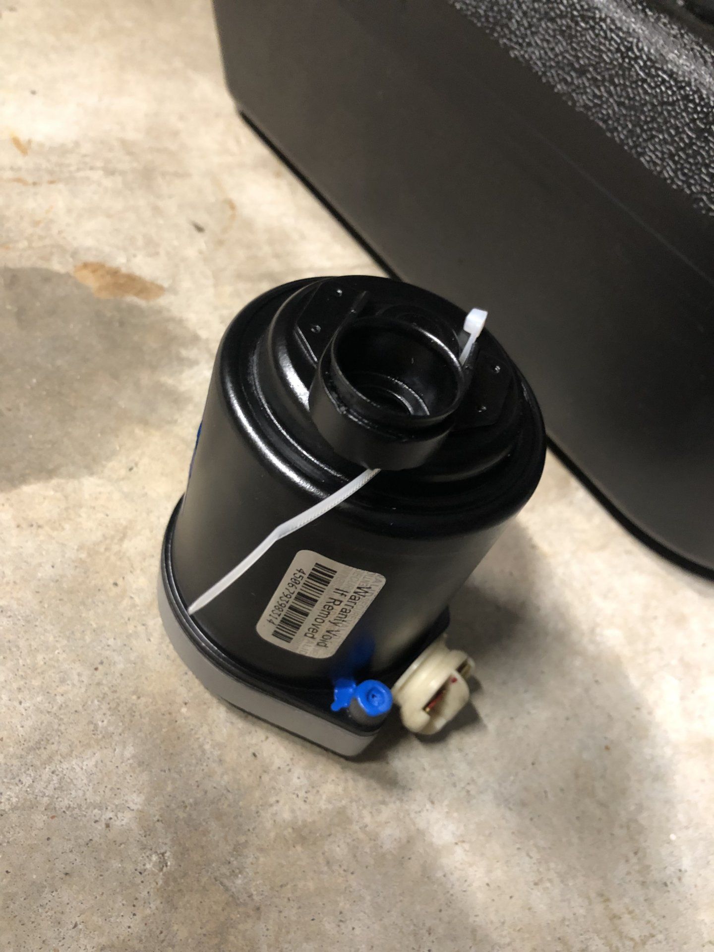

The double pump brake issue returned shortly after rebuilding the master cylinder so I purchased the rebuilt pump motor from that guy on eBay everyone uses, karpartzaddictionz72. Nice looking piece.
I pulled the Master Cylinder and replaced the old one and put it back in. Turned it on and everything worked fine. I will bleed the system today or tomorrow (or when I get time).
Be interesting to see condition of commutator inside your old motor and to know if control wire had any corrosion or discoloration on the leads or screws?
The Motor side of the wires was perfect. It looked brand new. On the other connection was a little rusty and corroded. I wire brushed them, broke them loose, dielectric greased them and reinstalled. Boot was perfect, very flexible, and on... I thought it was odd... Maybe brake fluid got in and brought moisture in?
I got a pic of the Motor side but did not get a pic of the other side.
