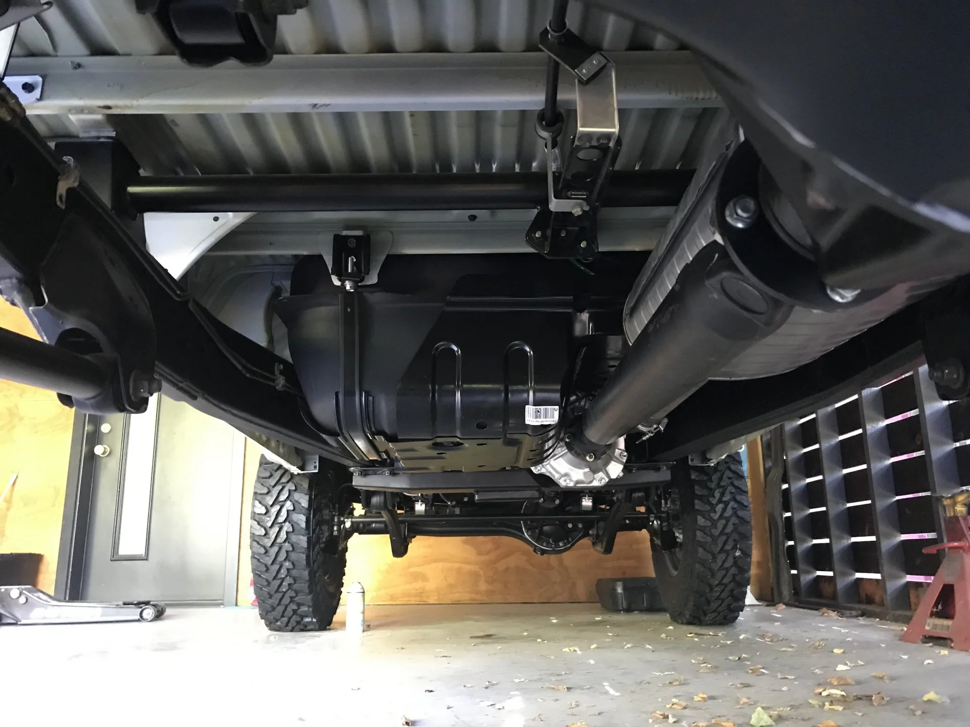

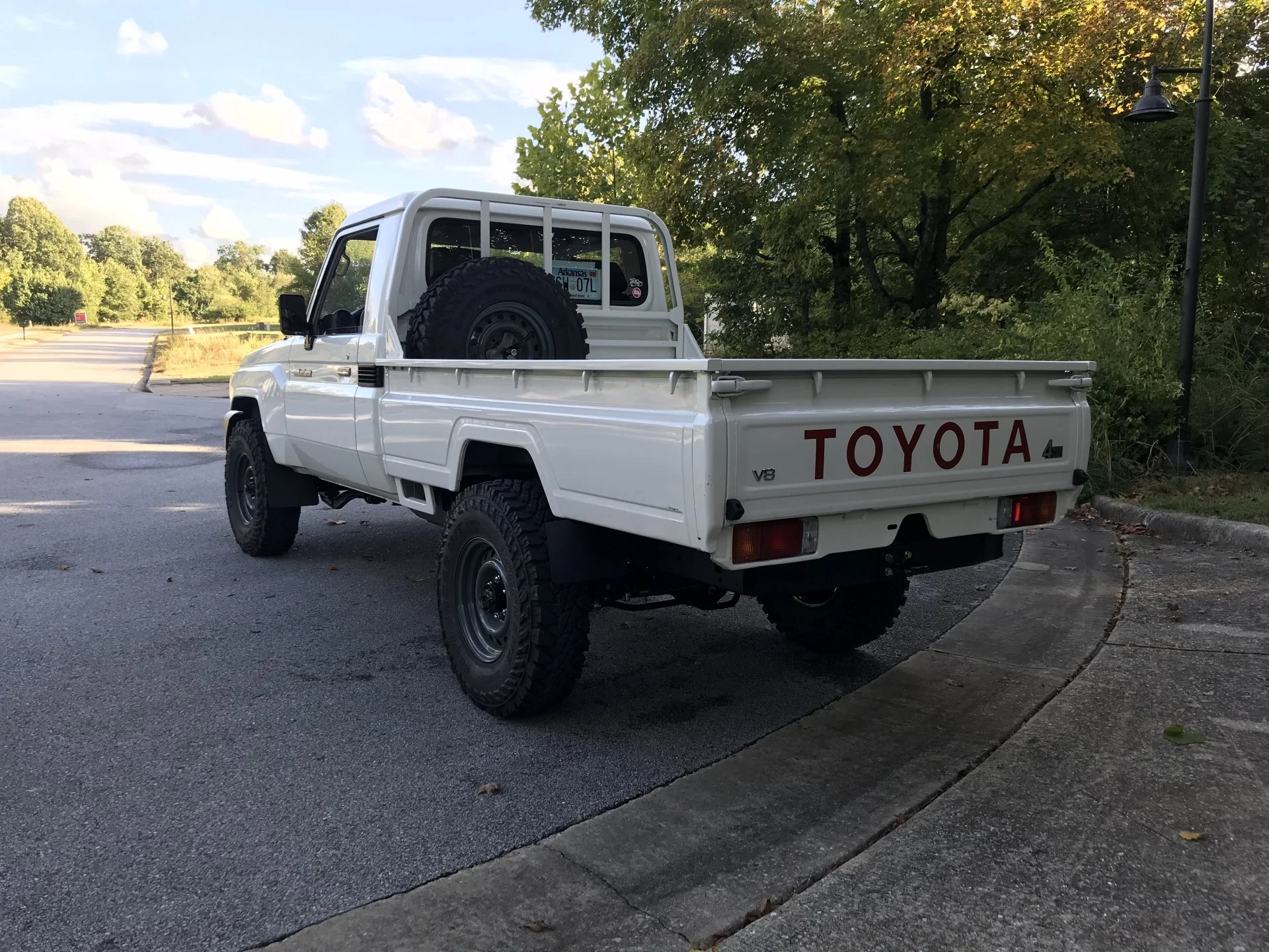

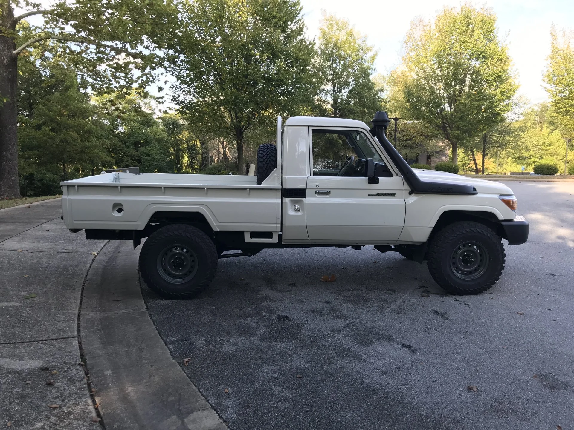

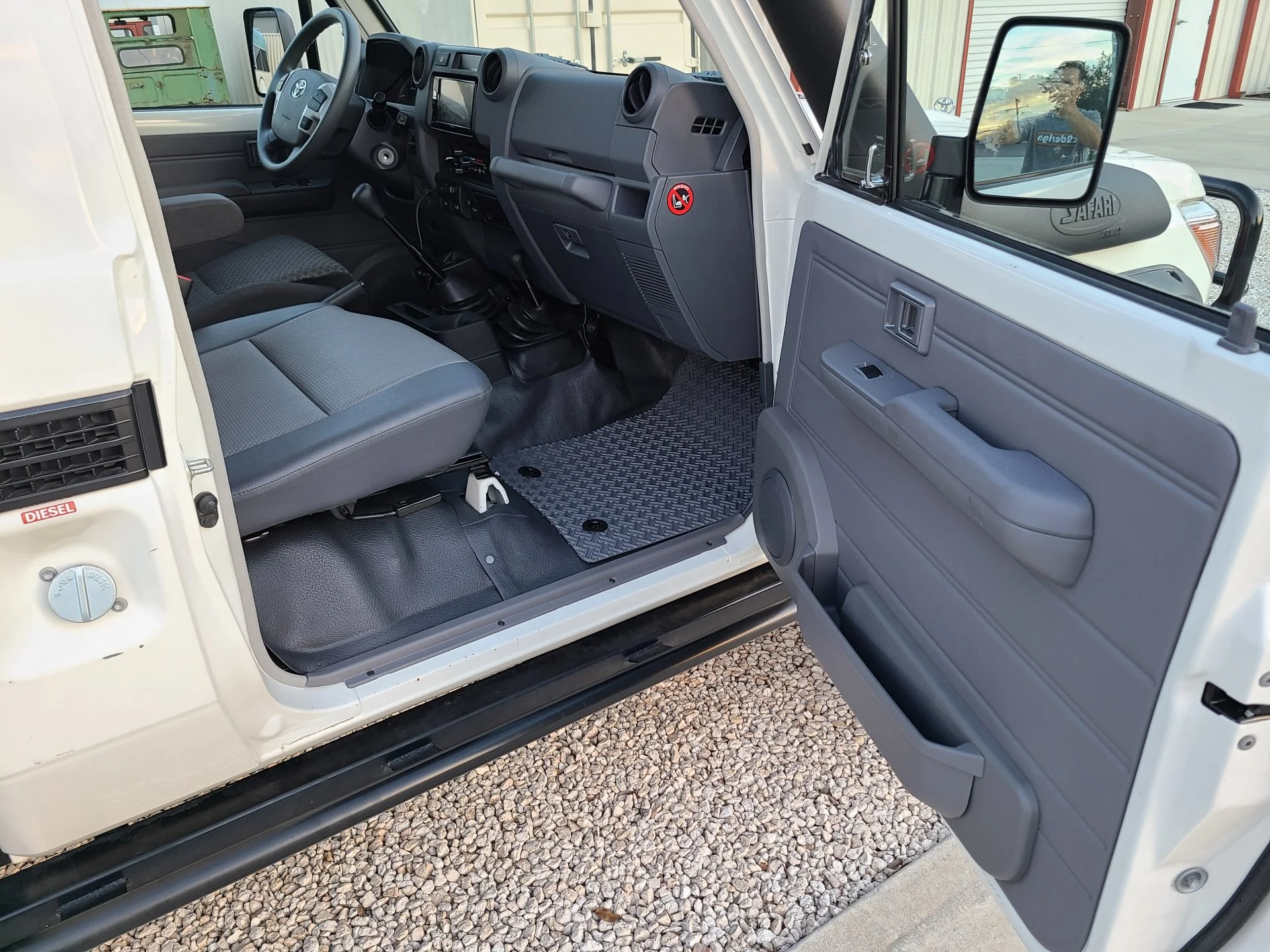

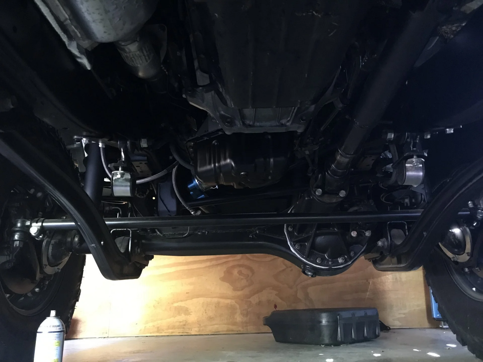

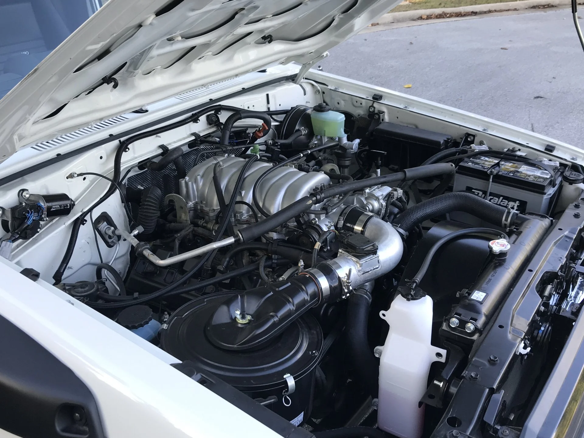

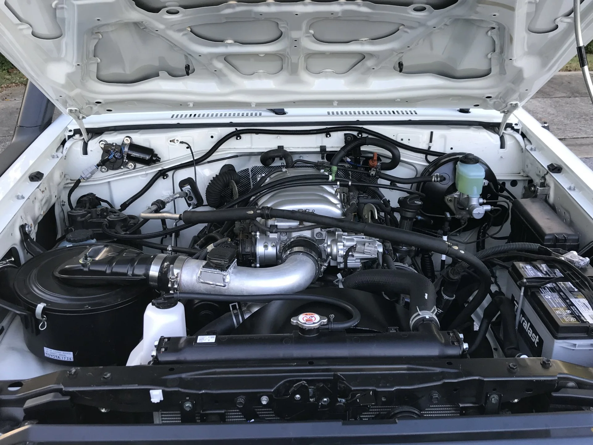

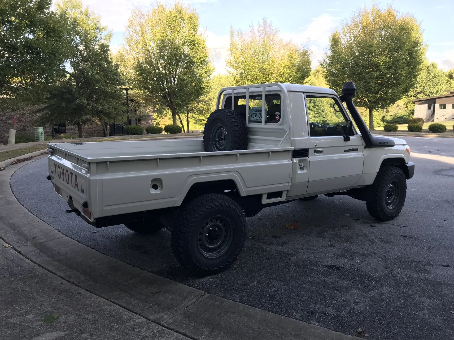

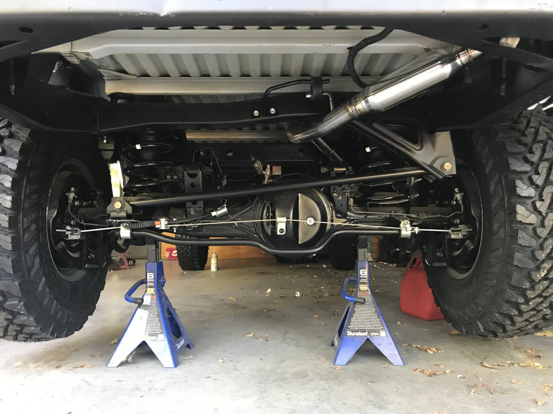

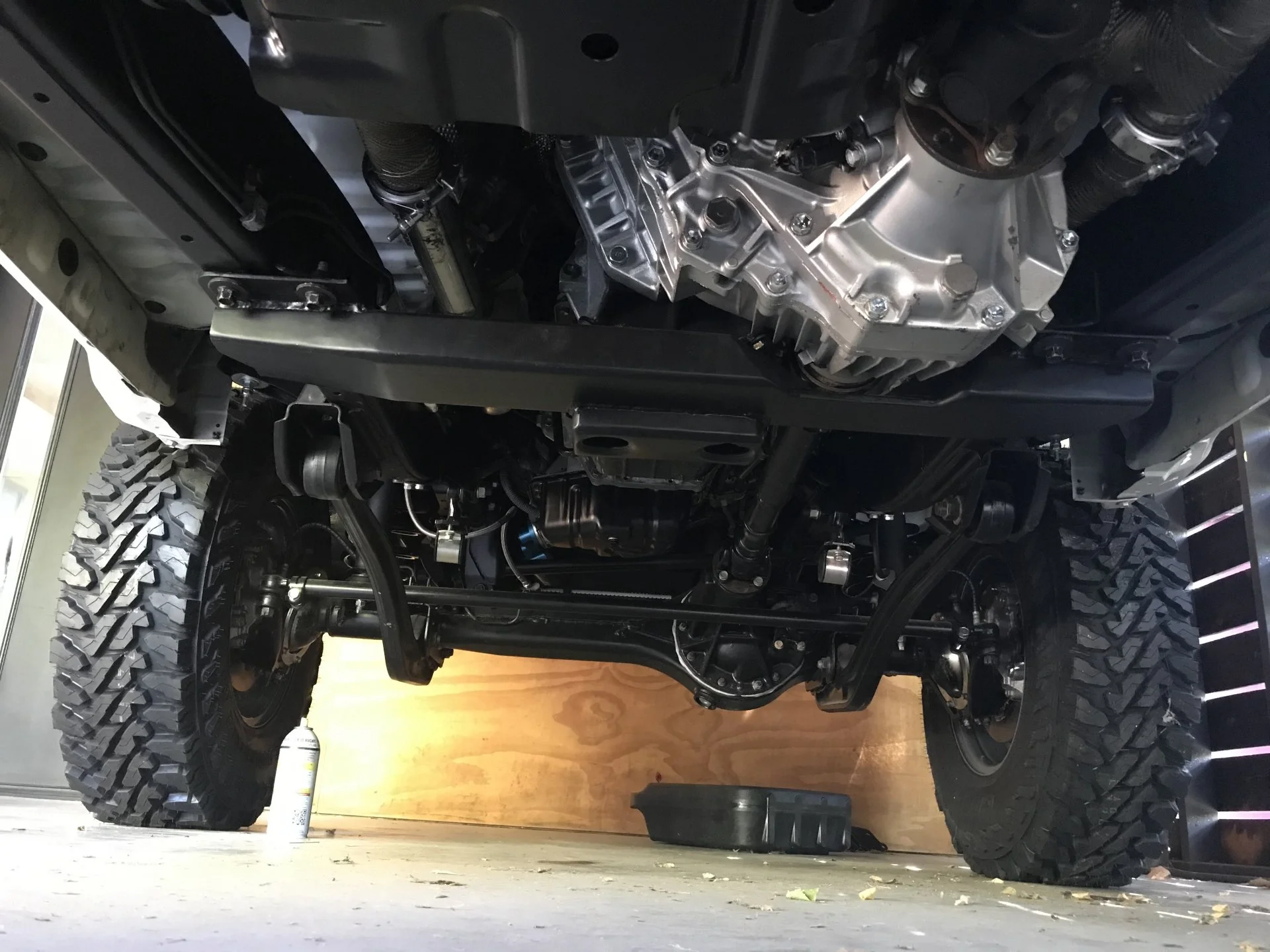

Decided to post my build here post completion. A big thanks to this forum, tons of info and knowledge here! This build is really not too much different from what you’ve already seen except for my choice of engine/trans. I completed most of the work myself at home in my garage. Majority of 79 series parts are new/oem so things like steering column and dash had to be bought piece by piece and put together. Been working on it for the last year and half. I decided to use a 2uz/auto a343f (100 series),mainly since it’s a common engine here in the US and parts are plentiful. Still wrapping up a few things, need a stereo and speakers (ordered), center console needs to be made, needs some protection underneath, and I plan to build a rear bumper. It will be similar to the stock tube bumper just not flimsy. Other than that I don’t plan to do too much else to it, it’ll probably stay the way it looks, I really love the way these trucks look in stock form with some 255’s, I might add an Arb on down the road and maybe manual hubs.
Details
80 series frame stretched 13”
Factory lockers F&R

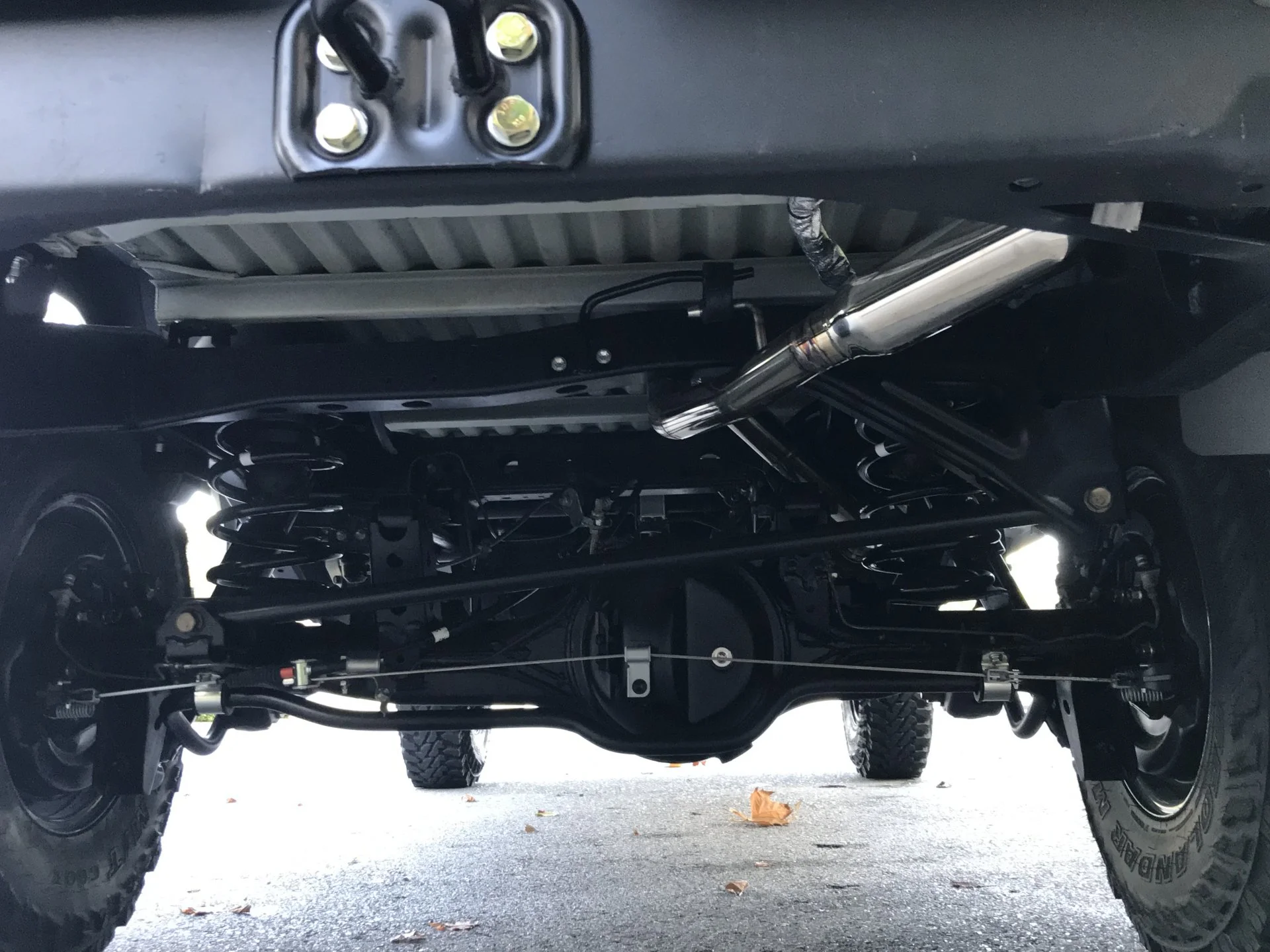

Suspension is OME 80 series stock height with 30mm spacer in front with factory Toyota shocks.

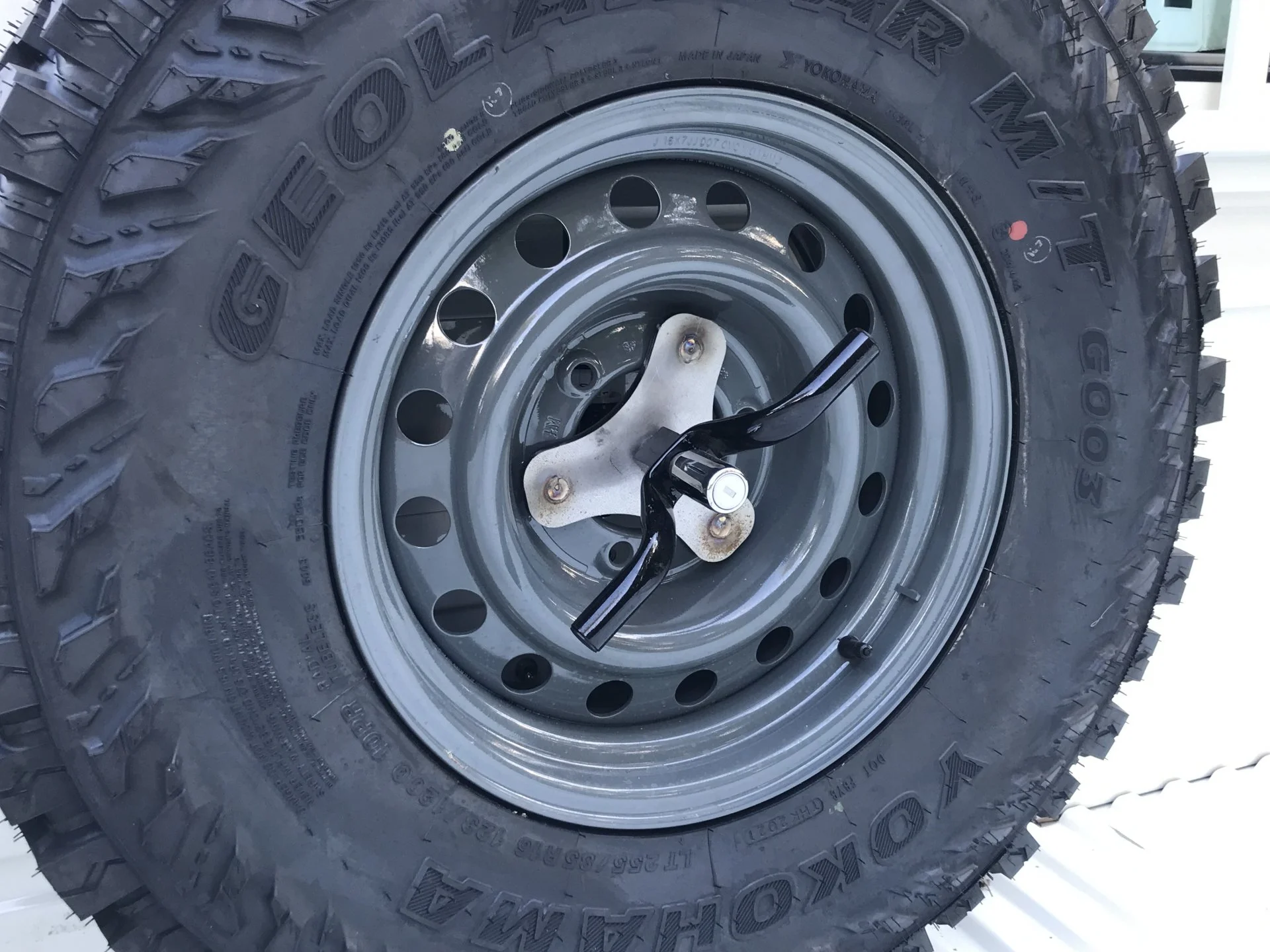

Wheels are 1st gen Tacoma, Tundra, Sequoia steelies powder coated traffic gray B on 255 85 16 Yokohama Geolander MT 003
2uzfe 4.7 from a 2001 Toyota Tundra 2wd
A343F 100 series transmission and HF2A transfer case
Modified Tundra 2wd wiring harness, center diff lock control (100 series) and factory 80 series F&R locker control and harness
Exhaust is 2” all the way to a new oem 100 series muffler (modified) and 2.25 from the muffler to resonator and tailpipe. Exhaust is quiet, sounds stock which is what I wanted.
100 series shifter

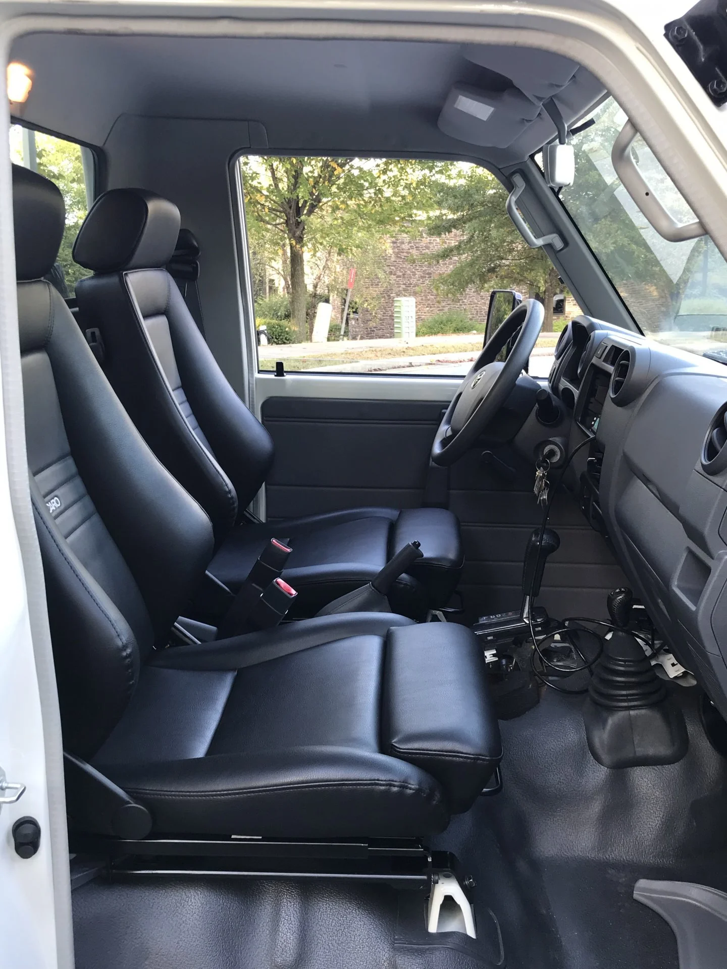

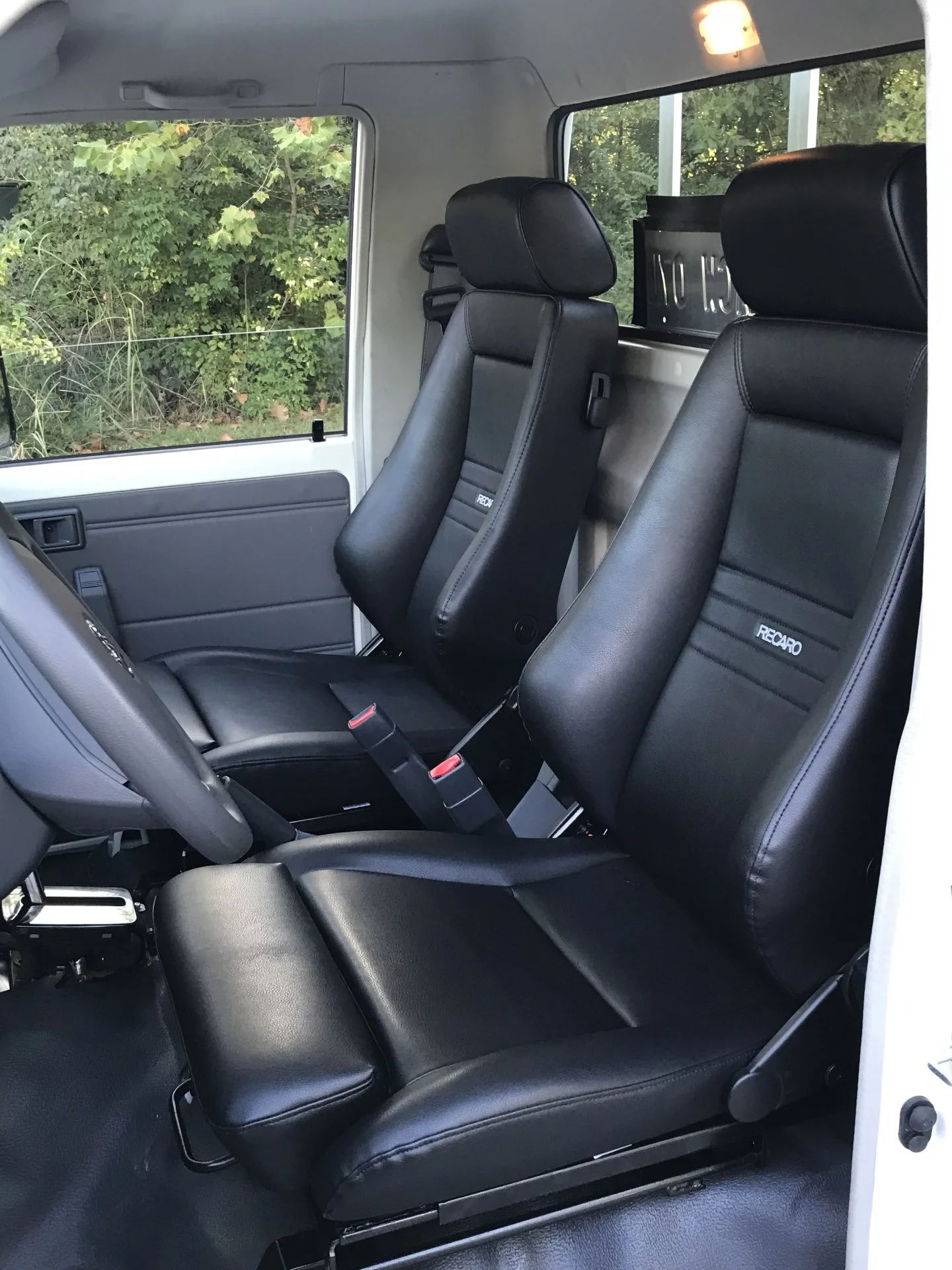

Recaro specialist M seats
79 series parts:

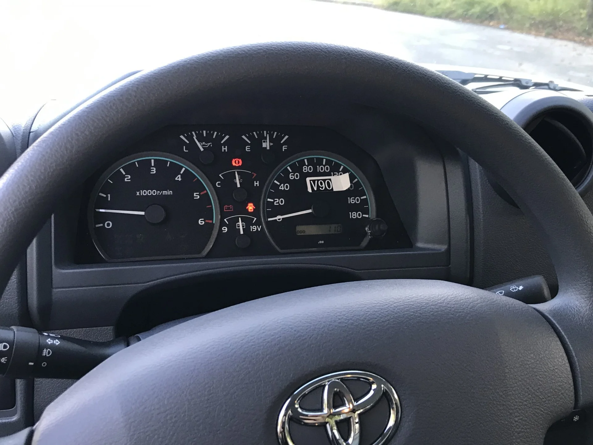

Complete Dash w/gauge cluster
Oem GrJ79 gas tank (front tank only)
Hzj79 rear driveshaft/custom front shaft
Hzj79 radiator with custom fan shroud
Hzj79 cyclone air intake
GrJ79 power steering lines(modified)
Hzj79 brake booster
Seat belts and buckles
I will post pictures of the build from beginning to end randomly through this thread. Feel free to ask any questions and I will answer to the best of my knowledge.

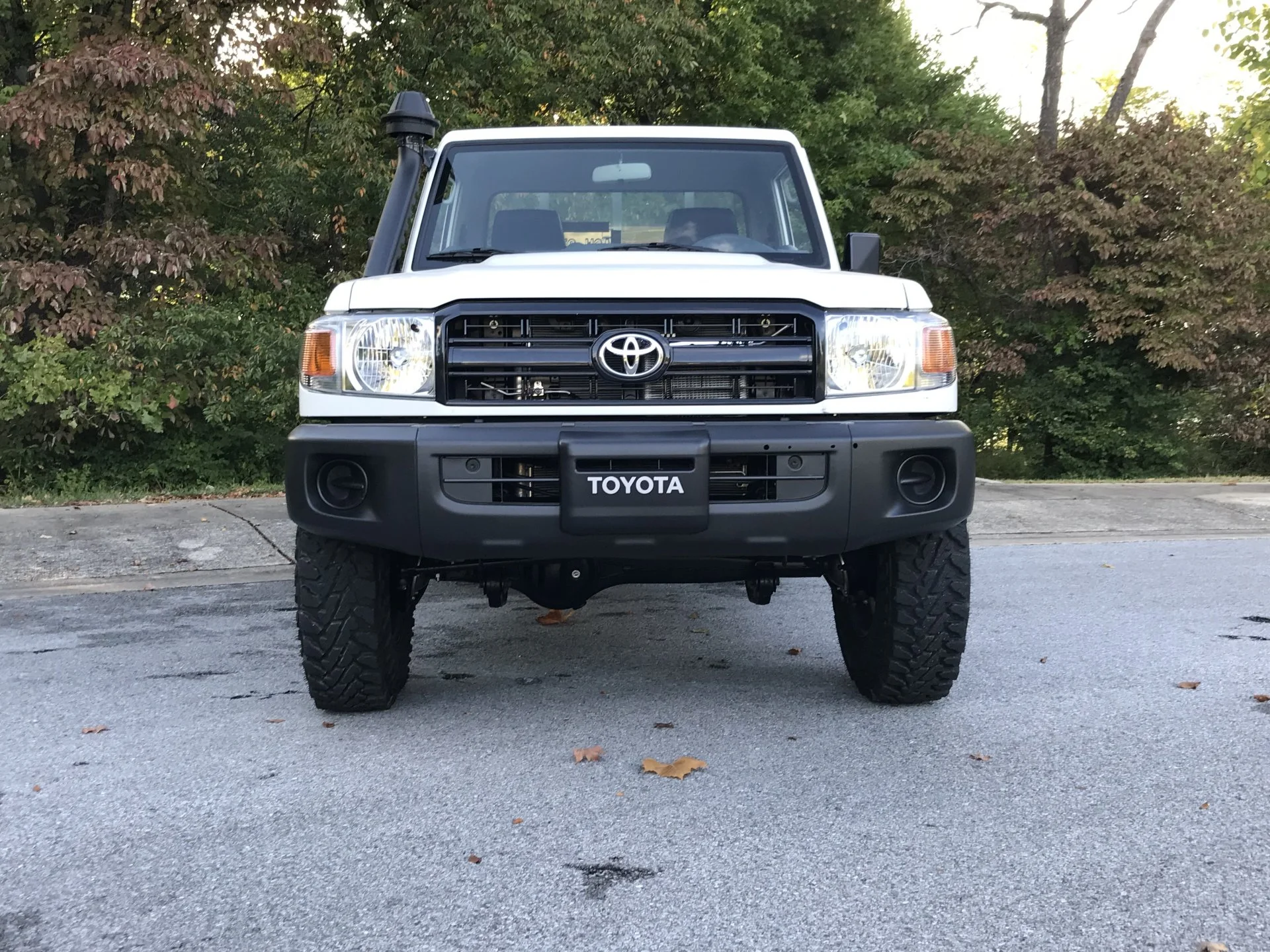

Awesome rig. Well done!
Well look at that! HOT!
Maybe I missed it in the initial post but where the did the 6 lug steelies come from?
Very nice …. Keep the photos coming. 😊

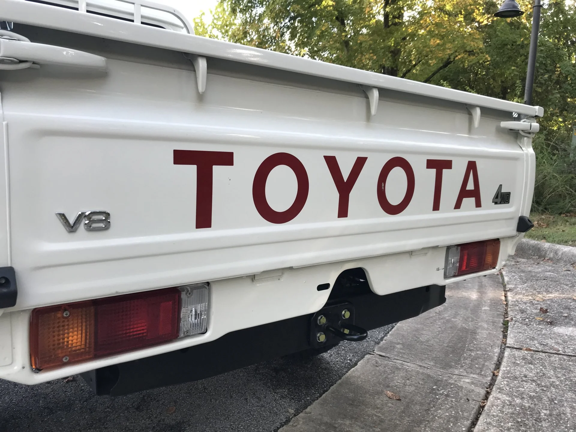

Gotta love that V8 logo. 😊
Beautiful build. They look so good in stock form.

Thanks! I definitely like the look of those, looks factory. I’ve got some JL’s coming for the stock location. I typically keep my audio simple so I’ll see how those do. Will definitely consider them if I want to add to my current setup.
And some say there are no interesting 70 Series builds on ‘MUD anymore. 😊
Are you running a OEM power antenna? Which dash wiring harness are you running?
