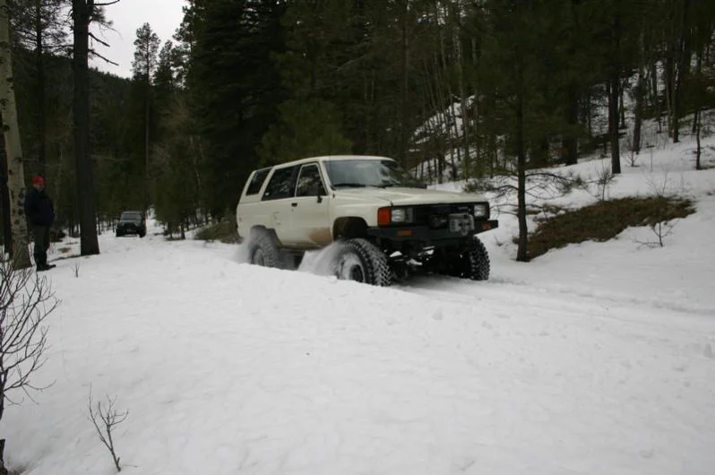

That is a pic of me churning up the white stuff.

You know how lucky we were that it didn't let loose up on the trail? I don't know if you could have gotten through some of those spots without large amounts of throttle.
