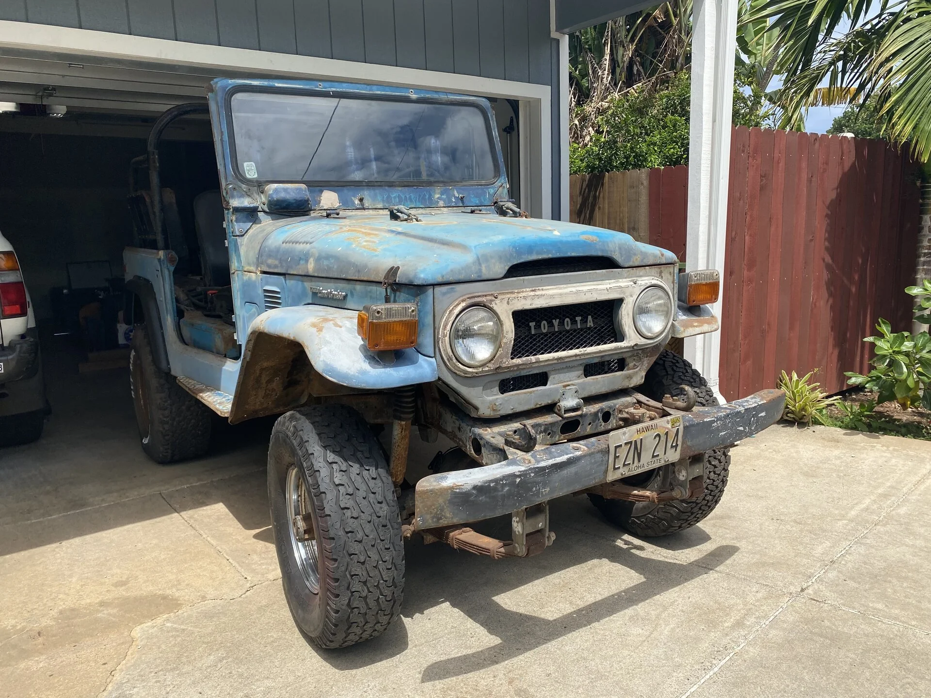

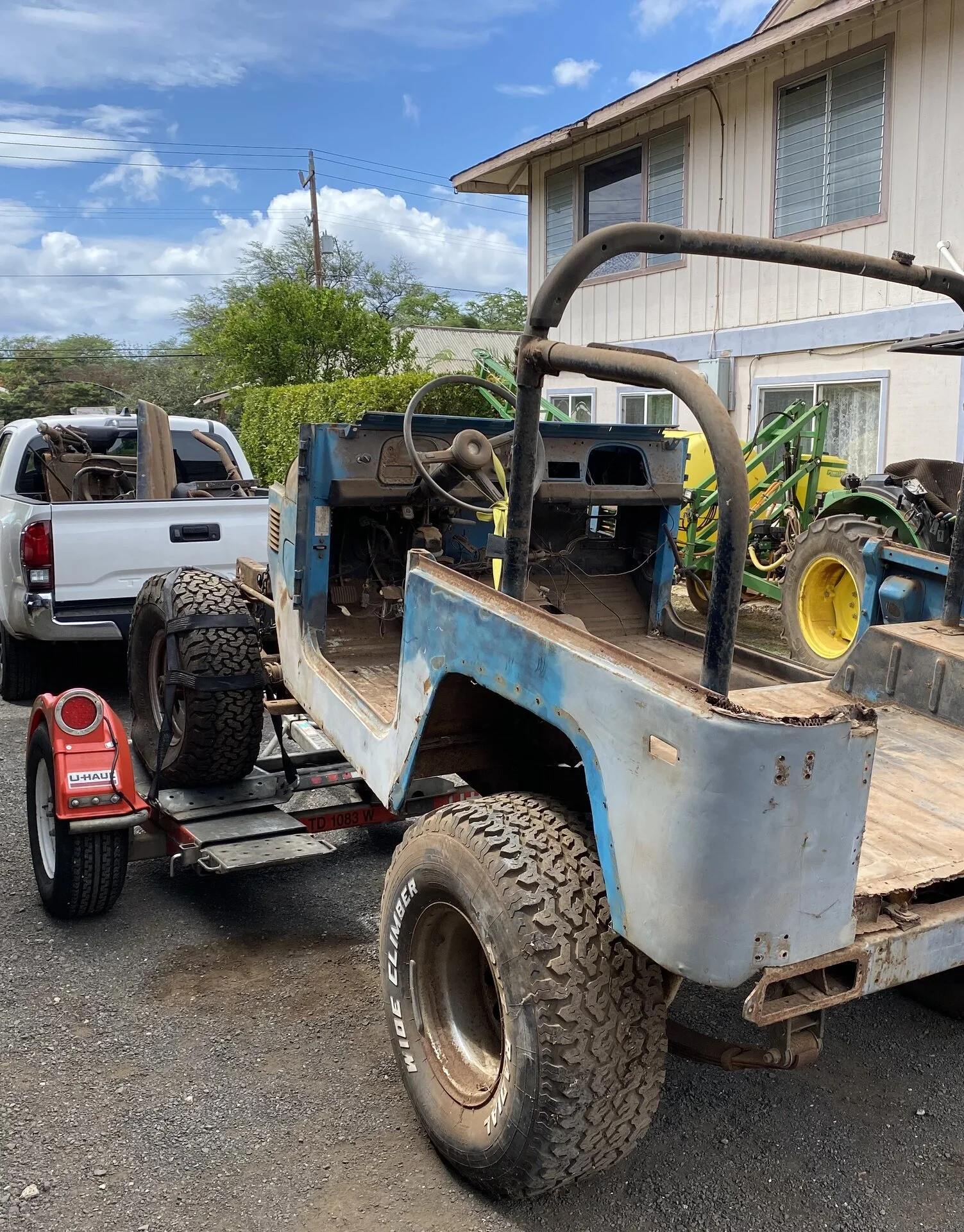

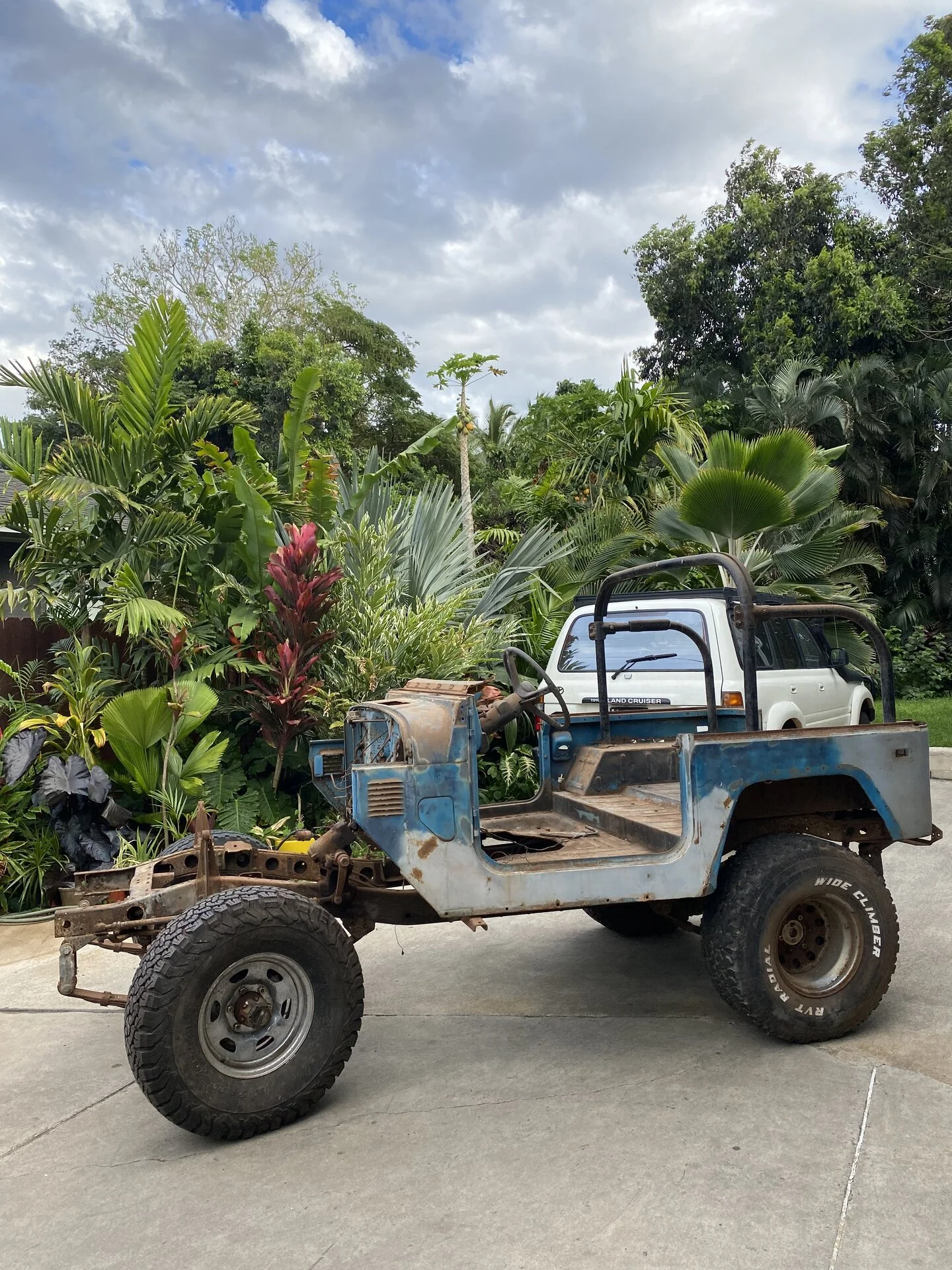

Derail away, all five cruisers in my garage are fair game for discussion on any of my build threads. As for the ‘78, aka “The Chicken Barn 40”, was found over on the west side of my island. I was told there was a guy that had a few 40’s in pieces sitting in some abandoned chicken barns and a couple more rotting in the field next to the barn. We took a trip over to the other side of Oahu and found some treasure, albeit in pieces. Any serious Land Cruiser fan would have seen the potential right away! Here’s a few pics pulling it from the chicken barn and loading on the dolly for the hour long ride back to its new home.
Farm owner had a backhoe that pulled it out and pushed on to the uhaul dolly.
The second of two truck bed loads full of all the 40 parts.

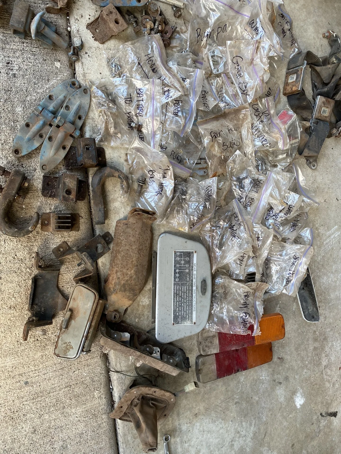

Sorting through the boxes of parts and bagged hardware that came with the 40. Some good stuff was hiding in there.
Unloaded from the tow-dolly (which was super sketchy with 30 year old tires on the rear) and ready for a good hose down to get all the spiders and dust/dirt from sitting for over a decade.
Unloaded the two truckloads of parts; degreased, scrubbed and rinsed all the various pieces that made up a complete cruiser.
Then reassembled to see how everything fit back together. And just like that, a nearly complete Cruiser (minus the engine and hardtop) and was added to my growing LC collection.

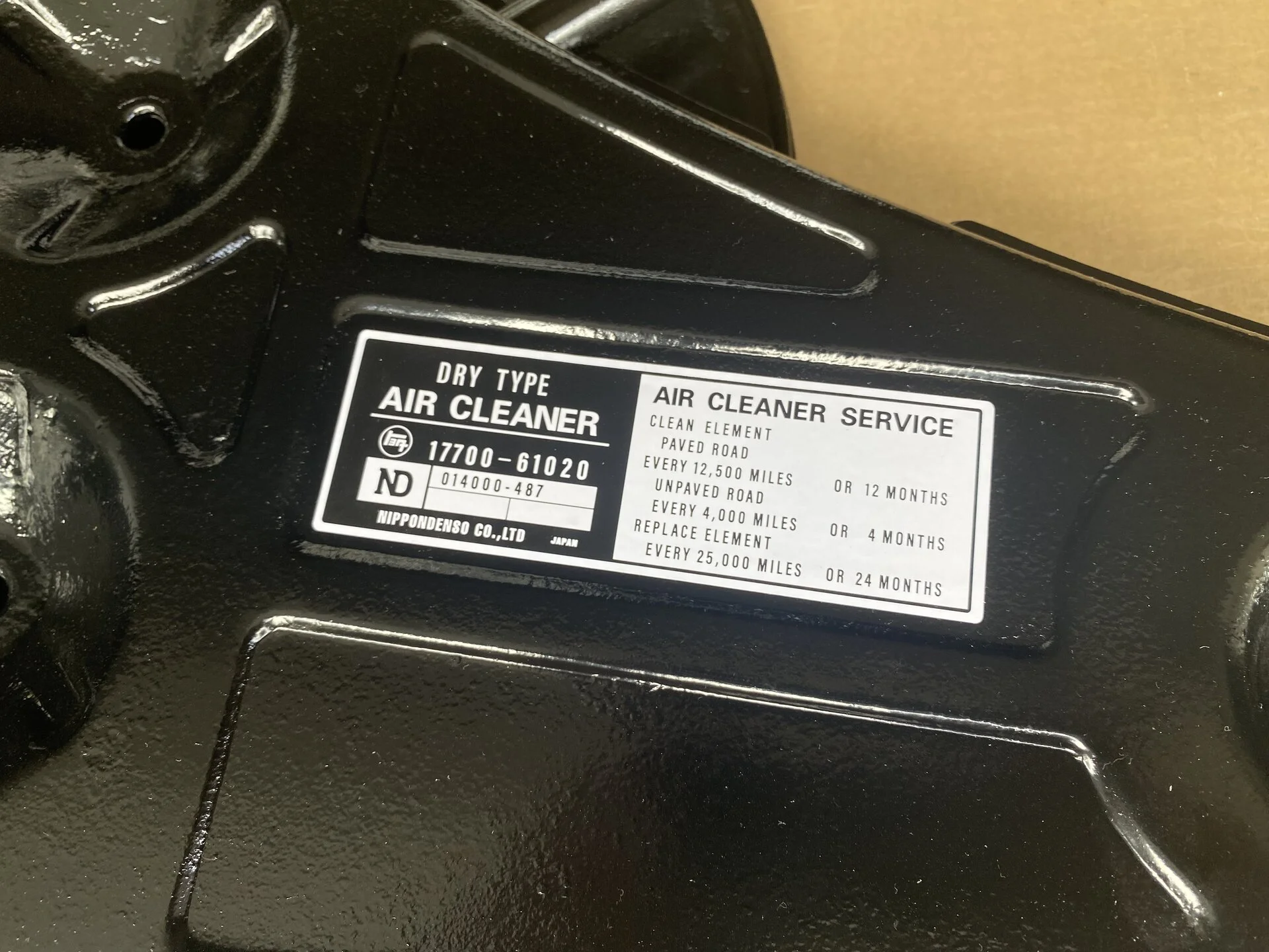

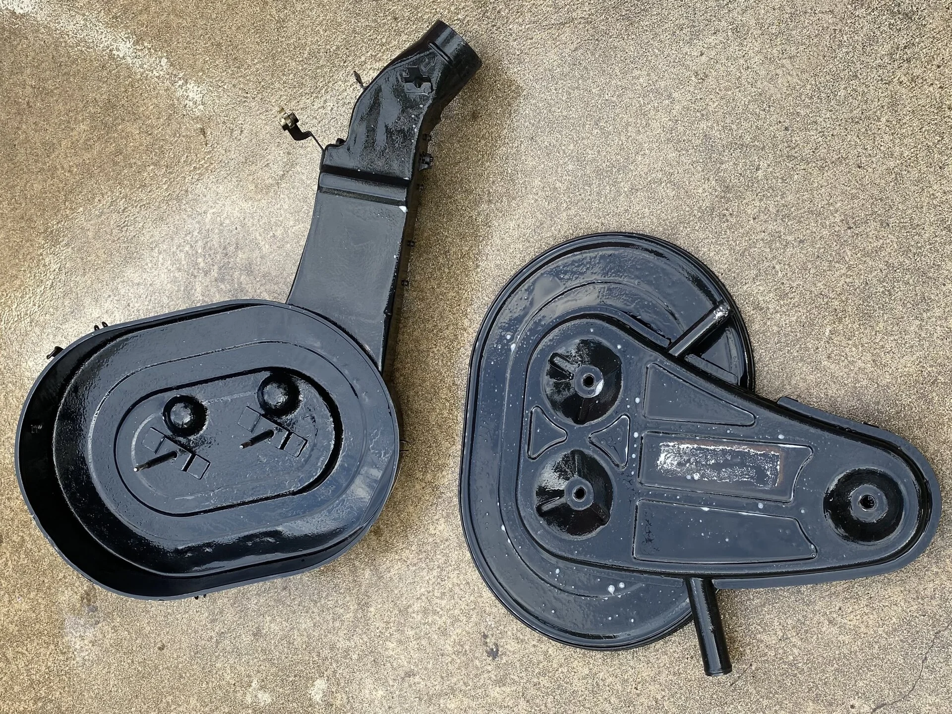

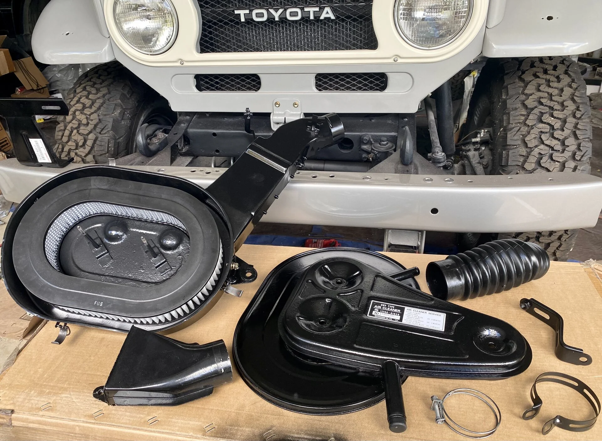

After going back and forth for a while, the decision was made to pull the air cleaner and give it a refresh even though it was in pretty good shape already.
As with most things on this project, it was degreased/scrubbed, any loose rust was sanded, treated remaining light rust and bare metal with the Ospho, followed by primer and paint. Added a fancy new correct year reproduction decal that I believe is from City Racer.

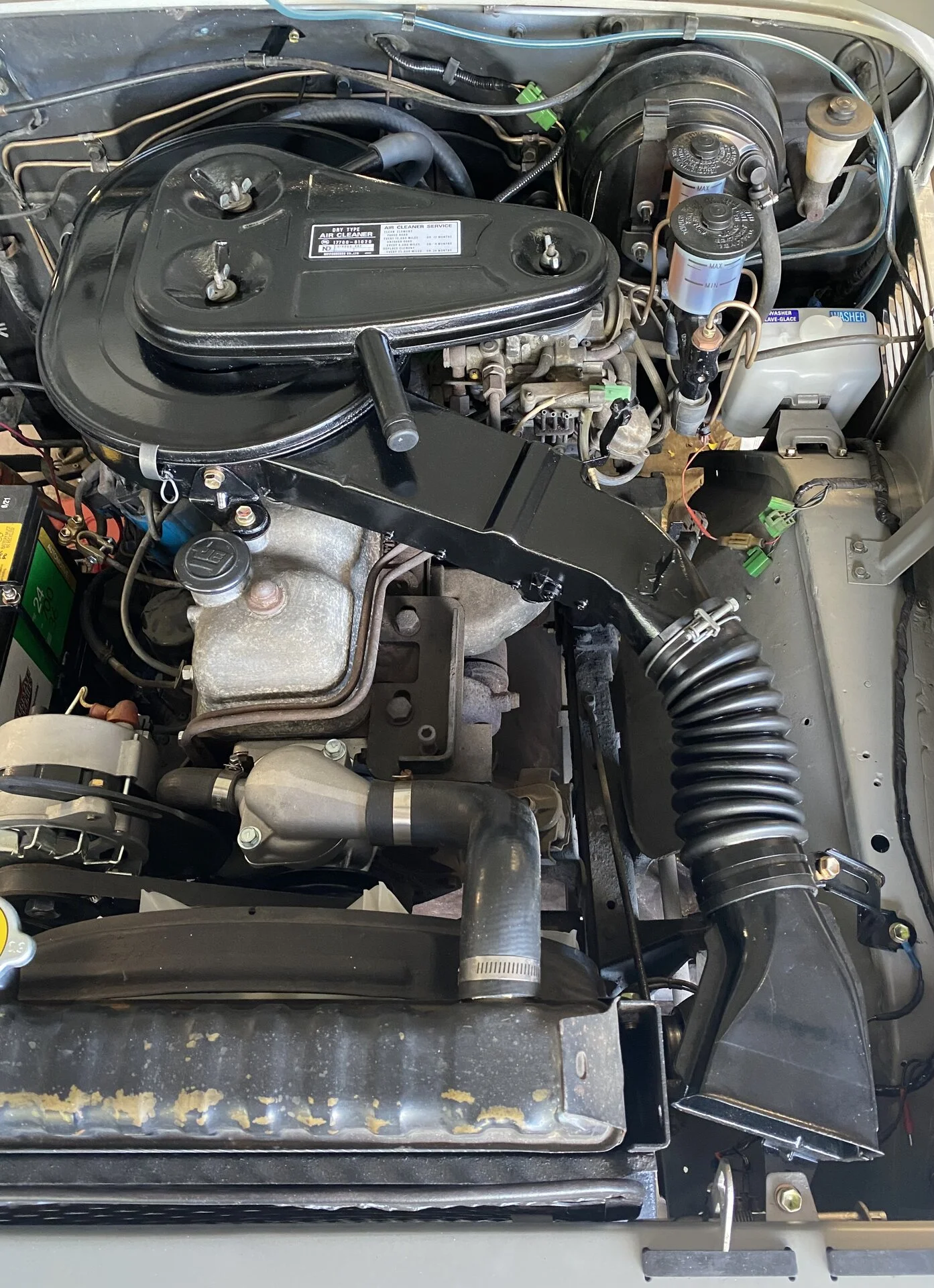

All the other components, brackets, front horn, clamps, intake hose were all refreshed and added a new Denso air filter to finish it off.
Also removed all the clamp/clips and removed all the rust and treated with Ospho followed by a couple coats of Penetrol. Cleaned up really nice and a huge upgrade to when the previous owner spray painted them black. Finished that off with all new Overland Metric hardware.
All hooked back up and looking so beautiful! Really makes the engine bay look much nicer. Really happy we decided to freshen it up.

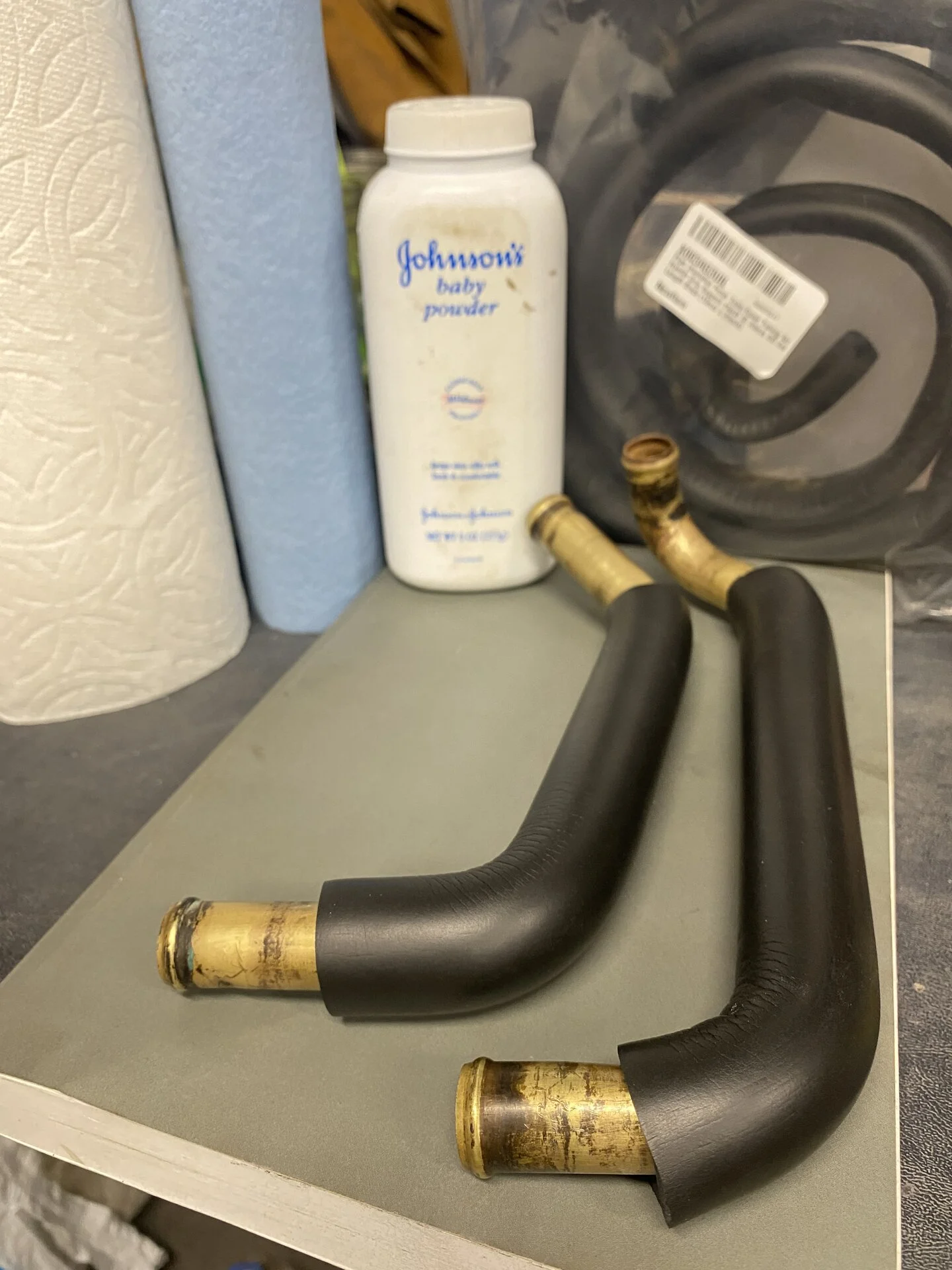

With the radio and dash wiring all squared away, the front heater box could be installed. My brass heater pipes going coming through the firewall to the heater box were a mess. Very corroded and black insulation was falling off when touched. Even though my 40 had a rear heater, I salvaged the heater pipes off of my other 40 that most likely didn’t come with a rear heater as it was original to Hawaii. Those brass heater pipes do not have the extra down pipes that go to the rear. Since I will never use the rear heater here in Hawaii, these unique pipes were perfect.

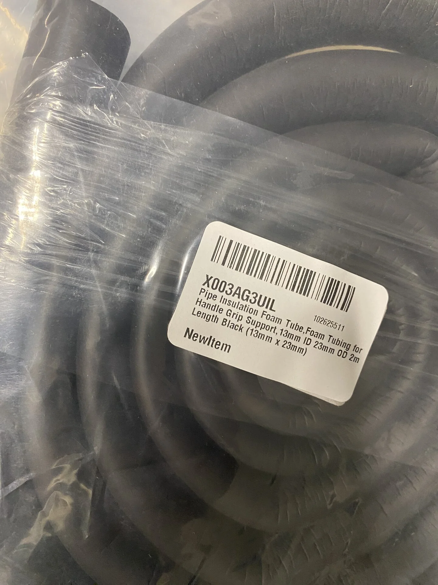

I used the same salt and vinegar dip to clean the brass pipes and they came out spectacular. I ordered some inexpensive 13mm ID foam rubber insulation for the heater pipes. Below is the stuff I ordered if anyone needs the details. It’s 6 feet, so may be long enough to do rear heater pipes as well.

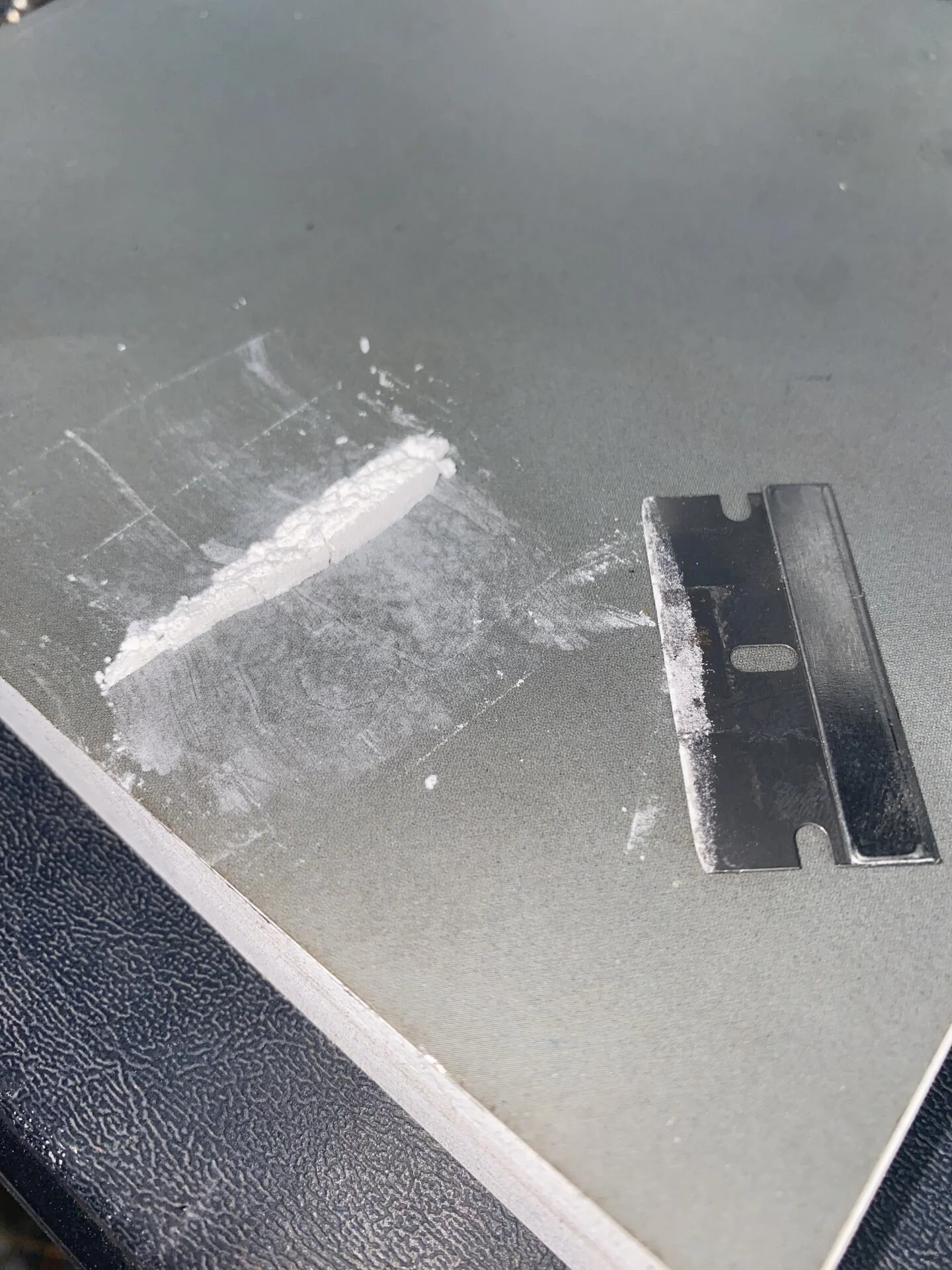

Had to break out the good stuff to get through this next part.
Settle down Moderators, it’s just a little J&J baby powder 😜.
When applied to the outside of the brass pipe and inside the foam insulation, the insulation slides right on the brass pipes so easily. A little compressed air shot through after clears out most of the baby powder.
can you supply the source of the foam insulation you used?
Got it on Amazon, $9.99 for 6ft section.
Pipe Insulation Foam Tube,Foam Tubing for Handle Grip Support,13mm ID 23mm OD 2m Length Black (13mm x 23mm)
I just checked out the product you’ve linked. I has the working temperature listed as -40 to 176* F. Before you have it all together, I’d confirm it’s not going to melt when the brass pipes surpass 212’.
I’d suggest Armscell or similar high temperature pipe insulation instead.
