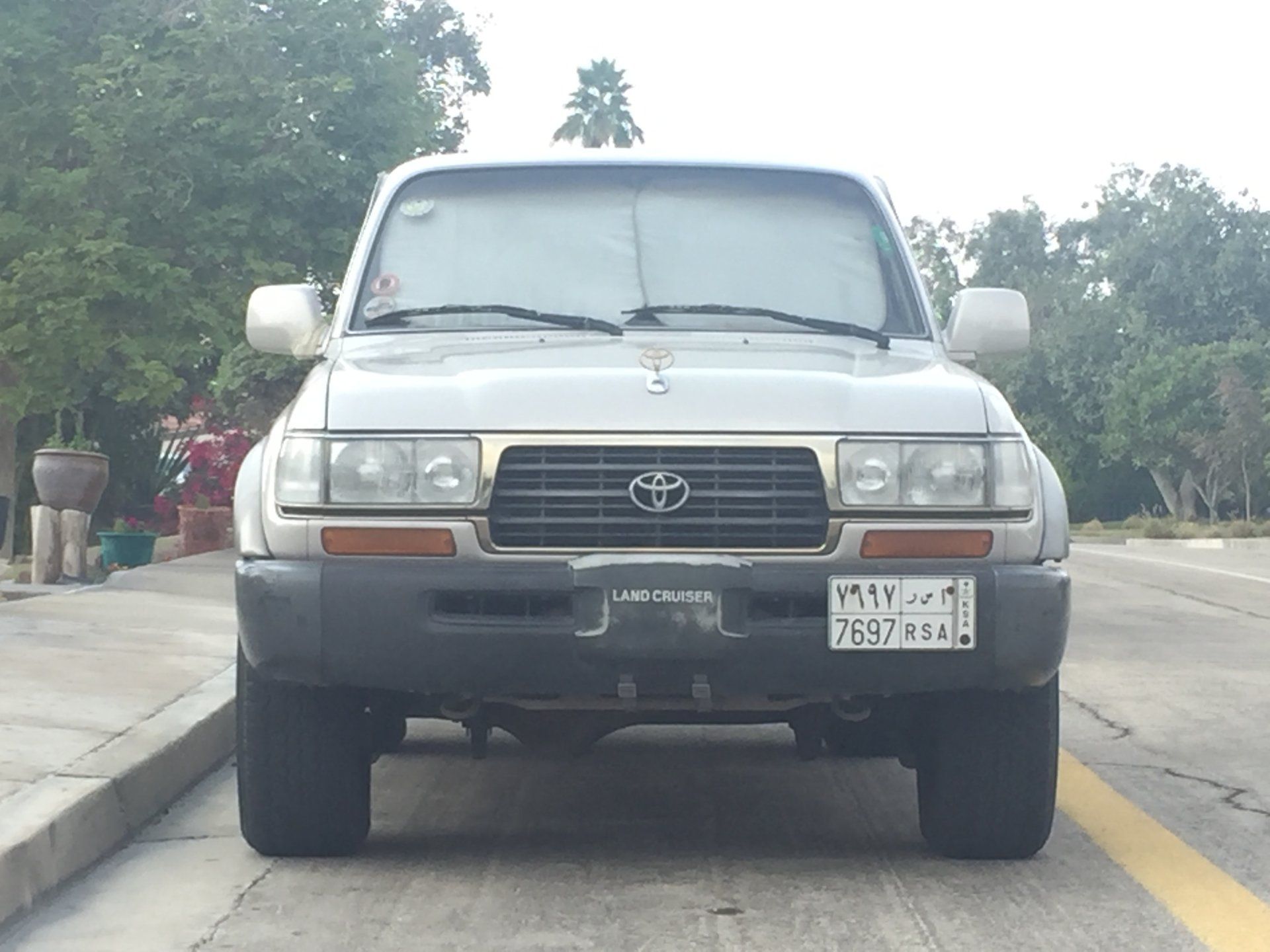

This truck is what got me into cruisers. It was owned by a family friend that bought the truck brand new back in 96. I believe it was the most fully loaded 80 series money could buy in Saudi Arabia at the time. I used to drool over this truck when I was a kid growing up in the Middle East.
Around 8 years ago I asked if I could buy the truck when they retired and they agreed. And, sure enough, 8 years later that's exactly what happened! I can’t express in words how grateful i am to the family that sold it to me. :)
Alrighty, onto the truck!
Here are the details:
1996 FZJ80, H151F 5 speed, HF2AV, F/R Diff Locks, Factory Winch, Sub tank, Fridge Console, Rear A/C, Dual spare tires (6 rims total on the truck) and barn doors.

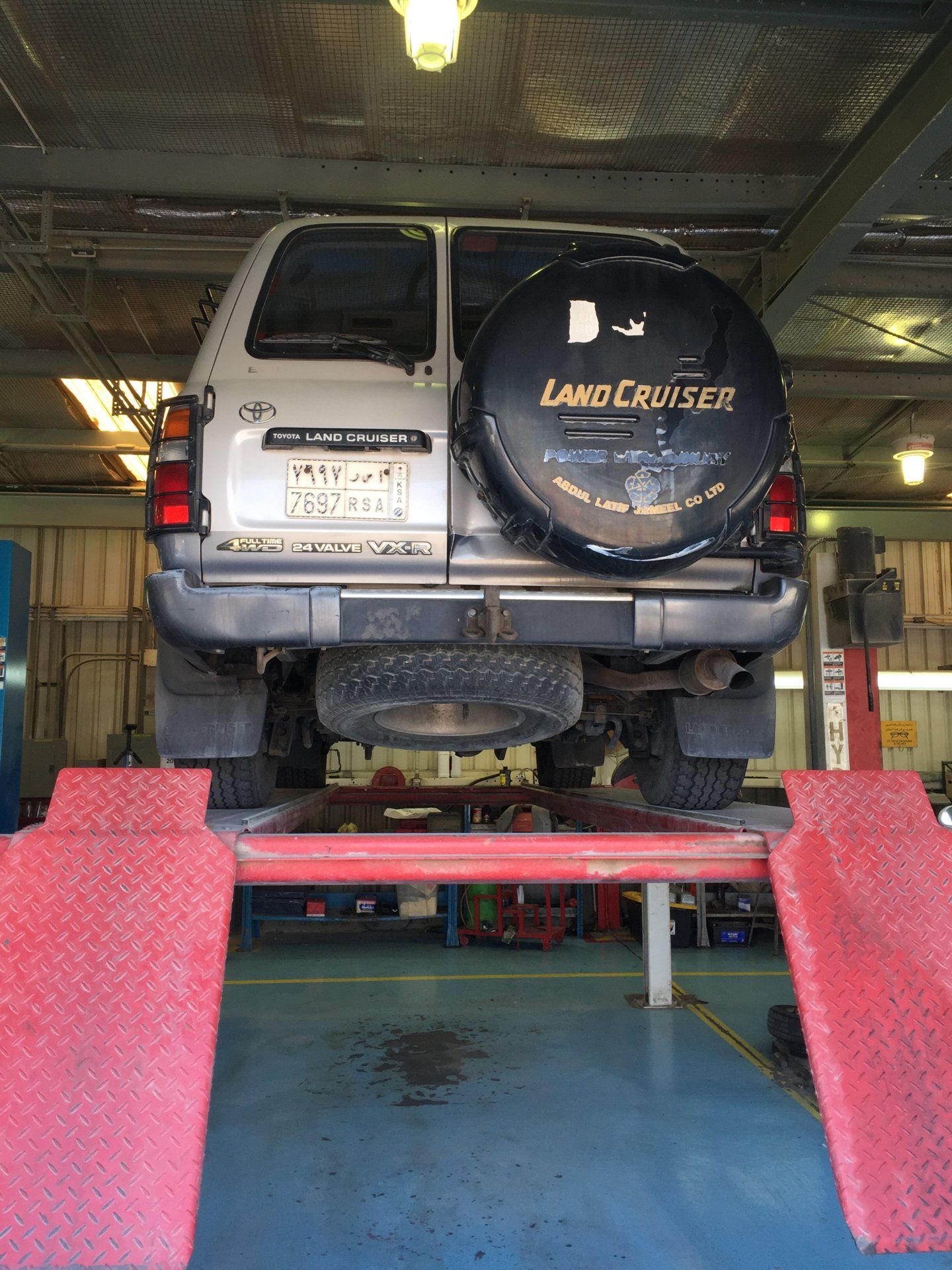

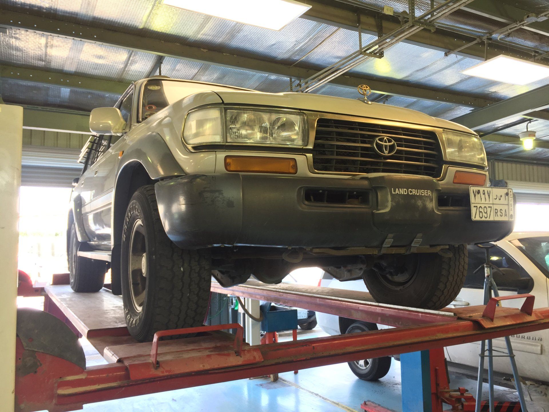

Got access to a hoist while I’m out here!
First order of business: removed damage multiplier.
Second order of business: assess suspension and driveline.

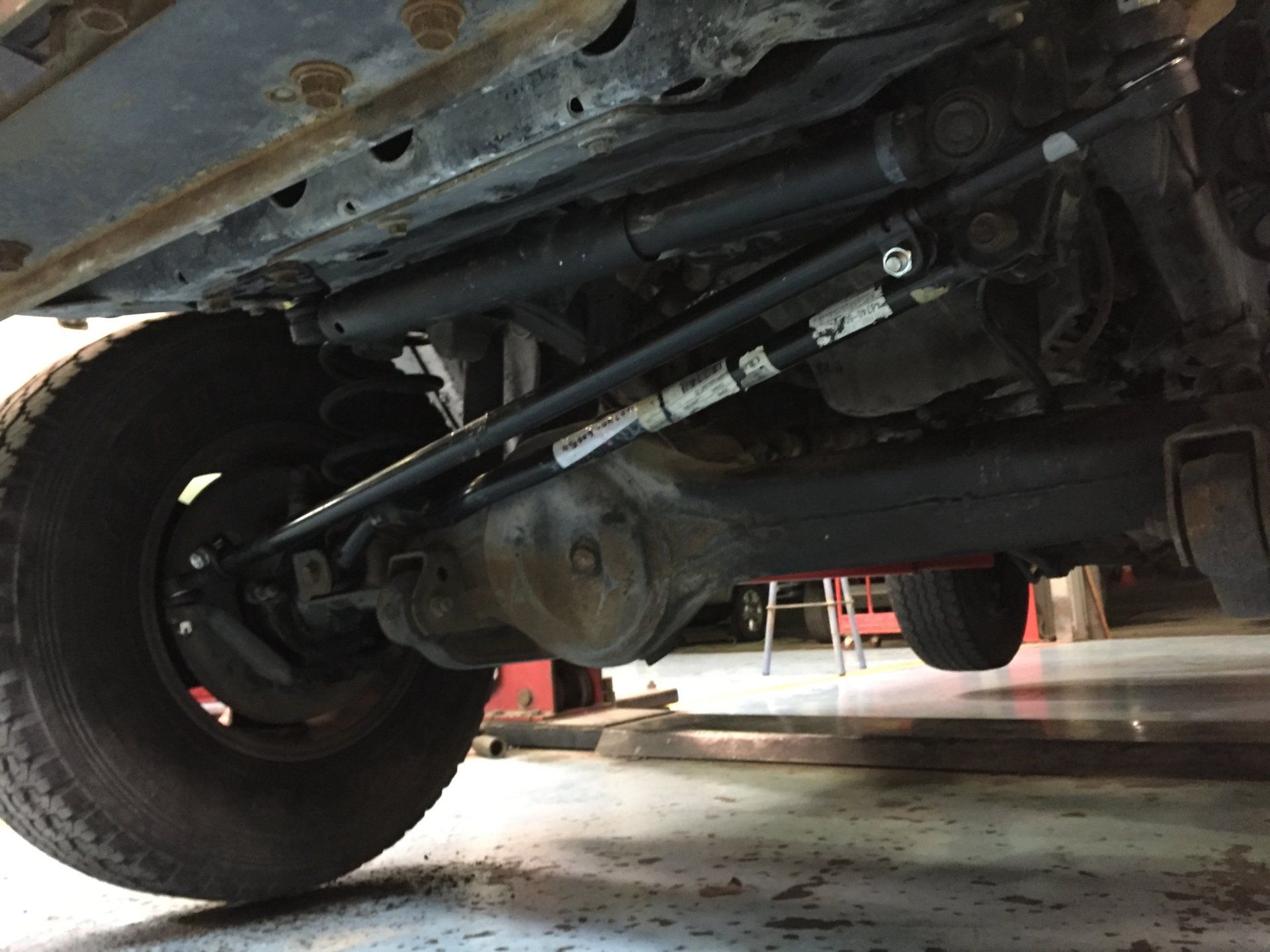

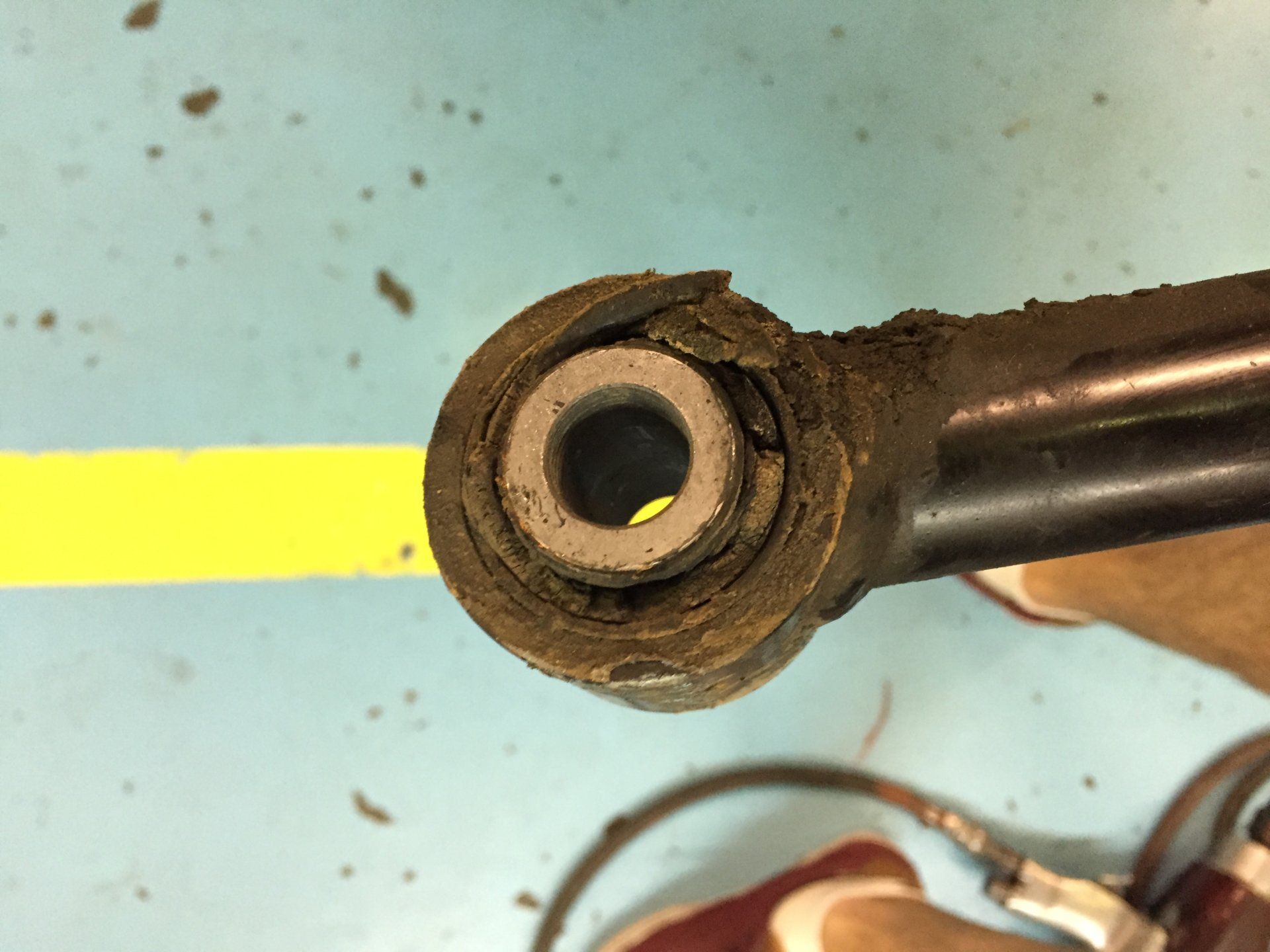

Looks like a few items to tackle. All the suspension bushings are totally rotted out from the heat. These include radius arm, lateral bars, rear control arm and sway bar bushings. Also looks like the tie rod ends on the tie rod and drag link are on the way out as well. And a slight power steering leak from the PS pump. Lots of stuff to keep me busy when it gets to Canada! I don’t have much time here so unfortunately I can’t tackle all of them on my Christmas vacation. Knuckles look like they have moly in them but I’ll redo them once it lands as well.

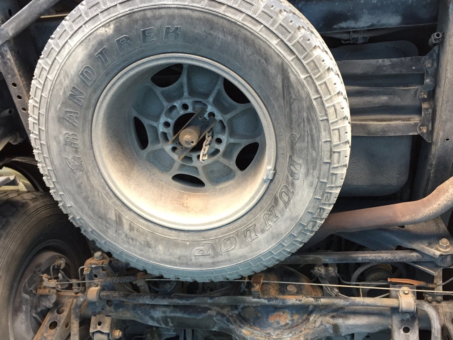

The spare tire under the sub tank is really interesting, I didn’t know there was enough room for both!
"Room" is a subjective word here.
All Aussie spec 80's have sub-tanks, and spare underneath. If you do much more than mall crawling, there's not really room for a spare underneath. They hang down a long way, and will be the first thing to drag offroad.

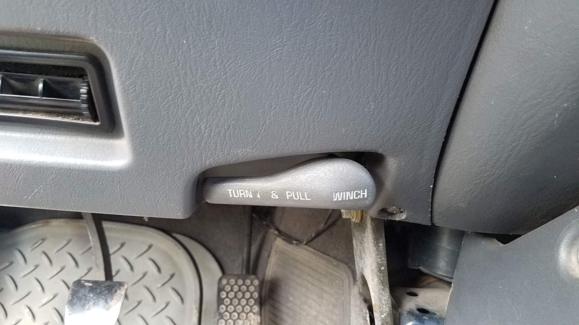

Is the winch handle below the steering column a hand throttle?
Yup it’s the idle up throttle. I’m assuming to idle up for when the winch is used.

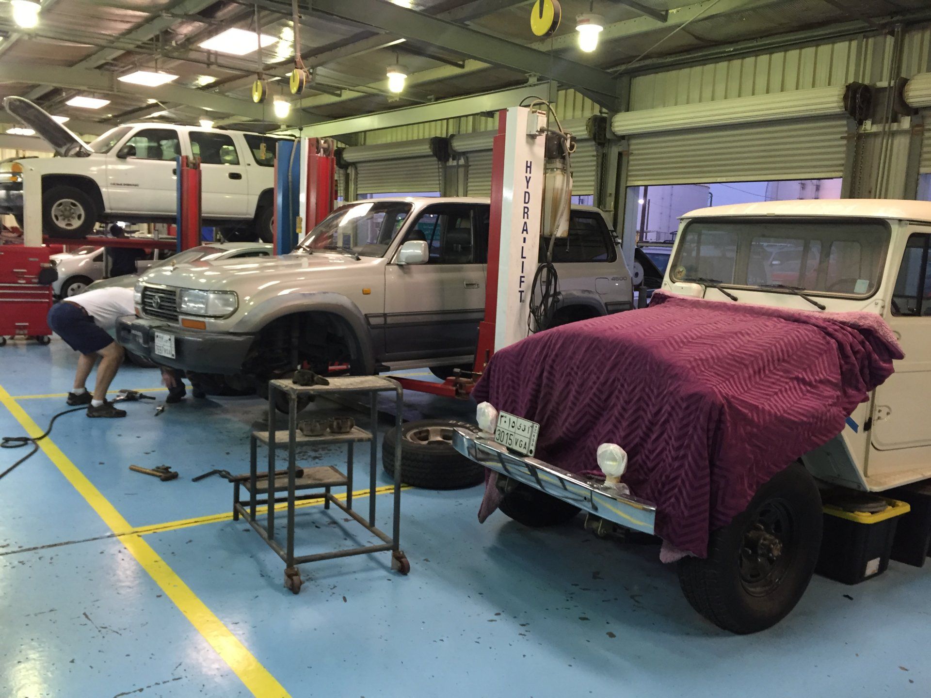

Back in the shop. Got some more assessments. Looks like the trunnion bearings on both knuckles have lots of play. Will do these when I’m in Canada and I can take my time. Brakes have loads of meat left and no vibrations. Phew!

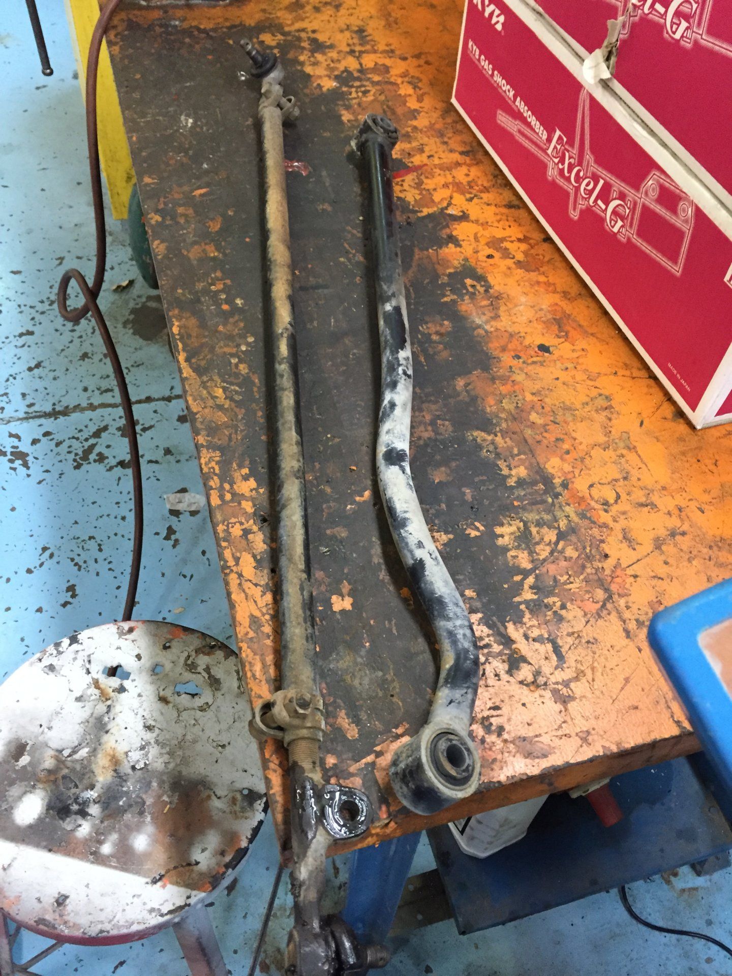

While I’m here I just wanted to shore up some of the front end slop so that it can safely drive to and from shipping locations. I was able to get my hands on a new front lateral bar and drag link. Abu Mazin Toyota didn’t have the tie rod and I didn’t want to fight with pulling the ends off with limited time. So I’ll leave on there as is.
Was working next to a 40 series restoration project. Holy crap that thing is mint. Cudos to whoever’s truck that is if you are on here!
Pretty happy I replaced the lateral bar, has anyone seen these this bad?
Front end slop is reduced significantly. Though the steering shock is toast and basically on there for show. Lots of work to do when it gets to North America.

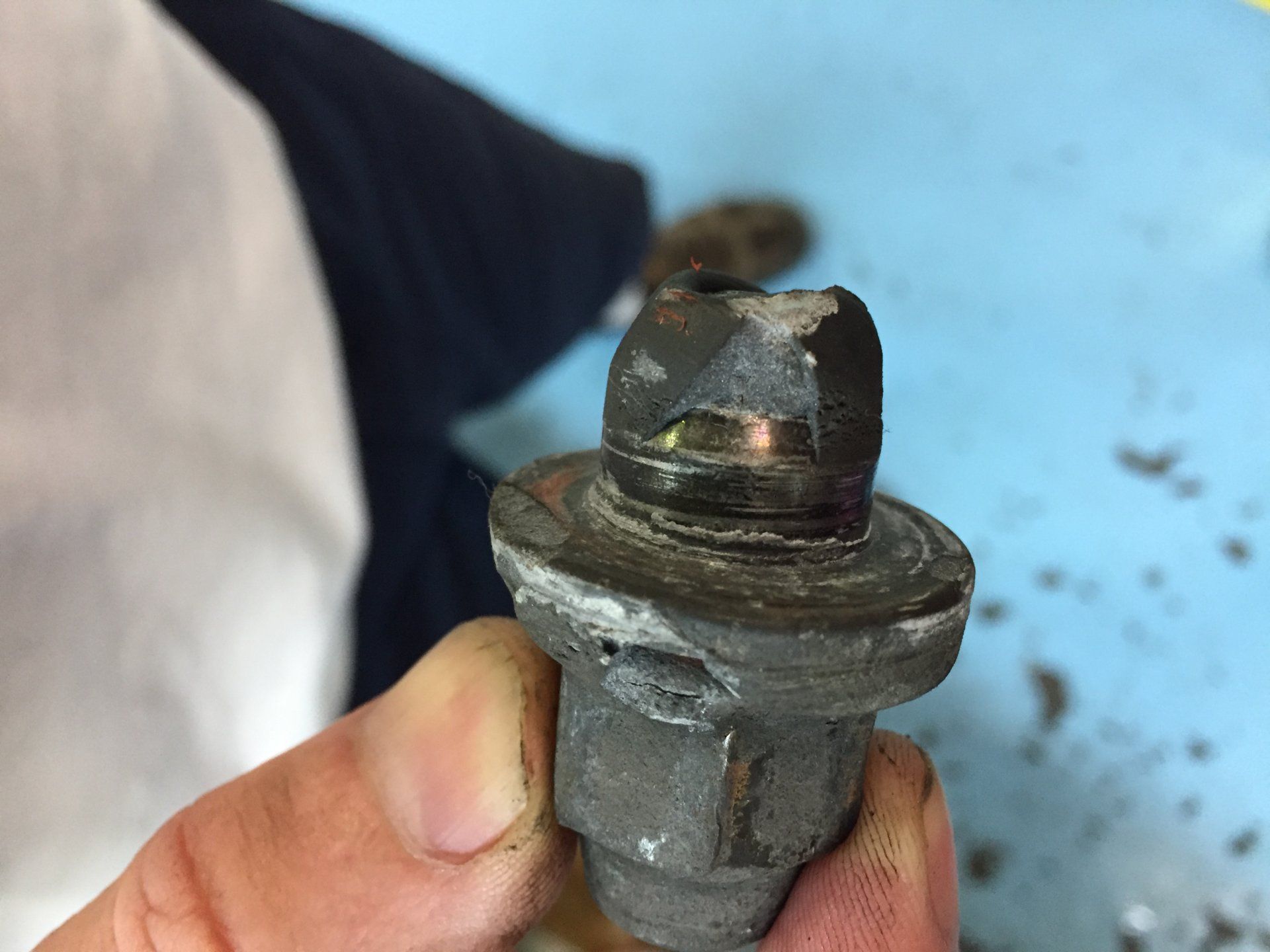

Also, forgot to upload this gem. When wrenching on the 80 we discovered that the mechanic that was working on this thing broke a stud and decided to GLUE the lug nut back on for show. I’m sure that won’t be the only interesting nugget I’ll find.

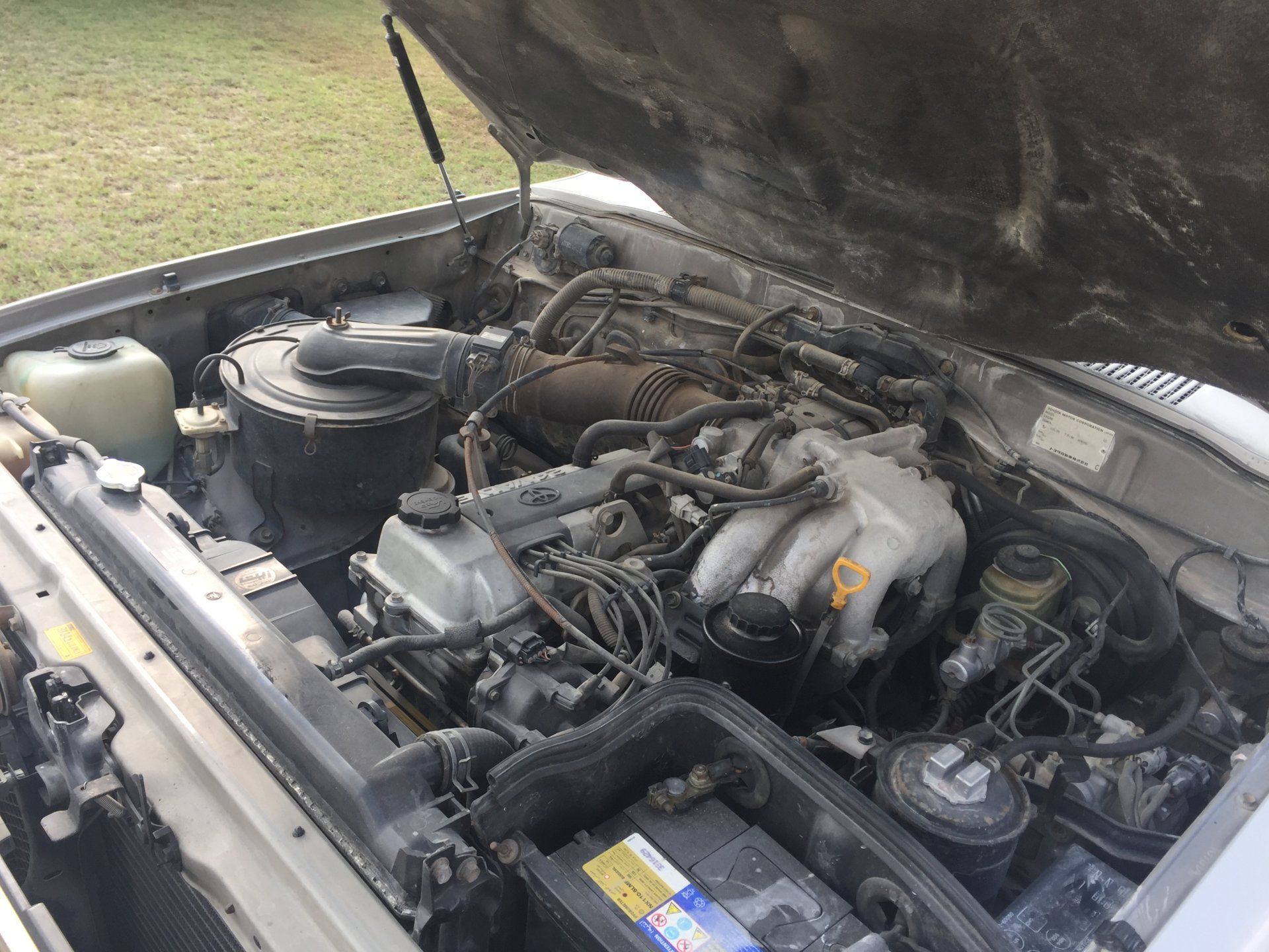

And did a once over on the motor. Lots of little things to sort out. I’ll probably do the same in depth PM job I did on my FZJ100. One thing though looks like the oil seal on the distributor is leaking quite a bit.
Also, I’m trying to figure out if the rad has been replaced. Anyone know if T Rad radiators have date codes???
