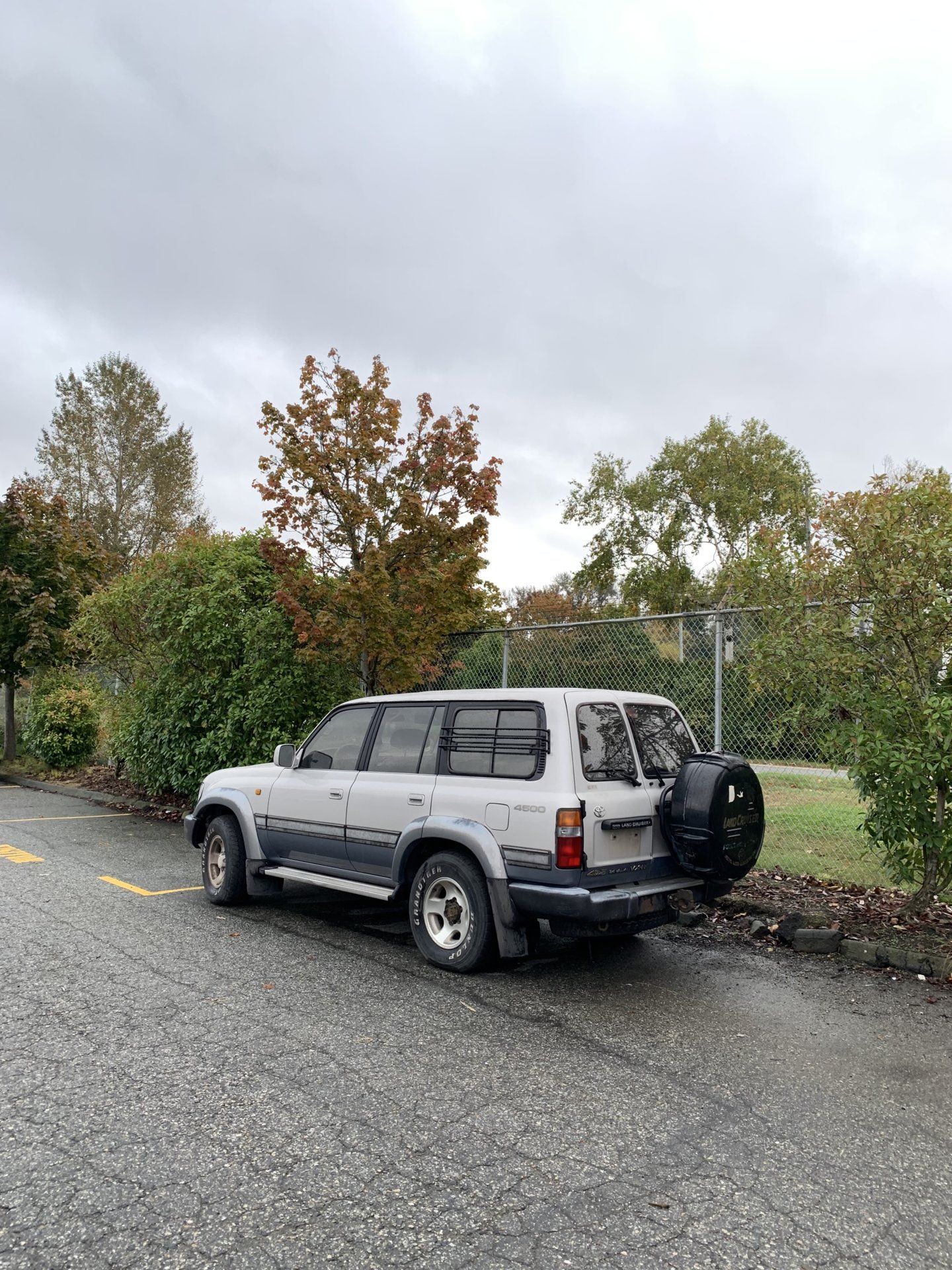

I’m used to seeing the British Columbia CL ads for all the RHD 80’s coming in, and they just don’t “ring the bell” for me - but yours is damn cool!
I’m not into barn doors for the way I like to use the back as a ‘hooch’ in the rain with a place to park my cheeks & a roof overhead, but to each their own.
Odd, but cool - I’m liking those 3 horizontal bars that look like a perfect dog barrier so you can leave the sliders full open either direction, and a “towel/clothes/whatever rack when you set up a camp.
If you could shoot a few shots of how those integrate into the windows, that would be cool - or if you think you want to ditch ‘em, shoot me a PM, my dog would dig ‘em!
Those three window bars would have been wiped off the side in some of the wheeling I've done in the past.
My HDJ81 had a single horizontal bar at mid window height inside the cargo area. It was handy, until I bent them using them to strap cargo in.
The 80 has finally landed in Canada!
Flew to Abbotsford and took a taxi to the warehouse where my broker was storing it. Fired right up too!
First order of business - buy windshield wipers for the drive to Calgary. These are almost never used in the Middle East so they are dried up to the point of being useless. And Vancouver is quite rainy this time of year!

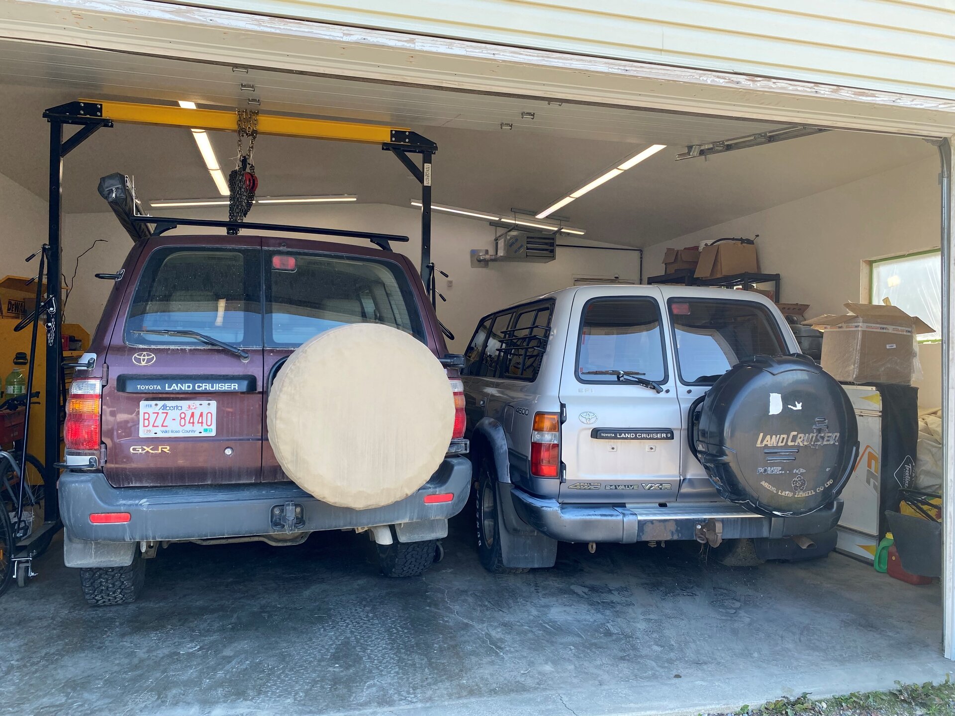

Did an oil change on my FZJ100 and finally had both my GCC trucks side by side in Canada. Funny to think both these vehicles lived in the same small town in Saudi Arabia for two decades and they wound up in the same place half way across the world.

dude, I forgot how small a stock 80 looks next to mine!!! hahaha
Glad I can help
