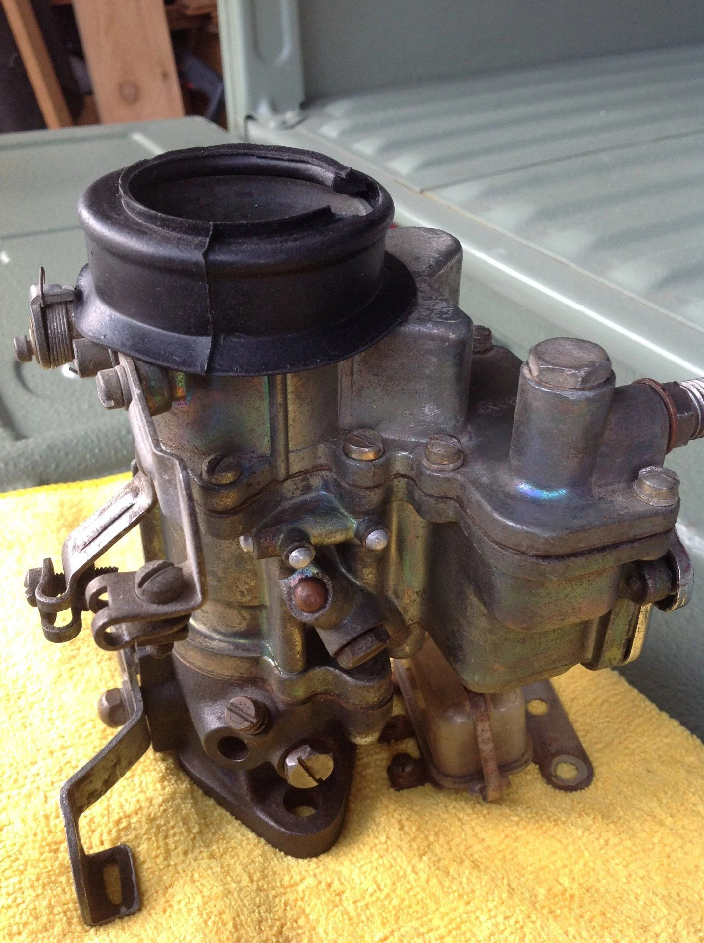

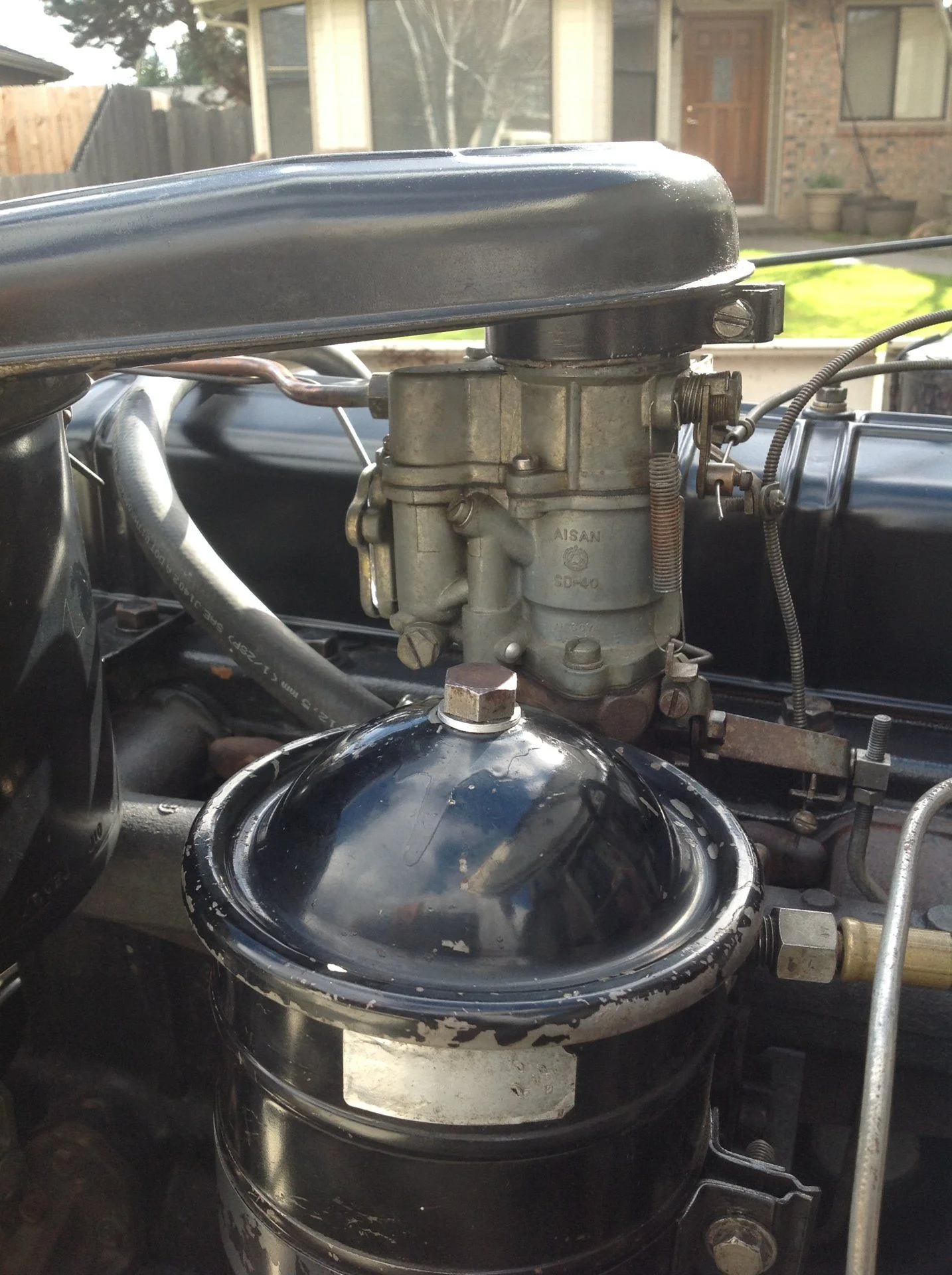

OK all you SD40 single barrel guys......has anyone come up with a replacement for this yet? It's been way to long....I think there are a lot of us single barrel guys out there.

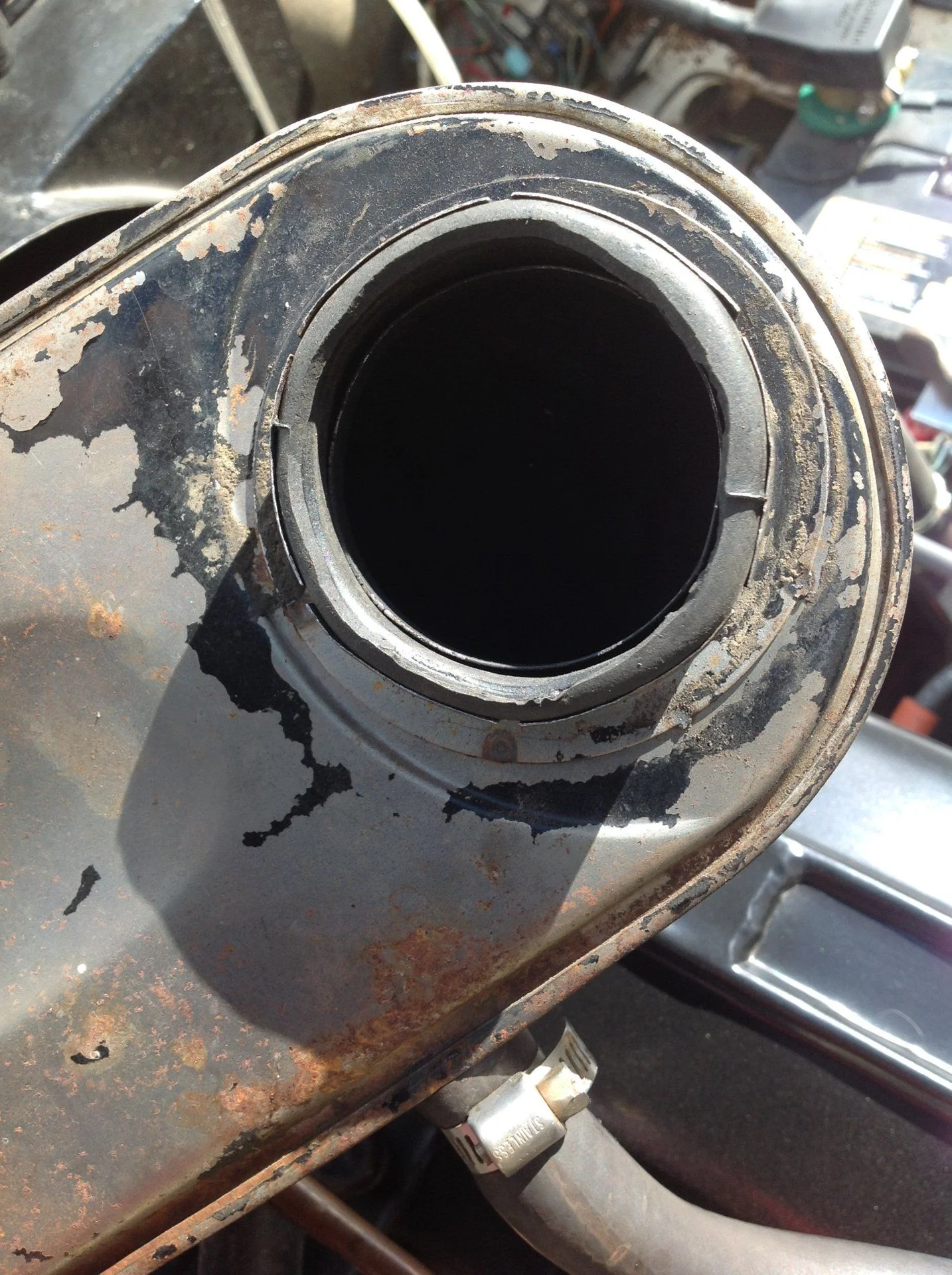

I just noticed that 097 does not have one. They are no where to be found so.....
I may have an option for us.

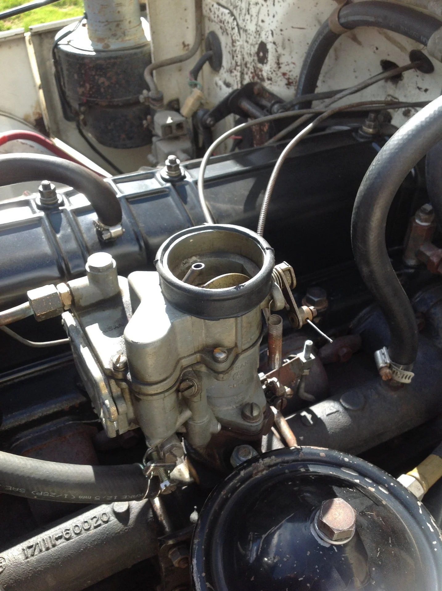

OK, here it is.... It fits almost perfectly... Needs to be trimmed...it's the same rubber thickness almost and it's only $5 bucks.
I'm going to trim tonight and see how it works....
Works great... Just need to trim a little..fits up inside the air cleaner, then over the carb just like the original NLA part.
It's a 1942 jeep single barrel carburetor gasket..for $5.

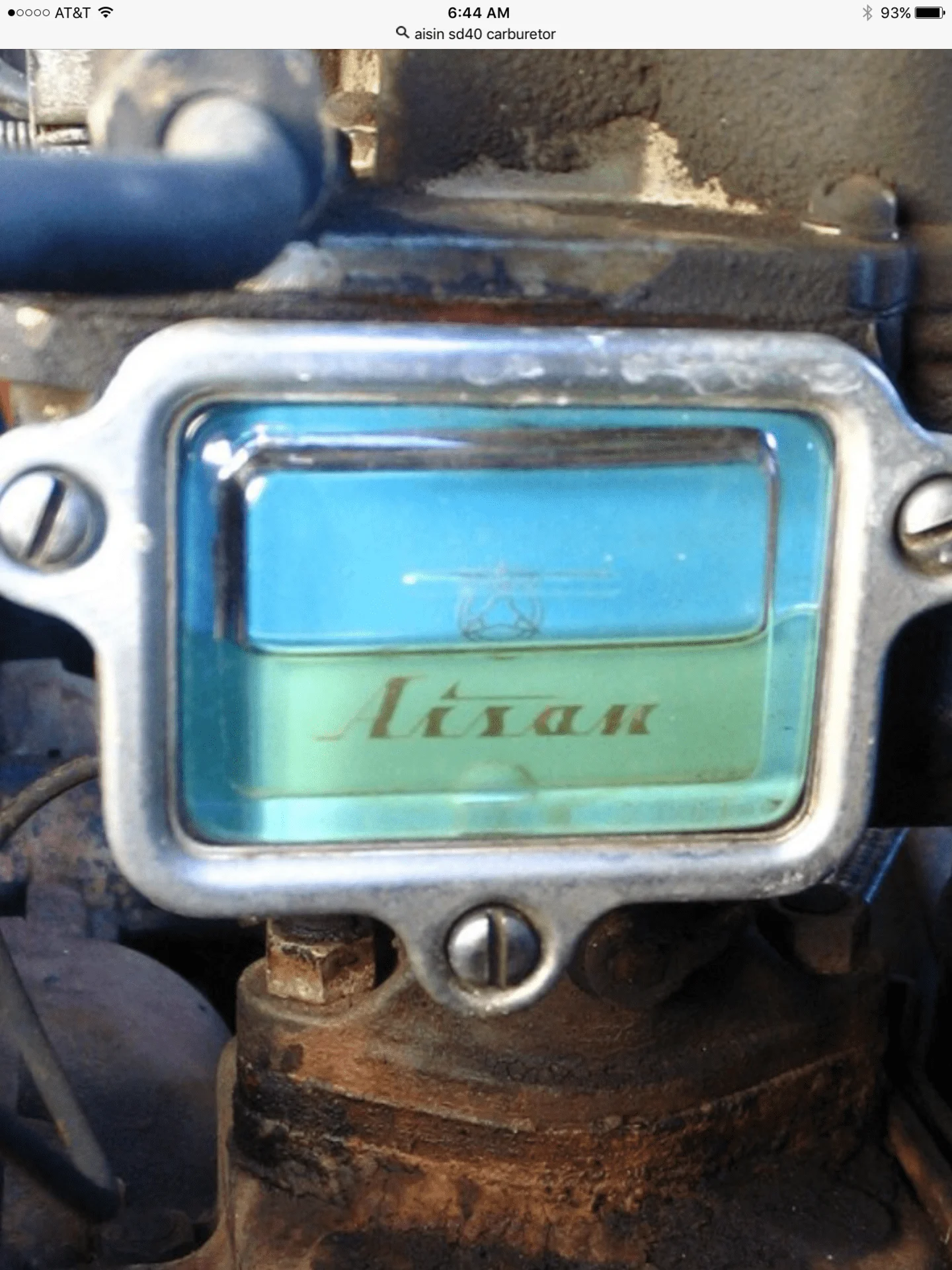

I wish, it's the only non functional part that I still have a yearning for. It really does complete the engine bay in my opinion.
Are you talking about the glass in the carb?
One of these two...they go behind the glass to help see the fuel level plus they look cool. Most tossed them after a carb rebuild.
