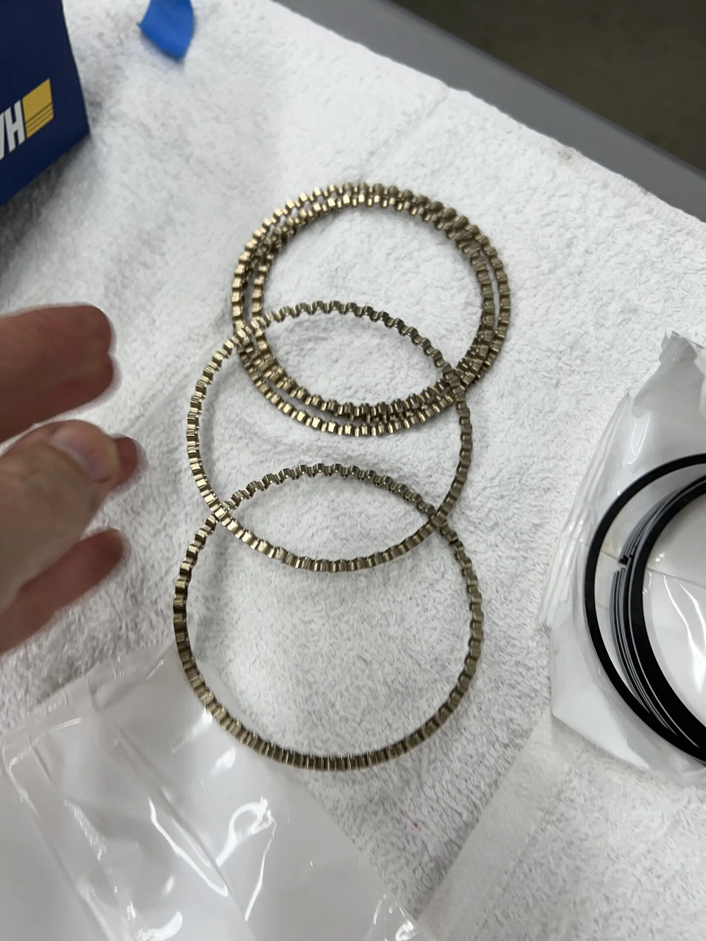

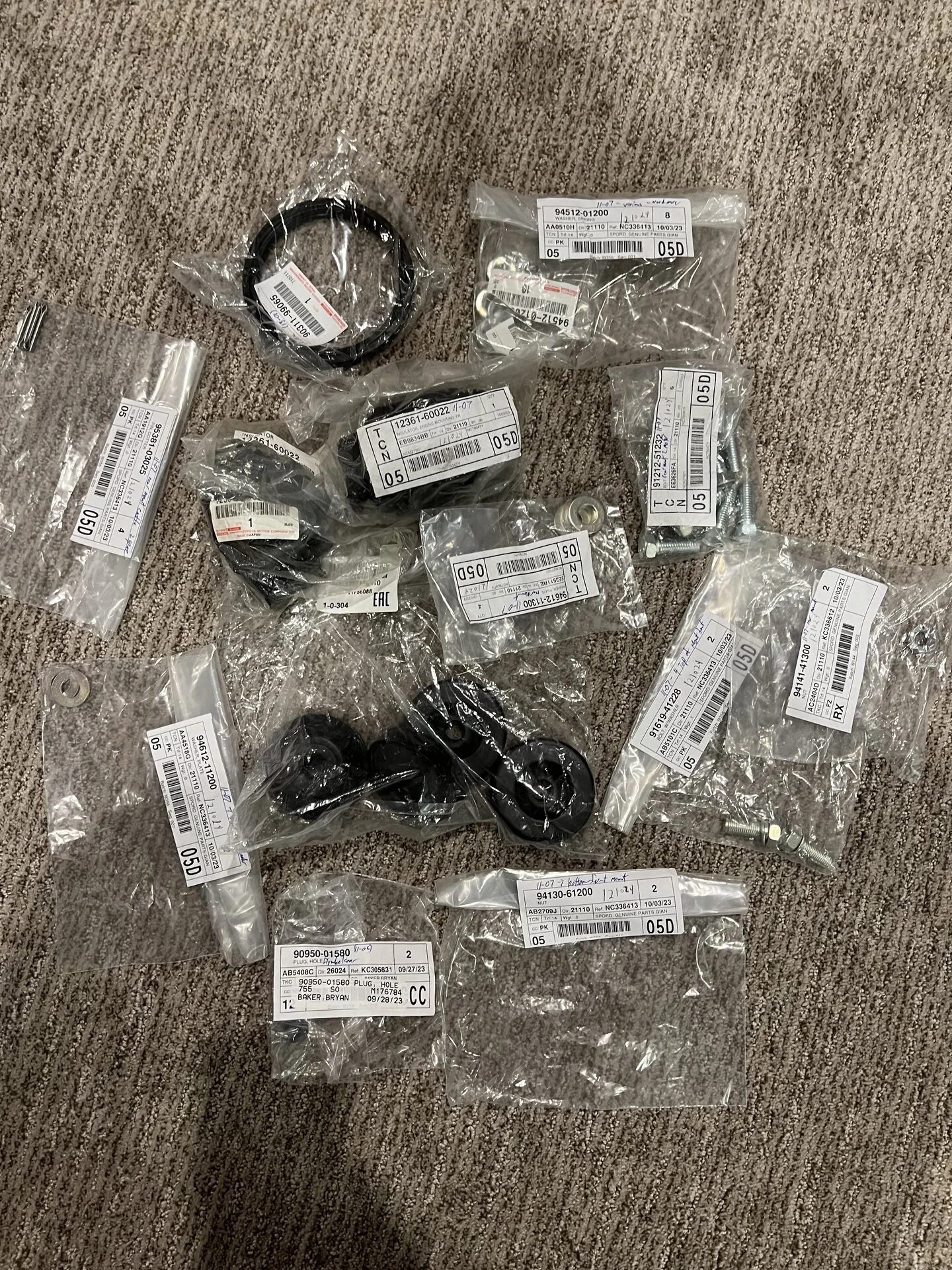

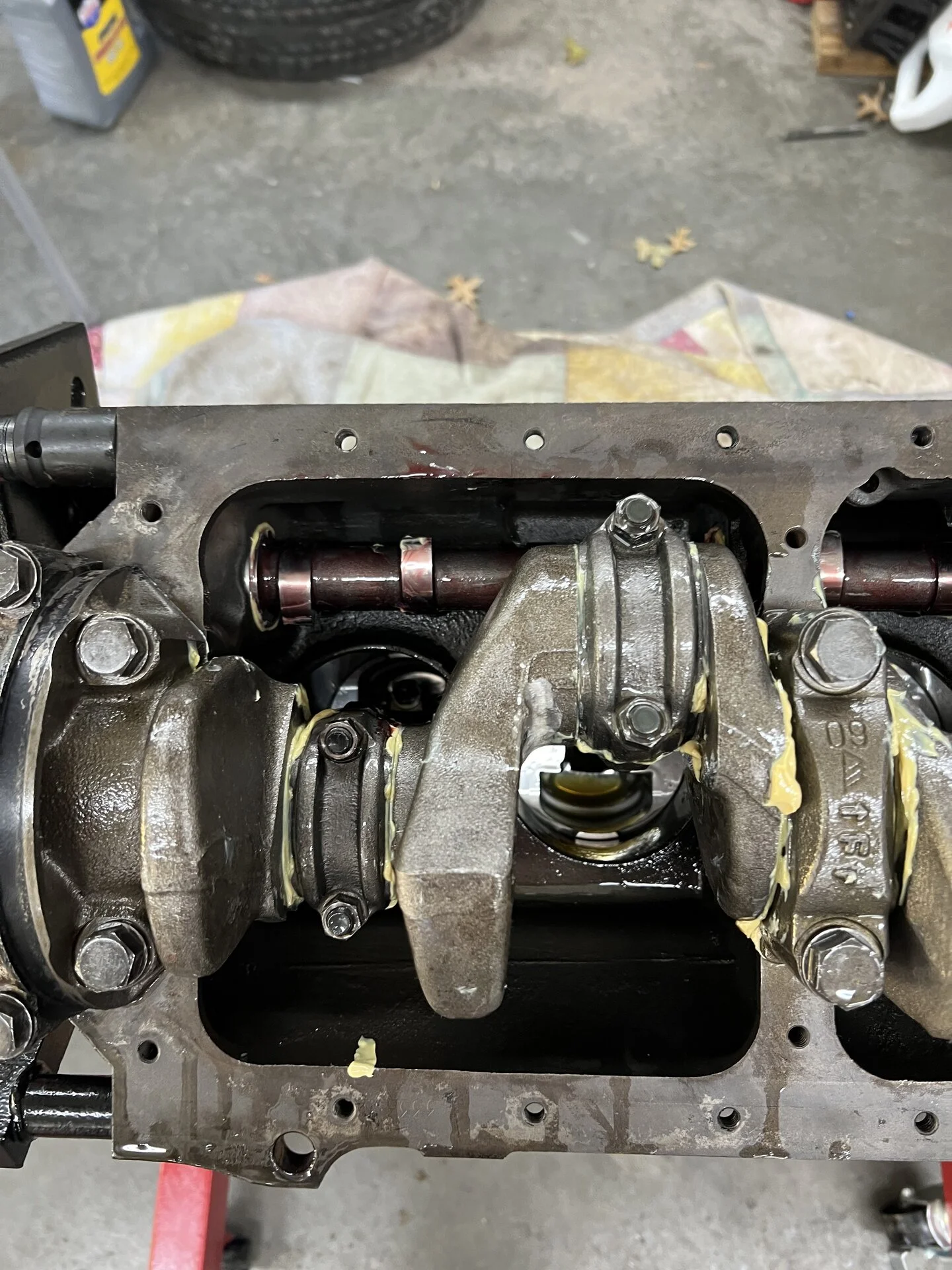

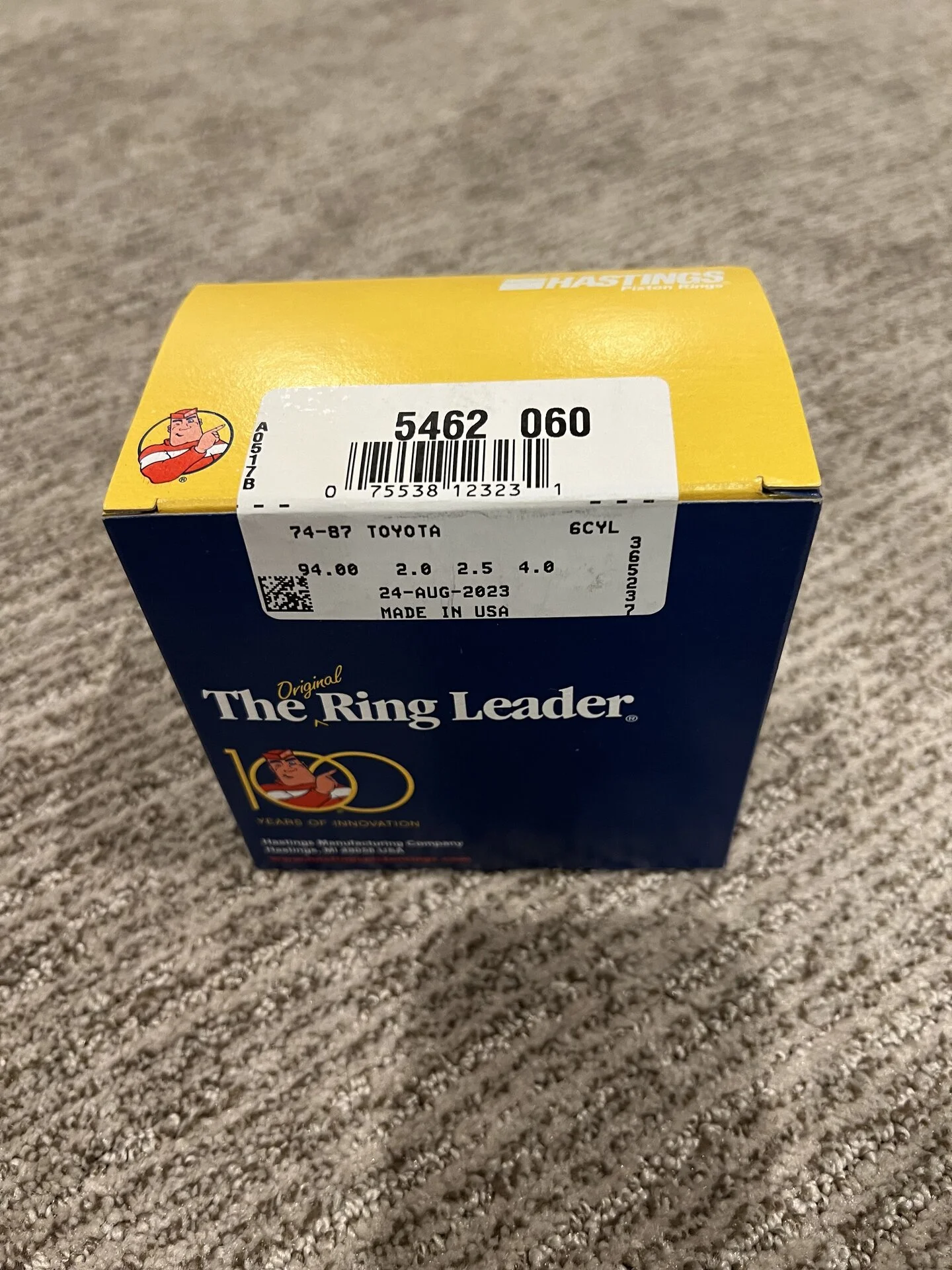

Well - 60 over rings have arrived - and decided to pull some threads and go all out with the motor mounts cuz I am really tired of removing and installing engines. I figure if I surrender my wallet to the FJ40 deities, I will receive favor.
Parts for the motor mounts.... and a main seal

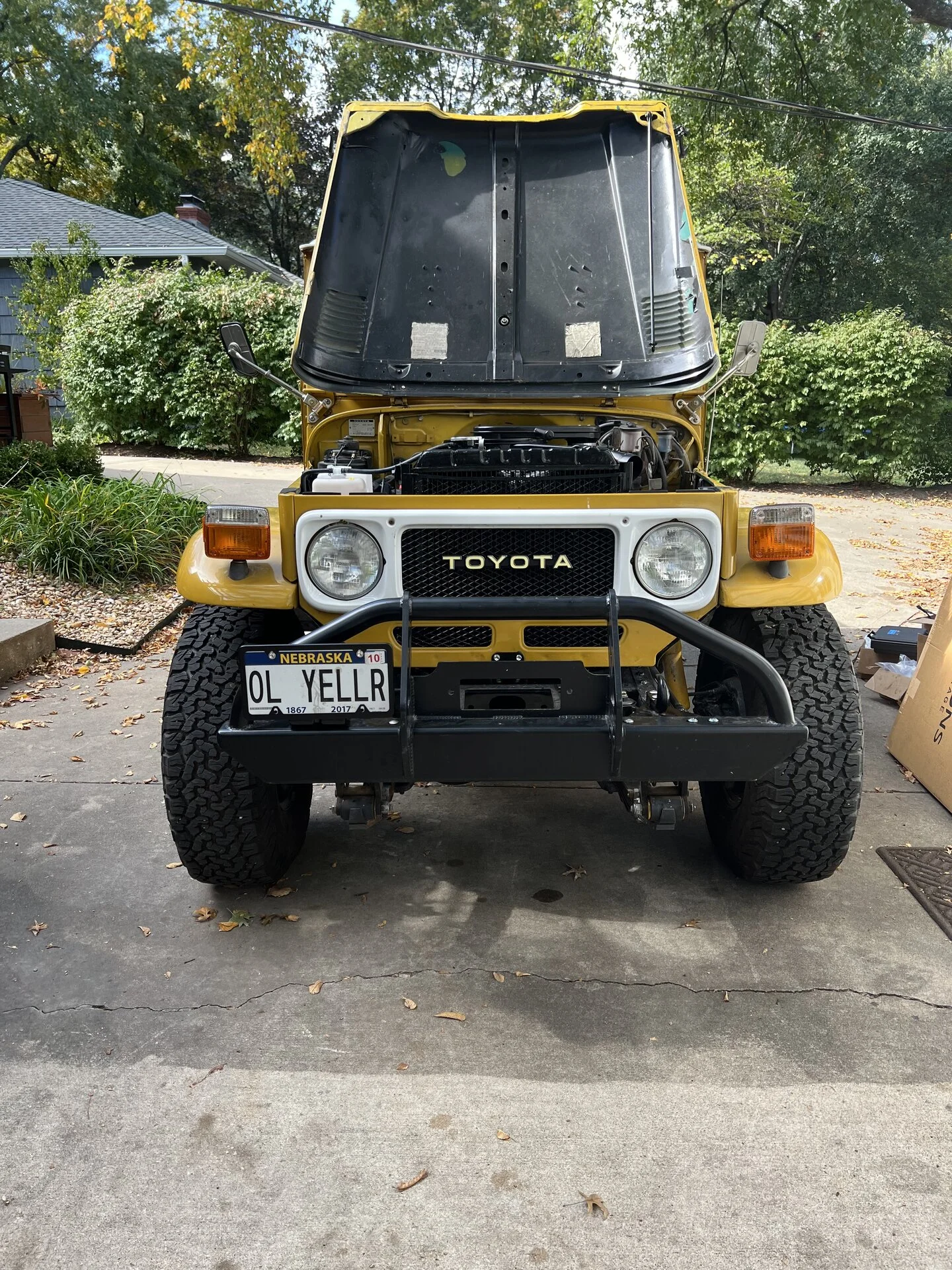

Got the 4Plus bumper on - OEM license plate holder (had to drill holes out wider to make it work -) adjusted clutch etc.

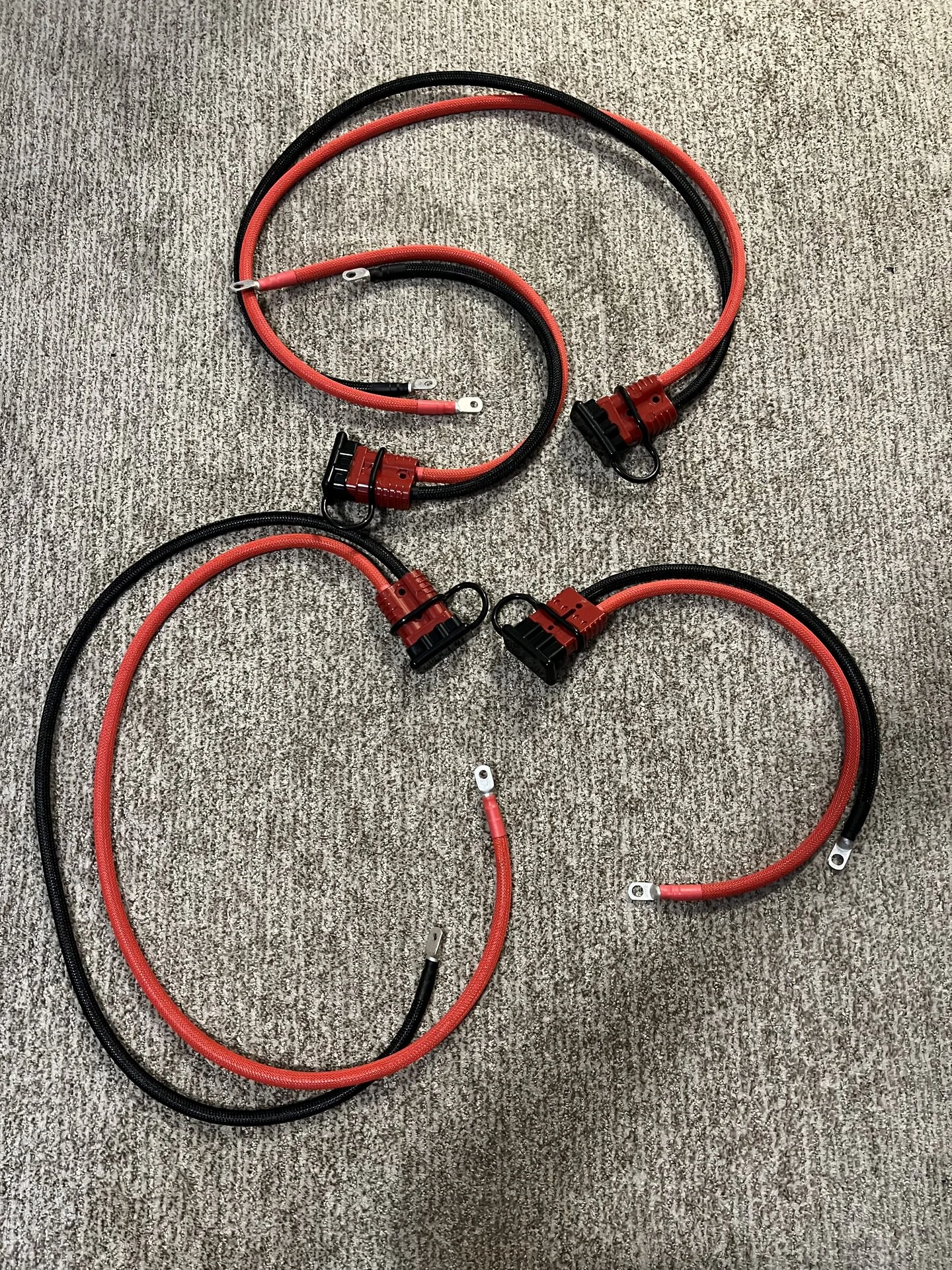

Lastly to @Fourrunner - my friend loved the gift of the quick connect winch cables you made! He wondered if there is a way to have jumper cables that would quick connect to that too. I am putting it here vs a pm as other people might have an opinion they want to express. (post 146 in this thread for a pict). I'd be interested, yet for me, I would want something I could roll-up compact(ish) to store in the rig. The cables you use are great, but I don't know I could coil as compact as I would like for hauling around cables - maybe they can. Some feedback I wanted to convey.
25 psi was a major improvement over the 35ish they were at.
Funny you mention the jumper cable. I have thought about that and will do a little more digging. It would be cool to be able to easily connect to a battery.
