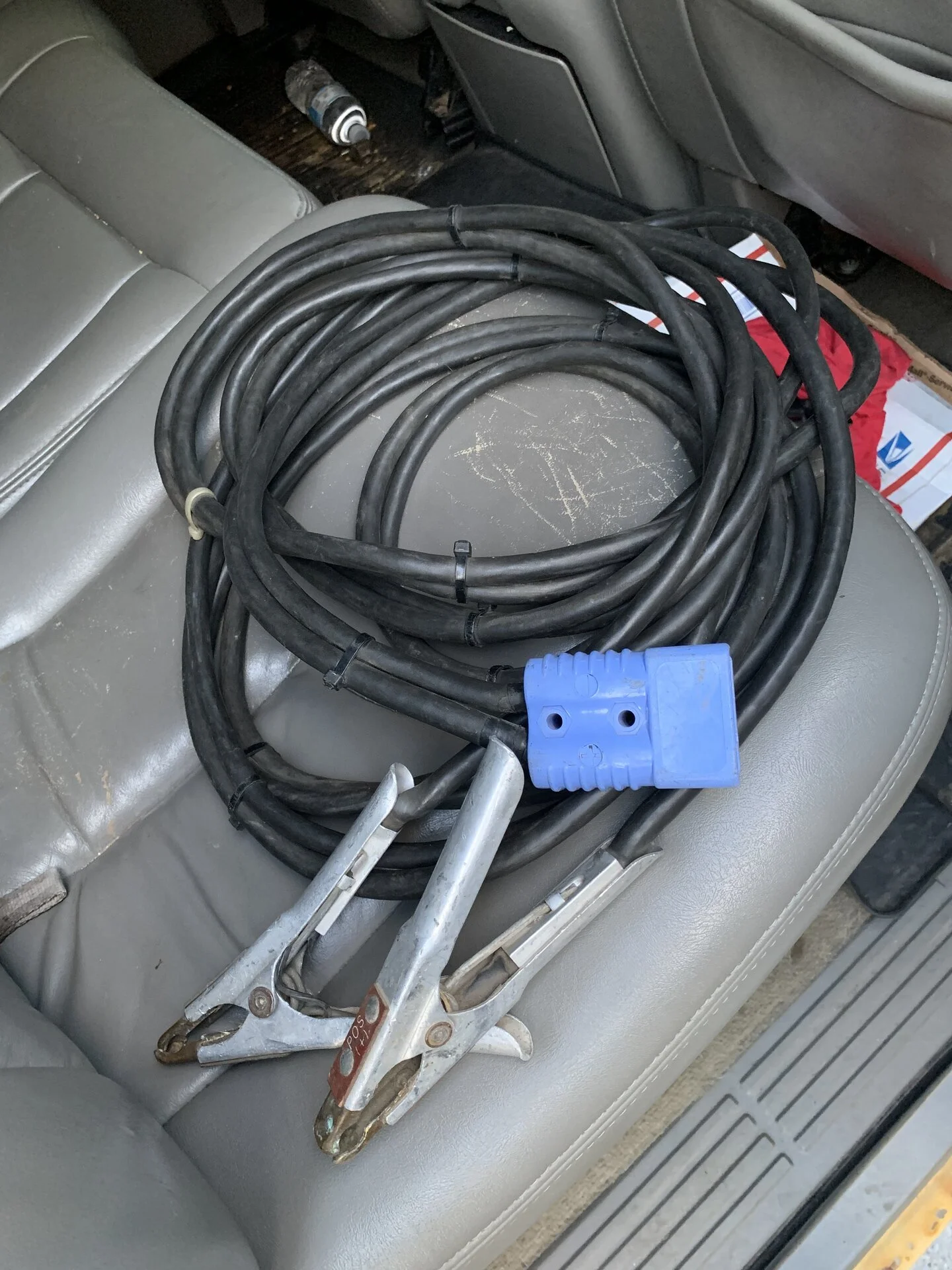

I have a set of jumper cables and they have a quick connect. Best thing I’ve done.
And no one can barrow them and not then not return them

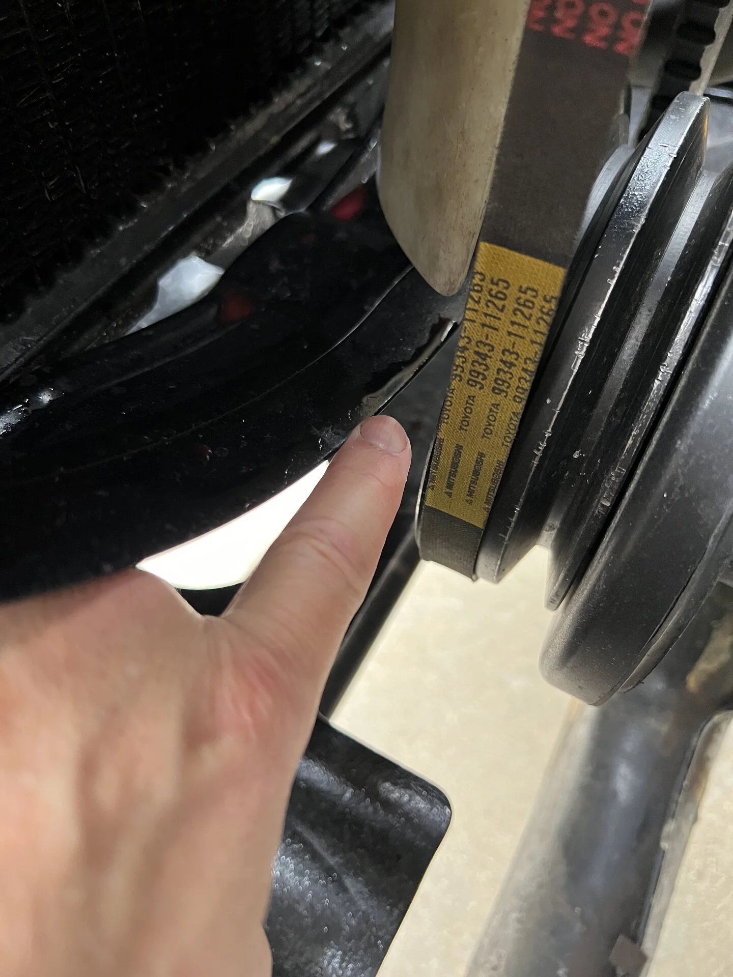

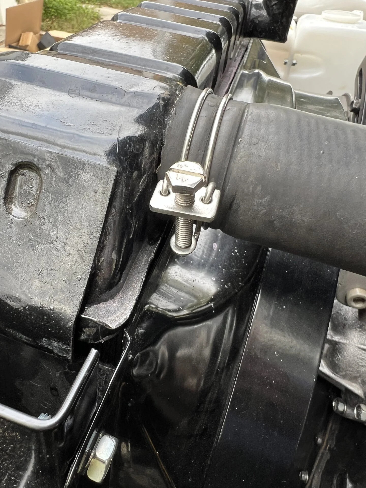

fixed a leak around the radiator- waiting for a gasket for another small leak. (Notice on the ground above)
wet inside fan shroud and was the underside of the hose to waterpump
And can see dark spot under clamp on left side (lip of radiator is wet)

Lastly to @Fourrunner - my friend loved the gift of the quick connect winch cables you made! He wondered if there is a way to have jumper cables that would quick connect to that too. I am putting it here vs a pm as other people might have an opinion they want to express. (post 146 in this thread for a pict). I'd be interested, yet for me, I would want something I could roll-up compact(ish) to store in the rig. The cables you use are great, but I don't know I could coil as compact as I would like for hauling around cables - maybe they can. Some feedback I wanted to convey.
How long of a jumper cable set would he be interested in? 20'?

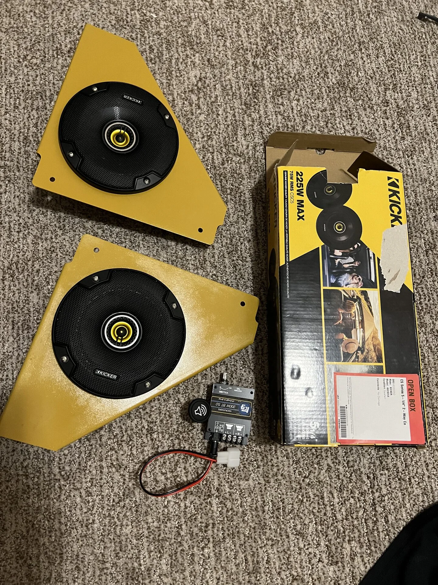

Also took time to get the bluetooth knob radio from @thecrazygreek has - Got speaker frames from SOR - rattle can - and some open box speakers
Going here
installed and looks like a knob - recap of previous post - go some parts from @Coolerman to replace the brittle connectors - got it in the existing radio circuit.
I use some double sides 3m sticky pads (that is a technical term) - not convinced on this setup yet and didn't want to drill holes unless I know permanent. Holds up well - and helps drown out some of the rattles.
And now to clean the inside more and tuck some of that cray cray in - clearly it is showing.

Spent time finding small leaks (some not so small) - hardest one to find was leaking coolant when the fan pull engaged. Oil leak behind the oil filter bracket. Gasket on order. Will do it when I do the oil change.

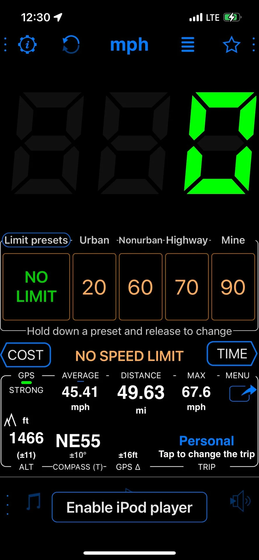

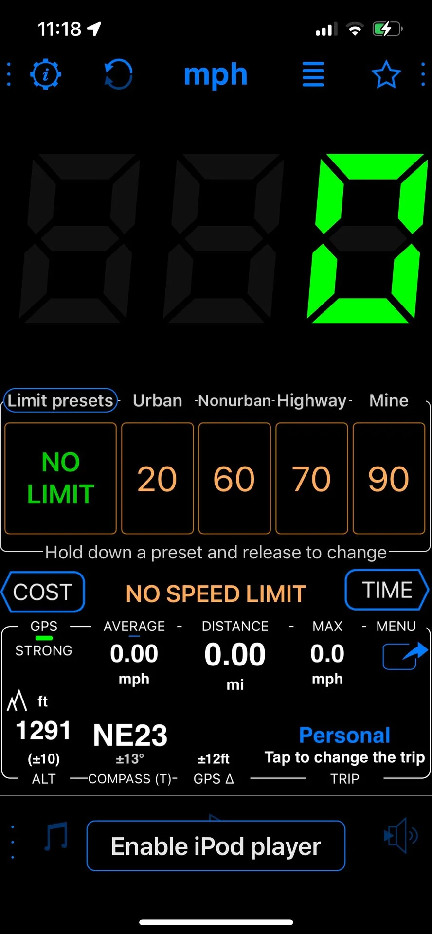

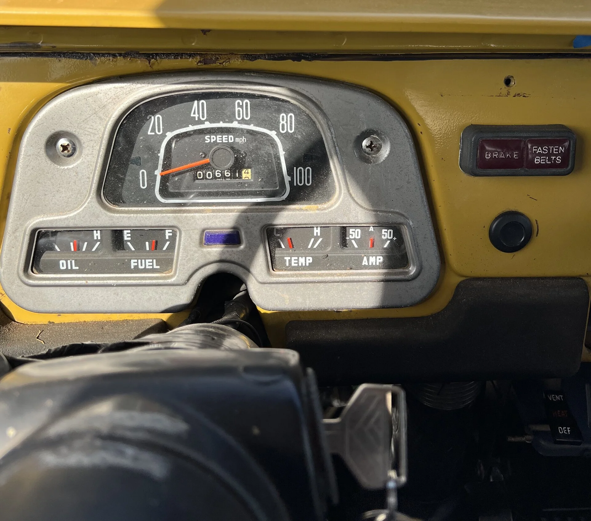

Another item - and tell me if my logic/steps are whacked AF... The speedometer under-reports reality (larger tires than stock etc). I've also been tracking MPG etc. Last night, over my second gin & tonic, it occurred if the speedometer is under, so is the odometer. So today was experiment day and travel to see family.
I used the phone GPS app that computes distance and speed. Baselined the odometer and reset the app to 0 distance and then recorded both when I stopped. Then computed a "conversion" factor to translate odometer reading to something more realistic to me. Did this several times and will continue to do so for a better long-term average. Then make is a spreadsheet I can just enter on phone when I fill-up.
Anyway - I am averaging 13.14 MPG vs 9.77 MPG before.
First of four experiment below - This one, I drove highway, then drove through downtown Lincoln (lots of stop lights) and back on highway.

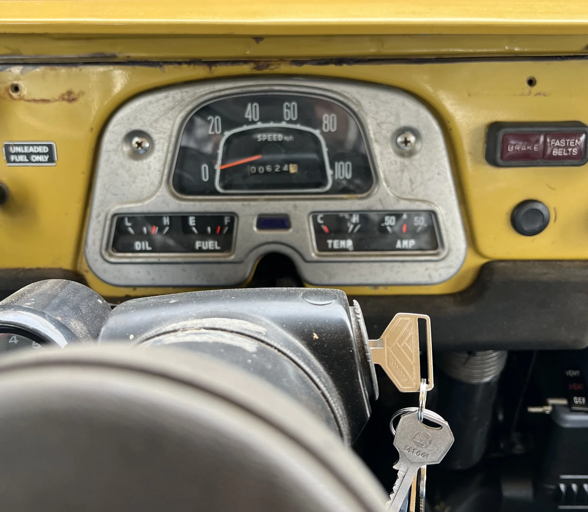

Odometer at start...
GPS App after resetting stats (Distance is 0.0)
Stop run 1, odometer...
App screenshot at end of drive...
Odometer is about 36.9 miles and GPS computed 49.63 - makes an impact computing MPG. Again, if there is a better way, I'd be curious, else going to collect more data for a longer-term average to apply to the calcs - and no, I don't want a Dakota Digital meter.
That’s a 35% difference, by my calculations, which seems high. I can’t remember how big your tires are. There are various threads talking about speedometer gear corrections, if you wanted to go that route.
Among others. Perhaps there are new options available?
I know this isn’t the most accurate way.. but at say 55 mph actual. I look at the Speedo, figure out roughly how many % off it is different than the actual. Then add that % to my miles driven.
So say actual Gps speed = 55, speedo shows 50, that’s roughly 10% difference. I drive 100 miles on the odometer, I add 10% to get 110 miles actual driven.
Just how I do it. It’s not 100%, but it’s close enough for my calculator
Thanks - will read/research into that. I used my phone to compare to my highlander and it matches within what I assume are reasonable tolerances. Another item to my list.
