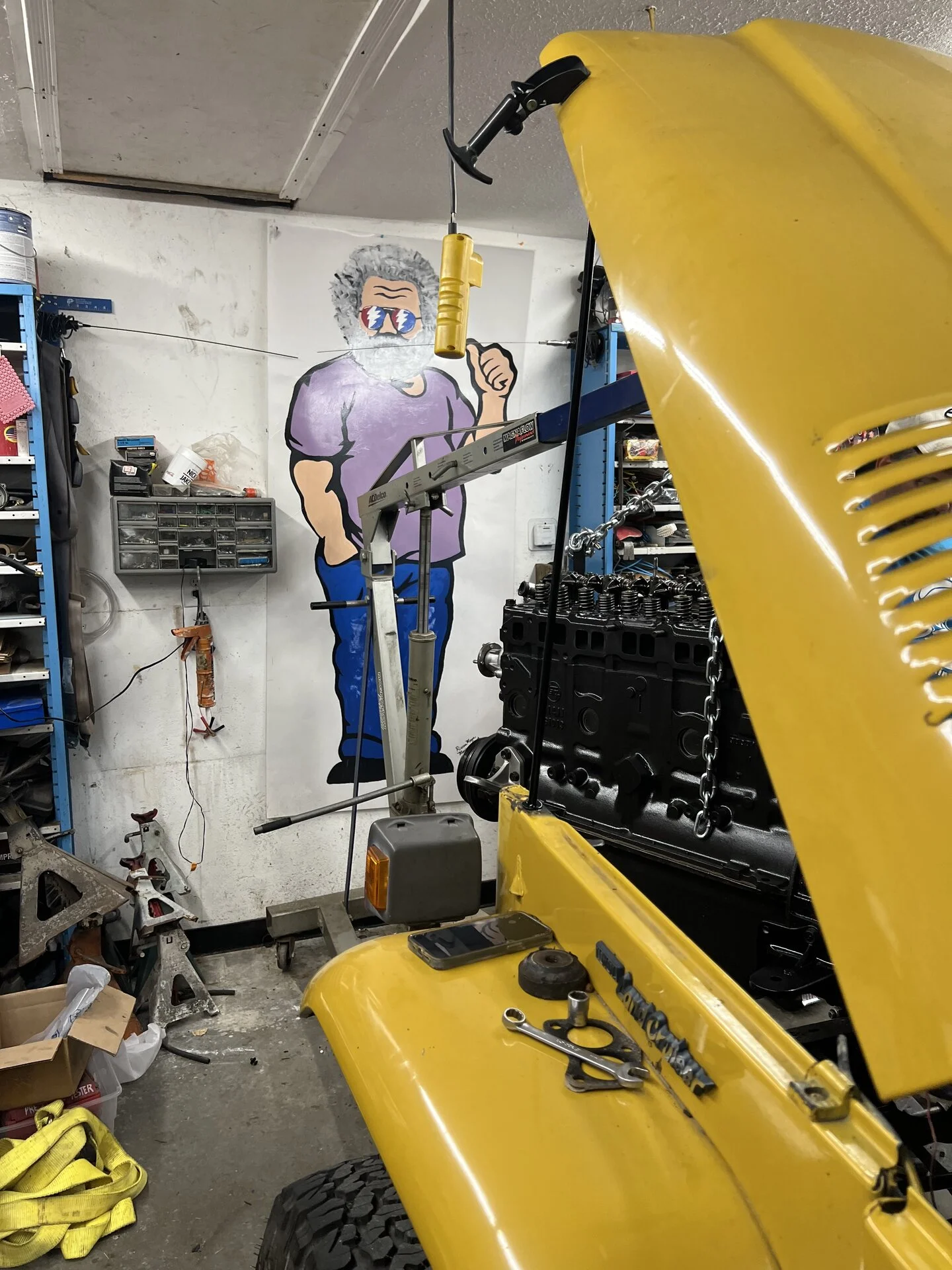

More bla bla later head on - and ready to remove it from engine stand.
Getting food first then will organize garage and get Yeller in of a stabbing.
Tired from the last two days, didn’t make it as far as we wanted, some stuff just takes a while.

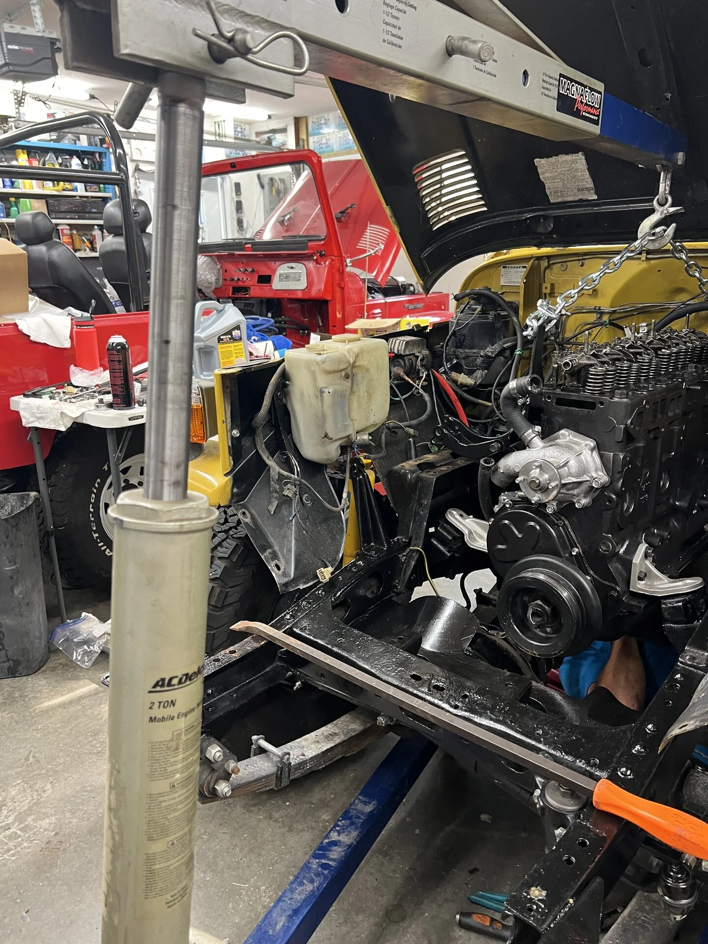

Engine is in, bib is mostly on, put the new grill badge on a few minutes ago drinking coffee.

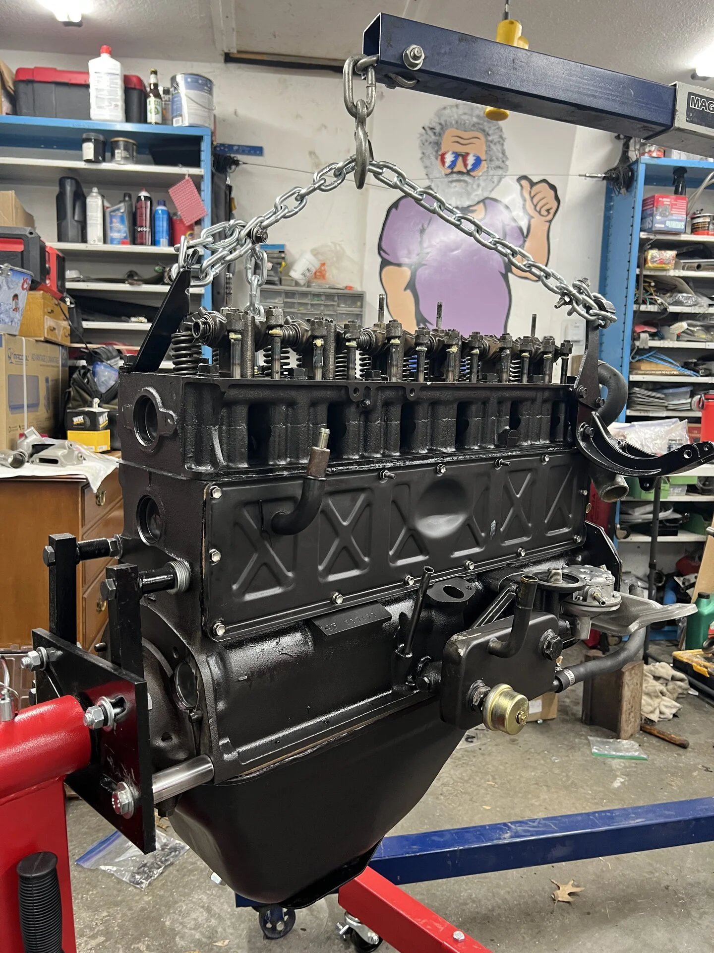

Oil added while on hoist. did the first valve adjustment on the engine stand before we installed the engine (soooo much easier on the back)
Oh yeah - did a leak-down test too before we installed the engine - and the results 80/94 = 85%. Way better than the 50% before.

Maybe come back and finish up on Sunday. It is close (and we were saying that a lot stabbing the engine in yesterday).

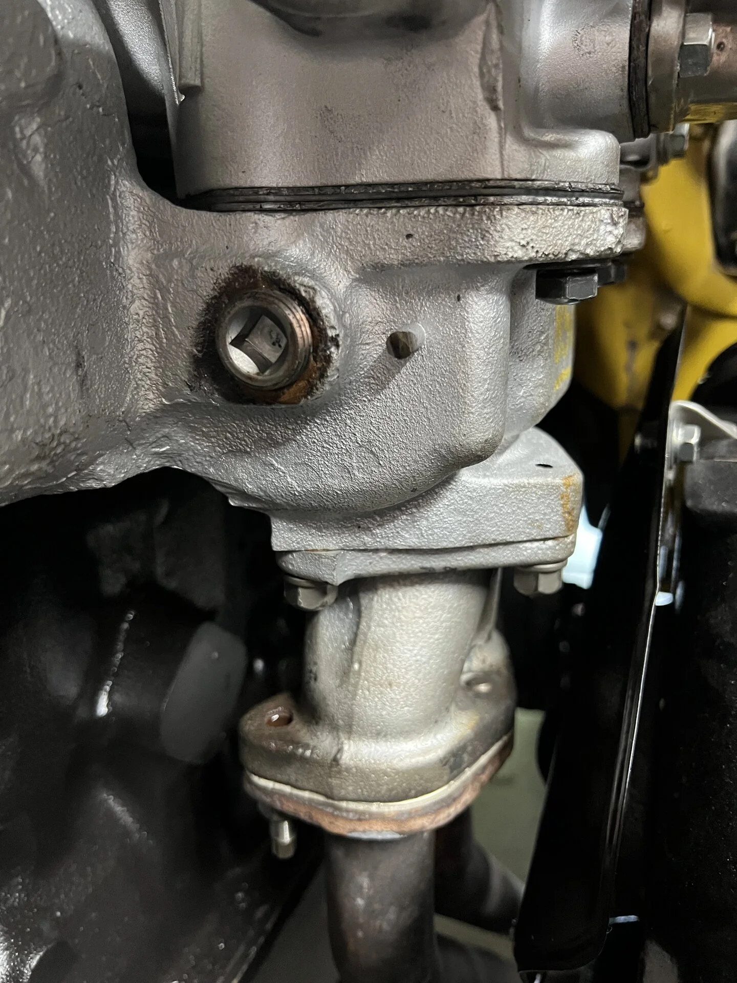

Here is the tap the machine shop put in the exhaust manifold. (last Pic) It was leaking where that dowel goes through for the heat riser parts. And there was a leak with the adaptor and the manifold - new OEM studs put in the adaptor and manifold (thread were bad after all the years) and OEM nuts. Thought I had one of the galley plug. Can't find an image.

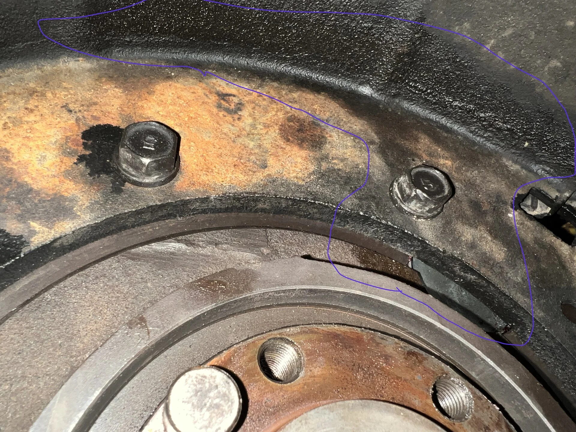

Took of the drive shafts off and dropped the tran & transfer. Looked at rear main seal - no evidence of any leak around RMS
swept it with a tool - no leak - kind of acted like the garter rolled -

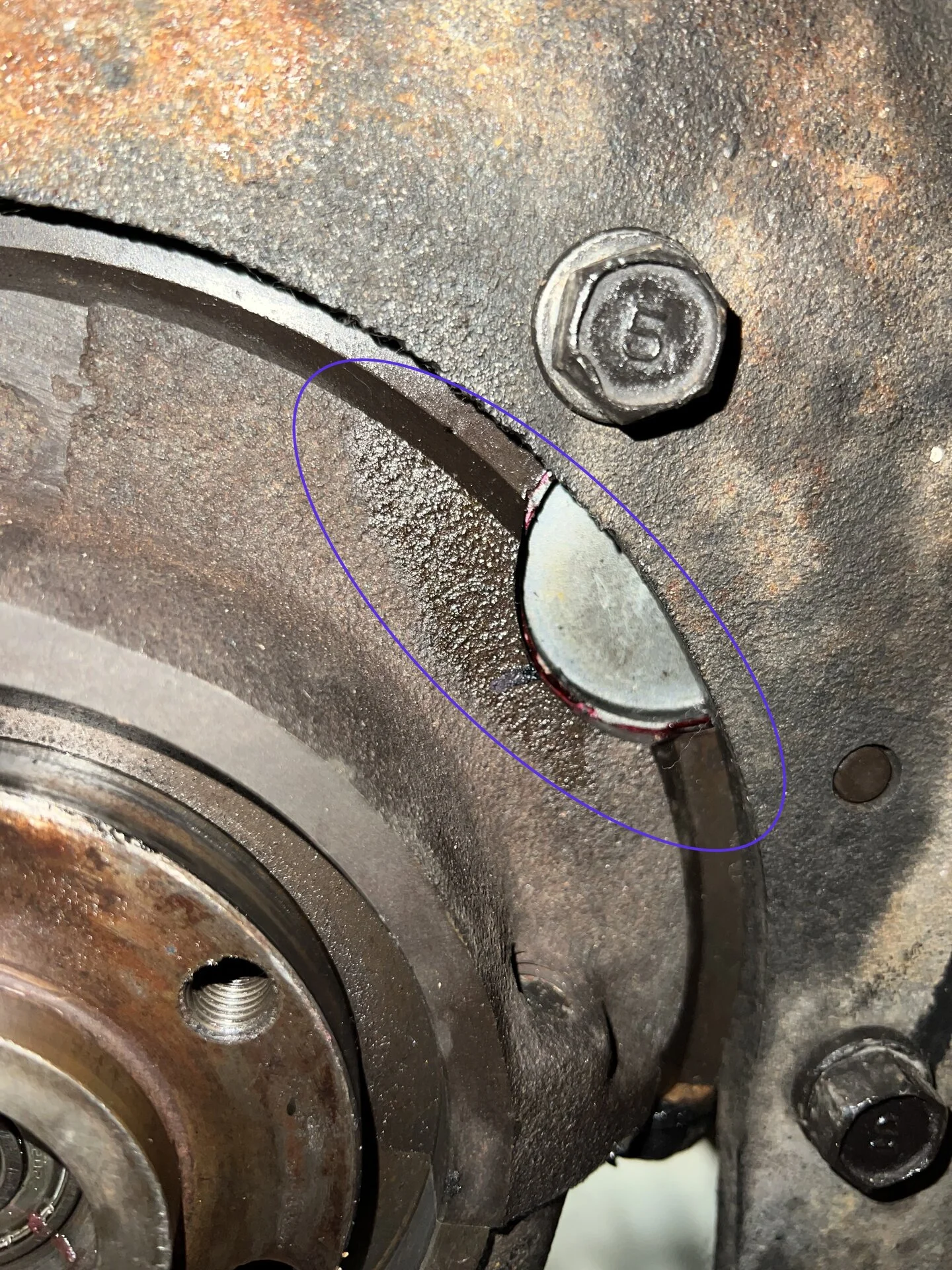

then looked at cam freeze plug - in the pict can see oil at by the plug and at the top of the bell housing circled in blue. Thought is oil hits the spinning fly wheel and why you see it on the top of the housing -
another shot
Took the bell housing off. Look at the oil above the plug - then nothing above that. it is all dry above the oil splatter so nothing from above going below. Blue circle oil - everything else was dry.
argh.
