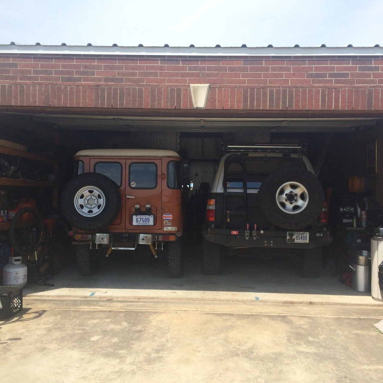

I have been doing my swap in an average sizedaily 2 car garage, I can't wait to see what it's like working on a 40 in there.

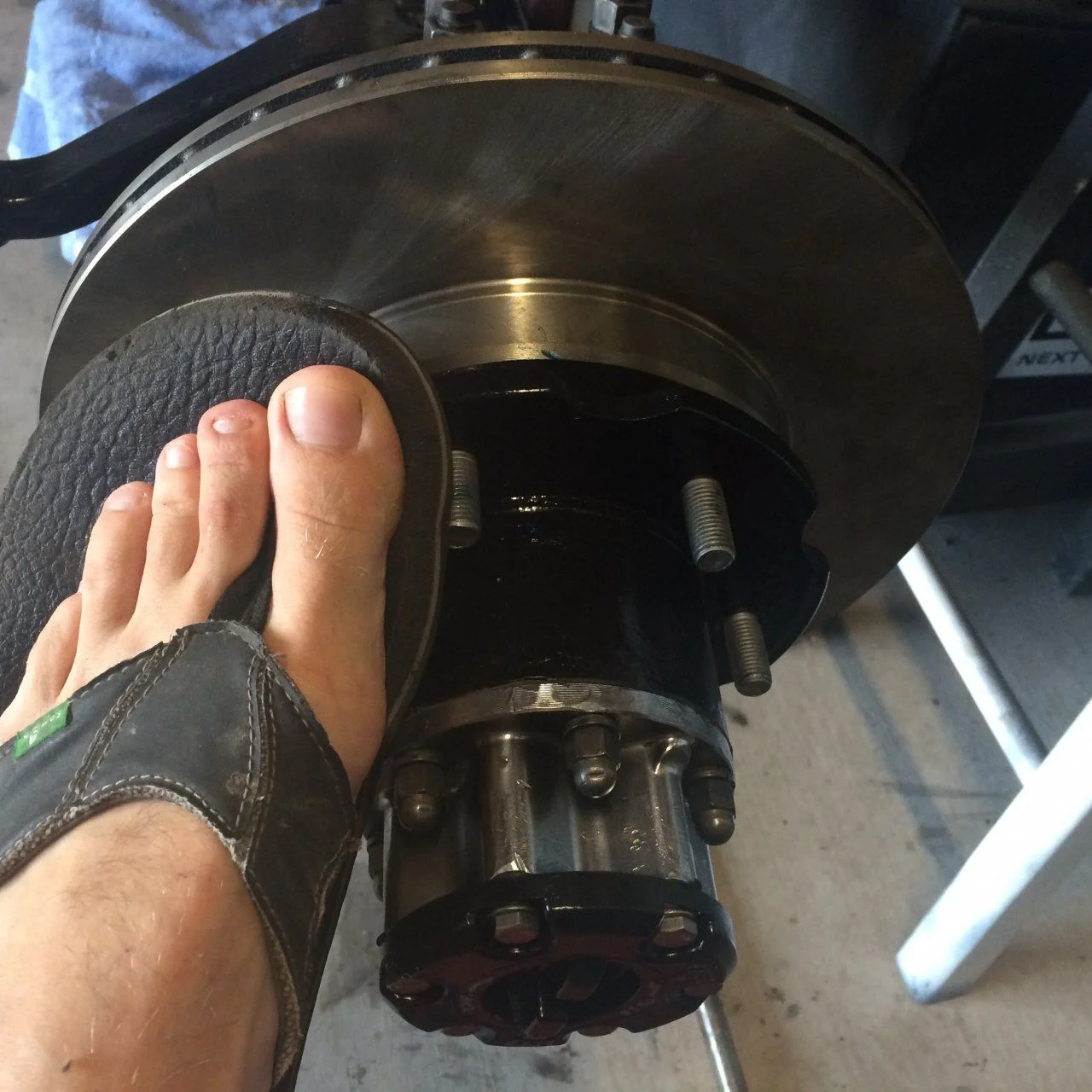

Today I decided to finish the disc brake front axle that will be swapped in. It had been left unattended since I smashed my toe with the birf. I do still need to find a brake booster and replace the master before it goes underneath. Finished it wearing the same pair of flip flops.:)
Both Land Cruisers put away for the next week due to work out of town. I still need to do some more garage rearranging to make some more space.

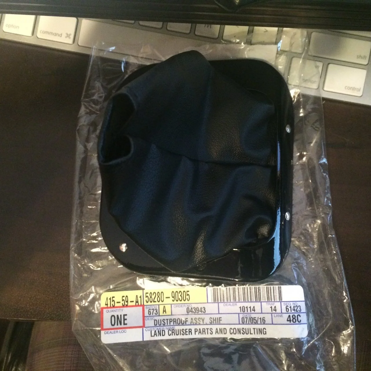

Trasmission and transfer case shifter boots. Both are presently ripped and not connected to the floor.

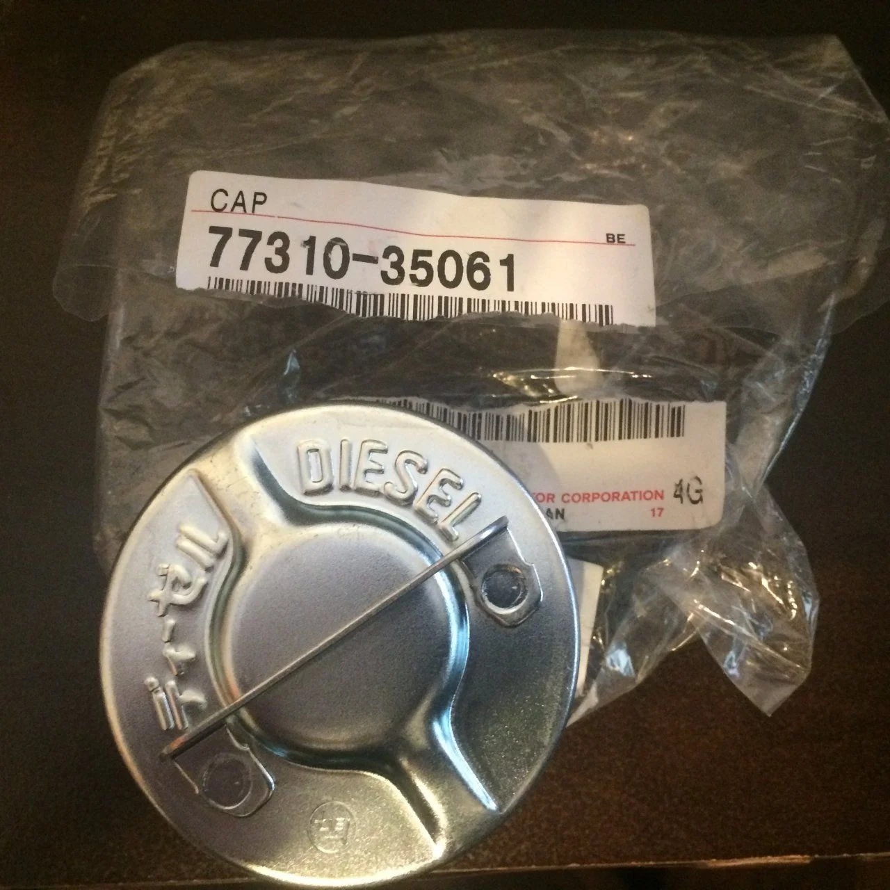

Diesel fuel cap. This will replace the aftermarket keyed version that came with the 40. I don't see the need to use two keys just to refuel. Maybe in Costa Rica they have a problem with fuel theft?

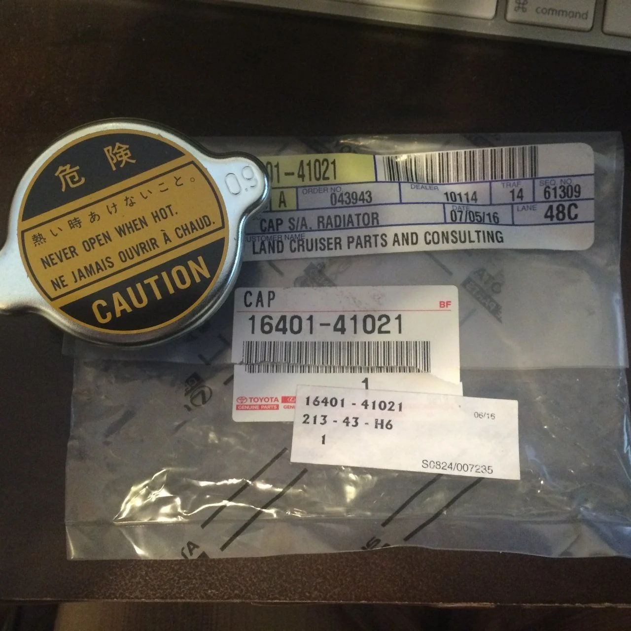

Radiator cap. Also will replace an after market one of unknown age.

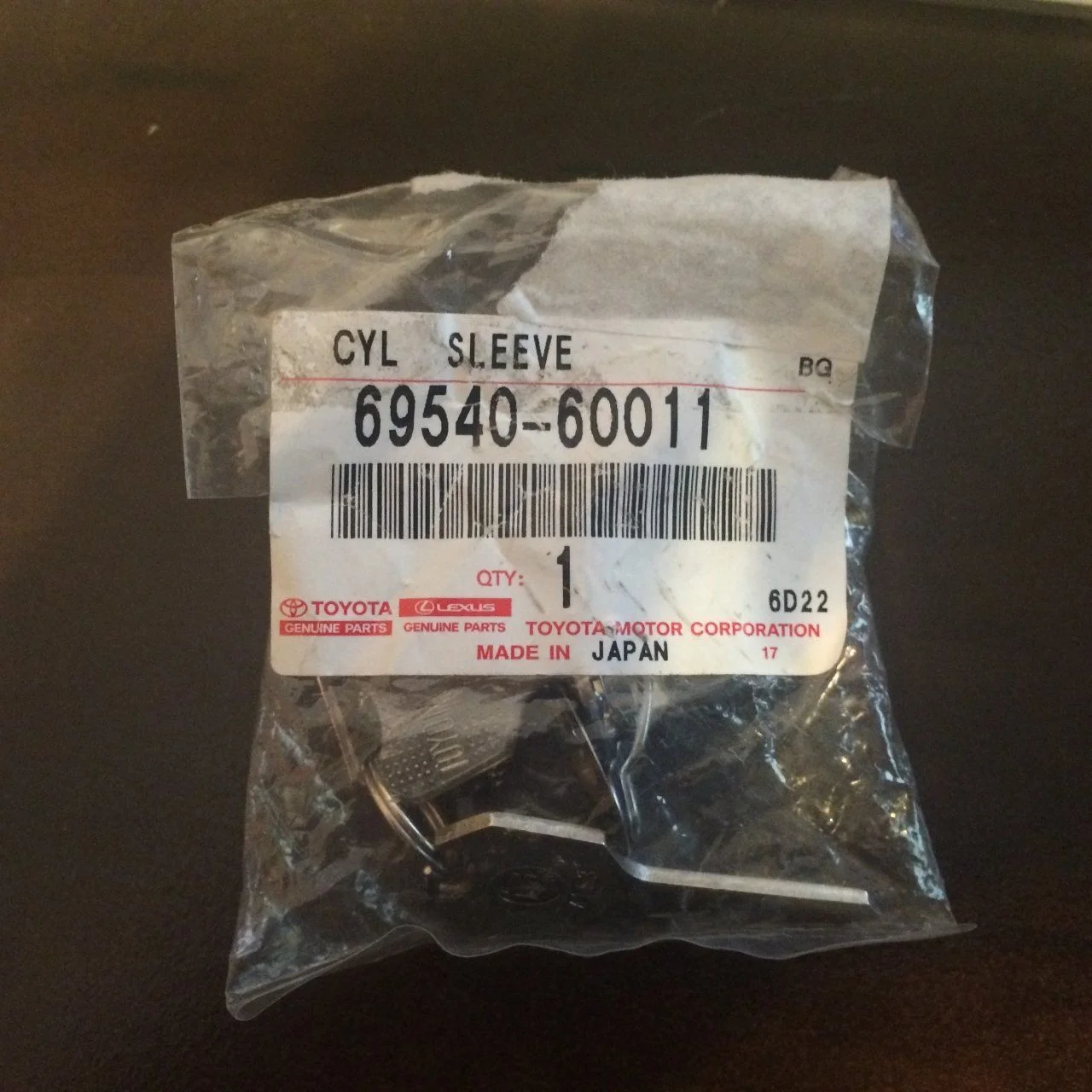

Rear door lock cylinder. This was missing when purchased.

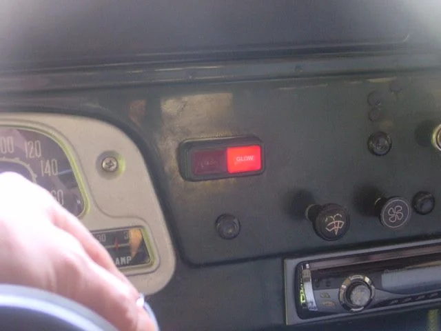

I also tried to figure out if my glow plugs work since the indicator doesn't glow but the relay clicks. However it does get hot because I burned my fingers when I reached up to remove it. Maybe not getting hot enough to glow red?
Depends on the glow plugs. If they are "new" energy saving plugs they'll draw not enough amps to make the controller glow.
The original 1970 plugs (8.5V) draw 10 Amp each, so 40 Amps in total.
The new plugs I bought were "energy savers" (8 Amp each) but worked fine. Total draw is 32 Amps which is not enough for the controller to lit up.

I should have wrote down the part number on the plug when I removed one to see how it looked. Need to go back and do that. I did confirm it was a 8.5v plug.

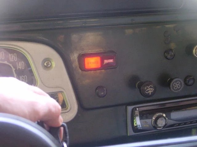

Do you know if the indicator used in forklifts works the same way with the 40amp draw? I would like the indicator to work at least when the wife drives.
Don't know, but should be the same system.
I used a little light in the empty socket next to the parking light.
I used a 12V bulb and hooked it up to the glow bar (8.5V) so it shows that the glow plugs are working.
And, Yes, I'm a control freak.
Rudi
