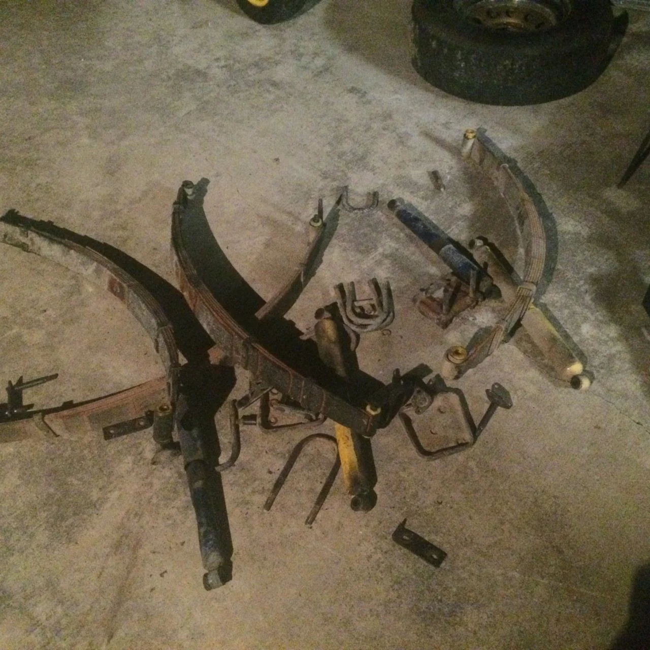

Yesterday I swapped suspension which took me about five hours. I am pretty sore this morning as I haven't had a solid session like that in awhile. All bolts came out easily and I could tell the spring bushings had been replaced multiple times before. There were three different colors. I managed to take off three corners of u bolts before I got smart and broke out the grinder to cut off the last two. It was too late when I stopped to get any good photos so I'll snap some today. Only one I took was the pile of old parts at the end.
I forget, did you go with the Terrain Tamer 2.5" suspension?
I have the TT 50mm HD lift which is close to a 2" lift. Looking at it last night it seemed to only net me a little over an inch. I used OME shackles and don't know how they compare to the TT equivalent. The 255/85s fit nicely in wheel wells but I need to see if they will bonk the fenders before the axle hits the bump stops. Which reminds me I still need to cut off the excess U-bolt since they are pointing up now with the U-bolt flip kit that was installed.

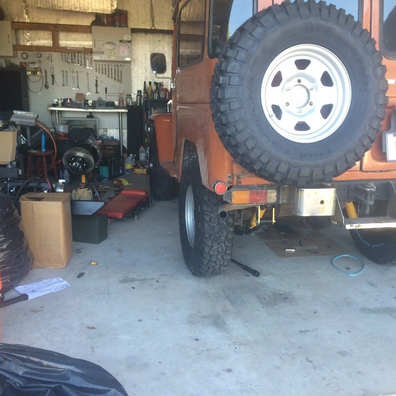

The best I can do this morning. Too much crap behind it to back it out. If I was smart I would have wrote down the before measurement. I only put it in the mental library which failed me when I tried to remember the number after install.

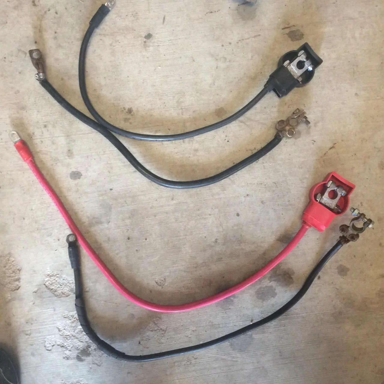

I bit more progress this afternoon. I made some new battery cables with new terminals with some scrap cable we had at work. I am going to shorten the negative cable a bit. The old cables has seen better days.

When I pulled the truck out of the garage it had a lean to it. The passenger side is higher than the other side. Maybe the new springs need to settle in?
