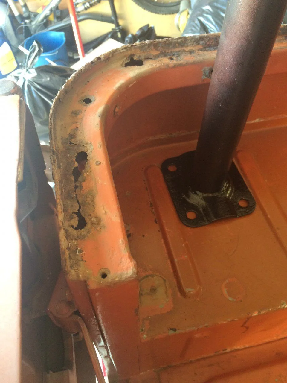

The wife and I took off the top today. Broke one bolt in the process and uncovered some rust also. Nothing that I wasn't expecting coming from Costa Rica. Odd are being garage kept with soft top plans it will never get the hard top back on. Tomorrow I will bolt in the roll bar.
This was the worst of the rust. Some on the other side and some on the bottom of the windshield. Maybe a nice winter project

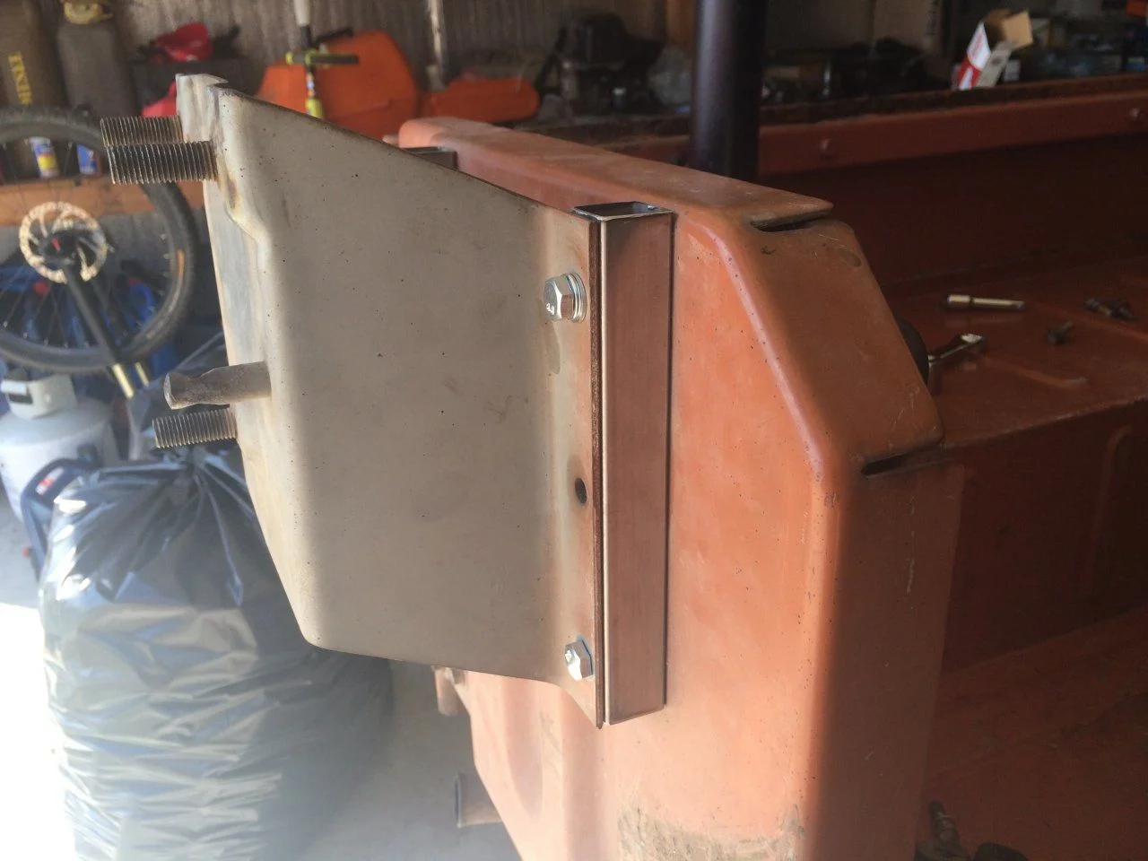

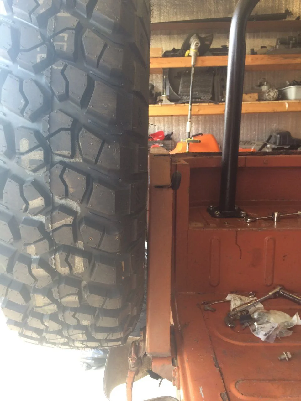

Today I made a spacer out of square tubing so my spare would fit the tire carrier. Pretty simple project. Now just waiting on the paint to dry to install.
The 1" spacer worked perfectly. You can barely see light between the tire and carrier.

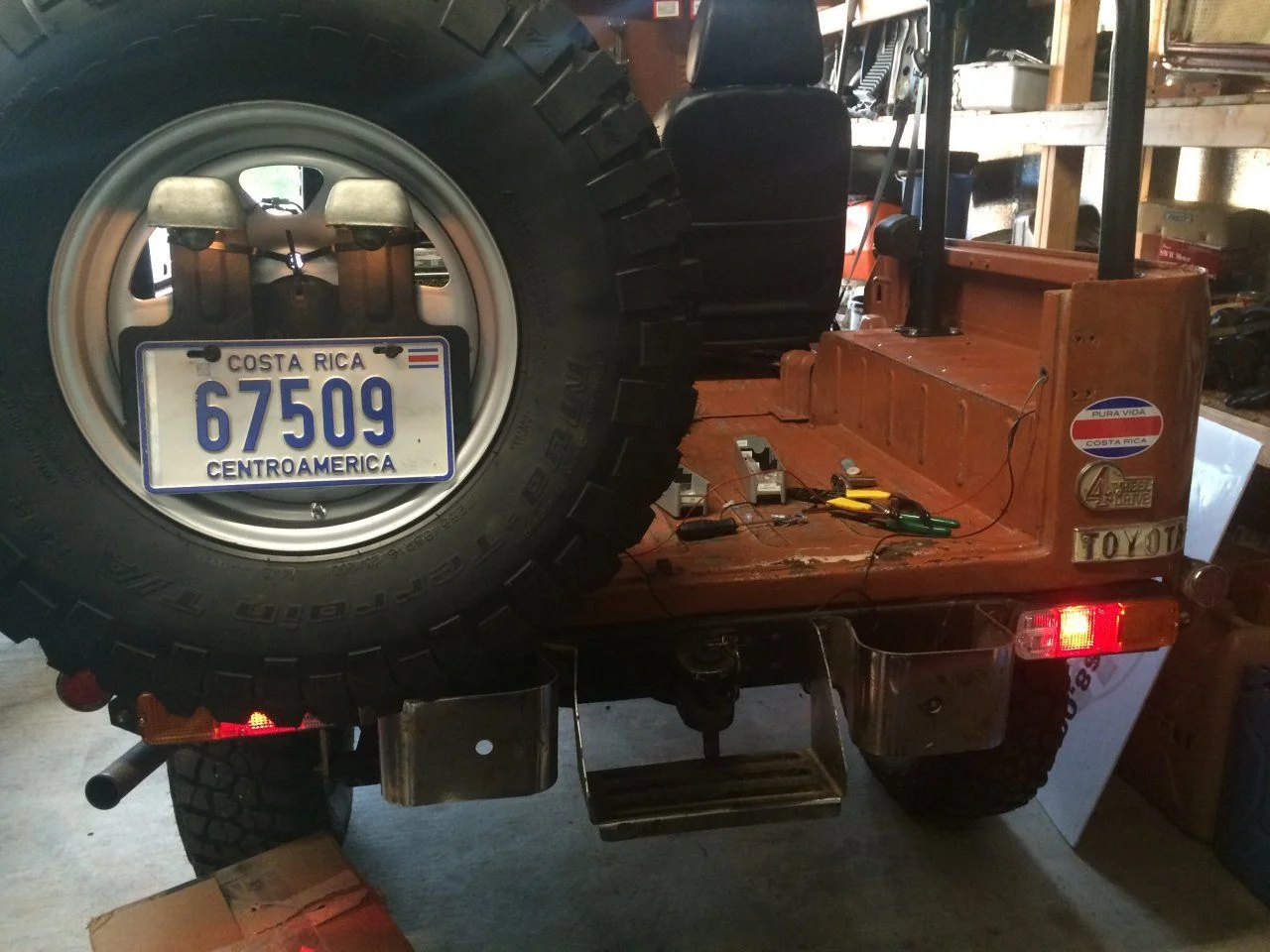

Tomorrow I will also attemp inspection which should be a breeze since diesels and old cars are safety only. I did have to ghetto fab my license plate holder/light to the spare tire with some zip ties since I don't have a tailgate yet.

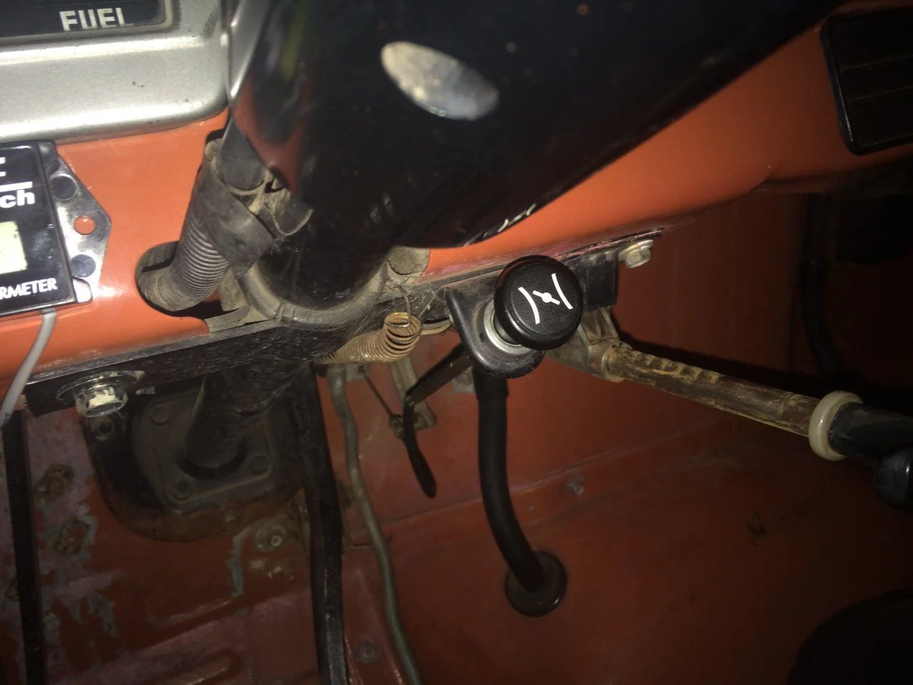

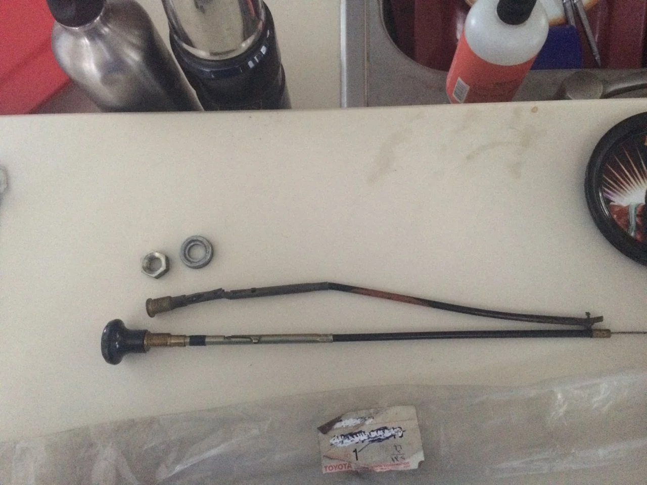

I got my NOS hand throttle in today which I ordered from @Racer65. It's a discontinued part and I was having a hard time even finding a used one but found it on his site while looking at his brake boosters. Luckily I threw the remnants of mine on the garage floor and not the trash because I needed the nut and washer thingy off it. It was a perfect match.
And a few of it installed.

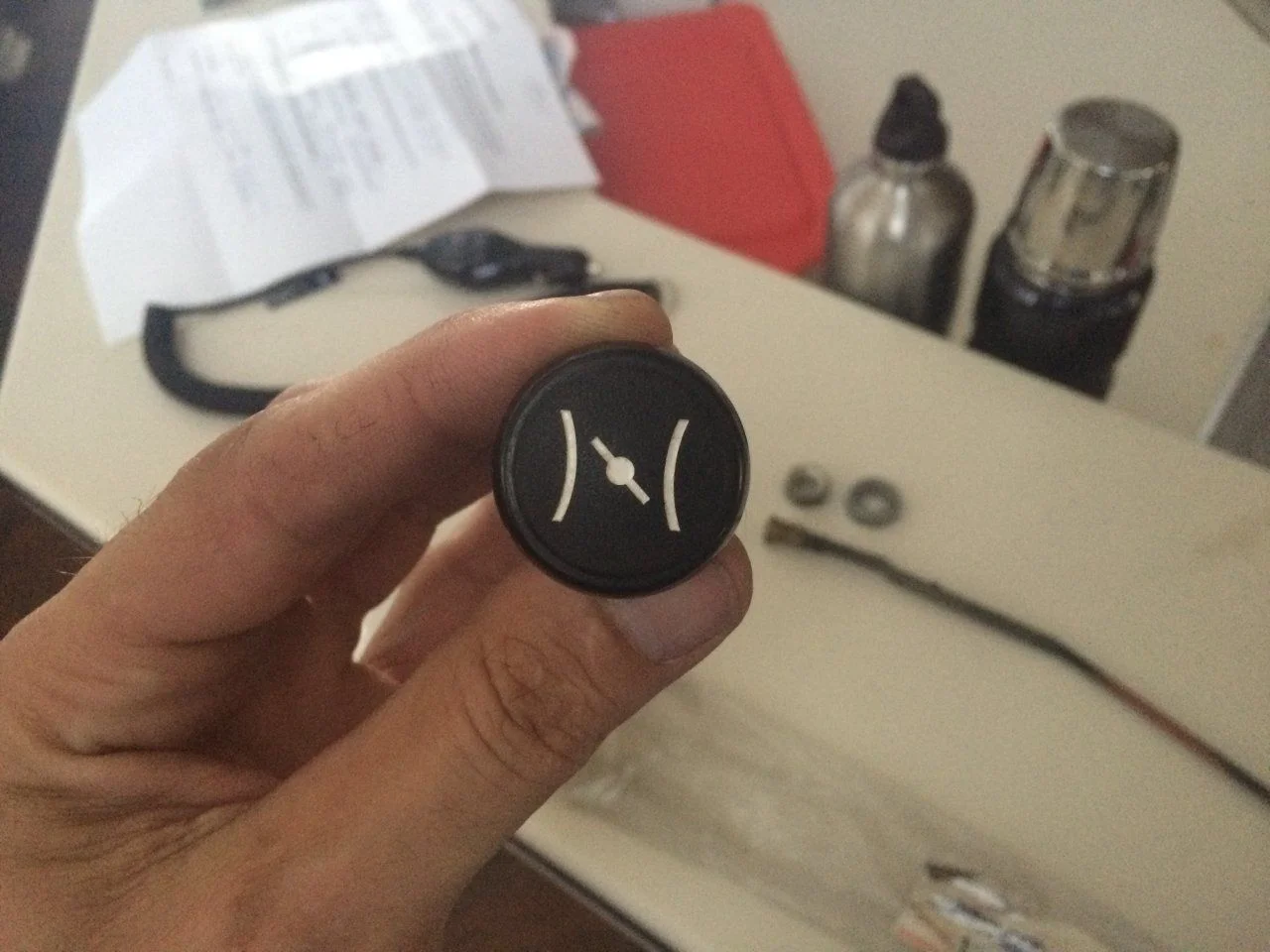

I don't think I have posted this next photo of the Costa Rican theft deterrent. I assume you put a lock on it so a thief can only drive straight?
Classic piece of engineering to say the least...
FWIW-I did the same thing on my '72 tire carrier to fit a 33x12.5x15 BFG on 15x8 wheel on the stock carrier. I need to go back one day and raise the tire mount up a little since it blocks the latch on the early type right side carrier.
