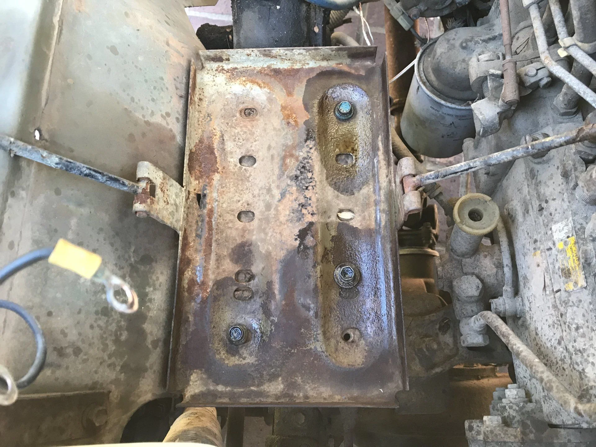

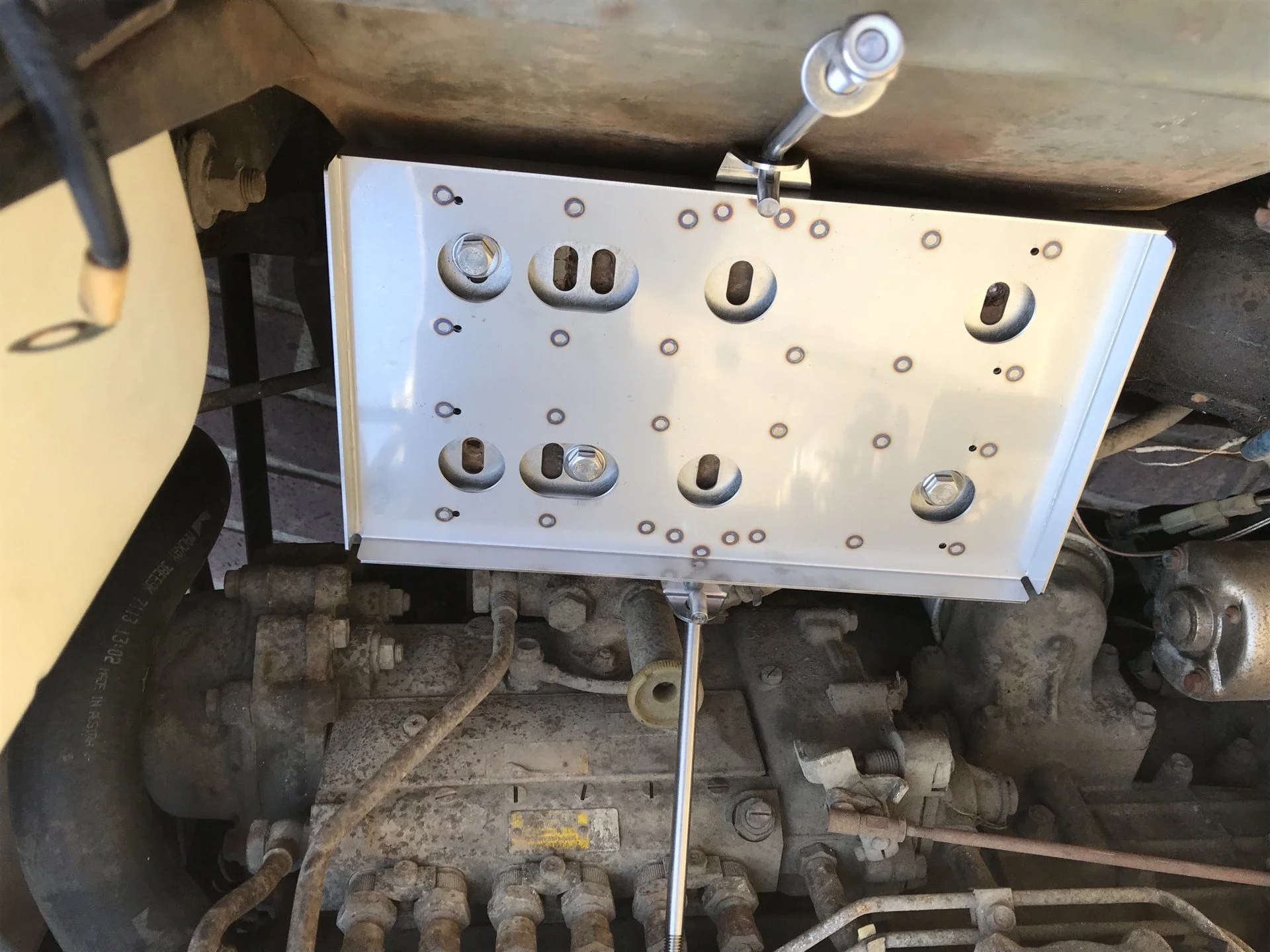

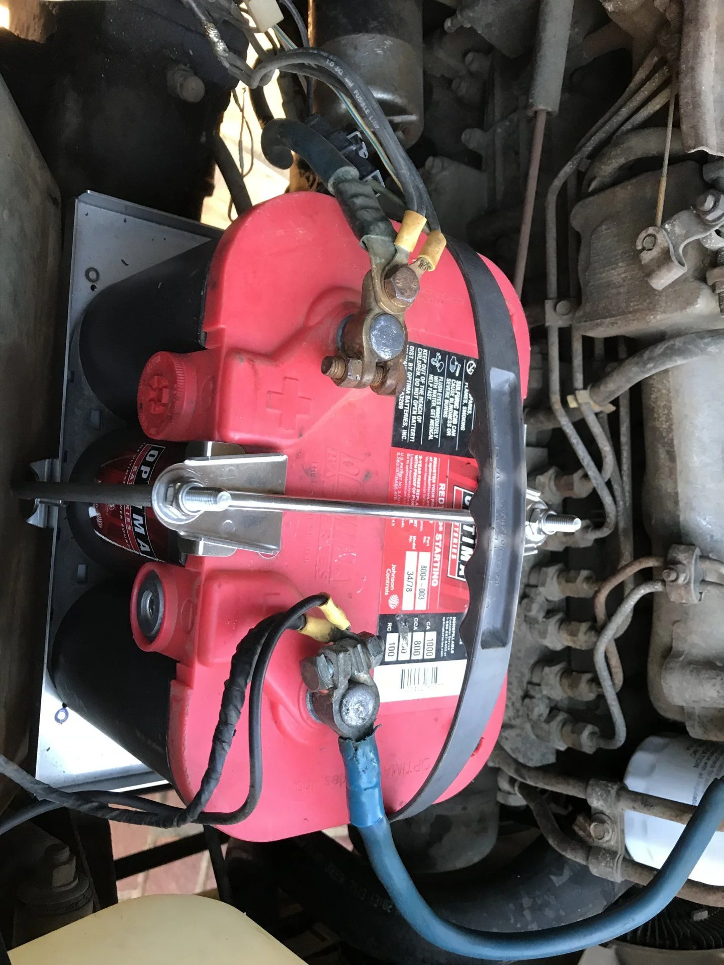

Just a little time spent today installing my new stainless steel battery tray from stainlesstrays.com. Couldn’t be happier.
Out with the old:
In with the new:
I’m glad you posted this. I need one for my Pig.
I’m very pleased with it. Construction looks great and Noel was helpful answering questions I had before purchase.
I got the Optima hold down version, which worked great and was a perfect fit.
I’ve had one on my 60 for years. Just forgot who I got it from because I’m old.
What is the difference on the Optima version? Is it the length of the hold down rods?
That’s exactly right. When I had the OEM holder on previously, I needed a bunch of nuts as spacers in order to get enough height to reach the threads. I think that the hold down is also slightly smaller to fit snugly over the Optima. Not positive on that, though. I just know it fits snugly.

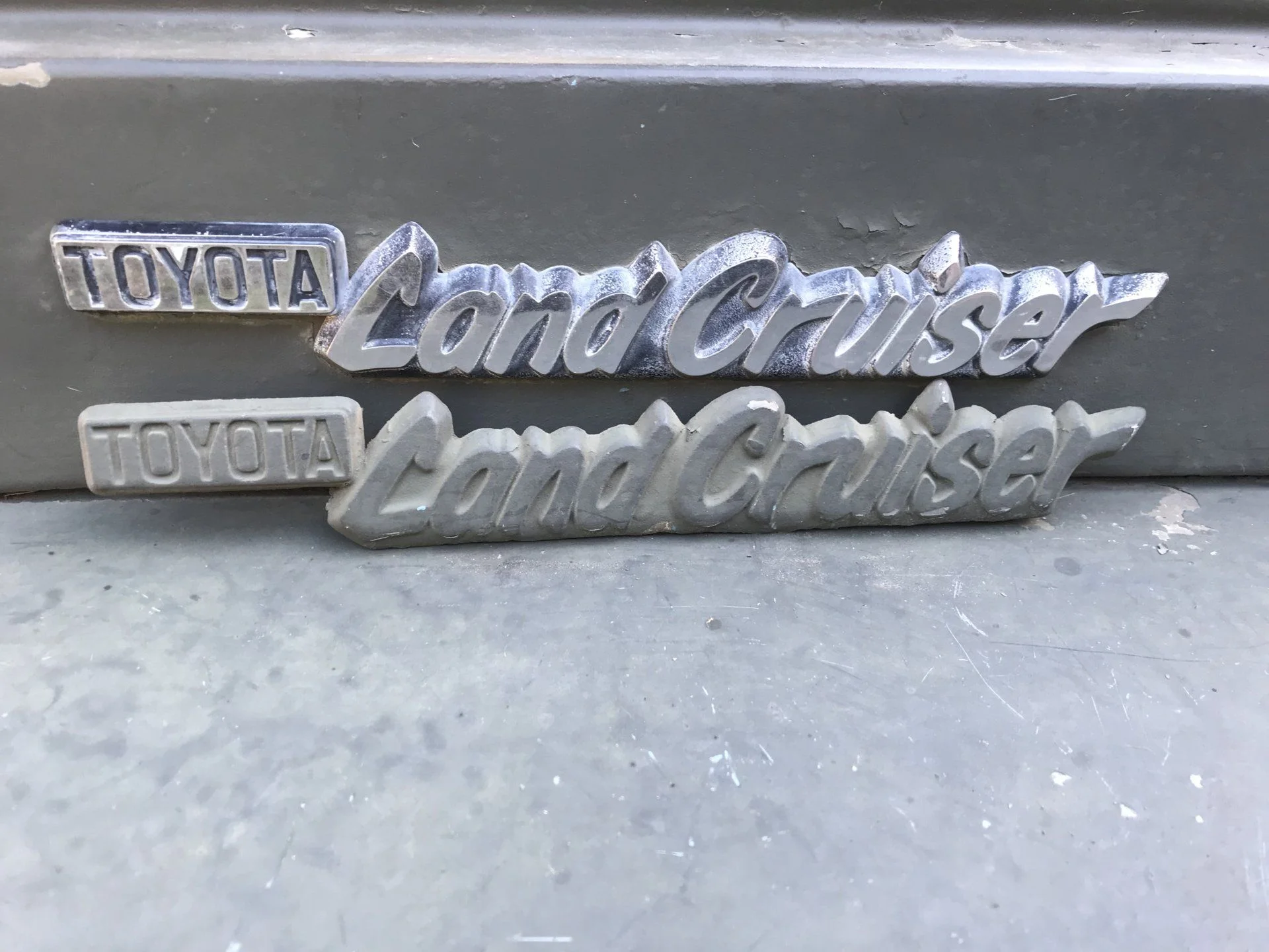

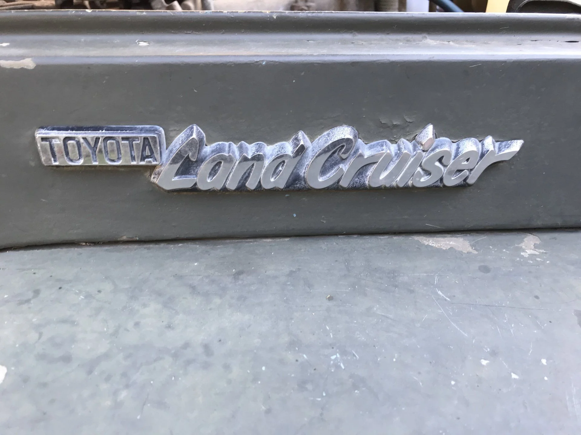

In the mean time, I also refreshed the badge on the driver’s side. Mine had been painted over more than once and I wanted to get the original look back. Found a cheap, used one on eBay and replaced mine.

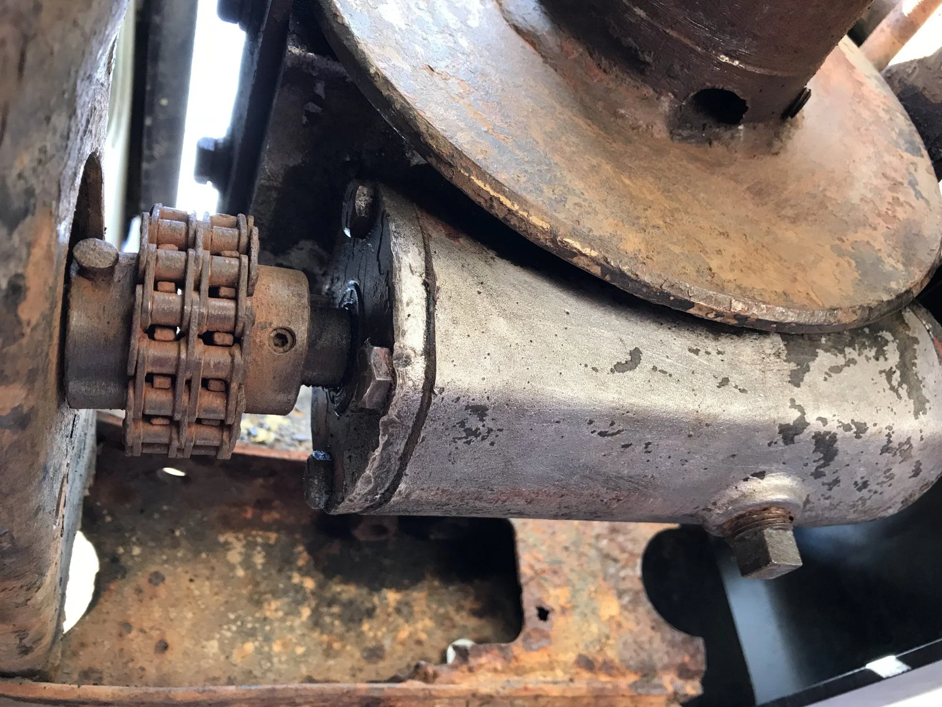

I’ve been planning to pull the winch and give it a thorough refresh, especially since Mark noted that it likely had some issues in the PTO. Now I’m looking to figure out the best way to remove the winch.

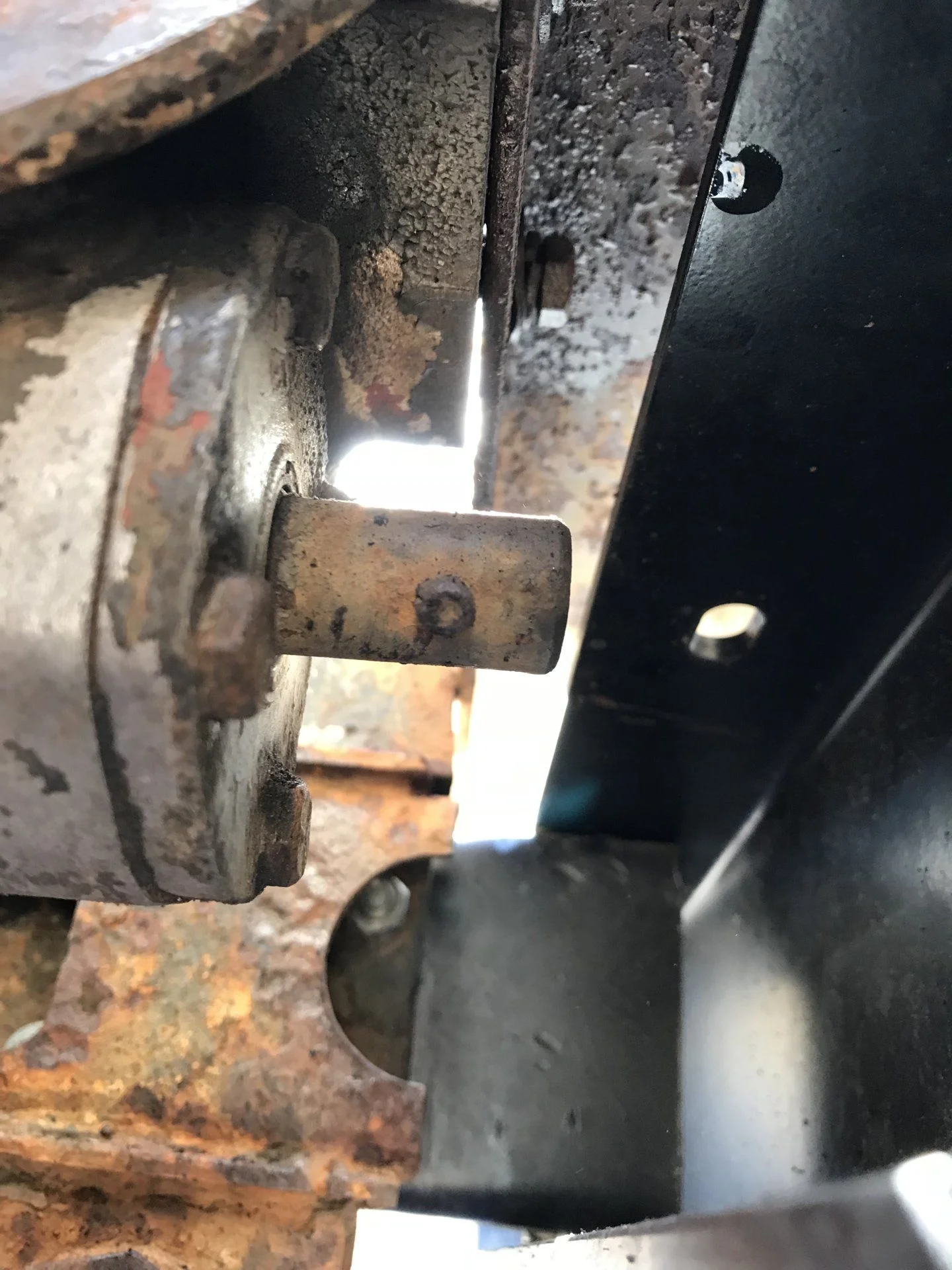

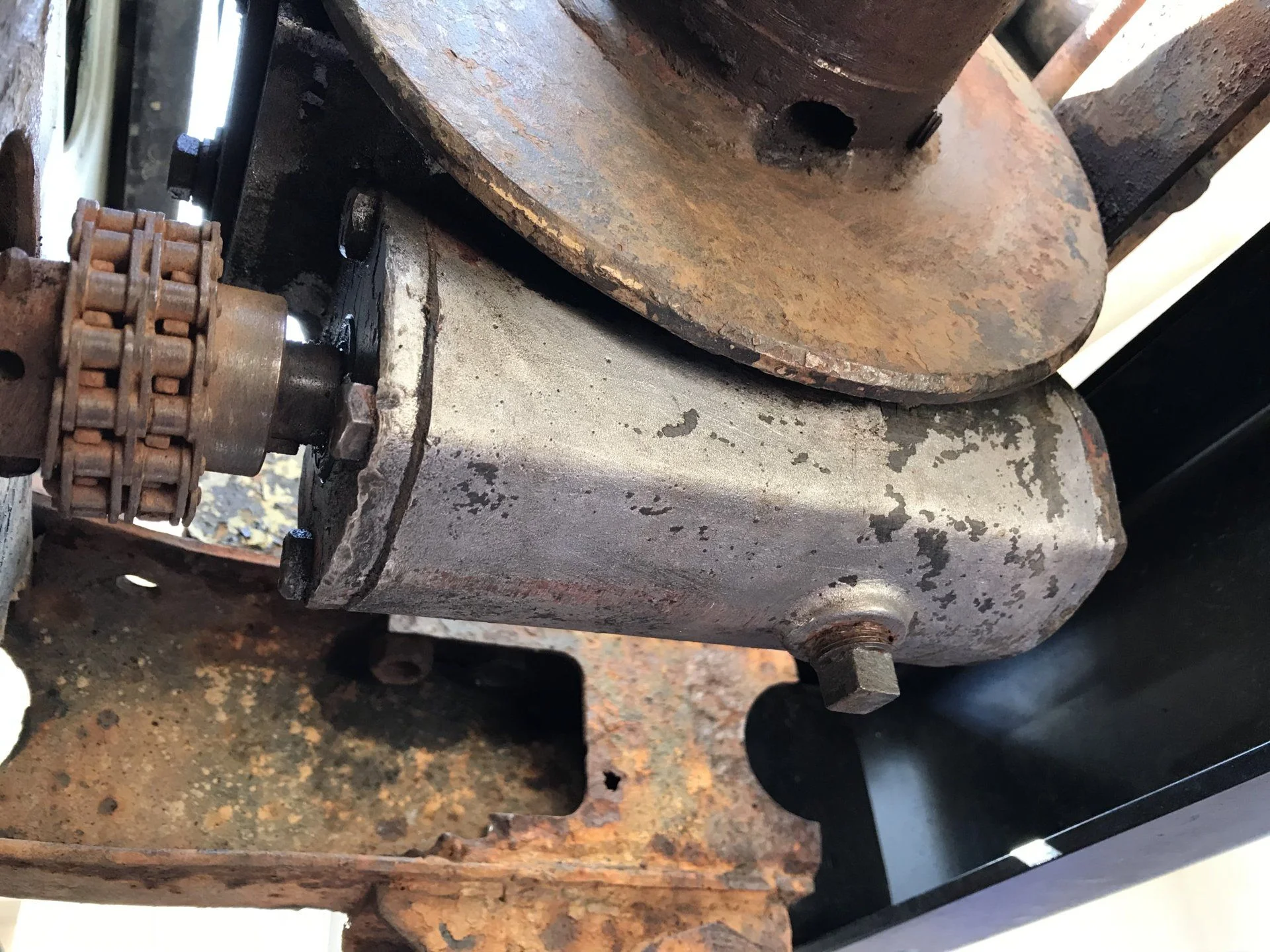

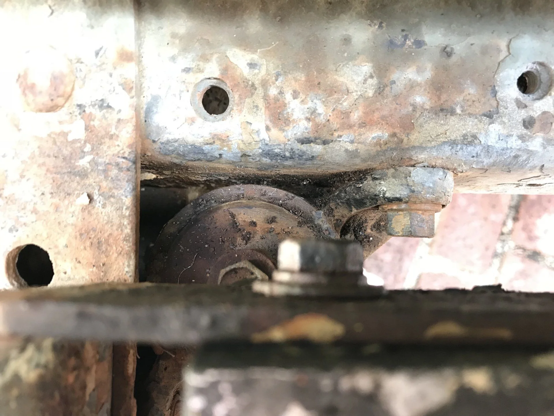

The winch frame simply bolts to the frame rails with four bolts. Simple enough, but I’m trying to figure out if I have to remove the front bumper in order to slide the winch shaft out through the cross member or if there is a way to disconnect the shaft from the gearbox at the winch. Here is what it looks like:
Rear
Front
This is a Thomas T8000 PTO Winch.
You should be able to find a center link on the chain coupler and simply remove the chain and lift winch up and out. I wouldn’t bother with the center arm, it gets tossed with the ps install!
Oh! I hadn’t even considered that the chain was a coupler—I was trying to figure out its function.
So, if I assume it’s like a bicycle chain, would I pull the center link in the chain apart and the chain would then unwrap/unravel and allow the winch head to separate from the shaft?

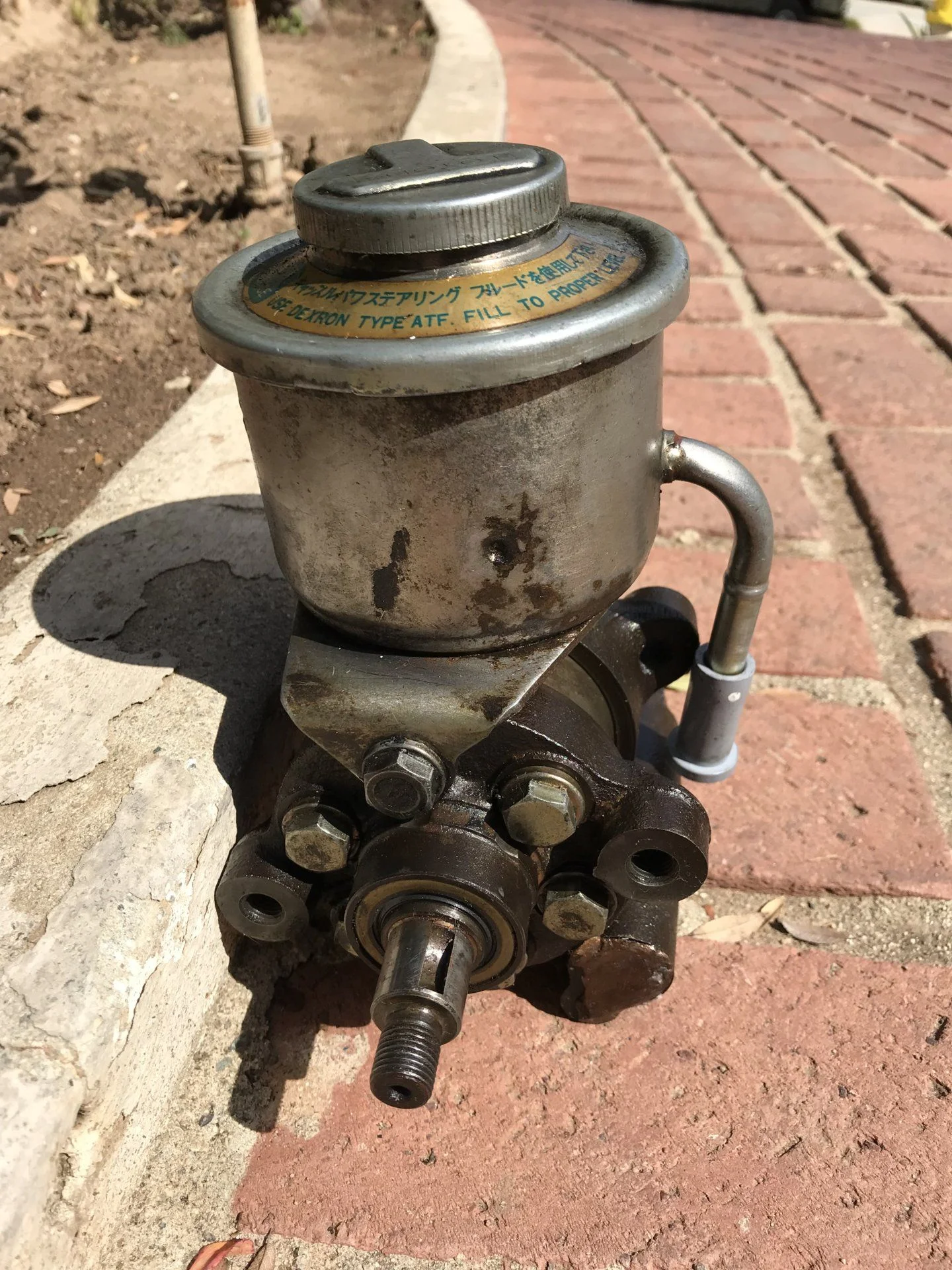

FJ60 PS Pump
