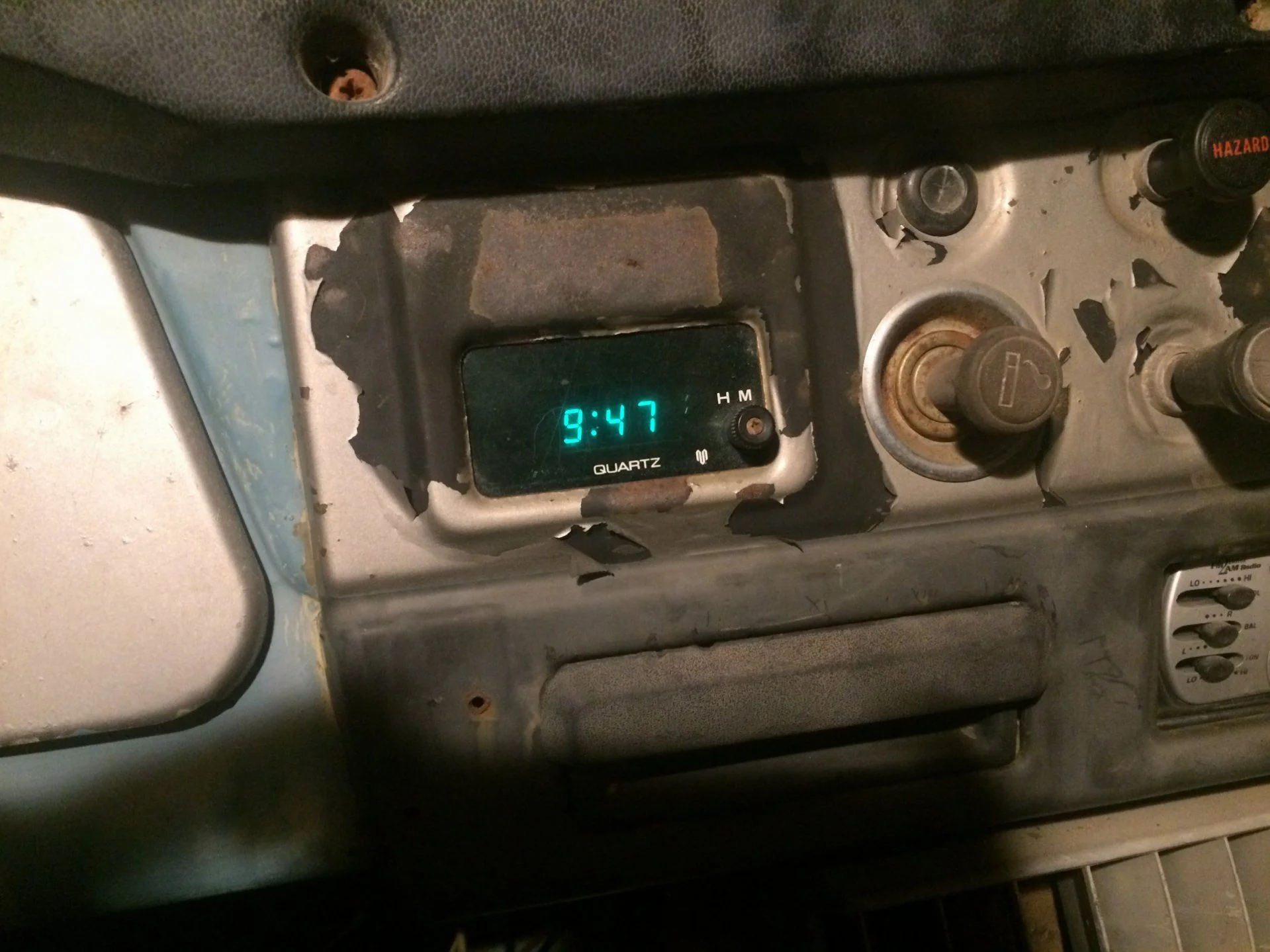

The clock has never worked since I got the truck. I bench tested it a long time ago and couldn't get it working, but again: confidence or lack thereof, I suspected my multimeter skills were at fault. I recently got a new dash panel with all switches and a clock and that one worked! I had to redo the wiring inside the dash, because the Army had reworked it for a blackout switch that had long since been removed by a PO.
Maybe I'll use the old clock as a housing for a Raspberry Pi or something.
While I was in there I also replaced the hazard switch with a new one from my new dash panel. The stem in the old switch was no longer connected to the inside of the switch, so it was not functional.
With the new switch, though, I have another Rudy-worthy conundrum for @bj40green. With the hazard switch pulled all the way out, I don't get lights or flashing, though I can hear the flasher clicking. I noticed that if I turned the turn signal on while the hazard switch was on my hazard lights came on and flashed properly.
I also noticed that if I only pulled the hazard switch out approximately 3/4 of the way the hazard lights flash appropriately.
Why could that be?!?

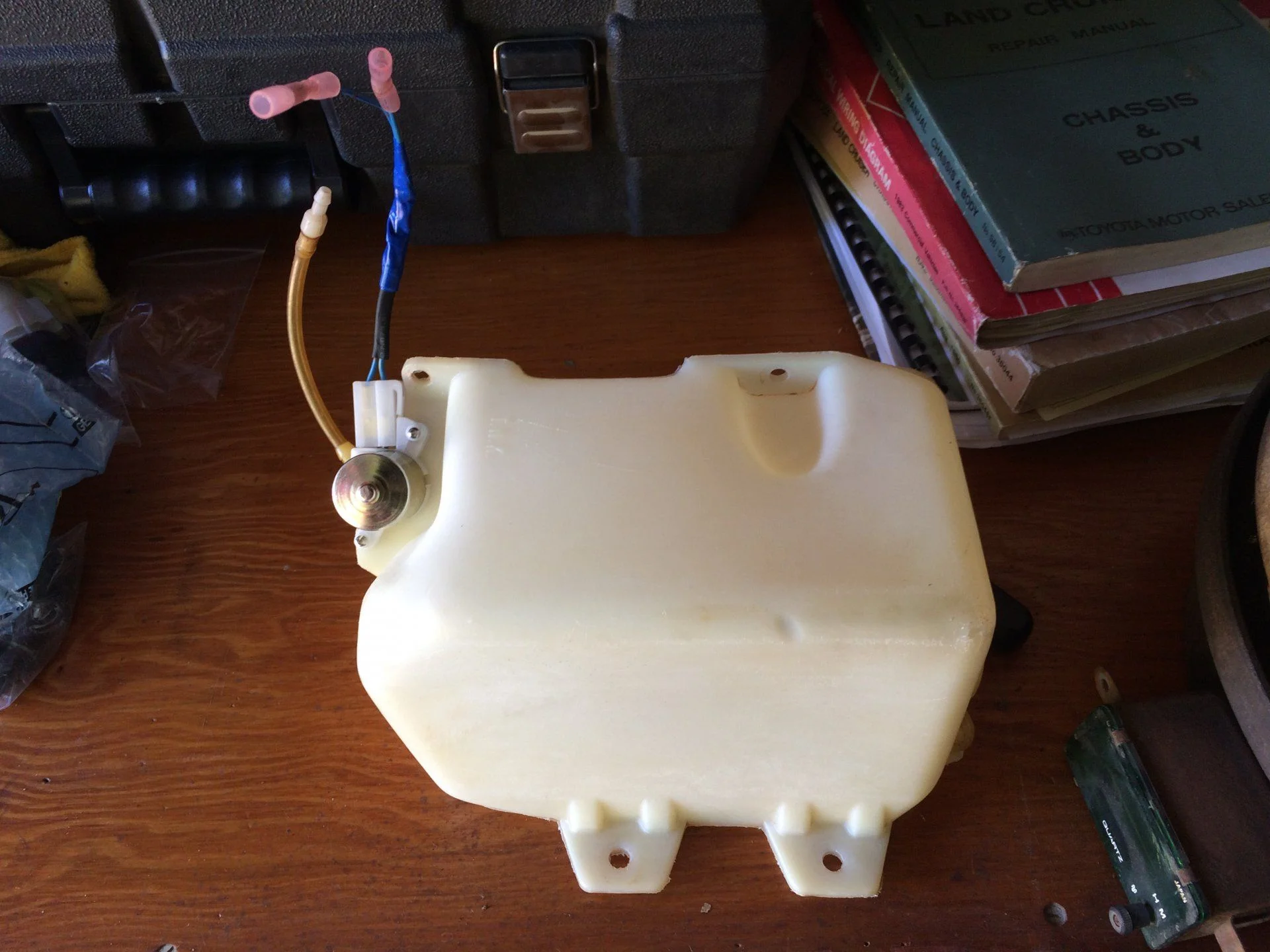

Small progress.
Although I understand a lot about how these old trucks work, thanks largely to helpful folks on Mud, I don't have a lot of time or practical experience working on them so my self-confidence is usually relatively low when it comes time to do work.
I spoke of this awhile back with my friend, @65swb45, and he suggested that to get familiar with working on things and build some confidence that I should just take something small, remove it from the truck, clean it, and put it back on.
As is often the case I took the advice and mulled it over for a long period of time while I figured out a plan of action.

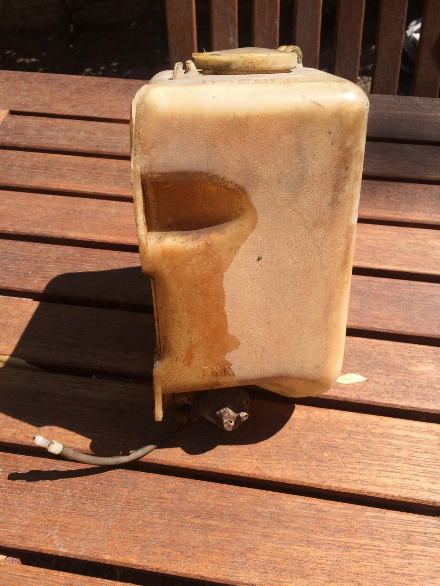

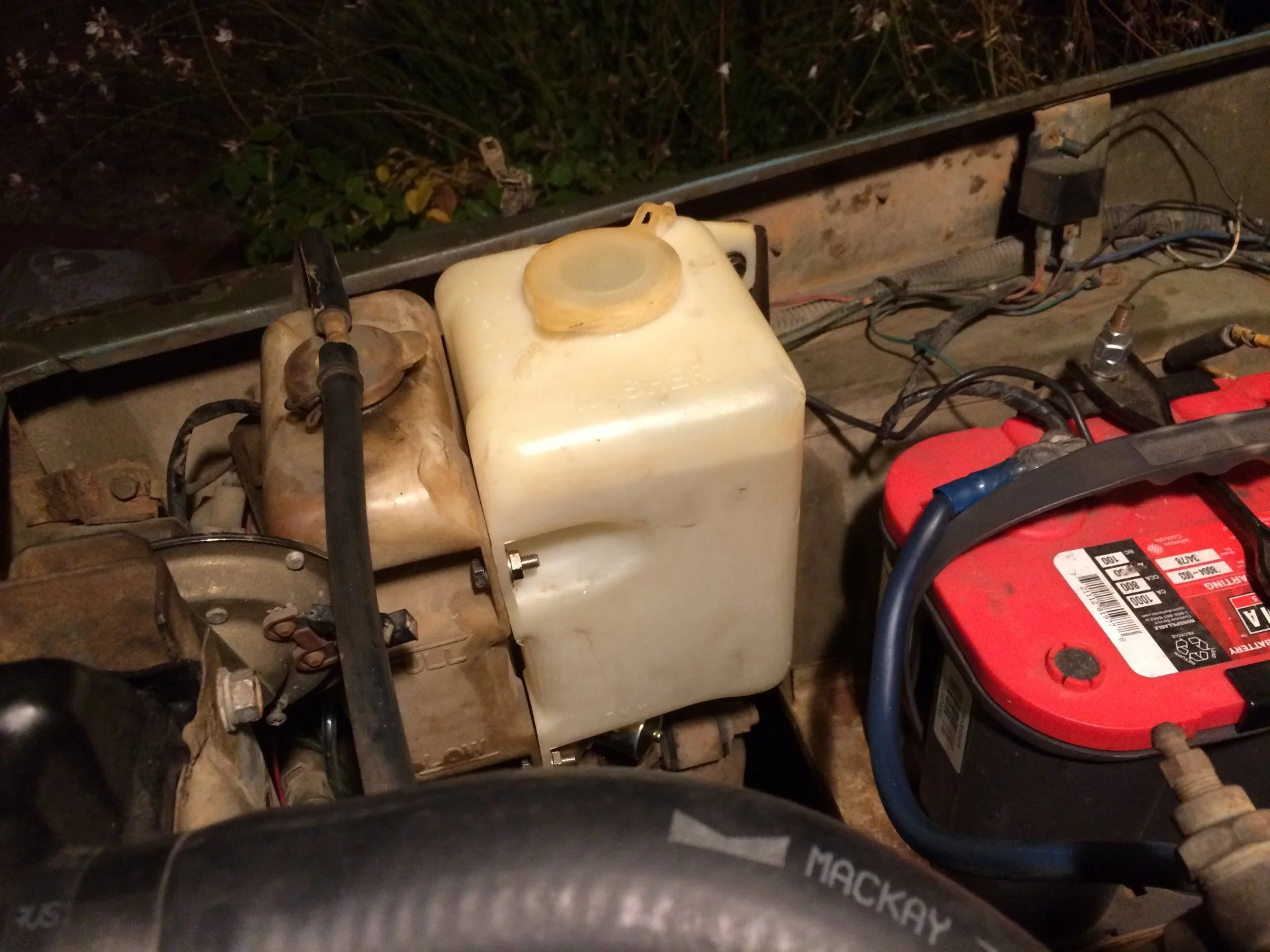

Fast forward a few months to this weekend when I was finally prepared to remove the windshield washer bottle and pump. My old pump motor was corroded and no longer connected, and the bottle itself was filthy.
I watched some YouTube videos and got to scrubbing and produced this:
Installed:
:clap::clap:
Thanks Mark, and thanks for the encouragement, too!

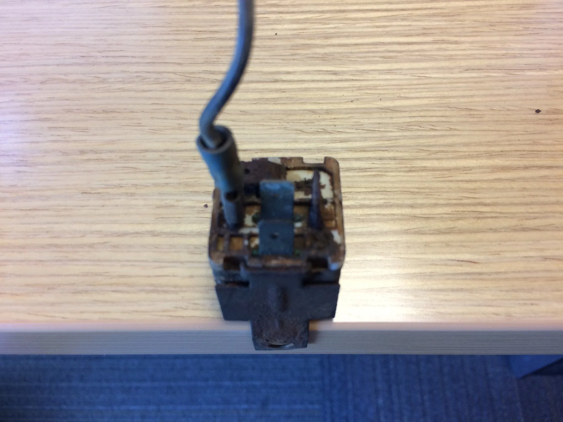

So, as is so often the case with these things, I did not get a perfect score. The new motor works perfectly (bench-tested), but I can't make it work from the wiper switch.
Previously the old motor wasn't plugged in, and the harness plug was instead plugged in to this old thing:
I think that it was there just to complete the circuit, because it was not attached to anything other than ground.
As far as the non-working washer pump goes, I have done the following:
  • Confirmed that when connected directly to + battery terminal and ground the pump works and squirts water
  • Followed the path of the harness where the Blue (L) and the Blue-Yellow (L-Y) wires travel below the radiator, along the passenger's fender wall, and into the cab and do not see signs of it being cut—mind you I did not open up the loom to visually inspect the wires across the entire run
  • Cleaned the wiper switch and the contact area on the dash panel, though I think from reading the wiring diagram that on my late model truck there is a dedicated ground wire, the switch is not grounded to the frame by the retaining nut
Since the washer motor works by turning the switch's knob to complete the ground, I'm guessing that somewhere I have a grounding issue. But where is it likeliest to occur? And how best to test?
W/B is your ground wire. The switch makes a short between L/Y and W/B.
Test: touch the L/Y on the switch side to bare metal. If motor works.... the L/Y is OK.
If not.... trace the L/Y from motor to switch.
Rudi
@bj40green, I wasn't sure of the best way to get at the L/Y on the switch side with the wiper switch still attached.
On the later model wiper switches there are two connectors, one which has the L-Y/W-B separated. I pulled the switch from that connector and jumpered from the L-Y to the W-B on the harness side, and that did not cause the washer motor to engage.
Is that a valid test?
The test is valid. The question now is; is there voltage on the L wire to the motor?
If yes: is there voltage on the L/Y wire from the motor?
If yes: is there voltage on the L/Y wire at the wiper switch?
Rudi
@bj40green Rudi, thank you again for your patience and encouragement!
I pulled the test light out of my tool box tonight, disconnected the two-prong connector from the pump motor and tried the following:
  • Probe inside L connector and wire connected to body: light goes on with key in ON position. I think that that confirms voltage on the L wire
  • Probe inside LY connector and wire connected to + terminal on battery: light goes on when wiper switch is turned counter-clockwise (or anti-clockwise as the Antipodeans say). I think that this confirms voltage on L-Y both at the motor and at the switch.
Sadly, reconnecting the two-prong connector to the pump did not result in water squirting from the washer pump. That leads me to believe that the connector is corroded and that although my sharp-pointed test light probe was able to make good contact, the flat connectors of the pump motor do not.
How does that sound for a theory?
English is not my 1st language so try to understand what i'm saying.
Did you connect the (sharp) probe trough the insulation of the wire or did you make contact to the female spade connector(s)?
It's possible that the wire is corroded where it goes into the spade connector.
Solution.... buy a new connector from @Coolerman or cut off the connector and replace with 2 new female spade connectors.
Rudi
Understood perfectly. I pushed the probe into the female spade connectors.
As it happens, when I bought the new pump I also got a harness (because I thought mine was missing, snivel it was not connected to the pump motor). So I have a brand new female connector, with a pigtail that has proper color-coded Toyota wires attached. It even already has 3M waterproof bullet connectors, ready for me to splice to the existing harness.
Is that the better option at this stage, versus trying to clean up the original connector that's there? The truck is certainly no show truck, so keeping it "all original" is already a lost cause.
Yet again, with the sage advice and guidance of @bj40green, I've blundered my way through another one of the electrical gremlins in my truck.
Before chopping into my harness I took a metal nail file and scraped away at the female connectors. Thirty seconds of work, reconnect the pump motor, turn the key and twist the knob (clockwise, not counter-clockwise as I falsely asserted above) and that she blows!!!
It's the small victories that keep me going. Thanks, again, Rudi!
You found and solved it! :bounce::bounce2:

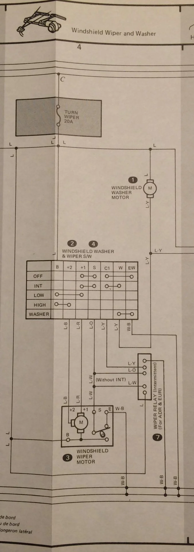

So with the washer pump motor sorted out, it's time to shift to the intermittent wipers and that wonderful little marvel of 1980's Toyota engineering, the wiper control relay.
Prior to removing the relay I would get a slight burning smell when I tried the wipers on the intermittent setting. Opening it up I found a fair heap of dust right in between the contacts. I'm pretty sure that that was the source of the burning smell.
I cleaned the innards with some electrical contact cleaner and some 400 grit sandpaper. The gears were spinning freely so I did not elect to regrease them.
Once I put the relay back in, I tested the wiper mechanism with my windshield wiper blades and arms removed—I was paranoid that I might burn up the motor or something vaguely weird like that, I guess.
I observed that I could hear the small motor inside the relay engage, and I watched the posts on which the wipers are attached spin in what looked like the correct motions on the low and high settings, but on the intermittent setting they didn't seem to be going in exactly the right way. Or at least not in the way that I expected. There was a delay, but it did not go in a distinct pattern of "counter-clockwise half turn, clockwise half turn, delay, repeat" pattern that I was expecting.
Thinking I might just not be that good at conceptualizing things I decided to attach the wipers. I confirmed the low and high settings were working properly, but at that point the intermittent setting seemed to no longer be working, and I didn't hear the relay's motor working anymore.
I tested voltage on the harness connector. There is a constant 12v on the L, and nothing on LO, LW or LY, which I think is correct as per the diagram I posted in #30 above.
So I think I need to bench test the Wiper Control Relay, but I'm not quite sure of how to go about that, and I'm a little concerned that I might damage it.
I think I need to apply 12v to the L post, hook up the WB post to ground, and then I think I need to jumper across LO and LW in order to engage the motor. Is that correct?
Hi Thomas,
Do you have another diagram? I think there is an error in this diagram, especially in the wiper motor diagram.
Have a look at the wiper motor; bottom is connected to B (battery) via the L wire.
Top +2 (= high) is connected to L/B switch B to L wire. Which is plus 12V to plus 12V.
Same goes for +1 (= low) is connected to L/R switch to B to L wire. Which is also plus 12V to plus 12V.
The wiper motor is nowhere connected to ground.
Rudi
