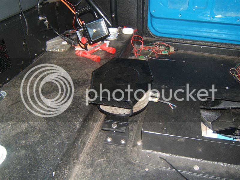

Nothing exciting to show but tons of progress. Pretty much all of the wiring from the back and the engine compartment has been run to the dash. Looming, wrapping and securing cable is time consuming... Also got the Dakota Digital dual fan controller and Diesel tach module installed in the glove box. Most of the wiring here is done too. Going to make a plexi shield in front of the modules to protect them when I throw stuff in the glove box.
Fabbed up a little shield to protect the vent filter and also got some mud flaps installed on the rear.
Rear heater is installed and I'm almost ready to install the front one (a little bit of wiring left to do before its installed) the plumbing is ready to install, so should go pretty quick. Also got the dryer for the A/C and the overflow bottle permanently installed.
Lots of stuff done and lots left to do but things look good for this summer (lets hope nothing happens...)
